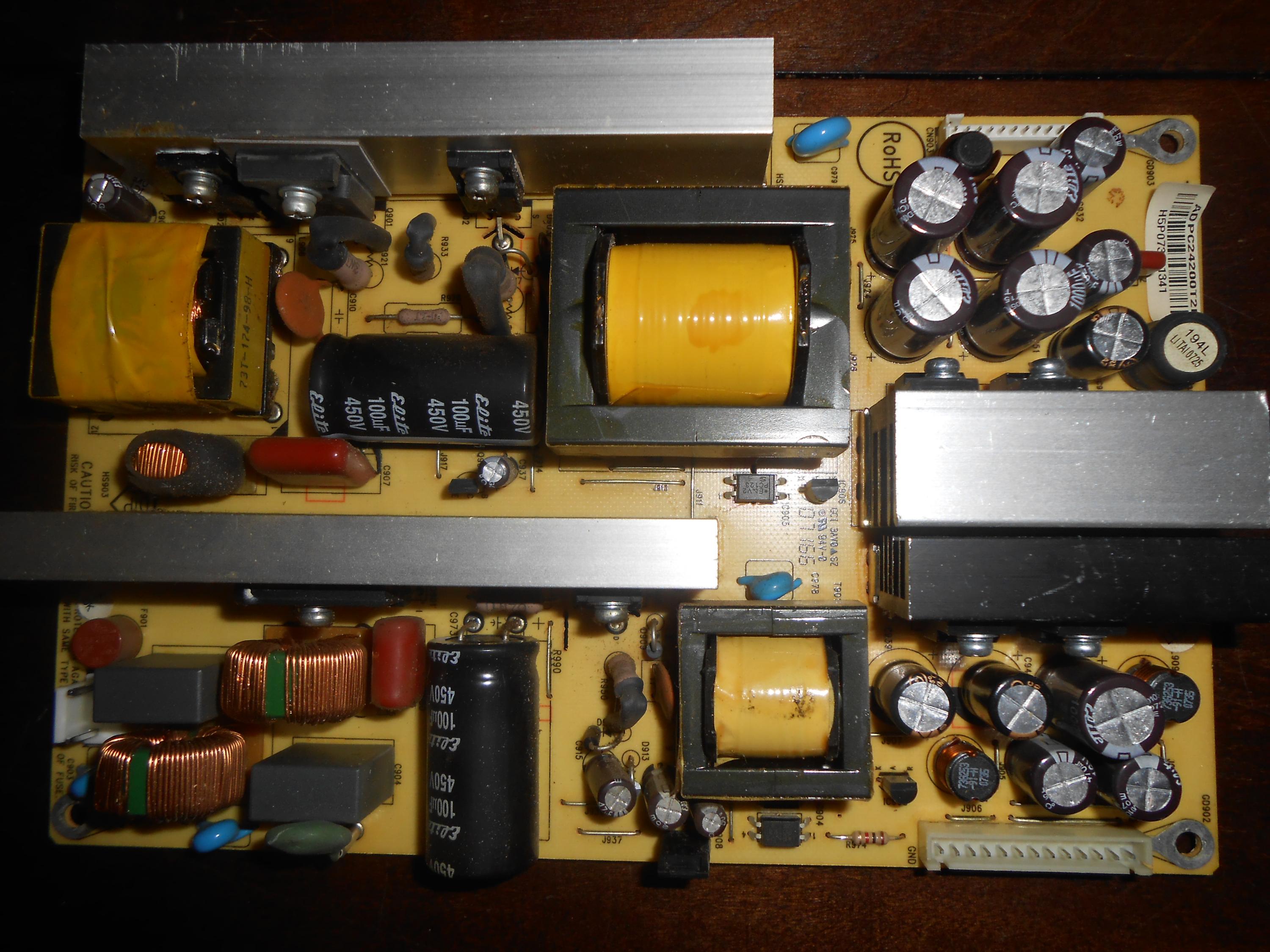

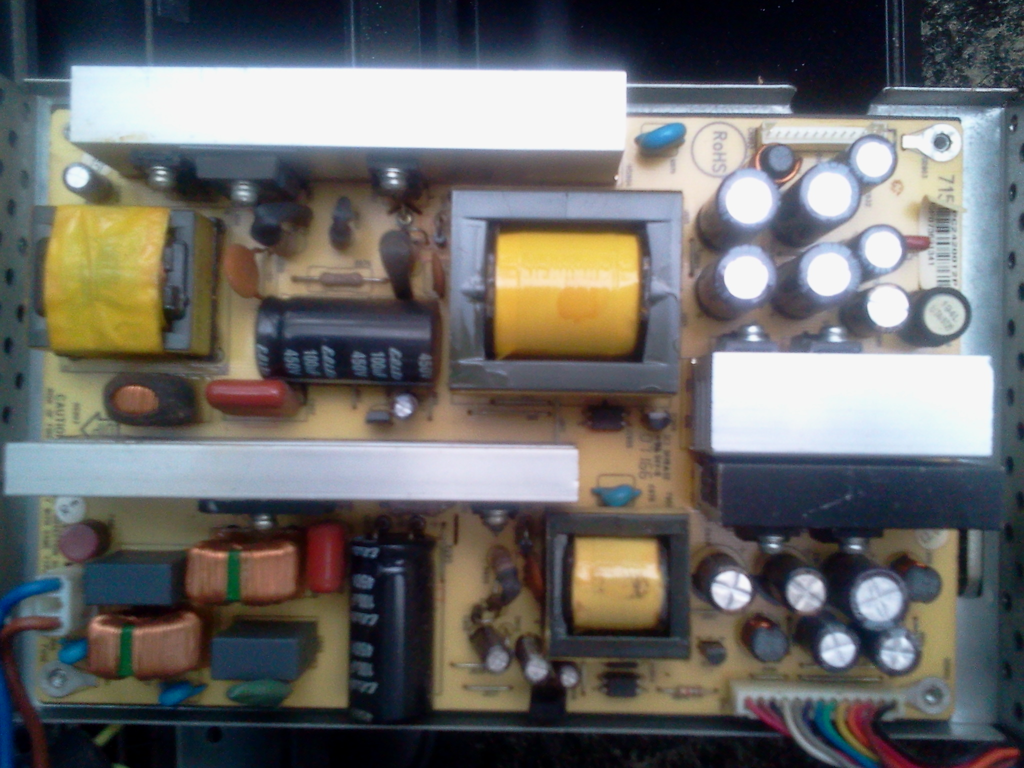

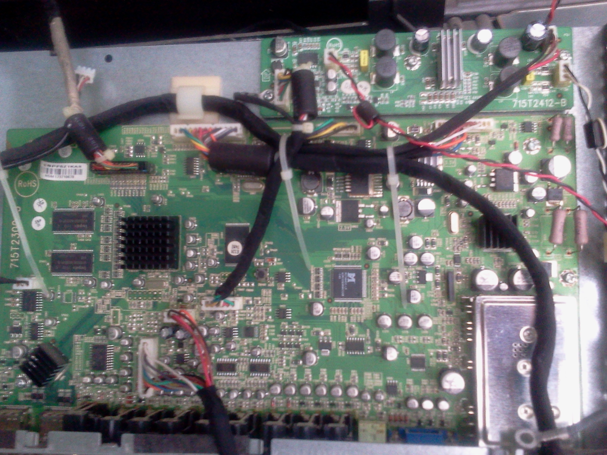

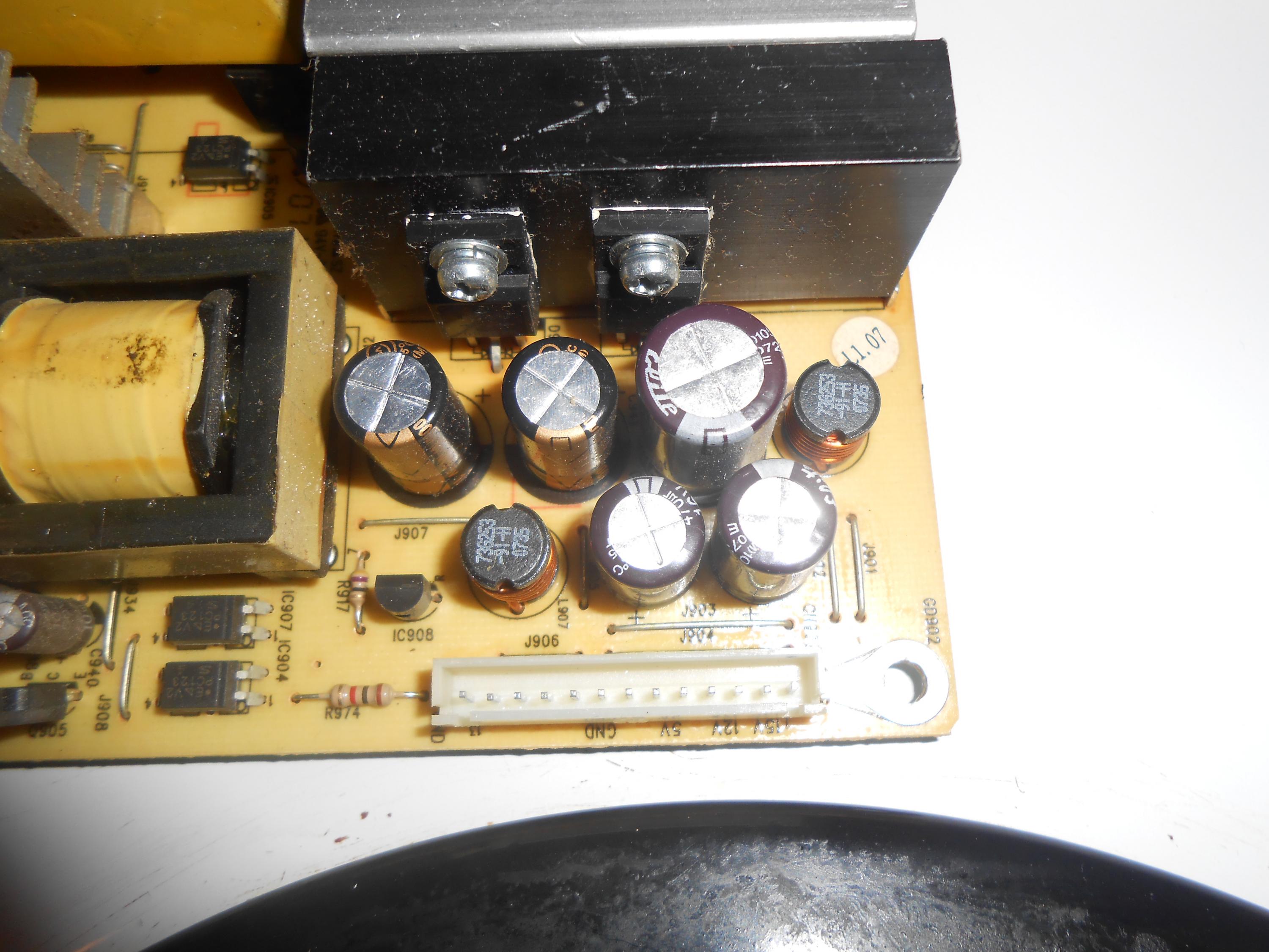

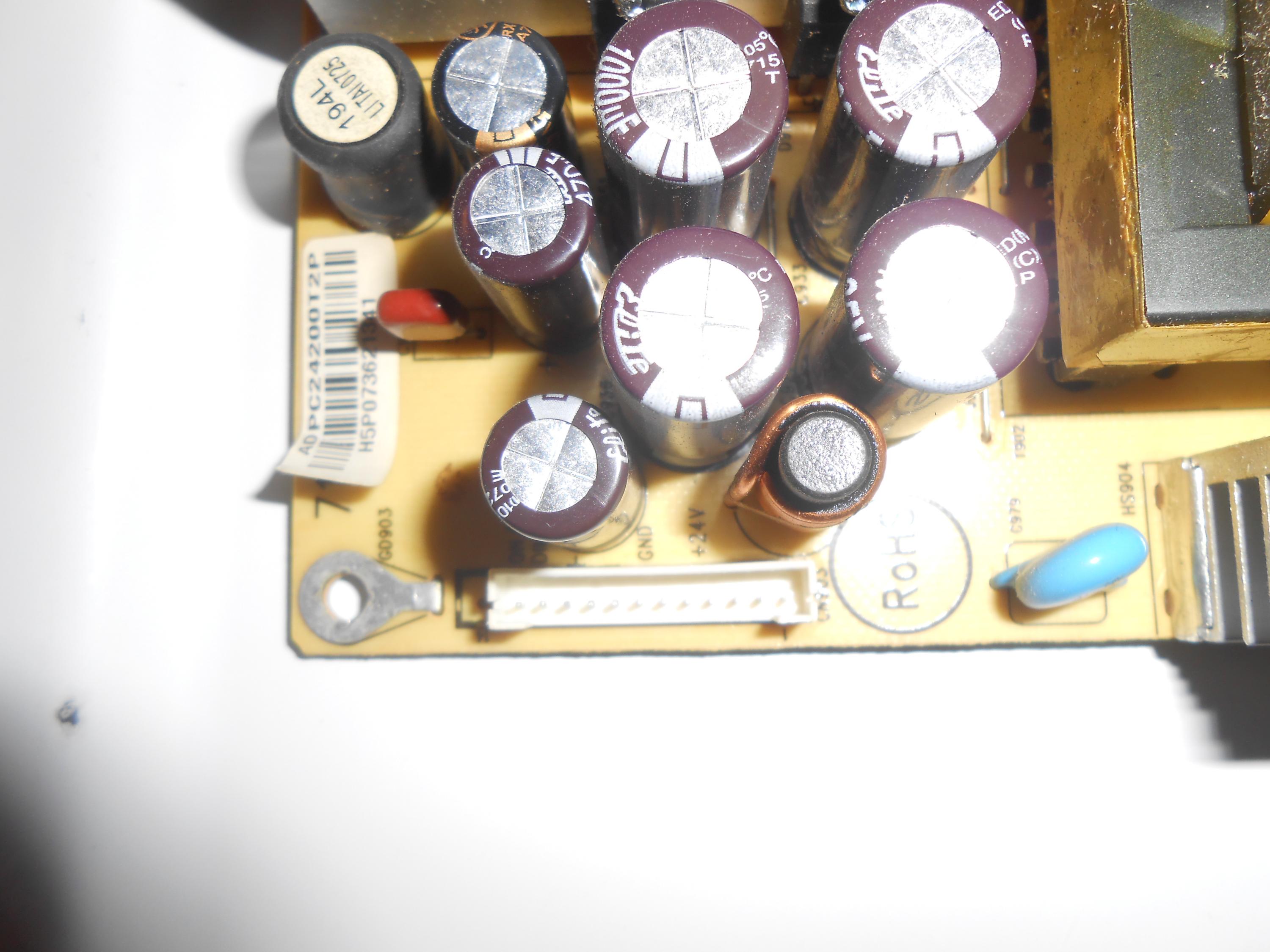

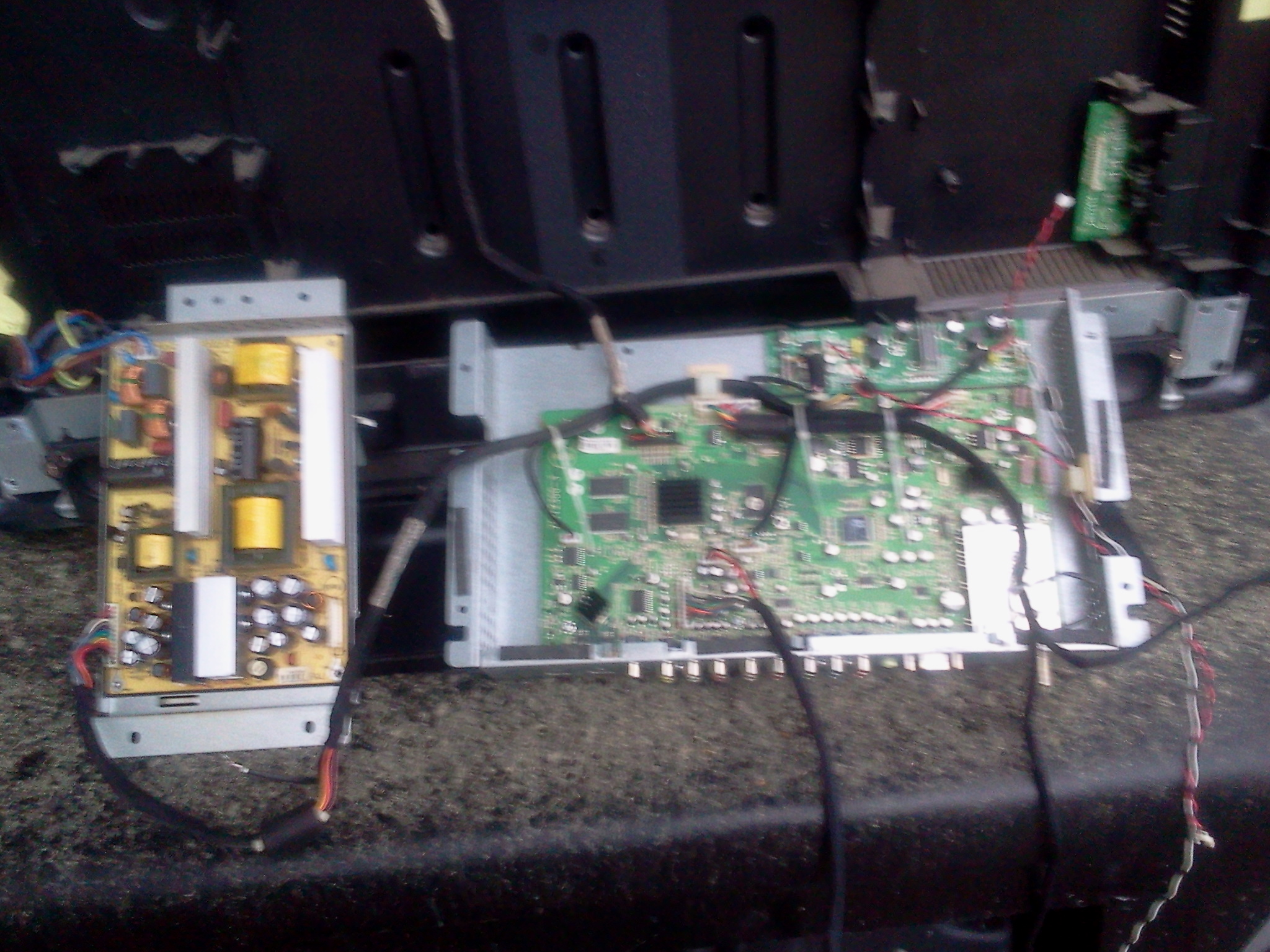

Here is pic of ps and main board my pwer supwply has voltage on the left hand plug going to motherboard but none on plug going to inverter think it sau
ys 24v. what do u think.Attached Filesif you find these attachements useful please consider making a small donation to the site

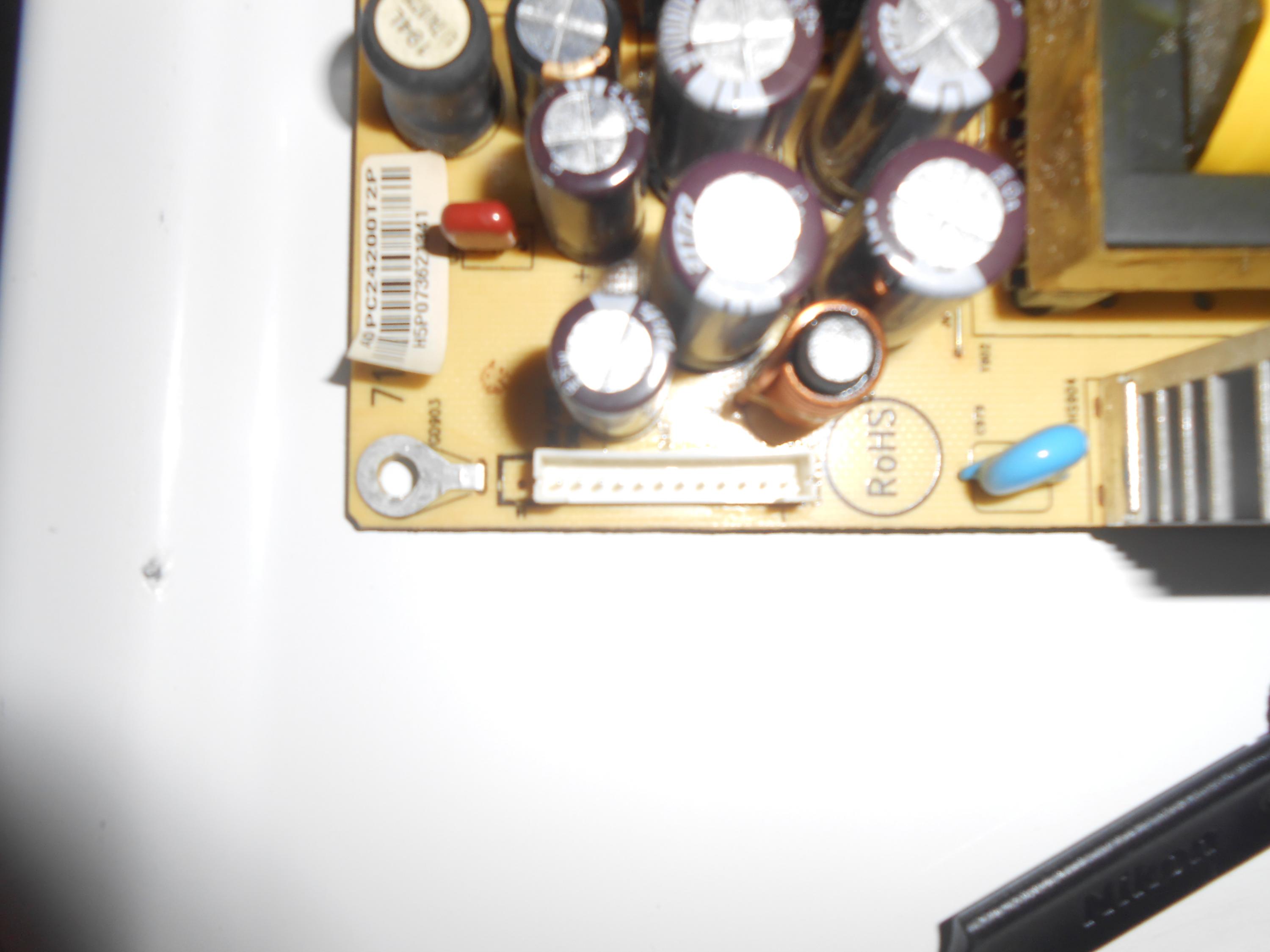

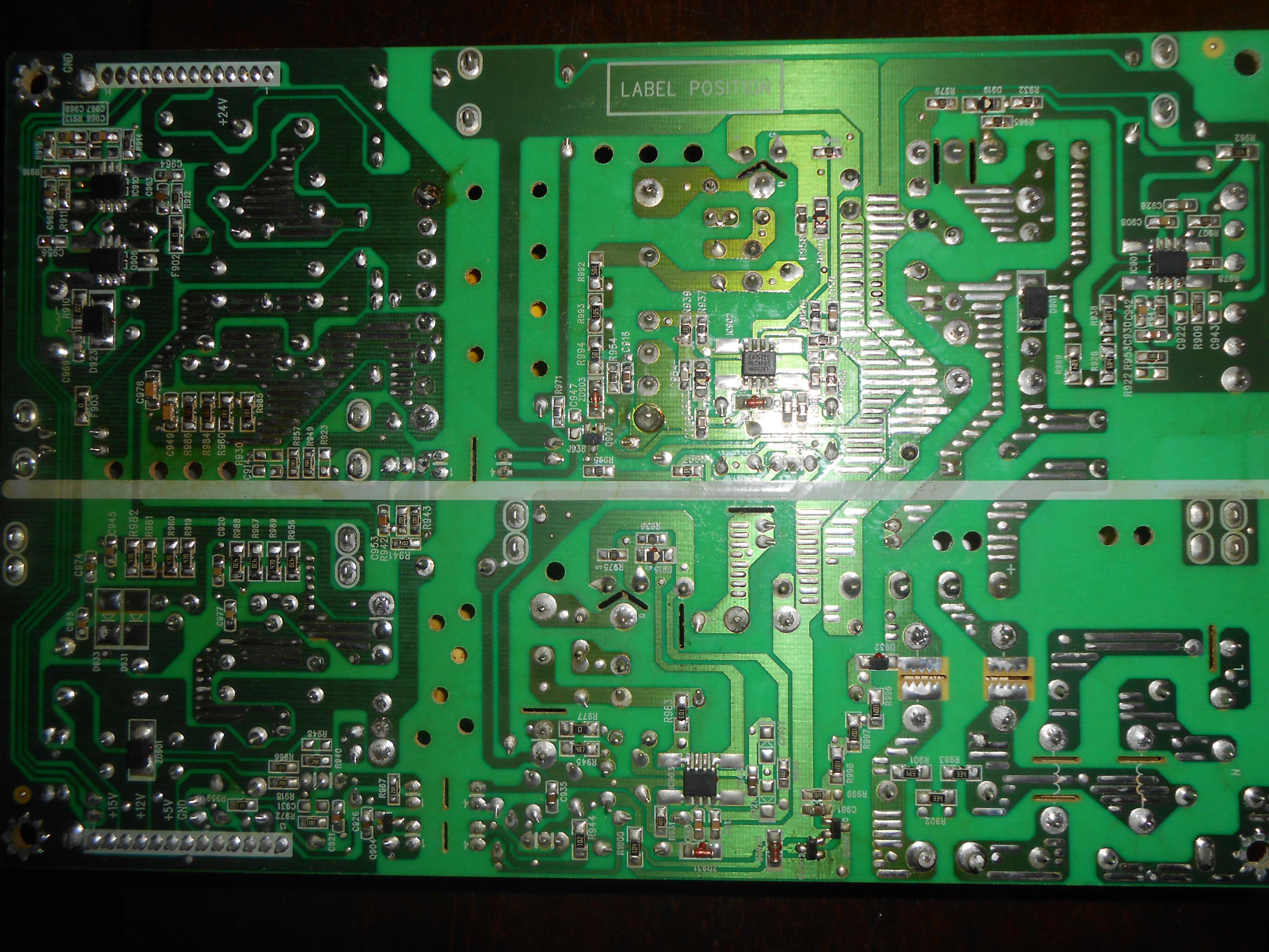

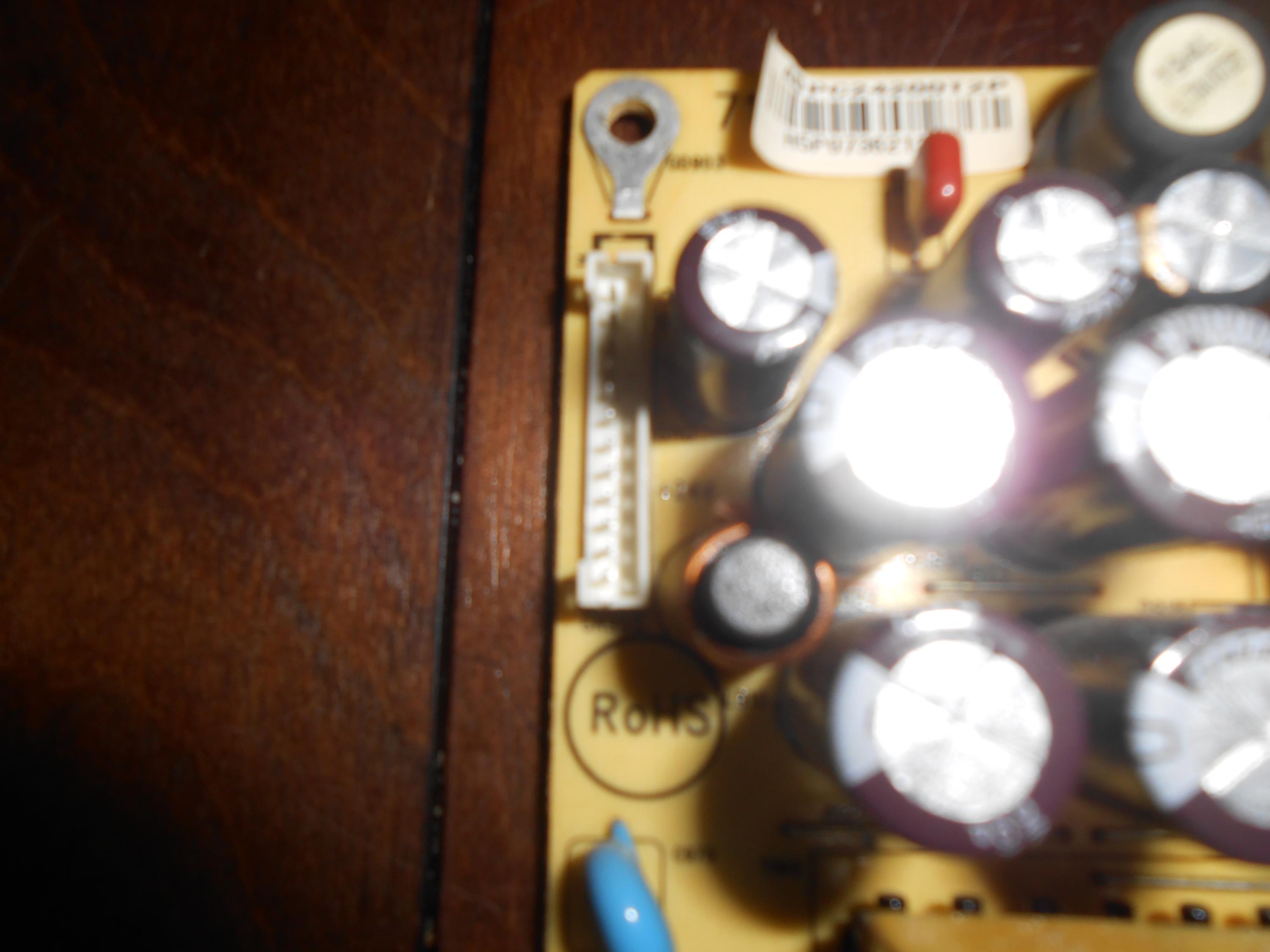

Can we see a pic of bottom of the PSU?
Also do Budm's suggested check of the big cap voltage.Please do not PM me with questions! Questions via PM will not be answered. Post on the forums instead!
For service manual, schematic, boardview (board view), datasheet, cad - use our search.Comment
Re: Rca 32inch l32wd22 no power up no inverter light.
Both big caps have 165v with meter on 400dcv. i am uploading additional pictures now.Comment

All right i have double checked i got 5, 12, 14.9 v on power supply, i got
5v standby , 12v, at main board, but when i press the power on i hear nothing and the voltage on the plug to invertor board is non existent. Could i have a main board problem instead of power supply issue.Comment
