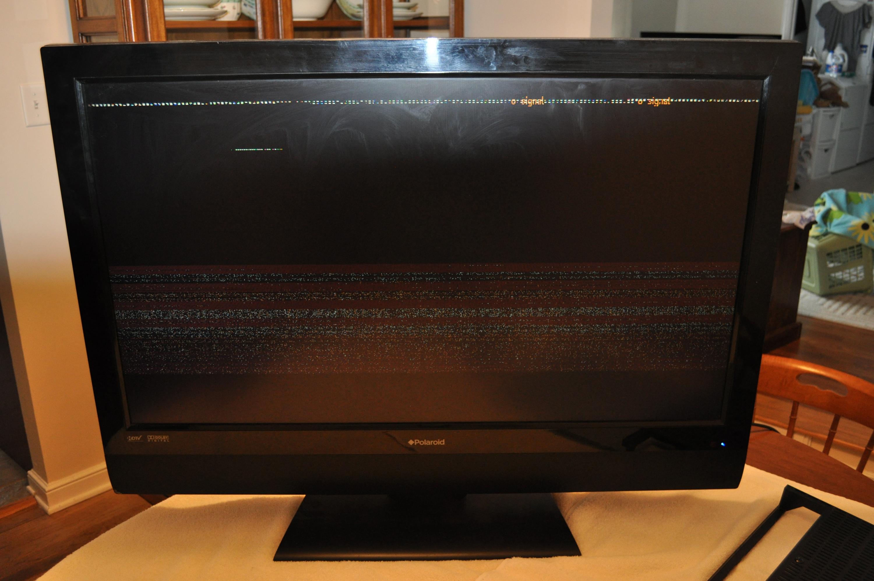

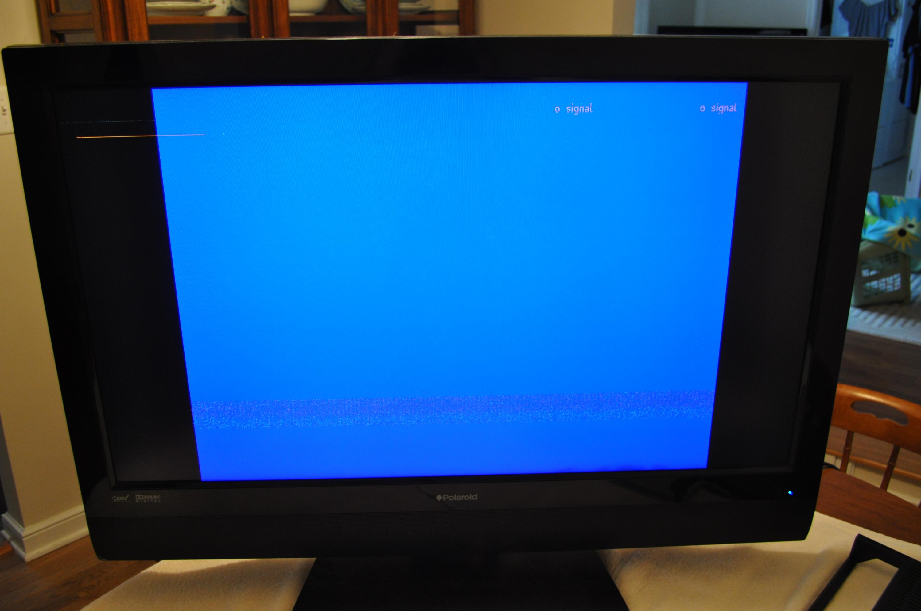

    Ok since you guys helped me fix my first set I picked up another one to try. Its a Polaroid FLM-4034b. It will power up to a blue screen with the words no input. I can get the menu to come up but thats it. It does click and pop a little and every so often it will make a loud buzz. The screen also appears to have random lines running through it at times. The screen also goes through different color patterns. I have opened it up and there are no "visual" signs of bad capacitors. Any ideas? thanks

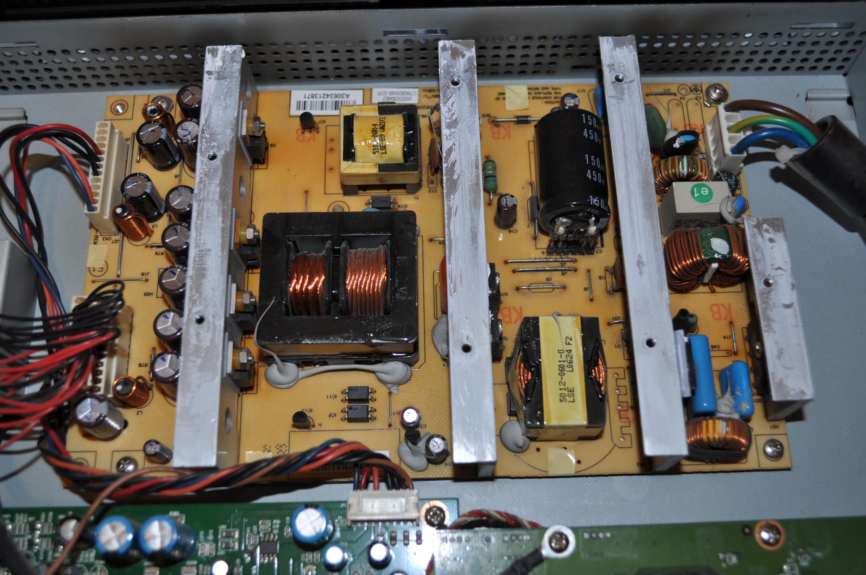

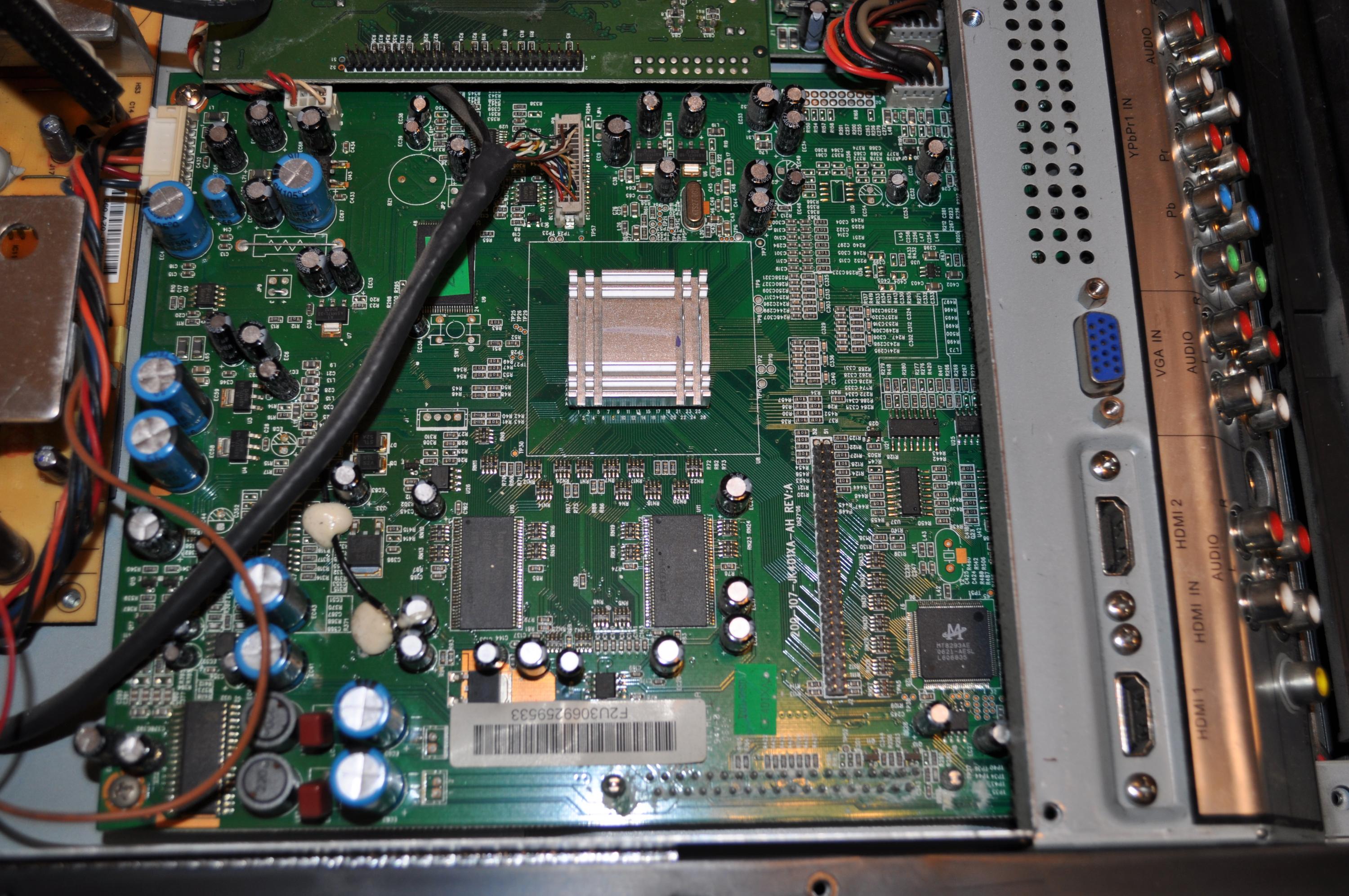

    I've fixed several Polaroids similar to this one. It's more than likely either bad caps that aren't bulging or a main board going bad. These seem to be the only issues with these sets. Do you have an ESR meter? Can you post pics of your power supply and main board?

            Here are some pics...

              Did some checking main boards are hard to find for this model. Can the main board be fixed? Should I look for bad caps or is there something else I should look for?

                  You can check the regulators, I've had four of these style TVs come across my bench in the last couple months. One of them had bad caps. The other three were all main boards. I checked all of the regulators and DC-DC converters and didn't find anything out of whack. If you haven't already, it wouldn't hurt to check the voltages coming from the PSU.

                        Re: Polaroid FLM-4034b issues
                        Voltages from the PSU are correct.

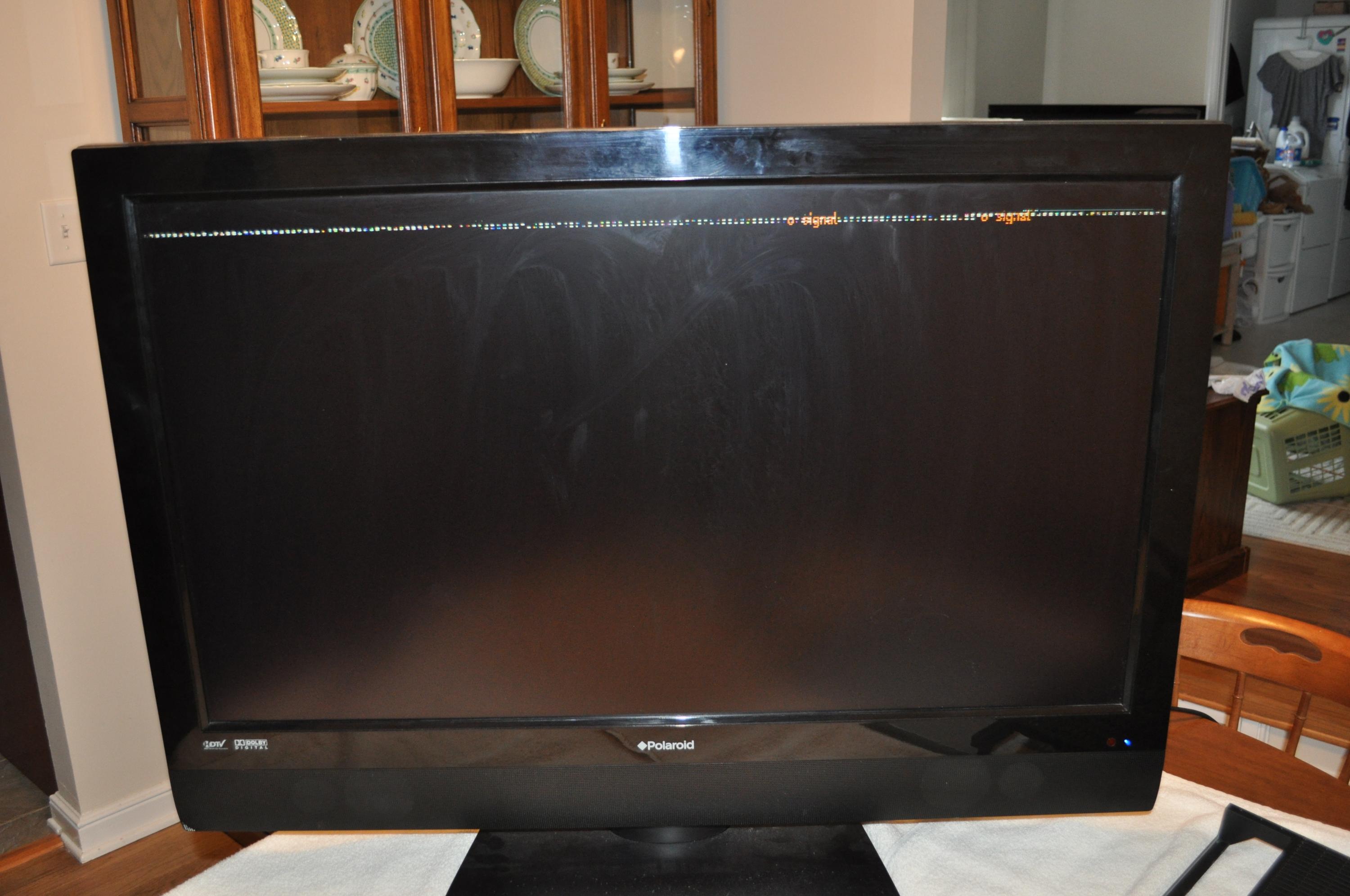

                          I took some additional pics of the different phases of the screen.

                            Thoughts?
                              Definitely looks like a main board issue to me.
                              The large BGA processor with the heatsink has probably overheated, this is introducing errors into the processing of the video.
                              You can try reflowing the processor, but it would only be a temporary measure, at best.

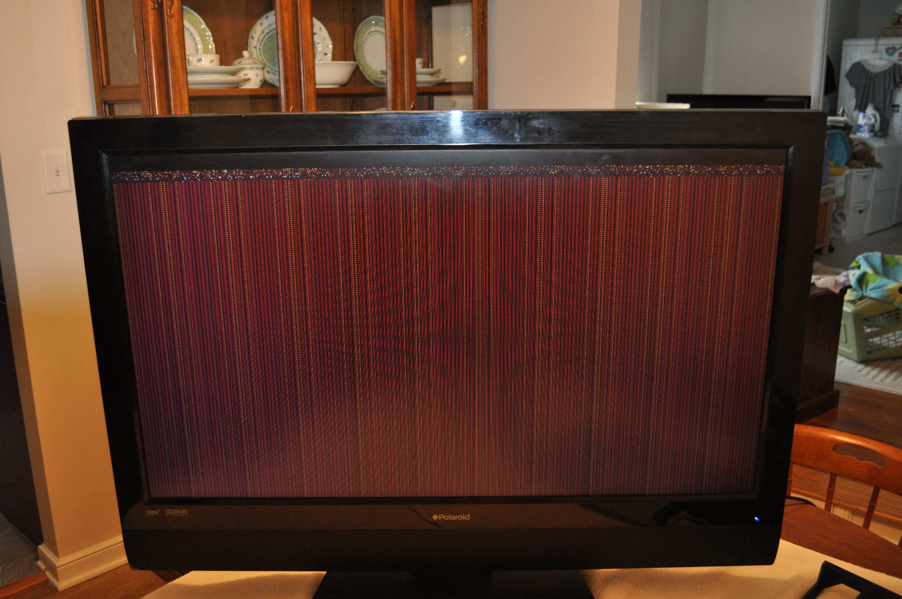

                                Ok finally got back around to this one. Ordered a replacement main board and now I have this. I'm thinking another bad main board?
                                  That looks like Gamma voltage problem on the T-CON board like this SAMSUNG.
                                  http://s807.photobucket.com/user/bud...?sort=3&page=1
                                  All the connectors are properly seated?

                                    Looks more like T-conn board failure to me.

                                      Could be T-Con, but could be a bad main as well. What does the menu look like with no signal applied?

                                        I also have the solarized video but it is not the tcon as I have tried 2 known working tcons. I think there is a main board issue but unsure where to look. Anyone have any ideas? Thanks. Mine is a FLM-3232.
