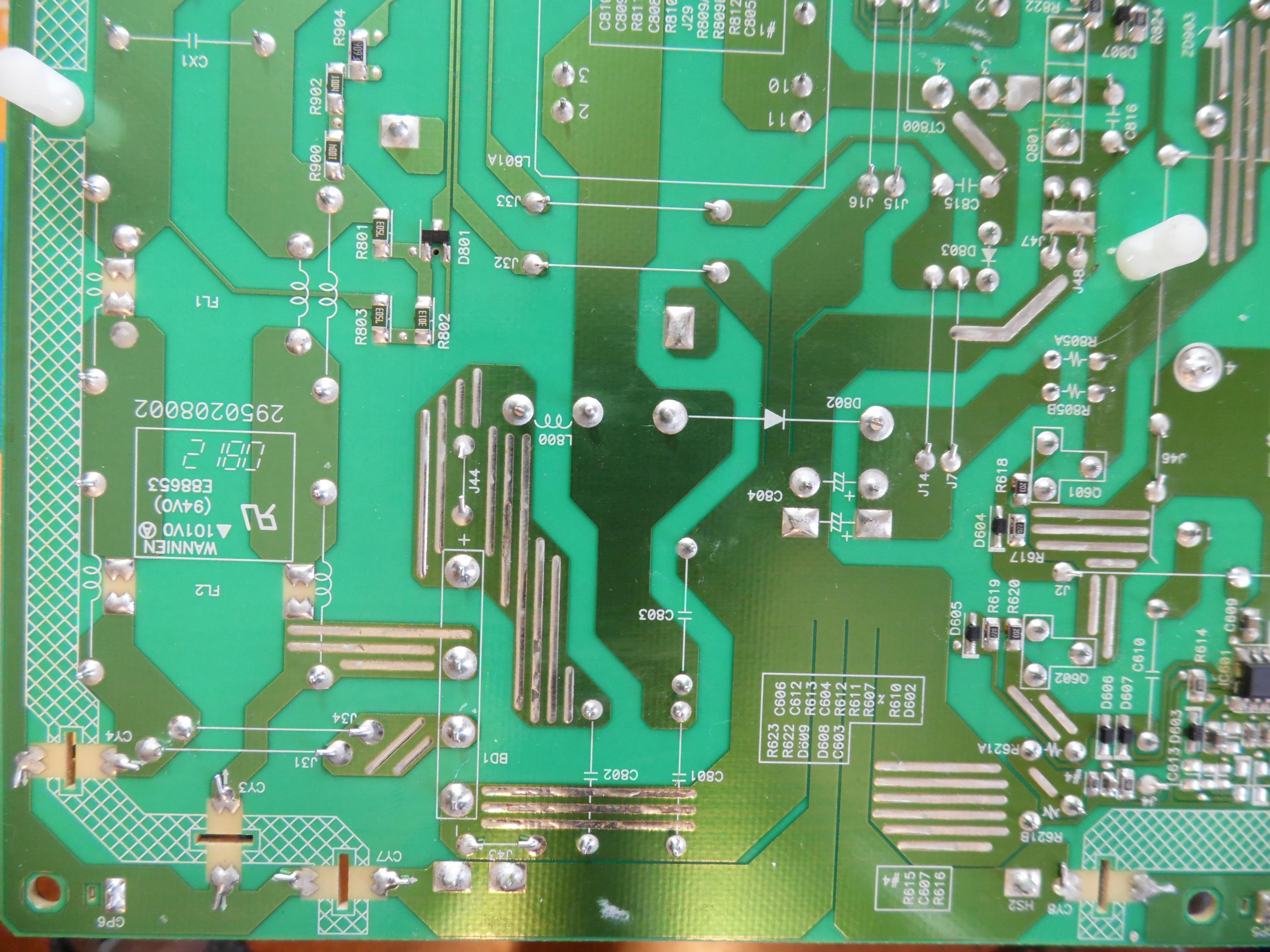

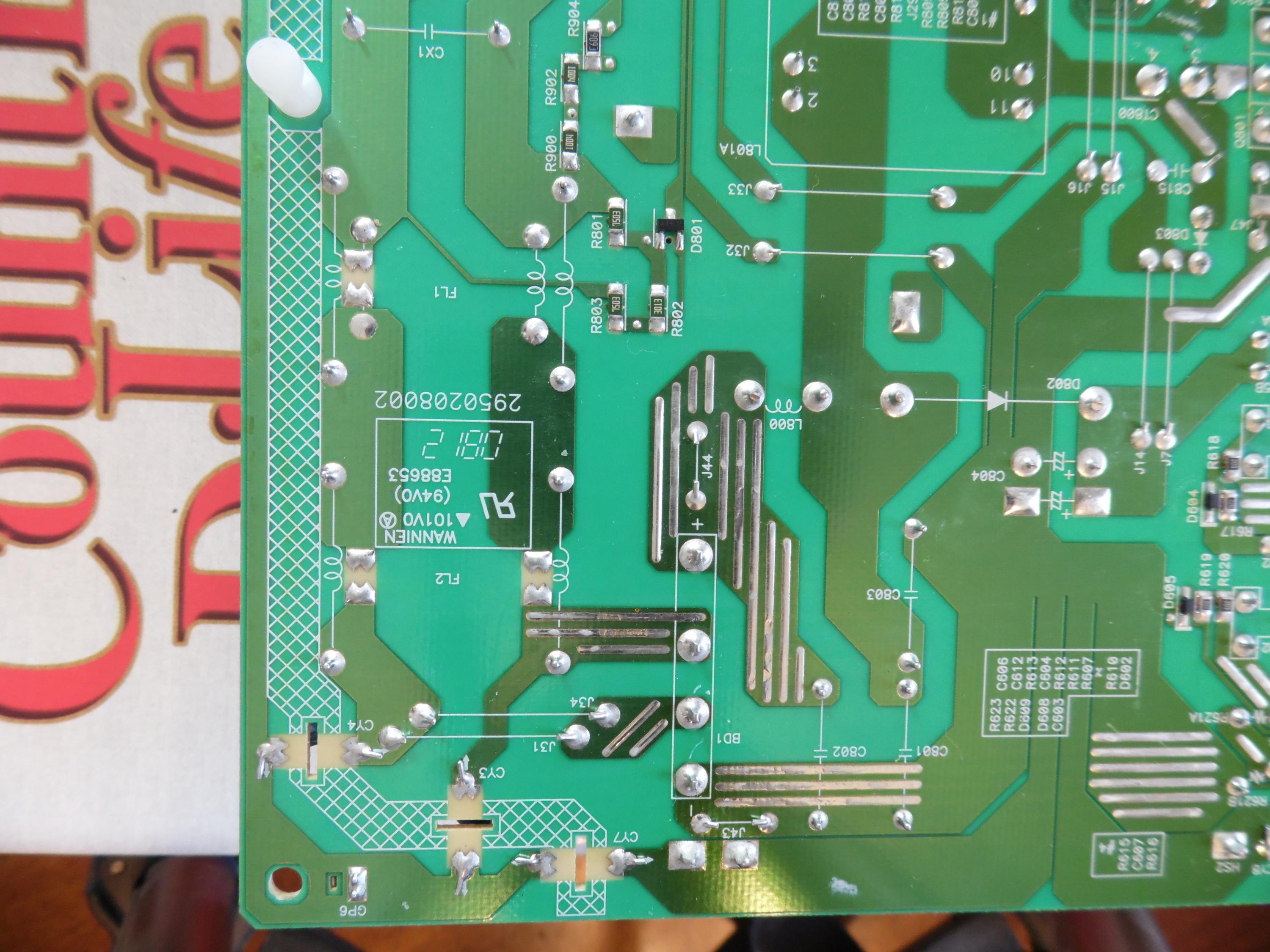

    Hi guys i have a vizio vw42l. I initially had a bad voltage regular on the main board. I had messed the tracing up on while removing the regulator. After attempts of trying to fix my mess up i made it worse and removed more tracing. I put the project on hold for a couple months and finally just bought a new main board. After installing new board the tv came on and everything worked great! I buttoned everything up the next day and went to turn it on, now i have nothing! Tore back apart and now i am no longer getting 24v or 12v from the power supply. The led turns orange to white and will will turn back off also. I have 5vdc coming from the supply to the main and i am getting 3.3vdc back to the ps_on. The 12v side of the main has no readings what so ever either. Please help, i am getting very frustrated. Thanks.

                  I have done a little. I have fixed 6 TVs so far from the forums. Caps, voltage regulators, power transistor. I have usually been able to find a post simular to the issue at had and diag from there. Not this time. I have a klien digital mm. Can read capacitance. Assortment of solder irons, solder sucker, solder wick, and plenty of room!

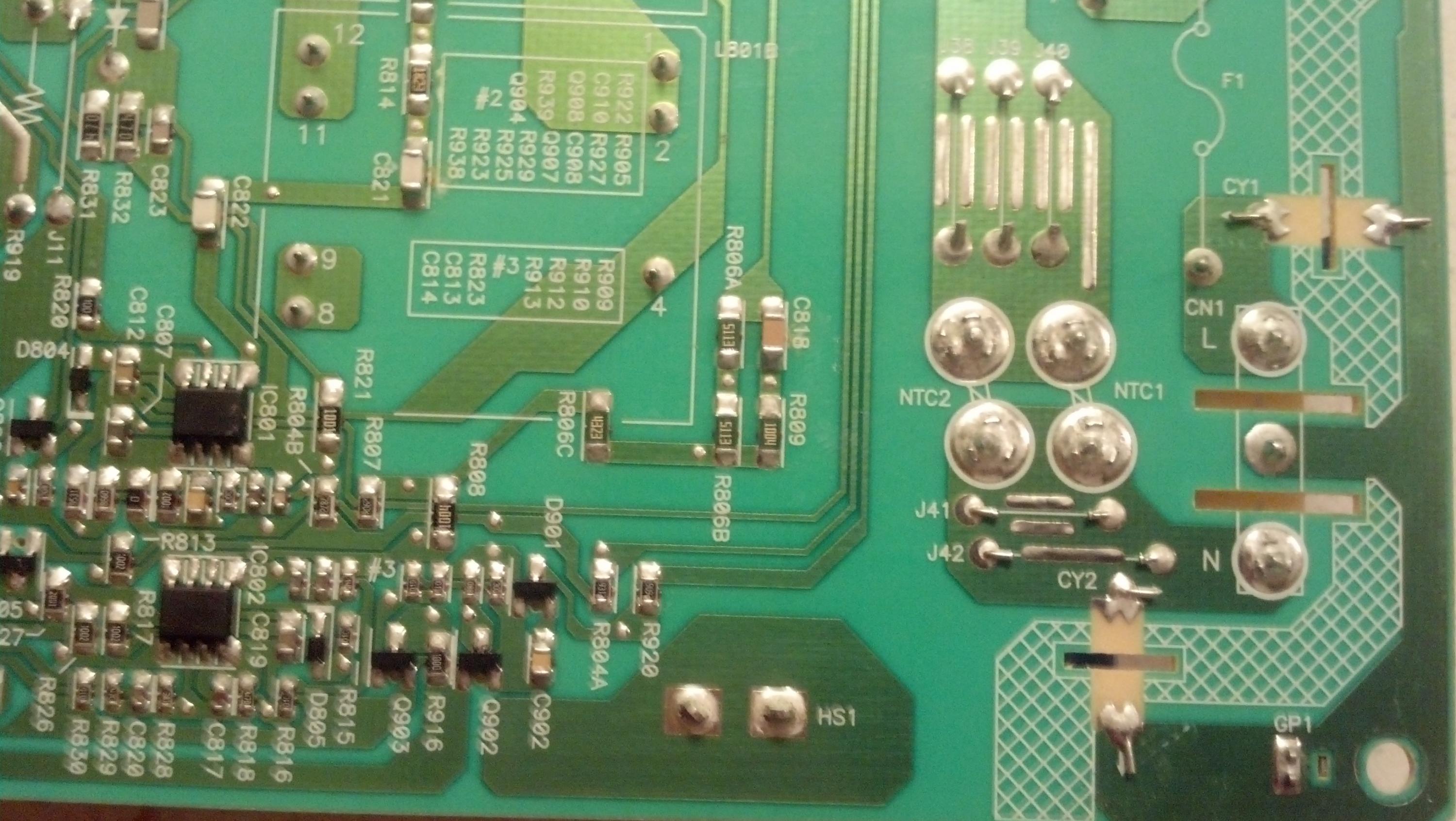

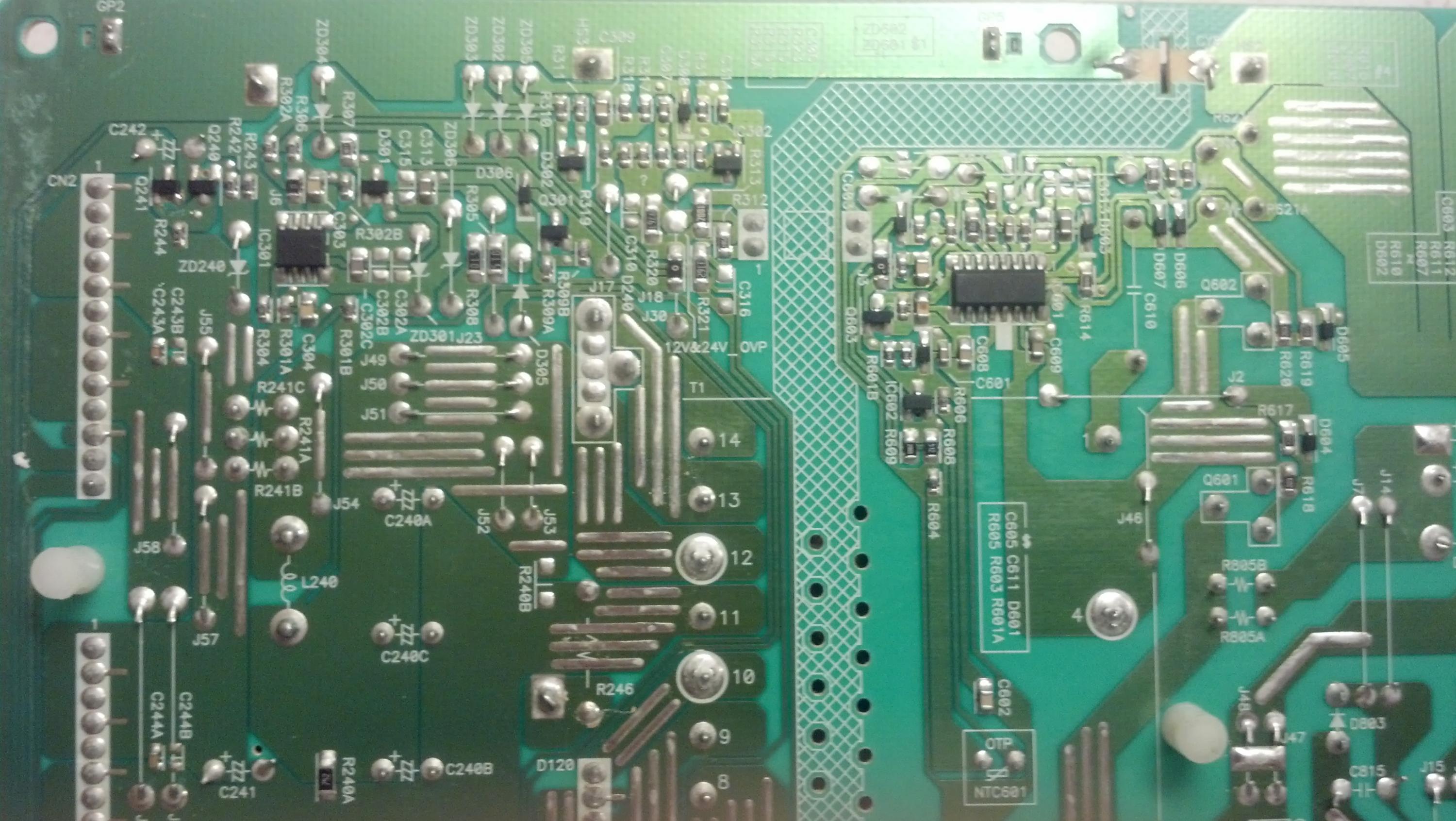

                    Re: Another vw42l problem

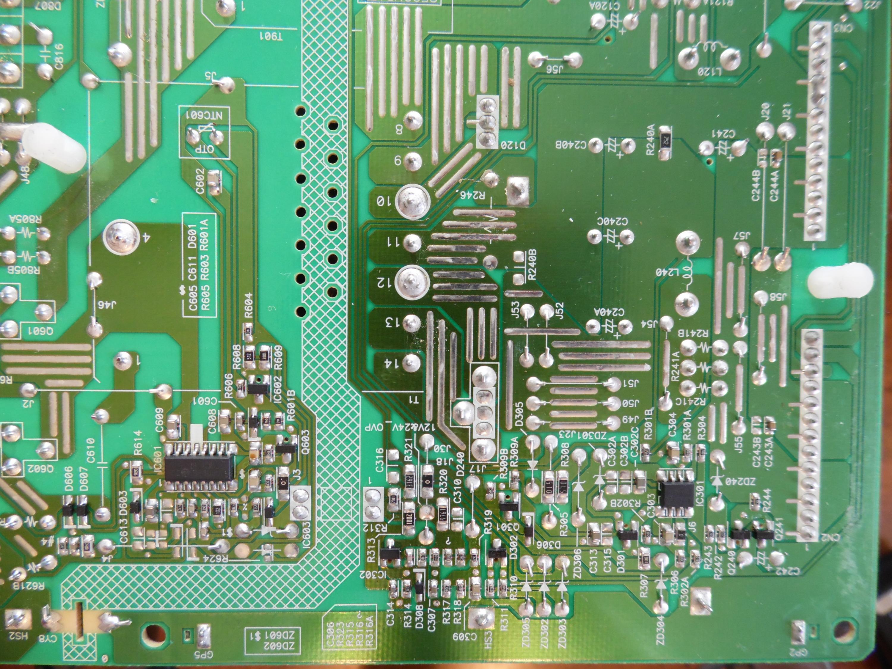

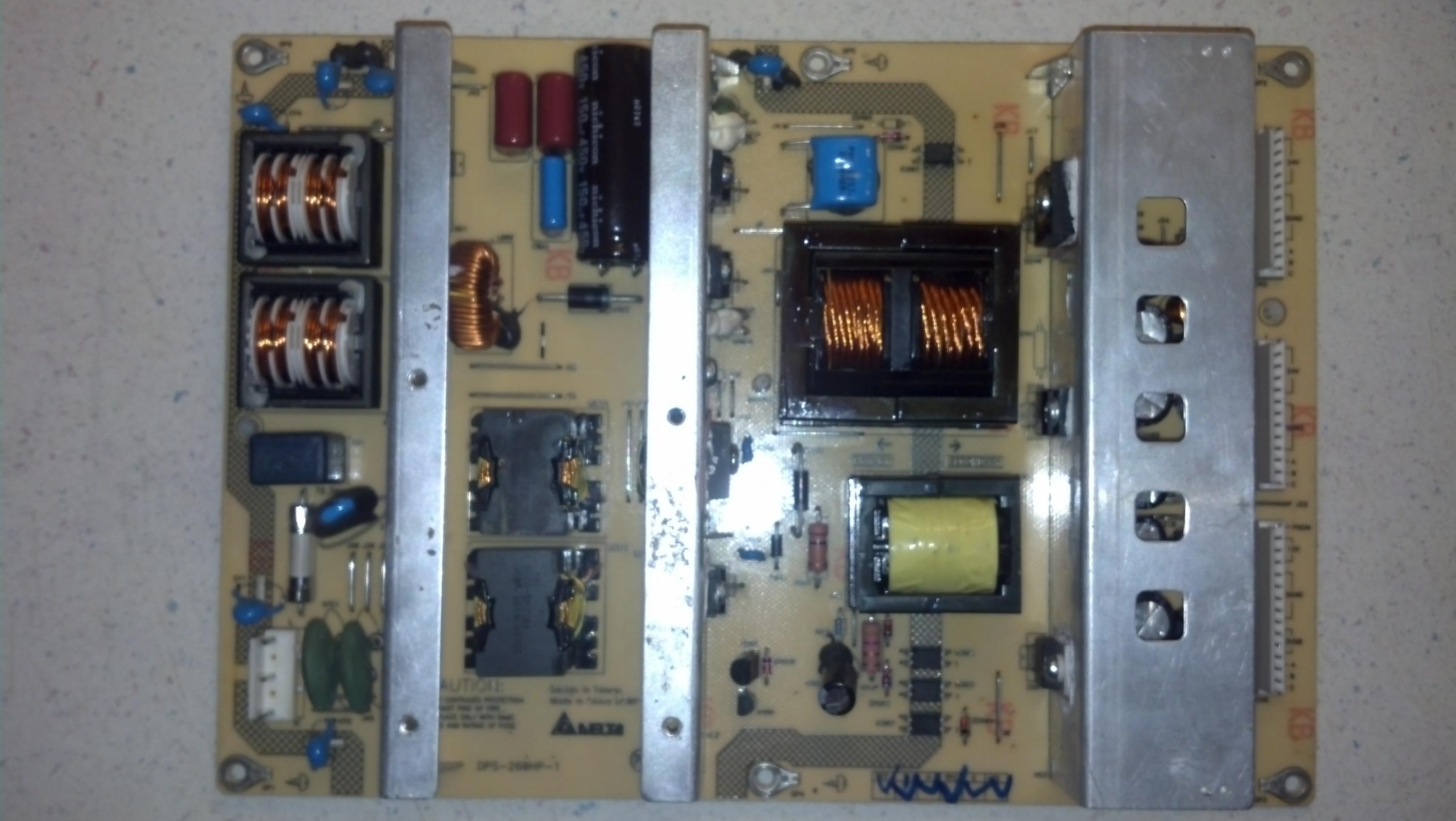

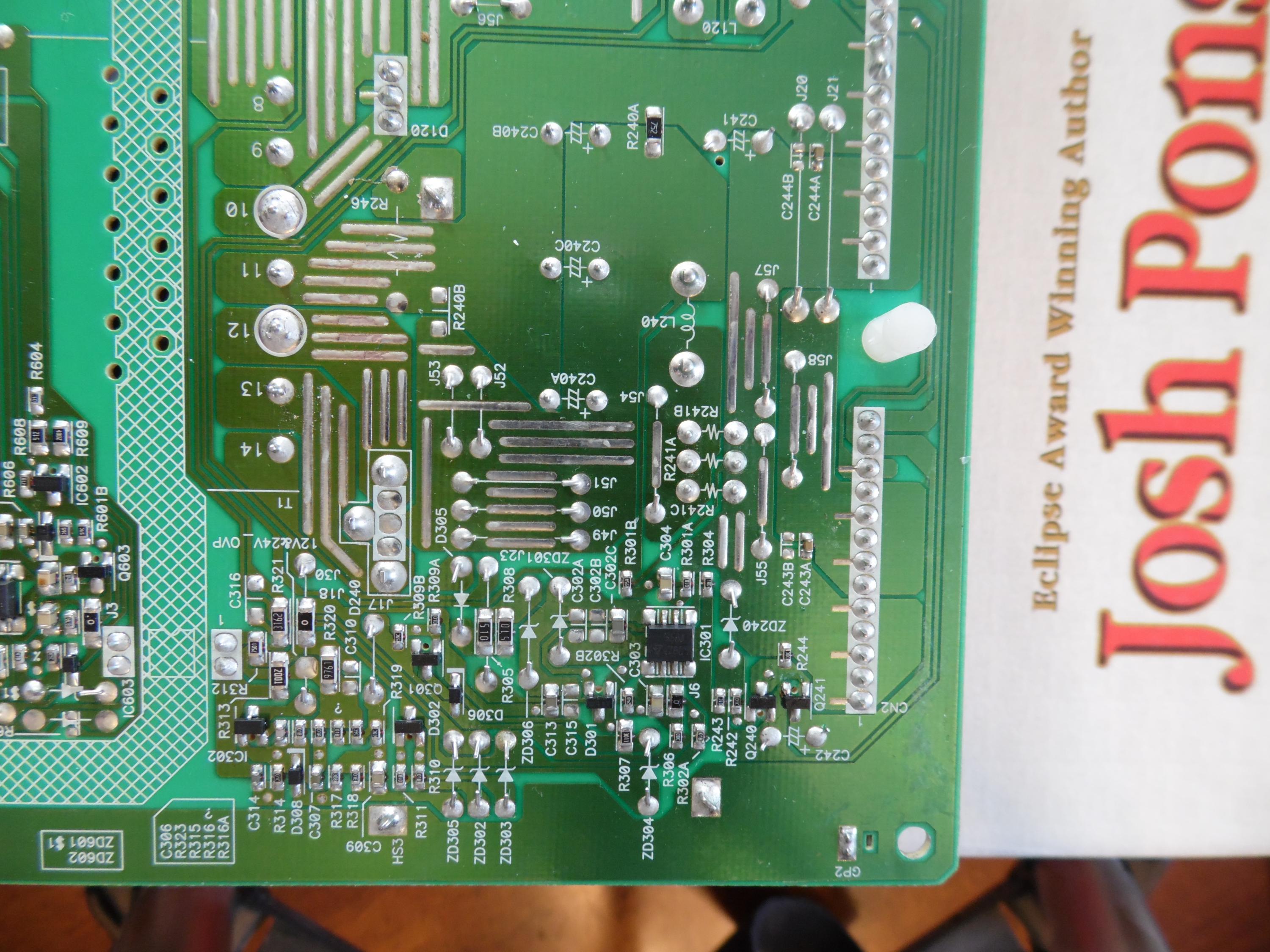

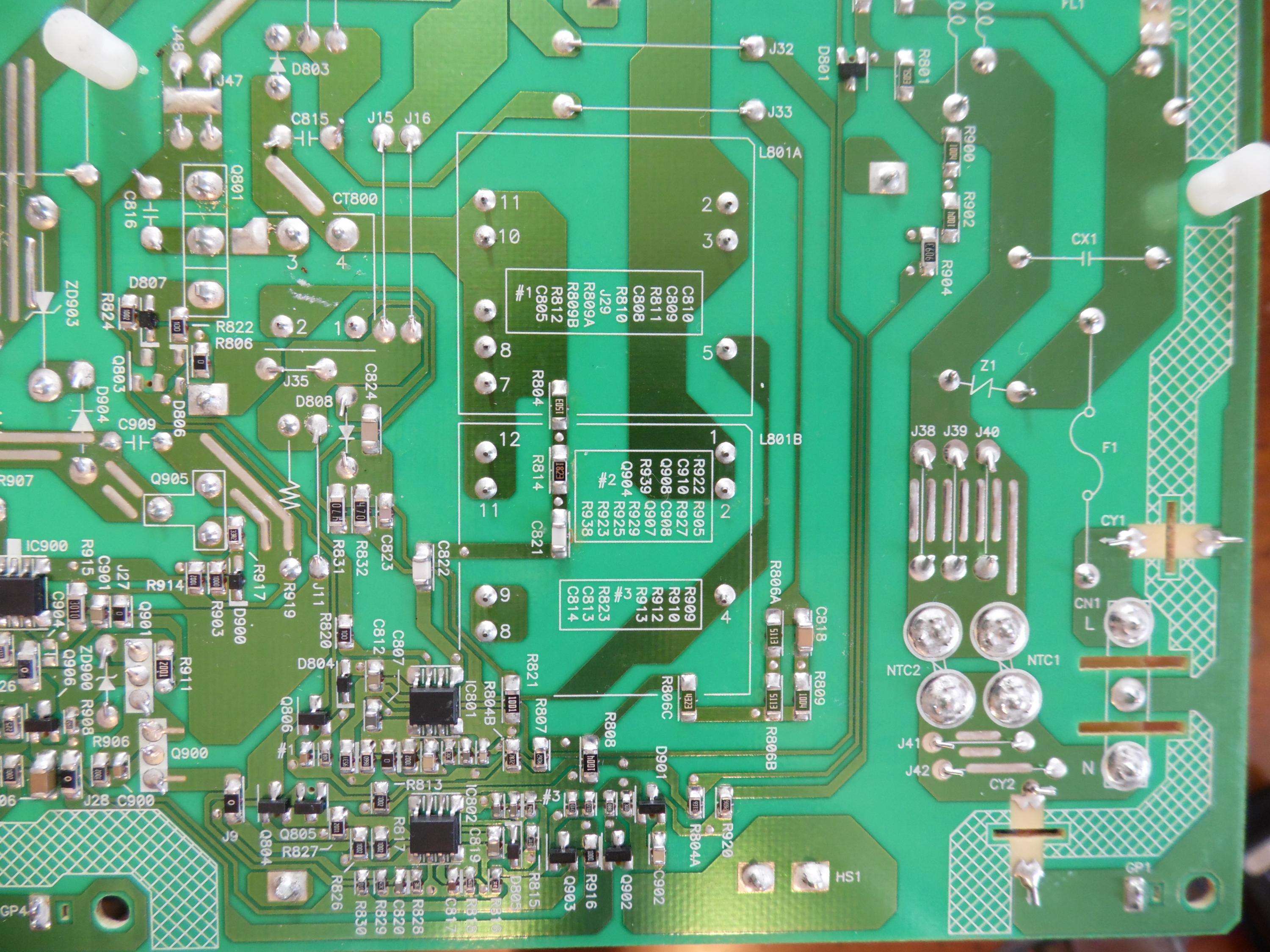

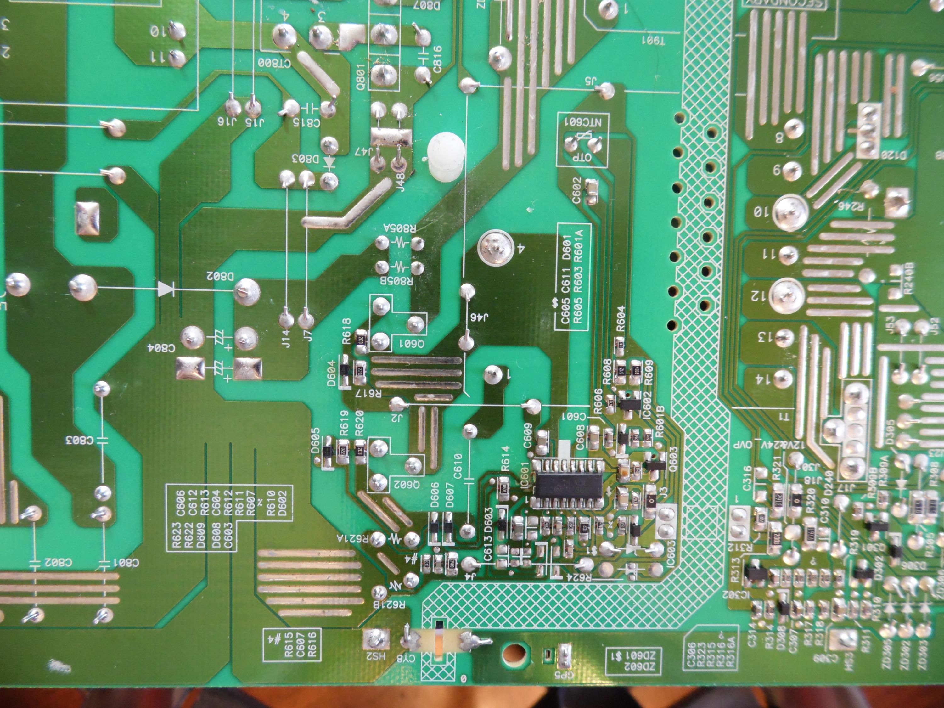

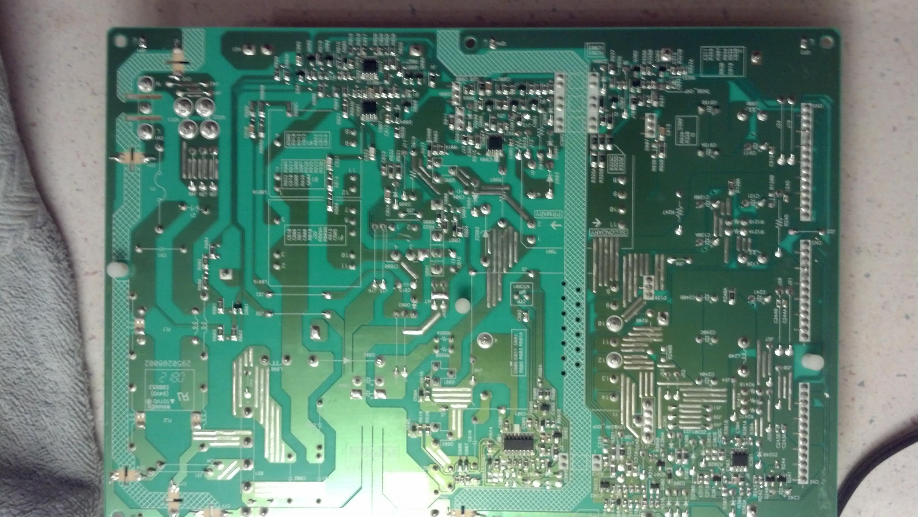

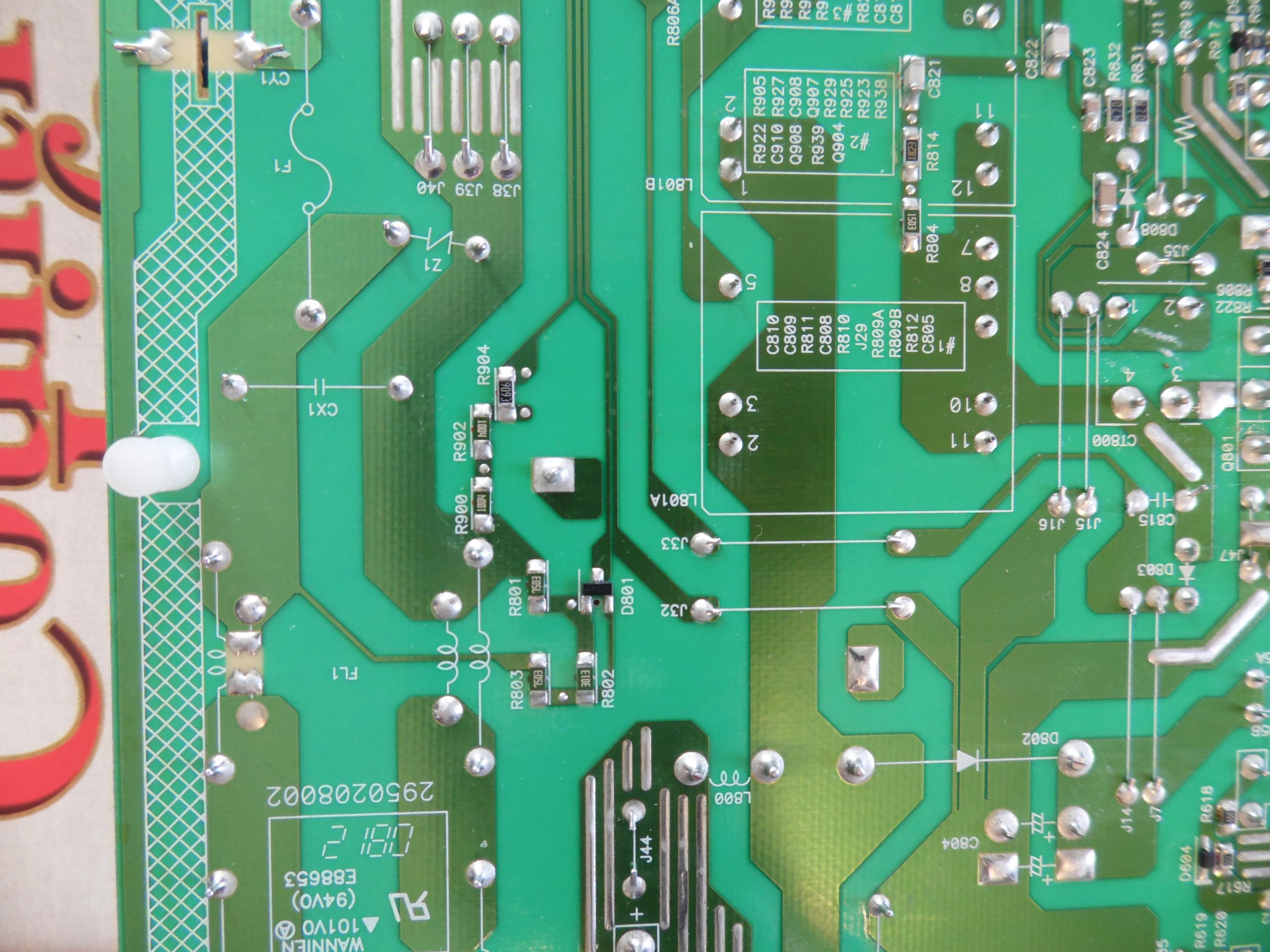

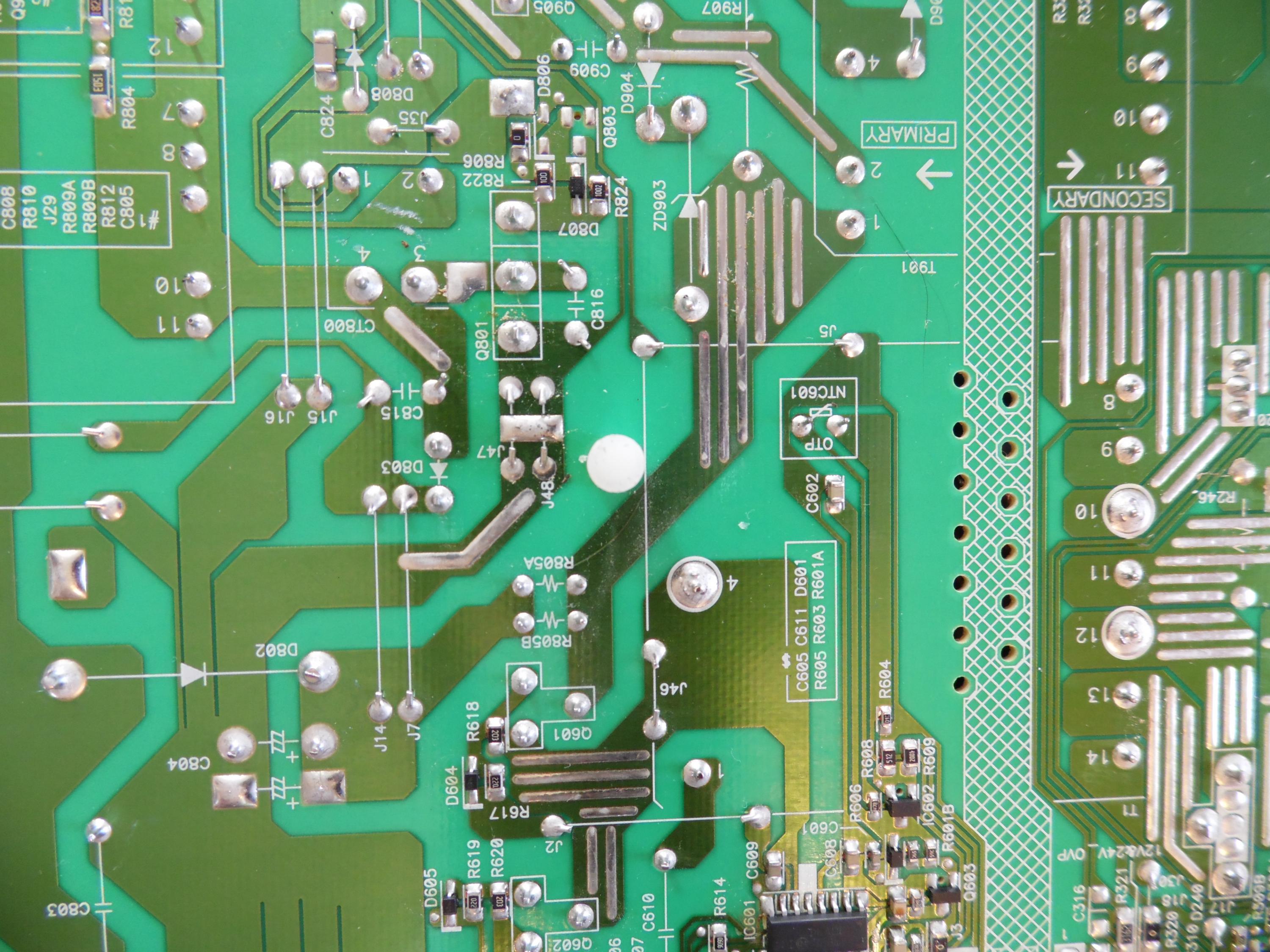

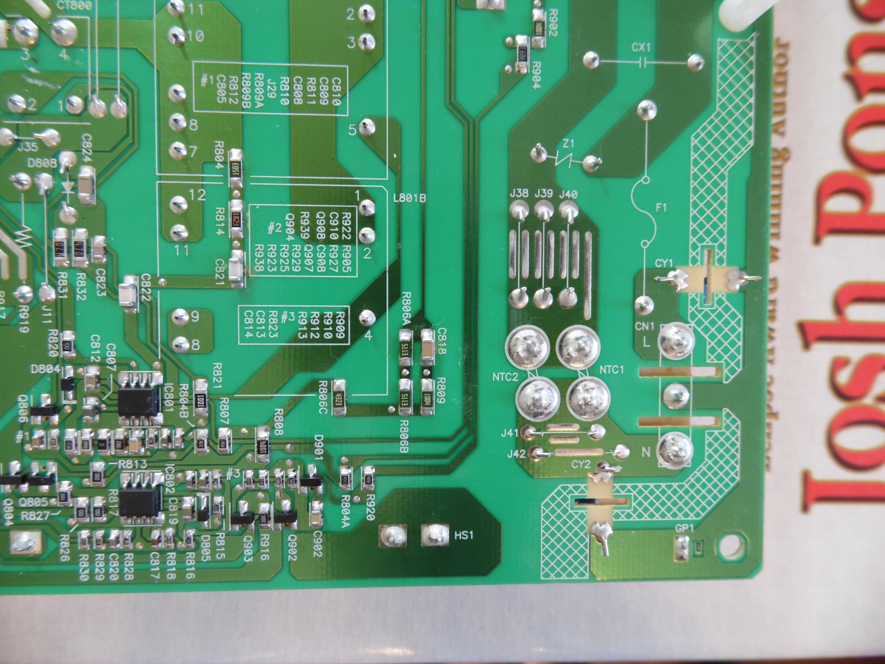

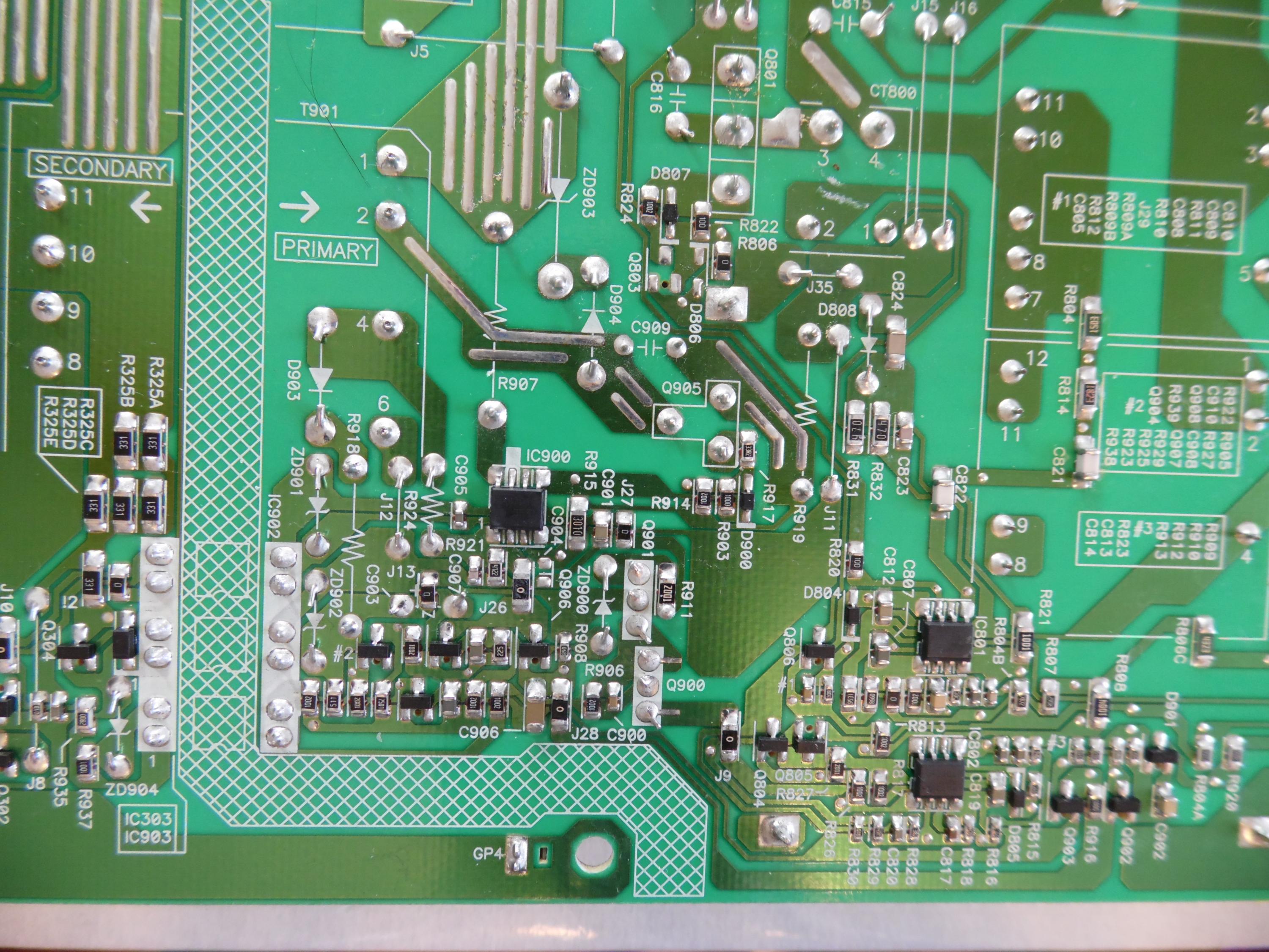

                    OK, then for me to help you troubleshoot this power supply board, I will need really good clear pictures of the board. Please take the whole picture of the top side and the bottom side of the board, then take close up 1/4 section of board (top and bottom) so I can easily see the traces and the component designators.
                    I will then try to trace out the circuits and then provide you the test points and components you will need to check.
                    Just remember that I do not have the board in front of me to look at, so GOOD CLEAR FOCUS pictures are really important.

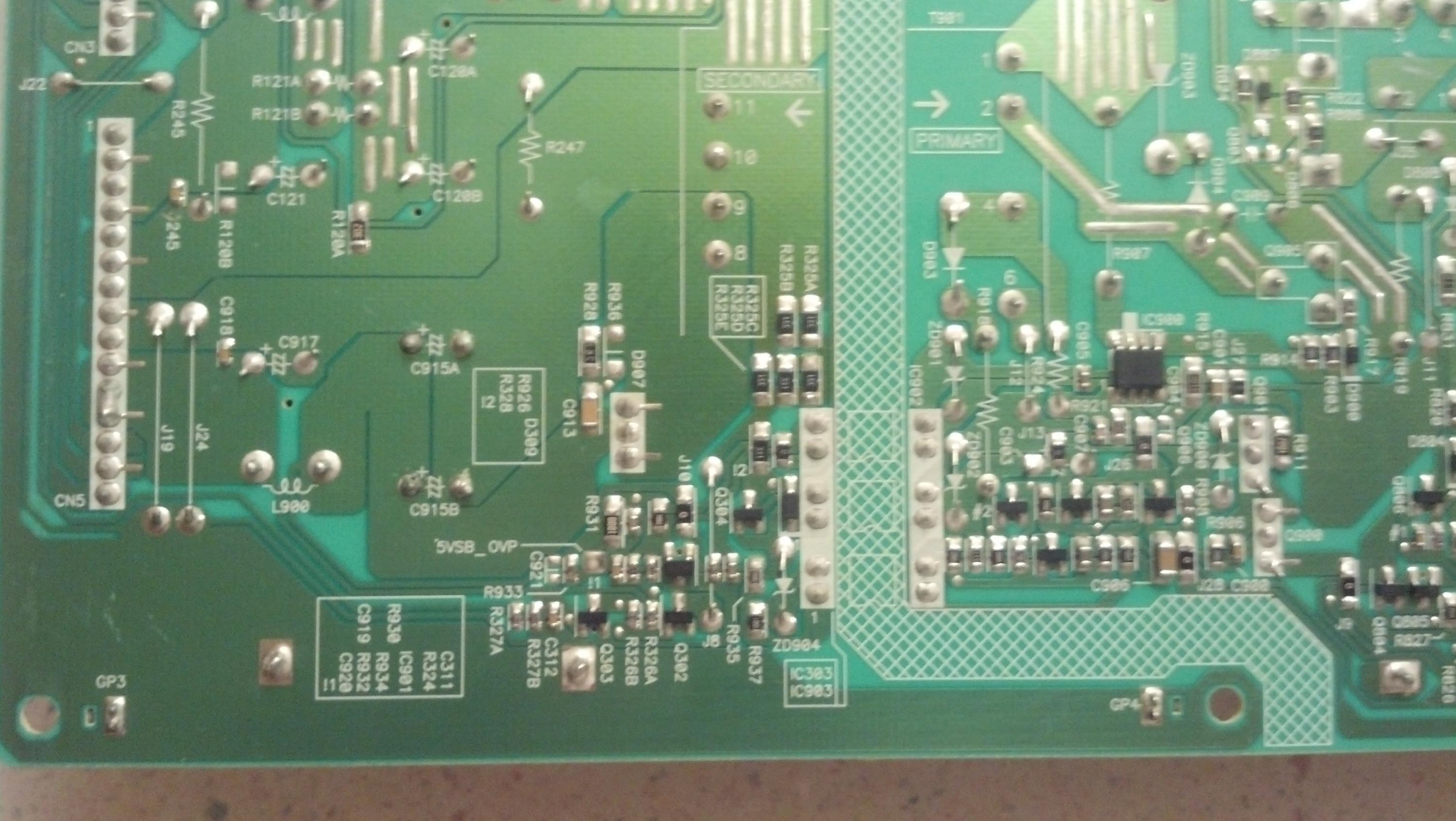

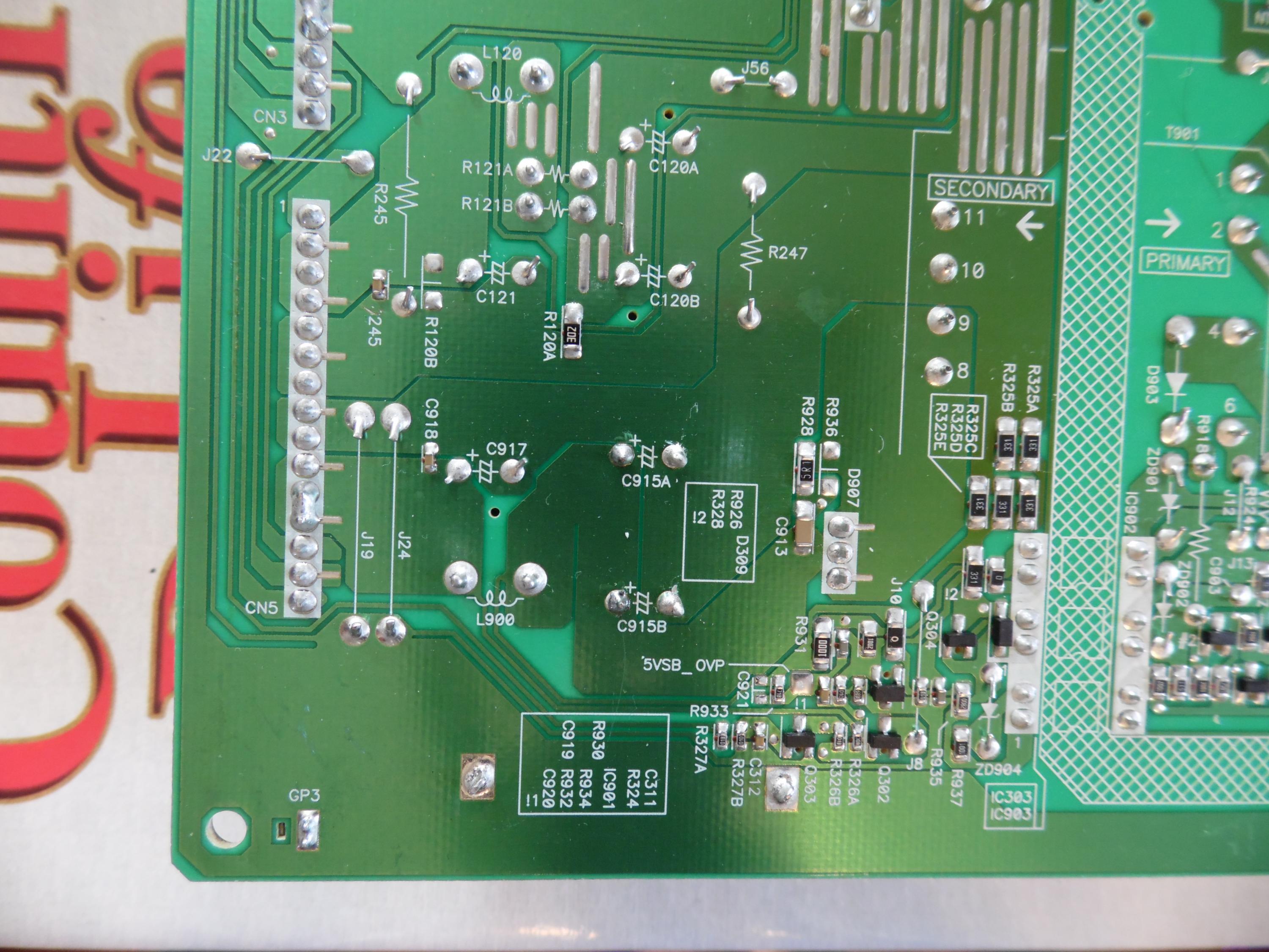

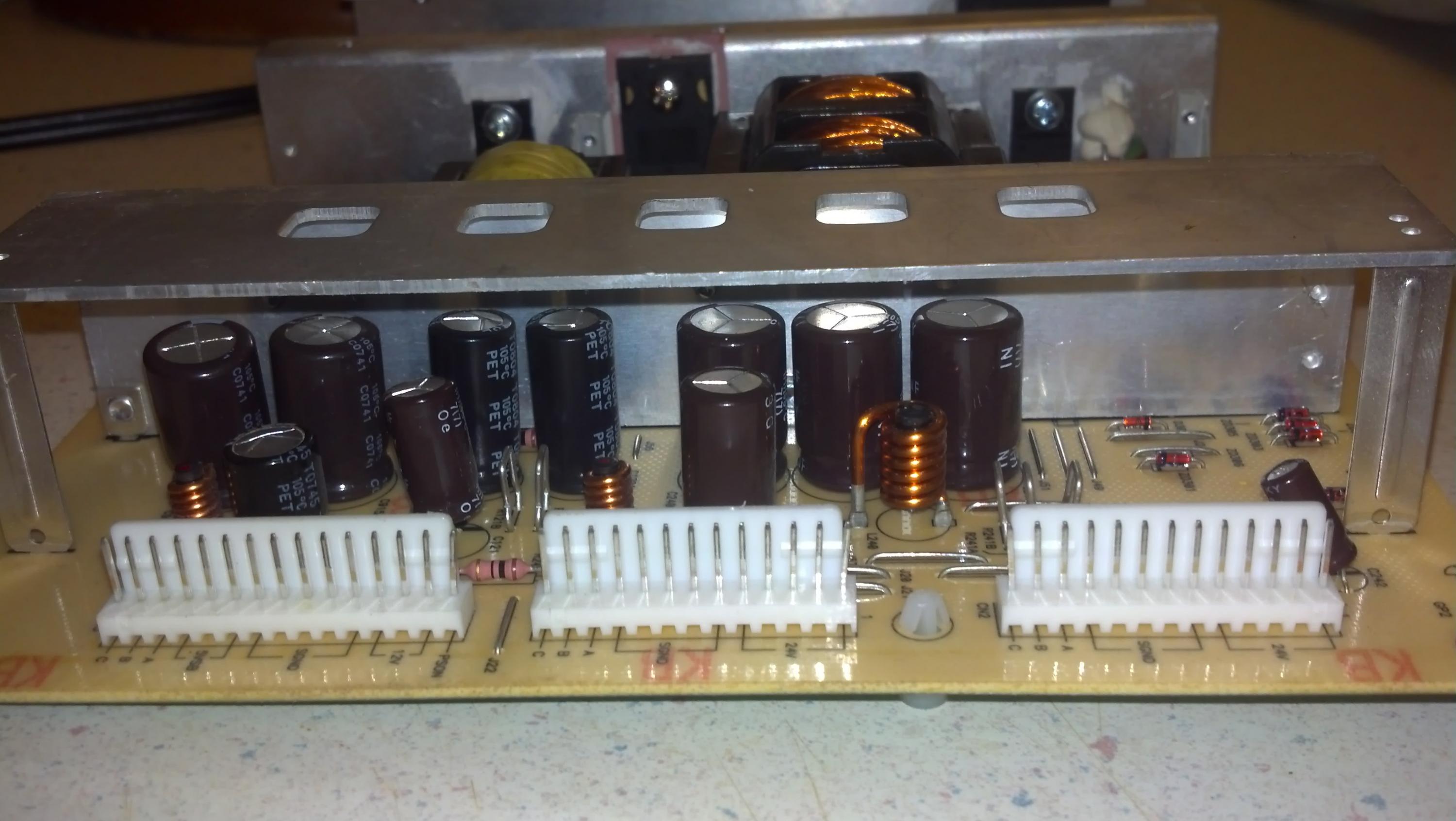

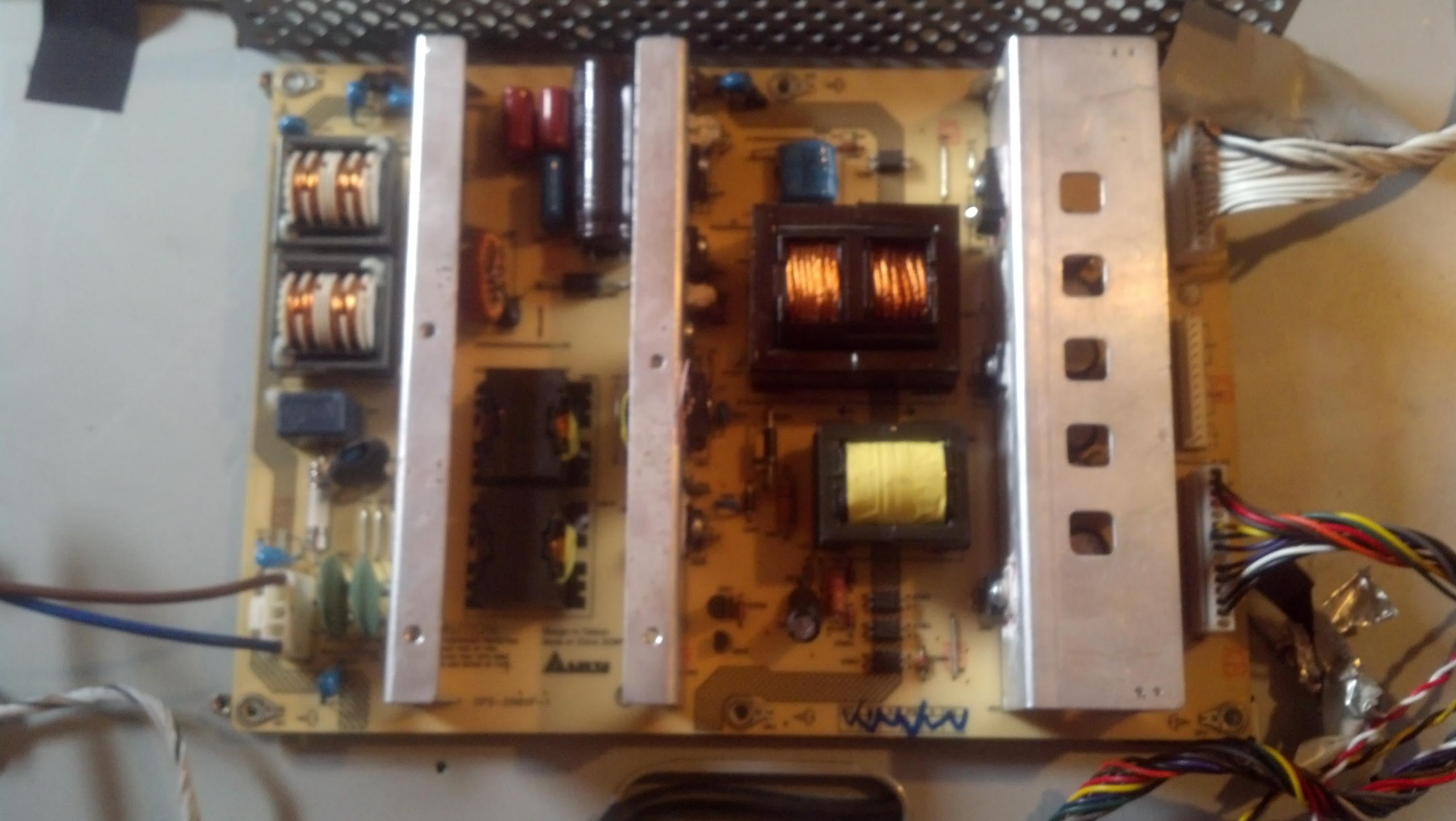

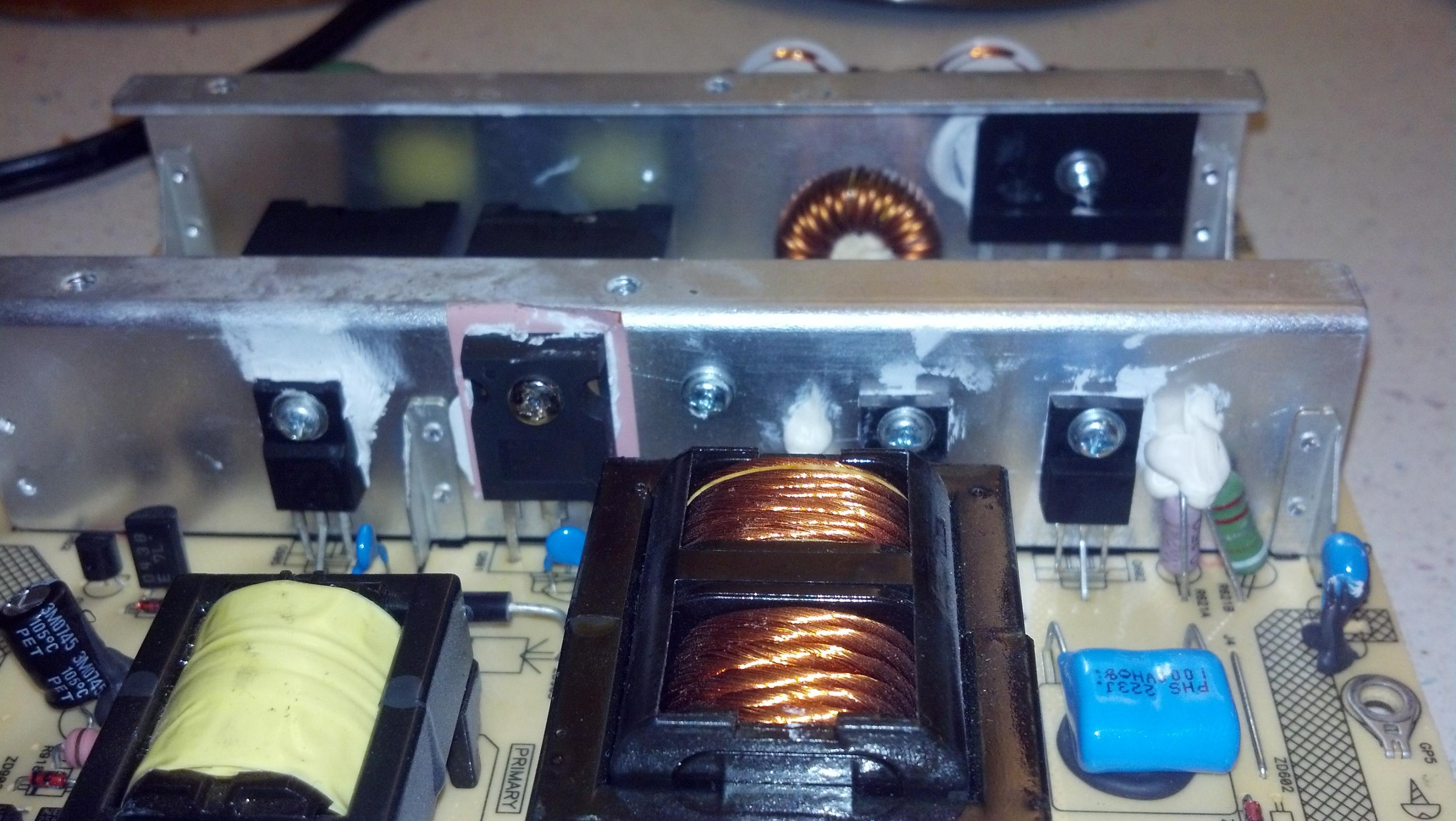

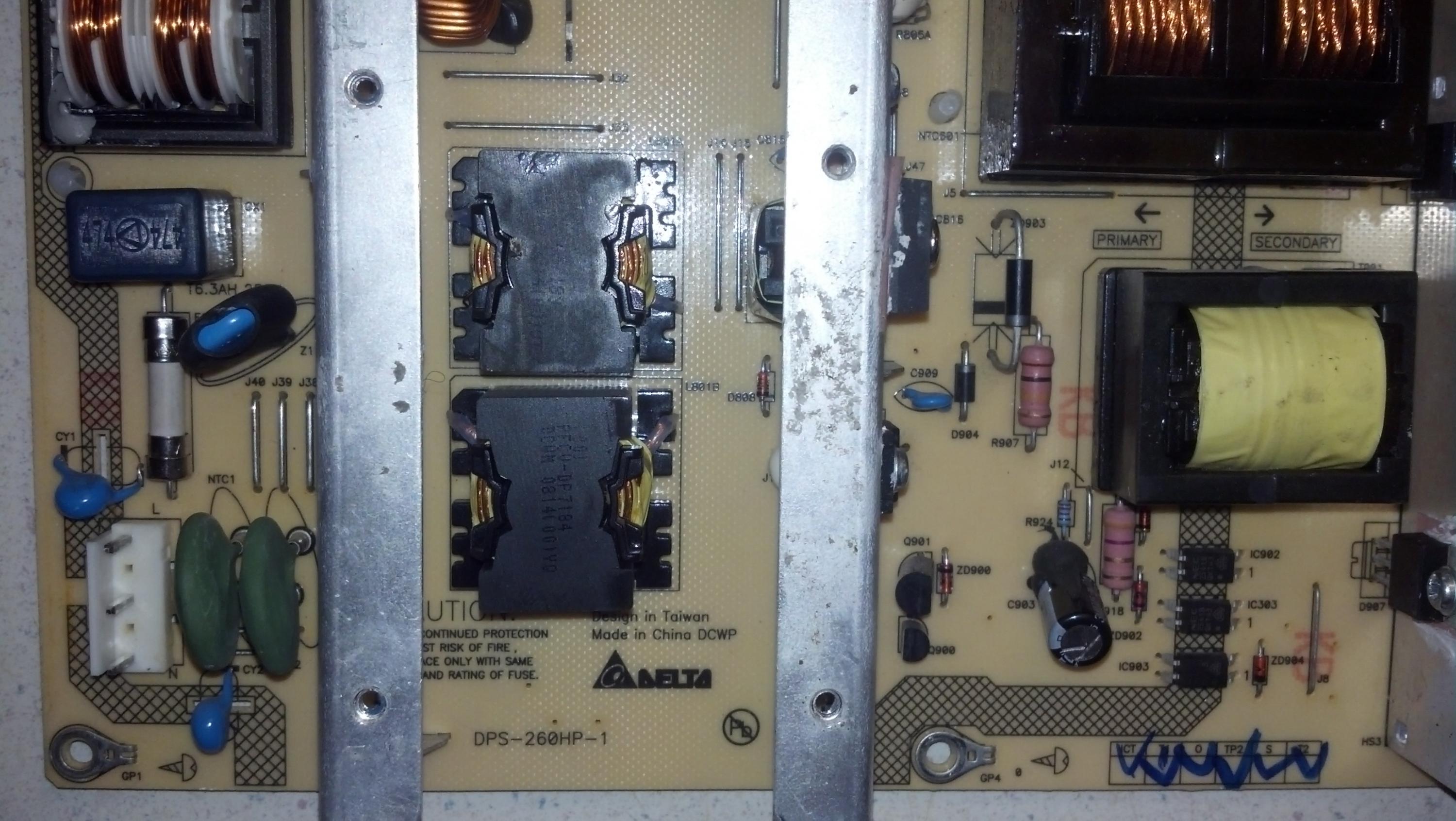

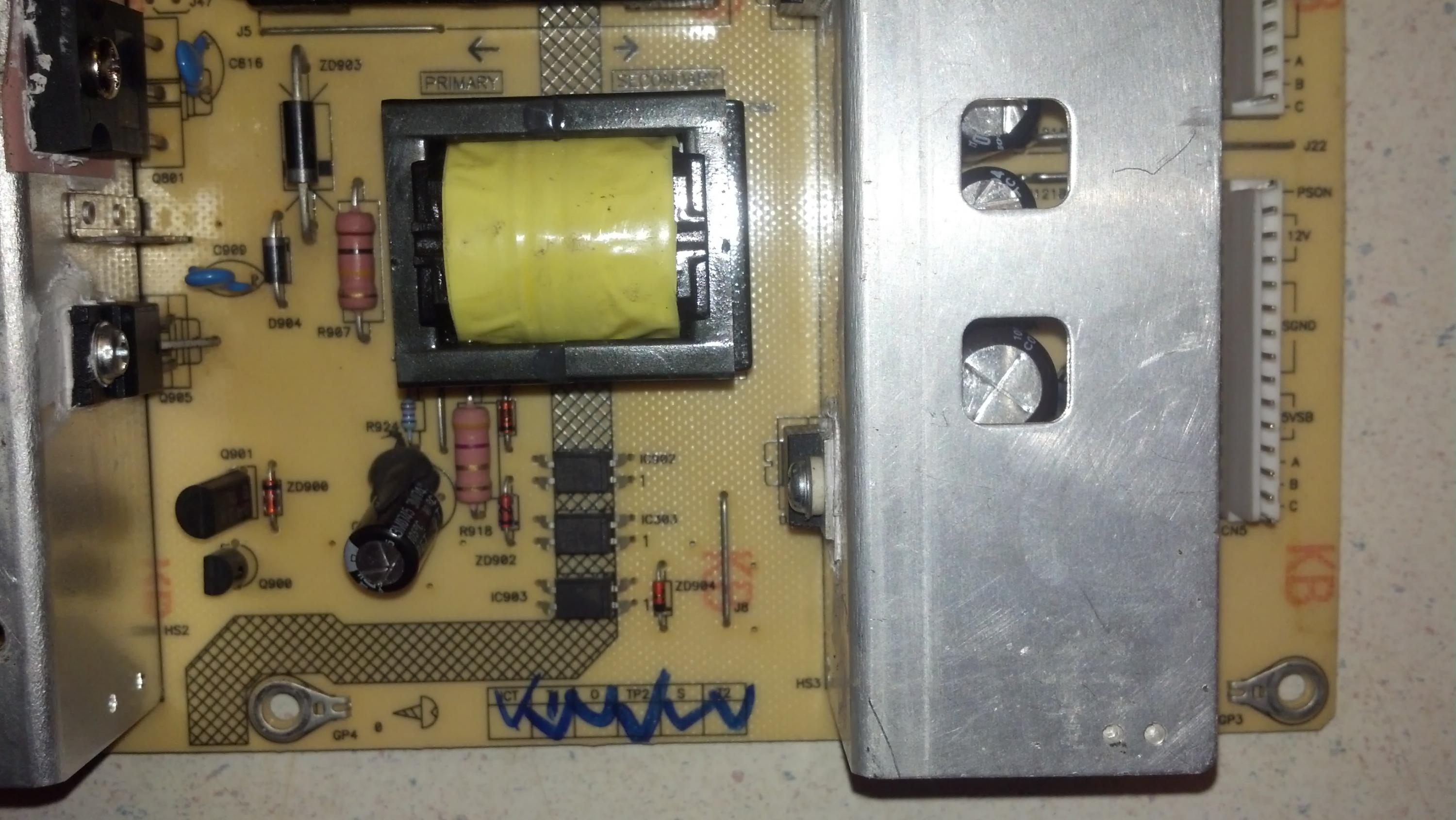

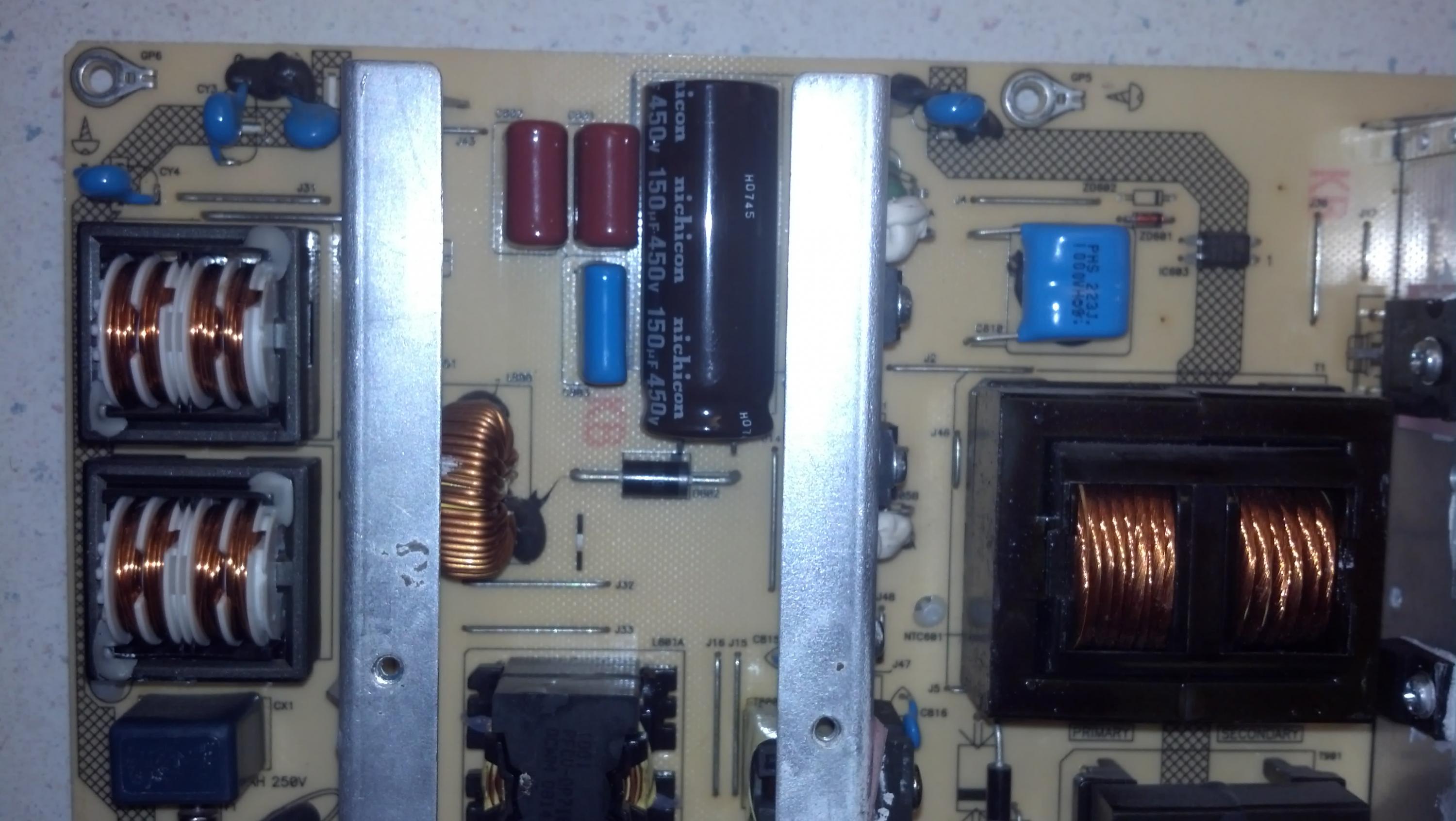

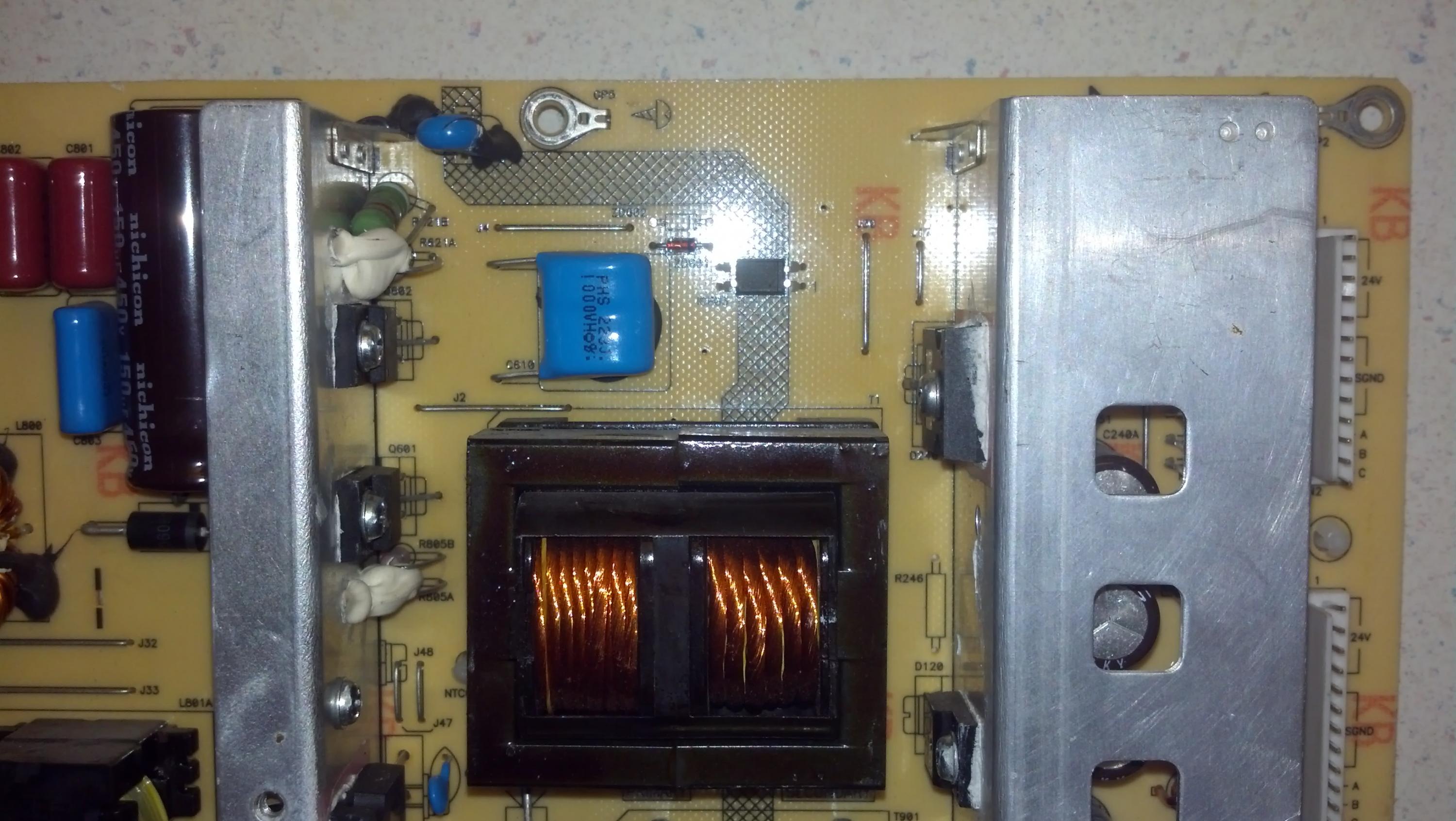

                        Hope these work. I have taken pictures for a hour and half. Harder than it looks. Let me know if you need a better one of something. I included a couple extra so you could see under heat sinks.

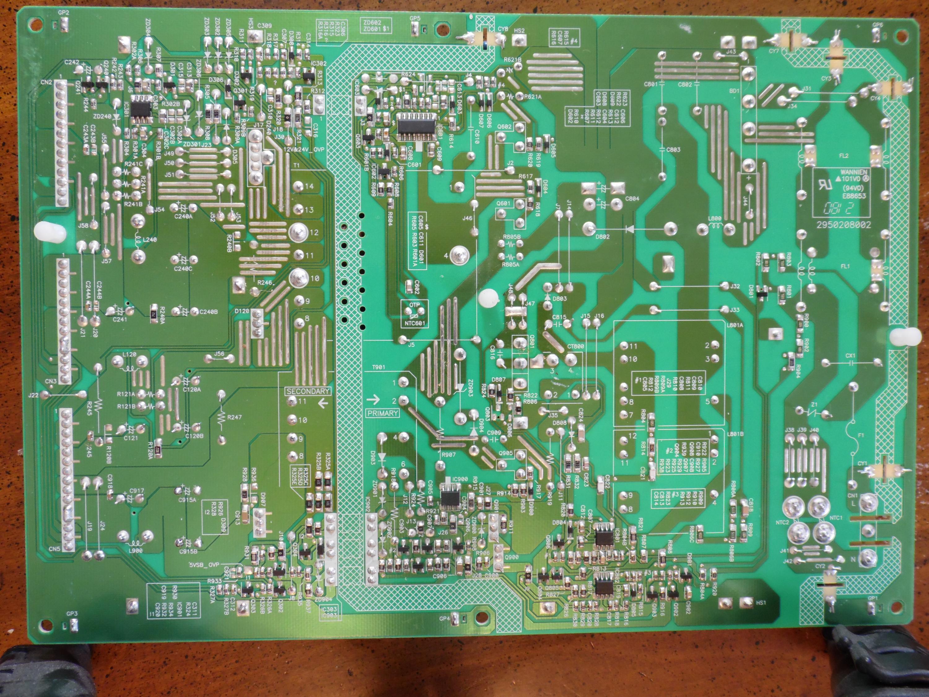

                            I do not see the picture of the whole view of the bottom side of the board, the other bottom side pictures are out of focus. May be you need good day light for the light source for better pictures.
                            What I have to do is to print out all the pictures and then tape them together to make one big board and trace out the connections. So you understand what I need for me to be able to see.
                              Ok, I see the whole bottom side, but it is not in focus.

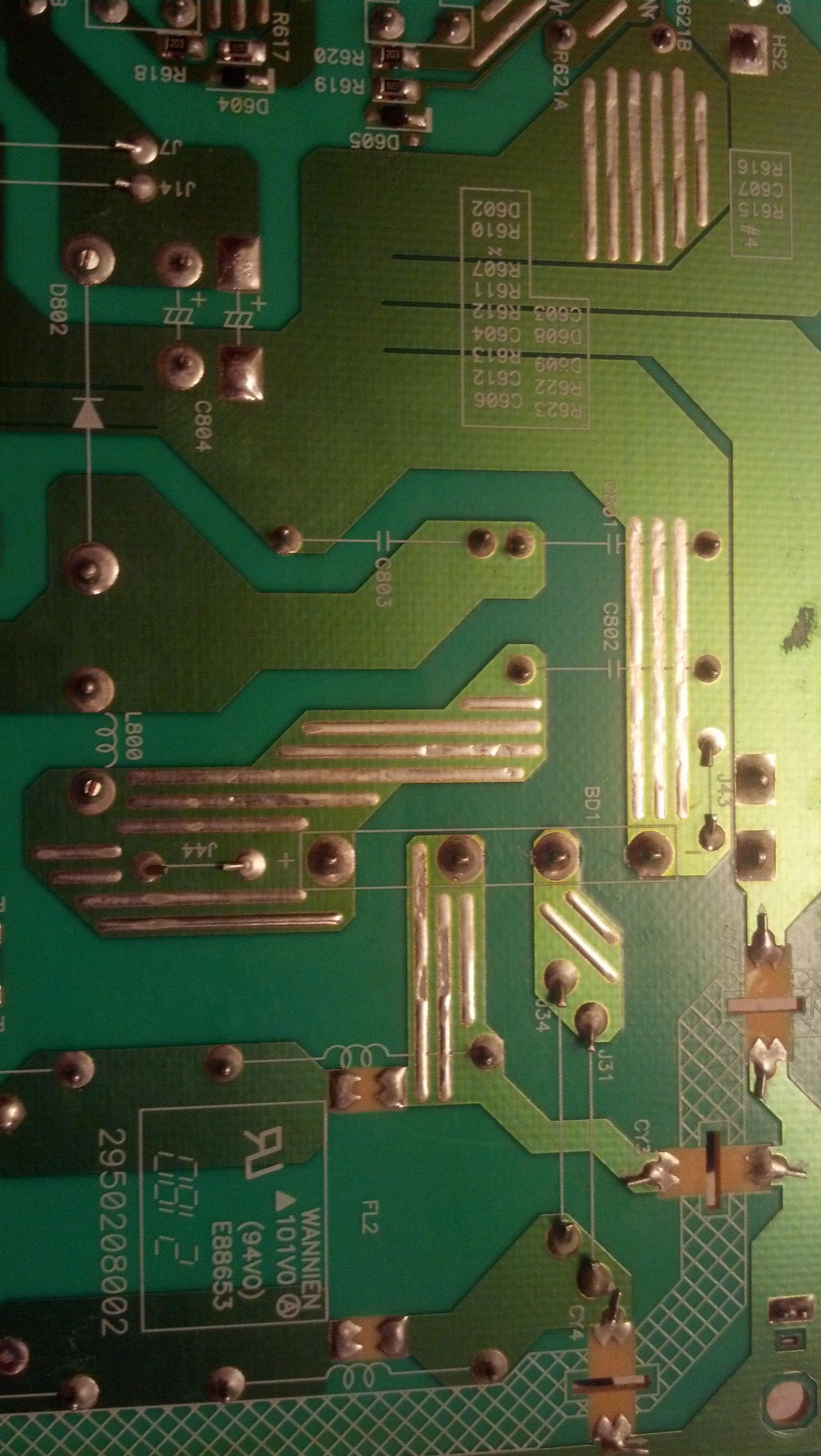

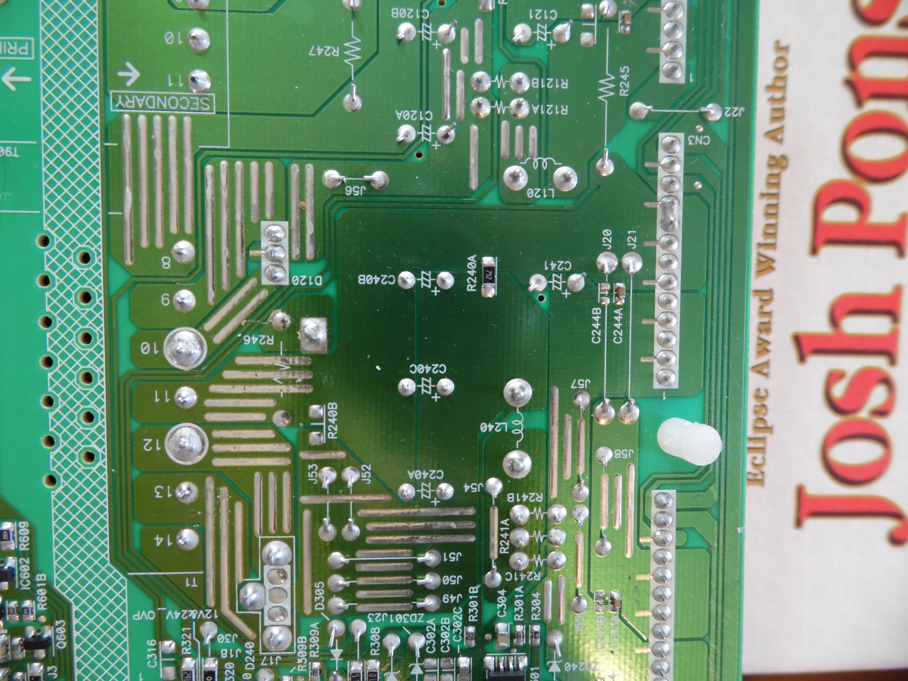

                                  Here is the quarters

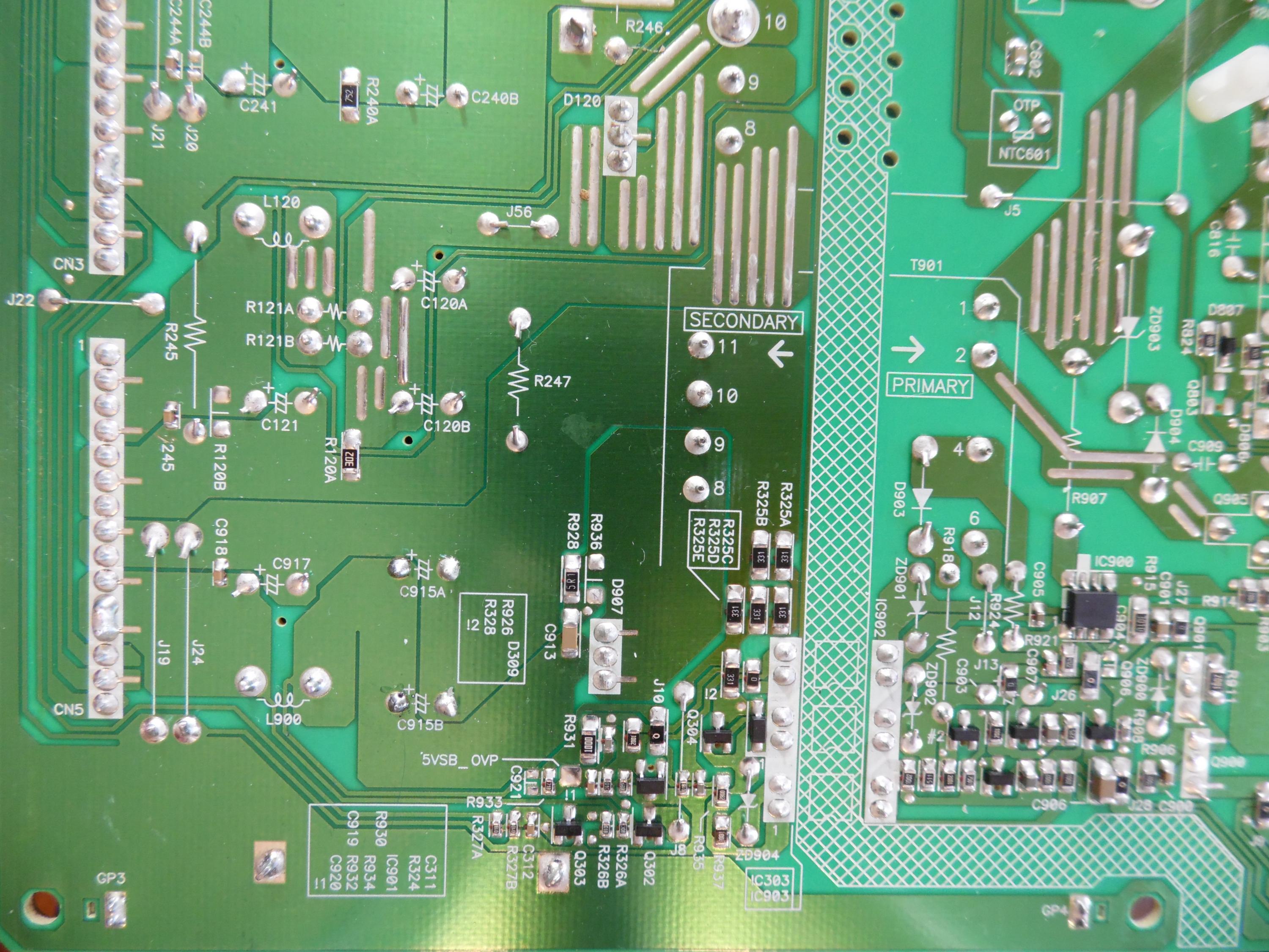

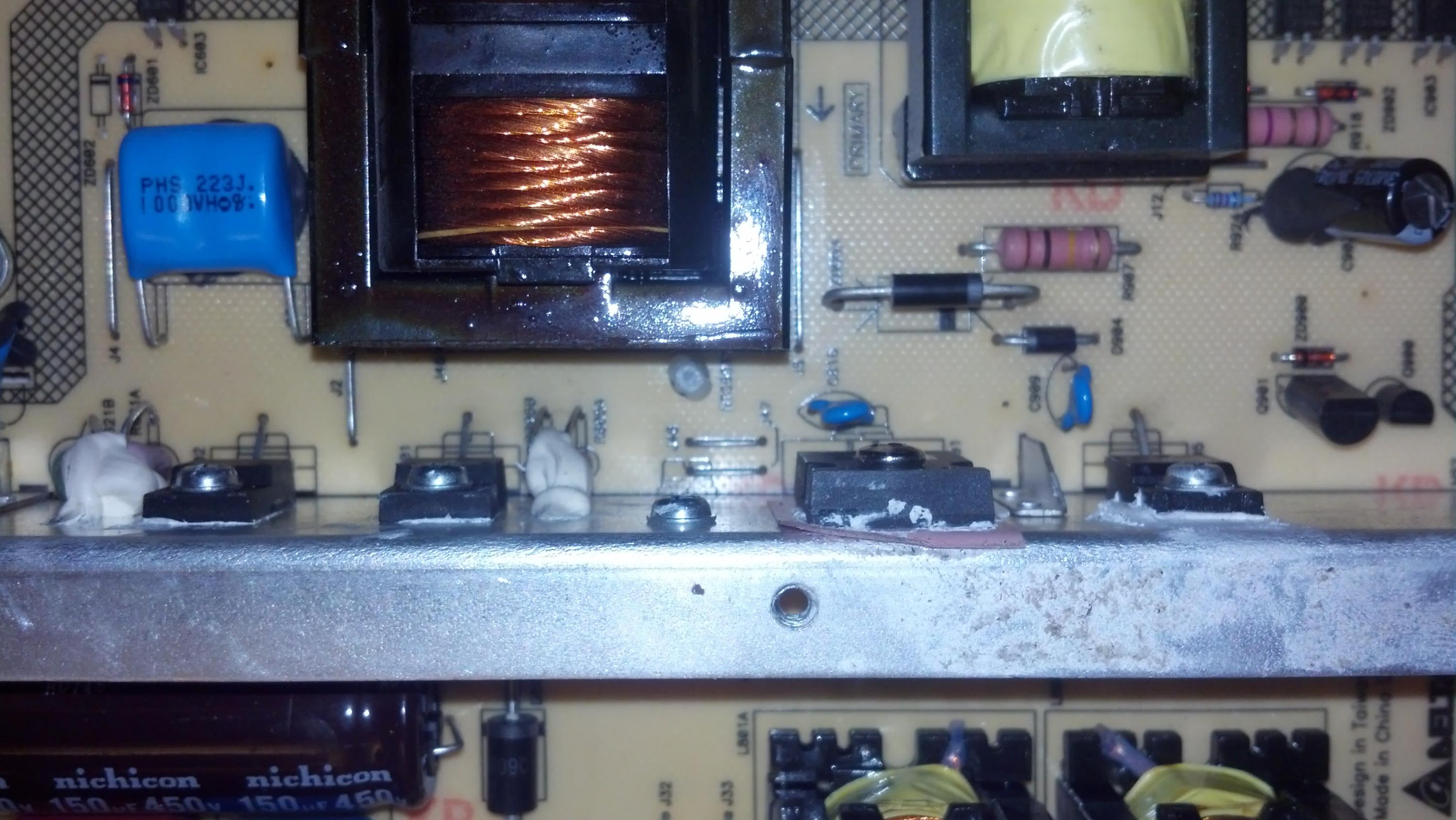

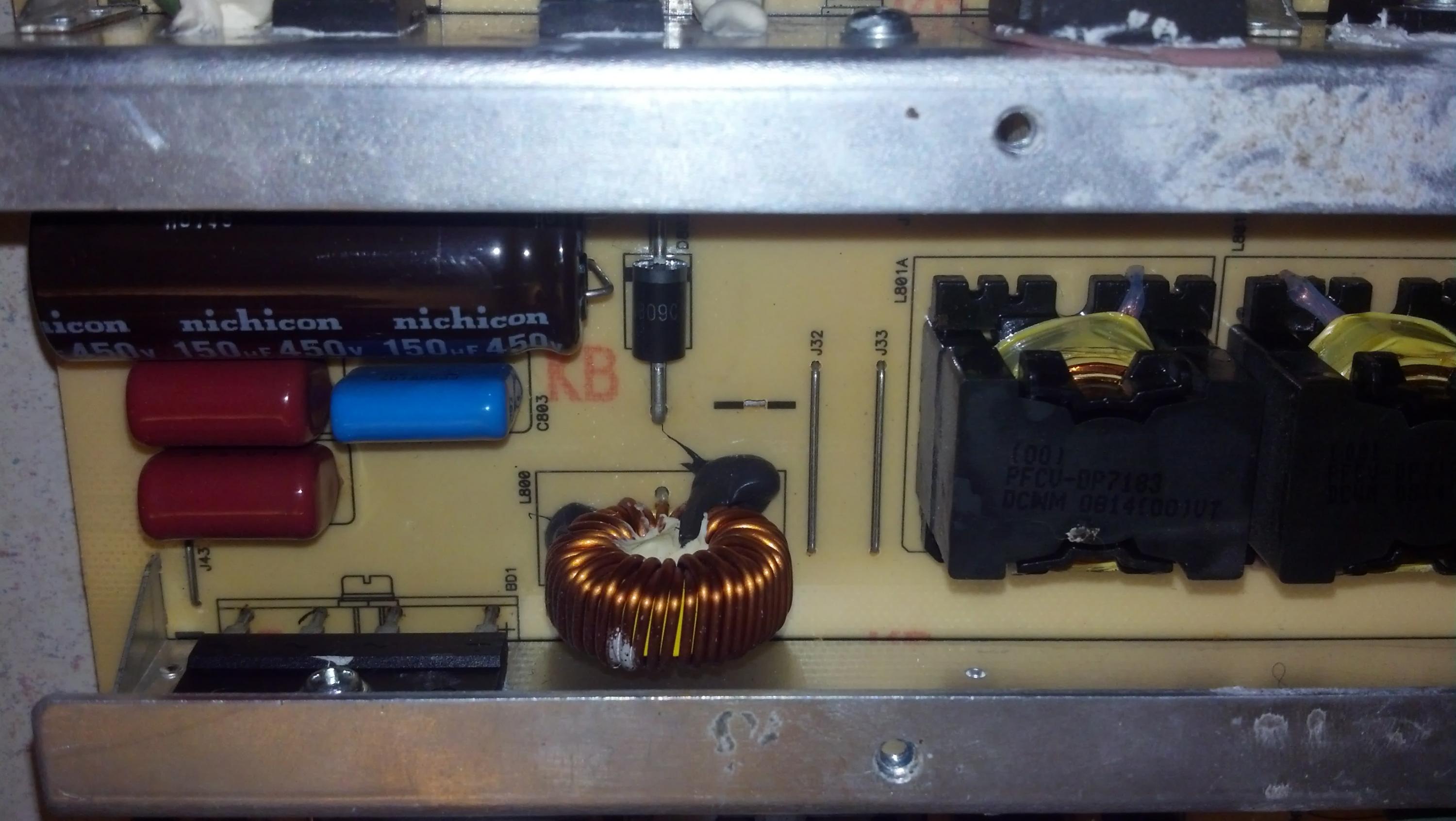

                                    There are some parts that are still not clear so here are 1/9ths
                                      OK, I just download more pictures that you posted, please give me more times to look through them.
                                      By the way, thanks for much better pictures! Same camera that you used last night?
                                        No, last night was 10mp on smart phone with shaky hands. Today was with 16.2mp digital camera on tripod.
