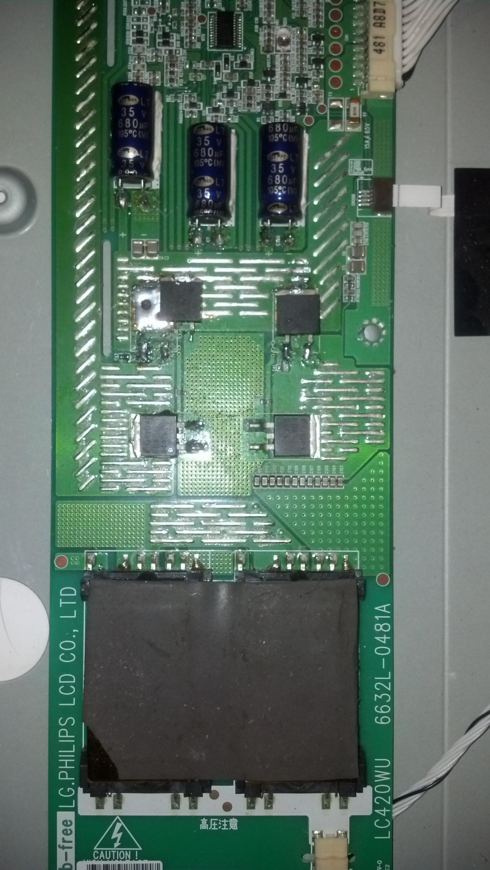

Re: Another vw42l problem
Disconnect the connector with a bunch of white wires which is the 24v for feeding the Inverter board and see if the 24v and 12v are present.
