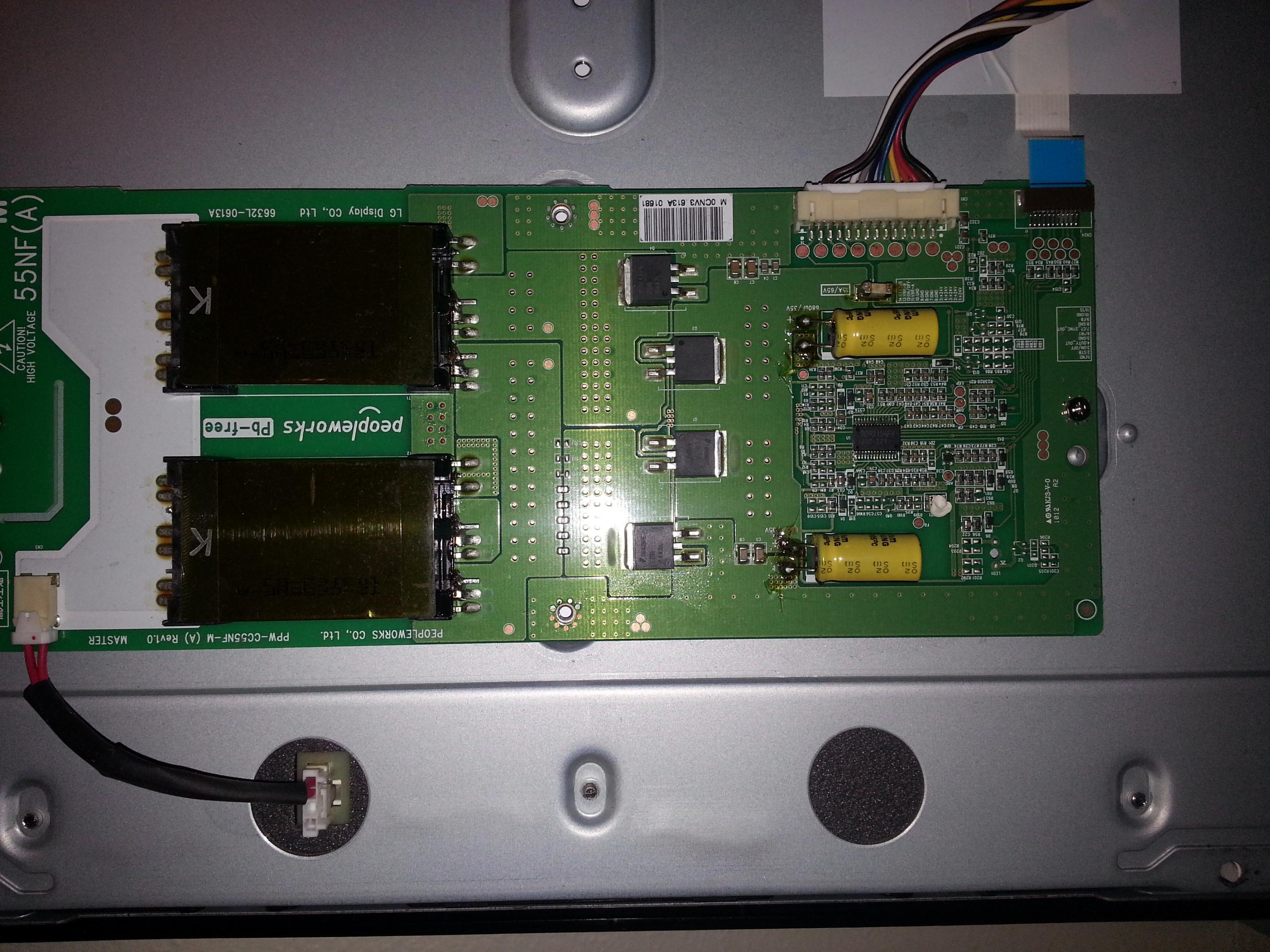

e550vl turns on 24v going to inverters fluctuates
  • kornwood
    • Jun 2011
    • 93
    ill post pics later but orange light comes on with 2 clicks on plug in then turn on logo turns white and briefly get 24v to inverters but drops and comes back but inverters never come on all fuses are good on mainboard I havnt tested the transisters yet on it and all fuses are good on on slave inverter were good but one was open on master I replaced it but no difference

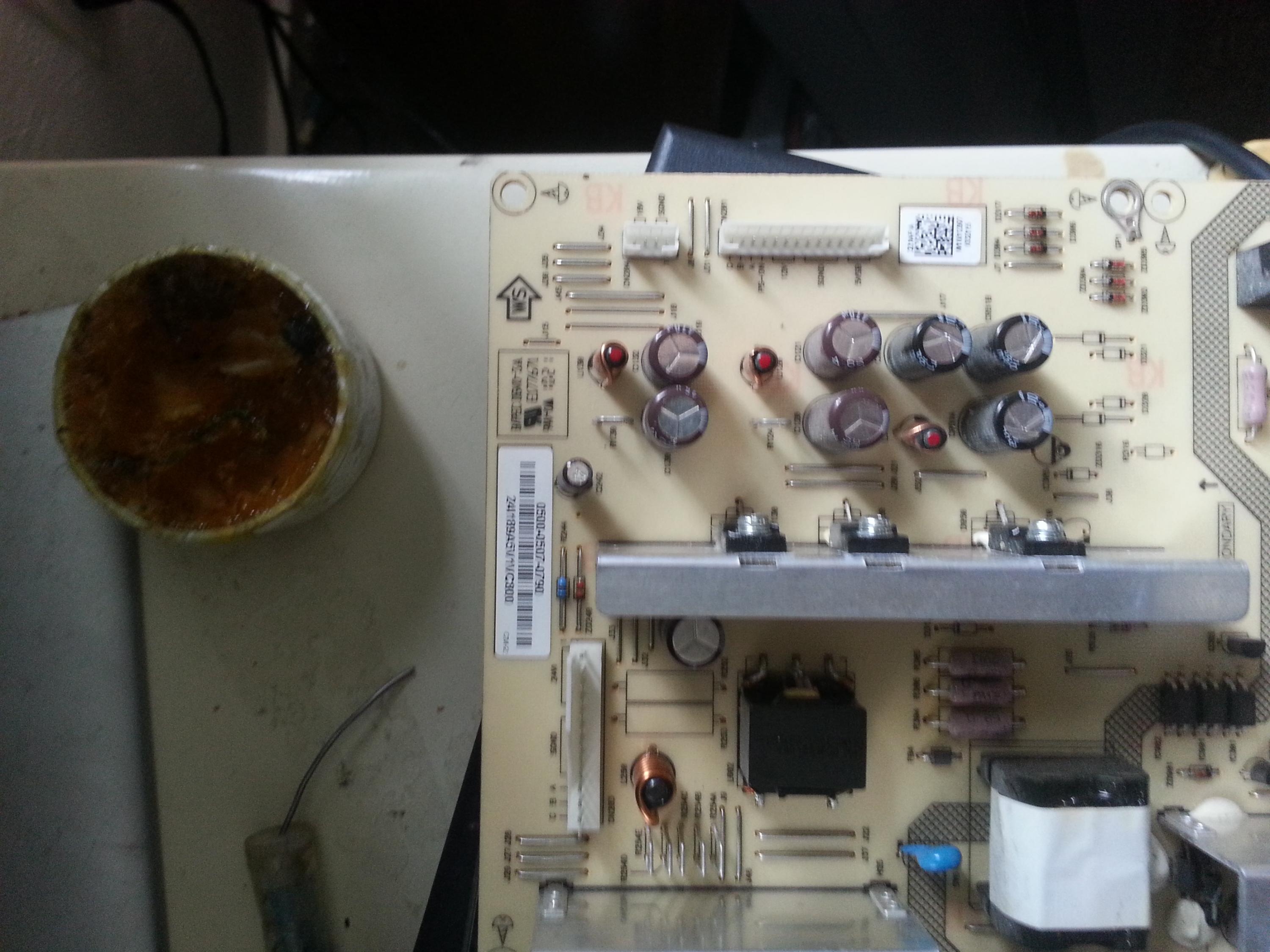

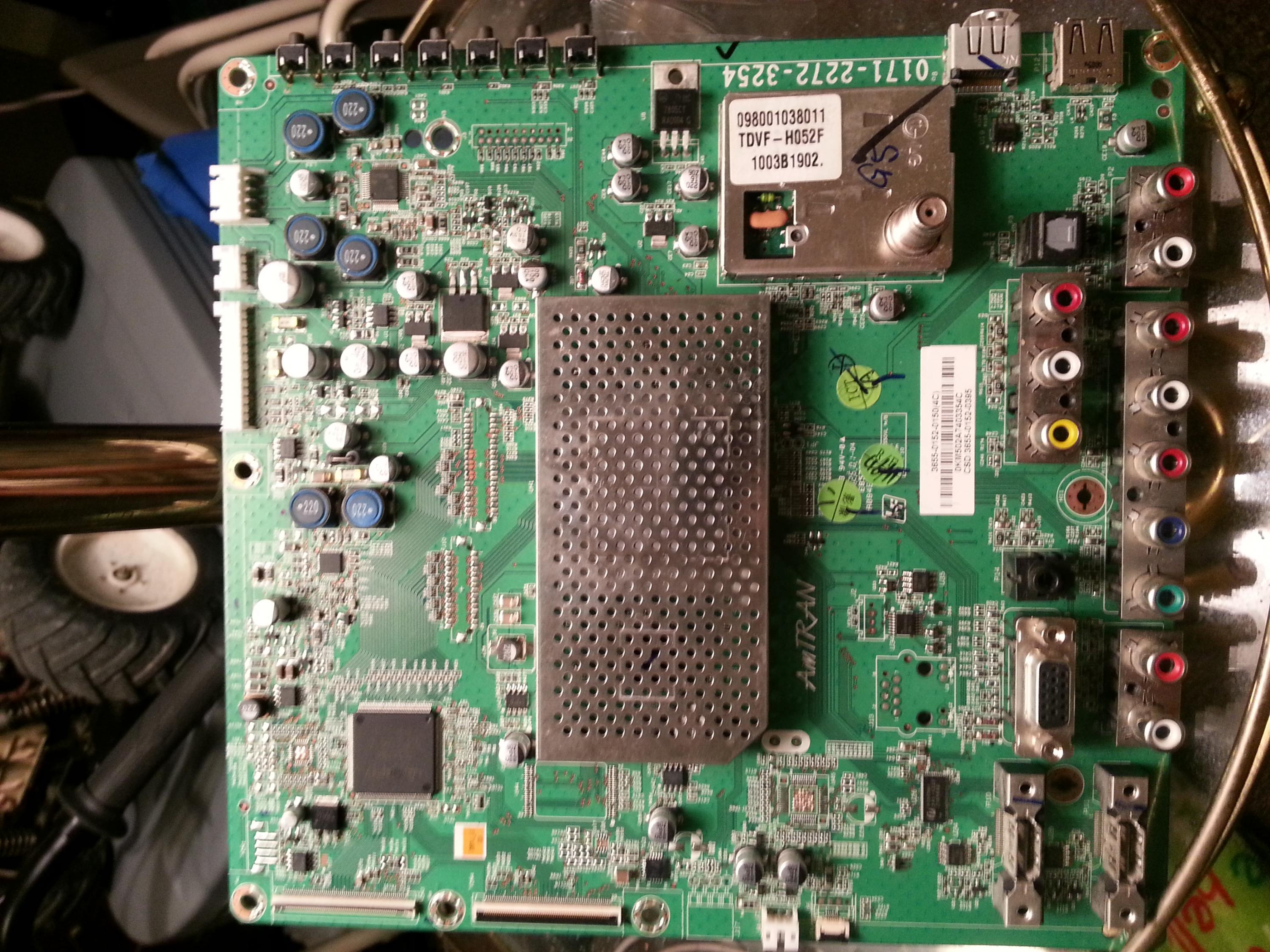

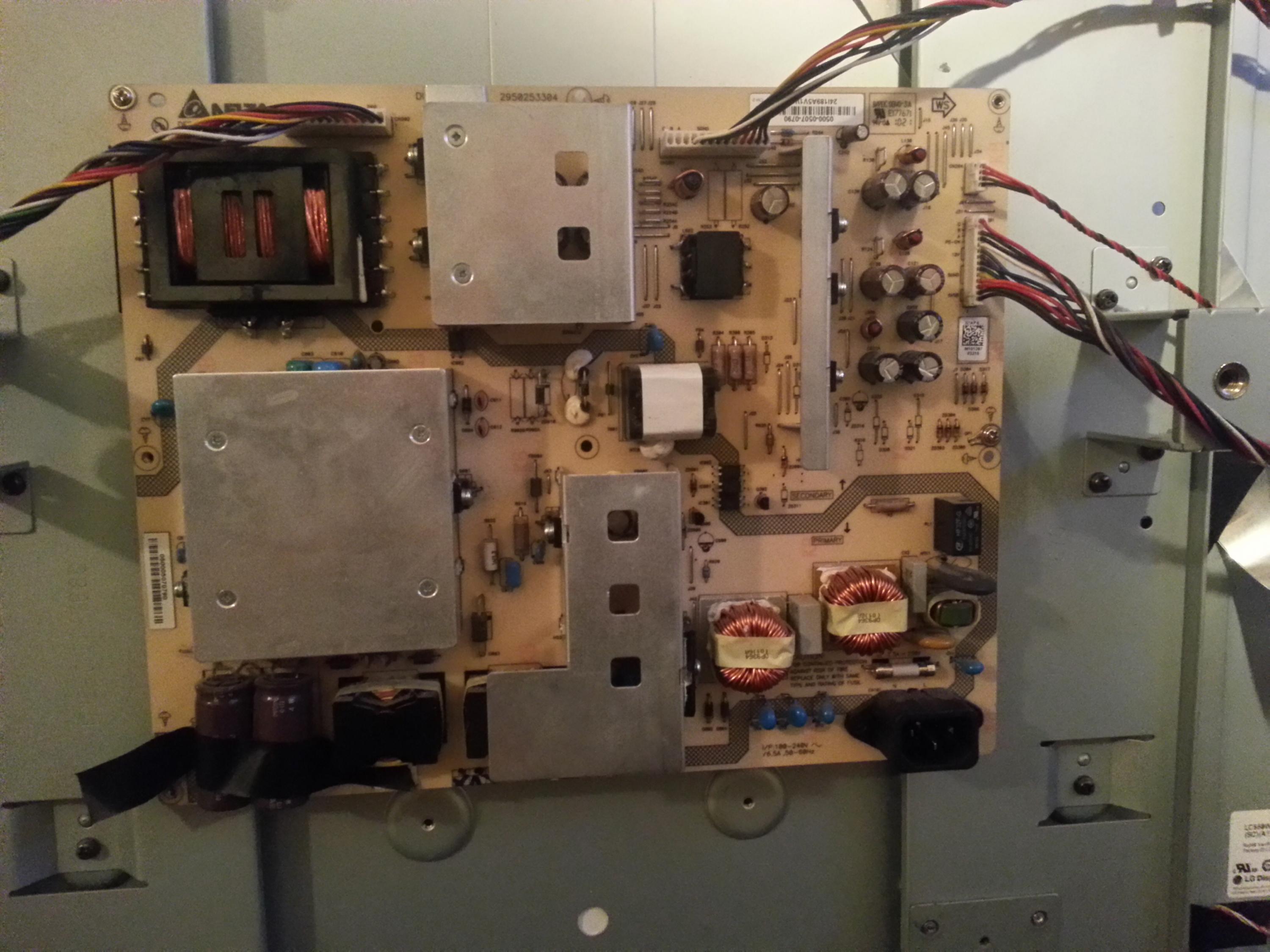

                          here is the power board and mainboard let me know if theres any other views you need

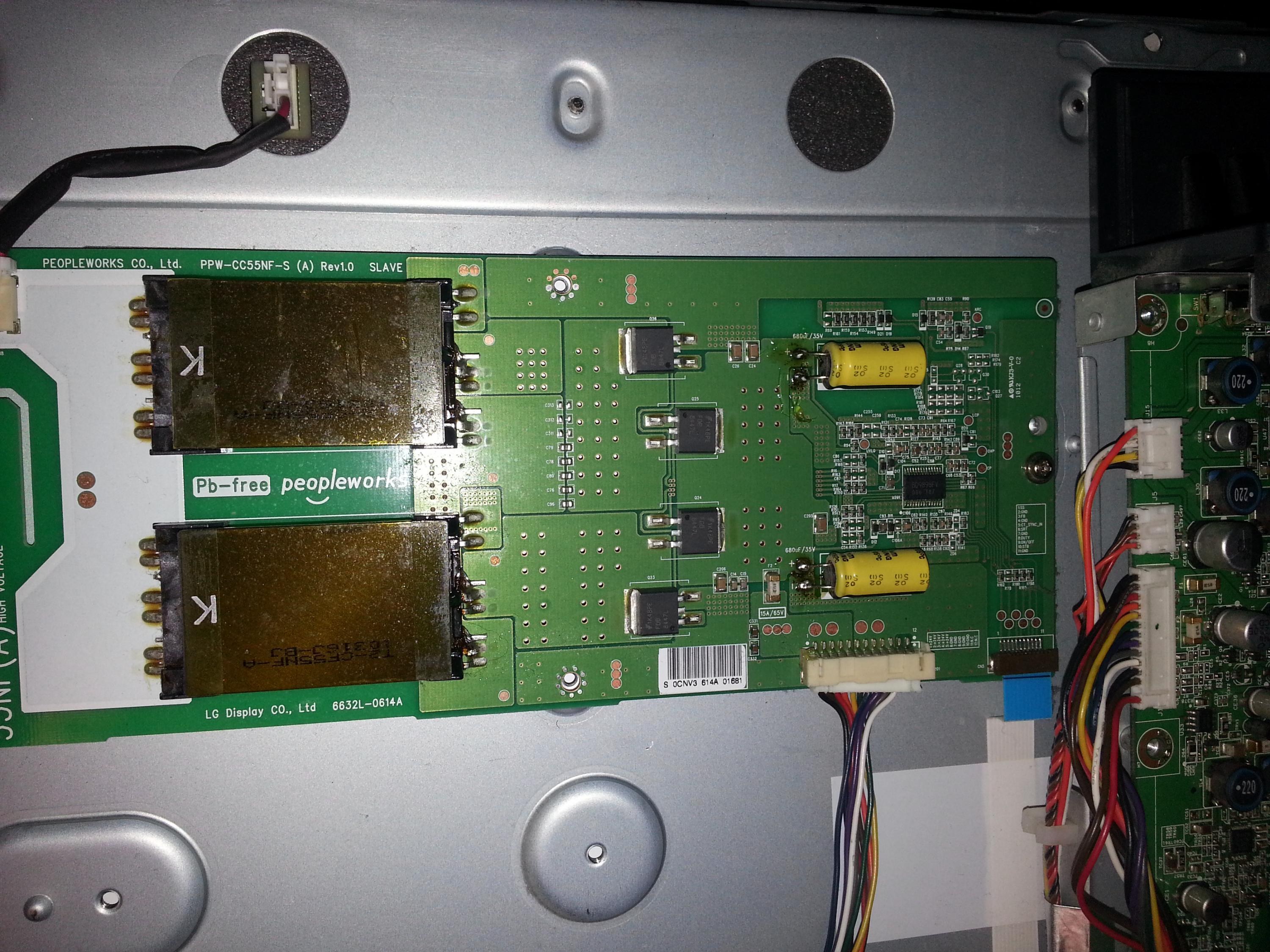

                            Pictures of the inverter board?

                            The filter caps for the 24v are under the heatsink. Can you see if they have domed tops?

                              Re: e550vl turns on 24v going to inverters fluctuates
                              someone had this set before me and took the caps off and put them back on and on the master inverter I put in a new fuse

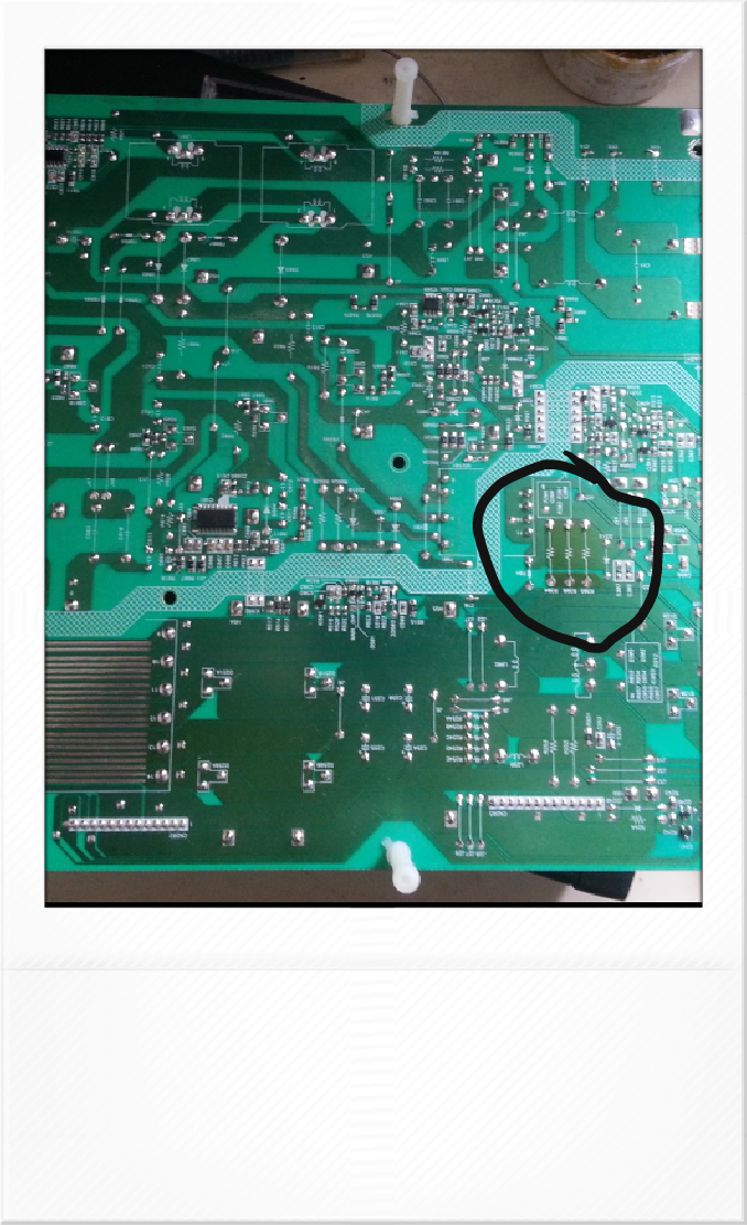

                                      those circled are r304 r308 r305 on power supply
                                        and the 24v caps look fine
