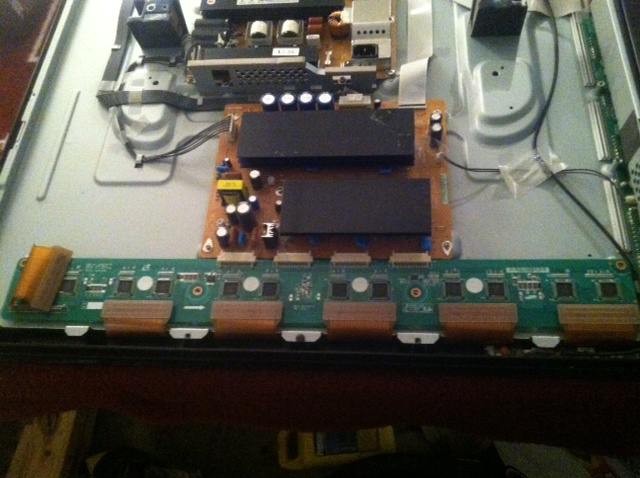

    I received this television from a gentleman with a faulty y-buffer. I replaced the buffer and the sustain because I already had the parts. No big deal.

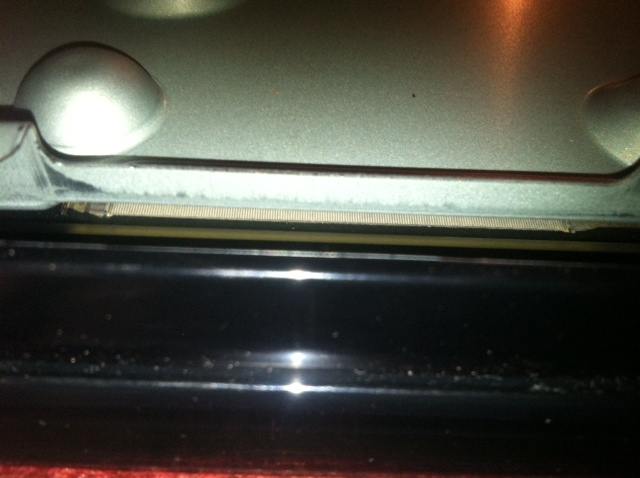

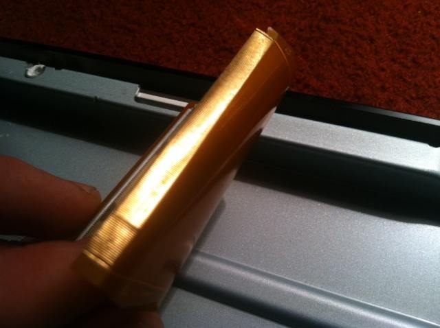

    The problem lies in the fact that the gentleman had attempted to work on the tv himself, without any idea of what he was doing. He managed to rip the top ribbon cable that connects the y-buffer to the panel itself, completely off of the panel, obviously causing a 2.5-3 inch horizontal black stripe across the top of the television. While he ripped it off, he somehow managed to do so without causing any visible damage whatsoever to the ribbon cable or it's seat on the panel. I know the verticle ribbon cables with chips inside cannot be repaired but I saw something here that gave me hope. He had literally attempted to reattach the ribbon cable with scotch tape. The amazing thing is that, when I got it, his scotch tape fix actually had 4 one-pixel horizontal lines working inside what should have been the solid black stripe. This gave me hope that it may be possible to fix. Anyone have any ideas on if reattaching this cable is possible and if so, what I might try?

    Unfortunately the ribbon can't be repaired once it is ripped, unless you can somehow connect the two parts. It can't be reconnected to the panel because it's bonded to the glass.

      The ribbon cable itself is in perfect shape. Just pulled off of the glass. So we are sure there is no way to re-fuse the ribbon to the panel?

        The ribbon needs to be laser-soldered to the panel -- I'm not sure you can do this at home unfortunately.

          Re: Samsung PN50C550G1F ribbon cable.
          Well that sucks. Great tv besides the black stripe across the top. Ah well. I'll just let the kids use it for a gaming tv or put it in the bedroom. Thanks for your help.
