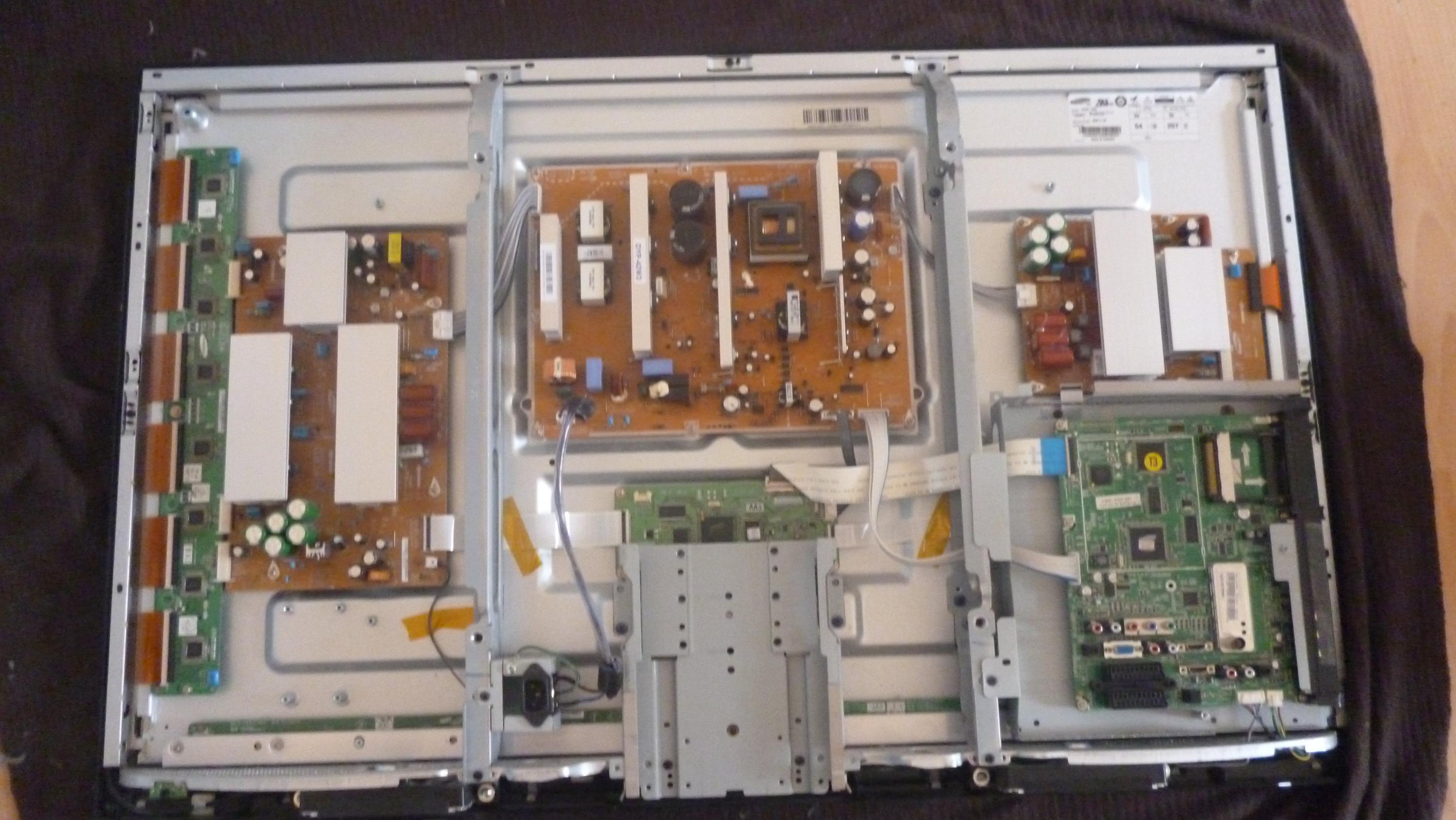

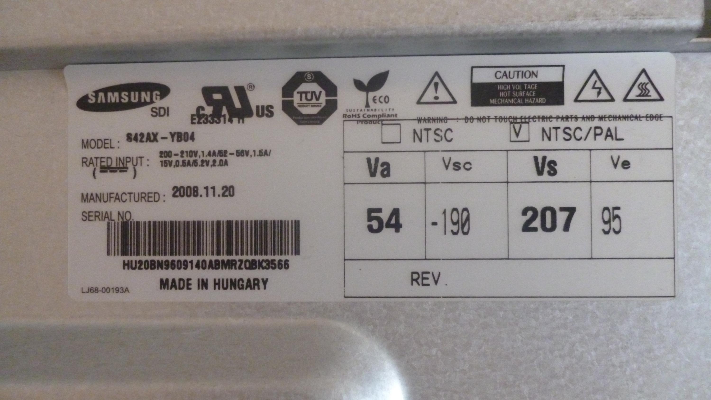

    hi guys got a faulty samsung model umber as in title, standby light on red wont respond to anything i do, took a few pics to help. noticed one cap that looks to be a little bulged. could it be just one cap ?
    if you guys need any detailed pictures of anything inparticular i can take more pictures thanks.
    Re: Samsung S42AX-YB04 Plasma TV stuck in standby
    Are you sure that's not just a panel mode #? We need the actual model e.g. PS42G400...
      Pictures
        sorry tom whats a Panel Model ? model number is PS42A457P1D

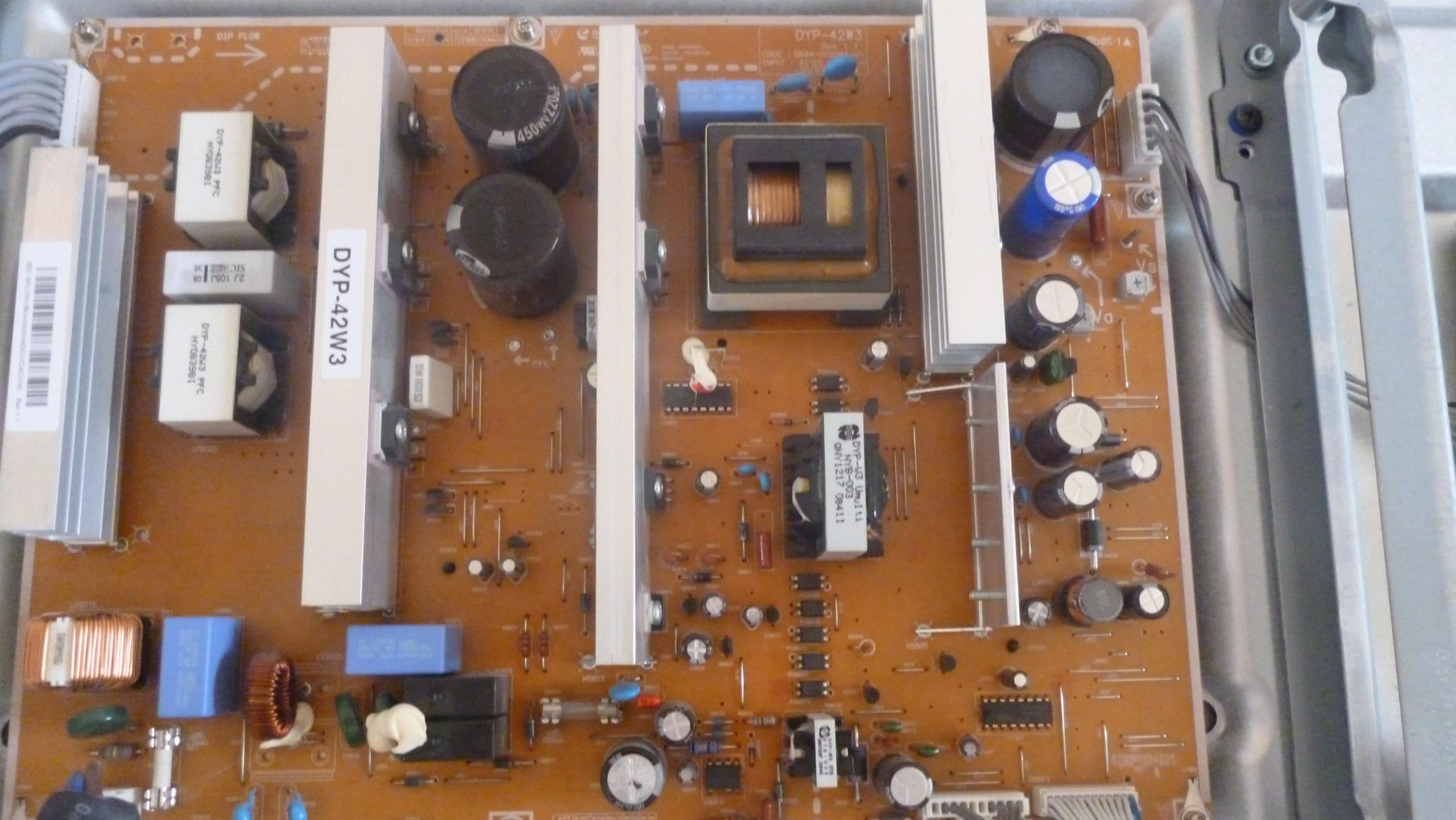

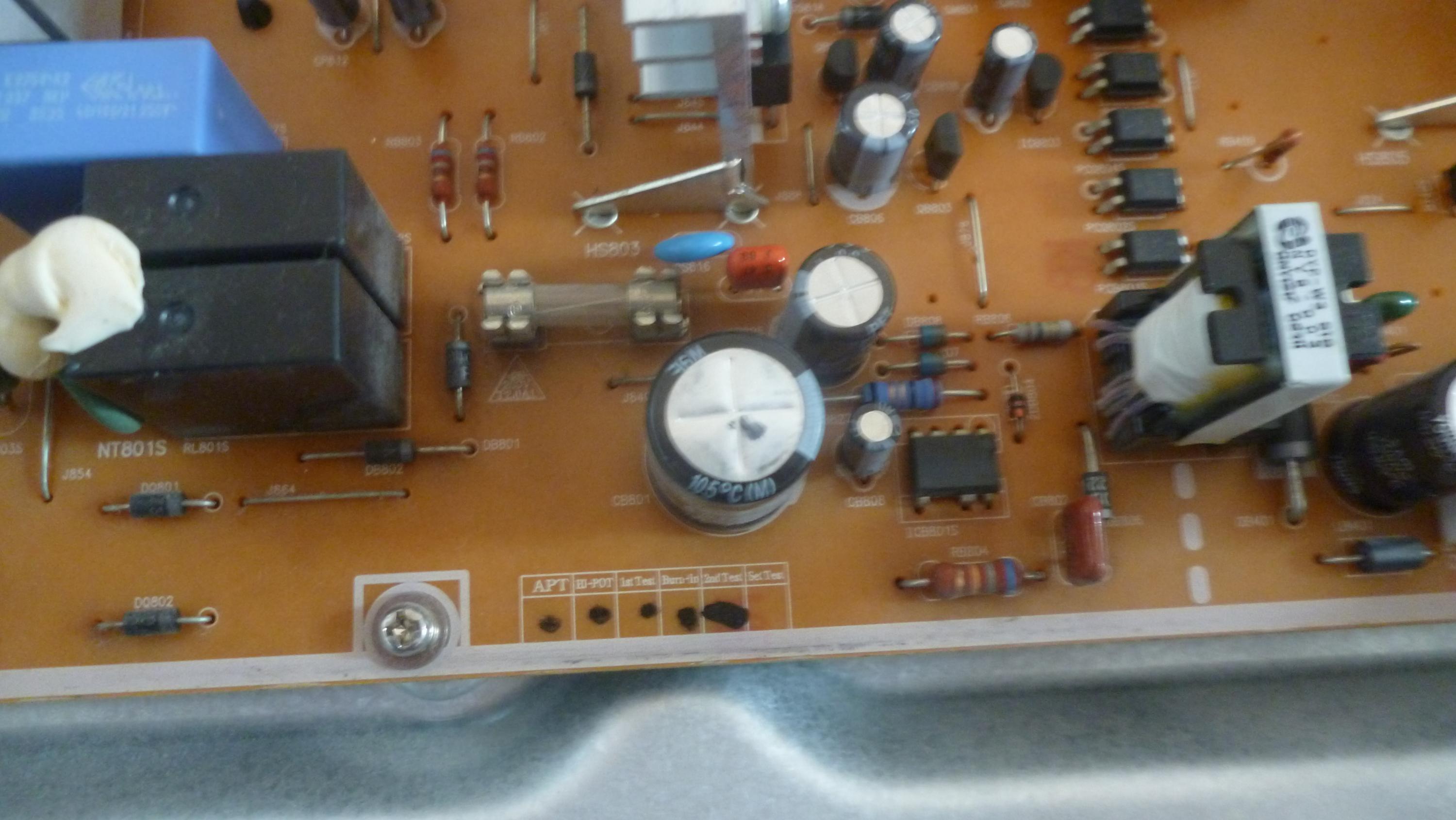

            Pictures are not really clear enough. You should be doing the tests we asked you to do on the hanspree and post the results. Test fuses. Test low voltages against ground screw.
            If None test Big Cap. If there are low voltages test them twice- when plugged in
            when switched on.
                That cap looks fine and I don't think it would cause the TV to stay in standby.
                Once (and ONLY AFTER) you have done Selldoor's tests, follow the steps here:
                https://www.badcaps.net/forum/showpo...61&postcount=2

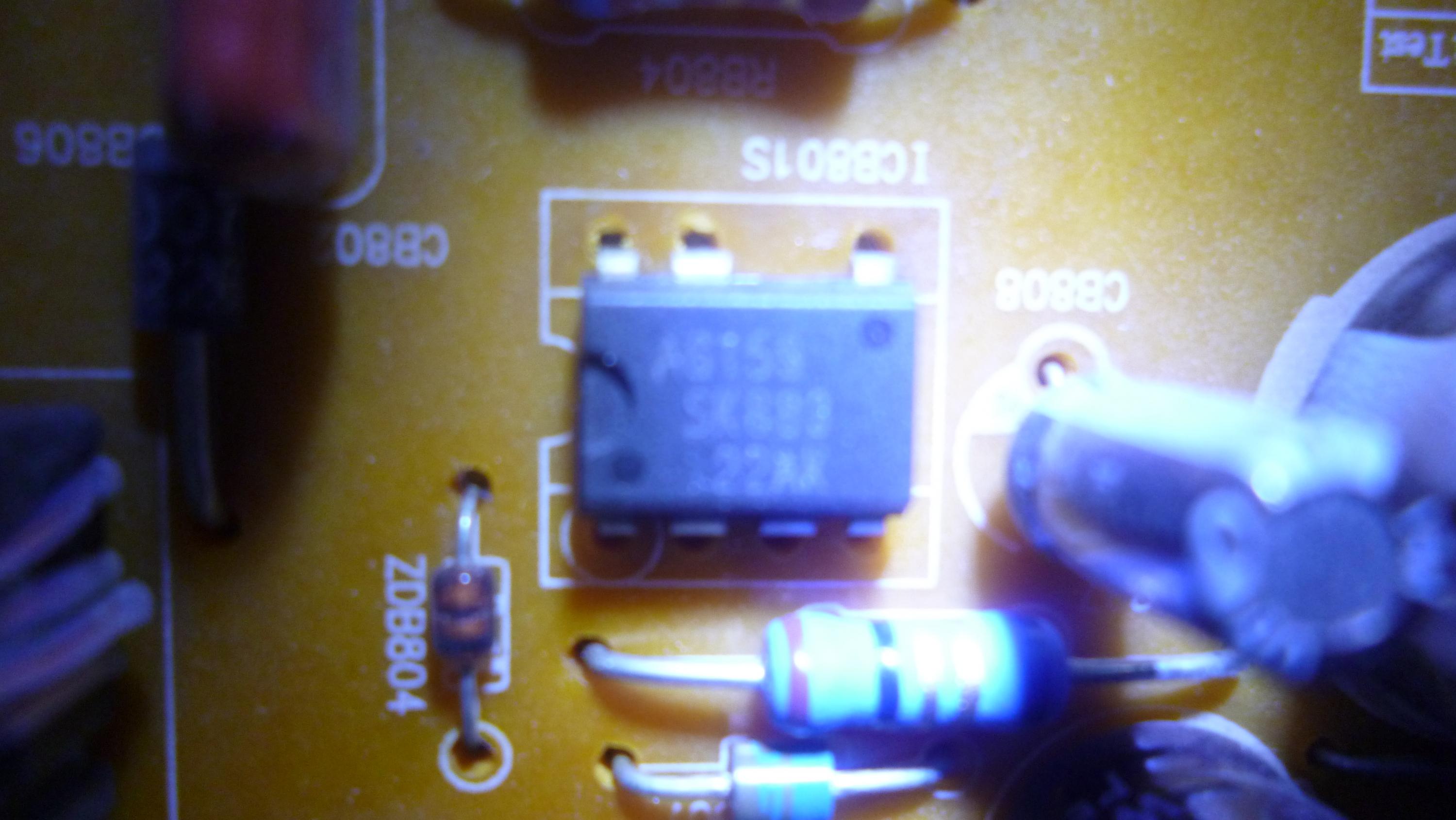

                                  Fluctuating voltage could be startup caps - what is the part number on the 7 legged
                                  component near the cap you thought was bulged?
                                  • Mikeyboy2007
                                    • Mar 2013
                                    • 745
                                    • Scotland
                                    will do another test to9 make sure its still unstable but part number you asked for is : A6519 SK883 22AK
                                      Schematic of PSU, I think
                                      http://www.tgohome.com/ServiceManual...&Search=Submit
                                      Part STR-A6159
