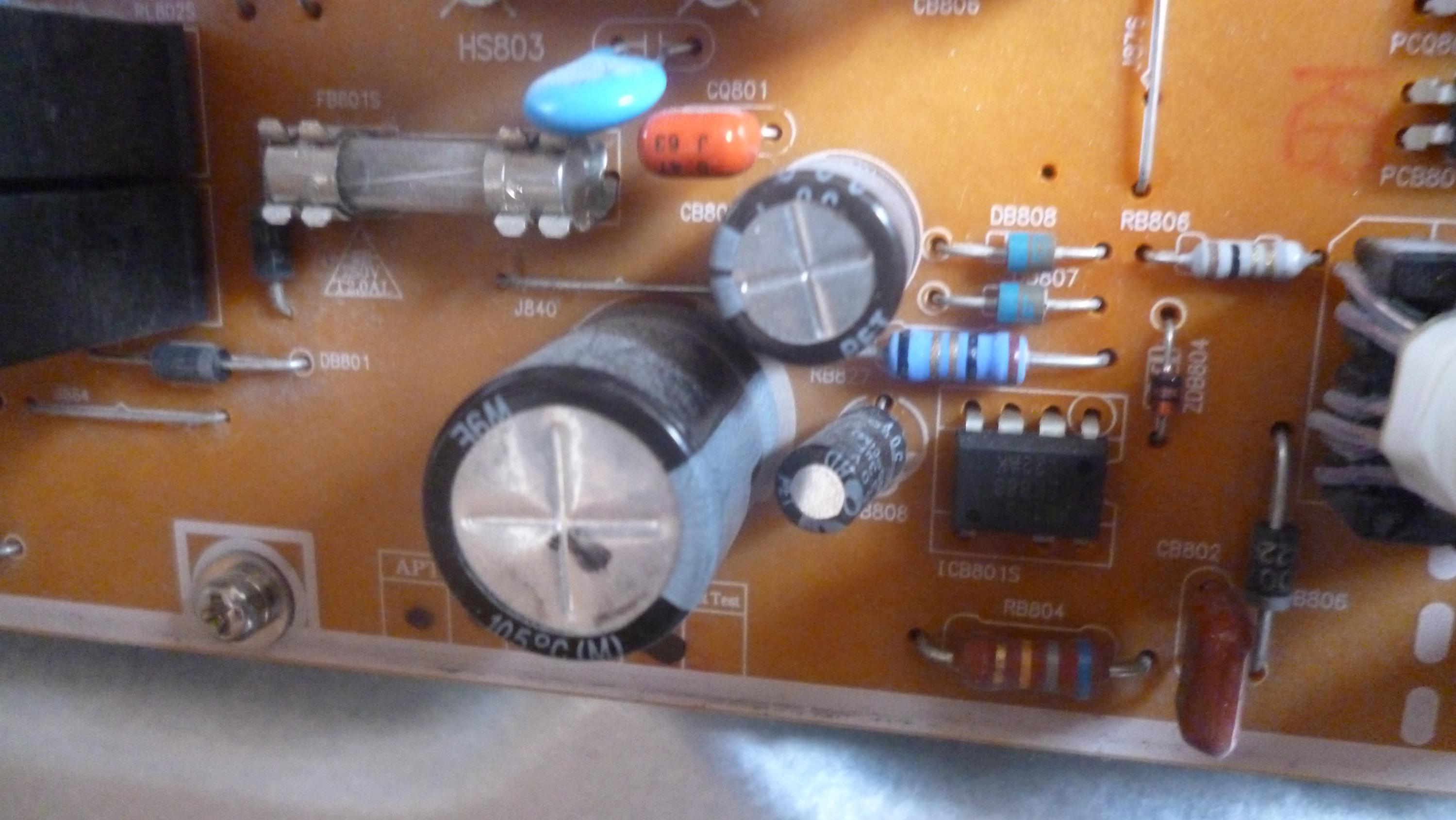

    Check voltage from pin 2 to pin 3. OR voltage across CB808 (one only.)

      sorry mate :/ il check voltage across pin 2 to 3> black probe on one red on the other ?

                  ok i will now test pin 2 to 3 on the 7 legged chip. how do i know which pin is n and 3 ? meaning there is 4 pins on 1 side and 3 on the other so would pins 2 and 3 be the one on the 3 legged side with the space in between them ?
                    #29
                    Re: Samsung S42AX-YB04 Plasma TV stuck in standby
                    Only need to check voltage across CB808. They're electrically the same. What was the result?

                      was boucing around a little, held probes straight and firm. but volatges ranged from 15.4 - 17.9
                        #31
                        The IC requires a min 16V to start up. So it would appear to be OK, but I would be suspicious of it.
                        I would prefer to check the supply with a 22 ohm 2W resistor to see if it regulates better under load. Any chance you can source one? Or a similar value 18~33 ohms minimum 1W (will get hot) but ideally 2W.

                              where would i put that though tom, sorry to sound like a d**khead just new to all this kinda stuff, tryin to learn too much too fast but appreciate the help. i have attached a picture of what CB808 is on the board as it looks different from a resistor >?

                                  You're putting it across the STBY voltage, not on the primary side. And not as part of a repair, because we still don't know what's wrong -- it's part of a diagnosis.
                                  Check Maplin code W22R. (For tests only.)

                                          I'm thinking that; the unsteady voltage makes me suspect that capacitor. However, I want to rule it out (or in) first.
