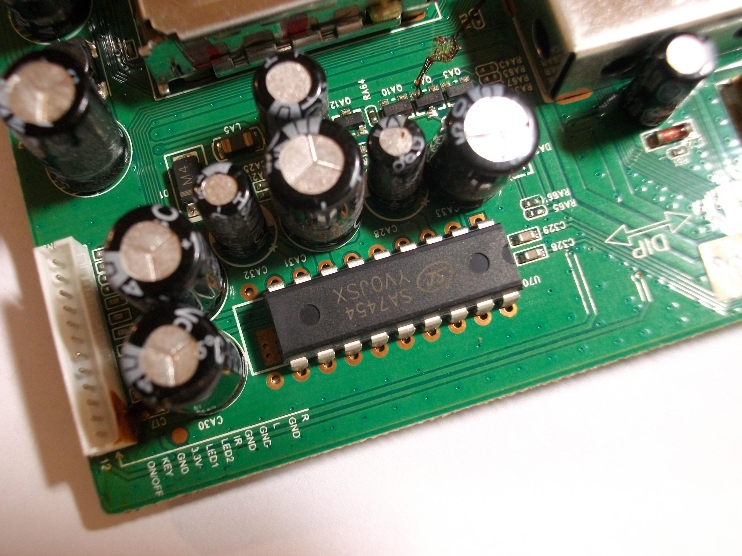

    coby LED 2326 will not turn on

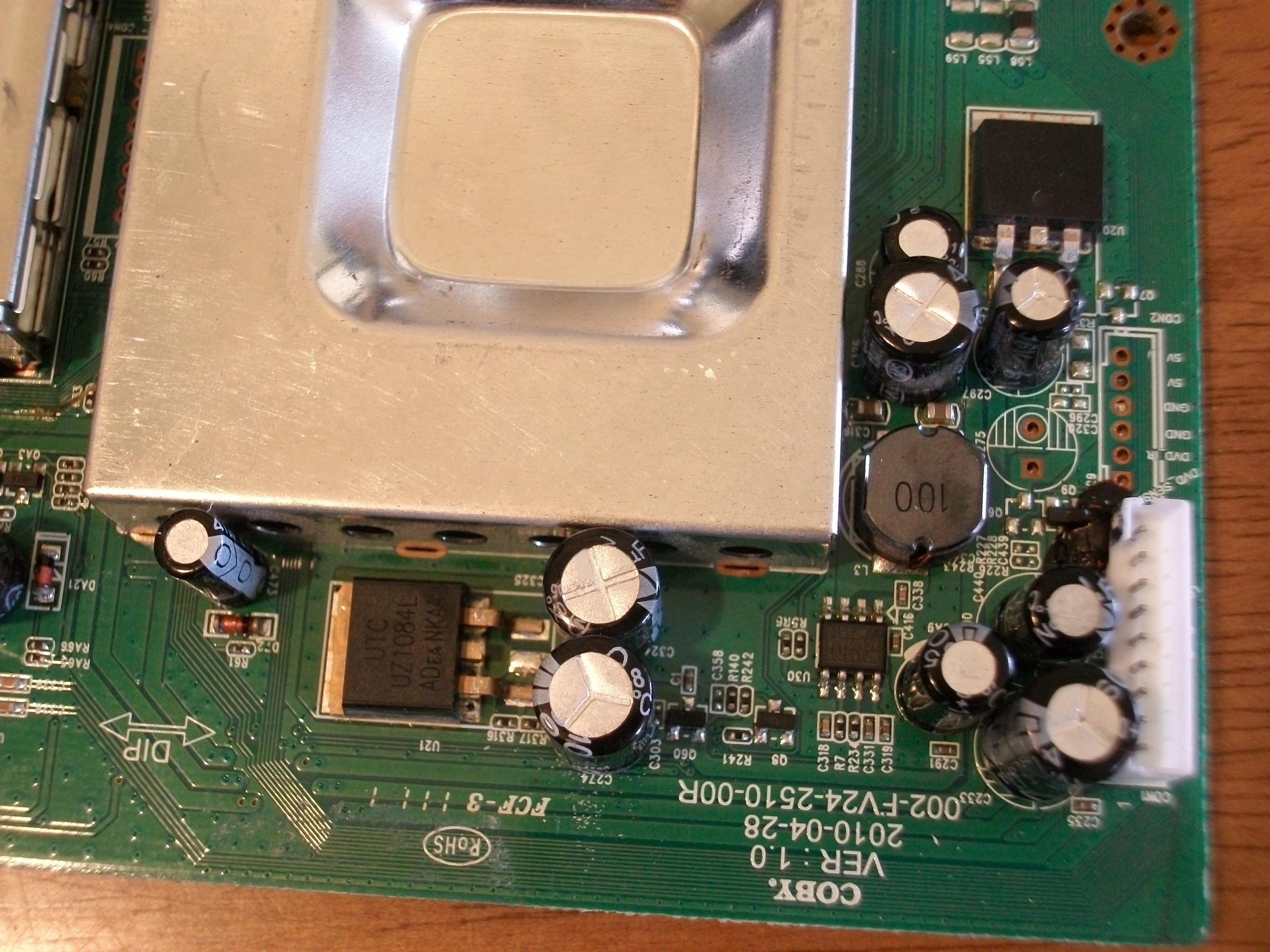

    Picked this TV up, The Tv will not turn on .It has a blue led light on in the right hand corner that comes on when you plug it in. If you hit the power button again the light gets brighter for a second when the tV shuts off. All the voltage is right on the power board 5v and 12v. On the main board the powers are right for 12v and 5v but the 3.3v is not right. It is measuring 5.27v
    Re: coby LED 2326 will not turn on
    Where is that 3.3V test point? Is it under that long board attached to the power supply board?
    I see the connector on the left side of the board where it has 3.3v label on it, so it must be 3.3V regulator or buck regulator on the main board.
      Budm I tested it on the main board at the plug marked 3.3v

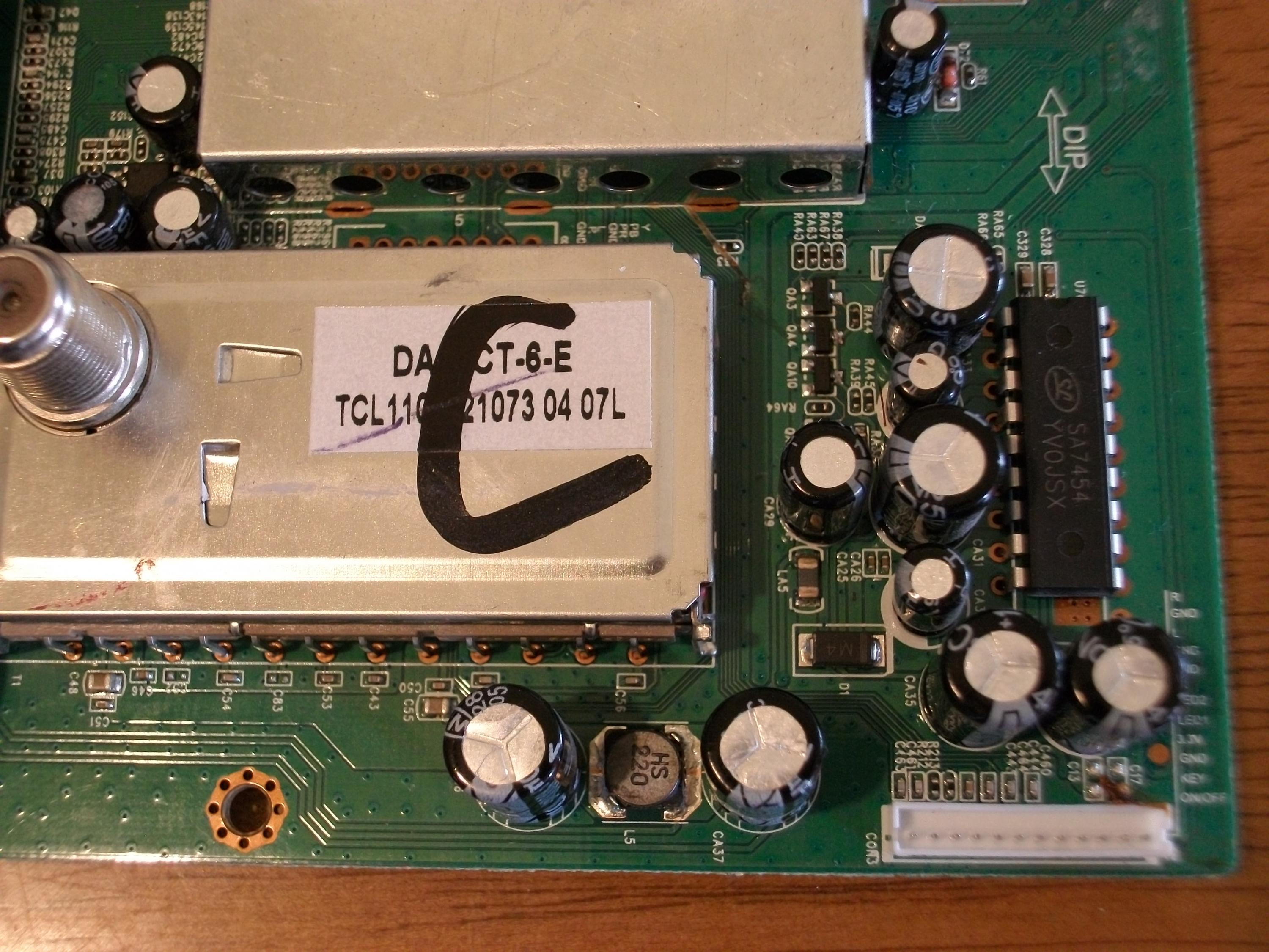

        Can you trace that back to the connection on the power supply board since I can only the the connector labeled with 5V and 12v OUTPUTS. There must be a regulator some where that drops the 5V down to 3.3V.
        I see at least two 3-leg regulators on the main board.

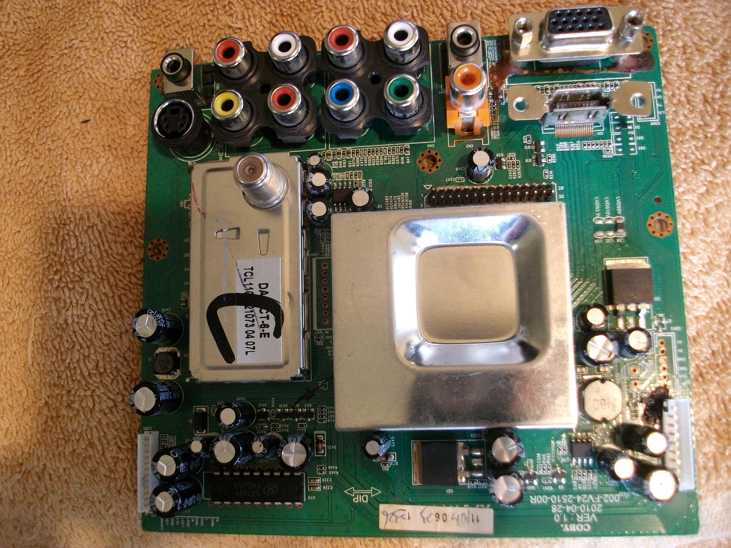

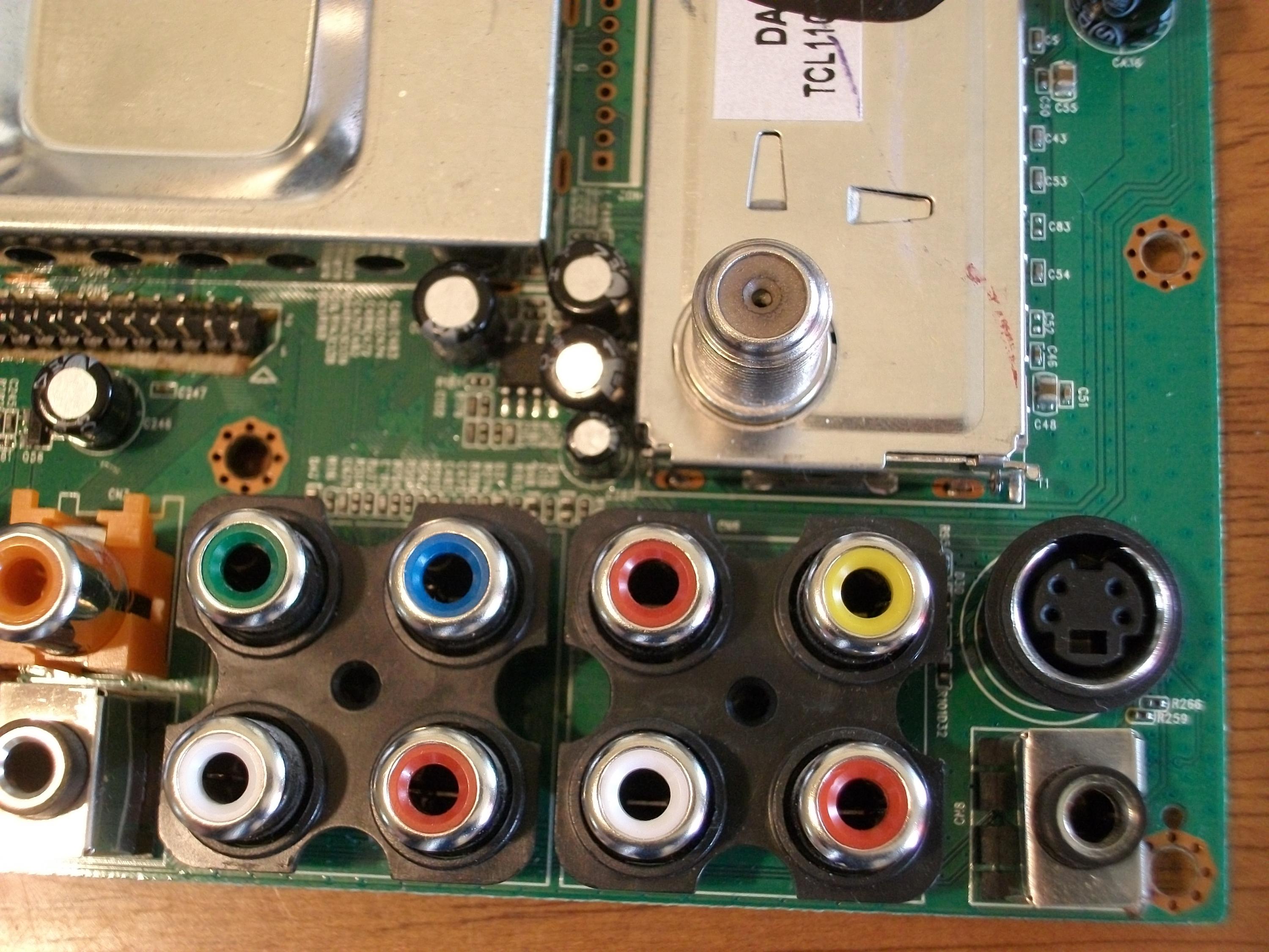

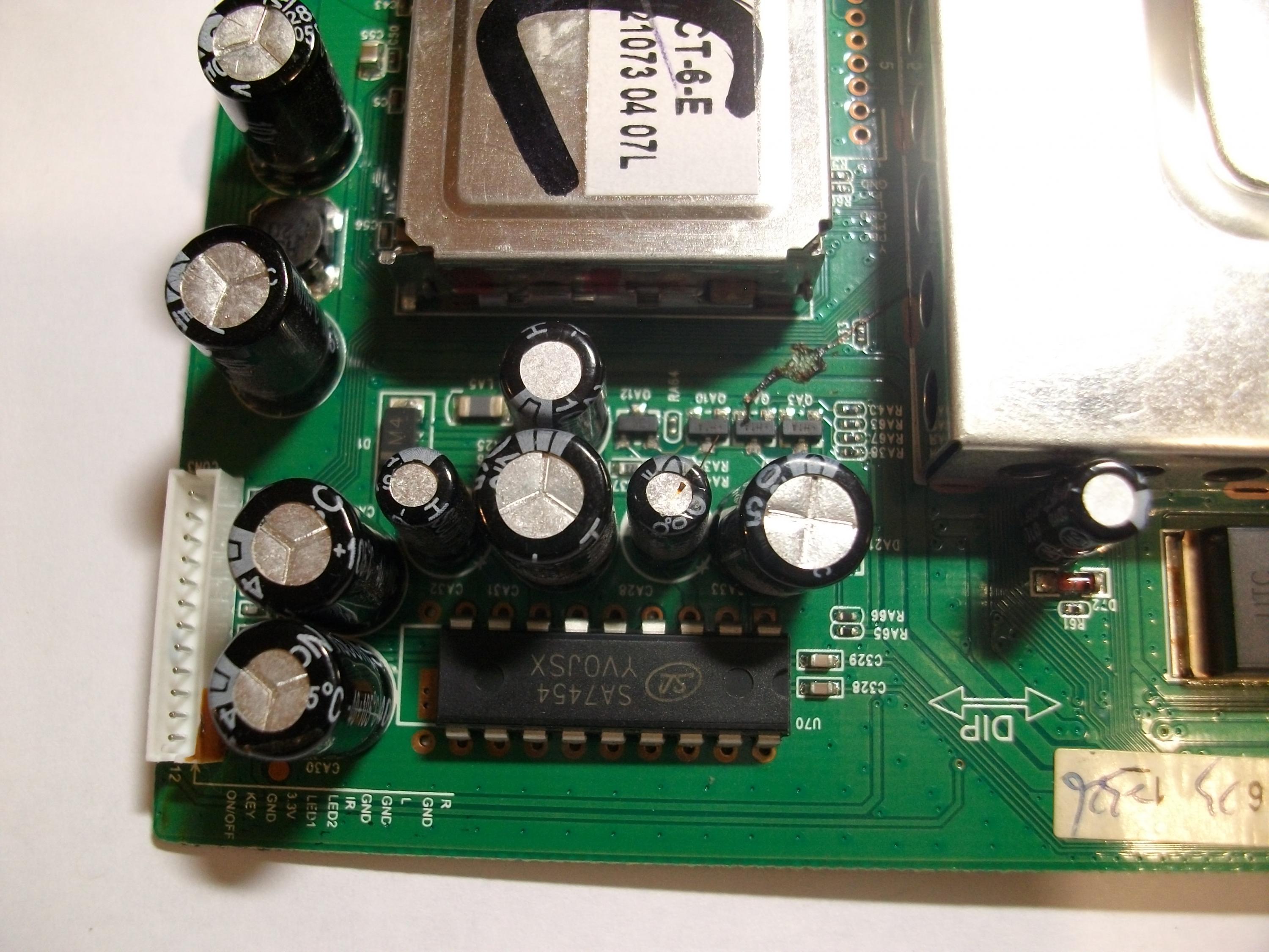

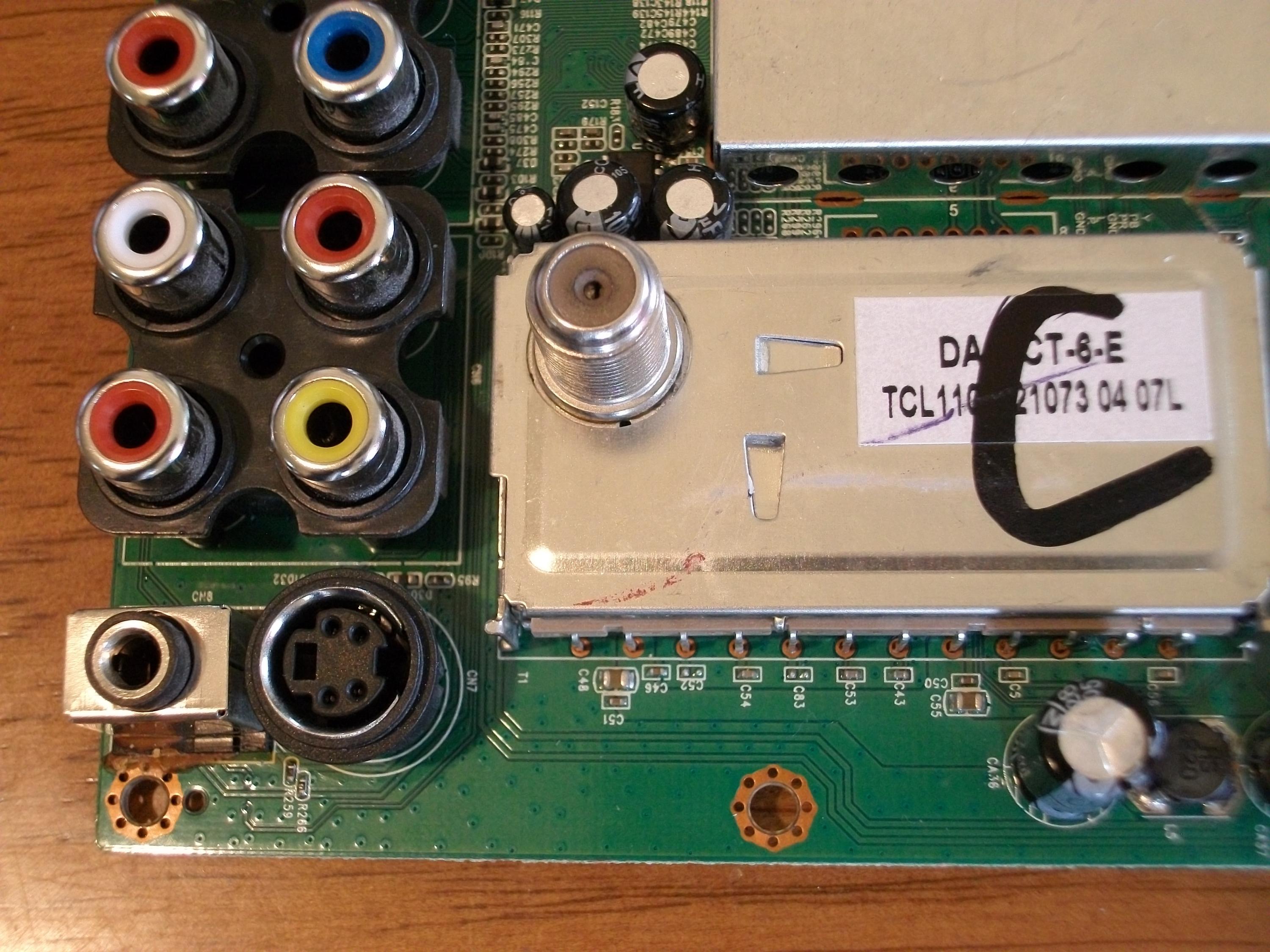

          budm, I can't trace it. here's a few more pictures. let me know if you need more

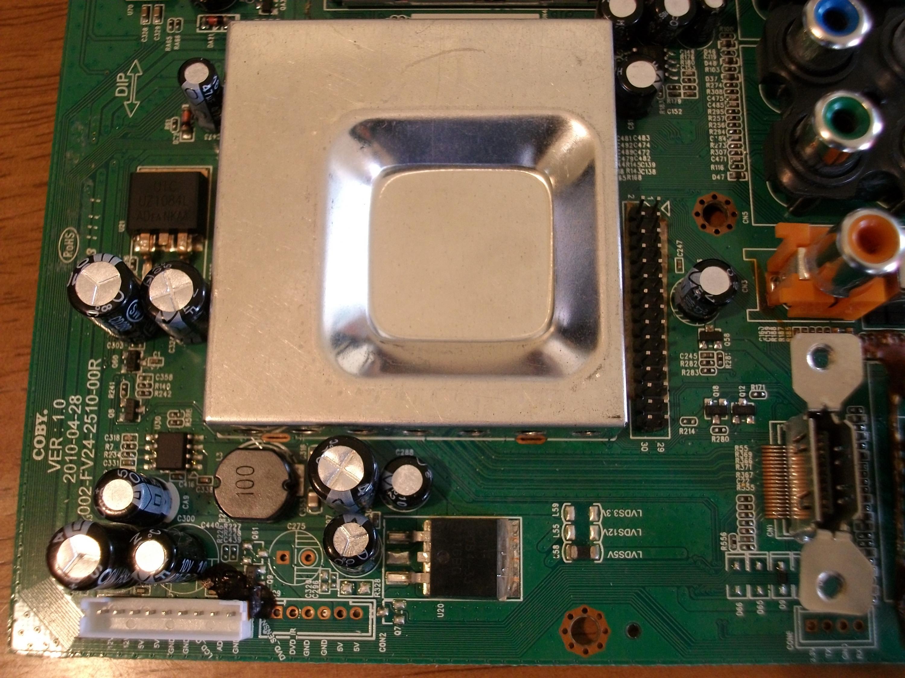

            Coby!! I thought they made trouser presses!!

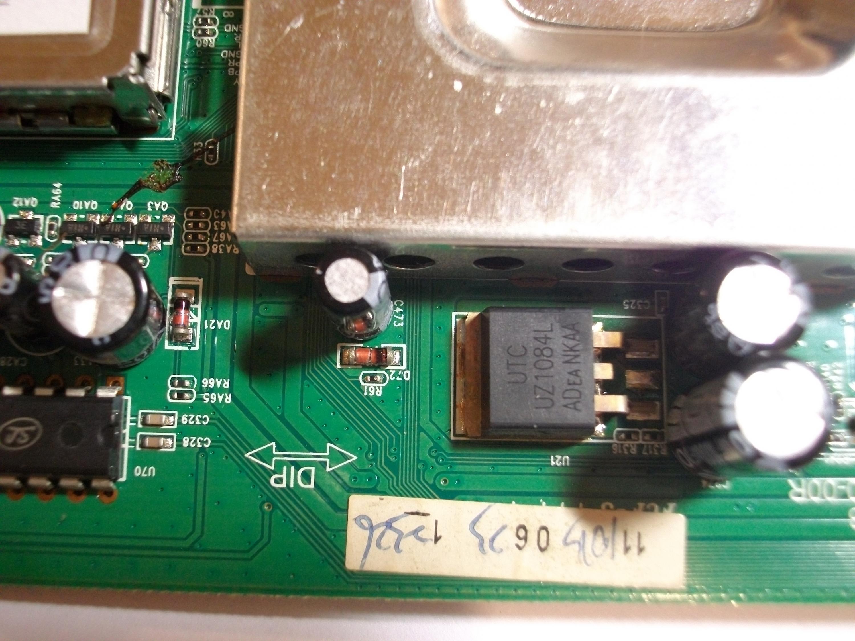

            U21 is an adjustable VR - can you test it -you have had lots of practice with those.
            Also what is the value of the little attached resistors.
            EDIT sorry that is Corby

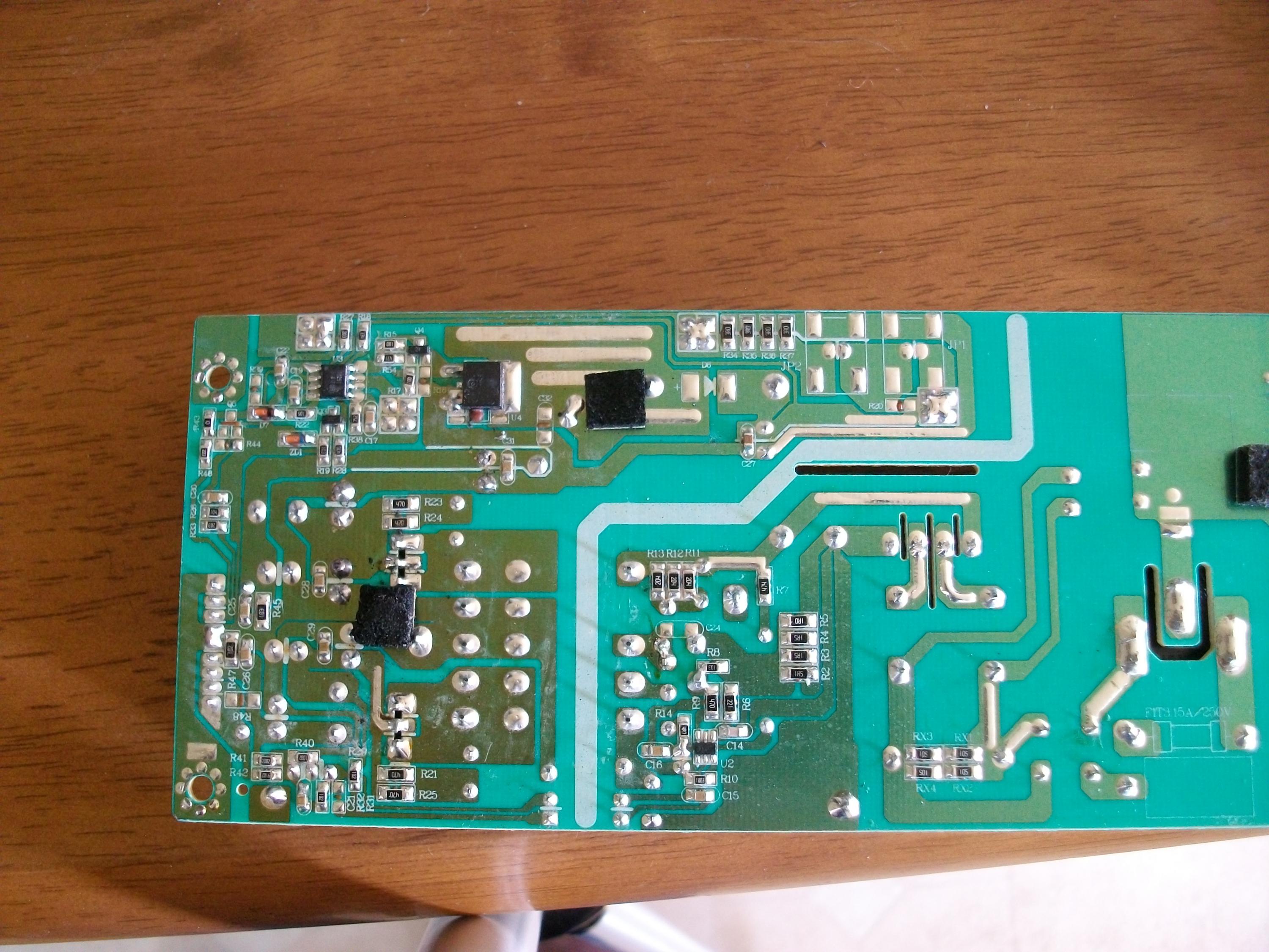

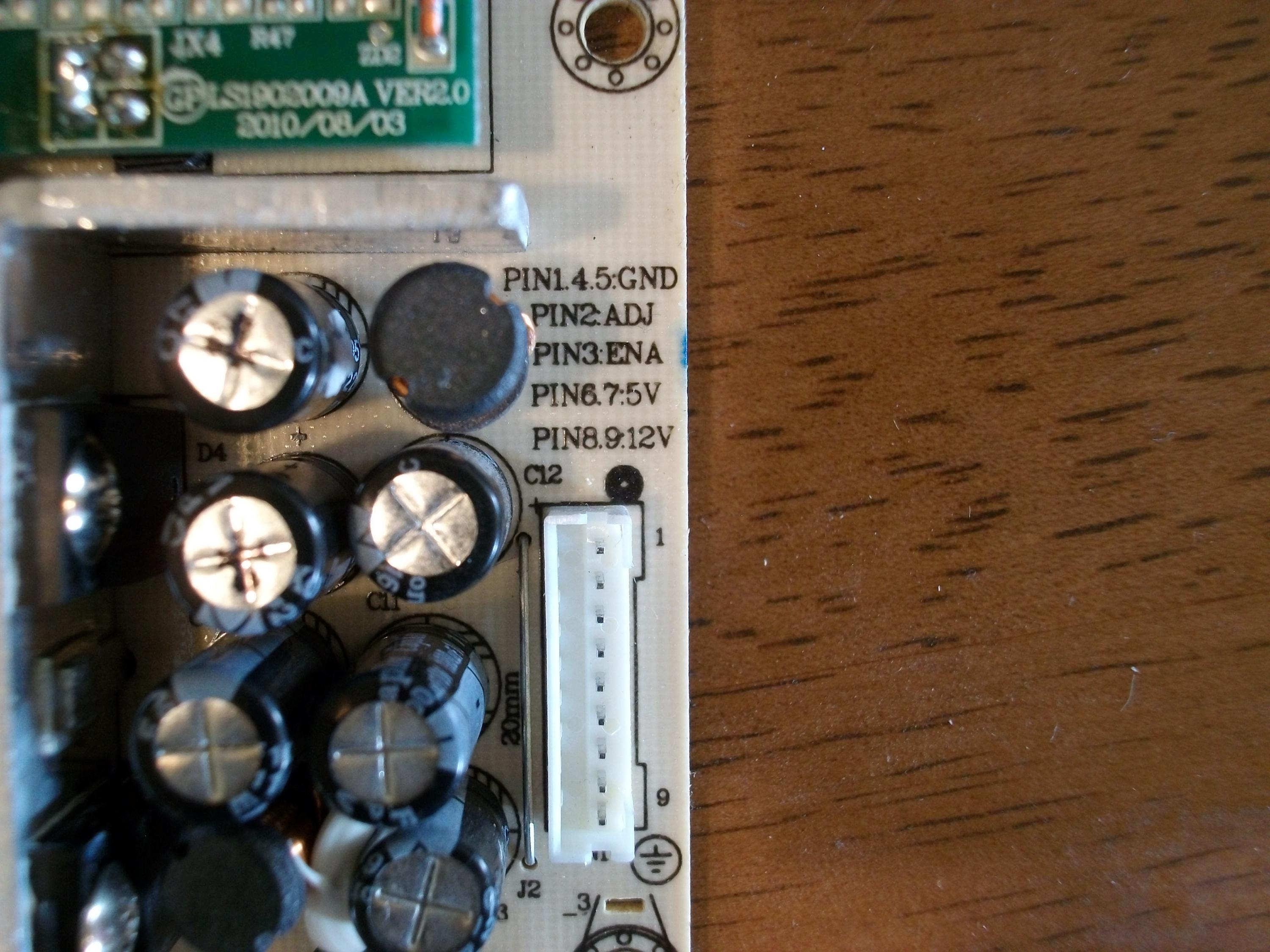

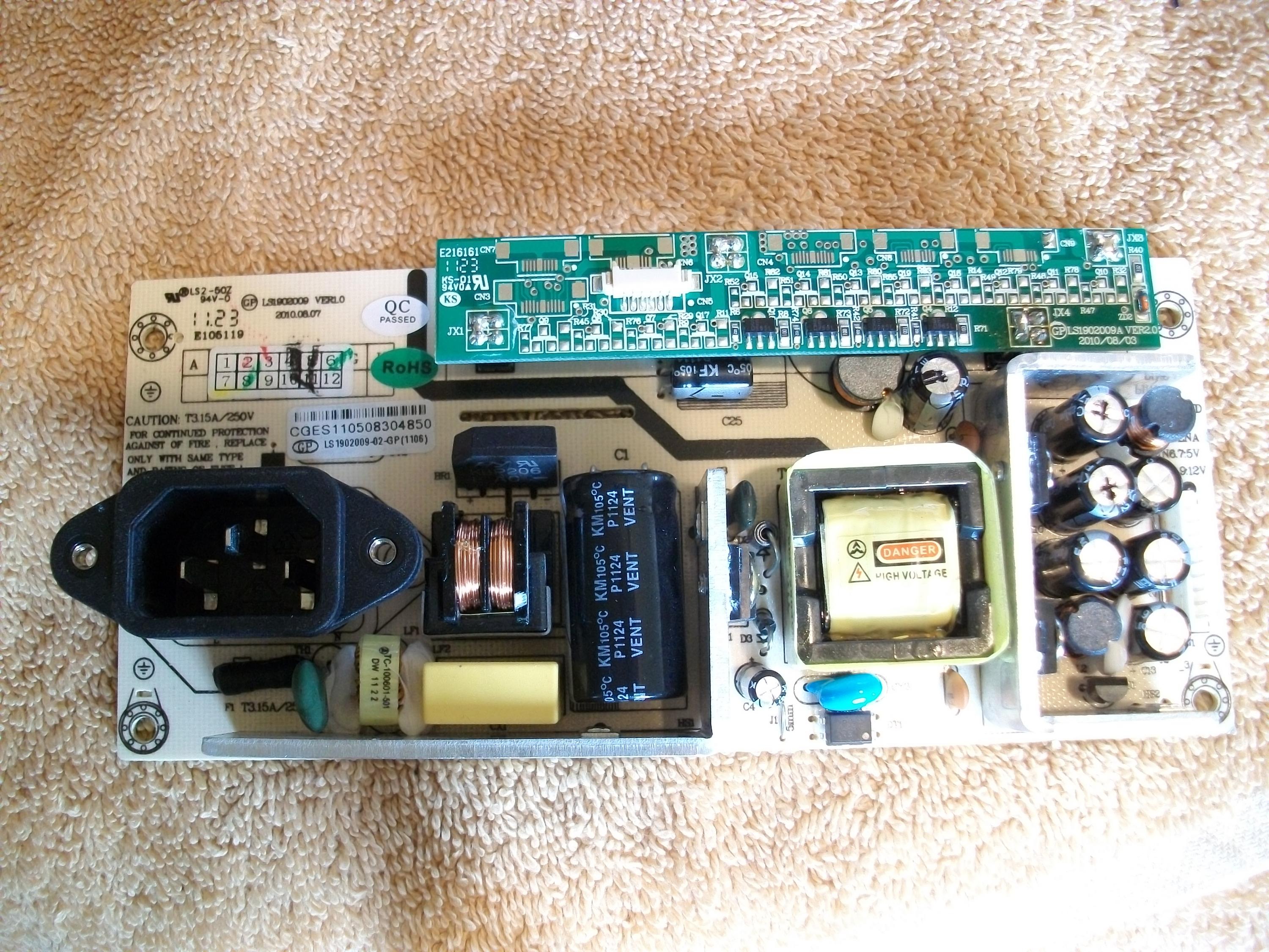

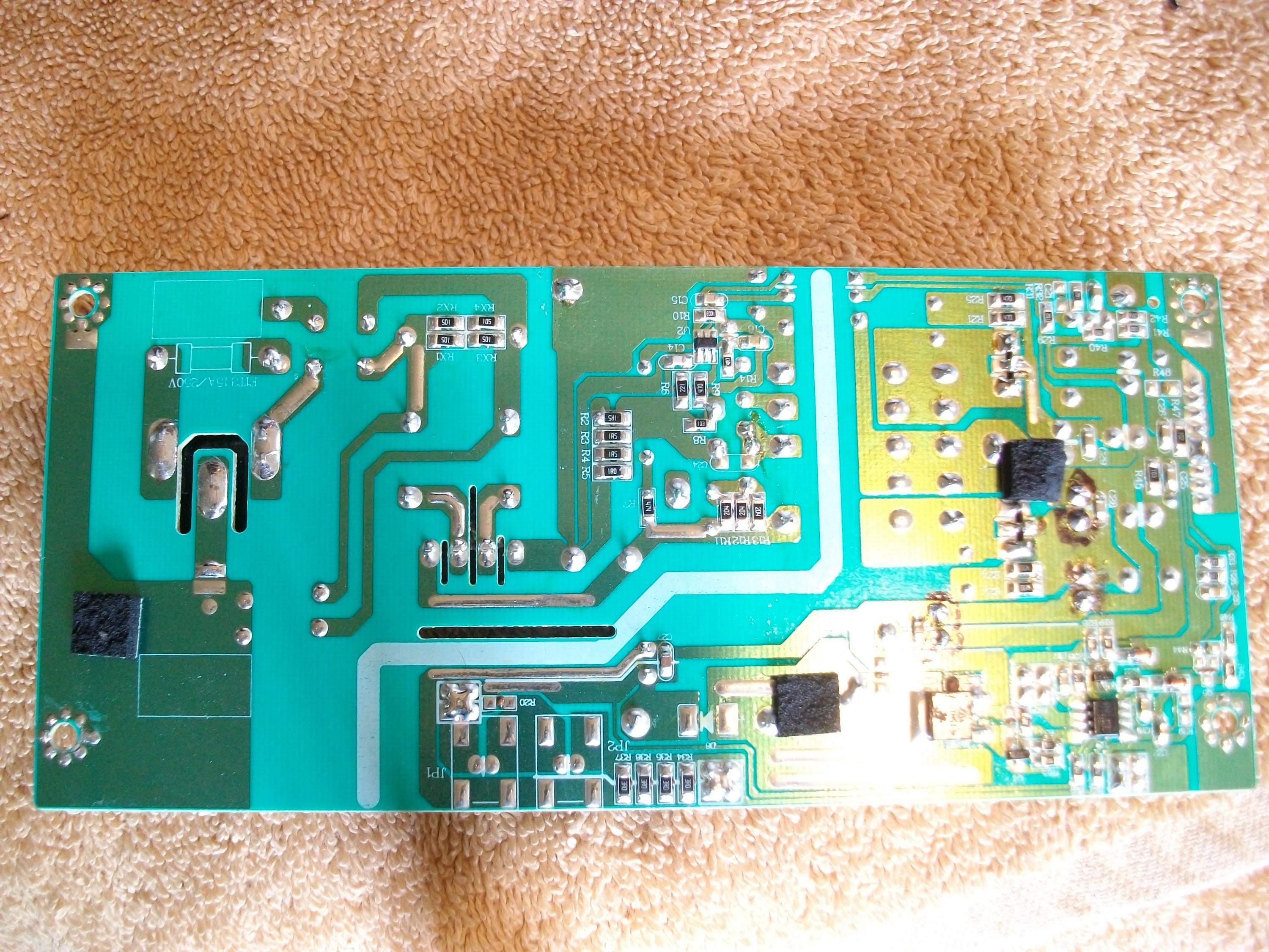

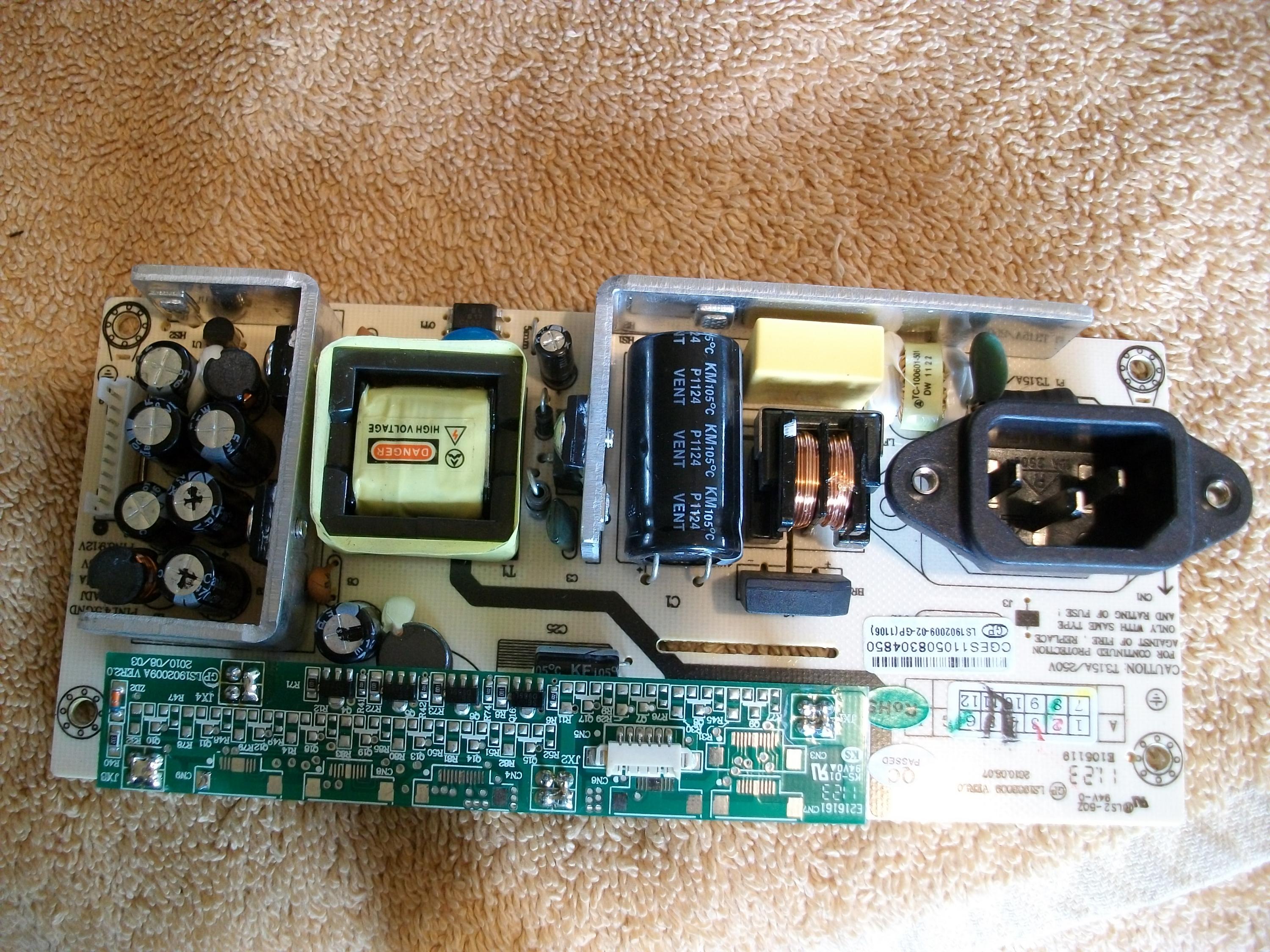

              Budm did say trace it on the power supply (not sure if that is what he meant) but you have posted pics of the main board.
              Can you do a close up of the other VR and on the power supply a pic from the side
              showing all the legend for the connector and another shot of the back of the power supply
              as the bit needed to trace back from the pin is flashed out.

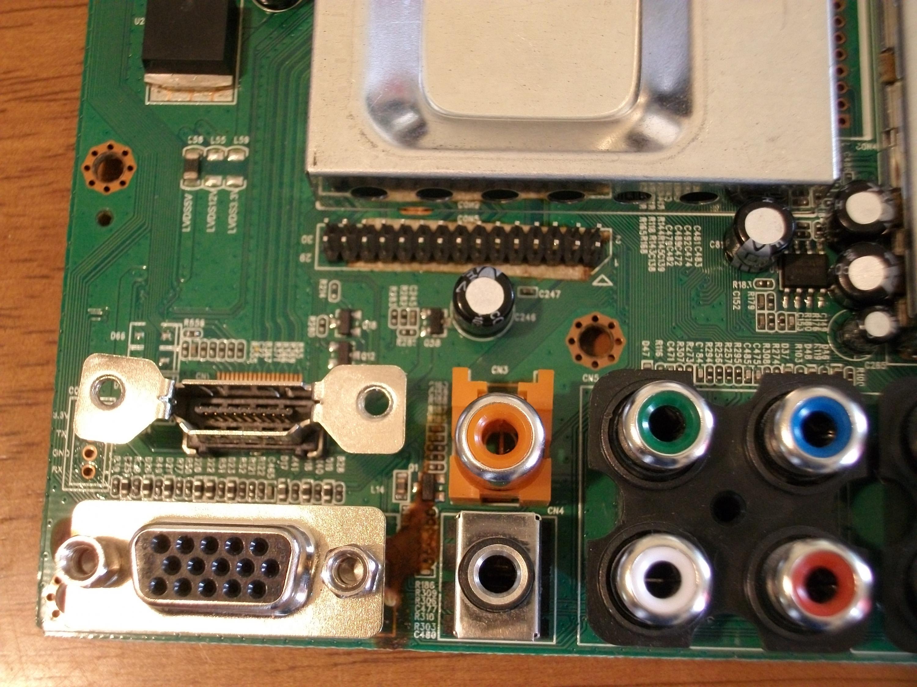

              ALSO what is the black blodge by the other connector on the main board has something died there - can you clean it off with isopropyl alcohol. There is also another streak in the last 3 opics can you clean that off as well in case it has gone conductive.
              None conductive stuff and dust heat up and if they get to the point where they oxidize or start to burn it can turn to carbon which is conductive.
                selldoor, do I test u21 with power on or off? I will be posting more pictures soon. The brown stuff your seeing on the board i think is glue. I will try and get it off
                  Power on, I think one of those regulator is for the 3.3V.

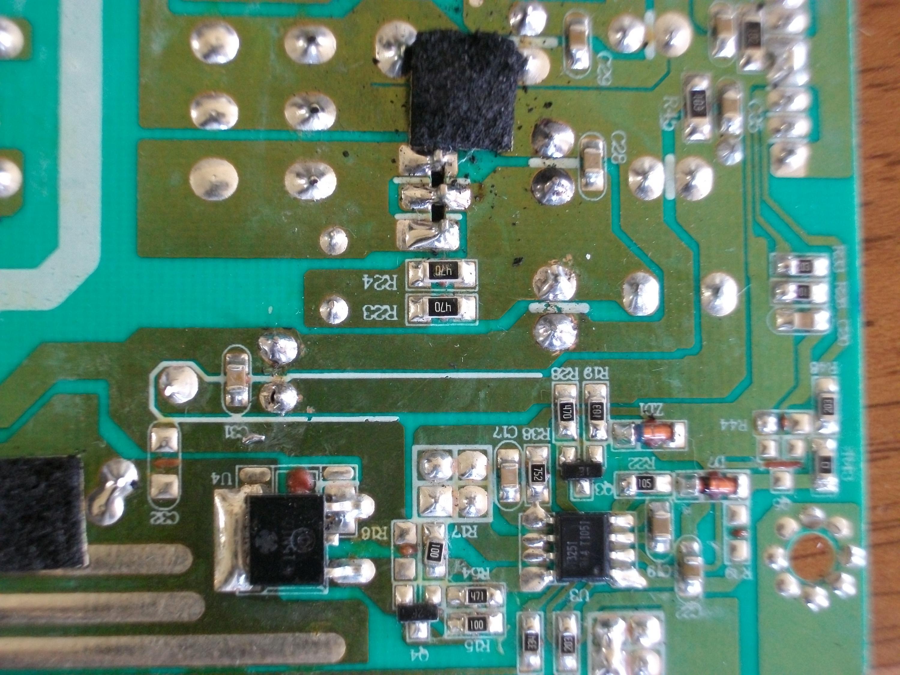

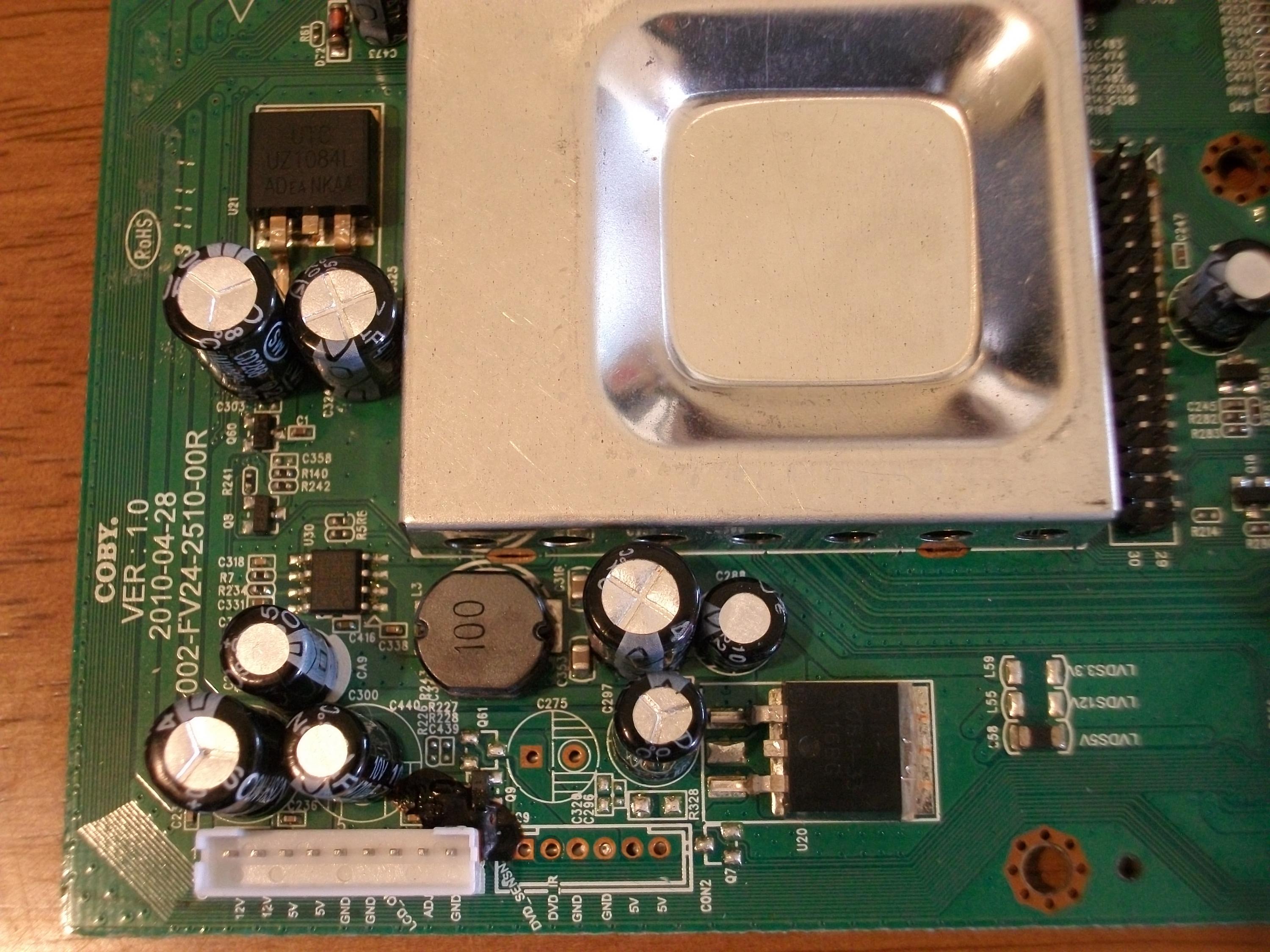

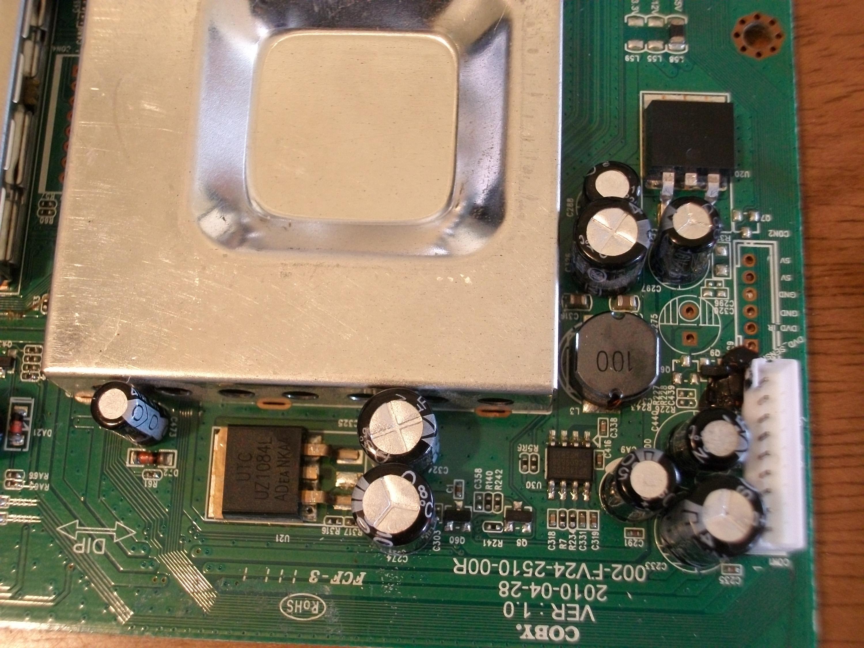

                    Here's more pictures of what you wanted selldoor.

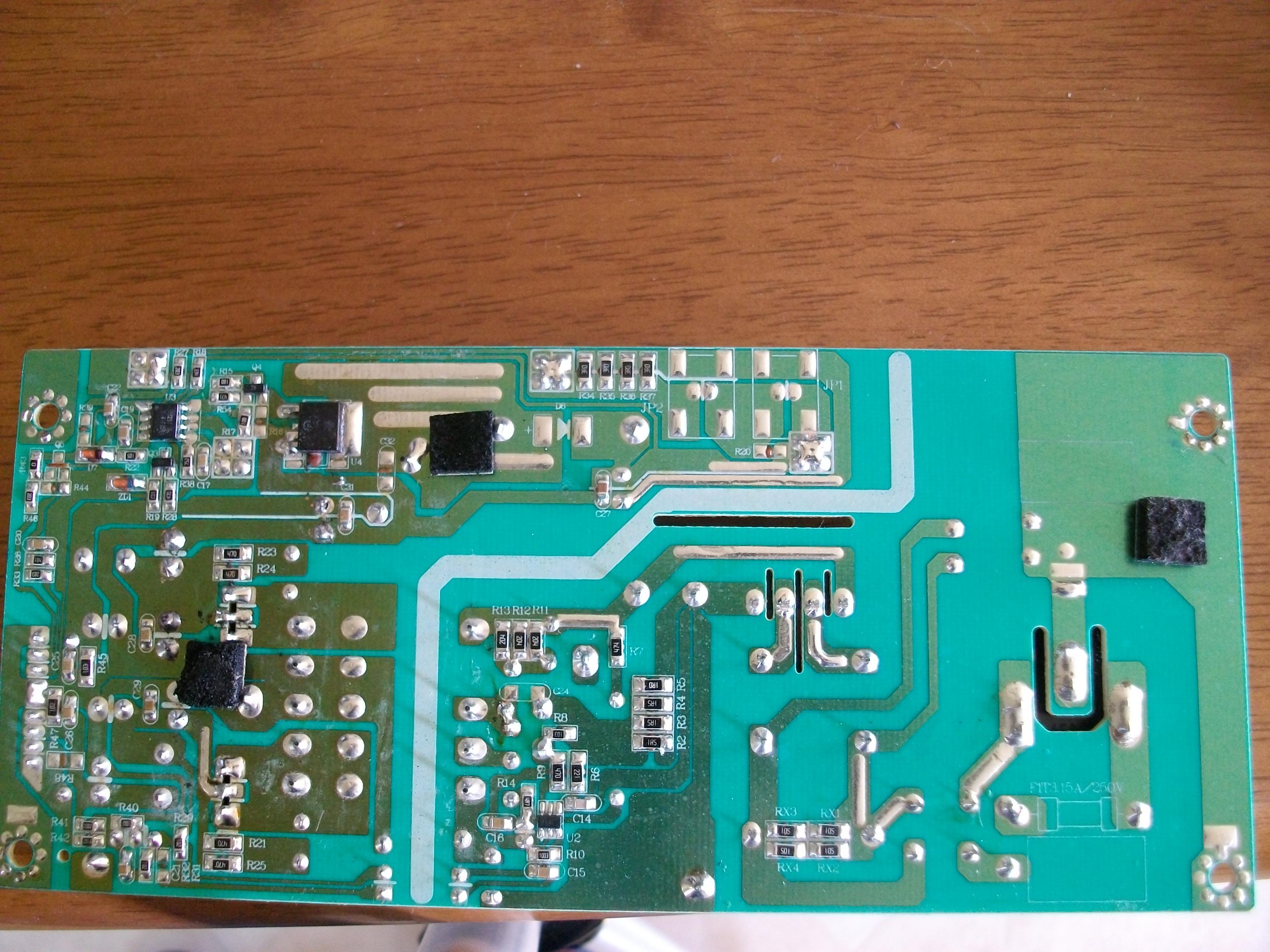

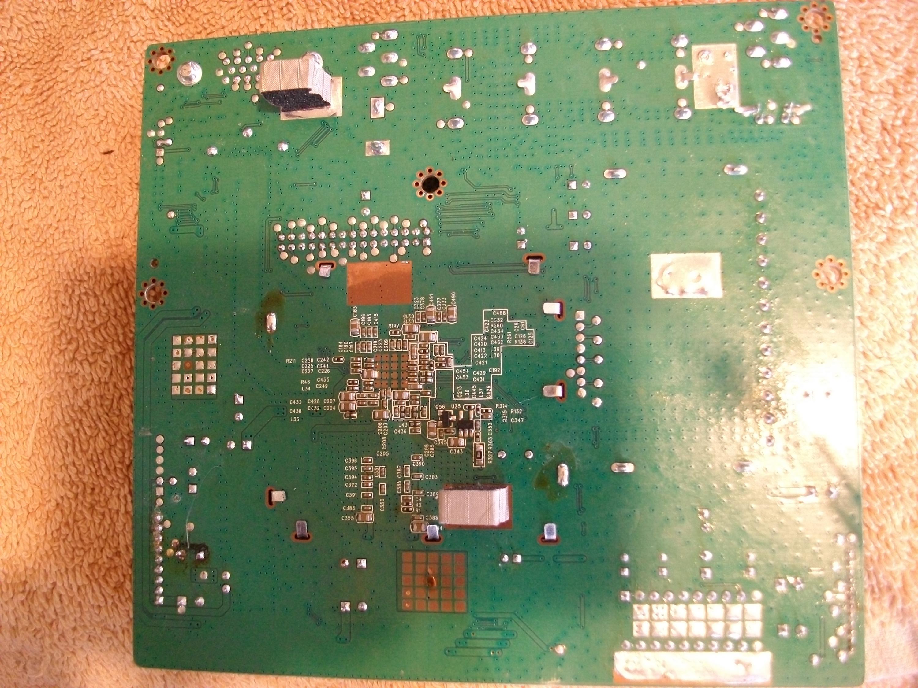

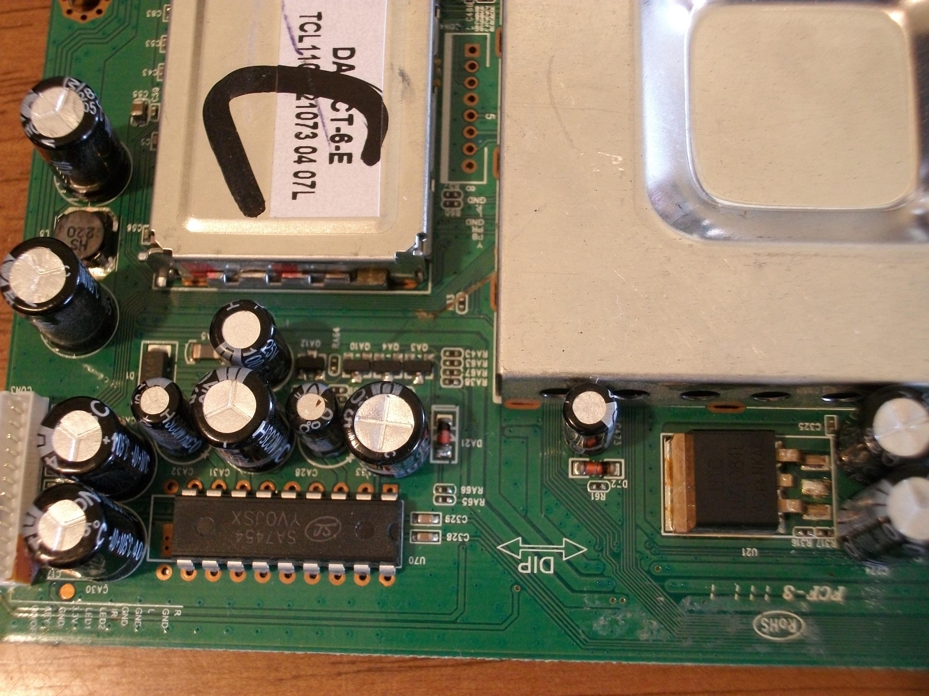

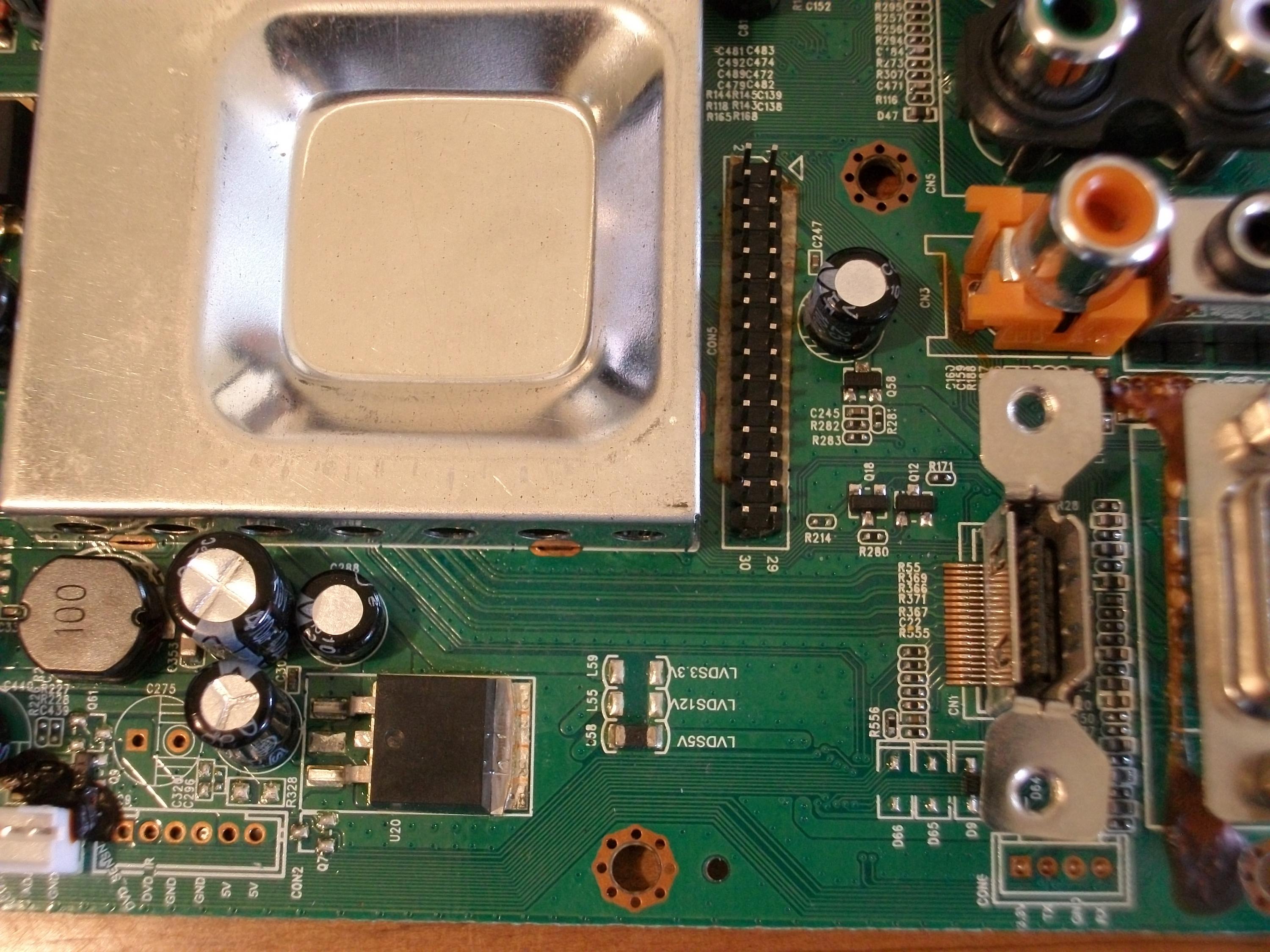

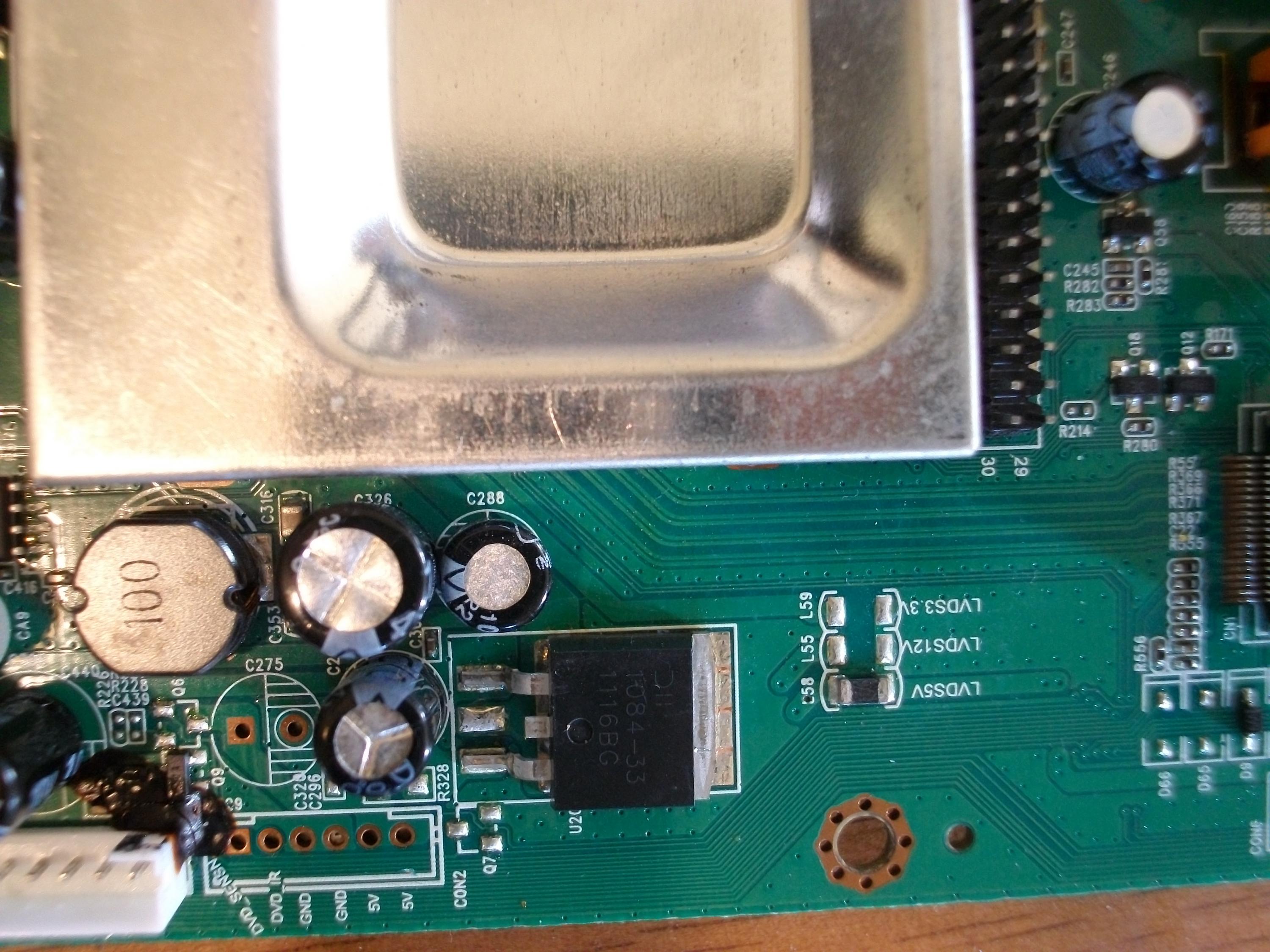

                      Ok - U20 is the 3.3 volt VR but what part numbers are the two on the back U3 and U4
                      Also in pic4 just above R29 there is a black spot between two traces - is it just debris?
                      can you remove it and check the traces are not bridged.
                        Part numbers
                        U3 3251 R64 11051
                        U4 ME 15N10
                        R29 was nothing just something on the board
                          U4 is a mosfet
                          https://cdn.badcaps-static.com/pdfs/...33c86bdf36.pdf
                          There is something before 3251 ? on U3 two letters?
                              Selldoor, tested U21 and U20
                              U21 Tab-1.2v, pin 1-3.3v, center pin- 3.308v, pin 2- 000.1v
                              U20 tab -3.206v, pin1-2.02v, center pin-3.201v, pin 2-5.14v
                                Ok so still 5v on that pin marked 3.3? Can you trace back from that pin to either of these
                                VRs
                                • CR Designs
                                  • Dec 2012
                                  • 430
                                  VRs
                                  Yes still 5v

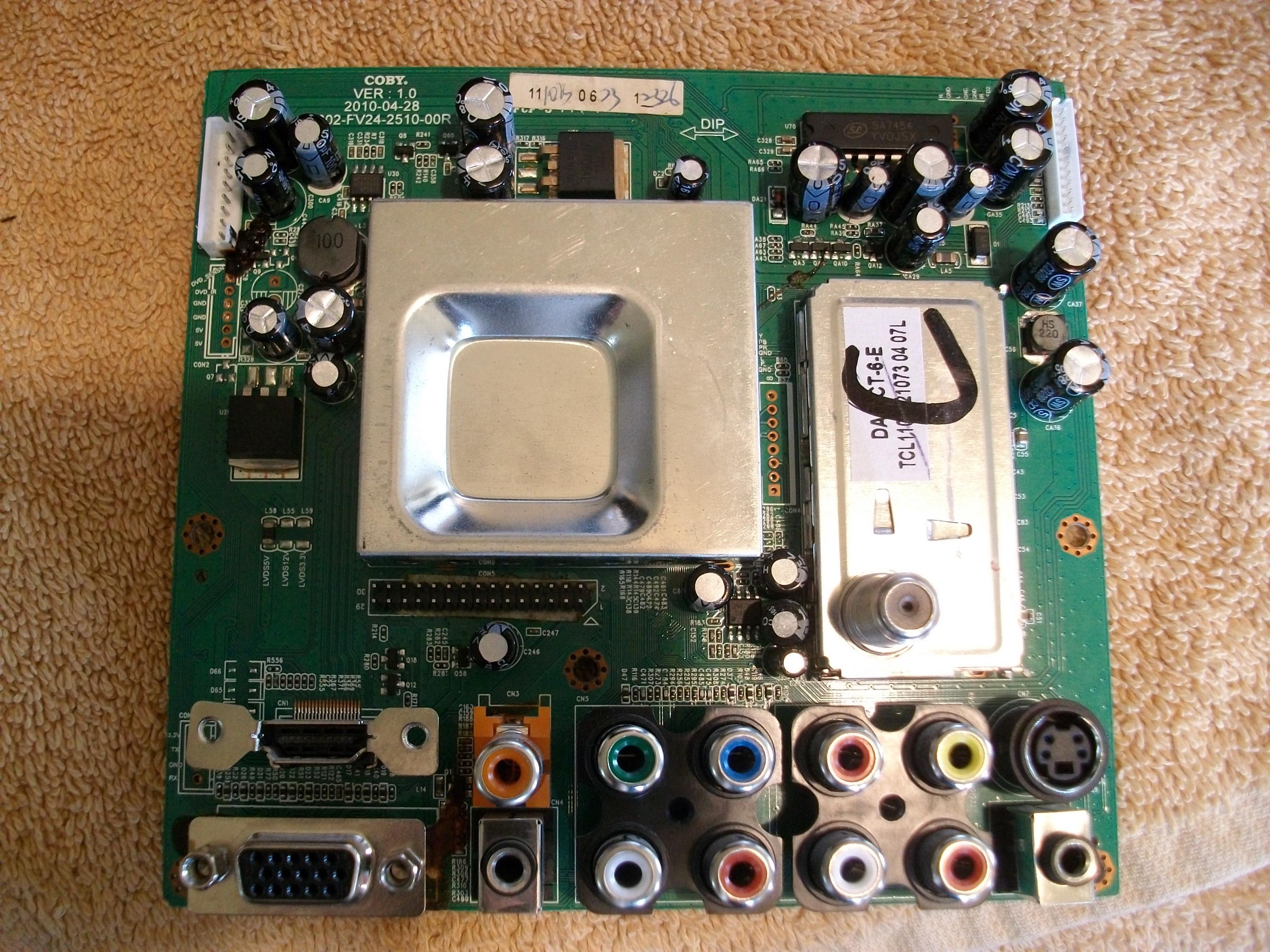

                                      Guys, here's more picture's I can't trace this board. May be these will help.
                                        Good news is, neither can we. This board will use at least 4 layers meaning two hidden between the top and bottom. More likely it will be 6 layers making it even harder.
