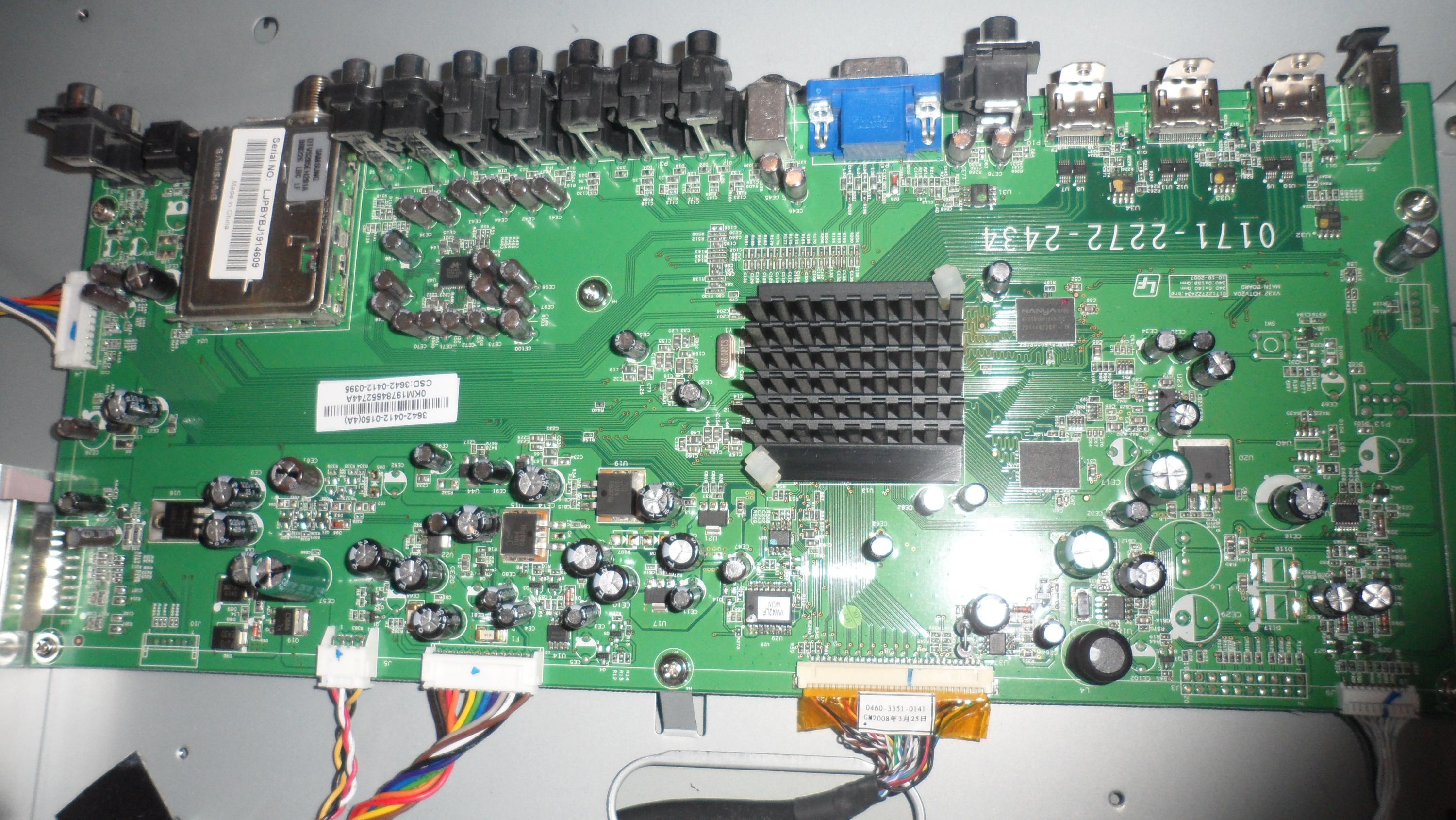

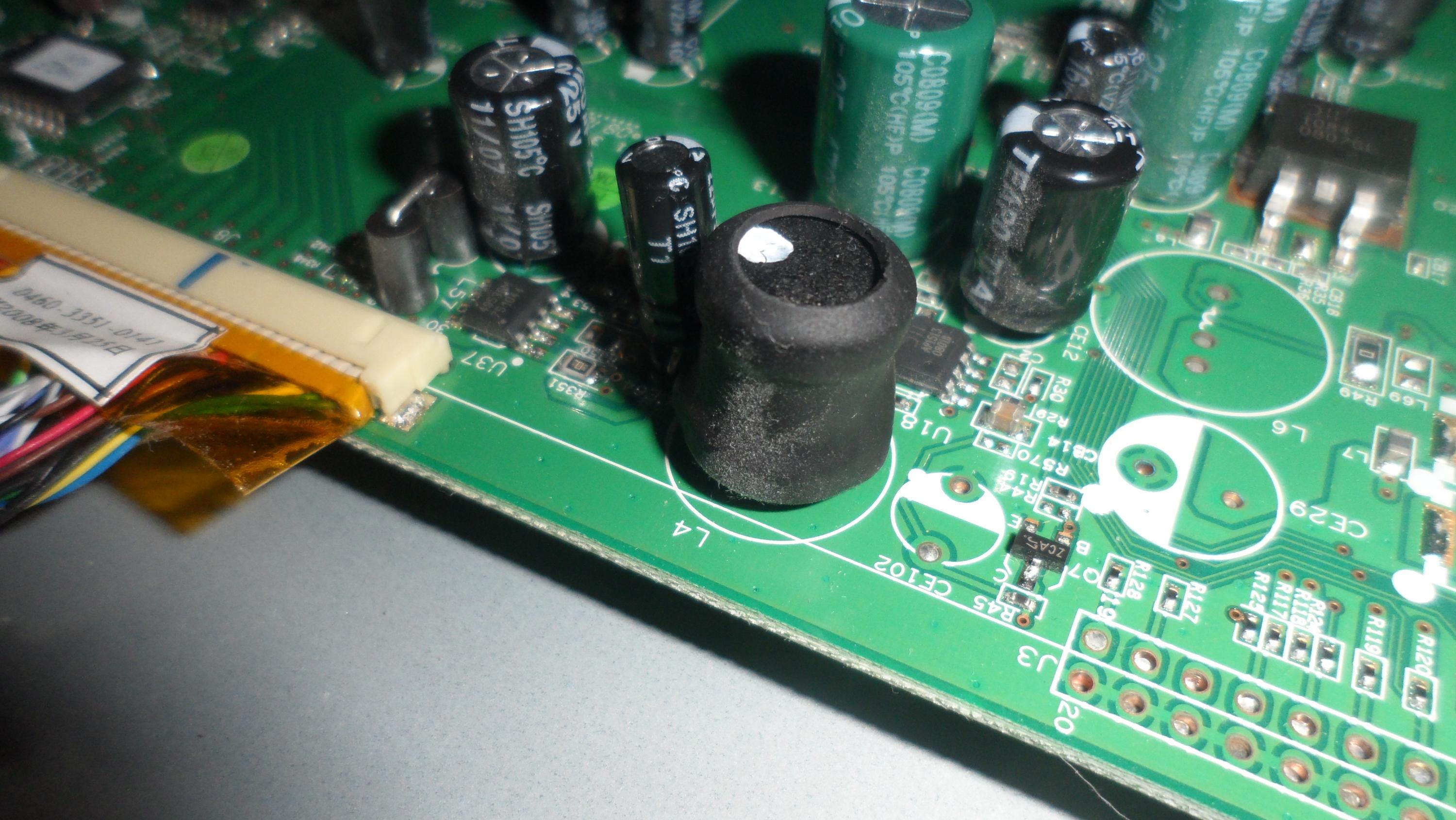

    I have a friends 42in vizio that i wanted to see if i can fix. His house got struck by lightning over the summer last year.
    I'm not good at the lingo or very knowledgable at this kinda of stuff but i like to tinker and am pretty handy with a soldering iron, but when it comes to testing with a voltmeter i'm clueless..
    Here's the jist of it with the back ripped off and all the boards exposed there are no signs of damage all the caps are flat on the top nothing burnt or melted on any of the boards.
    With the back off and tv pluged in only visable thing working is the vizio logo is orange when i hit the power button on the remote it turns white.. if i hit the power button again it goes back to orange etc... that's it nothing else is working.
    I'm looking to just replace a whole board i'm thinking the main power board but what do i know, looking for suggestions if you had to gamble with this very little info i provided you..what would you suspect to be the culprit???
    Thanks in advance...
    Re: vw42lfhdtv10a hit by lighting only logo works
    Can you supply some pictures? Then we can highlight areas to test.

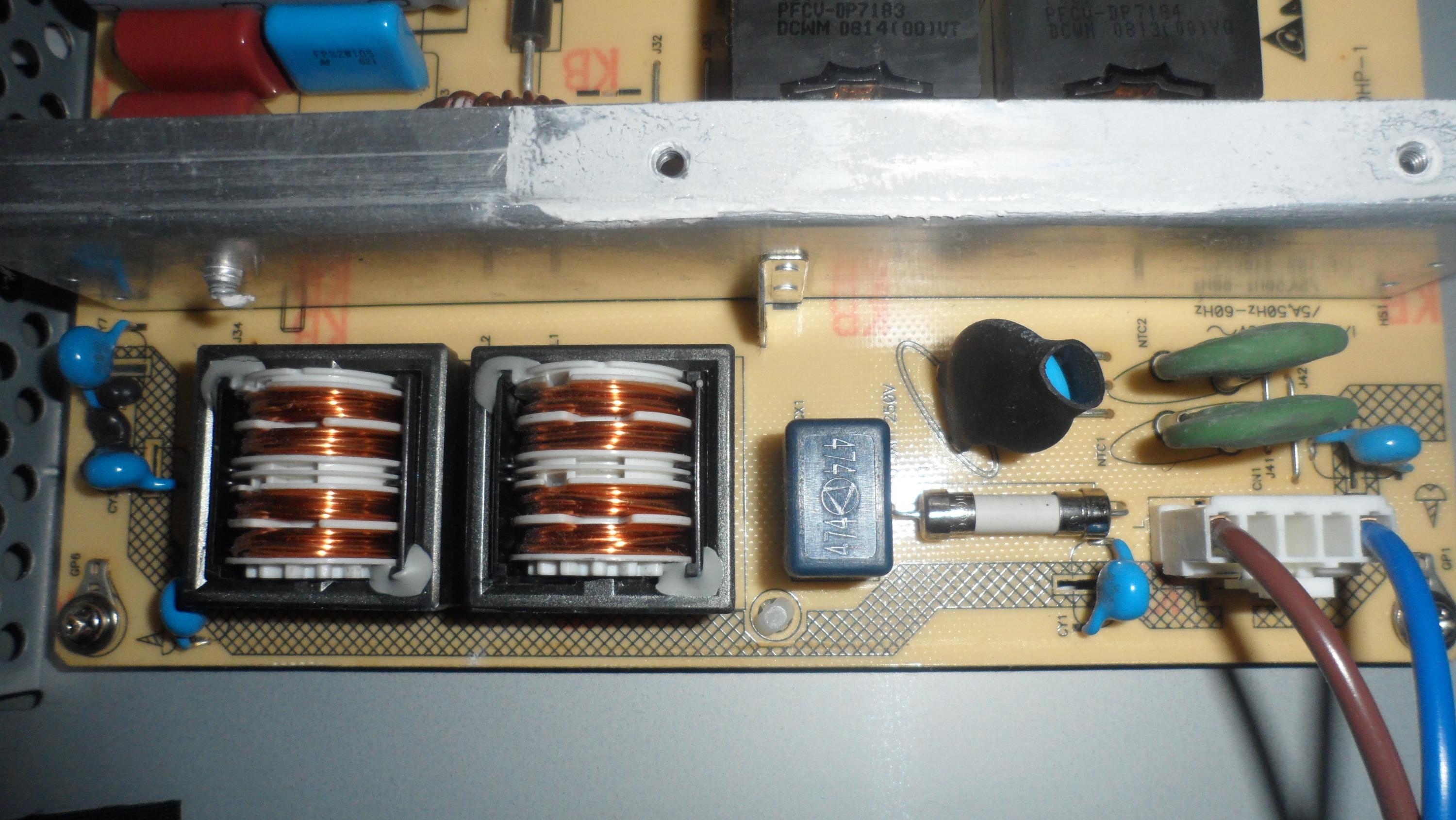

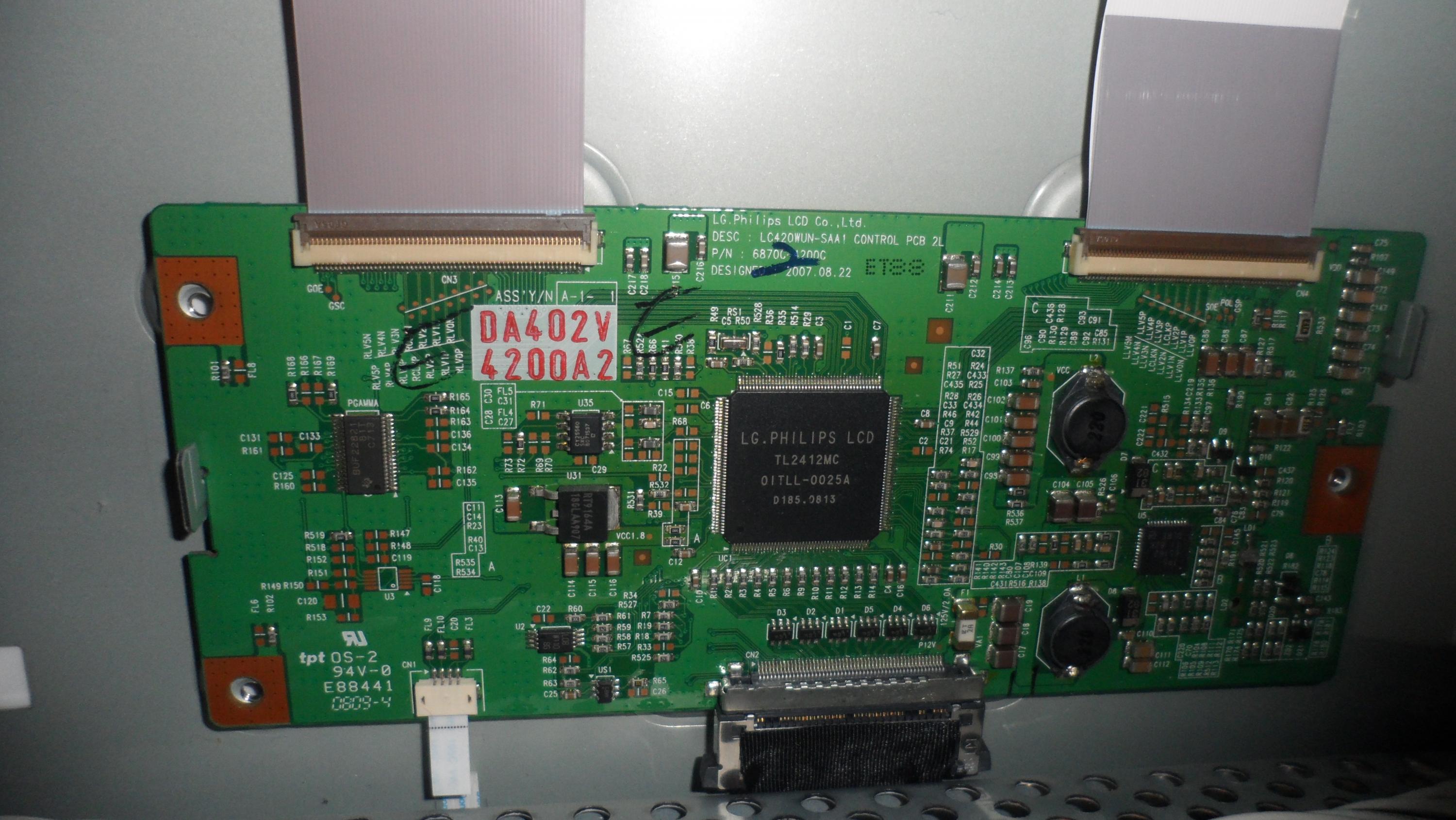

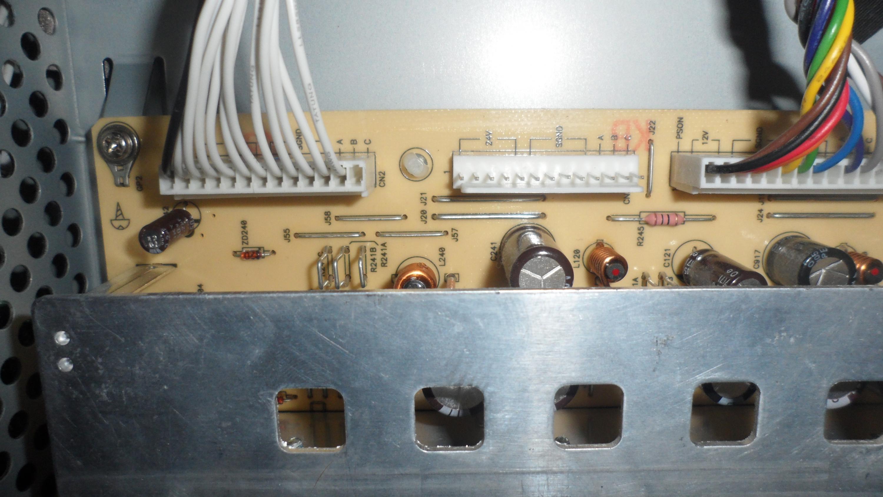

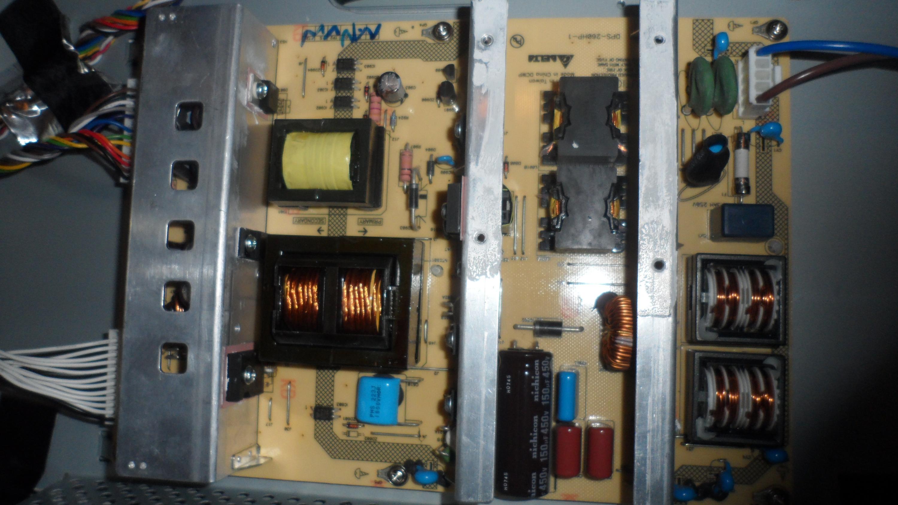

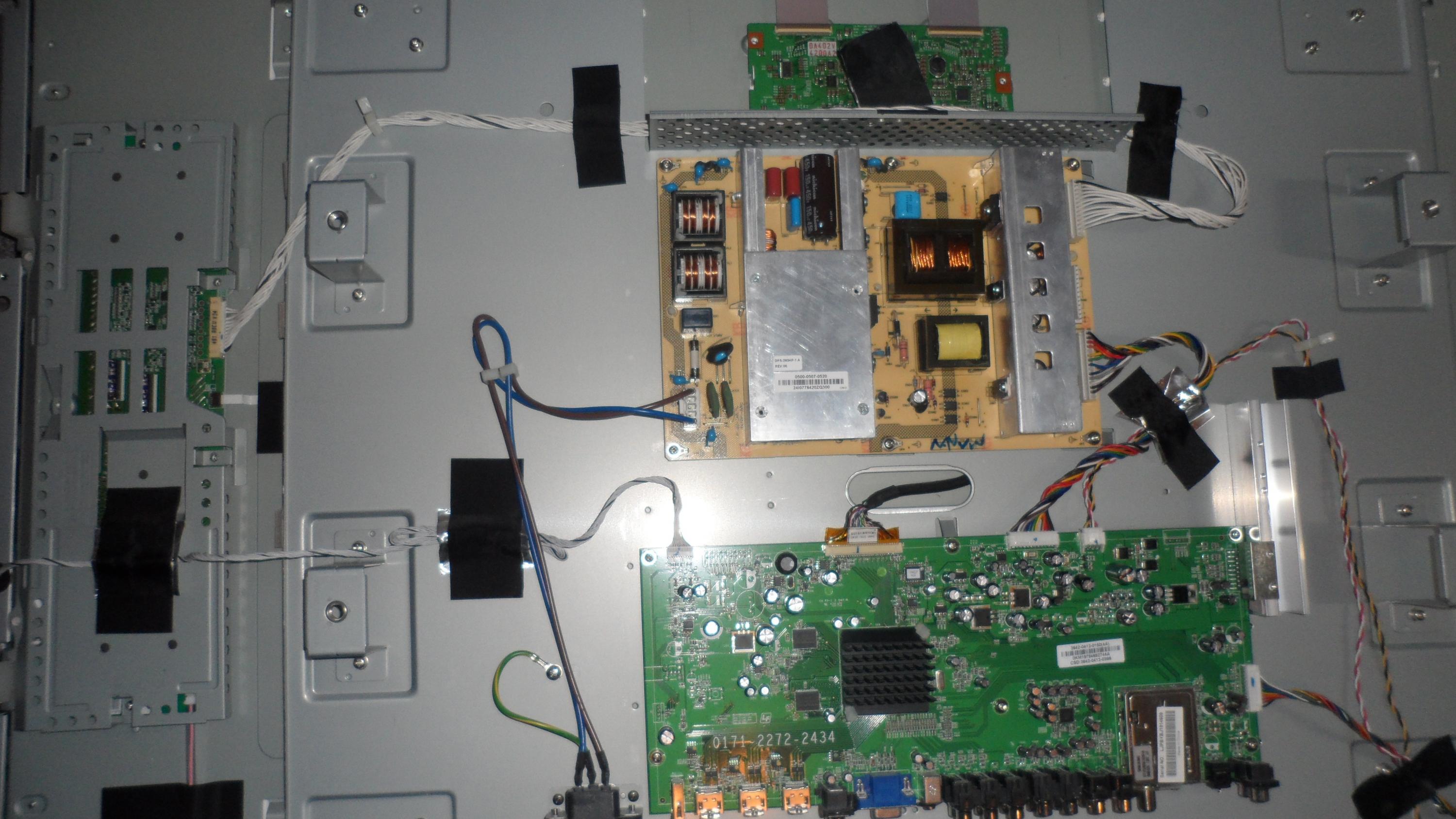

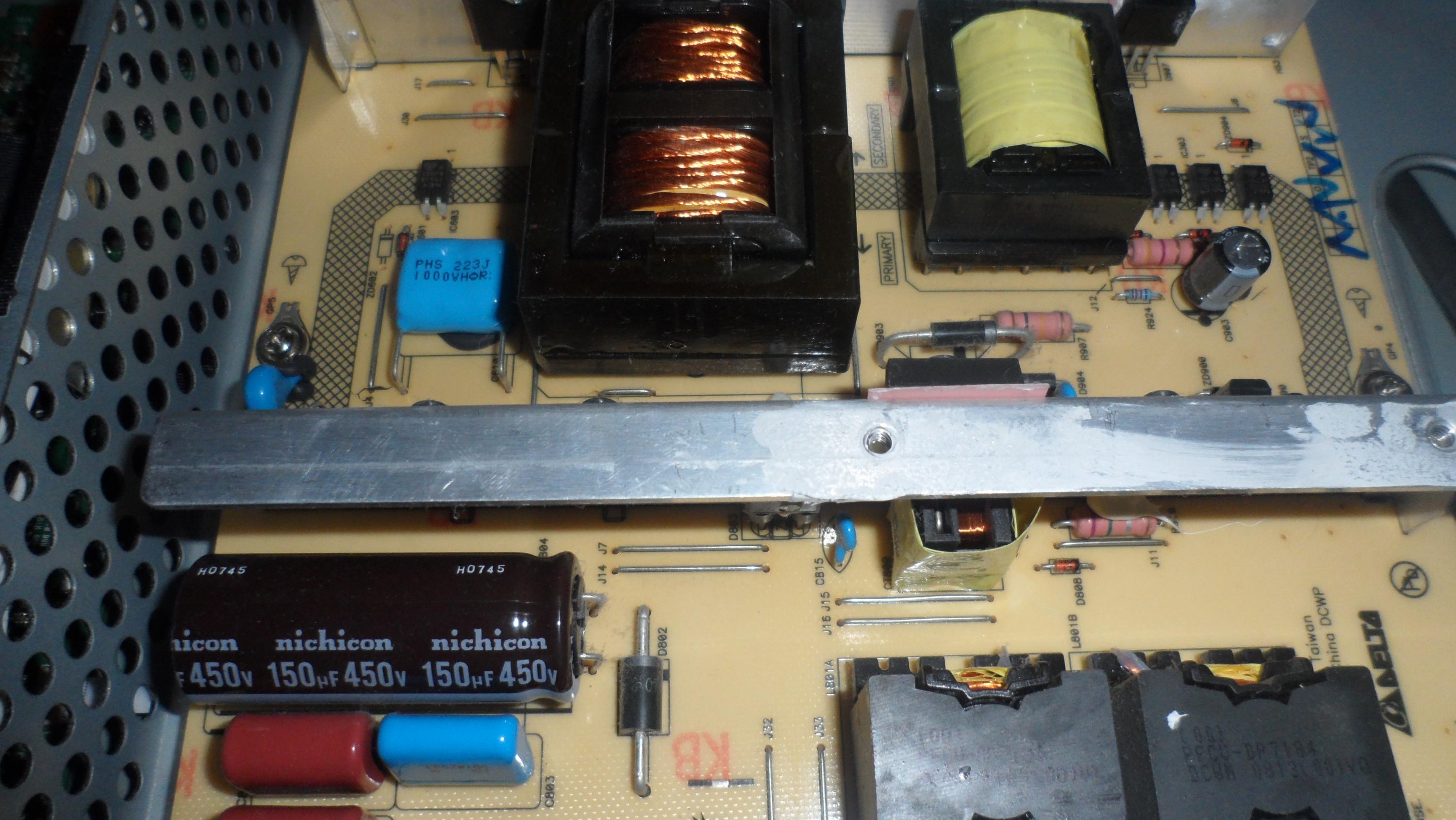

        here's some pics hopefully they are enough if not tonight when i get home from work i can put up more.
        the last picture was the only cap that i thought looked buldged but after looking at the picture must be just the lining around it.

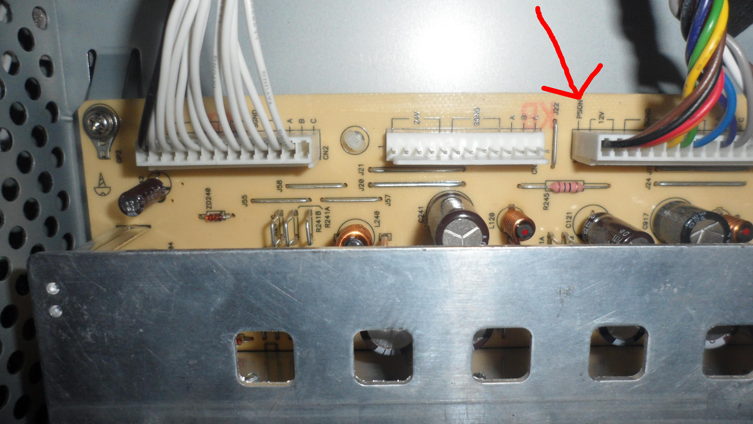

          OK, right now the 5V stanby power supply is working and the main board does response to the power switch.
          Please check the DC voltage on the PS_ON pin of the power supply when the logo is orange and when it turns white (TV power on), Black probe to the chassis for the secondary side ground ref point.

              It'll be on the connections between the main board (has video inputs like HDMI) and the power board.

                See attached image for PSON location.

                  You'll first want to do as Budm said, and test PSON voltage. Put the black lead to the chassis or one of the screws that hold the board down and the red on PSON. Have the TV off and then monitor the voltage while you turn the TV on.
                  You should see over 3 volts. If you do, then proceed to test all other pins on those connectors. Report your findings here.

                      sorry it took so long to check out things, but my brand new voltmeter didn't work so I gad to purchase another one...heres my results :
                      unit in standby
                      3 wirers have voltage (all read 5.19v) the white grey and purple which are labeled "5vsb" on the board
                      unit turned on "white logo"
                      black wirer that reads "pson" gives me a 3.17v reading
                      and the same for the 3 wirers in standby mode (5.19v)
                      and then on the board where it says ABC I get a 5.03v reading from the brown or (b) wirer and a 2.77v reading from the black or (a) wirer...the c is blank... and all the wirers in between are 0.00 or darn close some are like 00.2etc... so basically the 12v and sgnd part of the board isn't working..
                      so is my power board shot?
                      thanks..
                        Your PS_ON is OK, so the power supply board does have problem. No way to tell if the main board is fully function until you get the power supply board fixed or get another one first.
                        Lighting can destroy lots of stuff.
                        The A,B,C are from the the main board for the BL_ON, Dim, PWM DIM, not in that order, those signals are just passing through the power supply board for cleaner wiring.
