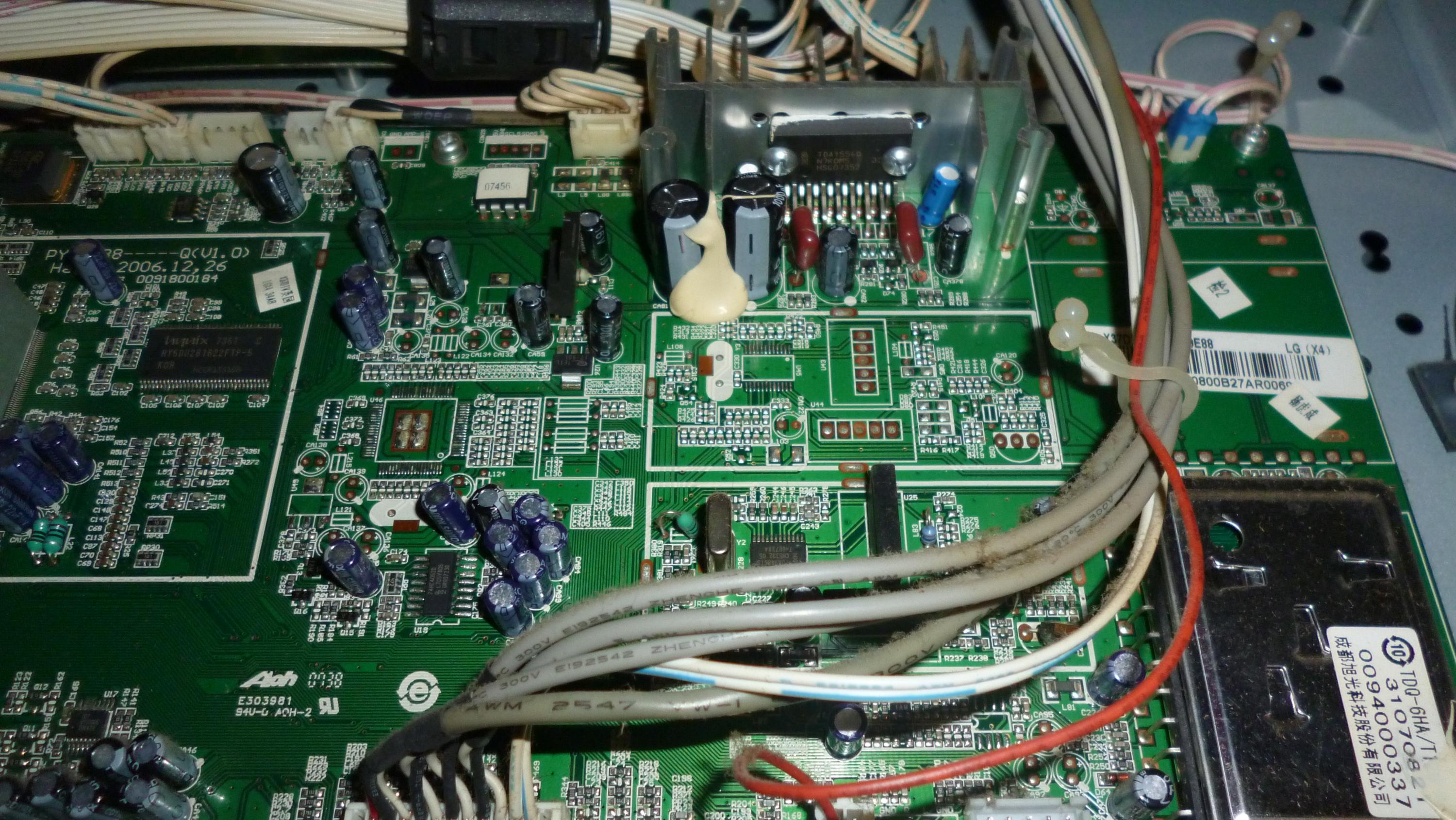

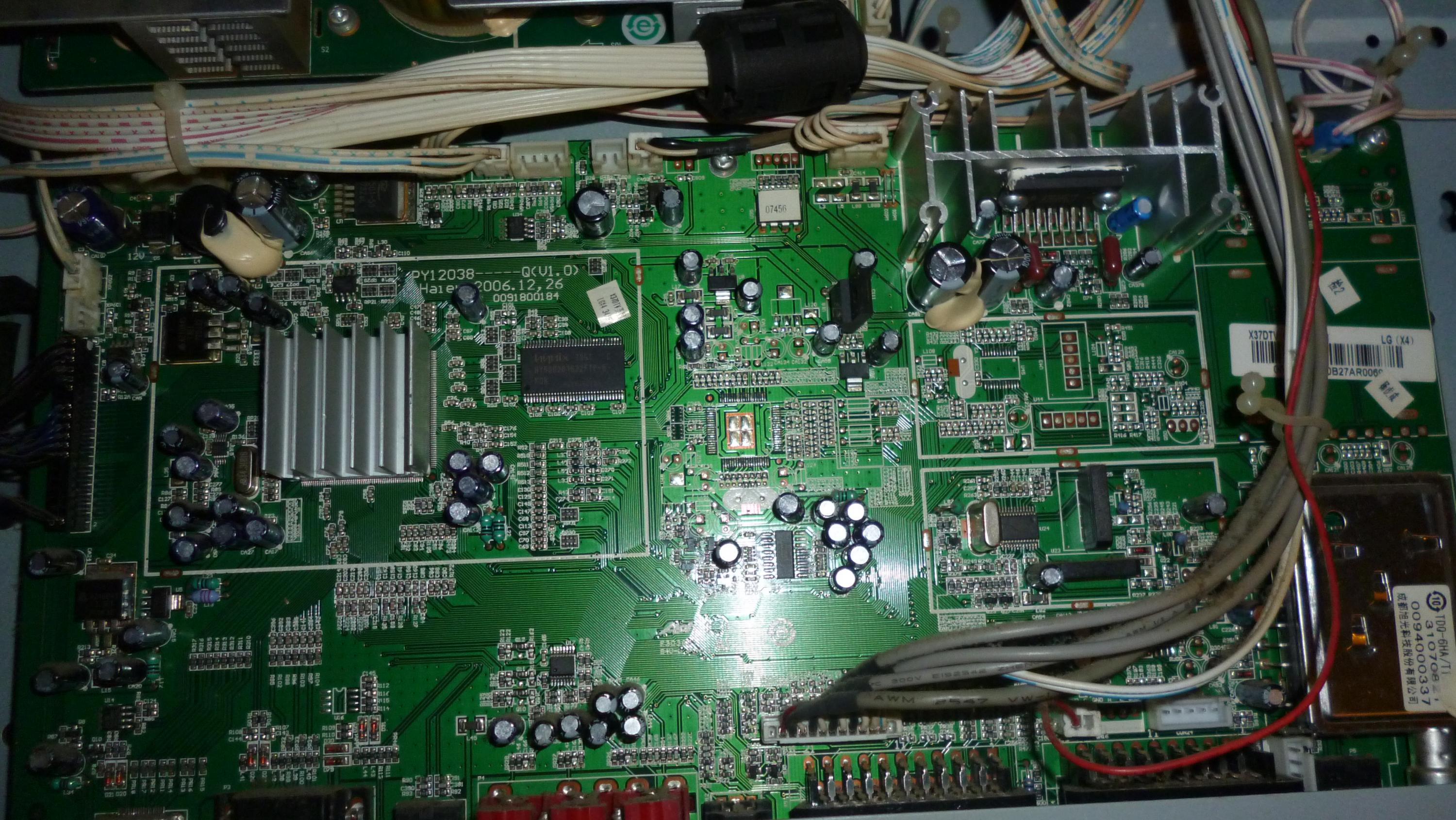

    hi guys im a newbie on this, had luck of repairing tvs up till my last recent few tvs... this one is a Baird X37DTV (rather sh*t make) but prefer it not going to the Dump like i see so many people do. the problem is when tv is switched on itjust flashes like a strobe, tried changing the invertor to the exact same one and has not fixed the problem, changed a Bulging cap on the poer board, still didnt do the trick > any ideas guys ??
    Re: Baird X37DTV stobe Backlight issue
    Primary capacitor can often fail on PSU which can cause rapid strobing.

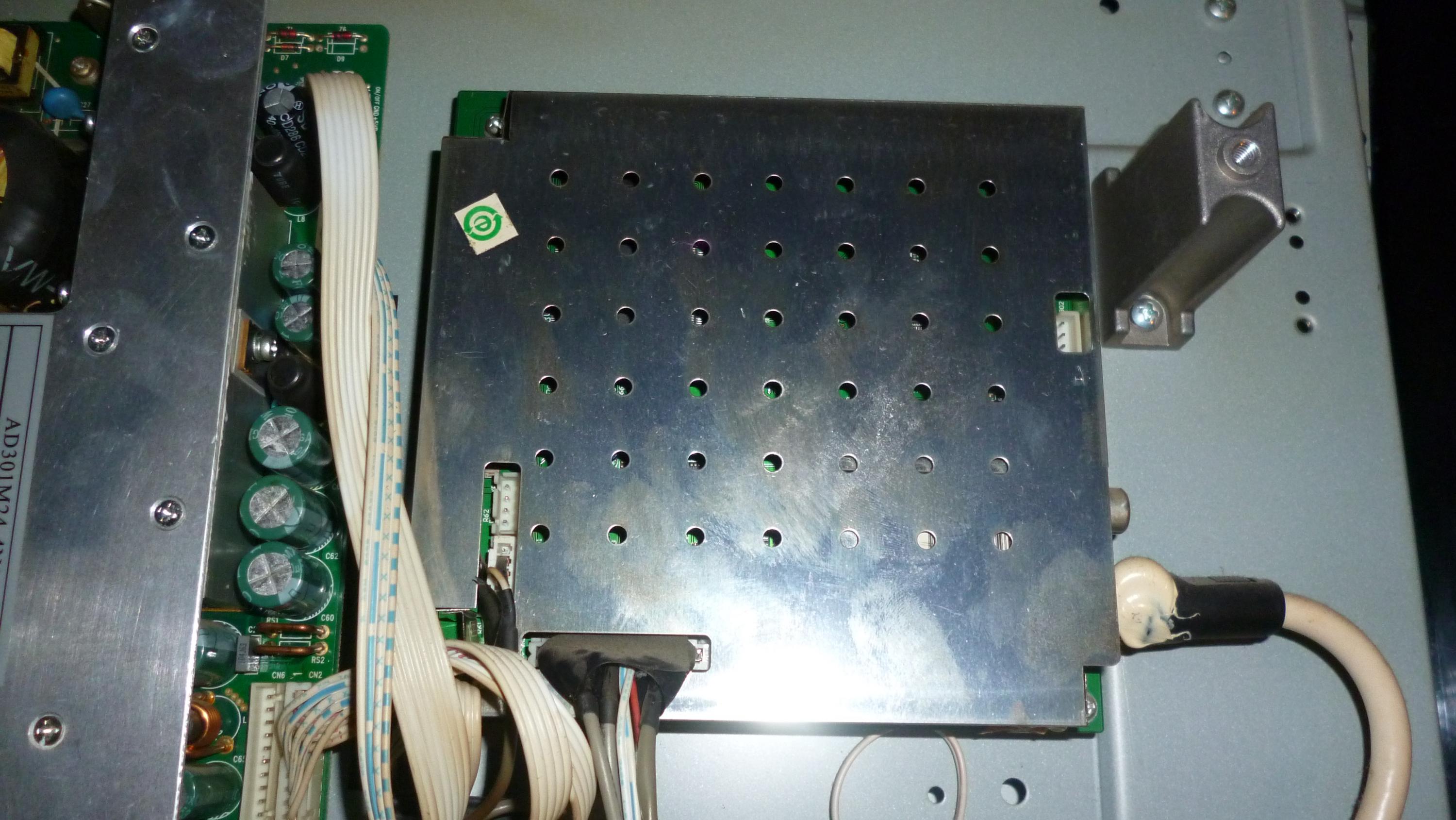

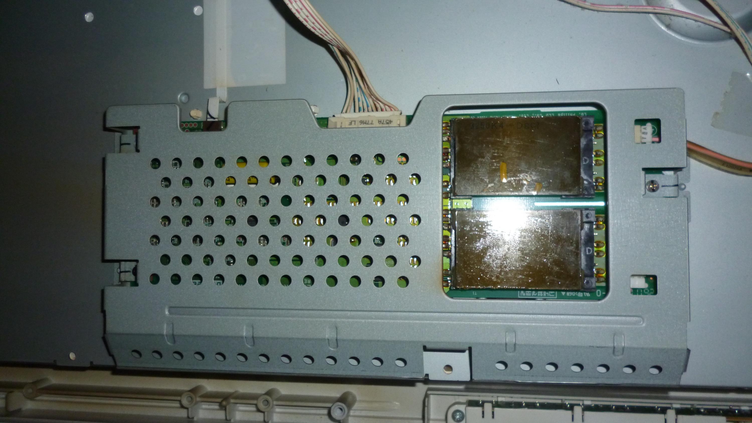

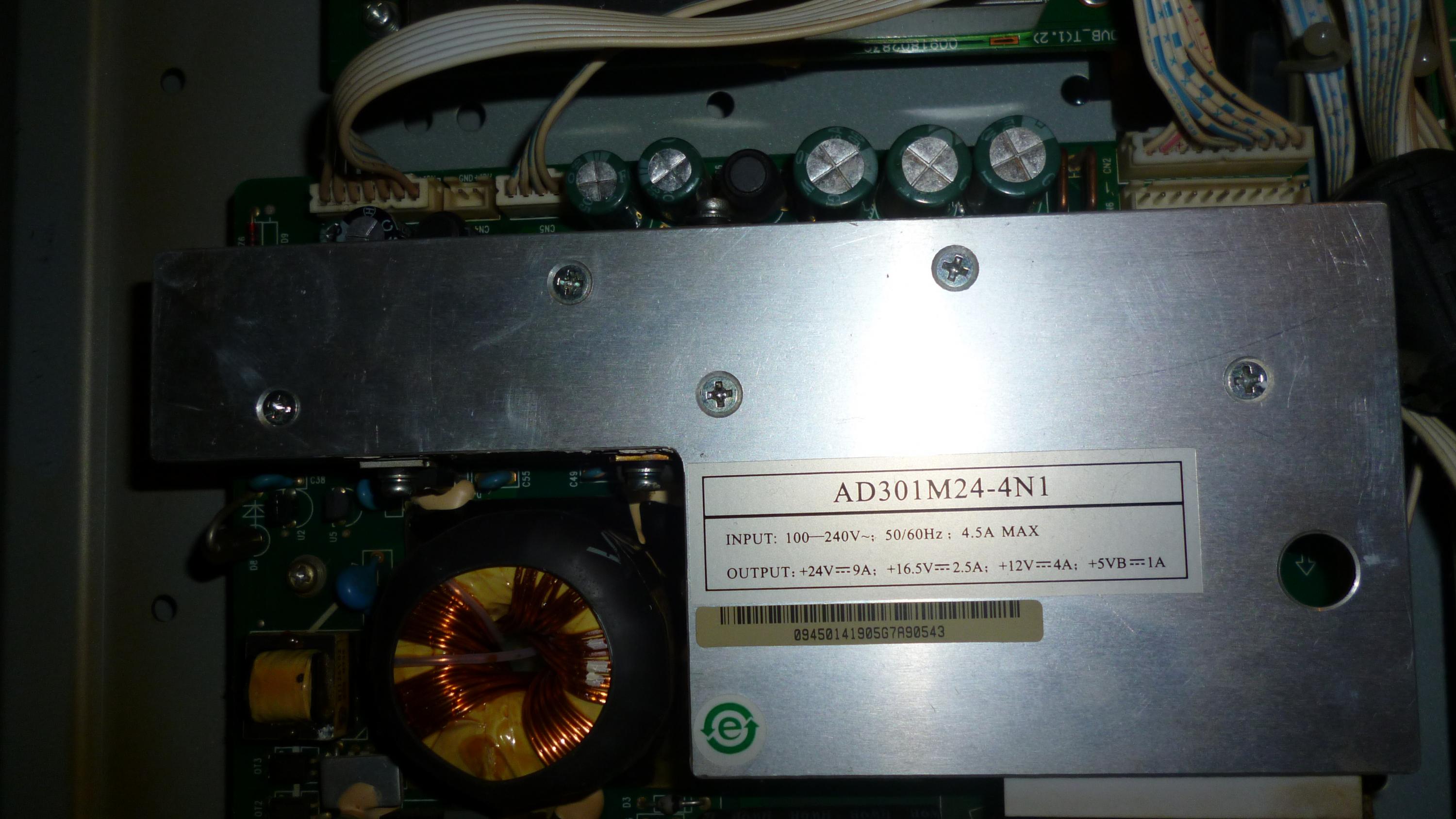

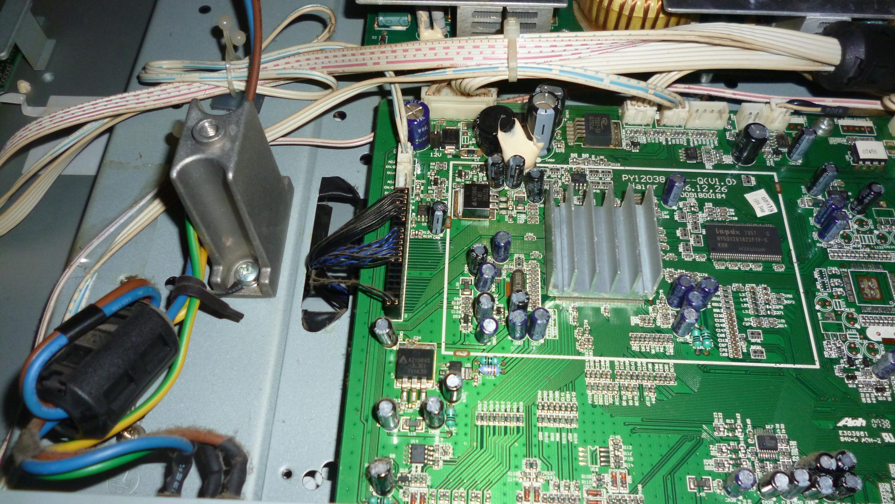

    How about pictures of the boards?
      ok give me 5 minutes i will pop open the tv and take some pictures.
        hope this helps mate

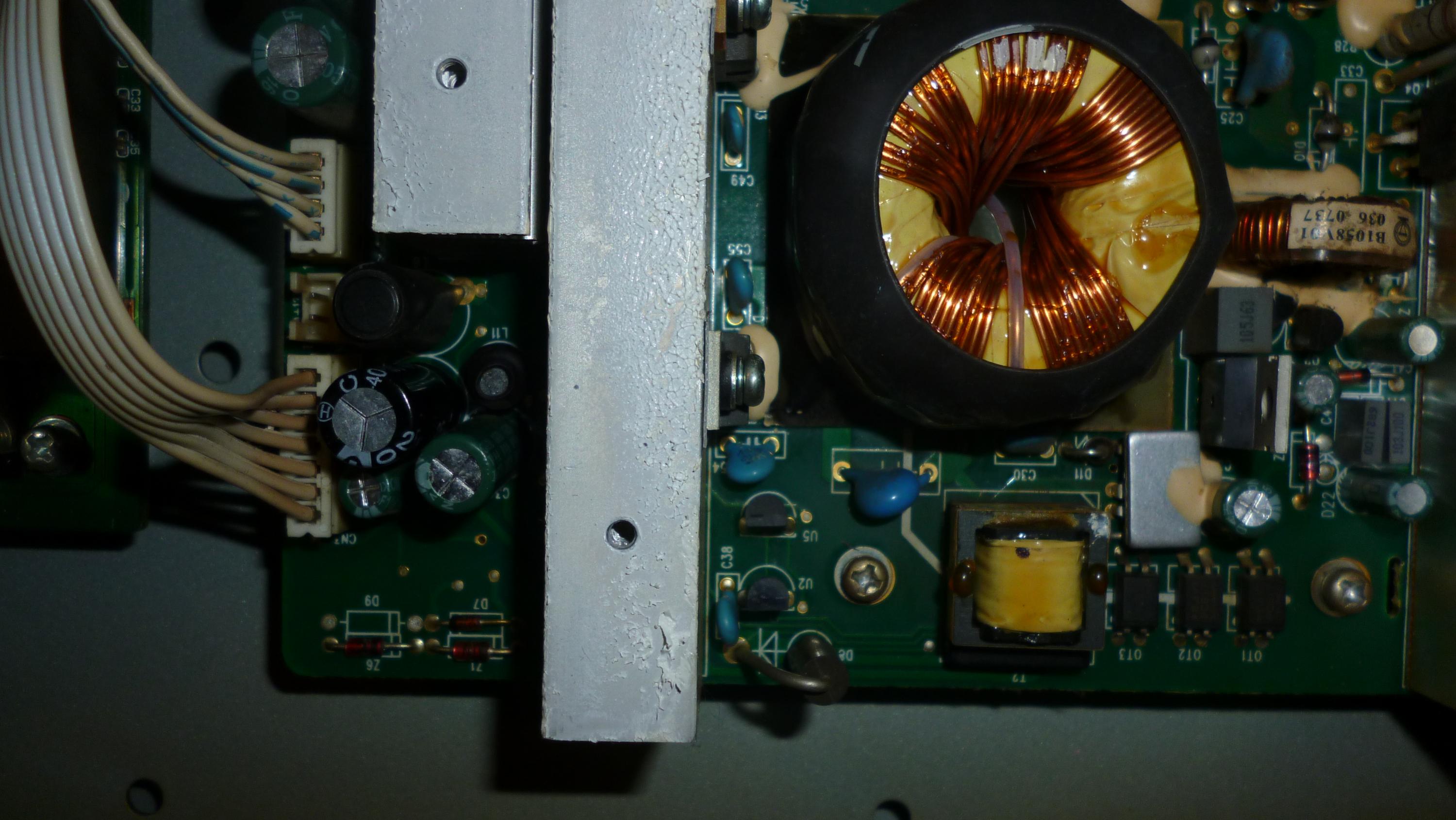

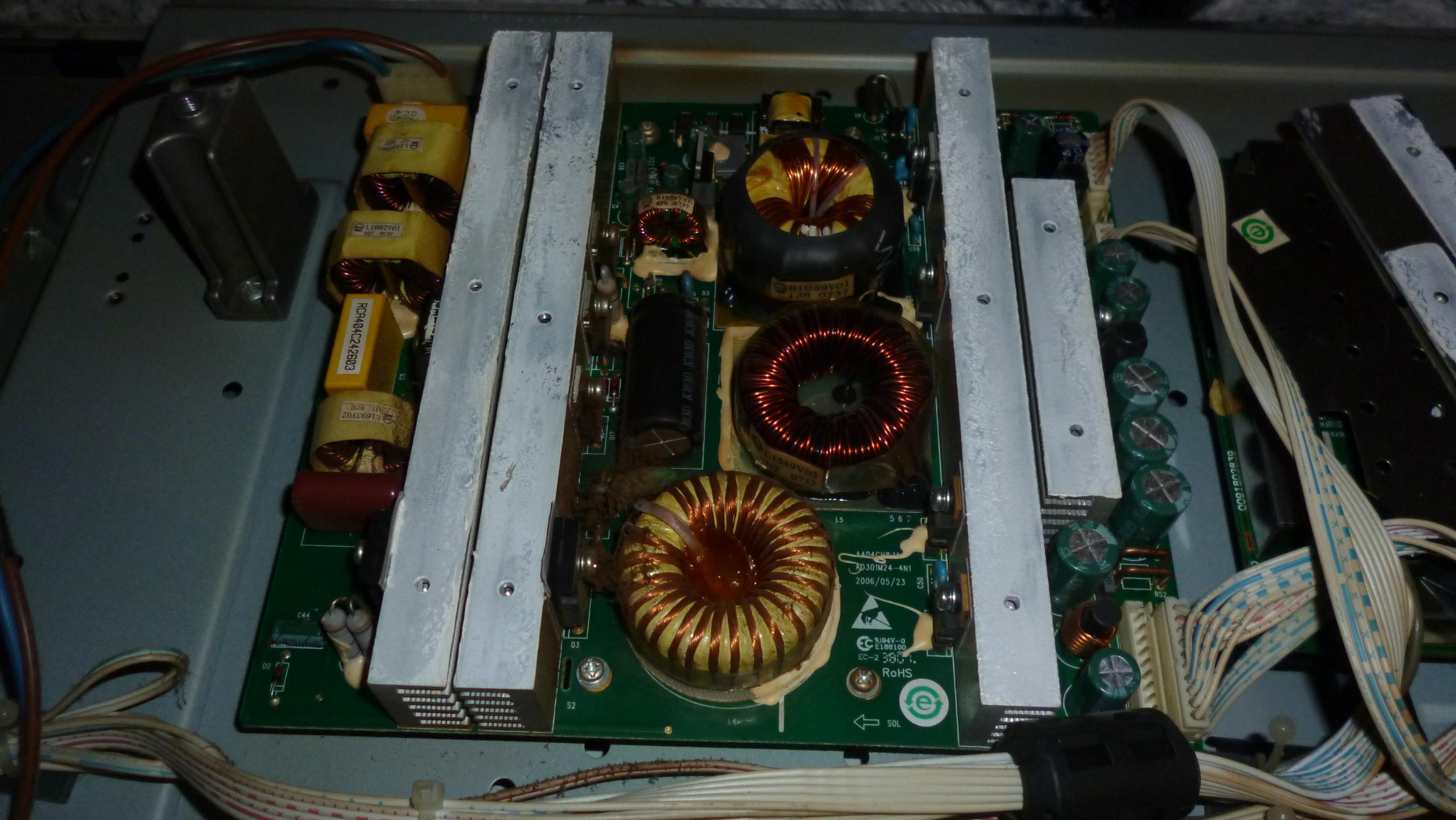

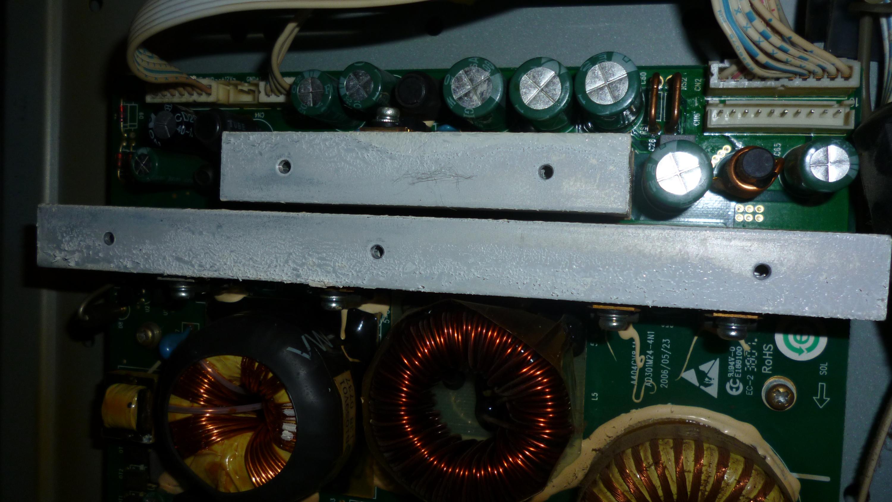

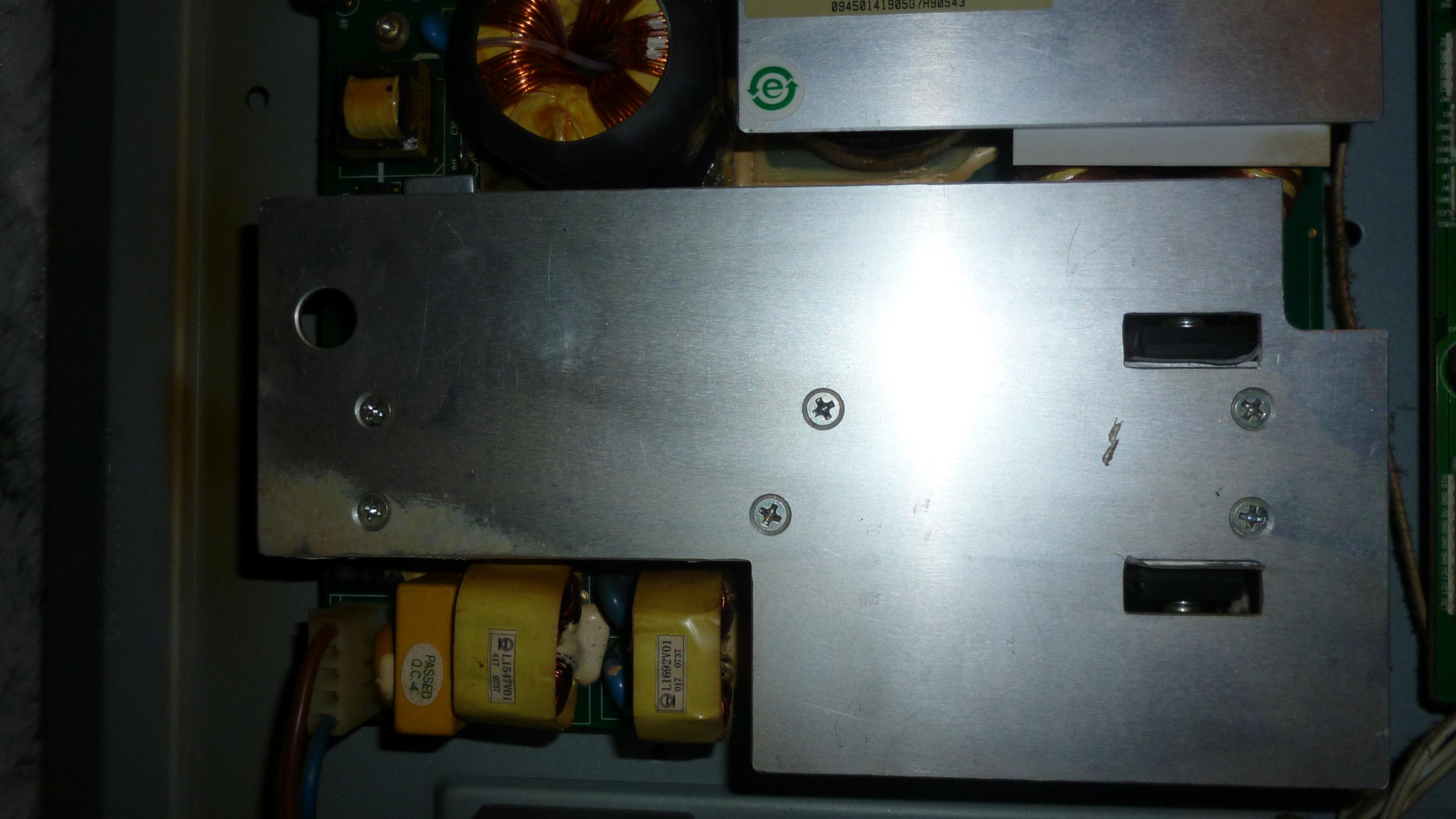

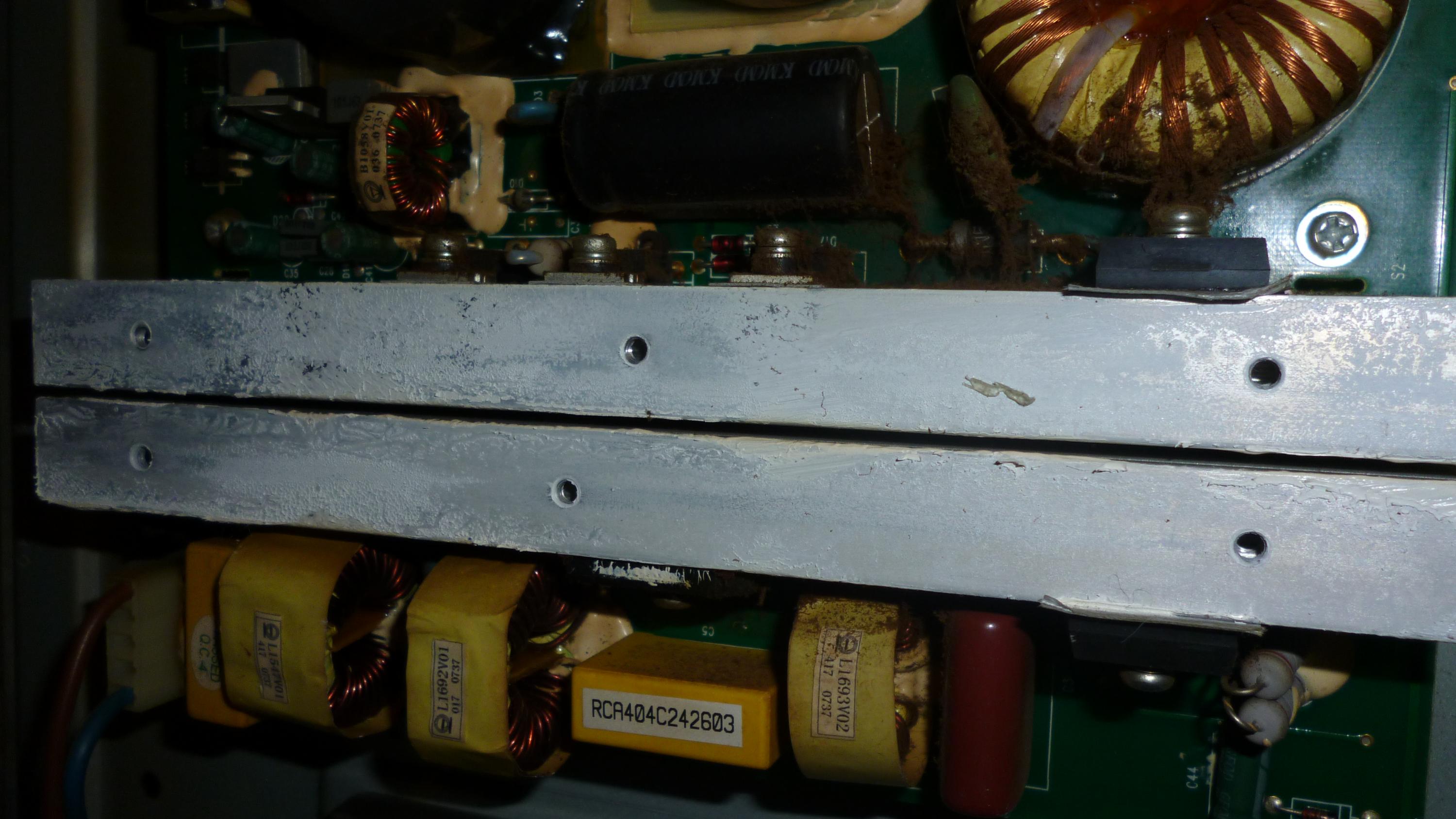

          Can you remove the metal shields on the power supply so we can see underneath them?
            yeah mate no problem, couple of minutes cheers

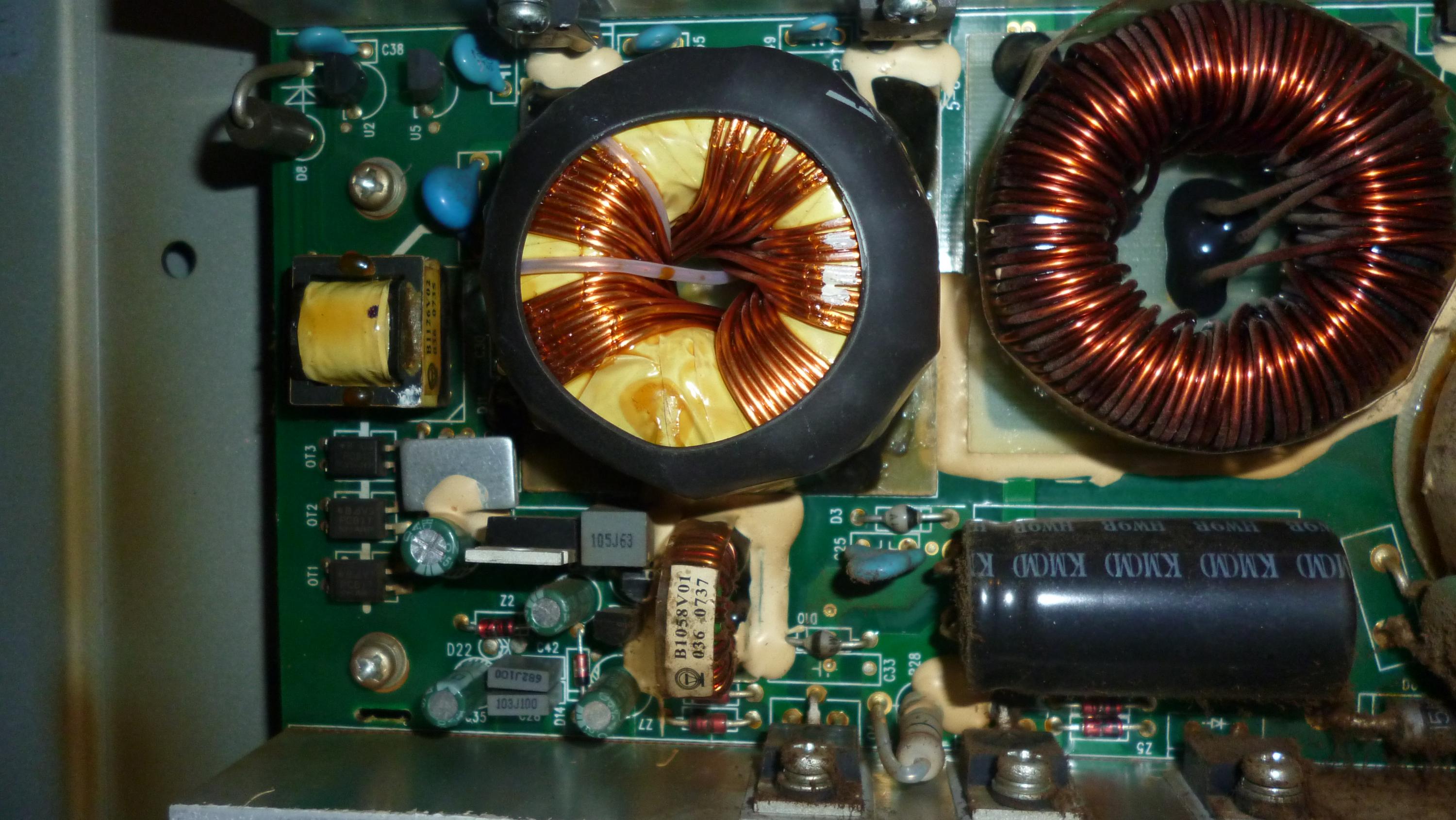

              hope these help. think thats thermal paste that was bonding the metal sheets to the top of PSU components

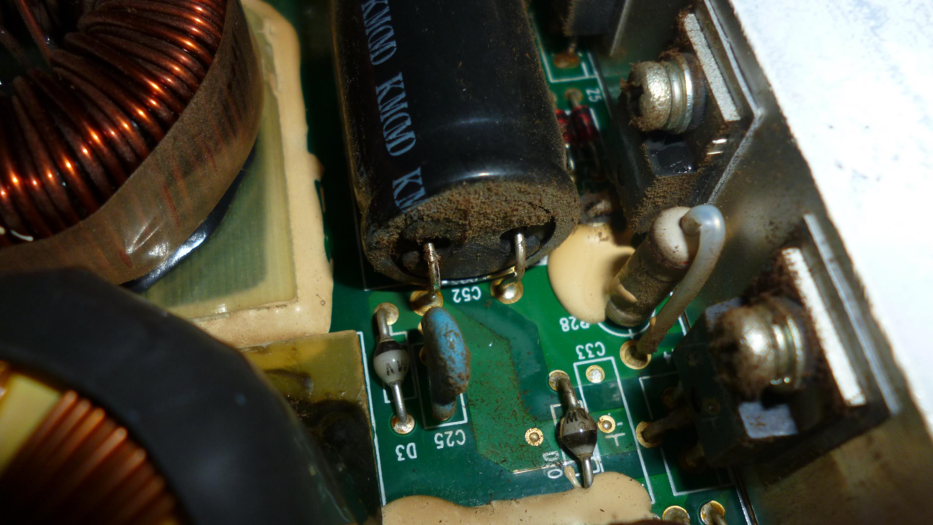

                It looks like the end of that large capacitor has one lead pushed out, which indicates it is failed.
                  can i repair ?
                    It can be replaced. Can you get a picture facing the leads?
                      by leads do you mean the two metal bits going into the Cap ? sorry if im wrong, bit new to all this, susualy just replace boards but getting too expensive, thanks for all your help mate
                        Yep, those are the leads.
                          sorry about all the dust, need to get it all cleaned.
                            Huh. I thought I saw the lead bulging out. I don't know if it is faulty. How often does it flicker? i.e. 10 times a second, one a second, etc...

                                  OK, in which case, do you have a hairdryer?
                                  Heat up the capacitor we have discussed previously. See if it begins to stop flickering.
