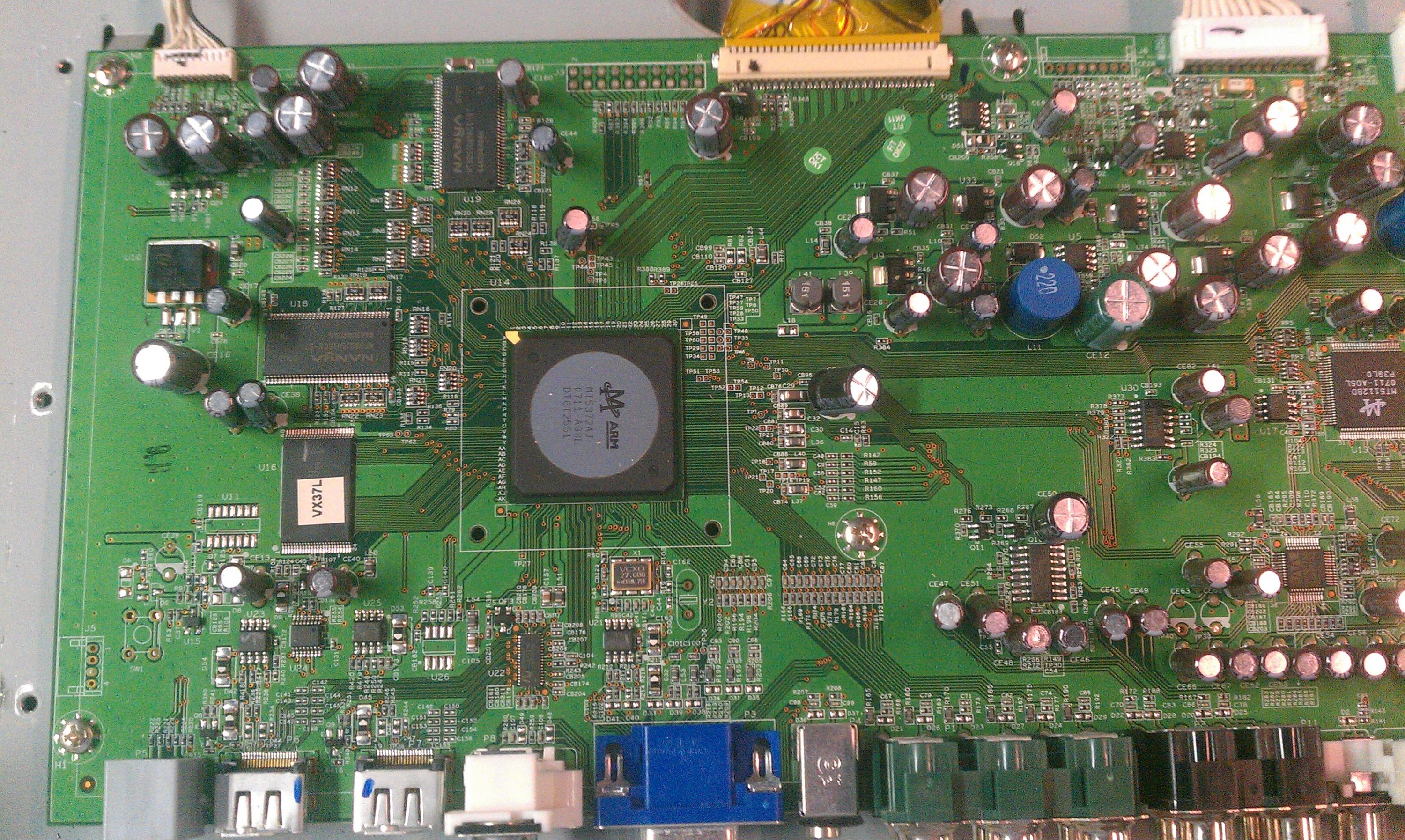

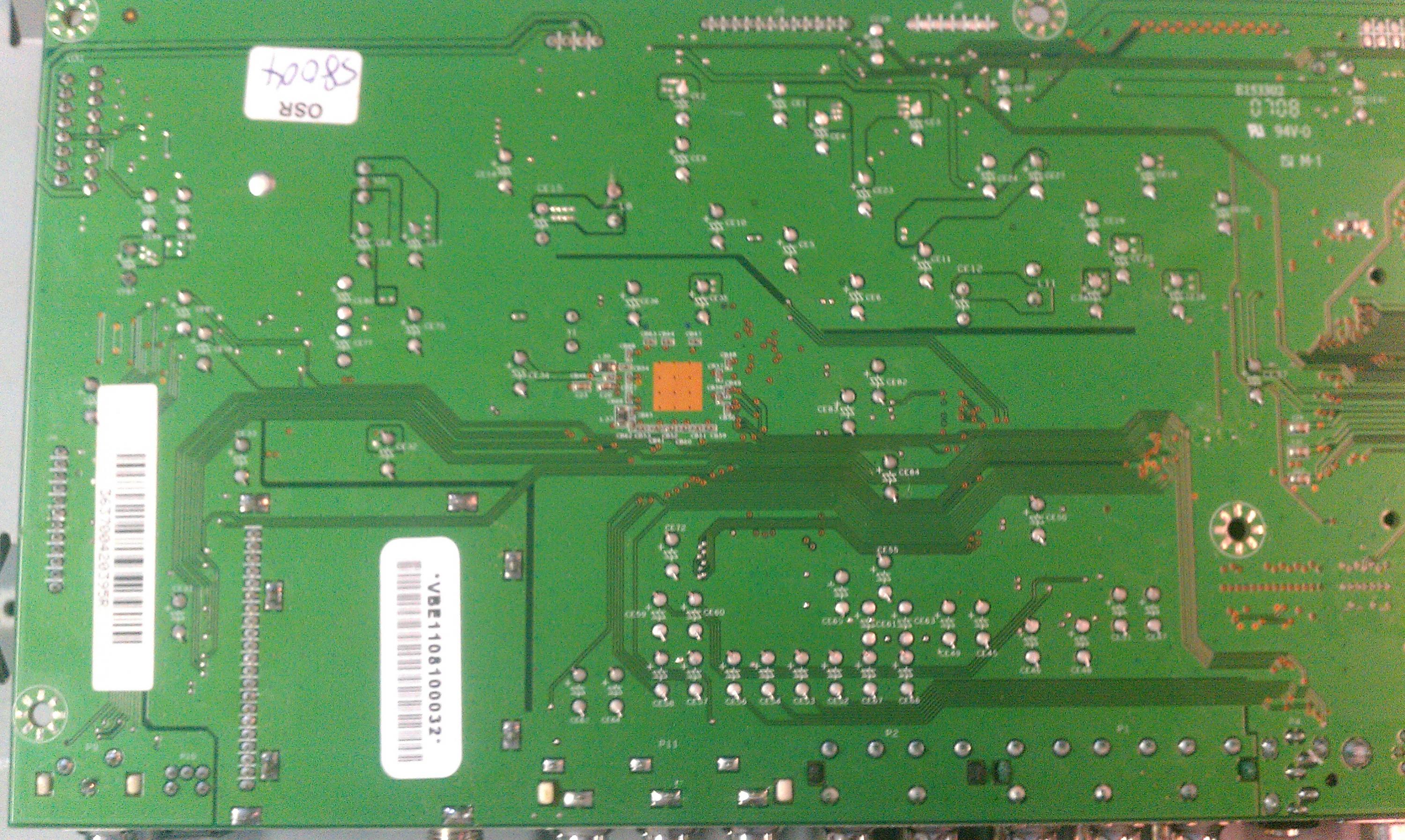

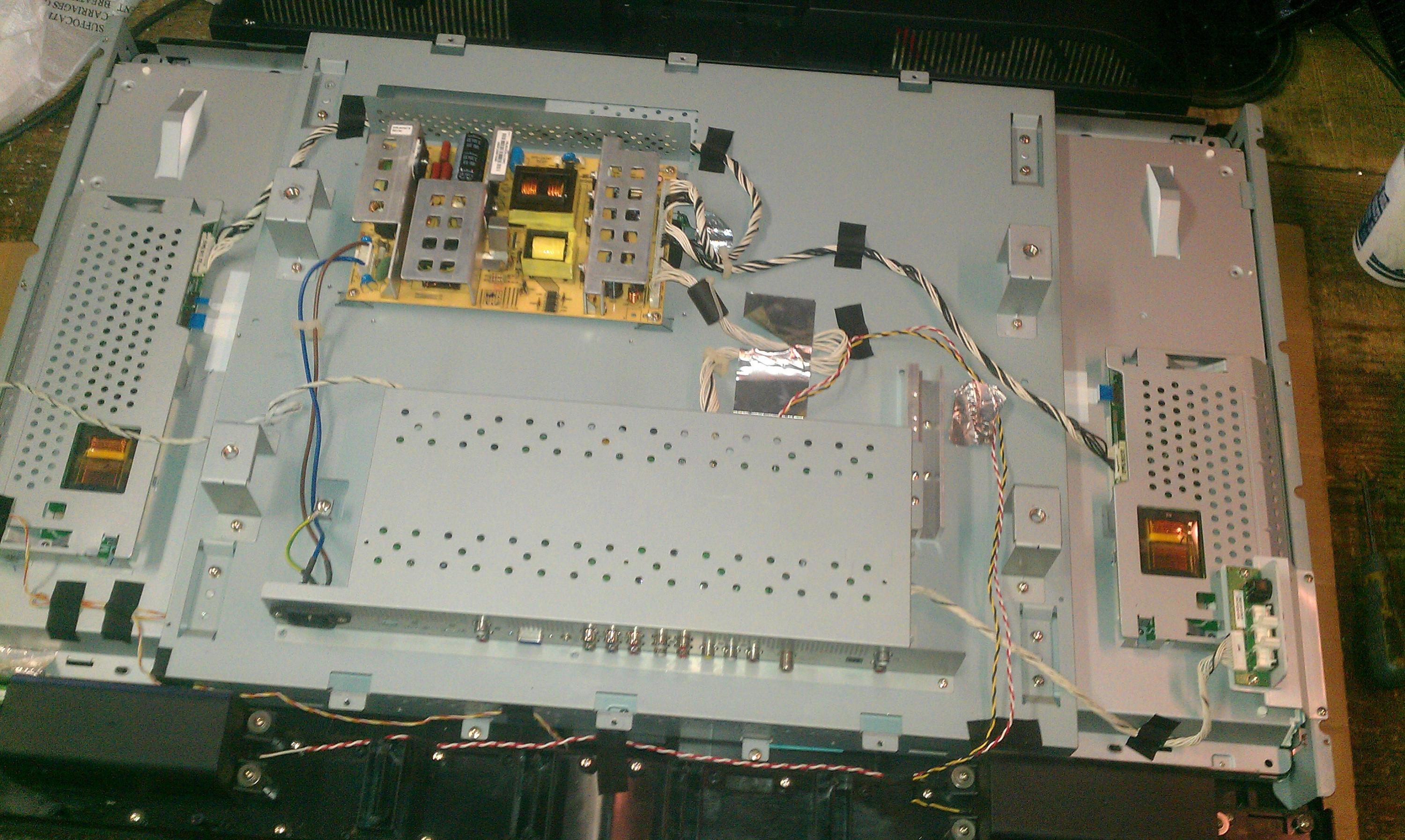

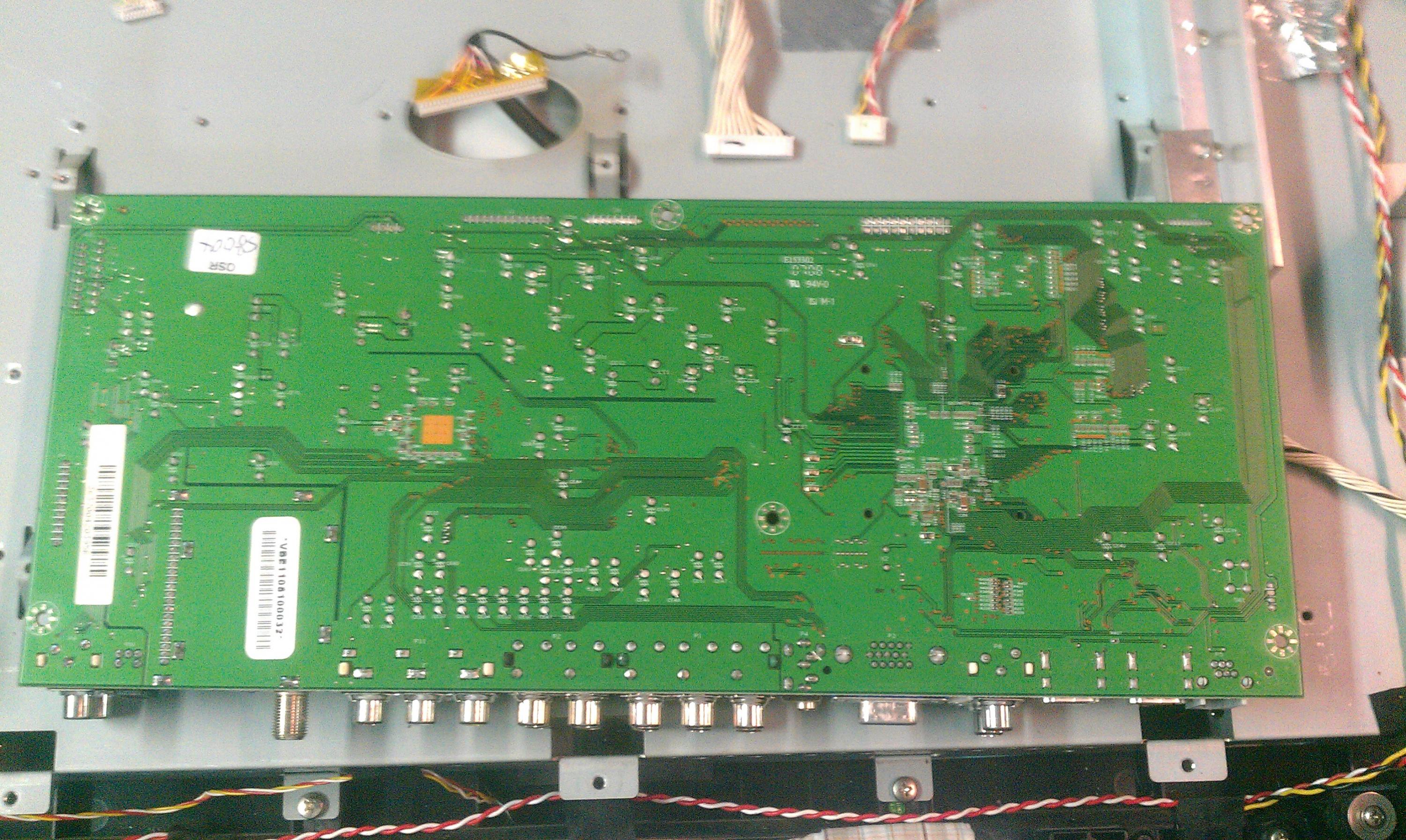

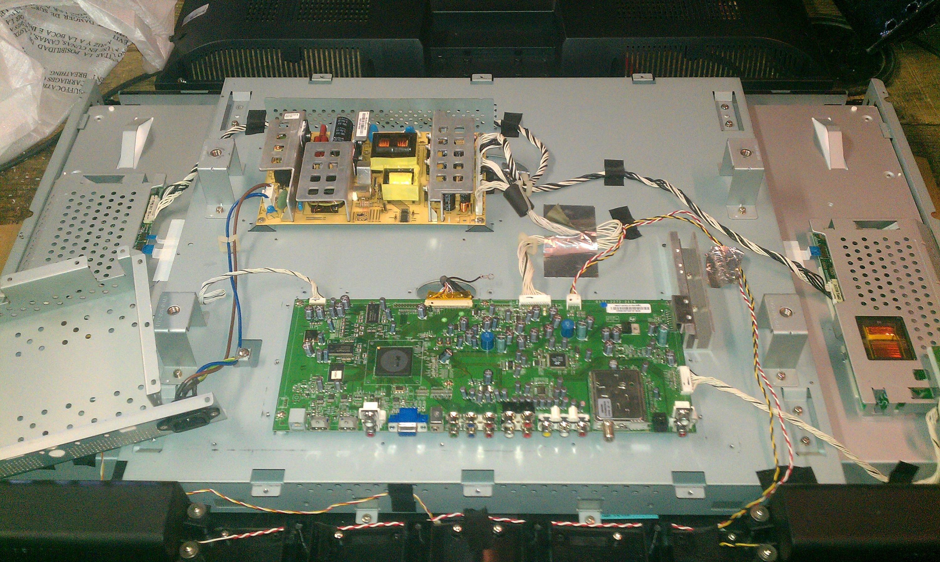

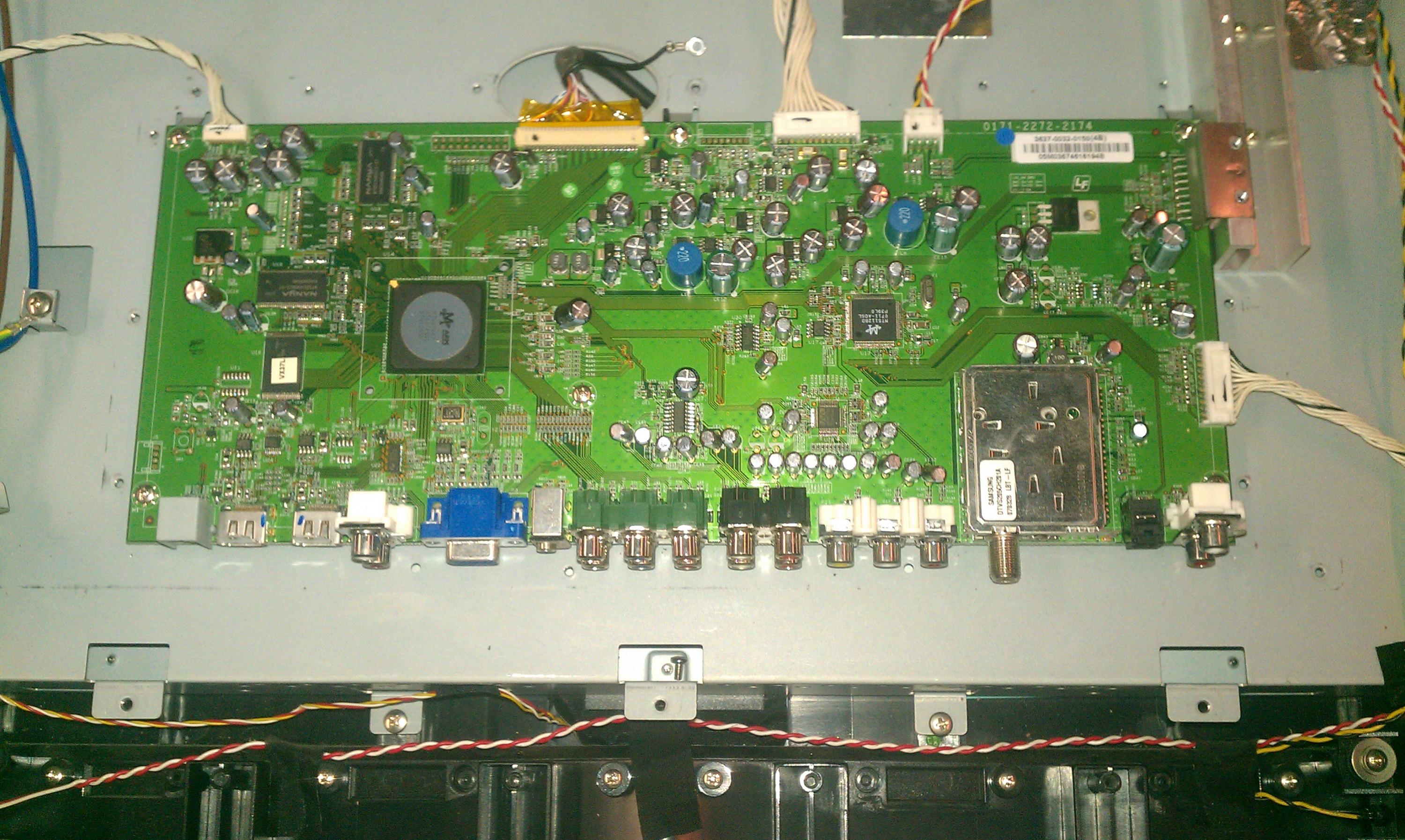

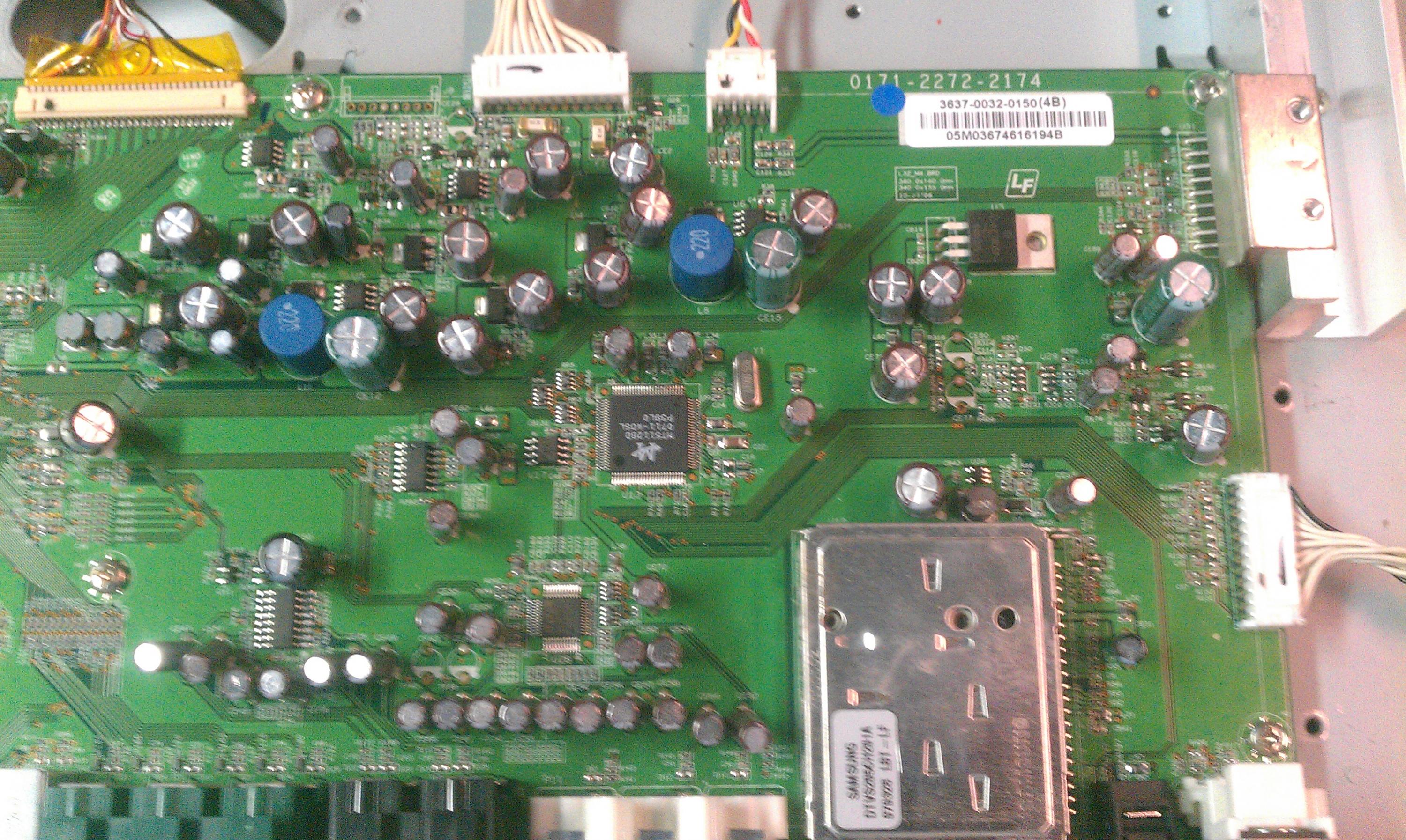

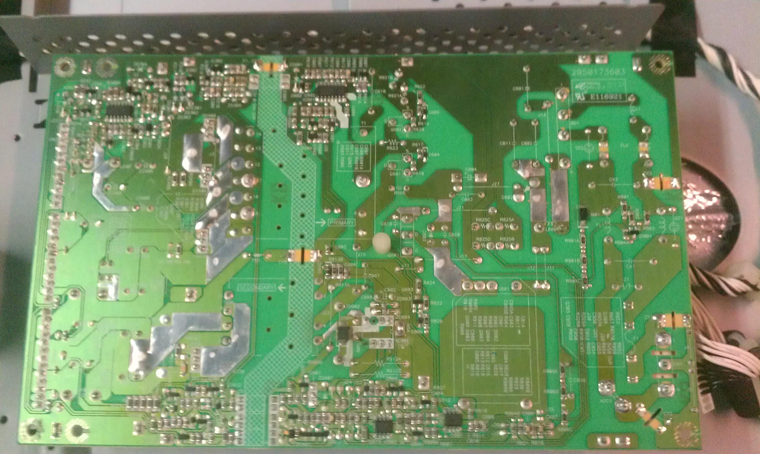

            Please post some pictures.
            • sbeck
              • Mar 2013
              • 31
              Re: Vizio vx37l hdtv10a
              Her are the pictures

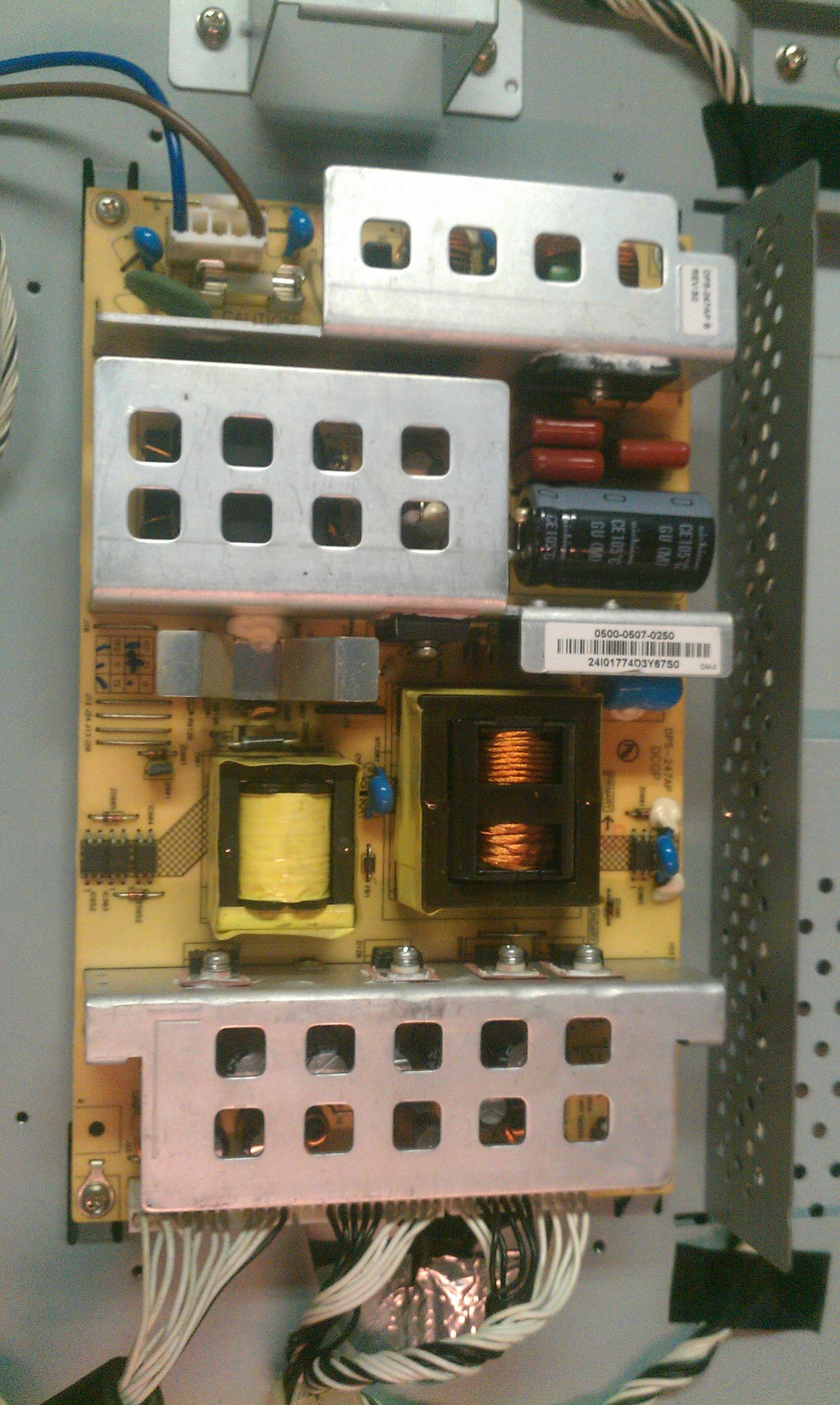

                Have you tested all of the voltages coming out of the PSU? Take a close look under that heat sink and see if any caps are bloated.
                I have a very similar TV to this and mine had power AND main board problems. I still havent' replaced the main so it remains leaning against the wall

                    All the Caps are physically ok on the power supply, also the voltages are:
                    3.19
                    5.27
                    12.22
                    The regulators seemed to test good,
                    Vin 3.39
                    Vout 1.25
                    both tested to the ground(adj)
                    I did notice that the power supply makes a noise about every 10-15 seconds. the sound of Electricity flowing, followed 1 second later by a repeat, maybe normal, just food for thought

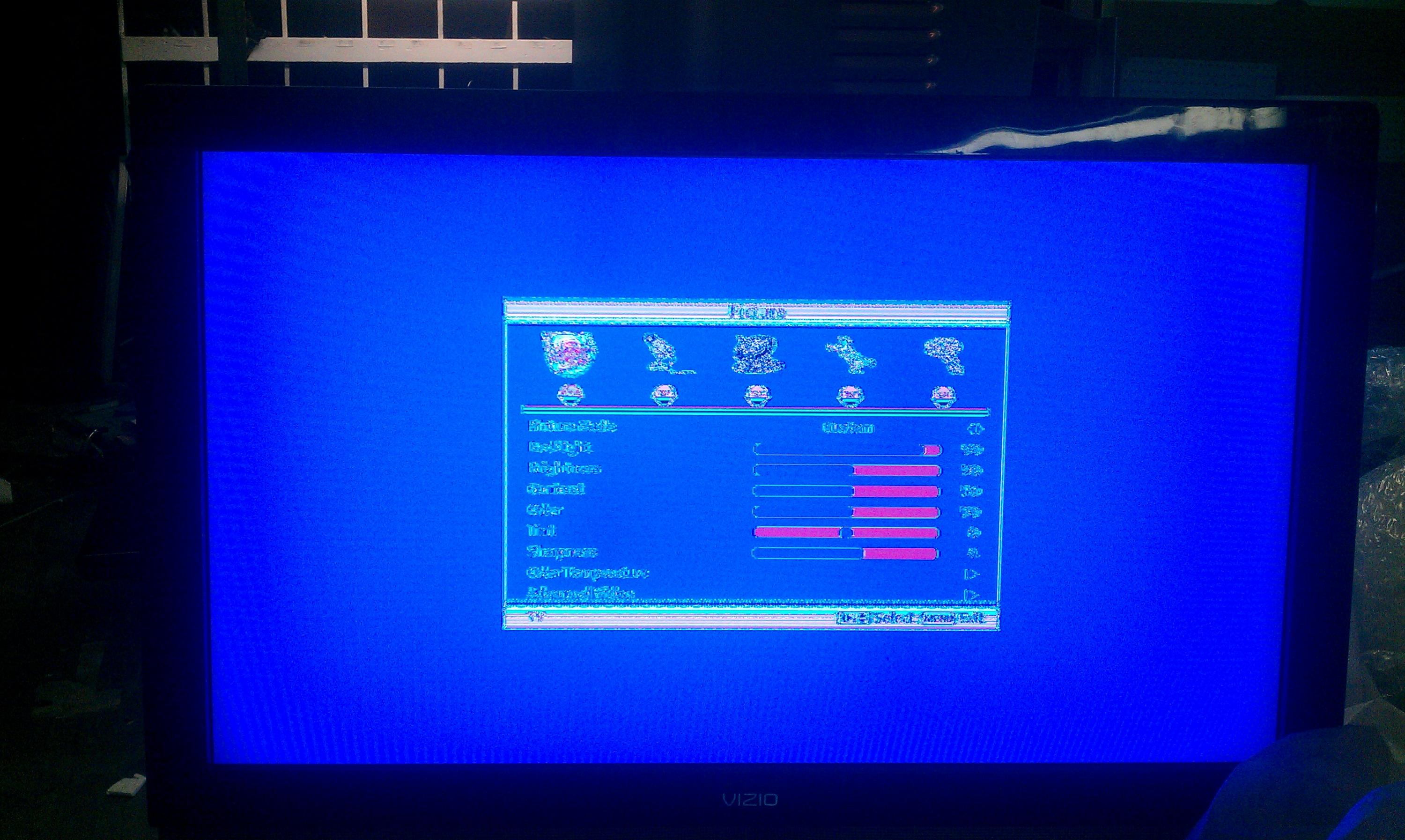

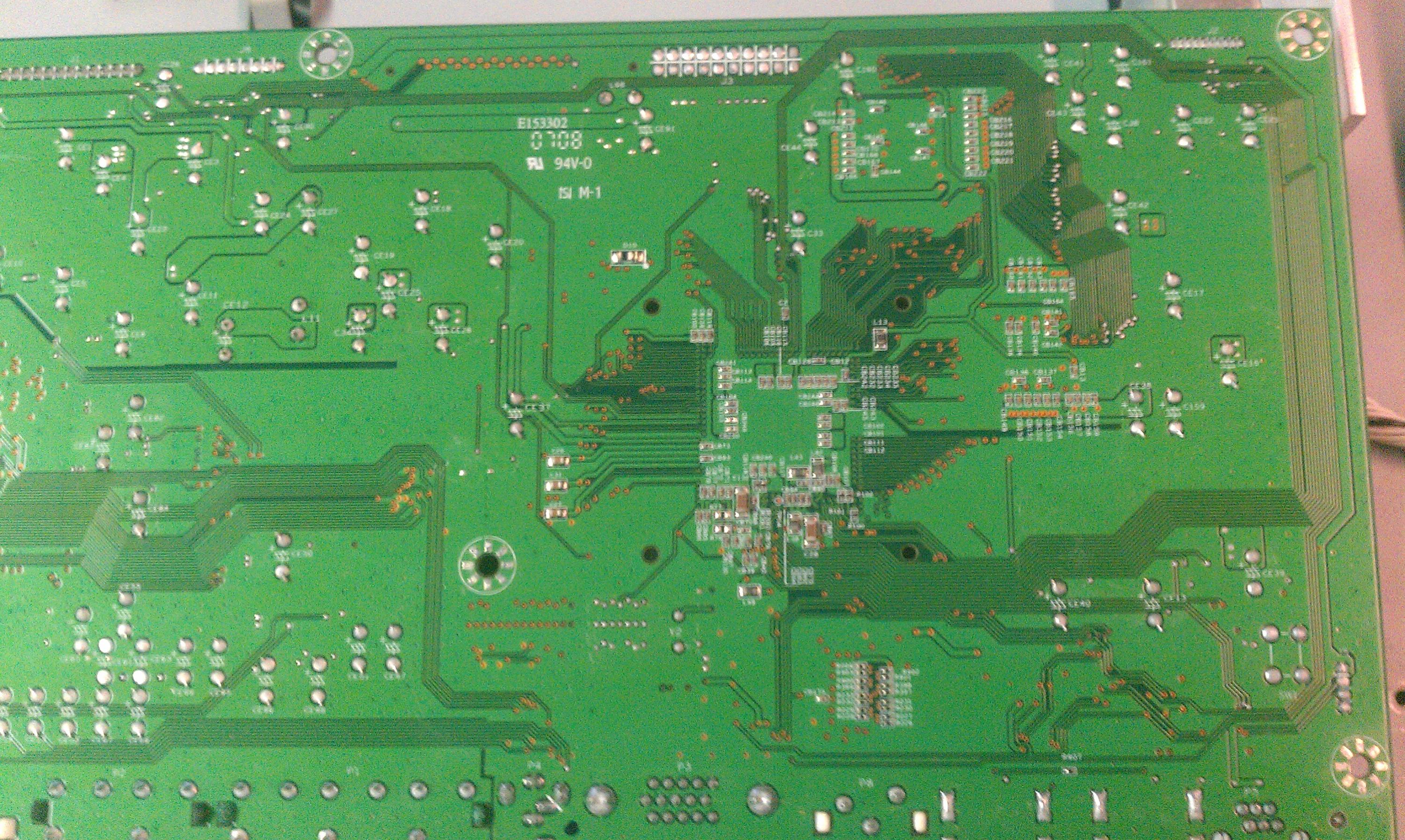

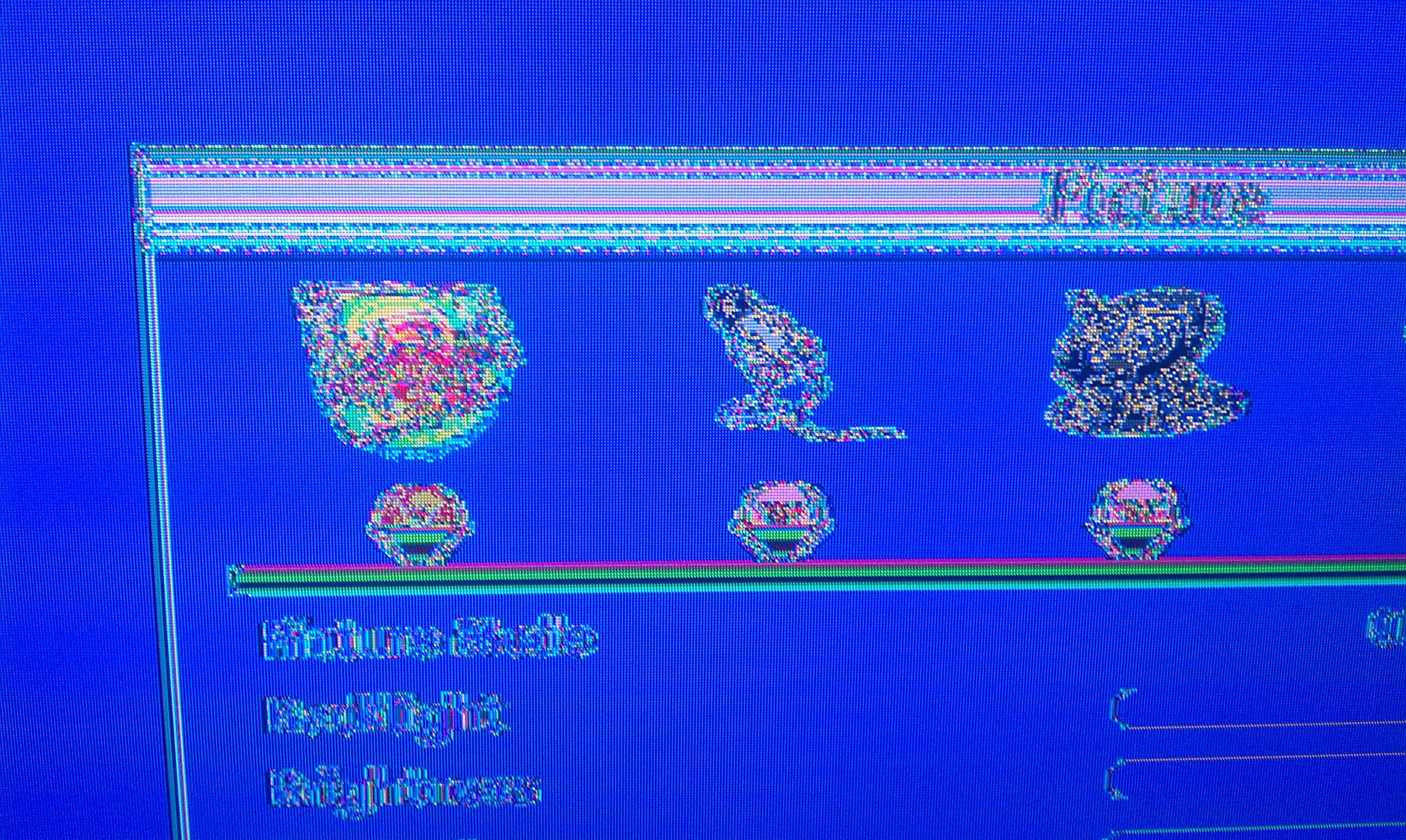

                            I tested all that I could find, and still no luck, so I decided to check cables and alas, I got some progress. The T-Con board is an LG, and my guess is that when the T-con does not recieve proper signal it does the screen flash. The LVDS cable was loose/ bad. I fiddled with the connection at the tcon and got a picture, not a good one, but non the less something. Pictures are of the new results. Any ideas what is making the picture so bad?
                            Also I think the background is suppose to be Green not blue
                            • sbeck
                              • Mar 2013
                              • 31
                              sorry to resurrect this, but what would cause that type of picture?
                              • bikerbuddy
                                • Jun 2011
                                • 134
                                Shut down the TV, disconnect the T con board and power on the TV back up and see what the screen look like, if you have a lighted screen then it is possible your t con is bad .
                                • sbeck
                                  • Mar 2013
                                  • 31
                                  When I do that, the screen is black with only the back light on
                                    That test proves nothing. Some panels are white when off, others are black. Most modern panels are black.
