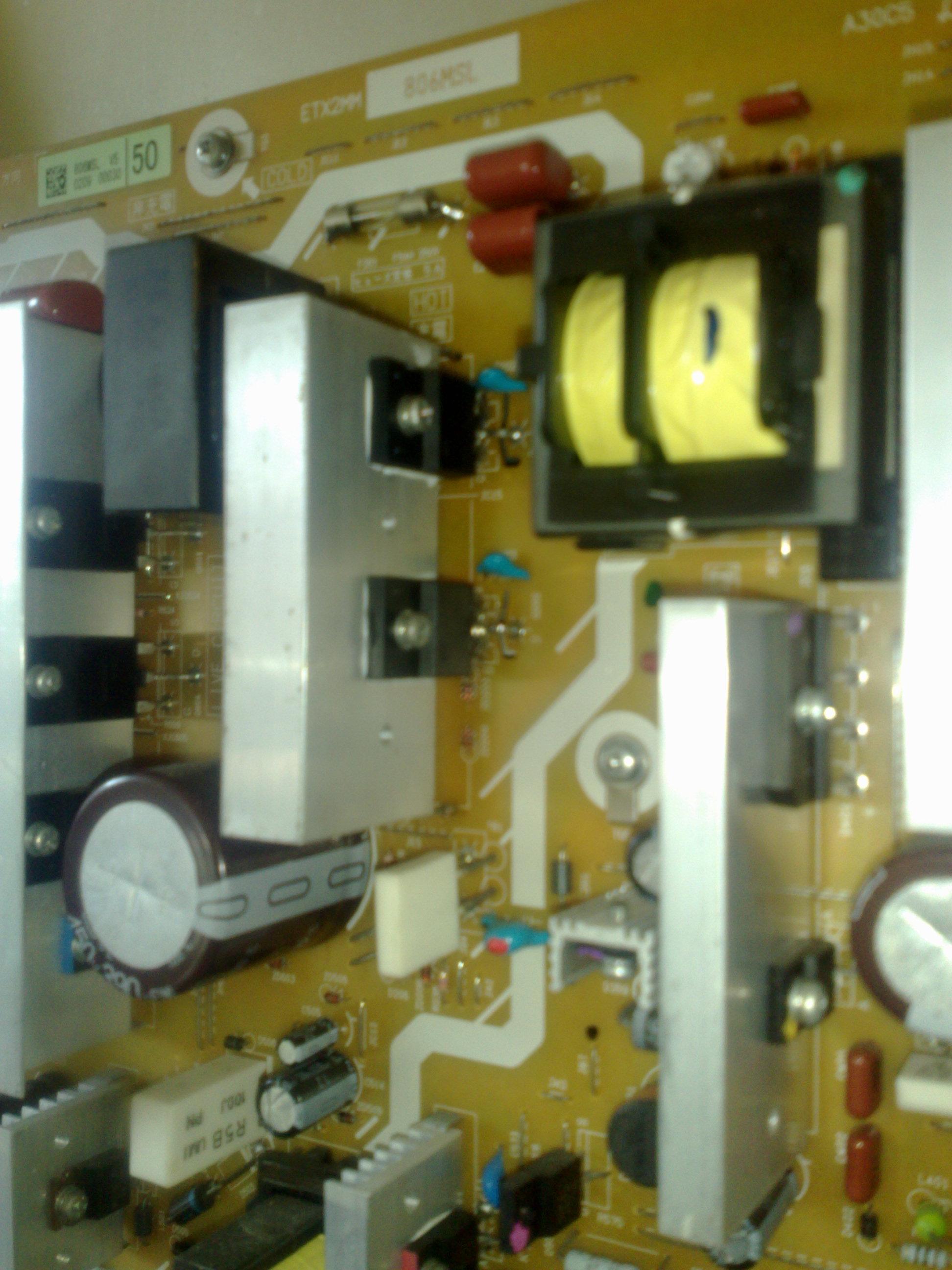

    Would it be worth wiring the V-SUS via a 150W lamp?
    May prevent more failures of new devices.....
    I did this recently with a Pan board that had blown a load of silicon....

                  Originally posted by tw2005
                  Board #6 Repaired TNPA5081AF. Again someone tracked me down via here so did the exchange thing.
                  This is the first board with the different looking DG402RP & DG502LW chinese parts which I'm unsure about. they're the same as what you see in a lot of Ebay kits, so again I'll give it a good run.
                  SC2 was not dead short.
                  I thought I'd try something different and see if i was good enough to determine out of Q701,702 & 818 were bad. Of those none were showing dead short. Normally Q702 is.
                  After looking closely it was low in ohms about 200. Q701 again seemed ok but then one side did not measure up possibly open cct, replaced that
                  Q818, the one i hate as it's hard to really know, did compare well in cct so left it(usually now i just replace)
                  So initial list is
                  IC16521 M81737FP, FET DRIVER , 15v line was pretty close so seemed it may be ok but when i did resistance checks on Q551 and Q521 they has low ohms, normally over 3 meg. It was the FET driver IC
                  IC16773 TC7SH14F, schmitt inverter ic (can use SN74AHC1G14DBVTG4) (shorted)
                  Q702 2PD601ART NXP (C3 W), (low ohms)
                  Q661 RJP63F3A (shorted)
                  Q621,622 GT30F125(R) (not short but low ohms got 0.190 in diode, normally
                  around 0.9 -1.00 in cct) replaced both
                  Q401,402,DG502LW (shorted)
                  Q421,422 DG402RP (shorted)
                  Q452 GT45G128 (shorted)
                  D482 RFN25TM4SW (shorted)
                  D451 RF101L4S (was ok)
                  Q701 MMBTA92 ( replaced)
                  Q818 2SK3018 (left)
                  END RESULT, FAIL - 7 blinks
                  I blame this on Q818
                  NEW LIST - 2ND GO
                  q701,702, IC773, Q621,622,Q401,402,Q421,422, Q452, D482,IC521 all survived.
                  This is what did not including new parts.
                  Q661, d641,642(never had to replace these before), q818 was replaced, D451 has now failed, i found that after every else was right, panel energised then 6 blink
                  So it's the same lesson, it's best to replace Q701,702,818,IC773, Q661, then check ic771 resistance vout -gnd, must be 5.7-6.1k, if lower like 4-5k then check d702.
                  check all over heatsink parts for shorts,replace where applicable, recheck diodes associated, replace Q621,622, check d451, replace the FET driver ic521.
                  check Q521,551, width ways, opposing pins at both ends, usually over 3meg
                  After this, recheck resistance for P5V = 5.6k, P15V= 1240 or more, vad+5v(IC771 5v out - gnd) 5.7-6.1k
                  the key to this is getting Q661 and the inverter cct 100%, use the manuals and schematics.
                  Just updating this board is still running fine. been in my TV since repair for 3 months now, all parts were from UTSOURCE and it's the main TV used every day

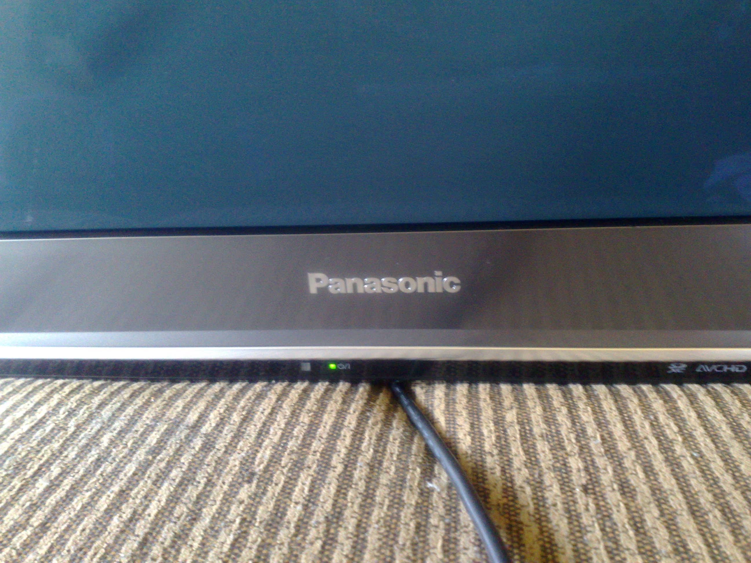

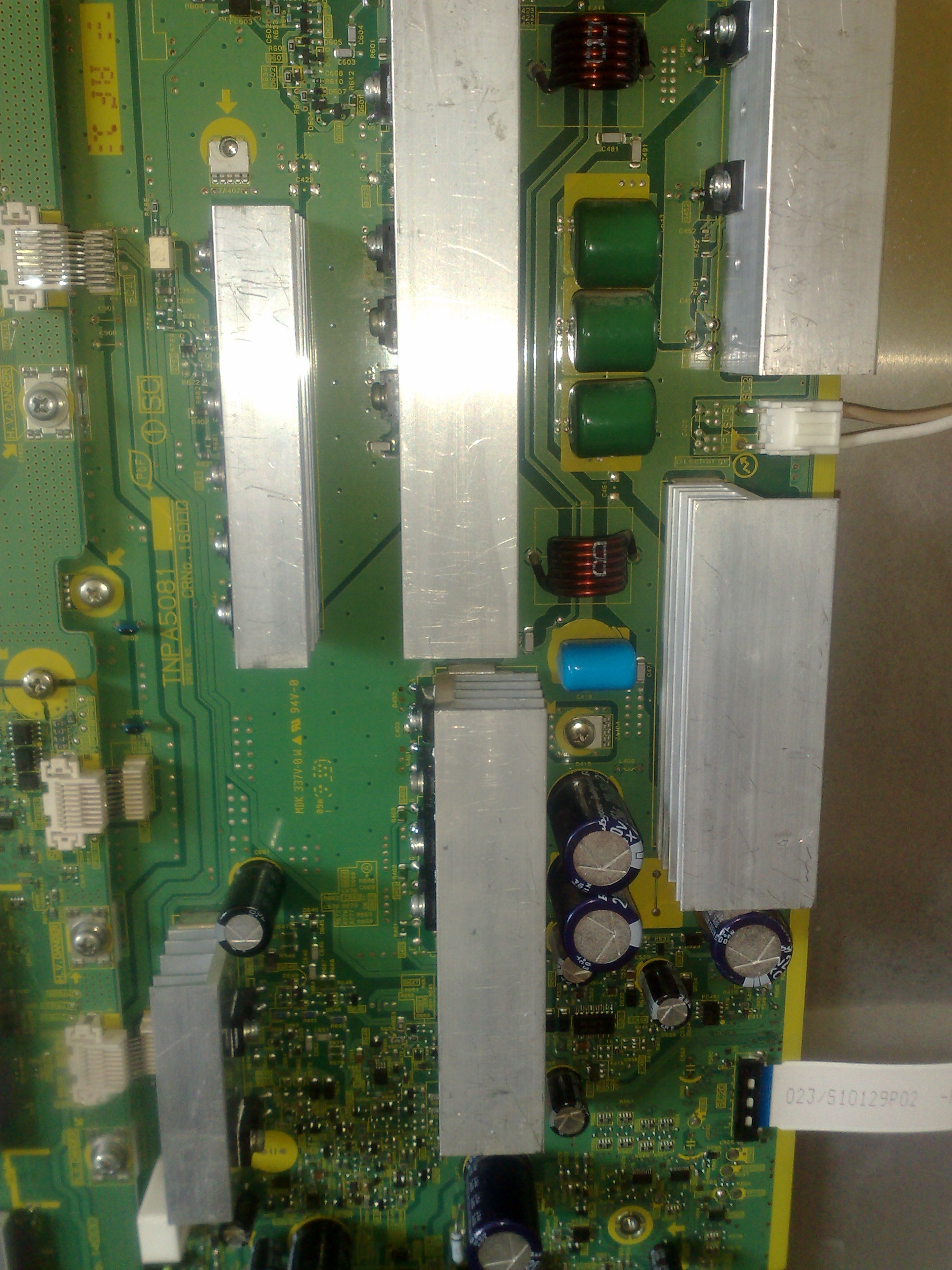

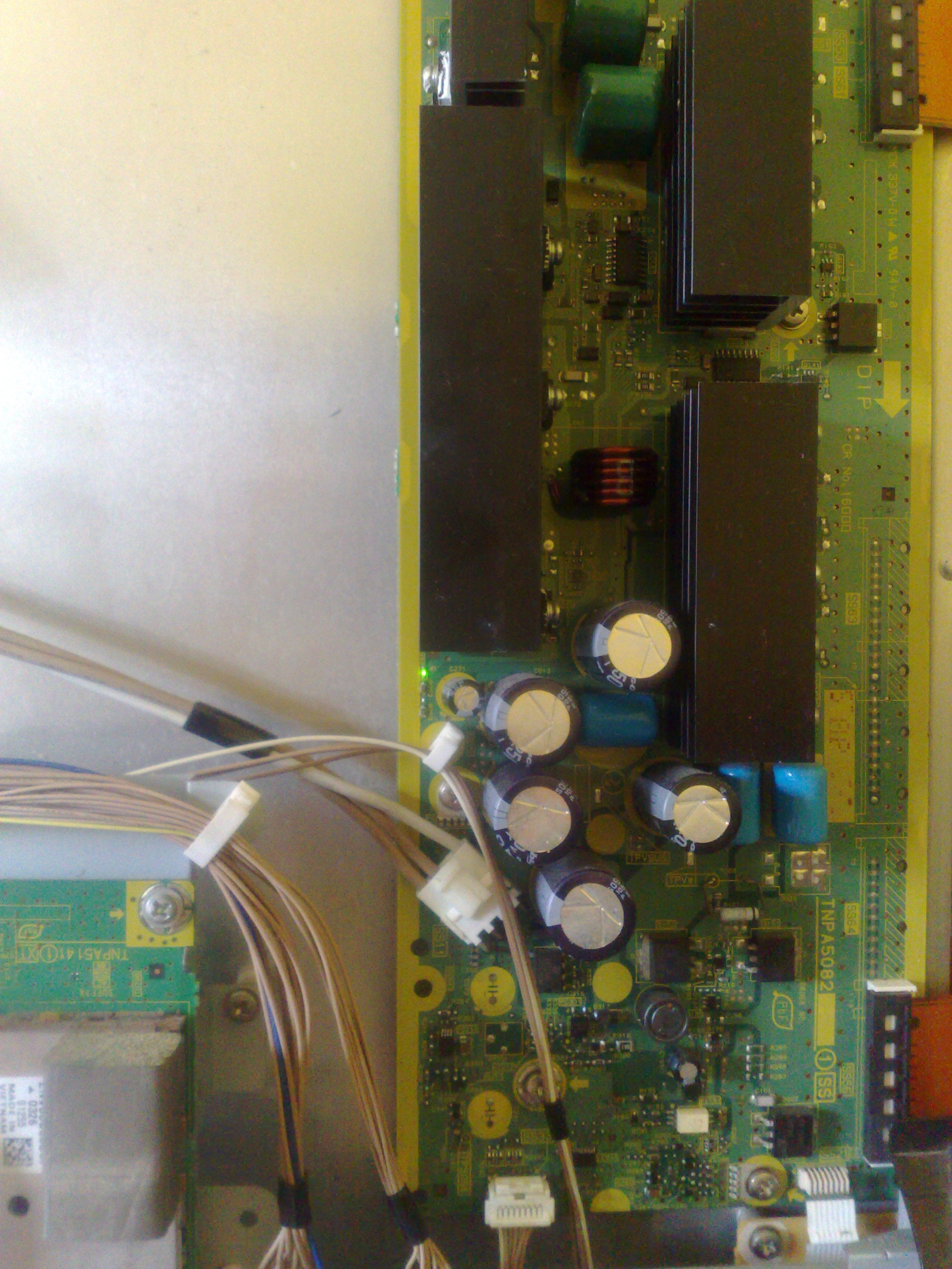

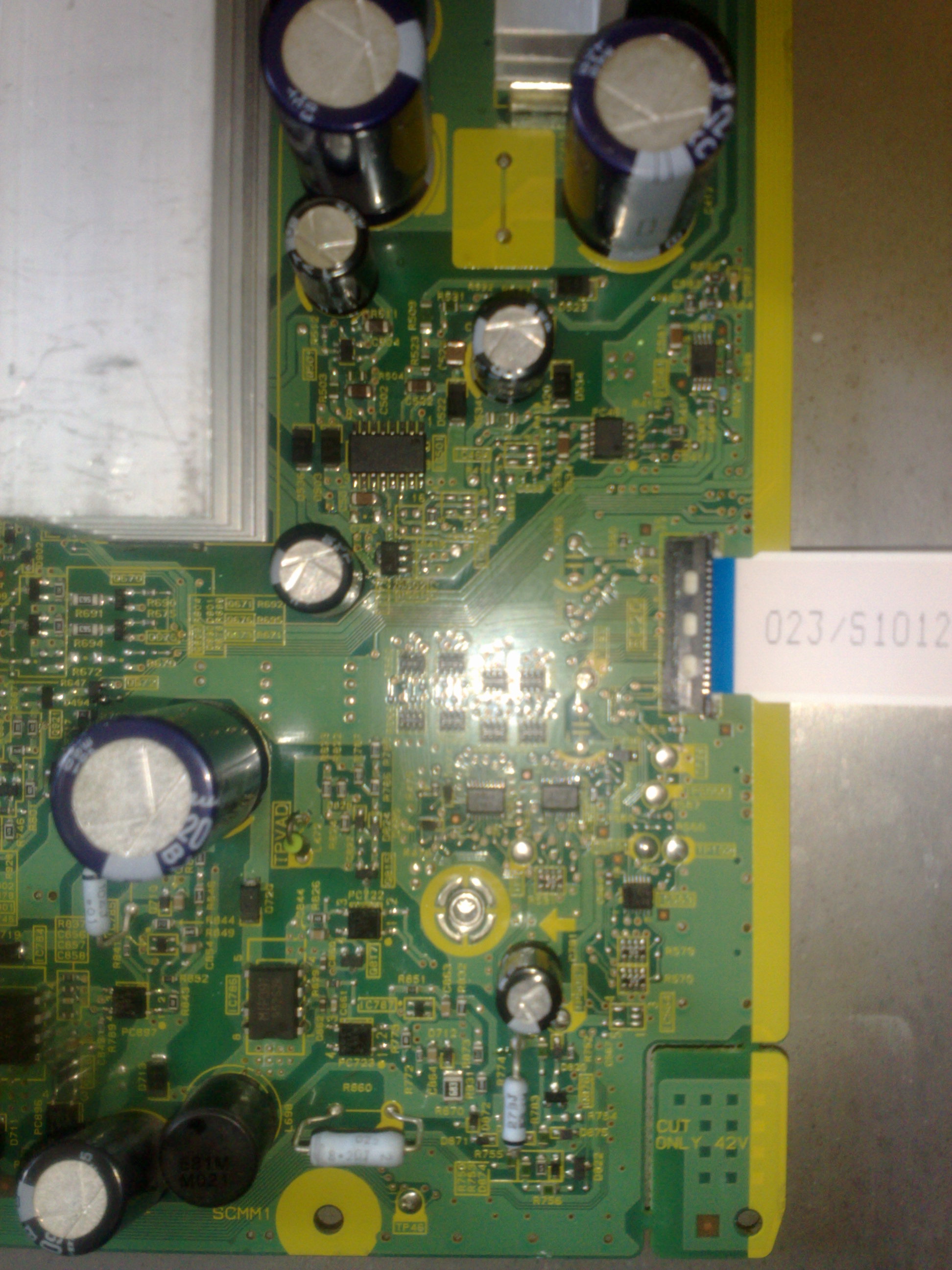

                    #269
                    Re: Panasonic sc tnpa5081 rebuild
                    personal hello.
                    I need help on the board tnpa5081af.
                    made repairs exchanging components 30 + or -.
                    now the tv is calling but does not appear sound and I have no video.
                    I like the post tw2005.
                    personal excuse the translation because I am Brazilian, and I am using translator ok.
                    if they can help me I will be very grateful
                    • tw2005
                      • Oct 2011
                      • 6458
                      #270
                      Originally posted by stryacker
                      personal hello.
                      I've found it very hard to help people with these even though I manage to fix them.
                      you would have to list what parts have been replaced.
                      30 or so parts replaced is not the norm, closer to about 13 parts.
                      The translator is not making the message clear.
                      "now the tv is calling but does not appear sound and I have no video."
                      not sure if this is saying TV is On, sound but no picture or what symptoms you have?
                      is the Tv turning on and staying on(no error blinks) but you have no image but the screen appears to be on?
                      any chance you can upload a clear image of the board (component side ) for me to see?

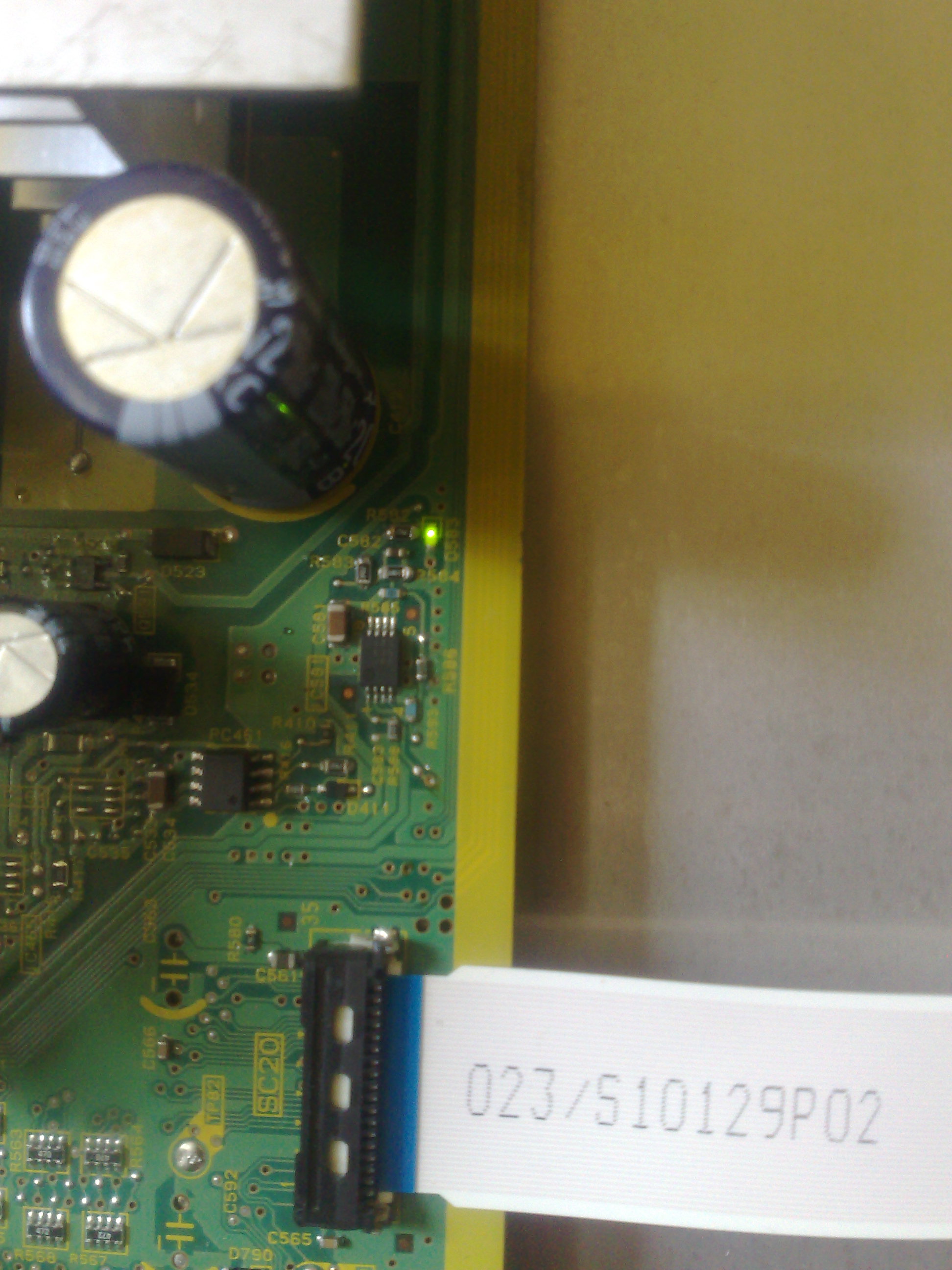

                        #271
                        Hello sorry for the bad translation.
                        all the transistors and diodes were exchanged.
                        Q421, Q422
                        D421, D422
                        Q621, Q622
                        D641, D642
                        Q601 Q660 And were good not changed!
                        Q661
                        Q401, Q402
                        D401, D402
                        Q452, D452, D451
                        Q441, D462
                        IC773 was in short was exchanged for the same HA
                        IC771 was exchanged good
                        IC691
                        IC562
                        IC774
                        IC521
                        Q551
                        Q521
                        Q810
                        Q701
                        2SK3018 all been replaced.
                        turn on the tv looks good and I have no video or audio
                        I have 50v in tpvscn and tpsc1
                        very strange.
                        now the tv stopped showing up the brightness in the image, but I believe That Is not the screen.
                        When moved the flat cables had very clear vertical stripes.
                        green LED lit without blinking.
                        Thanks for listening.

                              #274
                              The tracks are on the screen because they were poor contact.
                              When I cleaned the contacts back to normal.
                              This is common when a fault in the connector.
                              I realized that the Plate A ic stopped heat.
                              When he was hot on the screen appeared brightness and obeyed on off.
                              • stryacker
                                bga advanced
                                • Nov 2013
                                • 10
                                • Brasil
                                #275
                                I believe is A board
                                I will make a reflow chipset to see if it is defective bga.
                                I'll need luck now
                                PSU Q201 Q202 plate short changed by equivalent.
                                2SK352 are identical.
                                in sc board not found the GT45G128 here in Brazil can not find anywhere.
                                GT45G128 = RJP43F4A. and works perfect.
                                • tw2005
                                  • Oct 2011
                                  • 6458
                                  #276
                                  I'll need luck now
                                  45g128 is easy to find on Ebay or China. I had to import everything but I like your creativity.
                                  I've wondered for a while now substituting other IGBTs instead of getting the exact same.
                                  anyway of you putting photograph up?

                                    #277
                                    I sent photos as promised..
                                    • stryacker
                                      bga advanced
                                      • Nov 2013
                                      • 10
                                      • Brasil

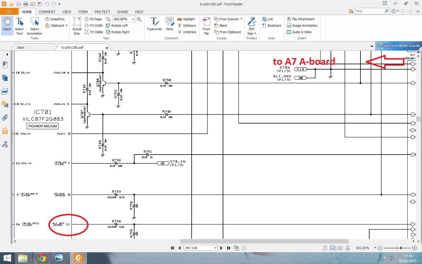

                                      #278
                                      I have a doubt.
                                      now TV features 13 LED blinks
                                      after 5 minutes, and turns off alone.
                                      and blinks 13 times.
                                      checked one 47k resistor that is with 3k, the connector pin 11 A7.
                                      what is this?
                                      pin 11 of the connector A-board A7

                                        #279
                                        I think I overdid
