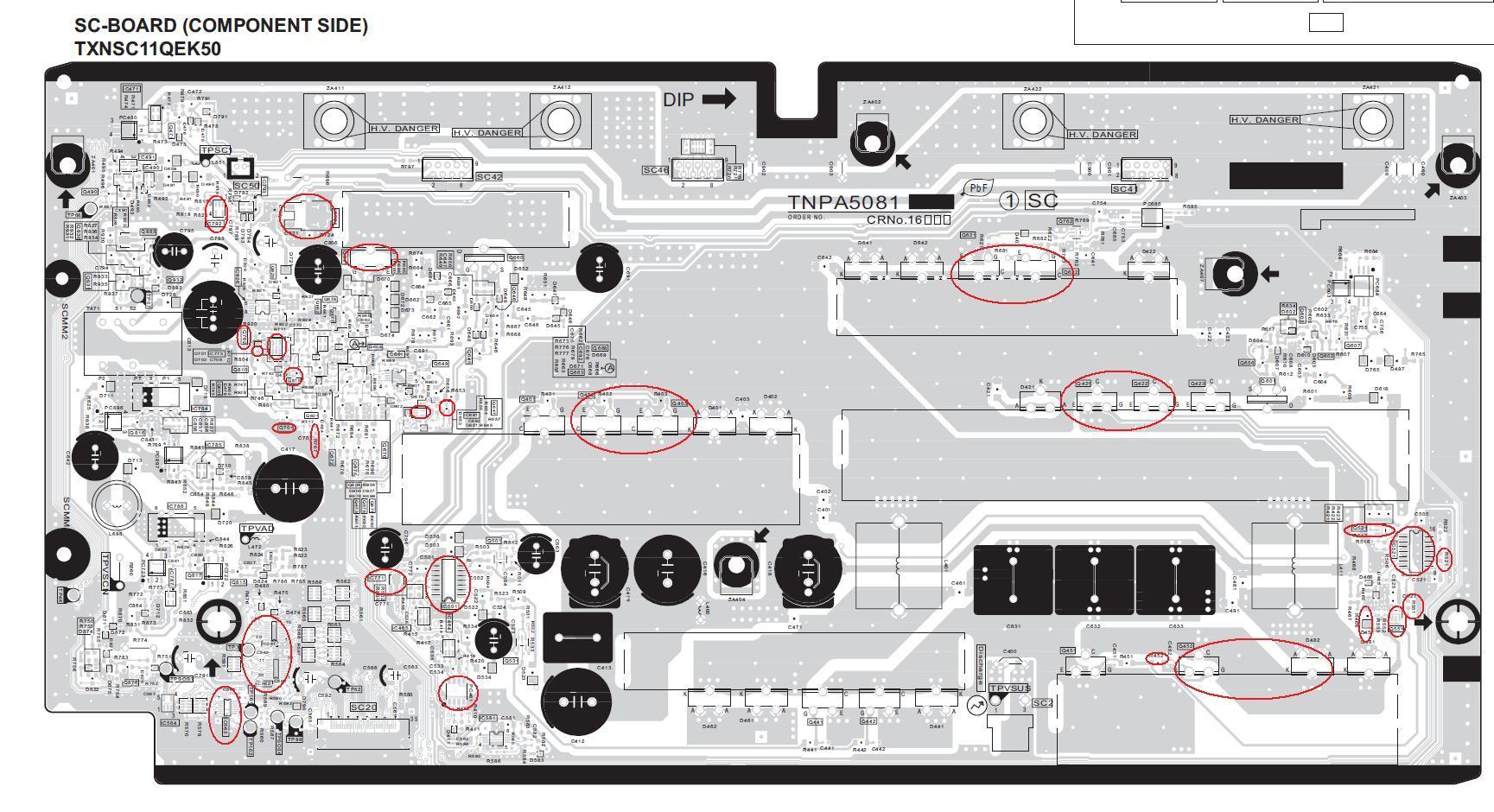

    OK. had a bit of a win on about my 20th lap around the cct, pulled into the pits for a think and decided to keep focussing around the areas with known failed parts.
    So whilst I've been relying on resistance readings and diode mode, as i've already seen polarity affects the results. So I had red probe on gnd and just went over a lot of stuff already checked.
    Went back to the NAND cct IC691, and rechecked Q647, another 2SK3018 (KN) FET and bingo, just like the other gave me a consistant higher reading than normal on one pin. Resistance and the other polarity matched up with all the other boards.
    Replaced this FET with a sub 2N7002 and flashing red LED, no SOS, solid green and an energised and humming SC board, great !
    Hooked up the buffer boards, repeat of above, screen energised, sound , Ahhh! No picture.
    Honestly, give me a break
    So I'm left with only one thought and that is the buffer & inverter ICs at SC20?
    They were all new ordered OEM from the US using a freight forwarder, however about 2 attempts ago I changed out the C14, inverter from a blown buffer board which I guess is risky and just a sign of pure desparation.
    I don't have a Scope which would be of great help in this circumstance but I really need a little guidance here.
    i'm hoping everything else is OK and the missing link is the drive signals.
    I don't really know what all the control line abbreviations mean so if anyone has a bit of an idea, please sing out.

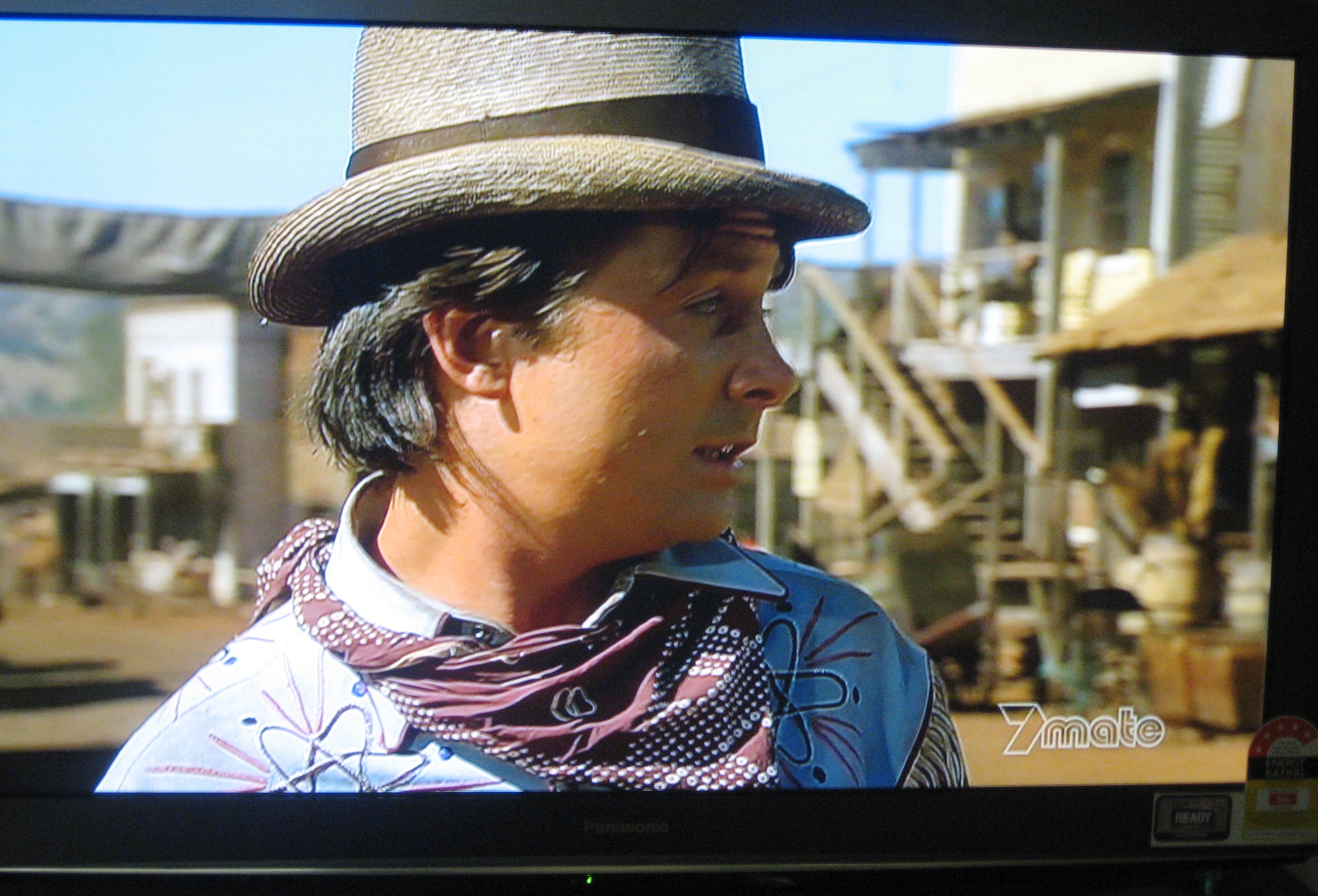

        WORKING WORKING WORKING!!!!!!!!!!!!!!!!
        I saved one of the original C541 buffers, the one that had not gone short on the Vcc, no idea it was good or not.
        Since I had only touched this one chip and went SOS7 again I saw no point putting the one I had just removed so grabbed this little sucker and cleaned it up, put it in.
        Powered up with the SC50 jump and it passed. Hooked up the buffer boards and stuff me Back to the Future come up. How fitting.
        Honestly, never expected this result.
        Family had to get me off the ceiling, i was just a little over excited.
        I targetted that particular buffer after tracing the control lines back in the schematic from SD46.
        I can only conclude that the new chip got spiked with all the other items I had missed.
        The one off the C board was the 3D version boards not fitted to this which had a good SC but the SD was shorted and this was a TV with a cracked panel.
        You'd think you would be ok grabbing one from this sort of board but there you go it must have been damaged with the panel.
        All I got to do now is source a NJM2406F(TE1) so i can get the working board I borrowed it from back up again.

                                        At a glance you've only replaced the blown IGBTs. I trust you have the manual and schematics to follow.
                                        q16421, DG402RP
                                        q16422, DG402RP
                                        q16423, ? is this fitted to your board? normally only 54" and above
                                        q16402, DG502LW
                                        Q16403, Was this short as well? Normally they both go.
                                        d16865 ?? Is that Q16885 2SK3065?
                                        q16661 RJP63F3A
                                        You'll have to recheck all IGBTs again. you may find Q16621,622 could be short.
                                        Check 15V in resistance, P5V in resistance. Check the two 5V regs resistance on Vin , Vout best out of cct if suspect as I had one IC16771 was open cct on Vout.
                                        Hell this is gonna take me forever to try and explain/list.
                                        This is the list of what it took tio get my last board going.
                                        If your board made a loud pop, zap and flash of light between q661 and sc20 you should check all these. pay particular attention to the inverter and nand cct. if the inverter ic773 is not working I suspect that's what blows Q661. Ic691 is the other. the whole cct may need replacing around those items. If the small 5v reg that feeds the inverter is dead, then IC773 will not be operating and q661 will short again.
                                        If you have not read this thread from start to finish, you should there enough clues and info if you write down some notes. I've even circled the 32 odd parts i had to replace on the board in a drawing.
