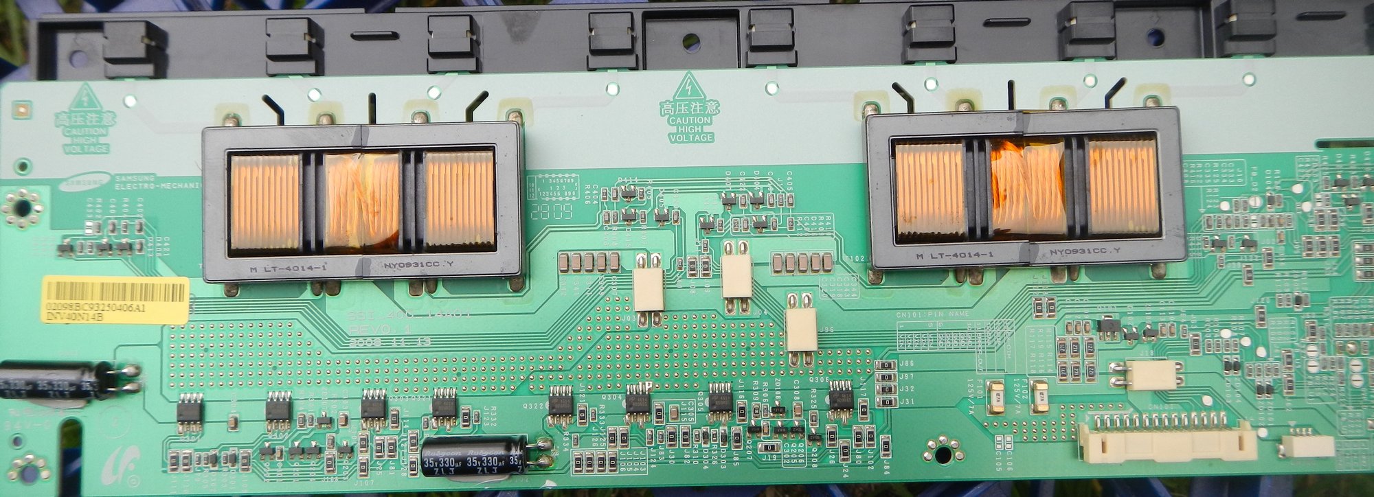

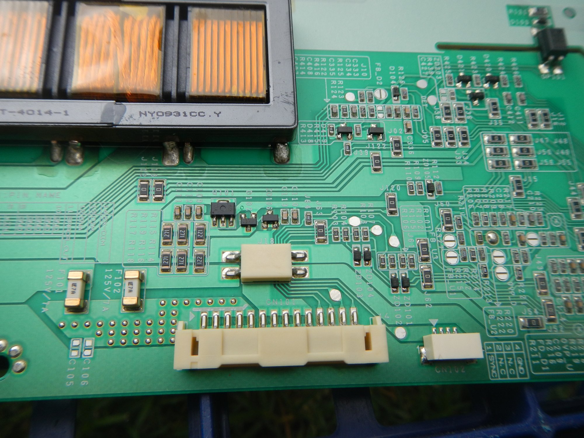

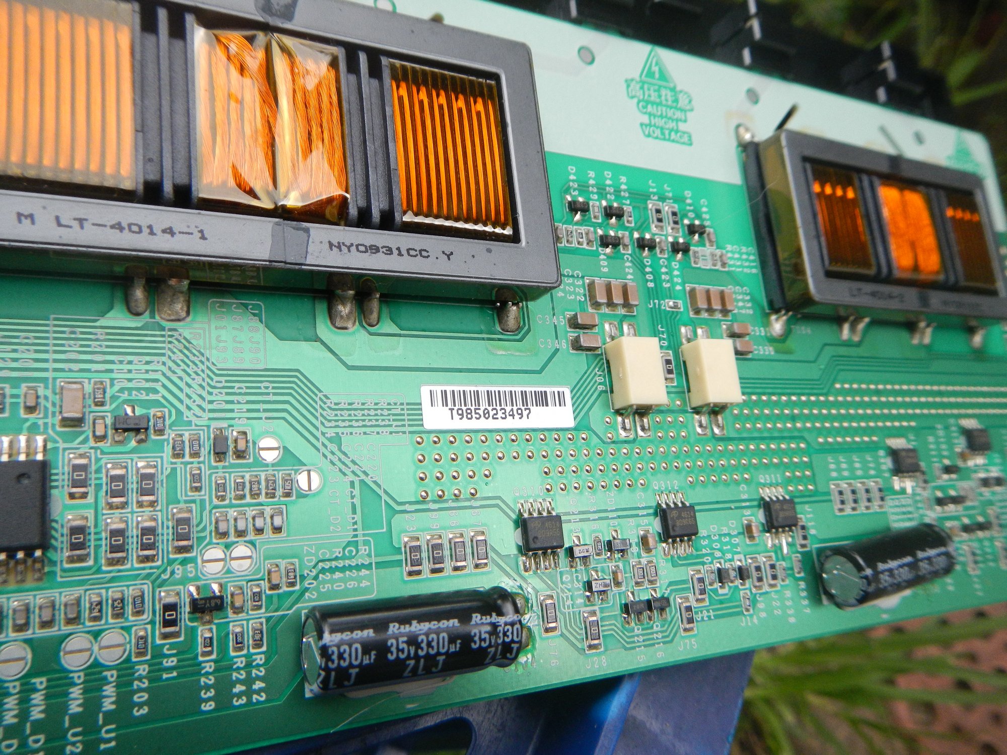

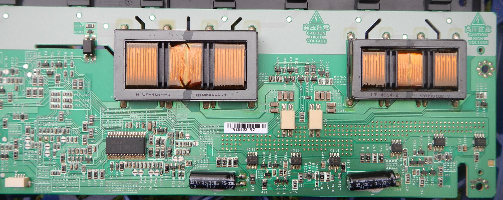

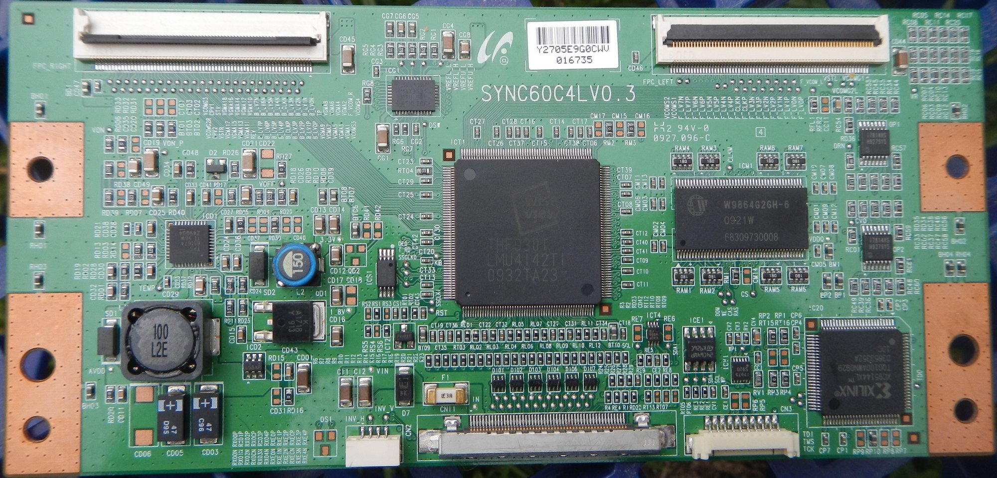

                          Please can you post a good clear straight on picture of the board at the top -TCON
                          and also of the Inverter board on the left ( You may need to do it in two halves.
                          Also what is the part number on the 4 inverter transformers.

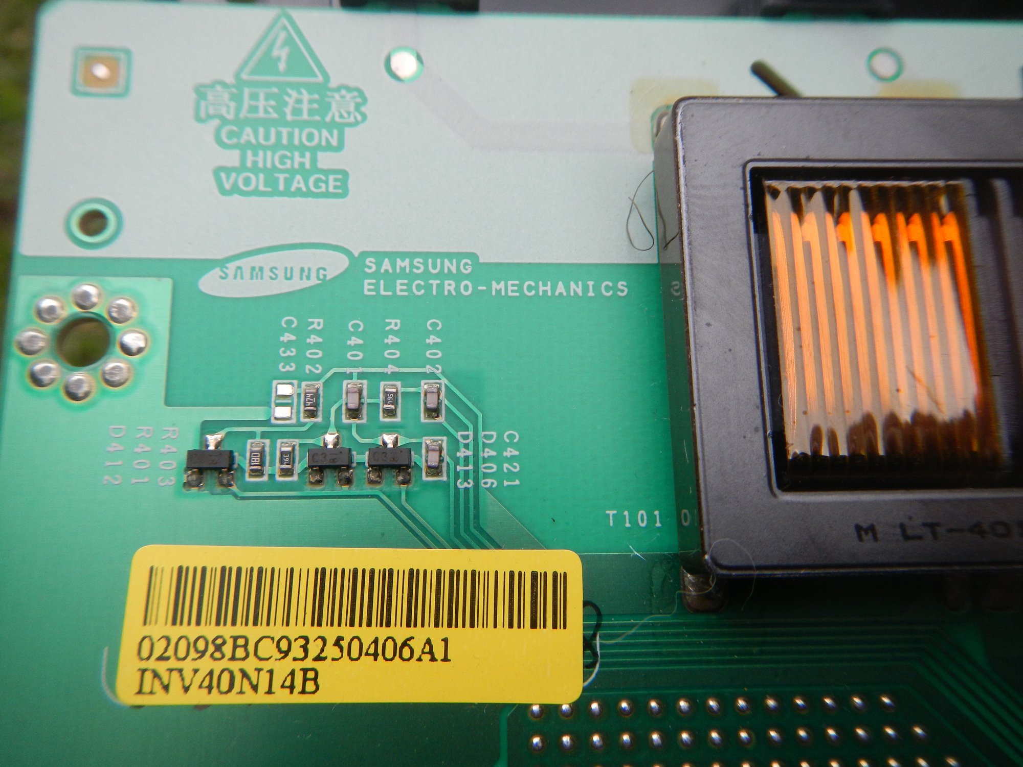

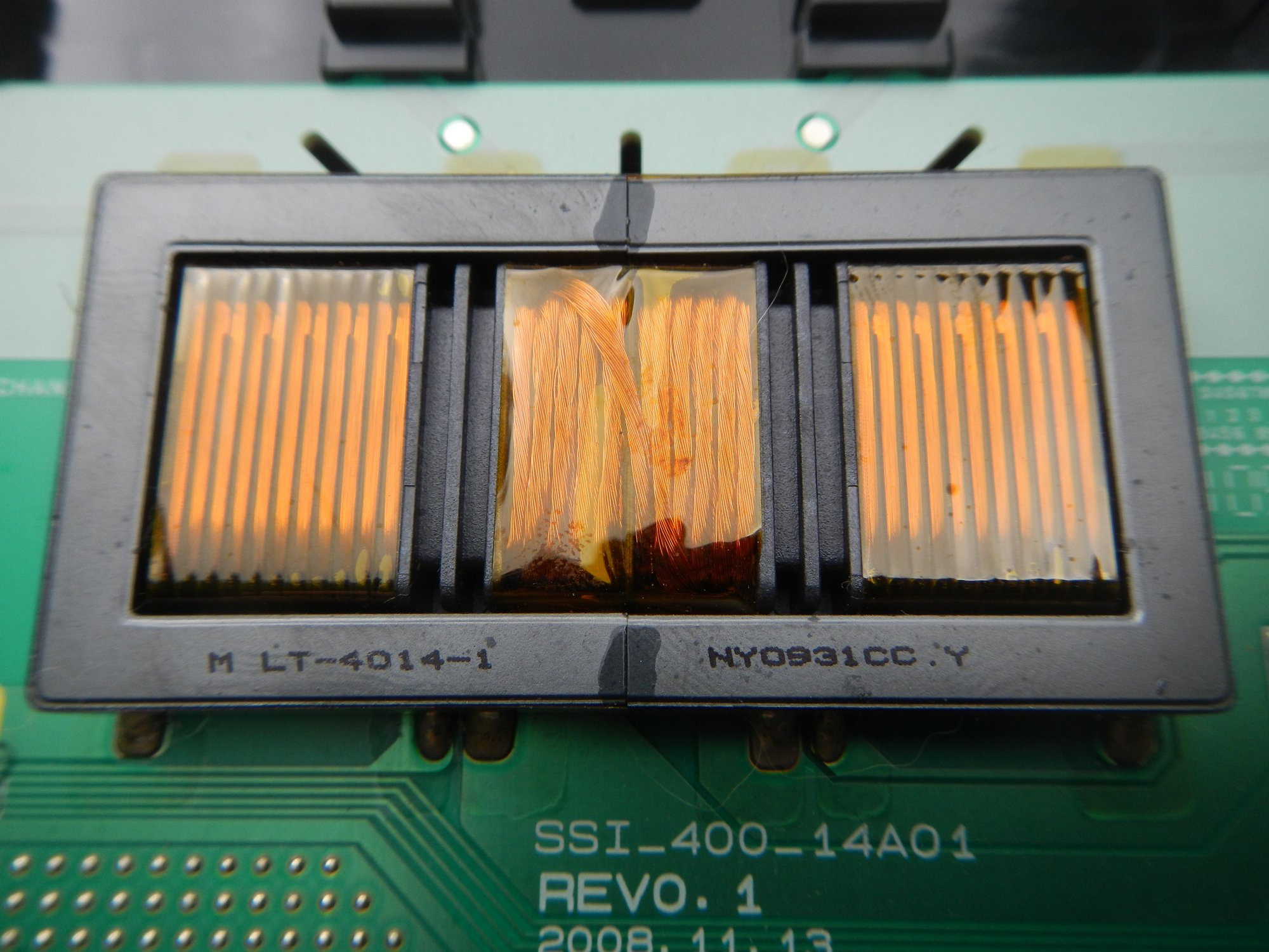

                              The part numbers for the transformers are
                              M LT-4014-1 NY0931CC Y (there are 4 of these)
                              LT-4014-2 NY09310C Y (this is the LAST one, and only ONE of these)

                                OK - on the inverter board each transformer has 8 legs call the top four (as shown in your pic 3) S1 S2 S3 and you guessed S4.
                                POWER OFF
                                Meter on ohms 2000 measure S1 to S2 and S3 to S4 on each of the 4 transformers.
                                There are also some small white fuses - Meter on ohms 20 test them.
                                Yes the hum could be mains hum. The uf does read a bit low but depends on your meter may not be accurate on big caps - again I dont think ESR can be measured accurately on BIG caps.
                                Our usual test is a voltage test meter on 600vDC - Carefully as May be 400vDC and hold the test for a few seconds to see if it fluctuates.
                                Perhaps also switch the meter to ac 600vAC and see what the ac ripple is ( I dont know what is acceptable) but retired caps or budm may chip in)

                                  Hello again.
                                  Transformers listed left to right.
                                  T101 - [S1-S2] - 1.512kΩ
                                  - [S3=S4] - 1.509kΩ
                                  T102 - [S1-S2] - 1.502kΩ
                                  - [S3-S4] - 1.497kΩ
                                  T103 - [S1-S2] - 1.519kΩ
                                  - [S3-S4] - 1.513kΩ
                                  T104 - [S1-S2] - 1.040kΩ
                                  - [S3-S4] - 1.040kΩ
                                  Both fuses are ok (>0.5Ω)
                                  Ill test to see what AC is coming through as soon as I have the inverter board 'clipped' back onto all the tubes I removed the inverter for the photo not realising what a PITA its going to be to get back on..lol..:P

                                    T104 is suspect - please re-test it.
                                      #38
                                      Re: 40" LCD Rank Arena (rebadge?) has standby, V+ seem OK, but wont turn on.
                                      T104 is a different transformer.
                                      Its about 2/3 the size of the other three.
                                      M LT-4014-1 NY0931CC Y (there are 3 [(THREE) NOT 4] of these) (....I said there was 4 before it was a mistake)
                                        #39
                                        I should have said..
                                        T101, T102, T103 - M LT-4014-1 NY0931CC Y
                                        T104 - LT-4014-2 NY09310C Y
                                          #40
                                          Oh OK, in which case they're probably all OK.
