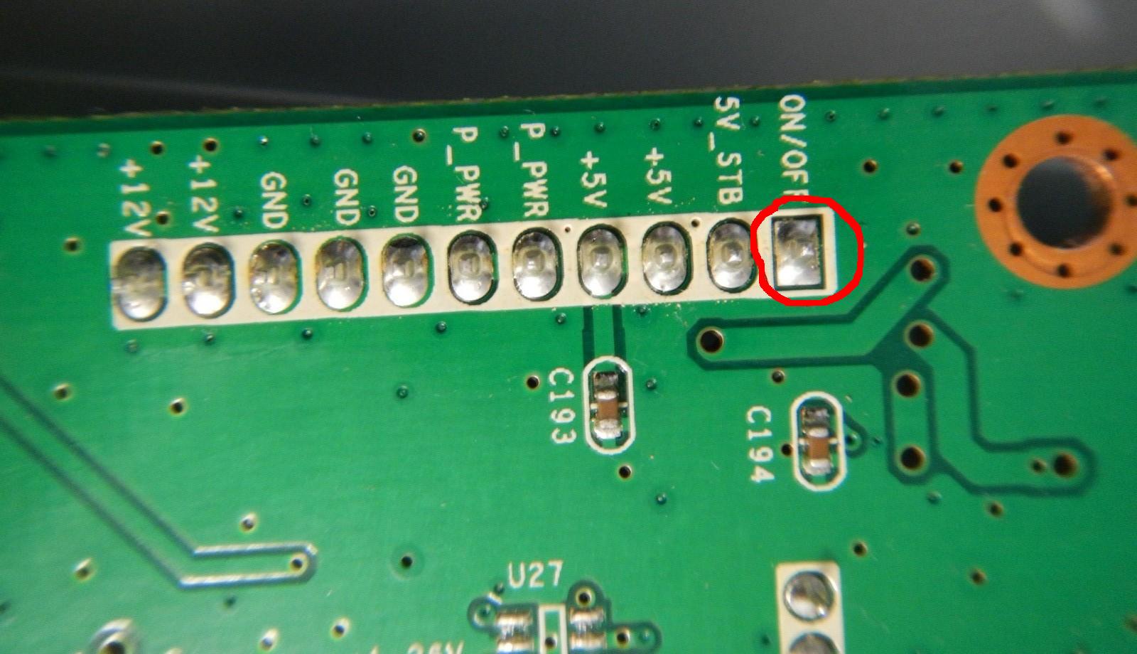

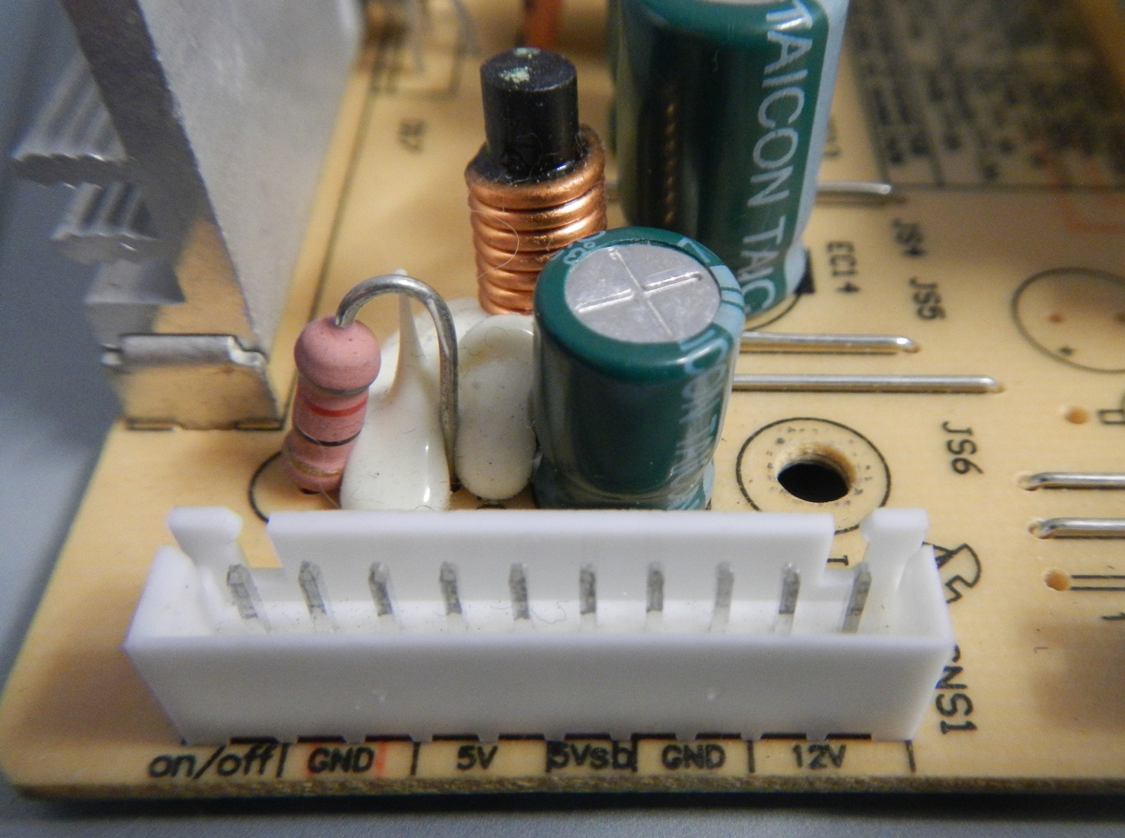

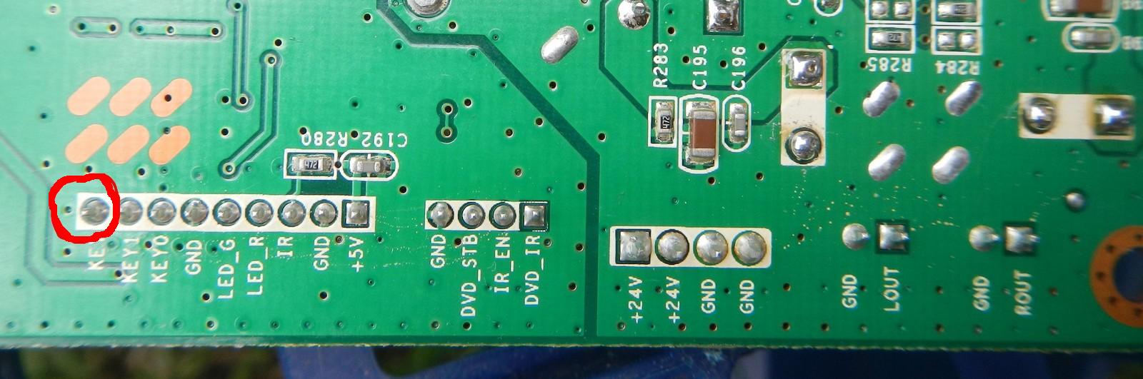

    Ive checked the voltages on the [CON2] which I have listed and all seems fine to me although im not sure if the ON/OFF should have the constant voltage.
    1. [ON/OFF] = 4.6V .............. (CONSTANT 4.6V, weather i press power or not)
    2. [5V_STB] = 5.23V
    3. [+5V] = 5.23V
    4. [+5V] = 5.23V
    5. [P_PWR] = 11.8V
    6. [P_PWR] = 11.8V(n/a - not connected)
    7. [GND]
    8. [GND]
    9. [GND]
    10.[12+V] = 11.8V
    11.[12+V] = 11.8V

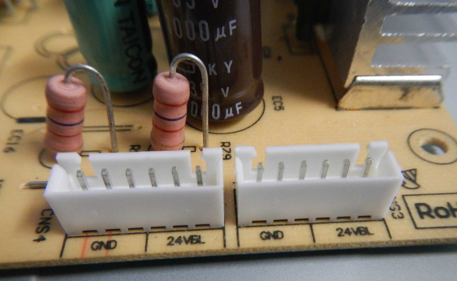

    I also have 24v present on
    [CON1]
    1. [24V_IN] = 24.34V
    2 [ 24V_IN] = 24.34V
    3. [GND]
    4. [GND]

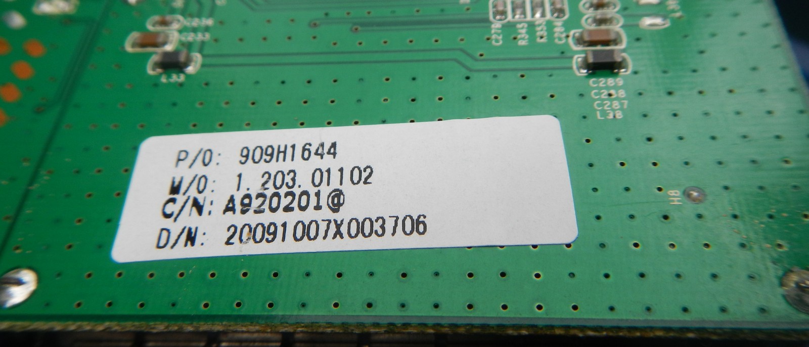

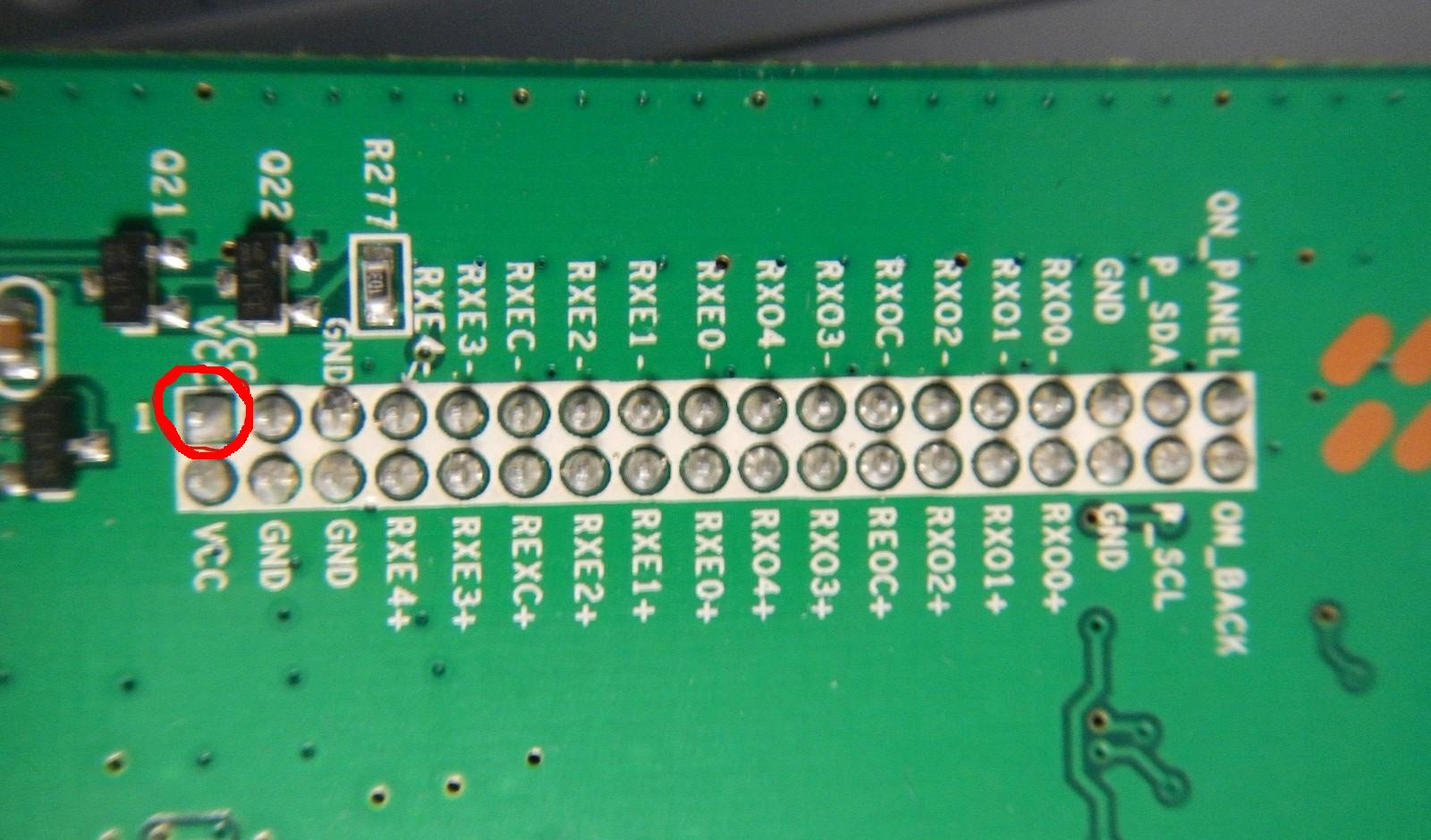

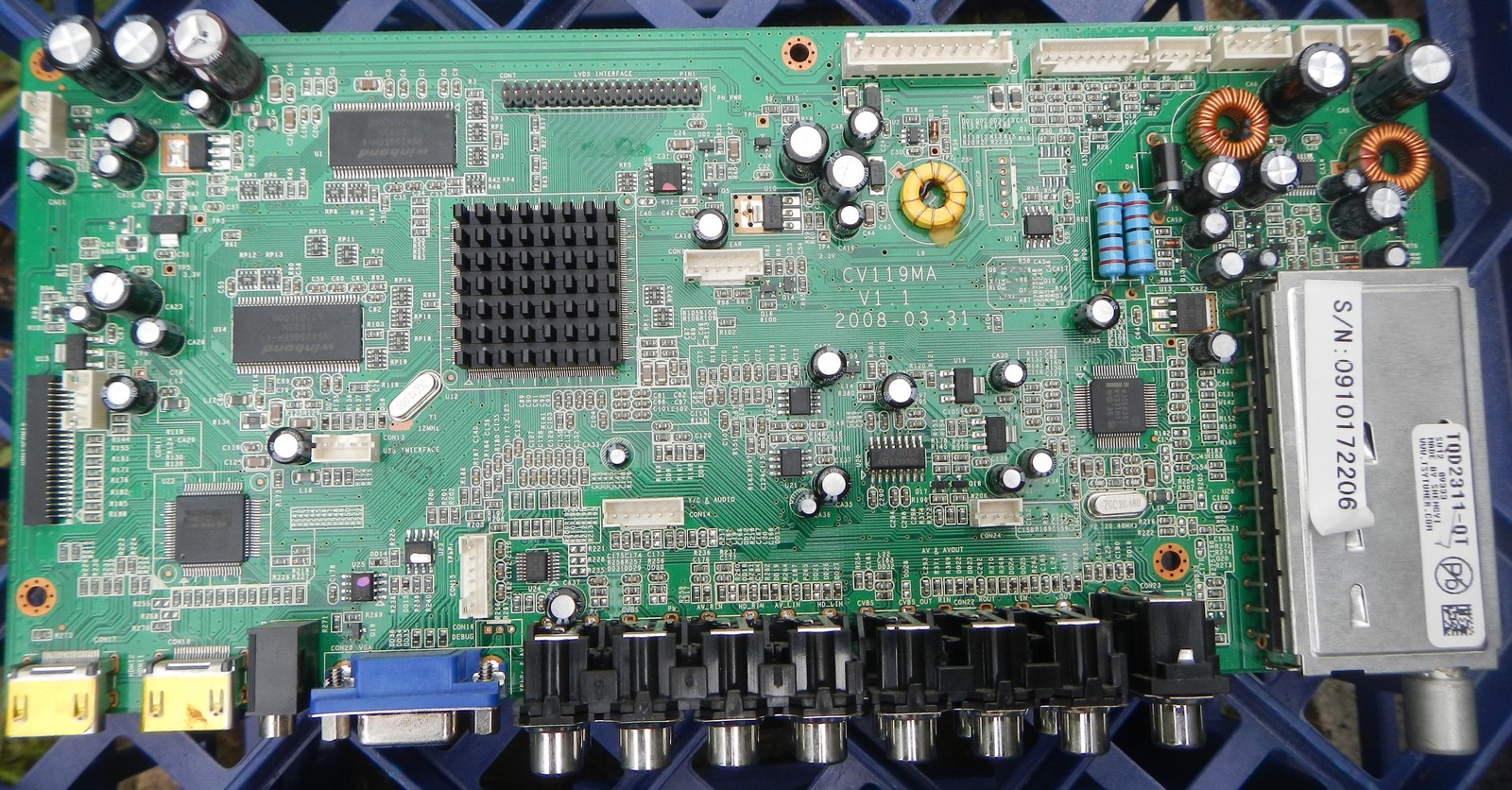

    This is the exact mainboard
    [MODEL NUMBER] - CV119MA
    http://www.cultraview.com/en/Products/view_82.html
    (and I found a "SERVICE MANUAL" for the "CV119MA" MANIBOARD which might be somewhat helpful)
    From my research it has the same mainboard as a few other TV's so although there are no specific RANK ARENA models mentioned on these forums doesnt mean my problem hasnt occured to someone before.. TV's that share the same mainboard that I know of so far are strangely all 32".......

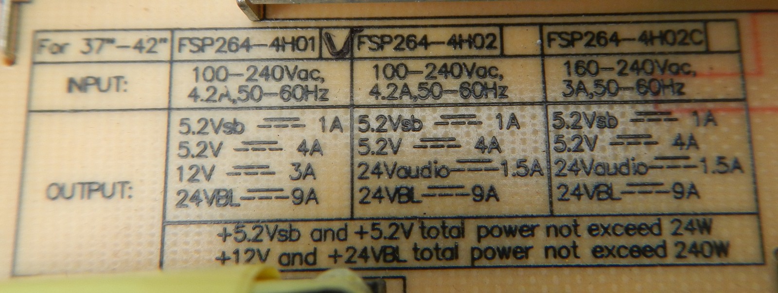

    The power supply model is
    E211940
    There is absolutely no change when I press the power button. I have also tried to power the tv up with the T-CON board DIS-connected and I get absolutely NO change, the exact same standby light blinking every 33 secs and nothing else.
    Is there anything else I can check here.?? I just dont know where else would I start looking for problems and at very least how could I tell if its the mainboard or something else doing this?? I dont even think the mainboard is something I can buy so its really either FIX it or BIN it (and I hate throwing good stuff like this away if I can help it)

      Well you seem to have most of the voltages in the right places.
      Have you checked the on/off switch and tried with remote?
      Make sure no buttons are stuck
      Pictures might help as even the one in the manual is not great.

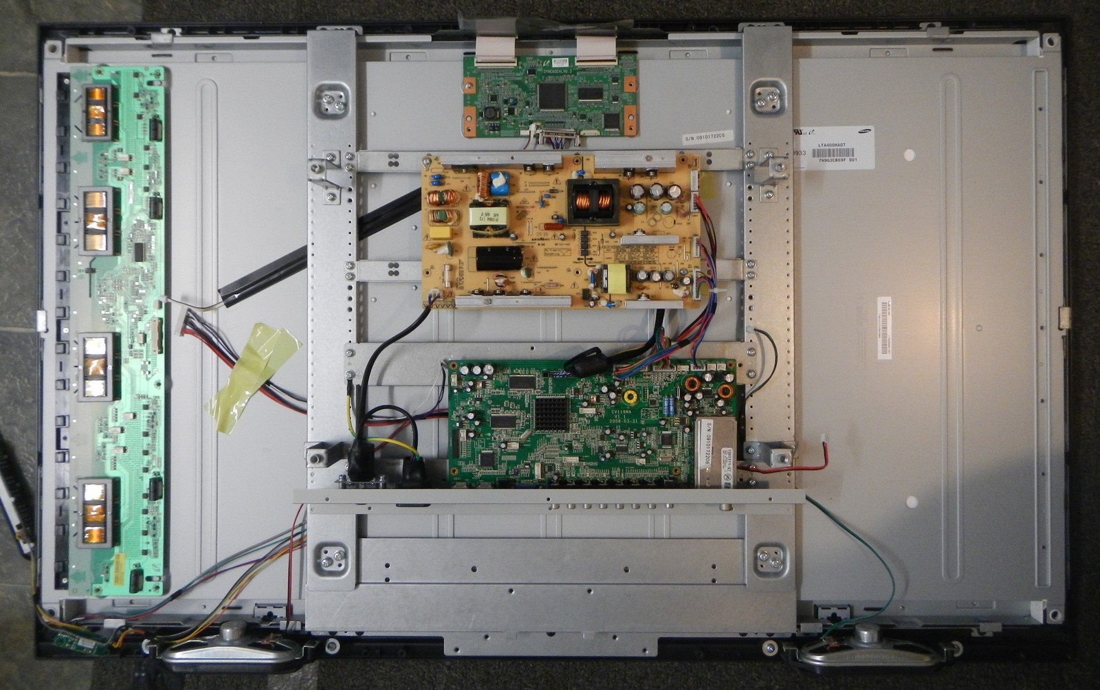

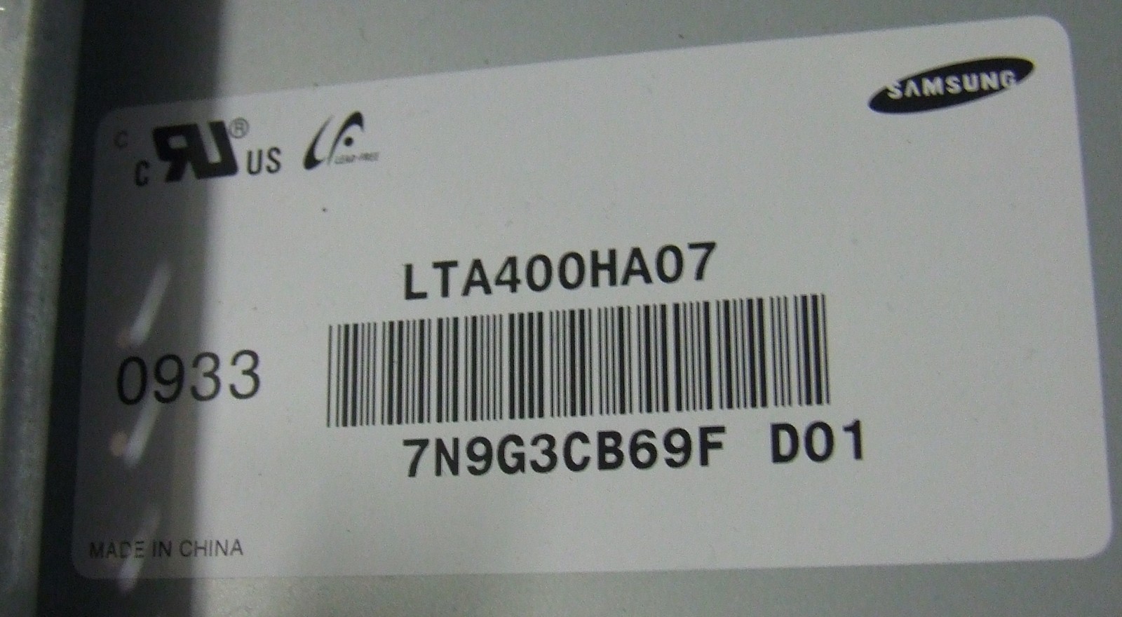

        Re: 40" LCD Rank Arena (rebadge?) has standby, V+ seem OK, but wont turn on.
        Thanks for the reply =)

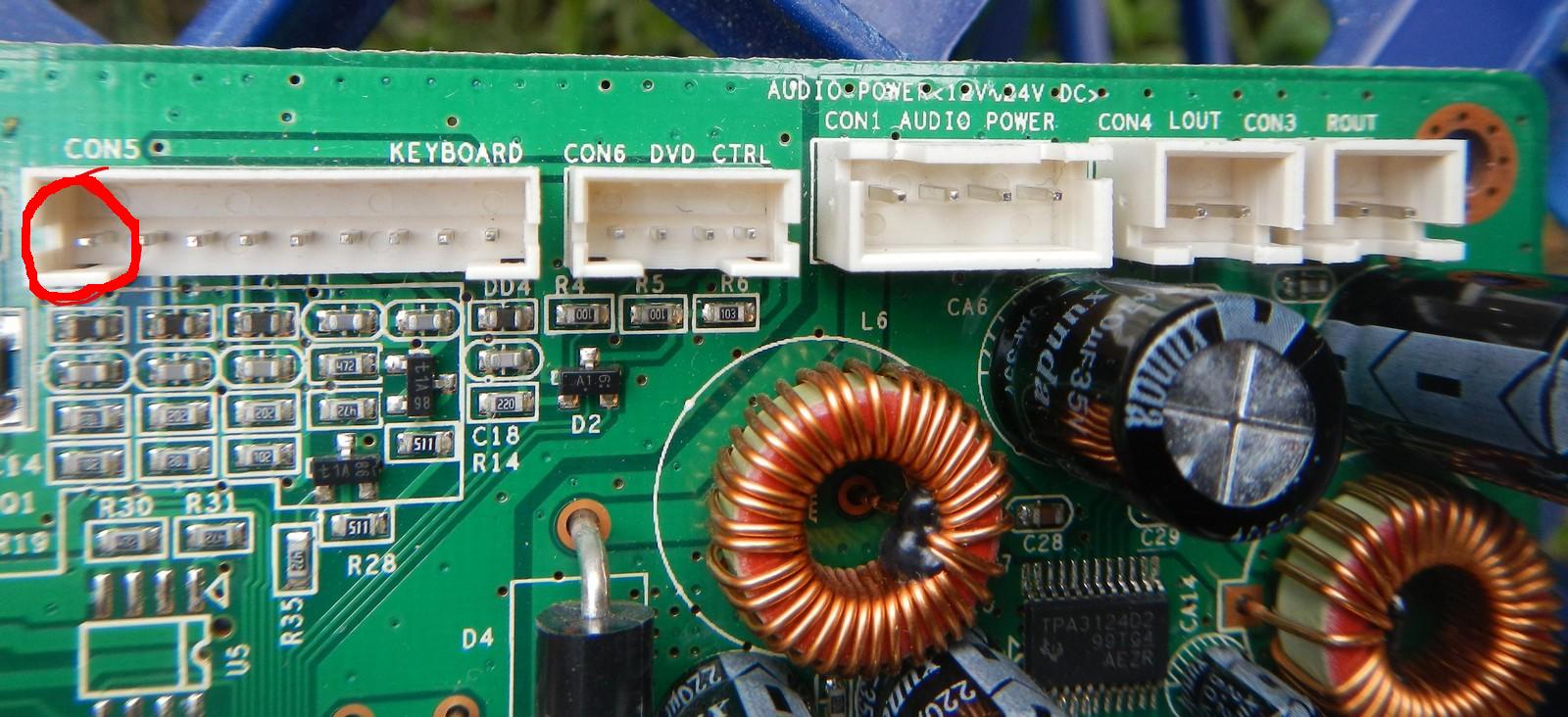

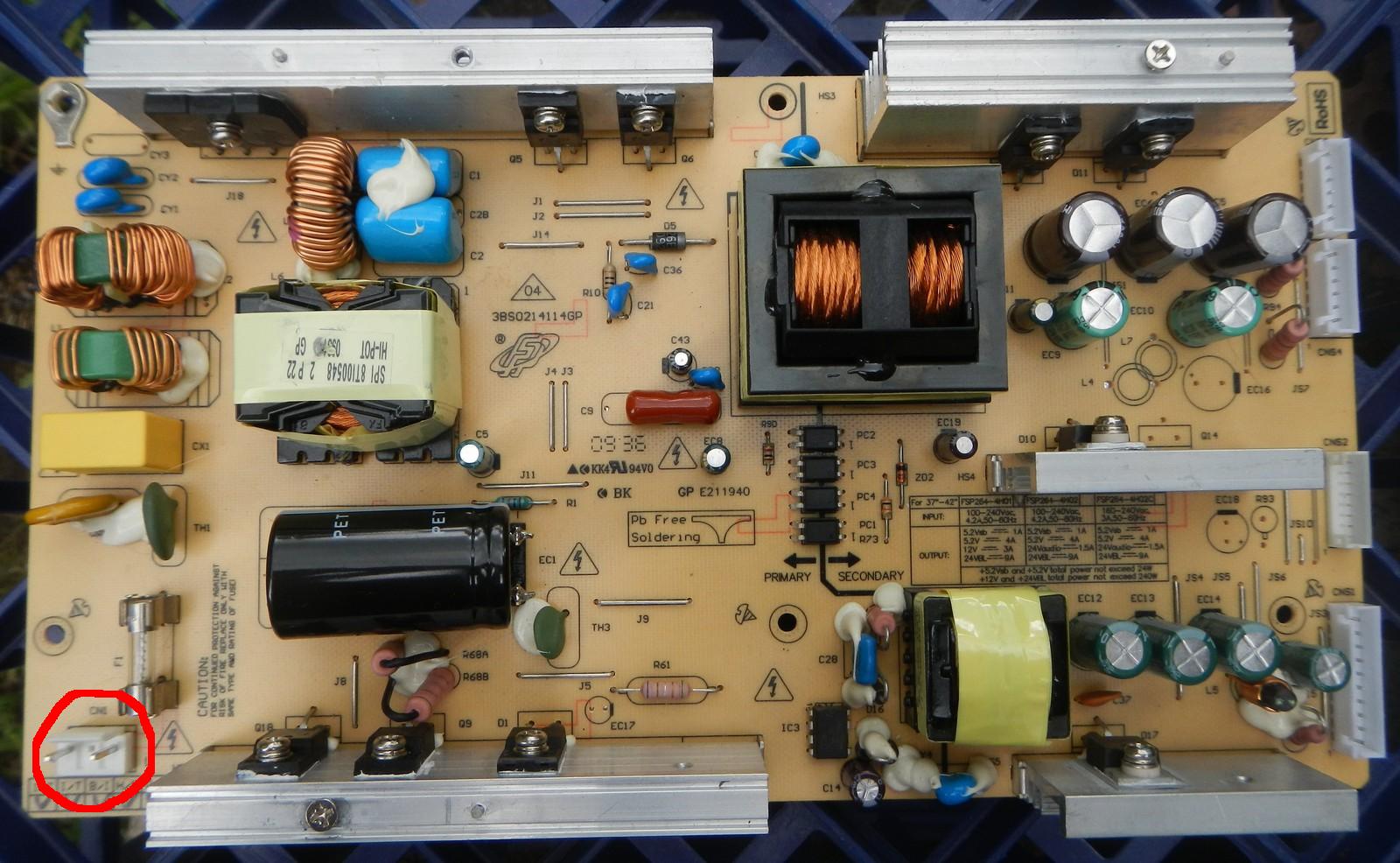

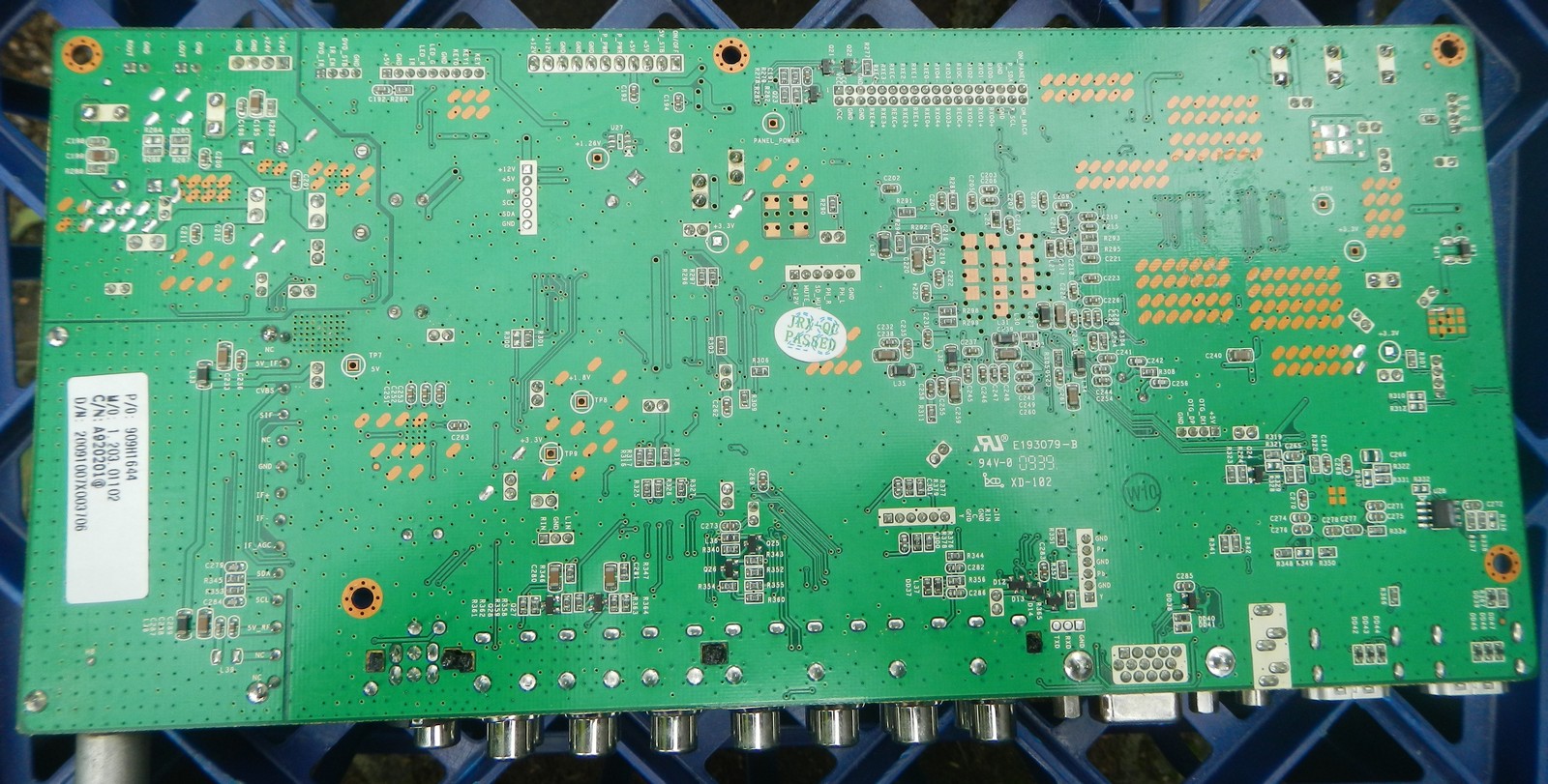

        Yes I tried the remote and also power button, same thing [nothing] happens both times. I checked the SMD switch itself with my multimeter (quick continuity test) and checked the remote with my camera. I also tried to hold ON for 10 seconds (over 10 actually) with no response.

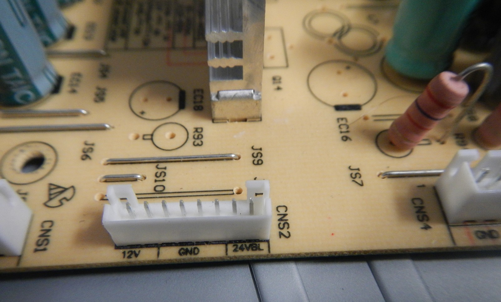

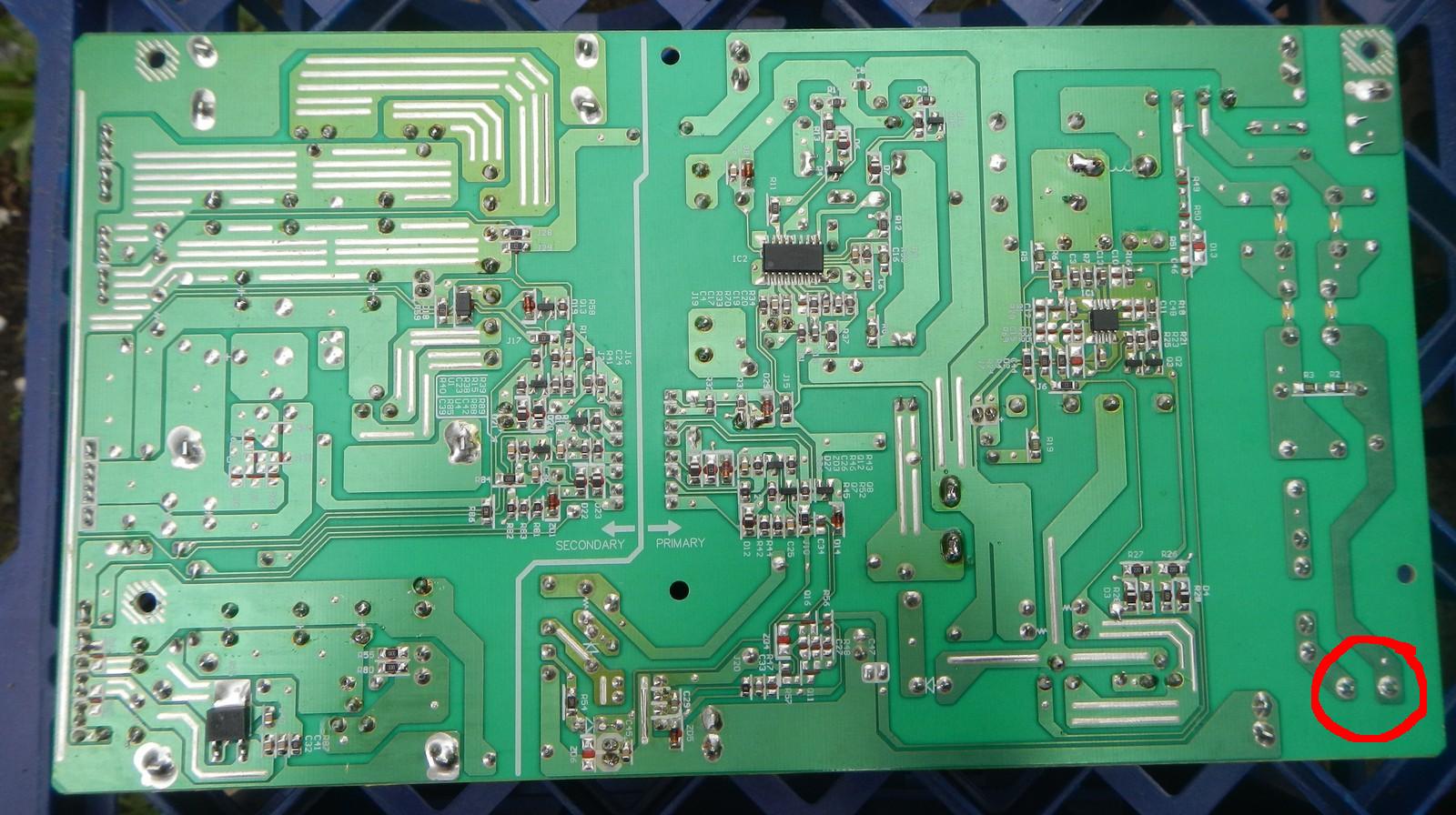

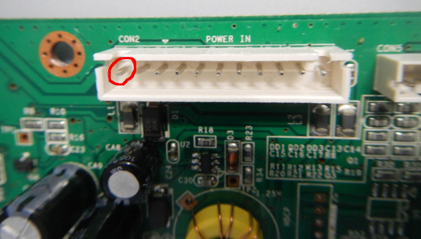

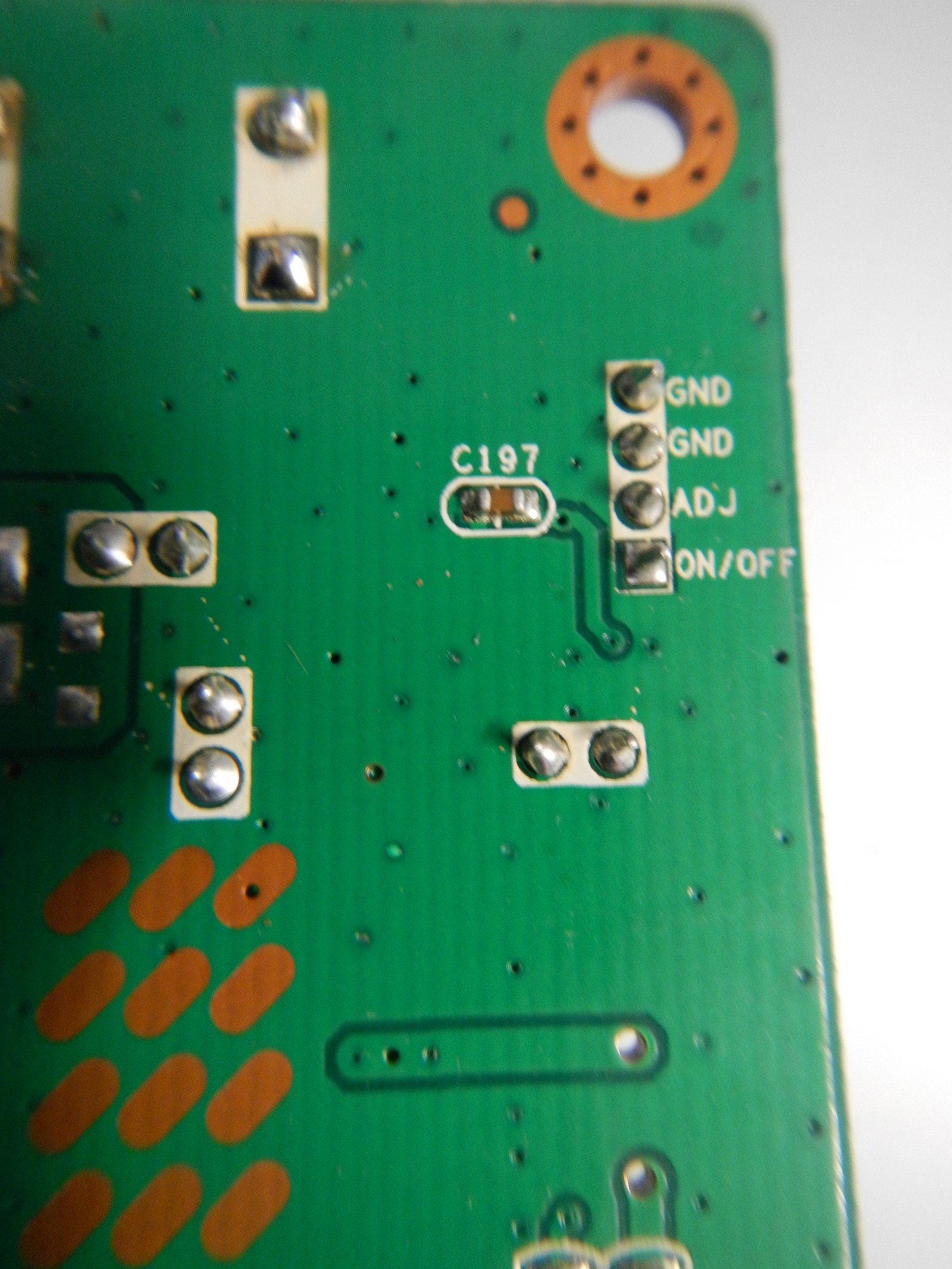

        Well here are the pictures I wasn't really sure what you meant by the orientation or about posting 'inline' ?? I just uploaded these as 'attachments' so I hope this works fine?? I downsized them all to save on bandwidth theres like 5MB of pics all up now.
        I also did my best to make it easy to look at, for reference I put a red circle around the "same pin" on both sides of the board, and I named all the pictures for easier sorting (hope it doesnt rename them)..
        I do hope I did the right thing here and havent taken to many pics.... :S

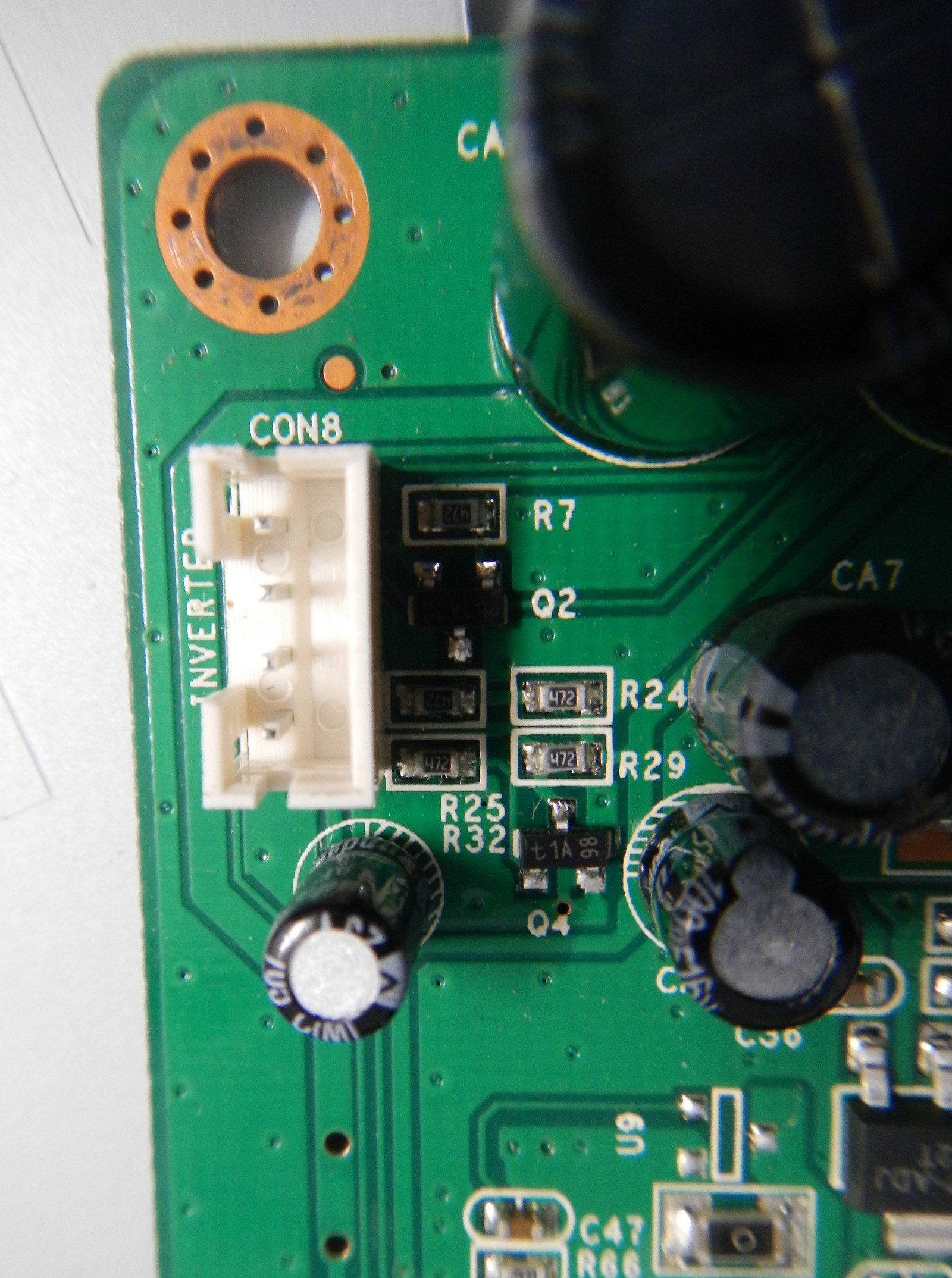

            You can try disconnecting the main board. With the main board disconnected, the ON/OFF should be 0V DC.
            If it is, then you can jumper 5V SB to pin 1 using a 1K resistor. That should at least light up the backlights on the TV.
            PS. On the main board, there are a number of voltage regulators. You can test them by following the "guides" link below. Report your findings in the format exactly as shown in the how to document.

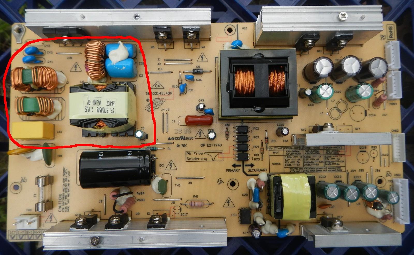

                All regulators are OK. Buzzing from the PSU or inverter?
                  Definitely from power supply.
                  It sounds like it comes from the area with the red circle. (top left)
                    When it buzzes, what do you measure across the large cap EC1 -- take care high voltage.
                      The voltage appears to rise with every 'zap' sound to around ~410V and when it goes quiet it drops off to ~390V before rising/zapping again.
                      I just had a listen and the sound actually seems to be coming from the transformer thats right there if it matters?.. Im pretty sure its not coming from the big filter cap..
                      (i used a toilet roll to 'pinpoint' the sound which I read to do on another thread

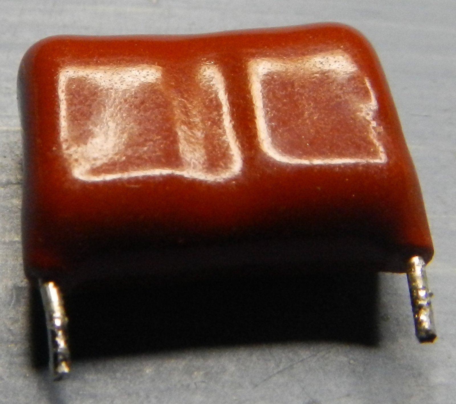

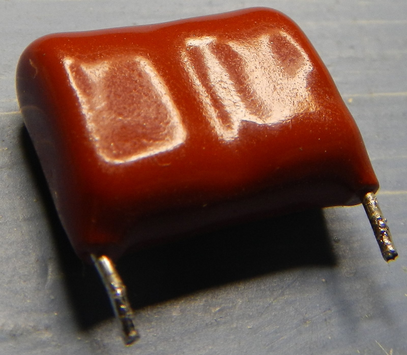

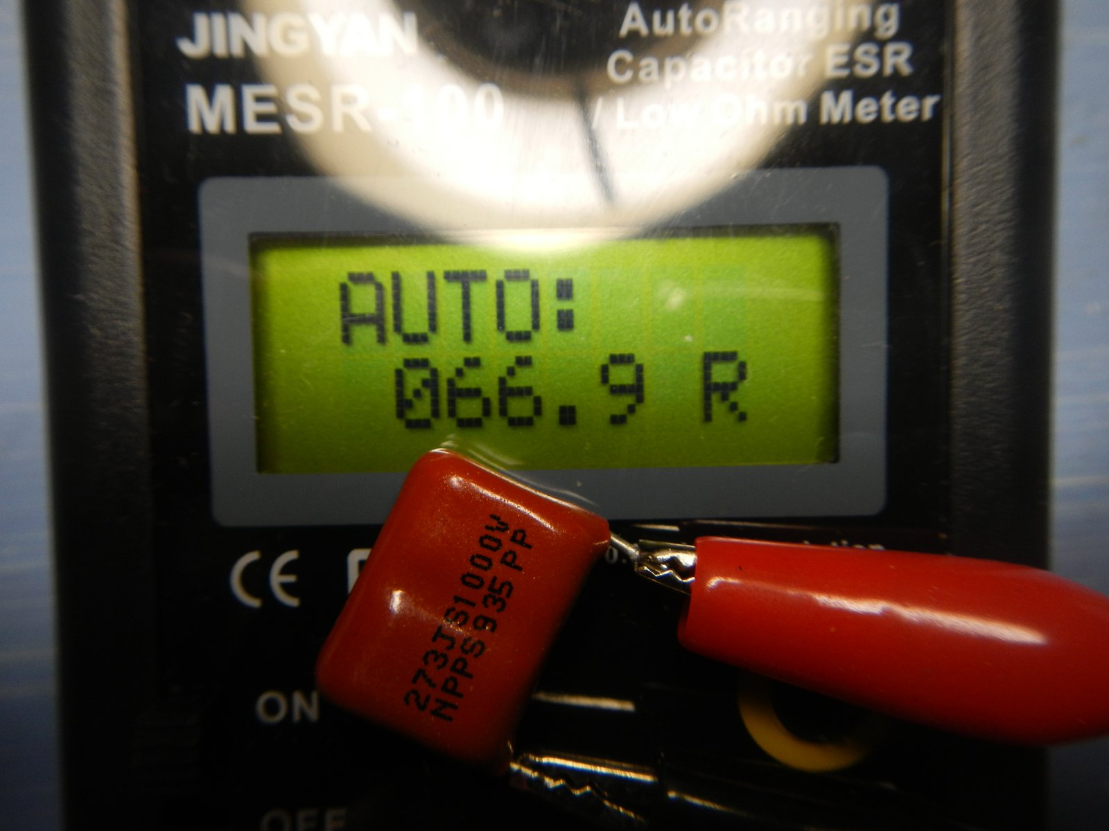

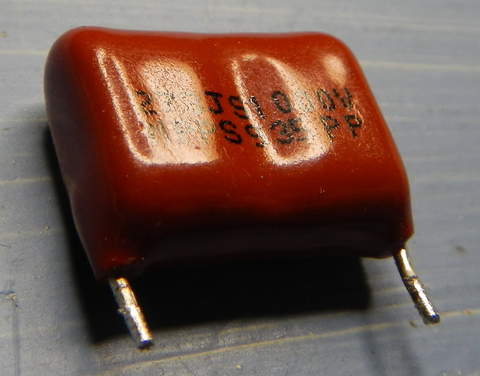

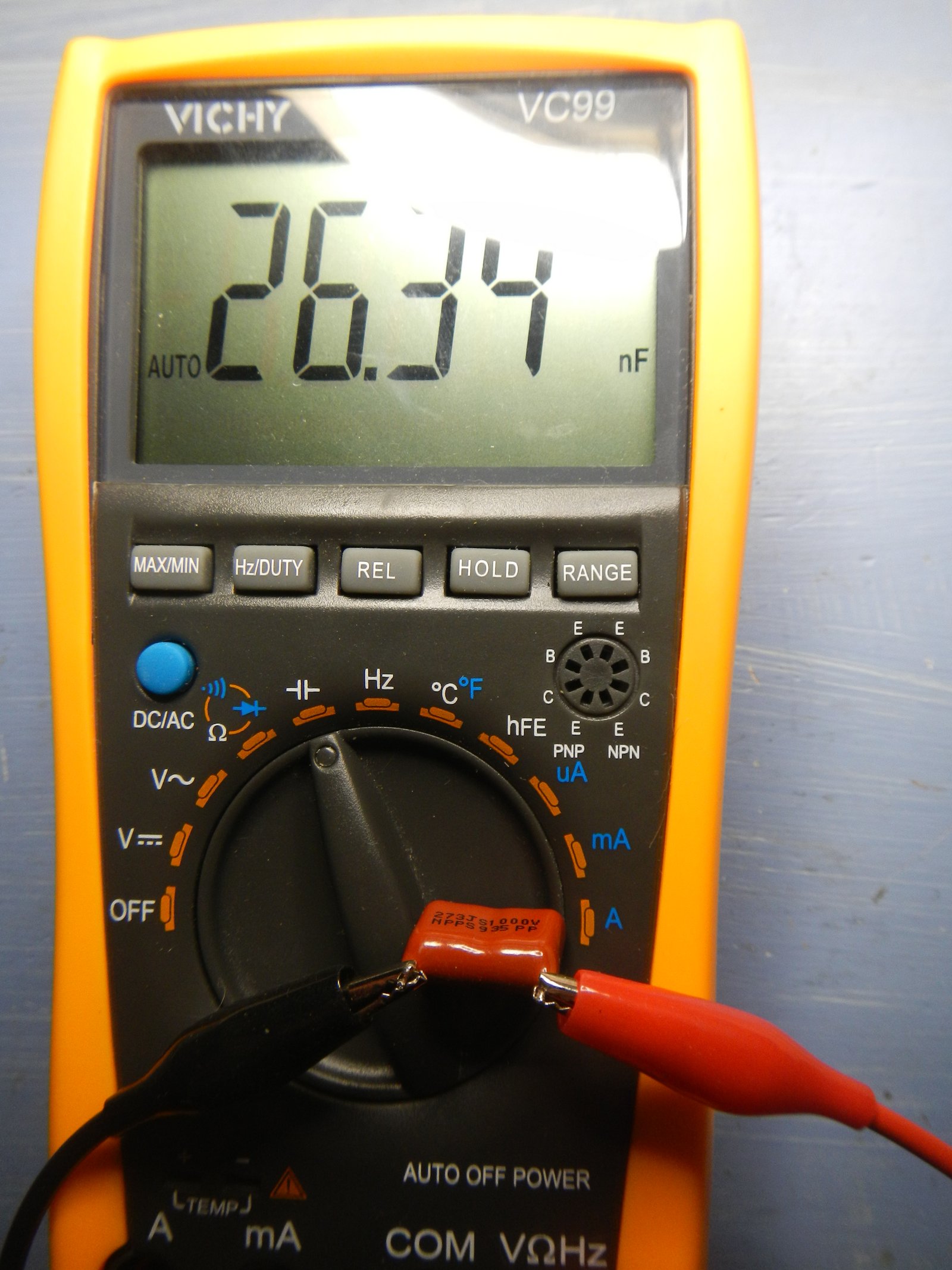

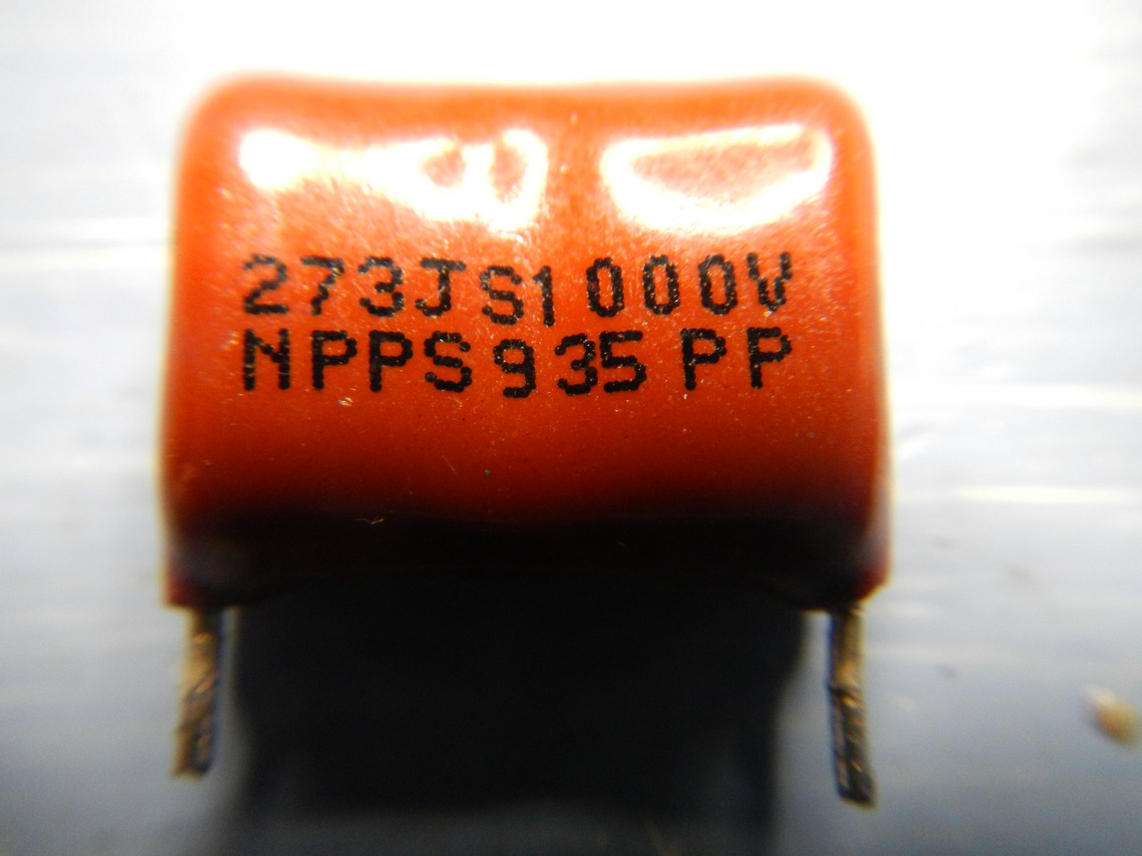

                                Can you take some close up shots of C9 the red cap it doesnt just look uniform along its length - havent seen one fail for some time but may be worth a look.
                                  I just replaced it with a nichicon cap I harvested from a old board I had here.. Exact same results as before
                                  (The board was 'good' & not exactly from a dead TV it came to me from a set who's owned decided to throw it on the floor to break the screen during a fight with their spouse, screen was all trashed and I harvested the boards, so I could use now I suppose..lol[well thats what ill tell the mrs later].)
                                    It's not uniform.. Here are some more pics for you good sir.
                                    EDIT: It looks like its supposed to have that 'dimple' in the middle from what I can tell..??
                                      It's good. You can't measure the ESR of such a cap though on a conventional ESR meter, due to the low capacitance.
                                        fair enough, I wasnt sure if it mattered so did anyways since wouldnt hurt,lol, but now I know thanks tom
