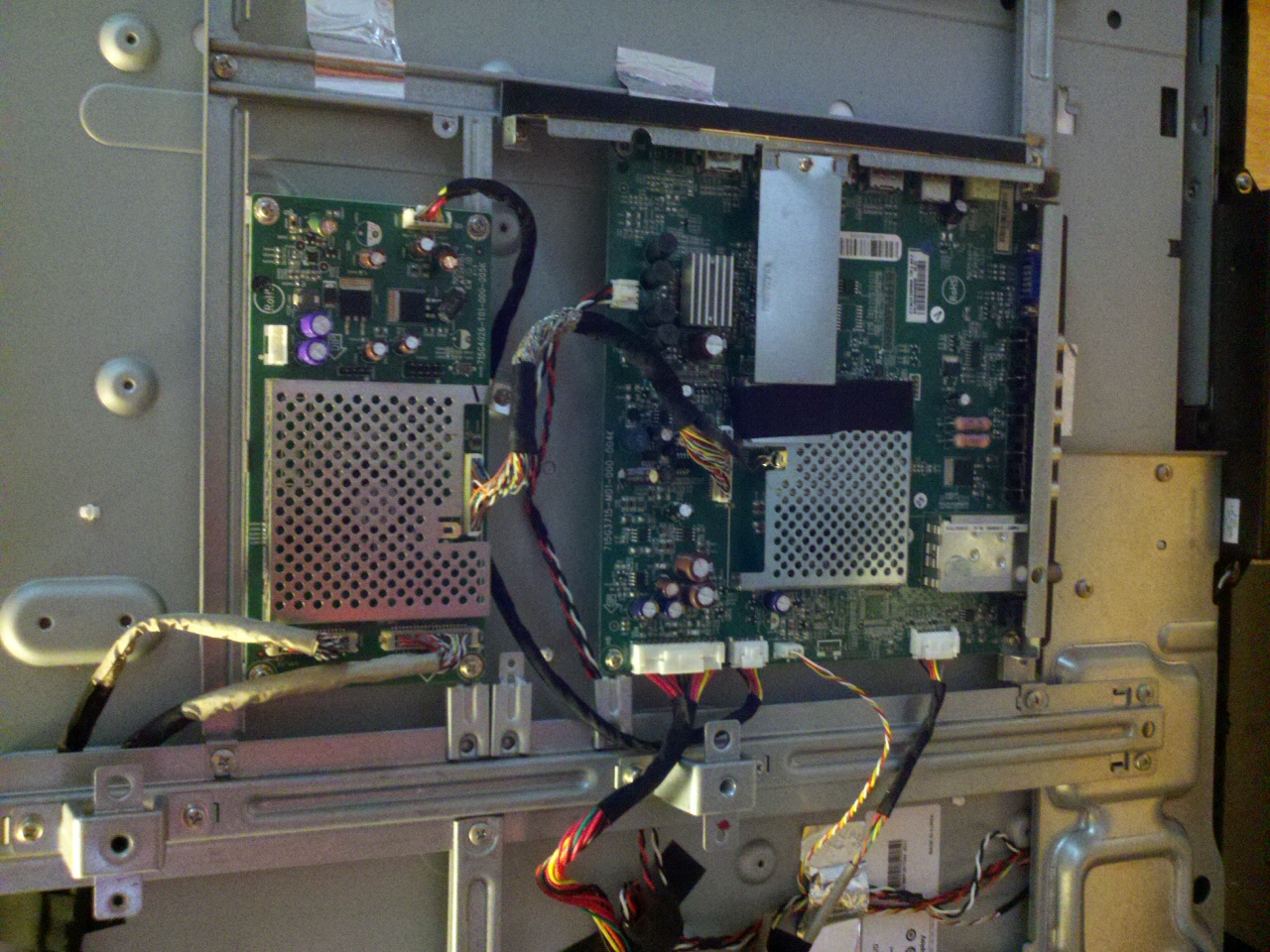

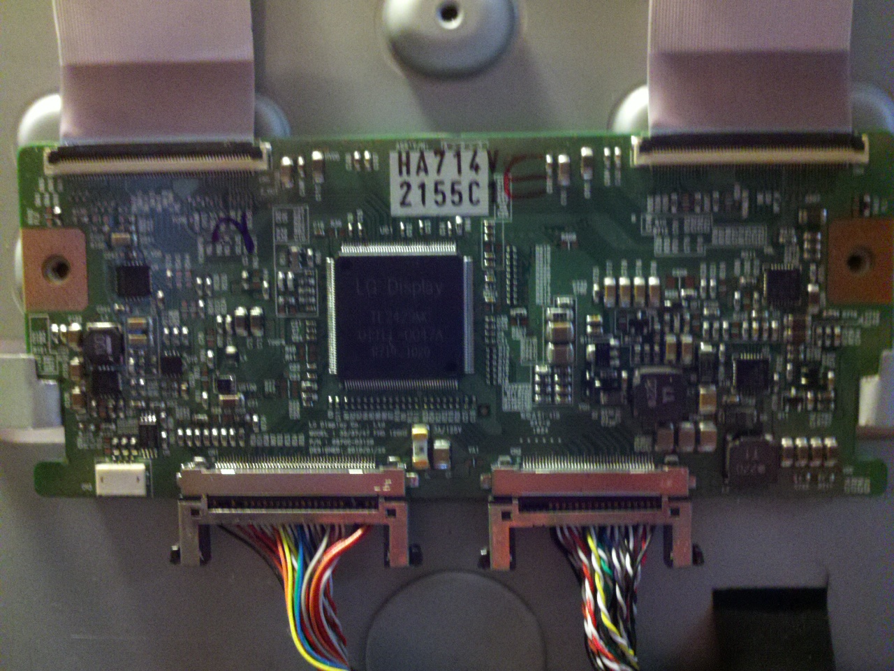

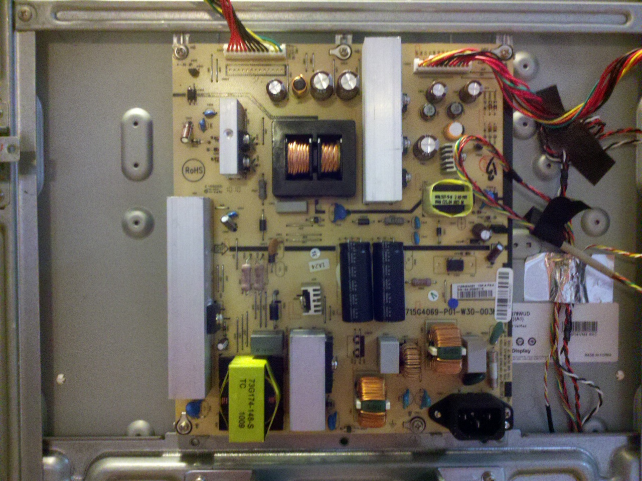

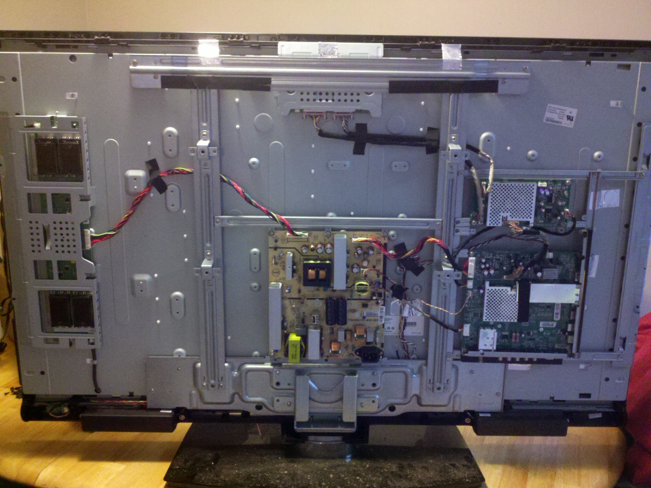

                            here are pics i checked for voltages seen small change like 1 volt now tv gives backlight but no menu.
                              Re: E470VA Flickers
                              So what voltage do you get at that white fuse on the T-CON board?
                                Re: E470VA Flickers
                                On fuse of T-con i get 11.88 then flickers voltage goes up 11.94.
                                  Re: E470VA Flickers
                                  Originally replaced main but seems i must have got bad main. replaced main again now TV plays beautiful.
