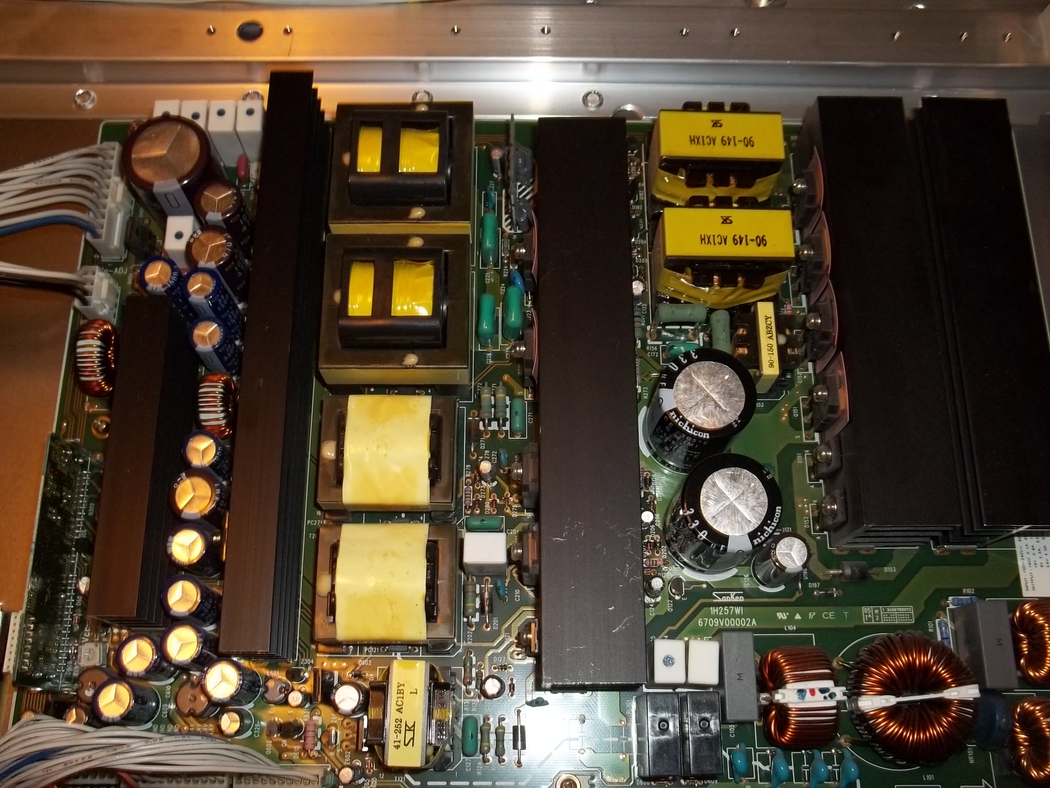

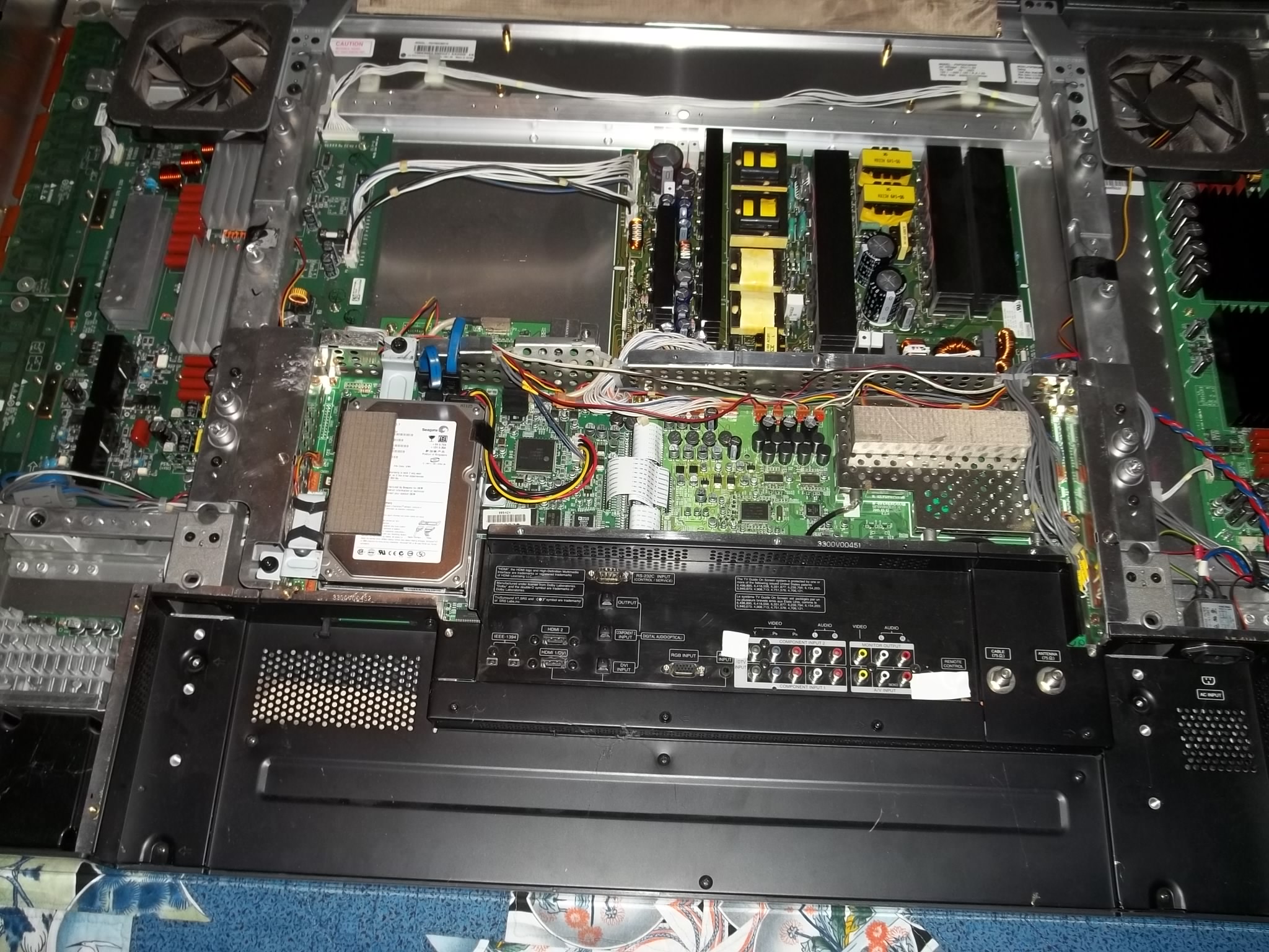

    I got a LG 50py2dr and just started to look at it. I took my chance and got it off of CL with some other tvs. I am fairly good with electronics and soldering, but really haven't done much with tvs.
    When I plugged the tv in, the orange light blinks 15 times then goes to a solid orange. LED 170, 901 and 302 all turn on immediately. I noticed the LED 301 doesn't turn on. There is no picture on the screen. Previous owner also included an extra y-sus board that he said didn't change anything. He said he couldn't remember what was wrong with the tv, but said the board made no change.
    Can someone help me with troubleshooting this tv. I can include photos or anything else if needed.
    Thanks!

    OK, top left of this board:
    https://www.badcaps.net/forum/attach...7&d=1359929387
    See the large connector on the PSU?
    Test the voltage on each pin, with all boards disconnected, with the Y-sustain disconnected and with the Z-sustain disconnected.

      Re: LG 50py2dr Troubleshooting help
      Tested voltages then disconnected the y and z sus and getting zero volts on Va and Vs on all readings. Tested continuity between ground and Va and Vs and it buzzed.
      Does that indicated the power supply is not working and there is a short somewhere?
      The fused tested good and just visual looked over the caps, which also looked good. I haven't pulled the board out yet to test ESR or other components.
        Hold the meter in the continuity range across Vs/Va -- may take some time for the caps on PSU to charge up, does not indicate fault. If it stops beeping no short on PSU, have a look at main board and see if it is sending power on signal.

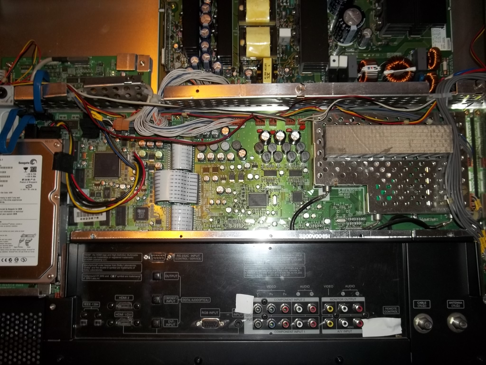

          You were correct on the Vs/Va. There is no continuity between the two. Hate to ask, but how do I see it its sending a power signal? Just not sure on all the abbreviation and such.
            On one of the many connectors going to the video board (has AV inputs on it) there will be a pin marked VS ON.
              Thanks again. I measured VS_ON and it's zero volts.
                So main board isn't turning on PDP. Check AC DET.
                  My guess is that is the same as AC_ON? If so, it was 4.29 Vdc.
                    When you press the power button, what happens -- make a note of any relay clicks and changes in VSON.
                      I hear one click and the VS_ON is virtually zero. It something like 5 mV and changes to 9mV. When I turn the TV off, it makes the same one click sound.
                        So, the main board isn't turning on the VS voltage, the fault is probably with the main board.
                          At this point, what would you recommend? Just replacing the main board or is it possible to troubleshoot it?
                          Thanks for all the help.
                            Try with an LG remote first...
                            Check side panel buttons.

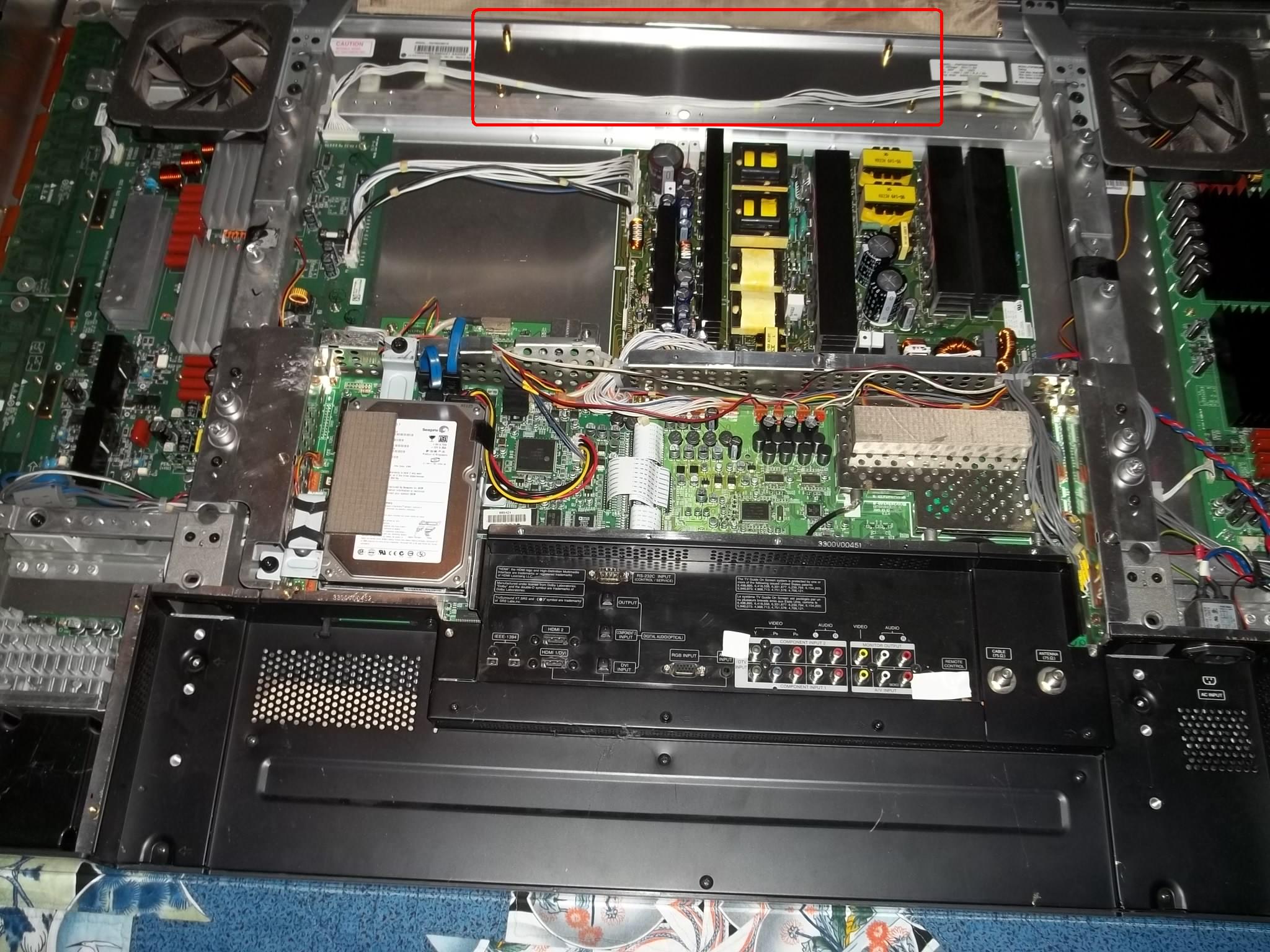

                                I am hopefully going to get the remote and some time to look at this again. If main board doesn't respond to the buttons or remote, what is might next step?
                                Also, is there something missing in the red box? Can't find another photo of the set. Seems odd that there are screw holes, but didn't see any connectors that would go to another board.
                                Thanks again!
                                  Some models have a different fan there, instead of one fan over each sustain board.
