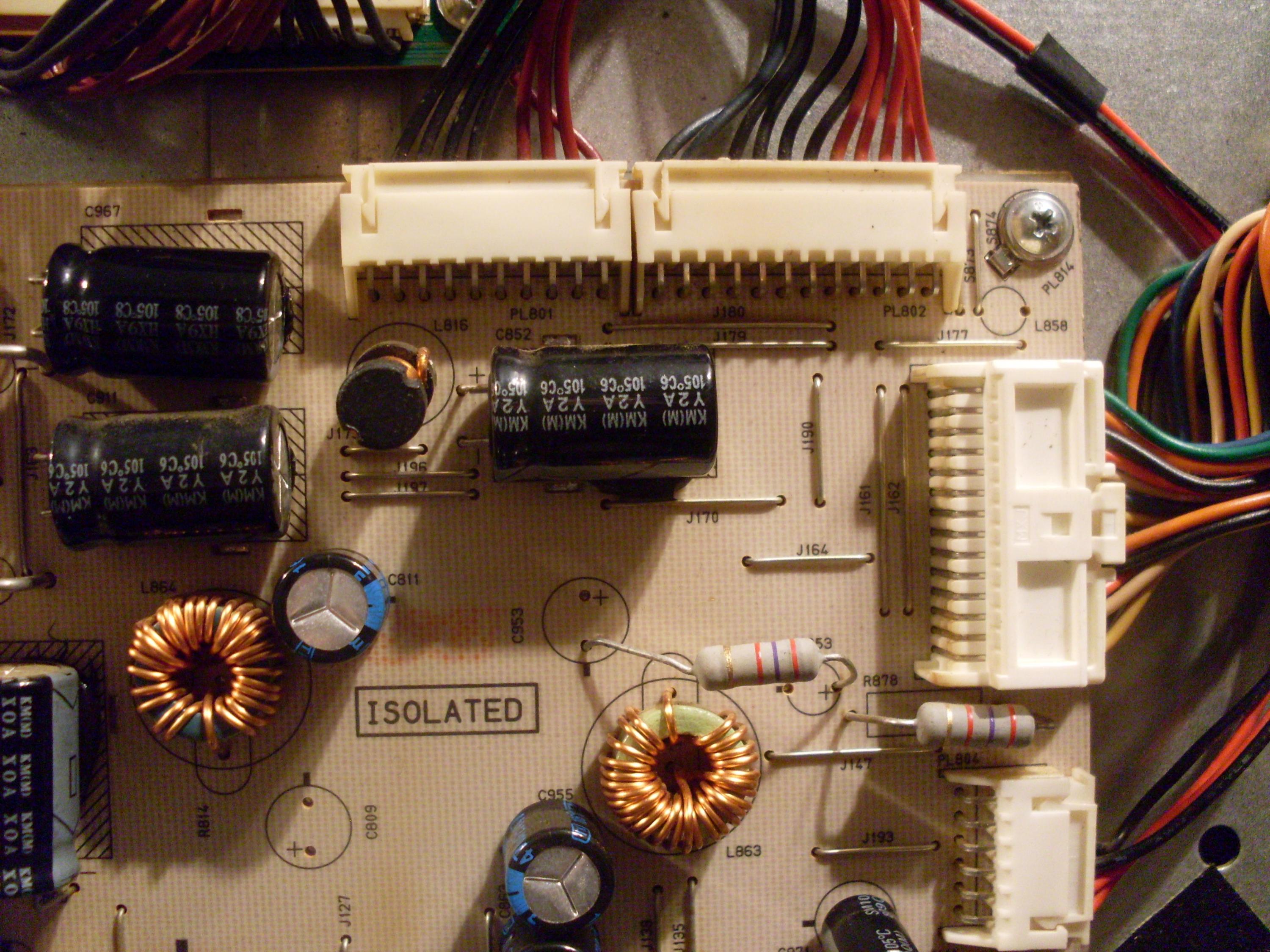

    Hi folks, first post, be kind
    Pretty certain the fault with this is the PSU. It's a Vestel 17PW01-4. There were 5 bulging caps on the board that I had replaced, and the guy who did it said there was also a dry joint that he fixed. However, when it was refitted it still doesn't work. Just shows a solid blue light (standby). When using the remote you can hear it try and start up, it clicks, but nothing happens.
    The five capos I replaced were the one just under and to the left of the ISOLATED marker on this pic http://www.lcdtvparts.co.uk/index.ph...image&pID=2103. Those 5 were bulging.
    I think I'm going to give up on the analysis of the fault because I don't have the expertise or equipment to go any further. I decided just to look for a replacement, but they're almost impossible to find.

        Across each of the capacitors you replaced, can you measure the voltage on the DC 200V scale, on the isolated side. (Don't worry -- you're not measuring 200V, the highest voltage on the isolated side is around 33V.)

                    OK, opened the TV up today.
                    I can't see how it's going to be possible to test the voltages across the capacitors as their connectors are far too short to get a multimeter to contact. There is no space between the bottom of the capacitor and the pcb. I considered taking out the board and bench mounting it to test on the reverse, but thought better of it.
                    As an aside, I trusted the guy who did the replacement to do it right, but I notice that the caps replaced are a different physical size to the originals. Specifically the 2 arranged above each other just below the Isolated marker are bigger. All 5 capacitors are marked Jamicon 470uF25V.
                      Re: Technika LCD42-910 Stuck in standby
                      Jamicon caps are no good... and can cause a lot of issues.

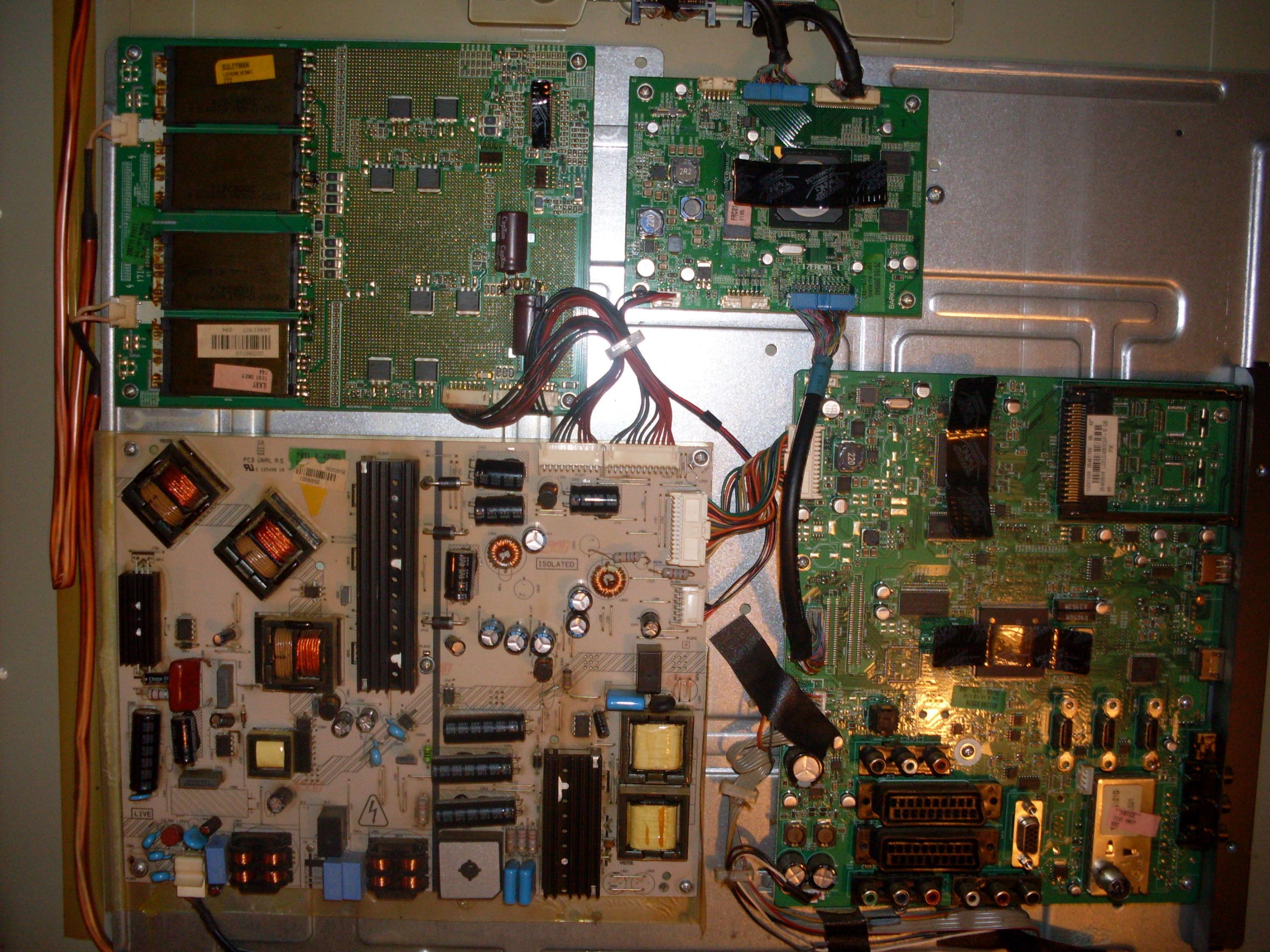

                      As I've no schematic for this can you supply a close up pic of connector on PSU, the one that goes to the main board?
                        Hopefully these are the photos you want. I've taken a shot of the back of the TV with all boards on display, then a close up of the connectors at the top right of the PSU.
                                  What do you measure (volts DC, 200V range) across those brown CapXon capacitors on the inverter board? The inverter board is the green board top left of this image. https://www.badcaps.net/forum/attach...1&d=1360011712
                                  • KevT
                                    • Feb 2013
                                    • 17
                                    • England
                                    Not getting any reading across them at all, maybe less than 1v if I turn the scale down. Guess this means they are getting no power at all?
                                    I can hear the power board clicking and whining, and the on/off button attempts to do something, but the TV remains stuck in standby.
                                      How many rows of pins does that connector going from power supply to main board have?
                                      • KevT
                                        • Feb 2013
                                        • 17
                                        • England
                                        Assuming the main board is the top right one, there's one row (PL804). Both connectors (PL801 and PL802) to the inverter have 1 row. The connector to the IO board (PL814), with the scarts, hdi, etc, has two.
