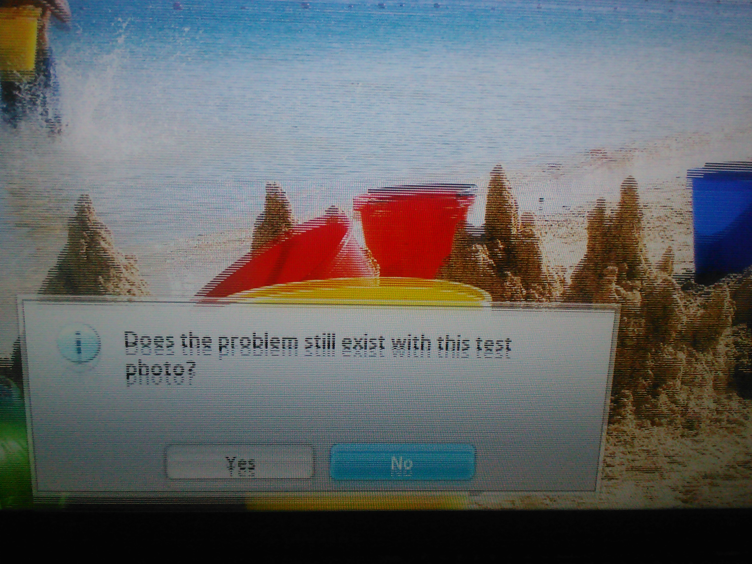

    samsun un46d6000 led tv with blurred double image
    tv is 14 months old and hardly ever used. was working fine this morning then all of a sudden the image is blurred,. looks as though there is a double image that is a half inch lower. it occurs on all inputs, tv menus. Samsung said it is 2 months out of warranty and i could pay for a tech to come out. I am fluent with a voltmeter but dont have much tv experience other than changing amplifier chips in a few rear projection tvs. from research I am suspecting tcon board, main board or panel. any suggestions on how to pursue troubleshooting and repairing this tv? thanks in advance

        Re: samsung un46d6000 led tv with blurred double image
        here is a picture of the screen. ill add a pic of the tcon board. i am looking at ordering a replacement board as I have found several at a reasonable price. if there are any tests that I can do other than visual inspection and reseating the ribbon cable, I would like to hear of them. Thanks for all the help!!!

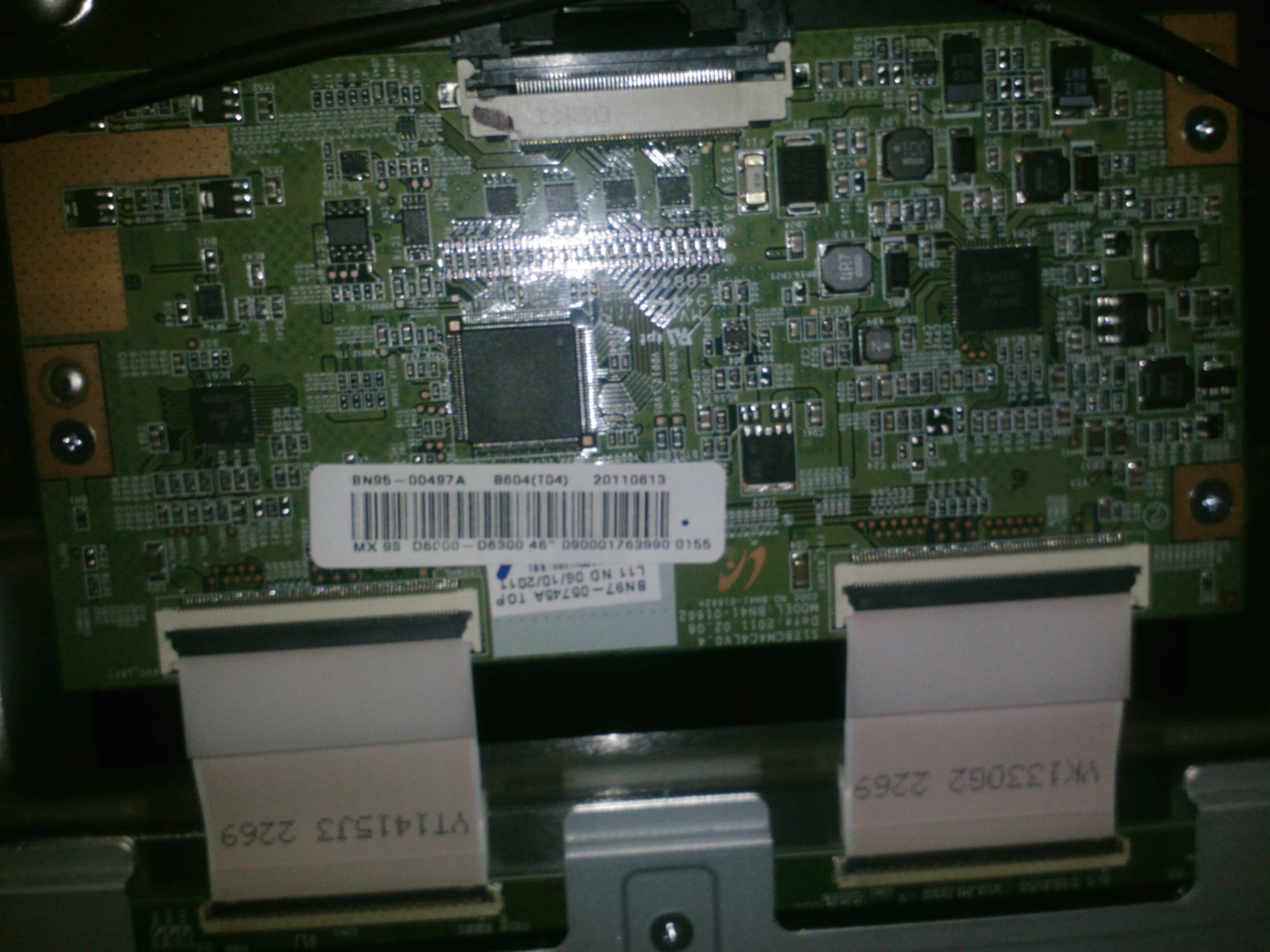

          Re: samsun un46d6000 led tv with blurred double image
          tcon board is a bn95-00497a also has a model of s128cm4c4lv0.4 code#bn41-01662a
            That can be the bad tab bonding also.
              thanks again for the replies. i considered the bad tab bonding as well, but considering it is even on the entire screen and there are no spots that are clear, I concluded that the panel and tabs should be ok. My thought was that if it were a tab or panel that it wouldn't be uniform on the entire screen as it is. Maybe I am wrong. I ordered a tcon board today and should have it mid week. For $22 I figured it was worth a try. If it doesn't work Ill have to dig into it more. Thanks again, I appreciate all the great people sharing their knowledge!
                I have seen whole screen distortion with bad tab bonds. Depending on the design it is definitely possible.
                      heres an update, received the new tcon board today and installed it. powered up the tv and the picture was the same as before so unfortunately it wasnt the tcon board. Looking for suggestions now. any way to troubleshoot whether it is the main board or panel??? looking for suggestions. Thanks everyone. I called Samsung and the vendor i purchased it from and both were happy to send out a service tech at my expense as the warranty is up by two months. this is my parents tv that is in their home they only visit once or twice a month so it is hardly used.
