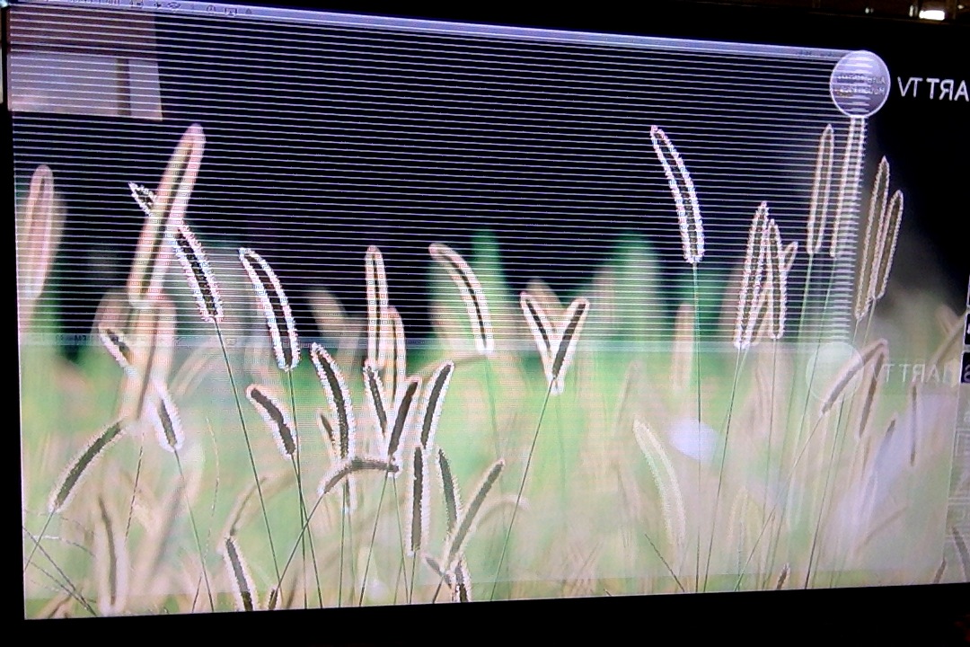

    i looked at the tv briefly today, i didnt have my meter with me to test voltages on the power supply. i did find that with one ribbon cable unhooked half the screen works great, when you plug it in it returns to a double image. i found that if you plug the ribbon cable in but dont close the lock and apply pressure in the right spot, i get the tv to have a clean and clear picture like normal. i am now thinking it is a bad ribbon cable from the tcon board to the panel. this number is printed on it: YK1330G2 2269. i am going to research a replacement. hope this fixes it!!

        i tried 4 different cables and also replaced power supply with a known good one. still having same issues. I am able to release lock on panel ribbon cable and hold in a certain spot to attain a good picture with minimal display issues but do see very small lines. any other advice? bad panel???

            Seems like a bad panel. Everything in the TV was replaced and the problem persisted. There's only the panel left.

                Hi everyone! I have one of these on my desk right now, and I've been doing the regular troubleshooting for blurred images (reseating ribbon cables, panel tabs etc, checking voltages on the t-con and main boards). I cleaned all of the cable connections to remove any static buildup, but that did not work. Searched and found this thread with a similar problem.
                Here's an image of the problem- double lines everywhere, and the picture keeps jumping.
