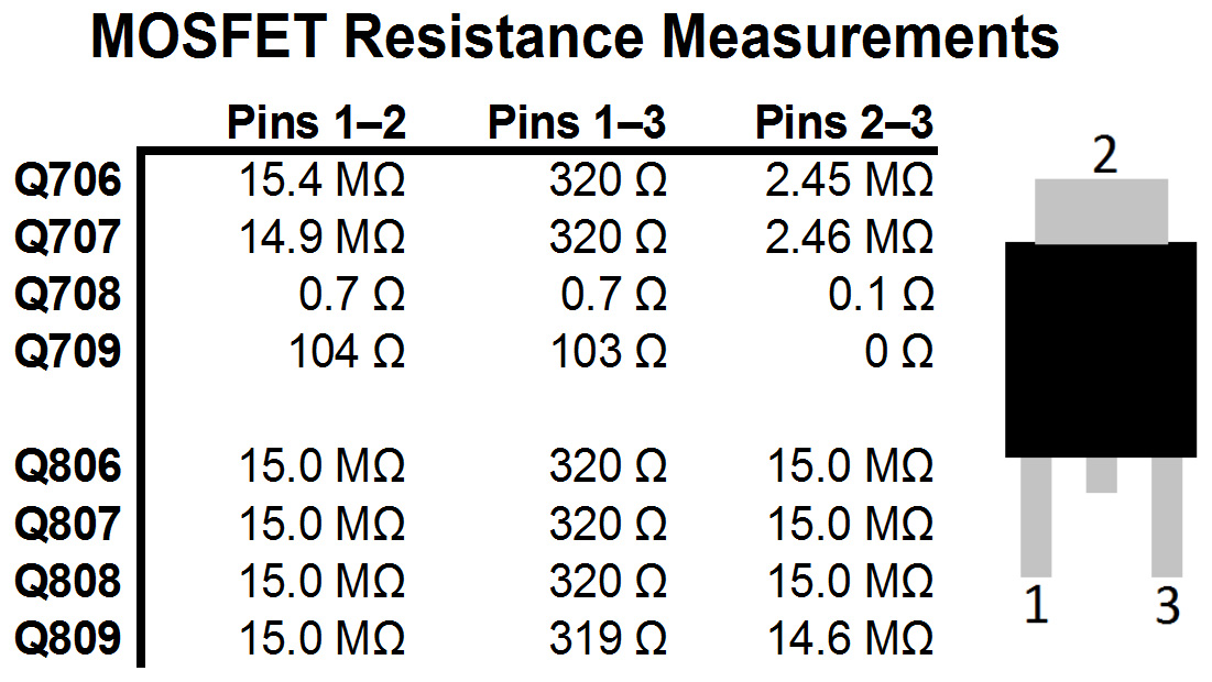

          Before testing, I measured the voltage across both C909 and C910. Both had discharged since my last session of testing.
          I then measured for resistance across the points contained within the box marked "GR3." I am using an auto-ranging multimeter, and it read "0 L," which seems to indicate "infinite resistance" according to my Googling.
          I also measured the resistances of eight MOSFETs on the rear of the board. I created a spreadsheet of the values and have attached a screenshot.

            Re: Vizio SV422XVT no backlight, photos and details inside
            Suggests q 708 and Q709 are faulty - procedure is to remove them from the board to re-test - what are the part numbers on those two?
            EDIT - I see you have posted the part no.
            Probably one of these
            http://www.alldatasheet.com/datashee...D/FDD5N50.html

              I thought the values for Q708 and Q709 looked suspicious. I will report back when I've located my soldering iron and desoldering braid for testing again off the board.

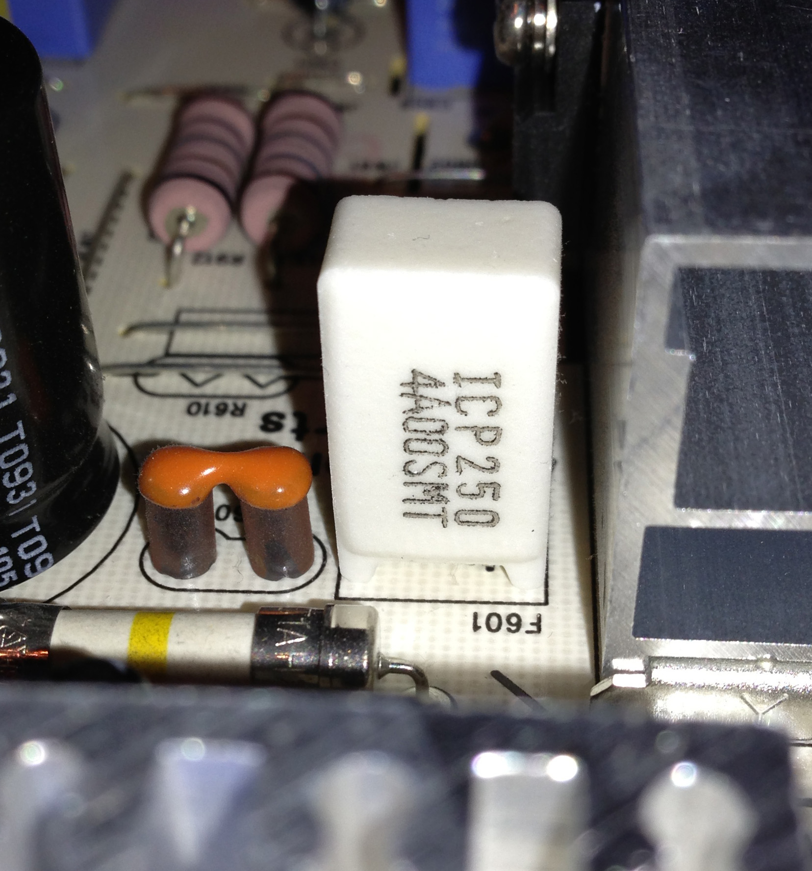

              Does my testing indicate that fusible resistor F601 is also faulty? I've attached a photo for help with identification. I haven't had any luck finding it by Googling the text "ICP250 4A00SMT" printed on its side. The closest I came is this TV repair blog post, which features an "ICP250 3A00SMT."
                Yes, that fuse resistor is blown due to shorted out MOSFET.

                  The blog post I mentioned earlier suggests TWW5JR15E as a substitute for ICP250 3A00SMT. Note the differing digit on the part numbers, "3" rather than "4" on this TV's ICP250 4A00SMT. I haven't been able to locate specs on this fusible resistor.
                    It's this part (search ICP):
                    4A rated = 0.11 ohm.
                      Great job finding the spec Tom.
                        Thanks, Tom! According to that spec sheet ICP250 4A00SMT is 250V, 4A, 0.11 Ohm.
                        Before your post, I chatted with a Digikey representative and he offered this TWW5JR10E as a possible alternative. It is rated at 5W and 0.1 Ohm. Does this look like what I need?
                          Only problem is it's not fusible, I'm not sure if that will matter too much though as it will likely only move the failure from that resistor to the main fuse.
                          The lead spacing is correct, but the replacement device is a little wider by 4mm. Do you think you could still fit it in?
                            Personally, I'd consider one of these devices:
                            http://www.digikey.com/product-detai...MCT-ND/2813098
                            If a 0.1 ohm resistor carries 4A max, it will dissipate 1.6W. This device is fusible and can handle 2W. The TV should use under half an amp for the backlight (@400V) as it's a fairly modern, efficient LCD TV. So I reason this device should be OK, especially as it provides the fusible option. Inrush is probably provided by the main NTC thermistor, so it's not a necessary feature.
                              I like your suggestion of the fusible resistor vs. the one I had offered. I should have no problem fitting an axial lead component in place of the existing radial one.

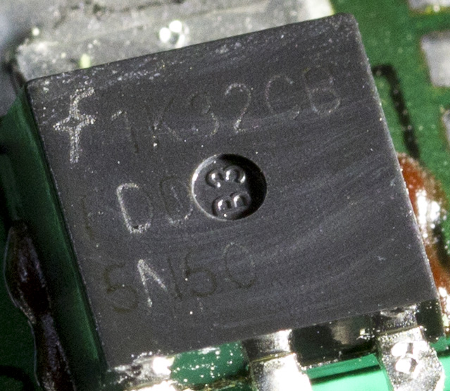

                              I will attempt to re-read the part numbers on the defective MOSFETs and report back.
                                #35
                                If you get the part # we can look up the specifications and find an equivalent device.
                                  #36
                                  Try using Alcohol to remove the flux off the body then you may be able to read the numbers on it.
                                    I've attached a macro photo of Q709. As far as I can tell, it says:
                                    1K32CB
                                    FDD
                                    5N50
                                    A DigiKey rep was unable to cross reference that number. I understand the lowercase script 'f' indicates a Fairchild part.
                                      in post 16 gustagen said
                                      The eight transistors you've circled all seem to have the same part numbers. They are all very difficult to read because they seem not to have been stamped hard enough for all digits to be clear, and are coated with a shiny, gummy substance. Using a magnifying glass and piecing the part numbers together from each one, I'm confident they say:
                                      1K32CB
                                      DD
                                      5N50
                                      from that I said post25
                                      Which suggests one of these?
                                      http://www.digikey.com/scripts/dksea...eywords=DD5N50
                                        Selldoor's URL didn't work, but it is here
                                        http://pdf1.alldatasheet.com/datashe.../UTC/5N50.html
                                        Sometimes when looking for part numbers, the first line is not always the actual part number. I, too, tried 1K32CB first but couldn't find anything.
                                          I had previously reported the second line of text as DD, instead of FDD.
                                          I found this page at Fairchild Semiconductor which seems to indicate the top line of text refers to factory and date codes.
                                          EDIT: Looks like retiredcaps beat me to this!
