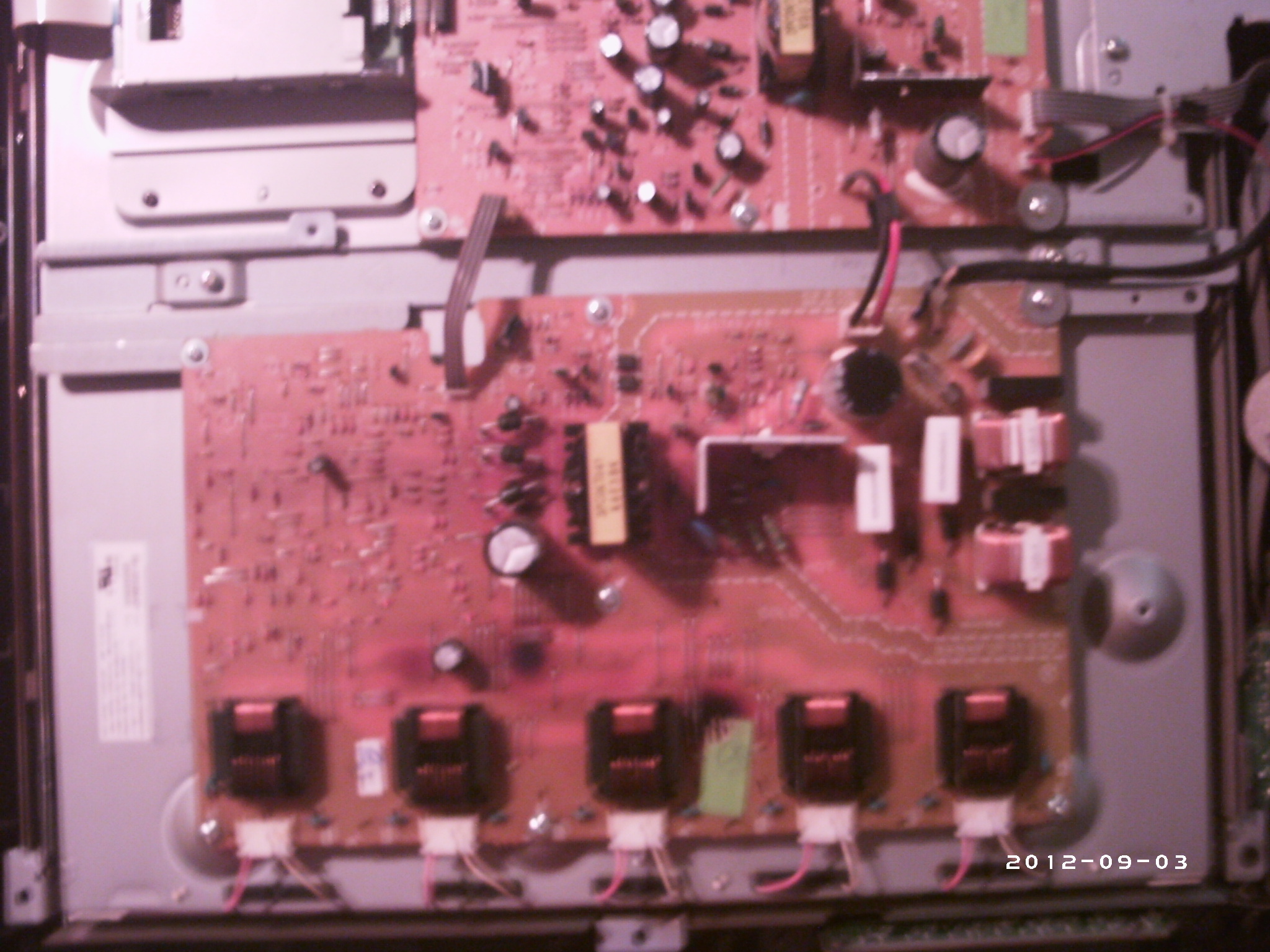

emerson LC320EM9 Blinking power light
  • bobbyd40
    • Dec 2012
    • 116
    • usa
    Re: emerson LC320EM9 Blinking power light
    Sorry meant resistor not diode
    • high-tech
      • Sep 2010
      • 197
      That diode is causing your problems in the inverter on circuit, after the first one I found I ordered a bag of 50 of them from china for 2 dollars free shipping on ebay...
      YOU'RE WELCOME
      • bobbyd40
        • Dec 2012
        • 116
        • usa
        • bobbyd40
          • Dec 2012
          • 116
          • usa
          Thanks high-tech
          • high-tech
            • Sep 2010
            • 197
            Your TV is doing what I call the classic Funai shuffle
            When you press the power button the main board sends a signal to turn the power supply/inverter on and the inverter/ power supply in turn sends a feed back signal to main board telling it i'm on and everything A OK.
            When the main board does not get this feed back it does the Funai shuffle "flashing power led".
            I don't think the burnt resistor is related to the problem, and its possible you may have caused that resistor to fail... IDK
            I hope this helps and always check the diodes around the Transformer on the main board first. You can test all of them in circuit, you don't need to pull them.
            • bobbyd40
              • Dec 2012
              • 116
              • usa
              Thanks high tech will have to wait until i find that resistor.

                              I'm new to this forum But i have an emerson LC320EM9 B LCD TV with the very same problem.I took a picture of the board so you could see what the problem could be and to point me in the right direction as to where i can get replacement board.This board has to be the problem There are 2 dark burn spots.the numbers on the board are BA8AF0F01032.The other no. are C7A3/A3.Any help would be greatly appreciated.Thank you
                                Had this same problem. Used ShopJimmy kit 1FSA10474. It had the mosfet and diodes I needed. And thanks to BUDM for the schematic found were everything went.
