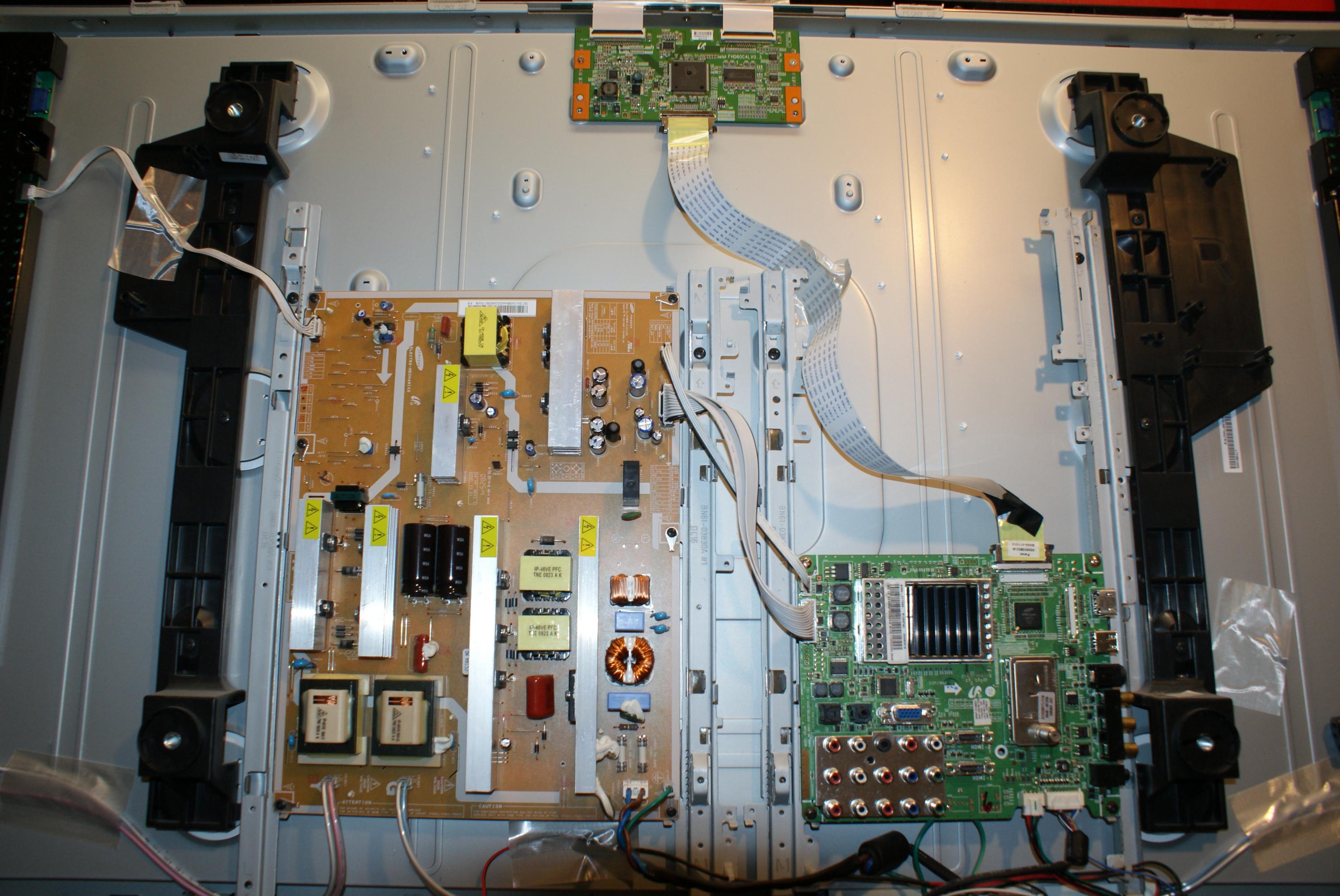

    Can anyoone help me, this tv is complete dead.
    Re: samsung ln46a540p2fxza no power
    You've abandoned at least two repairs in your last posts. We like to actually fix stuff, not waste time. It's very frustrating when no reply come back.
    How about some pictures? You've been here how long, and no pictures? No list of what you've tested already? Have you owned the set since new or ...?
        is this picture ok?

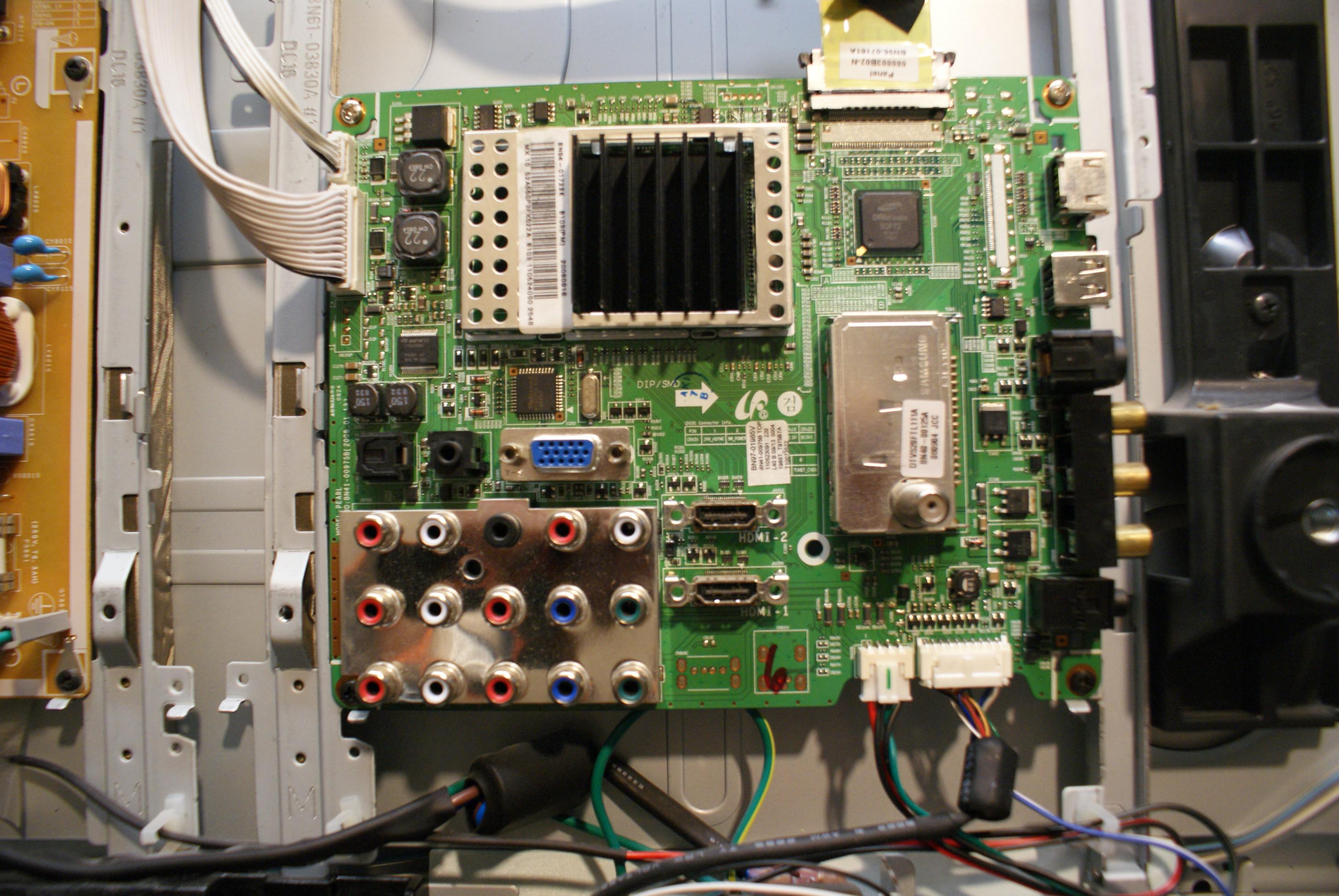

            Leave the TV unplugged, disconnect the large cable between the Main board and the power supply board, plug the TV in, the backlights should come on right away.
            What is the P/N on the power supply-inverter board? BN44-???????
              when i plug it this time the led ligth turn on and is giving me 12 flash plus one

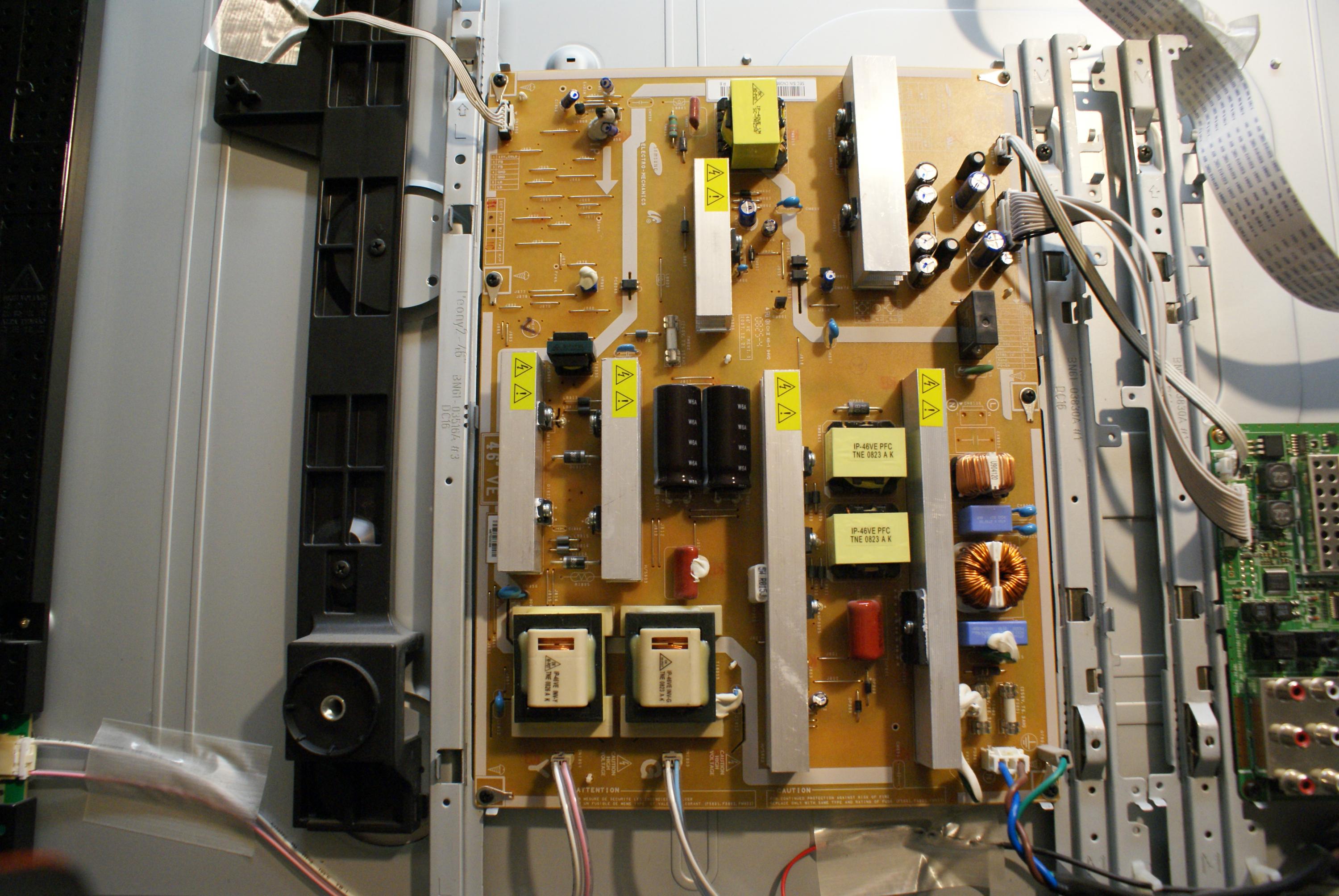

                power supply IP-271135A
                INVERTER BOARD LEFT SSB460W22V01
                INVERTER BOARD RIGHT SSB460W22V01
                  You have power supply/inverter board combo, the two boards on the side are balancer boards with lamp current sensing transformers for each lamp. To verify if you have power supply-inverter board problem or the main board problem, you have to disconnect the cable as I suggested in post 6, if it does not stay on, then you have power supply-inverter board or one of the lamp draws too much current, you must follow my suggestion on post 6.
                    I unnpluged it and get no power at all
                      If the backligts do not turn on the minute you plug the TV to the outlet with the large cable between the main and the power supply board disconnected, then you have bad power supply-inverter board or lamp over current problem.
                              This is one looks like your board:
                              http://www.shopjimmy.com/samsung-bn4...wer-supply.htm
                              BN44-00202A
                              Thanks to TOM66, he has the diagram for the board.
                              And this is how to test to find out if the lamp is bad.
                              https://www.youtube.com/watch?v=oE6K4xBVweA
                                      Ok. I tested the power on and the 5.v on j850 and i am getting power,sudenlly i hear the samsung music and i can see in the back of the screen that it on. I get no picture. I turn it off and now went i turn it on it start clicking trying to turn on. My question, tom66 show me how to jump it getting power from any other source, Can i do the same thing here?
