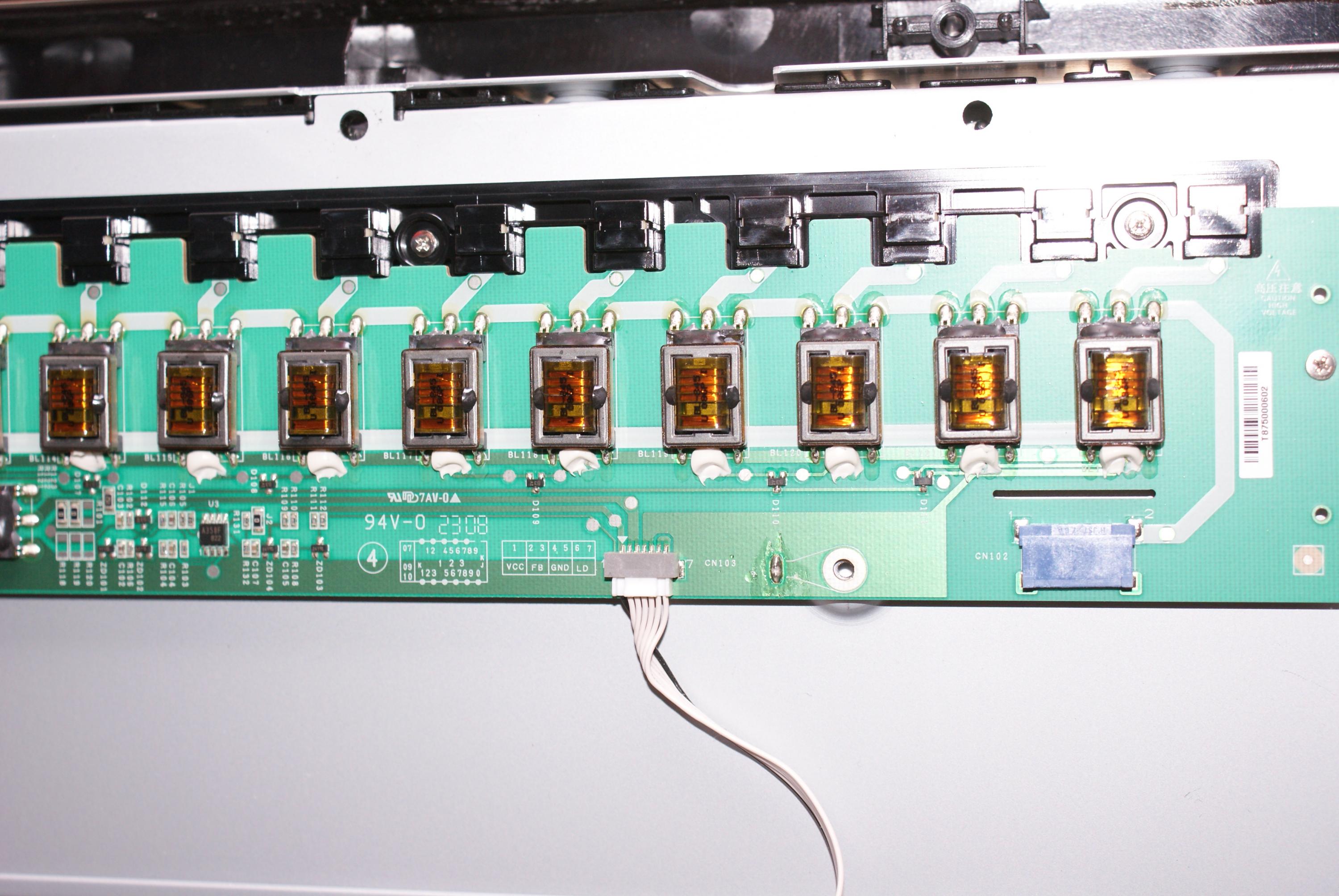

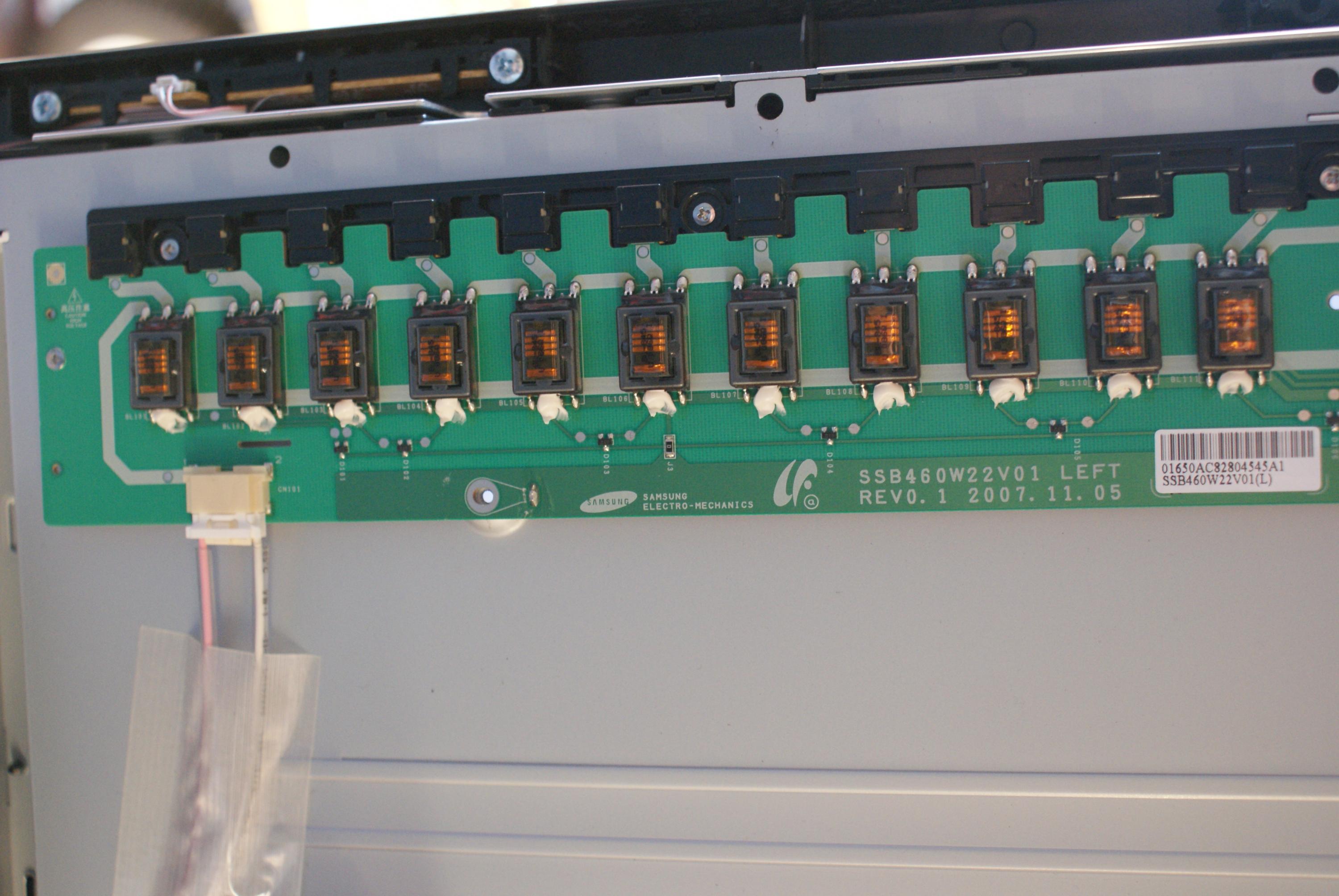

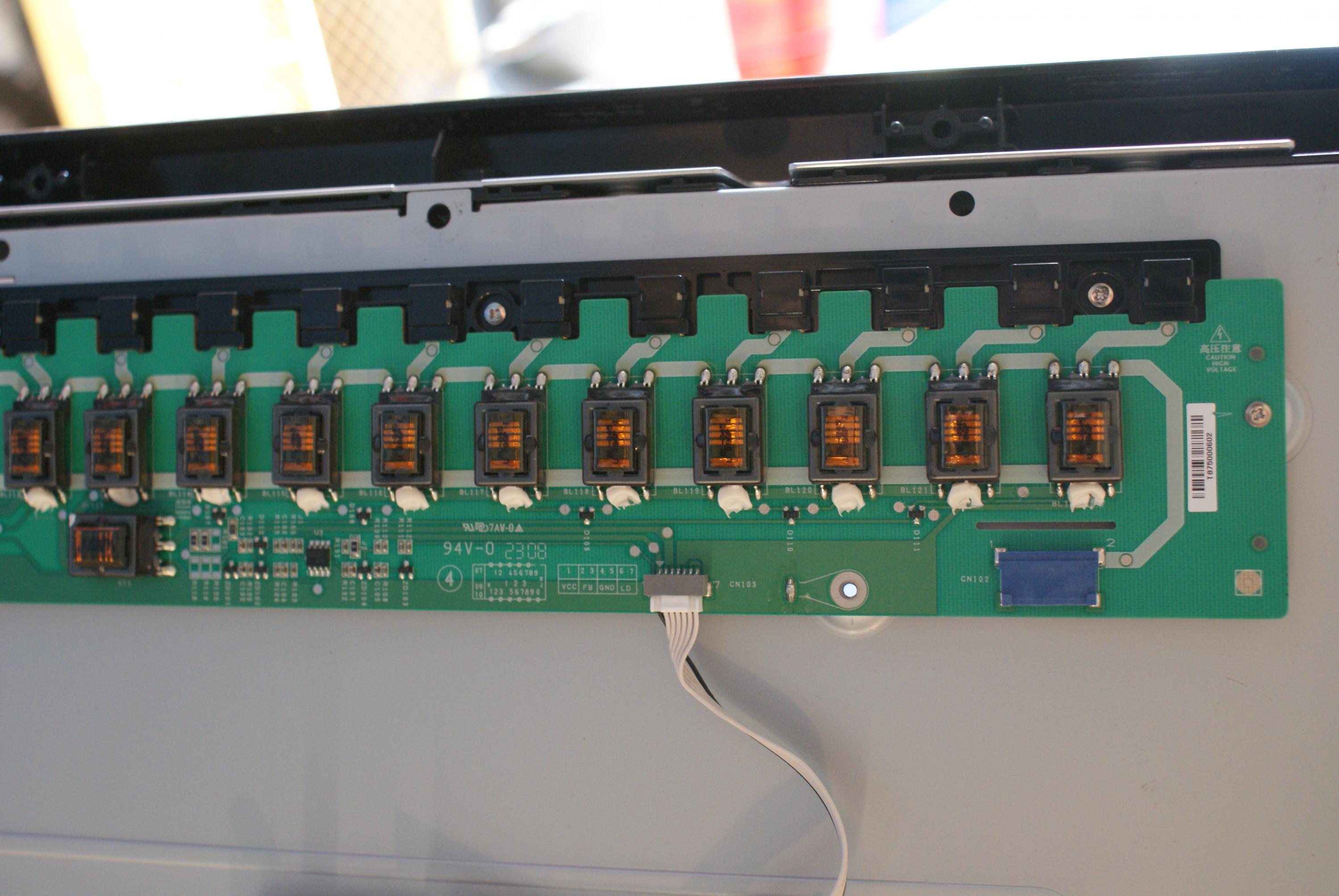

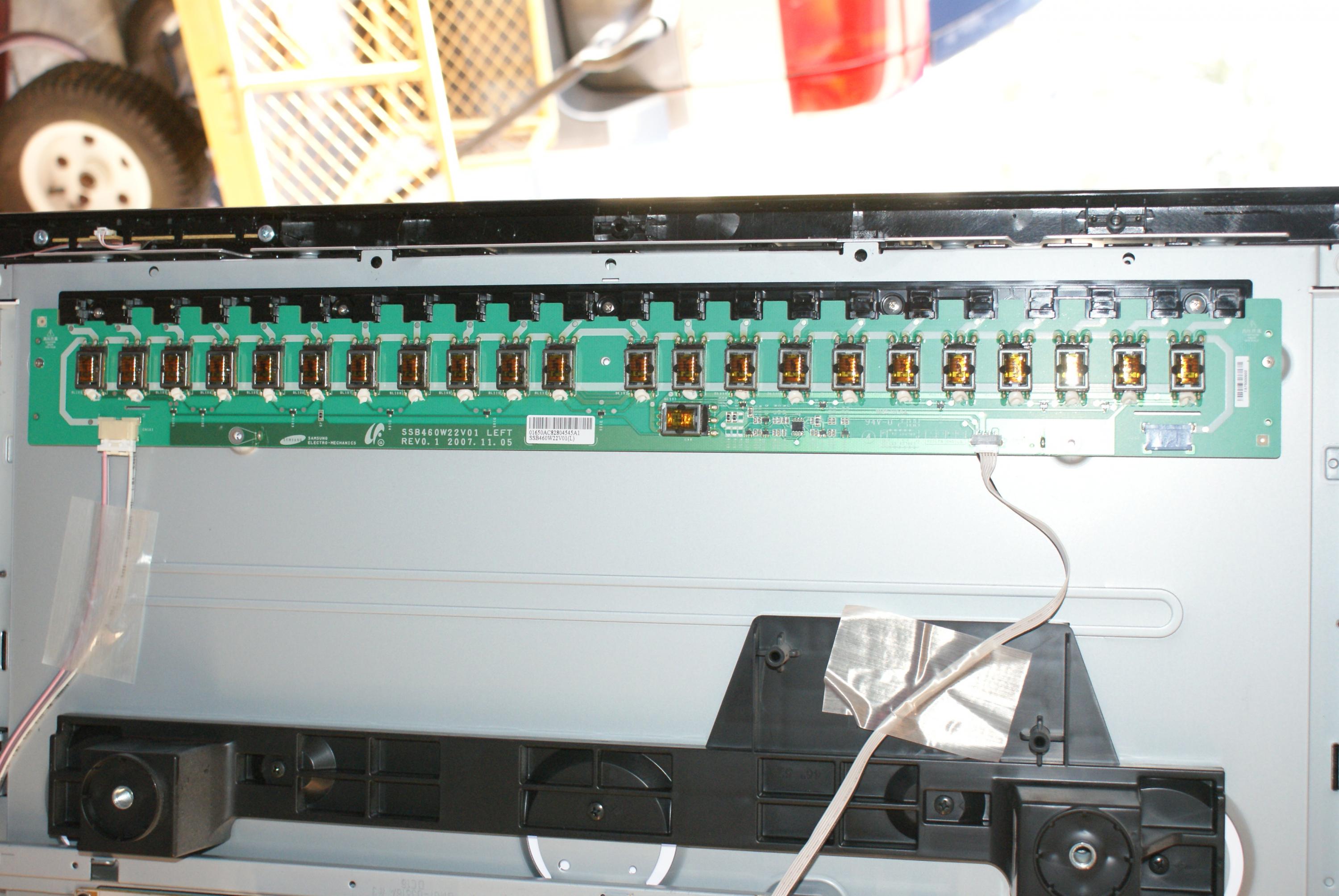

              Re: samsung ln46a540p2fxza no power
              Do you have the display with all the small transformers as in the youtube video link posted by budm.
              It is not much help just saying
              "I have two lamp that reading are quite different"
              We need to know what the readings are.
              If they really are much different to the others, have you tried removing the transformers and putting the jumpers in position to fool the protection circuit, as shown in the video?

                                  Originally posted by ealequi
                                  on the driver i am only getting reading in this transformer bl121= 1.v, bl112= 1.3v, bl101= 1.3v, no reading on the rest of testing points.
                                  I dont think we have a picture of that board? - how many transformers/bulbs?
                                  What setting have you got your meter set on when doing this test?
