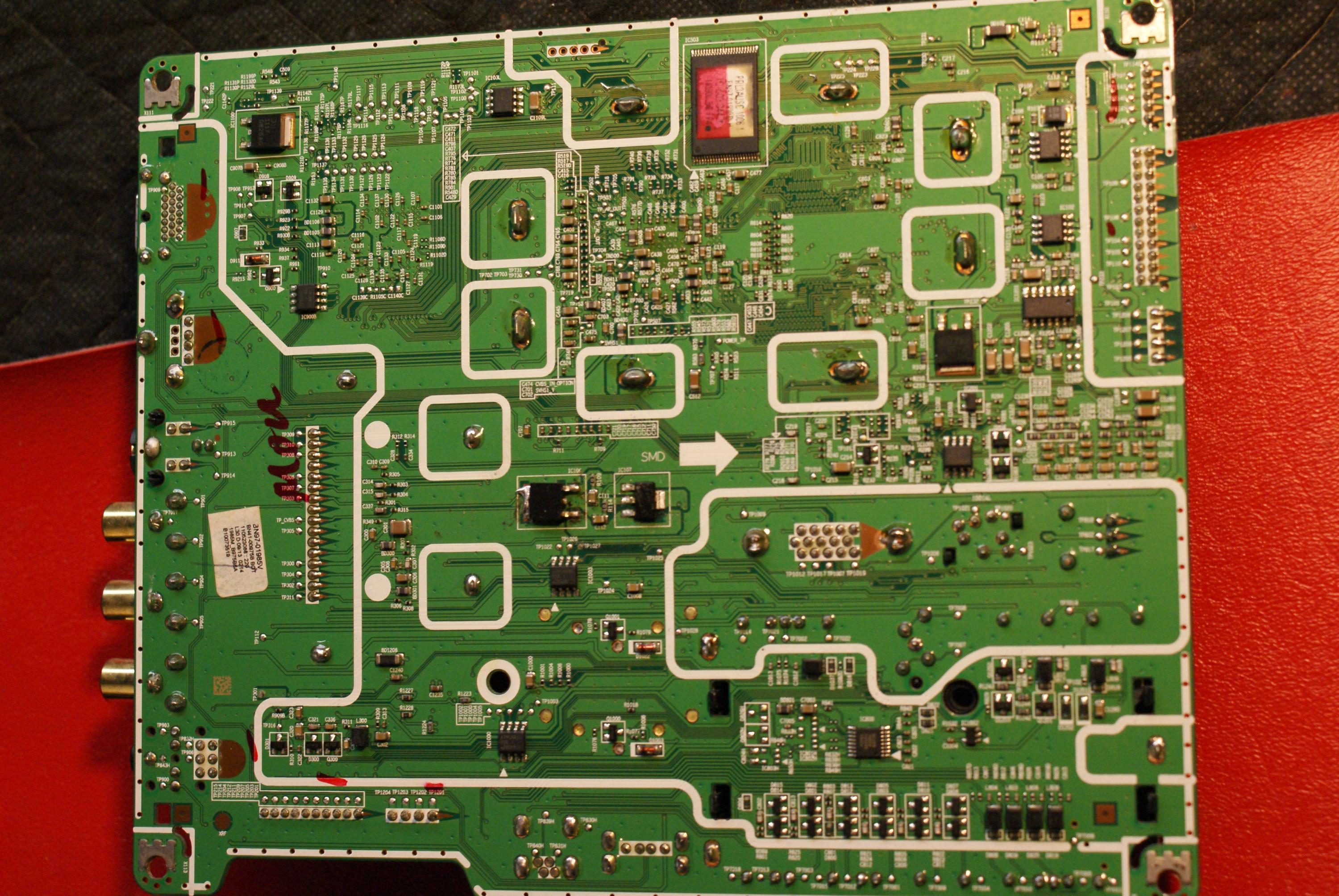

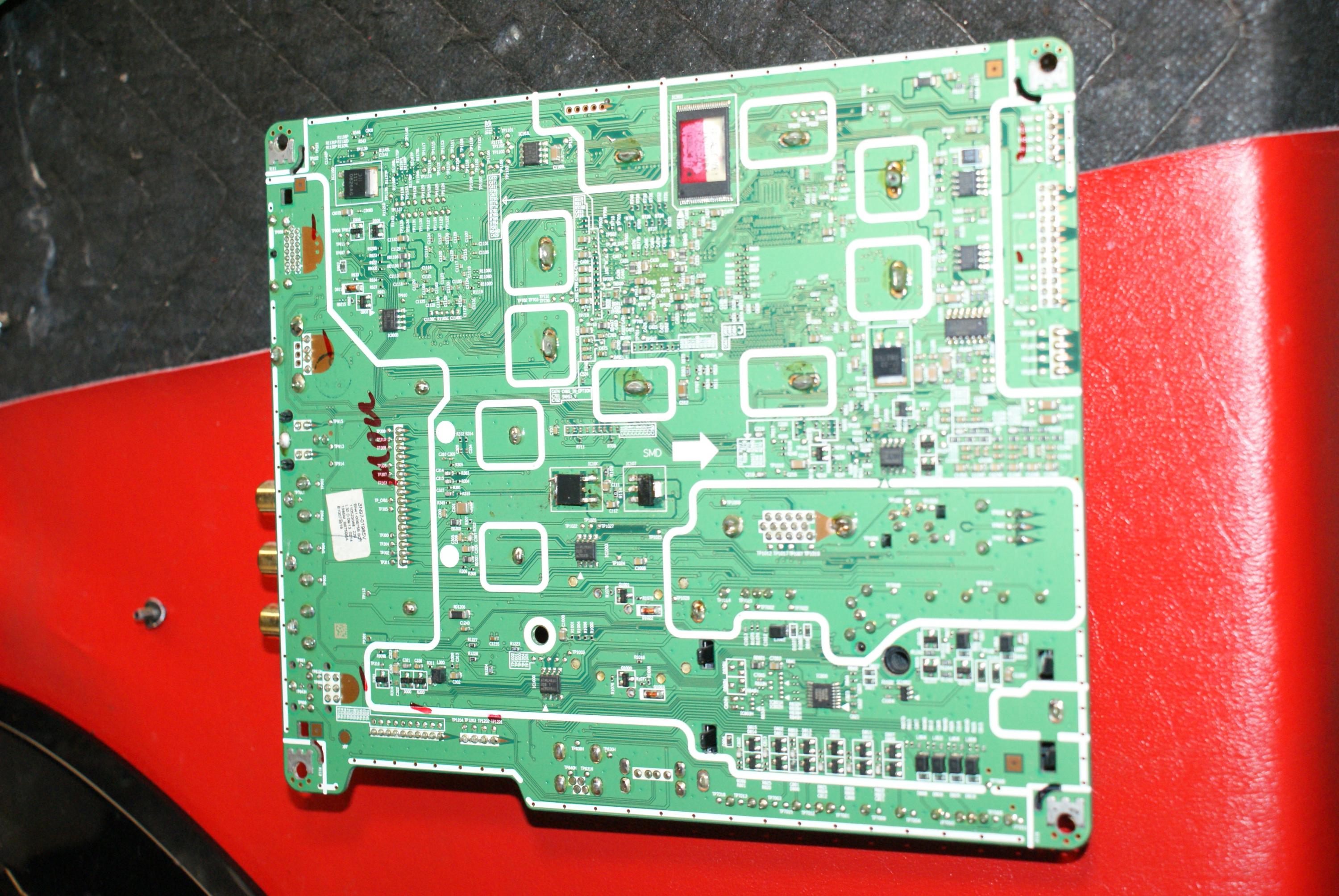

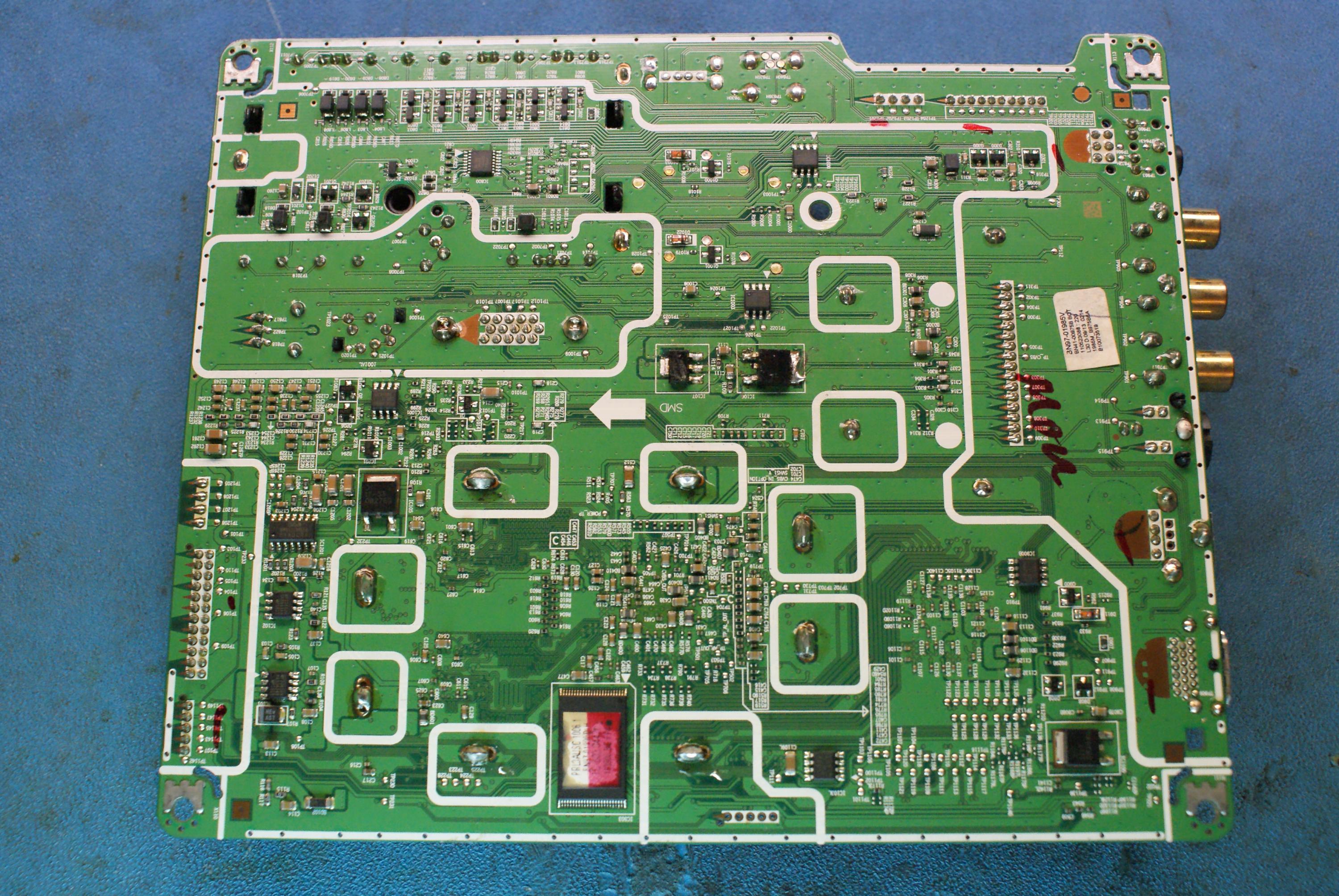

      Originally posted by ealequi
      the one you has posted is the same one i got bn97-01985v
      Well it would be - it is YOUR Board
      I just turned your picture to make it easy to read.

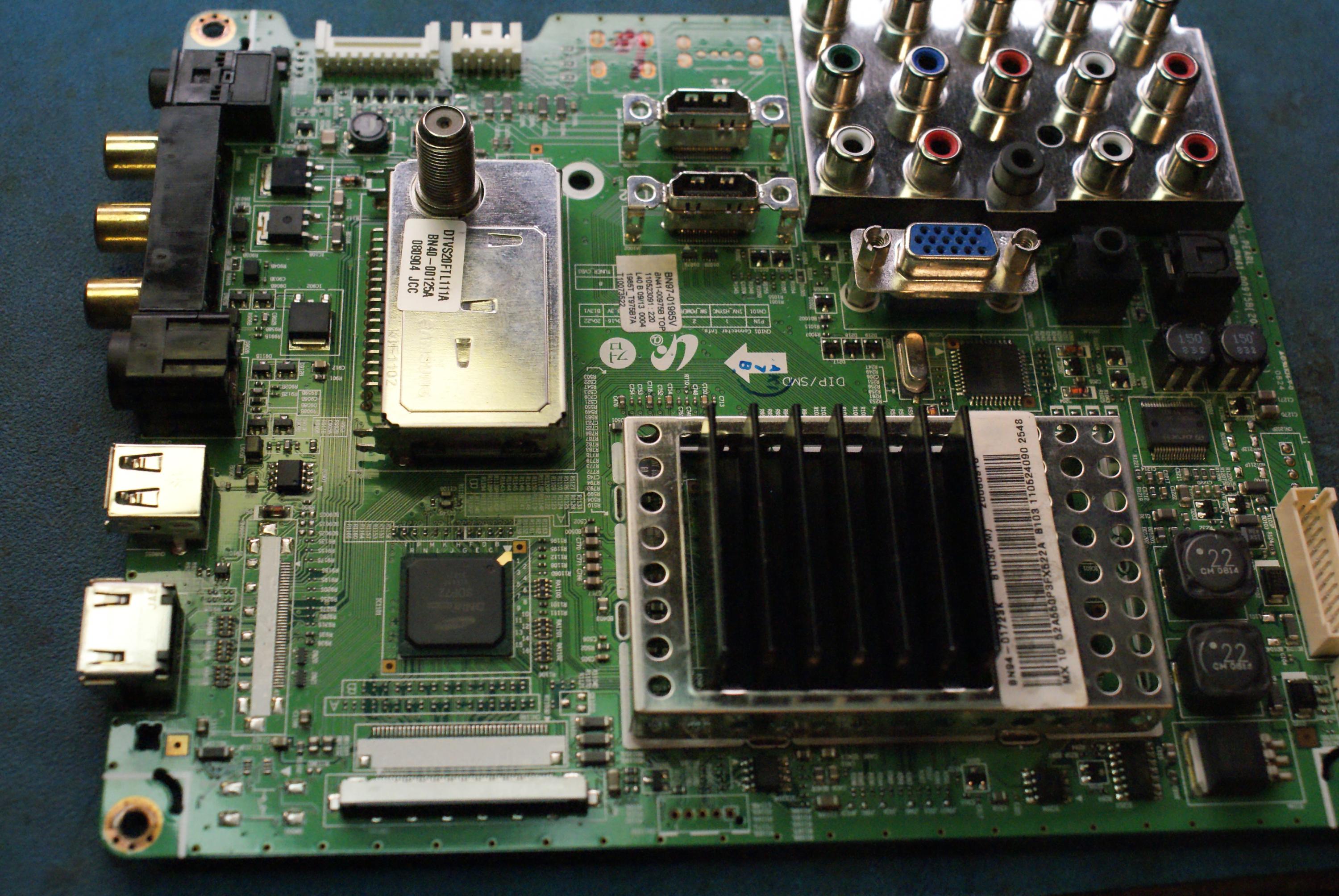

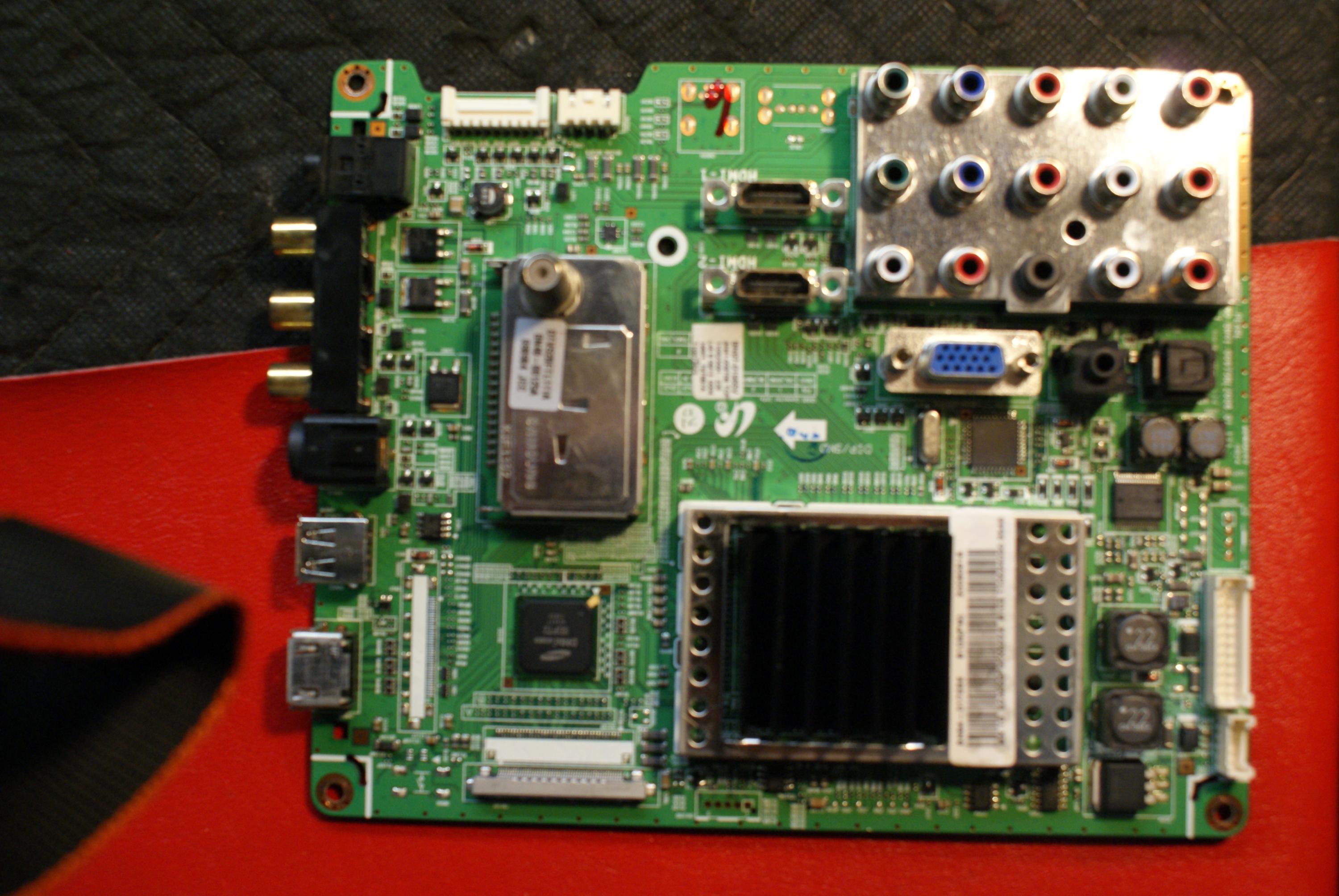

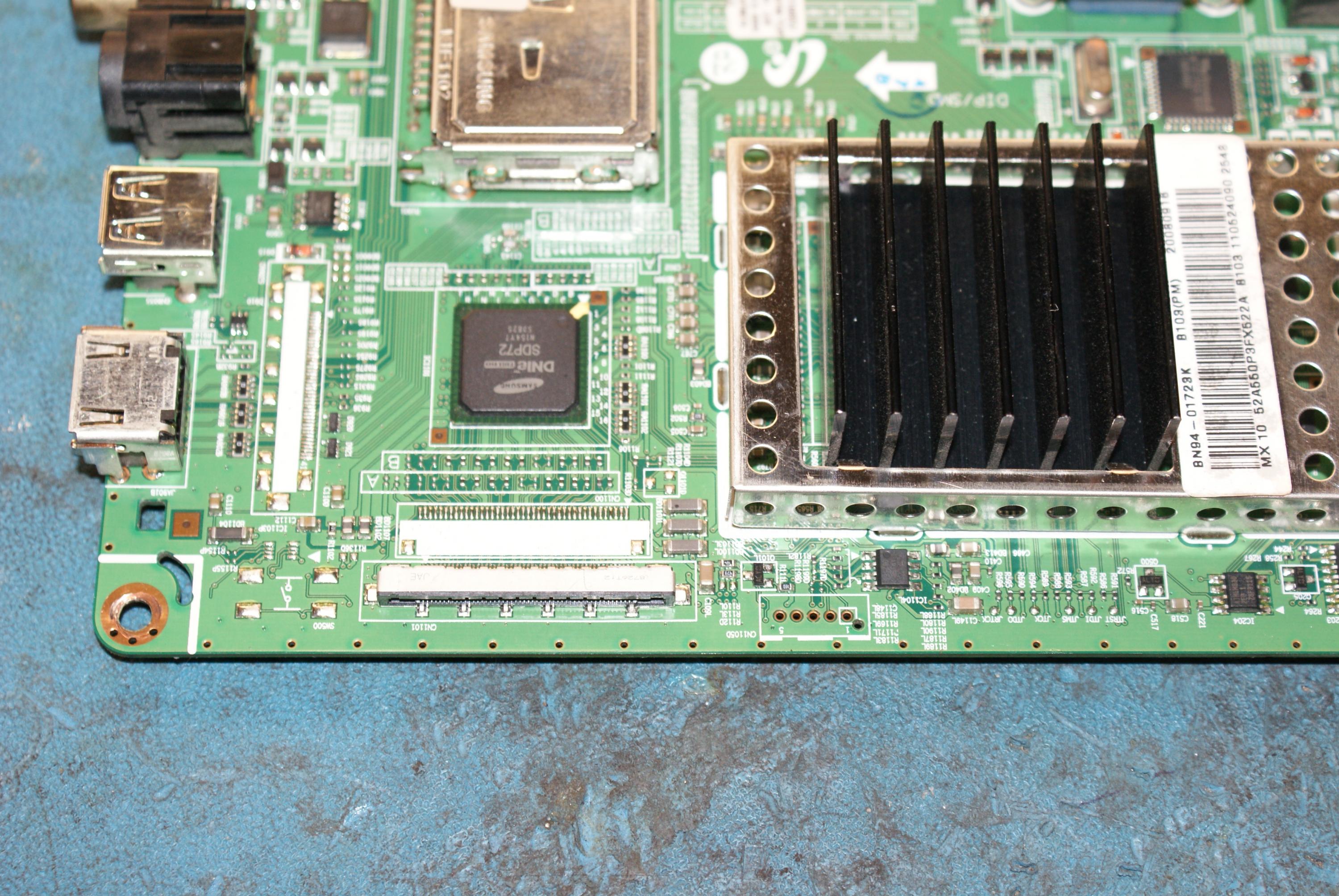

          Re: samsung ln46a540p2fxza no power
          Need to get a picture around the LVDS connector on the main board.
                  Yes, I got it, but it has no schematics.
                  So we will need pictures around the connector going to the t-con (but on the main board side), clear and in focus, as high resolution as possible.
                      Check the voltage on BD1101 (near LVDS) with board installed in chassis.
