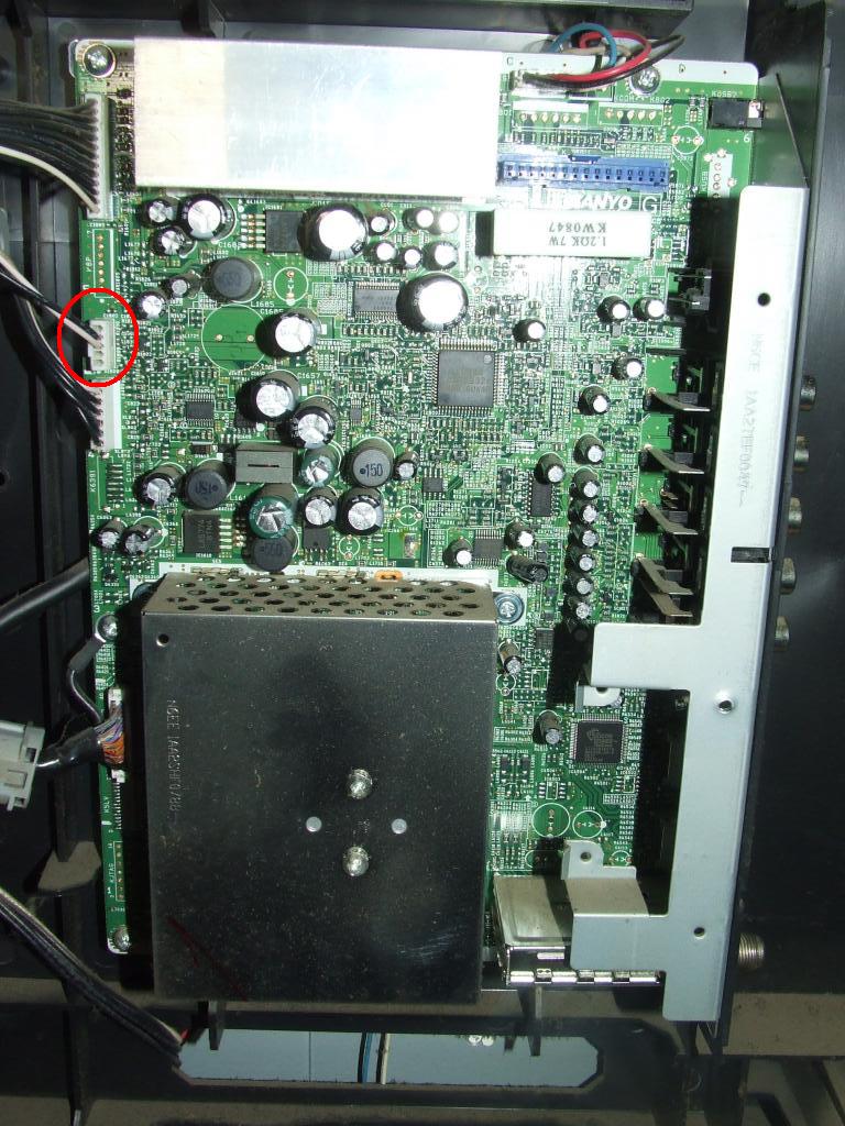

                  Re: Sanyo DP 42848 No picture
                  On my set, with the connector circled in the pic below unplugged from the main board, the backlights would light for ~15 seconds rather than ~2 with the connector plugged in. If this is the case, I'd still suspect burnt out bulbs. If I remember correctly, my BL_SW voltage dropped out as well when the backlights shut off.
                  Note, I'm pretty sure this was the connector, it ran to the master inverter. I do remember that it was only two wires and this is the only two wire connector that I see in my pictures. If you could post a clear picture of the back of your TV with the cover off, it might jog my memory.
                    OK, I guess I should have read my own thread a little closer.
                    From my thread...
                    "With K8L disconnected, the lamps will light immediately at power on and stay on for ~15 seconds, with a picture."
                    So, if that connector is labeled K8L, it is the correct one. If not, look for K8L and disconnect it.
                      I saw that in your thread last night, and disconnected kl8. All it did was come on instantly and shutoff just as fast as with it connected.
