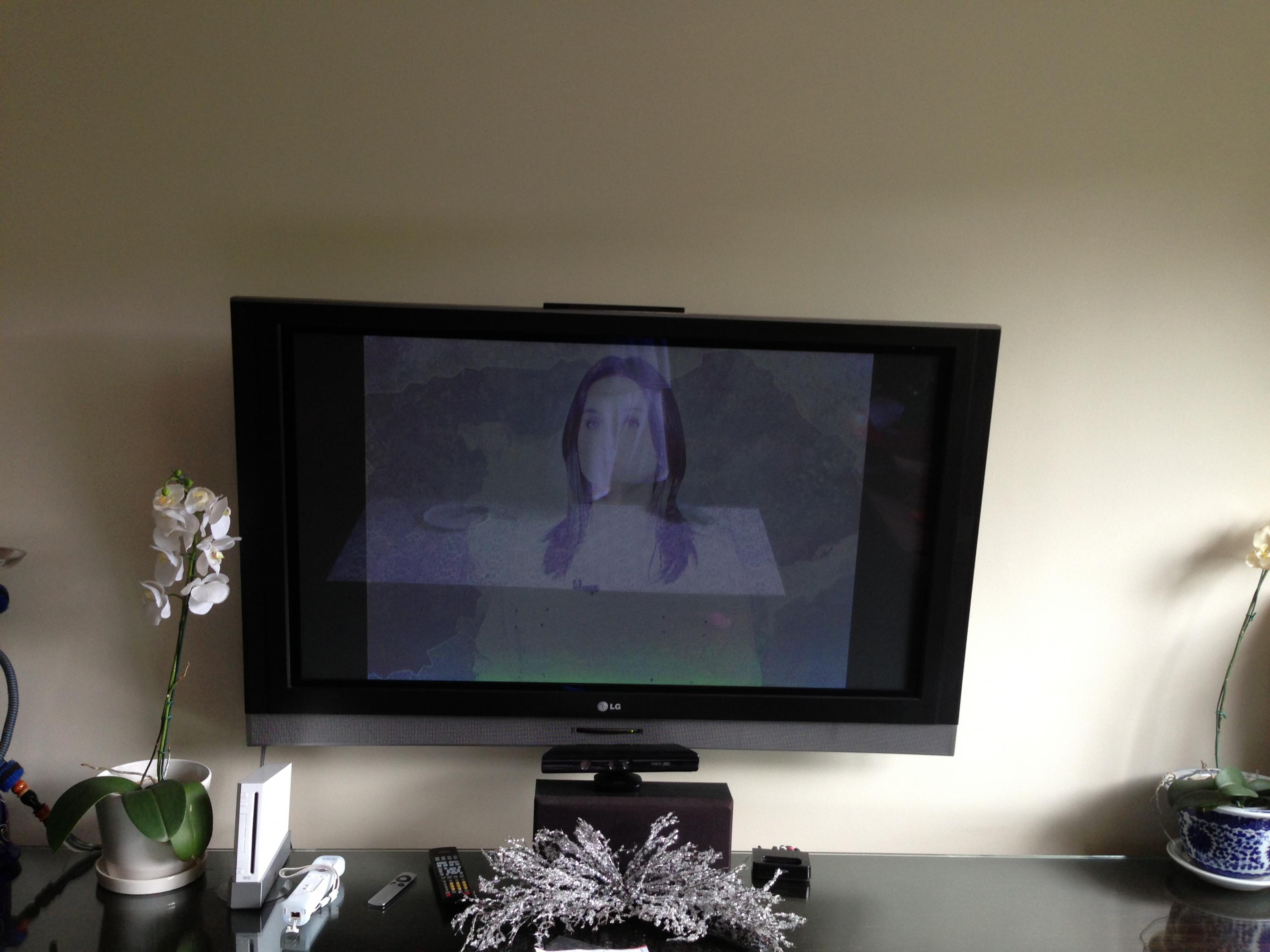

    Hi all, this is my first post, regarding an issue with mine LG 50PC3D.
    Here is a video of the issue.
    And some pics also!
    http://www.youtube.com/watch?v=bBwp2-VcoP4
    Need some help diagnosing the problem, read some about Z sustain, Y etc...
    Looks like power source?
    Thanks in advance.

    Just a little bit more information.
    The issue started with some red pixels flickering on the screen only visible if looked closely.
    Then after a few months, got no brightness from time to time.
    Now it is like that all the time.
    Doesnt smell bad, no smoke no loud noises.

      looks like zsus

                  Re: Issue with 50PC3d LG
                  No, it is a component on the Z-sustain which fails.
                  It contains an array of MOSFETs and IGBTs (power transistors.) Unfortunately, due to it being an IPM, you cannot replace the individual components, the whole module must be replaced.
                  This is definitely a Z-sustain failure. The panel is not being discharged and sustained properly.

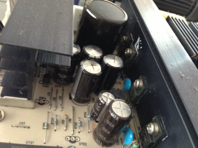

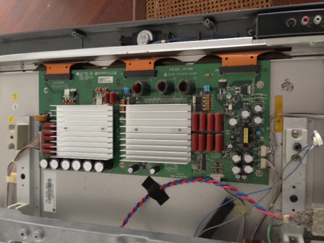

                                    Ok, just disassembled the TV and noticed some stuffed capacitors on the power board (at least i think it is the power board!
                                    Please check the 2 pictures. one are the 3 stuffed capacitors the other one is the Z sus board with the right part number "6870QZC004B".
                                    So the question is, could the issue be the power board? part #6709900020A.
                                    Thanks for the patience guys!
                                      That's the power board, yes.
                                      You have a very common issue with this set which is failed capacitors.
                                      But they are not yet giving trouble because the Z-sustain is the actual failed part. They would however cause problems in a few weeks to months ahead of time, so they should be replaced as well.
                                      Your picture is of the Z-sustain and the IPMs are under the large heatsinks.
