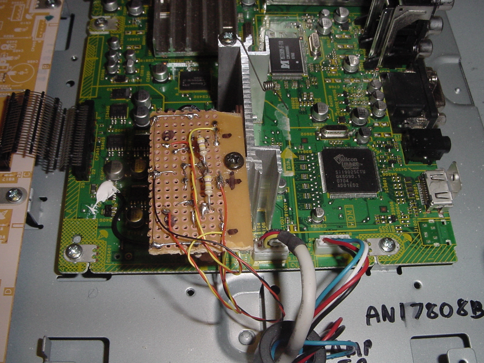

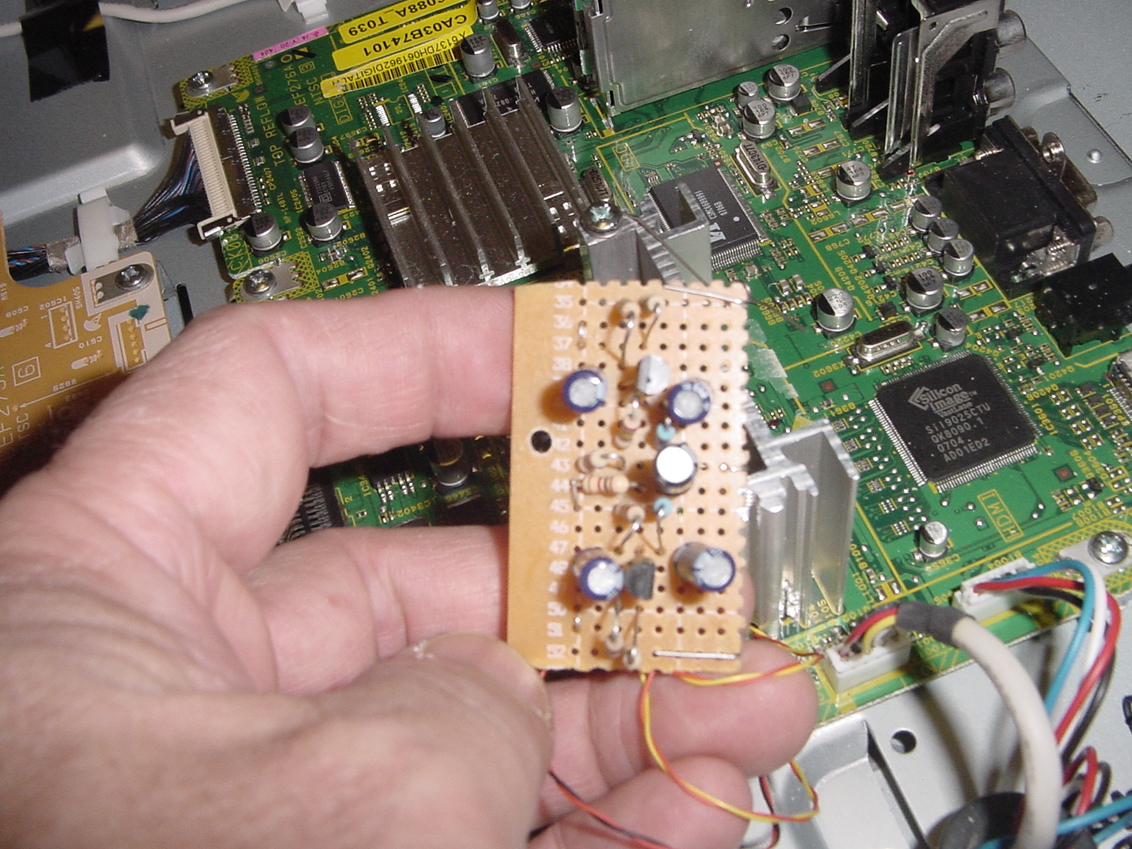

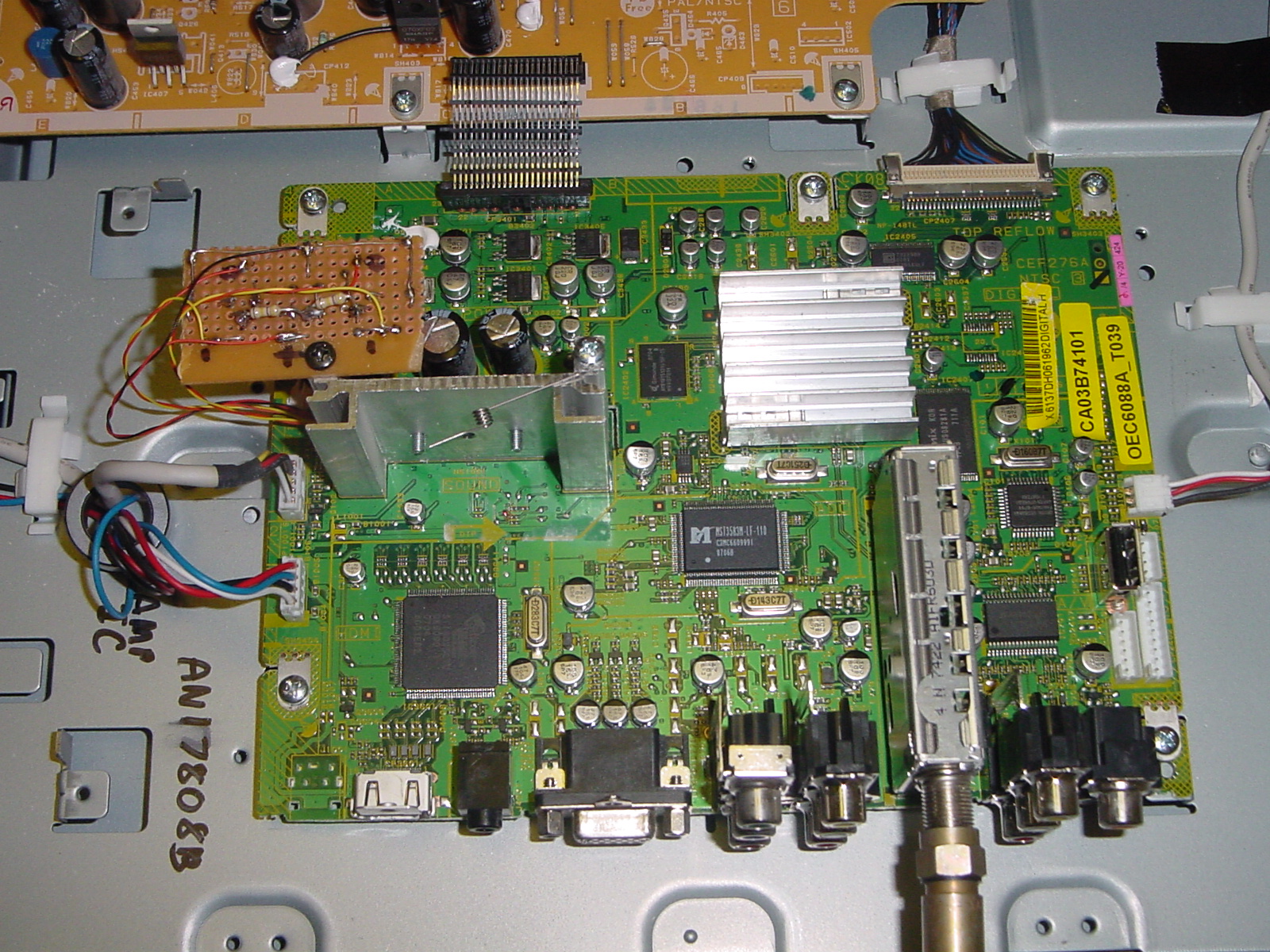

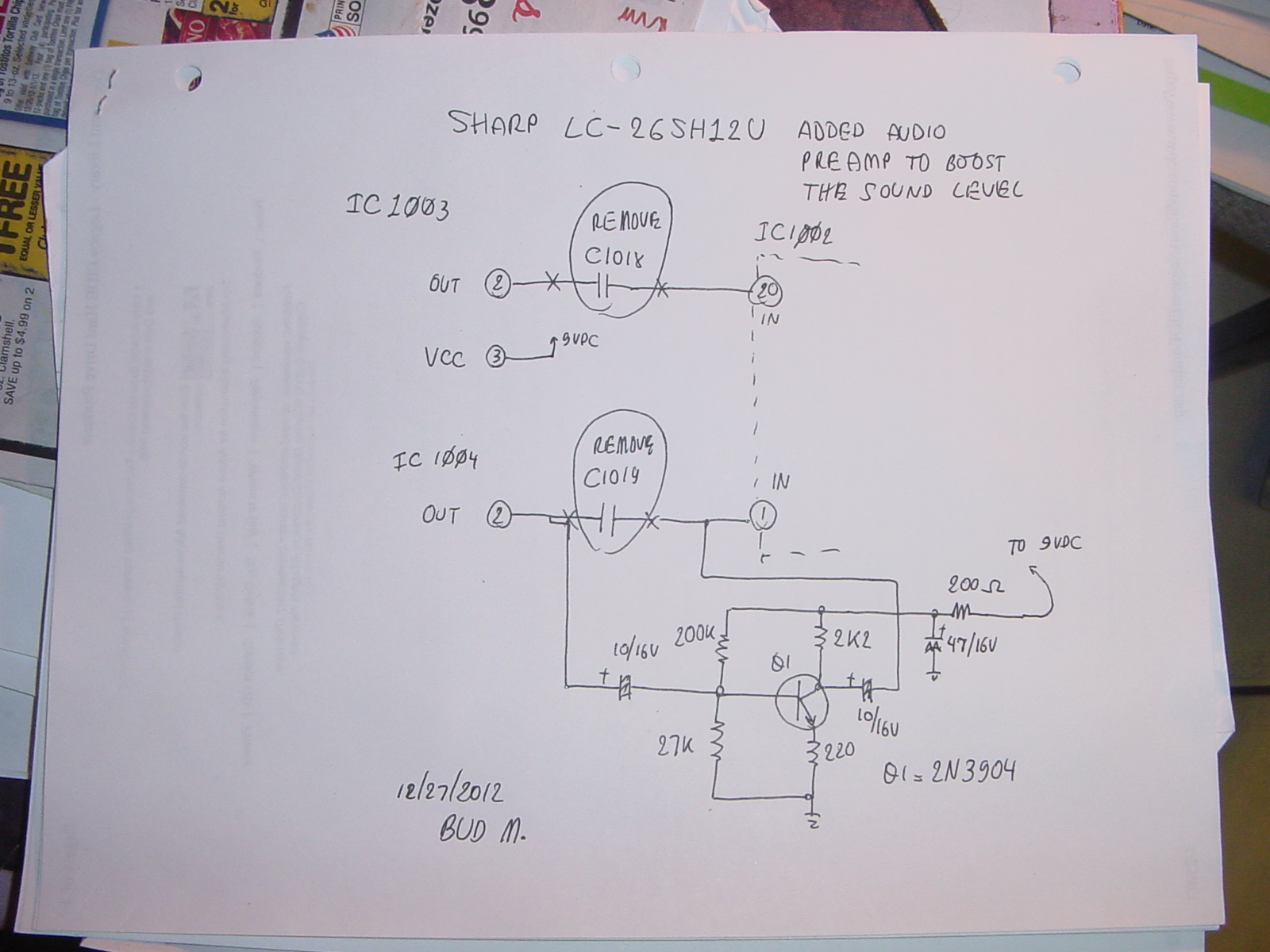

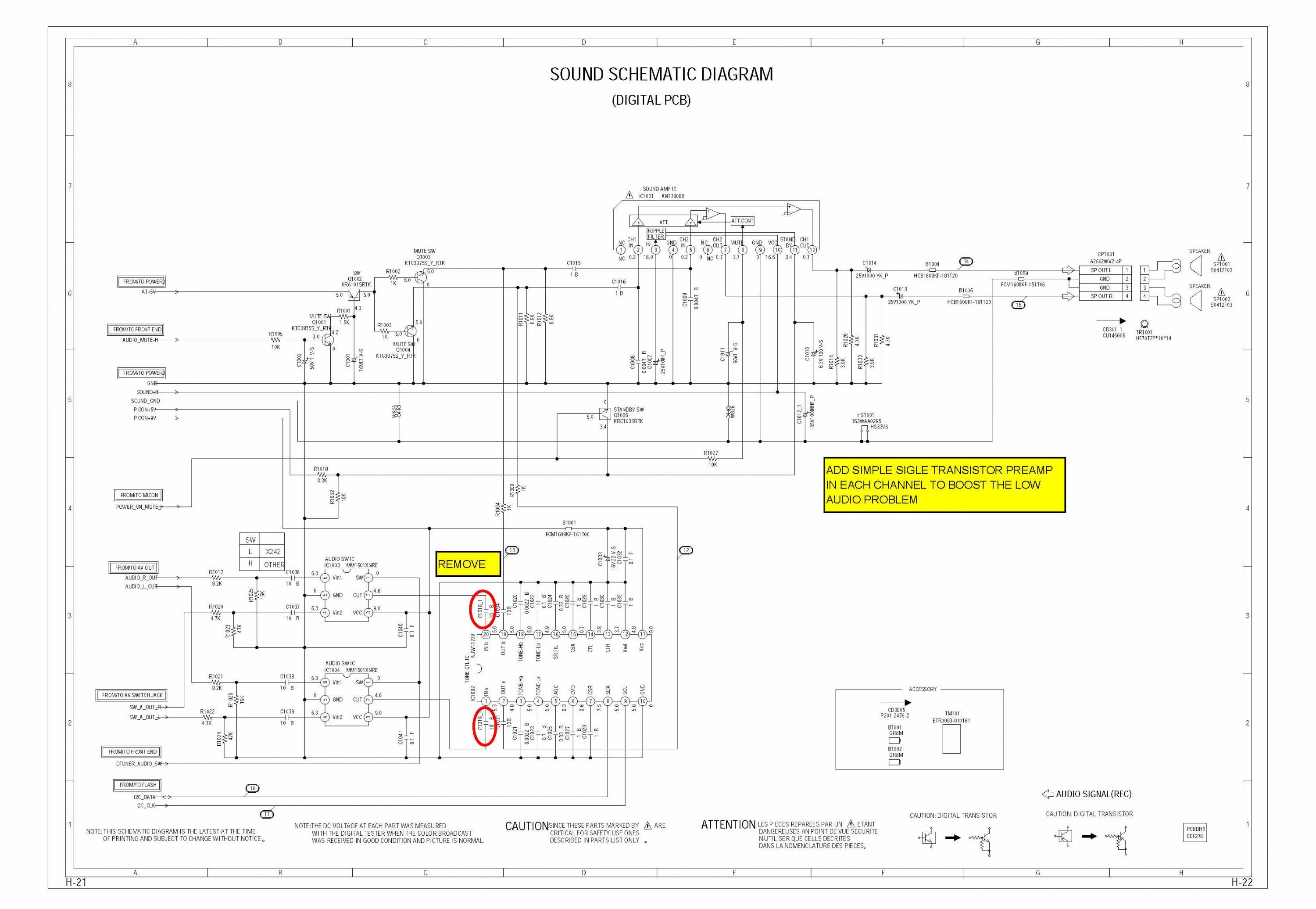

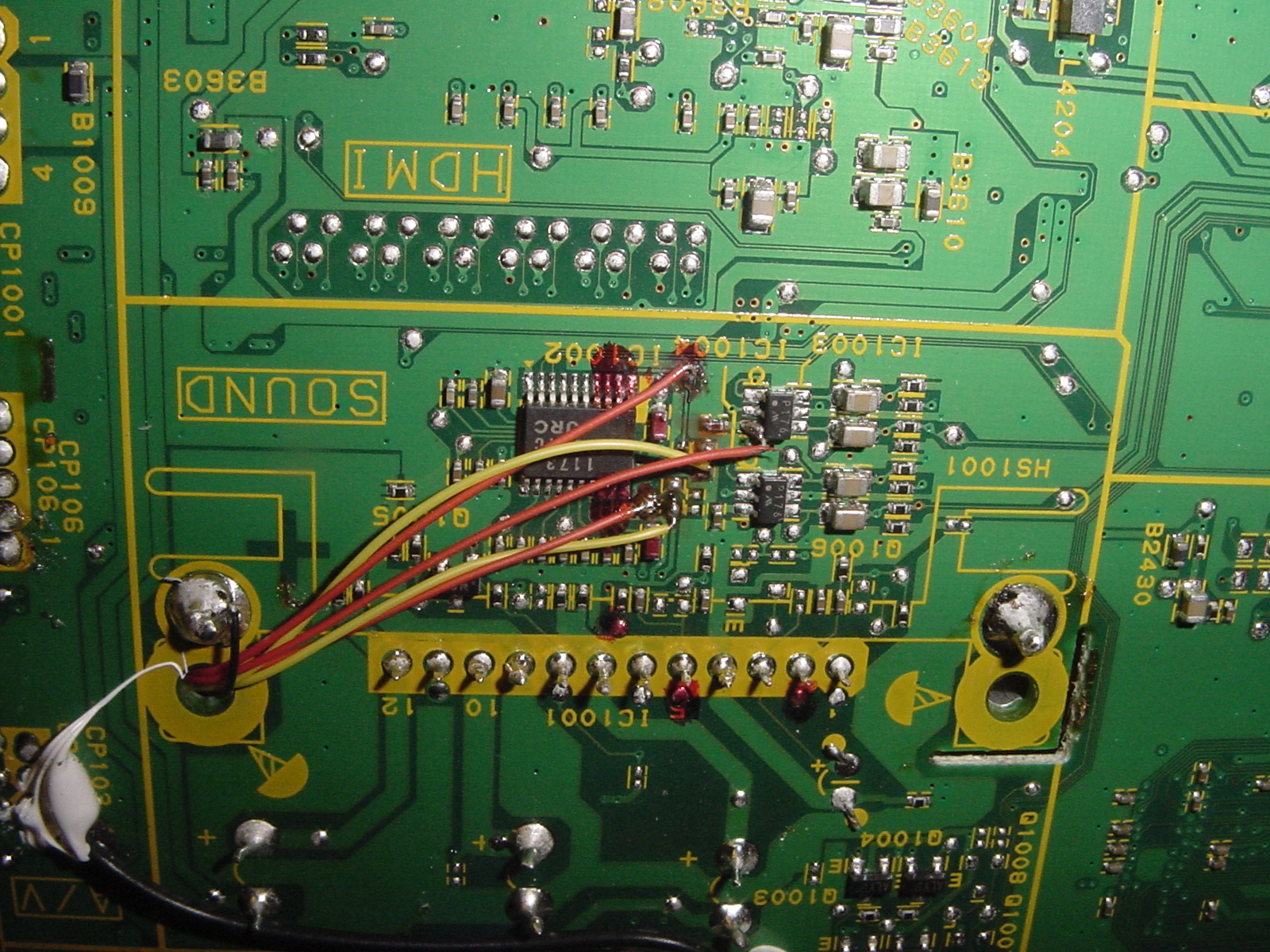

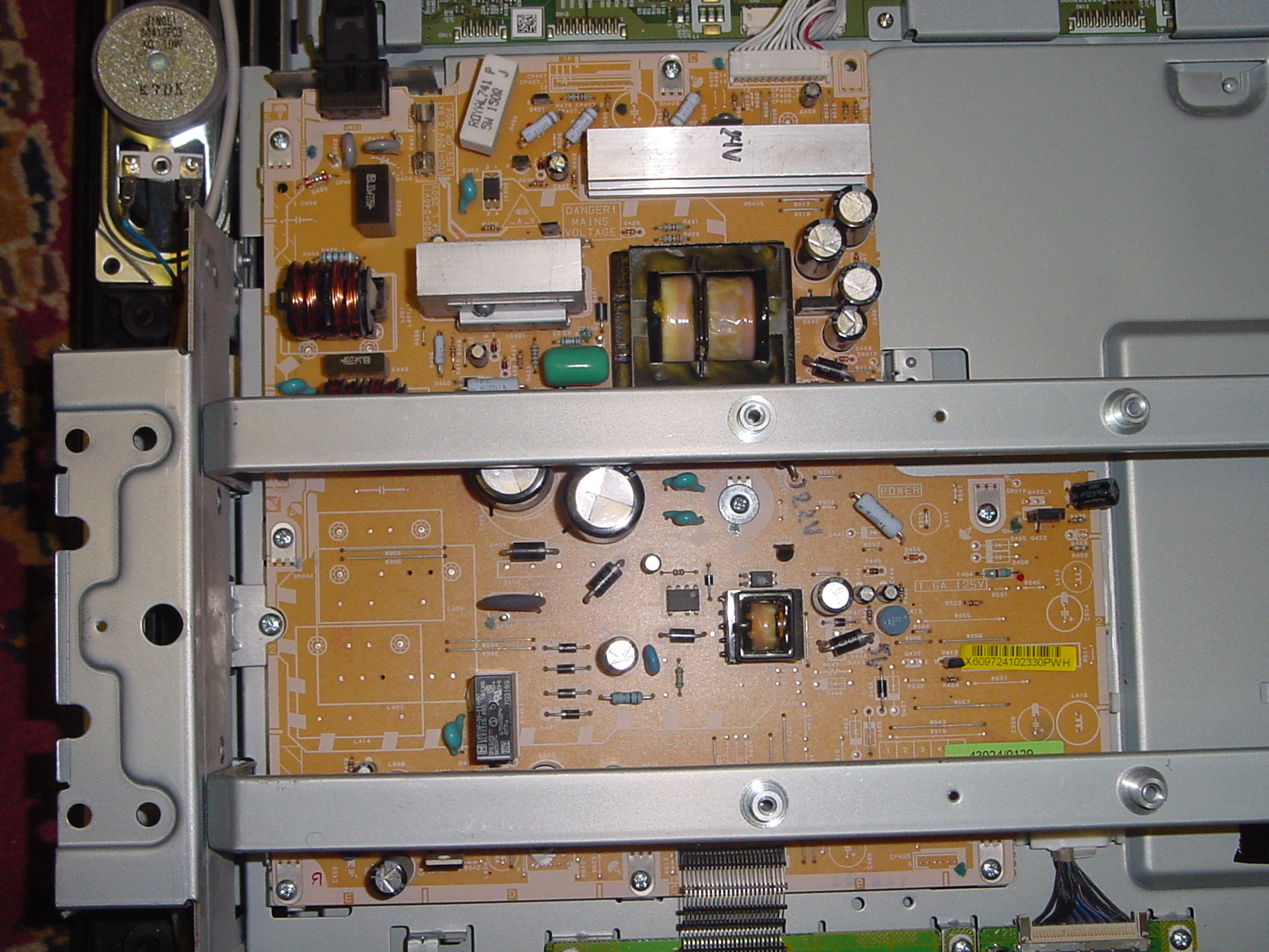

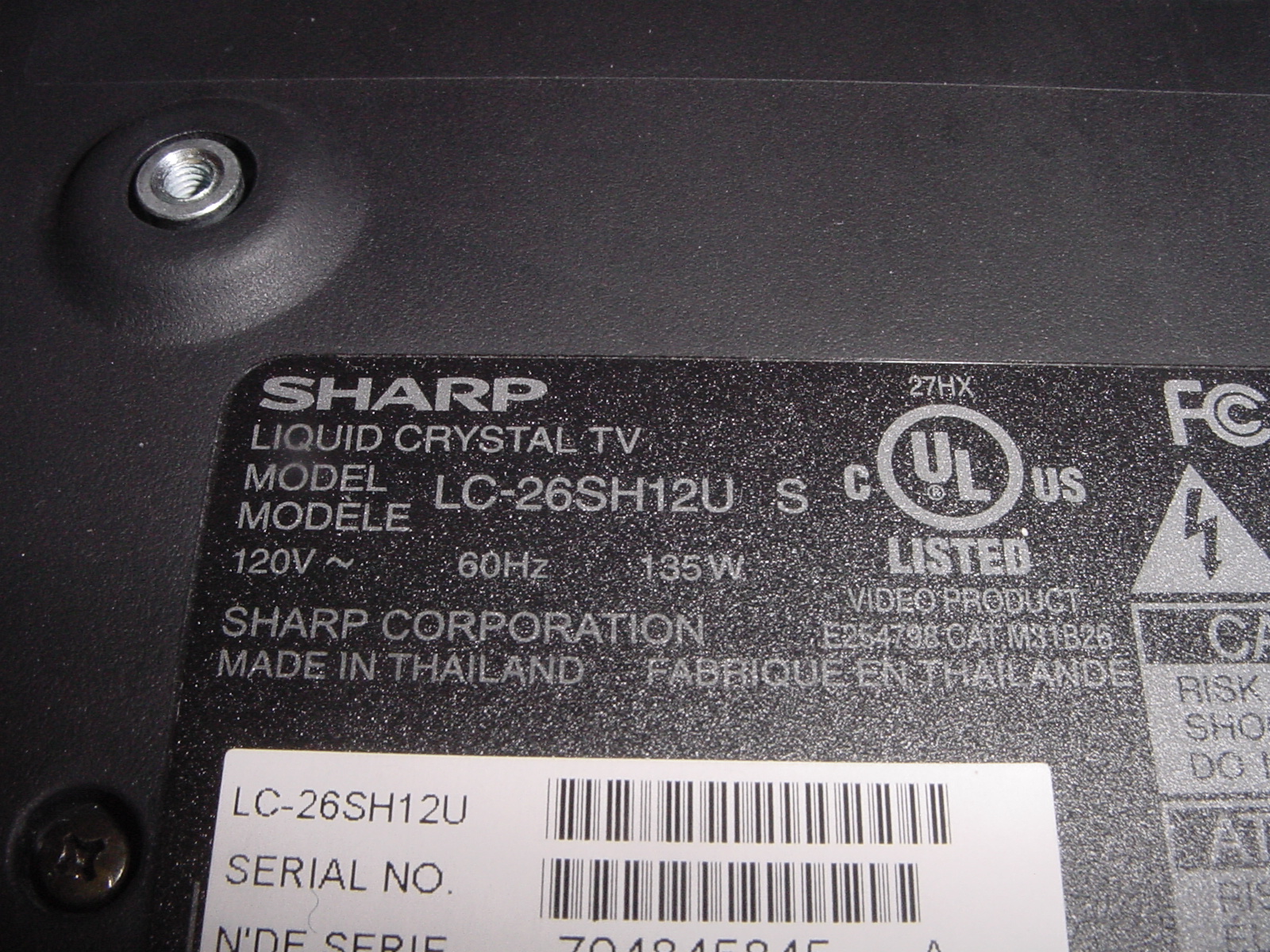

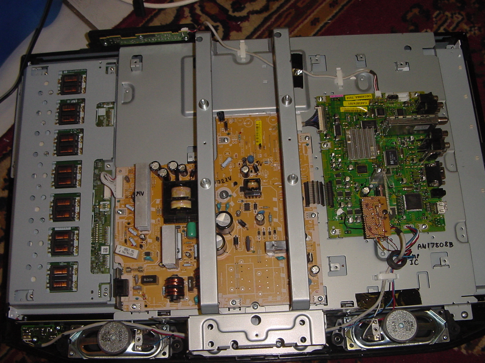

    This Sharp LC-26SH12U model had a lot of complaint on the web due to low volume, Sharp had released the fix with firmware and board upgrade. I am not about to do that for 26" TV, so I built small single transistor pre-amp per each channel, I could have done with using Dual op-amp also, but I like transistor.
    This TV does have really good picture for its age.
