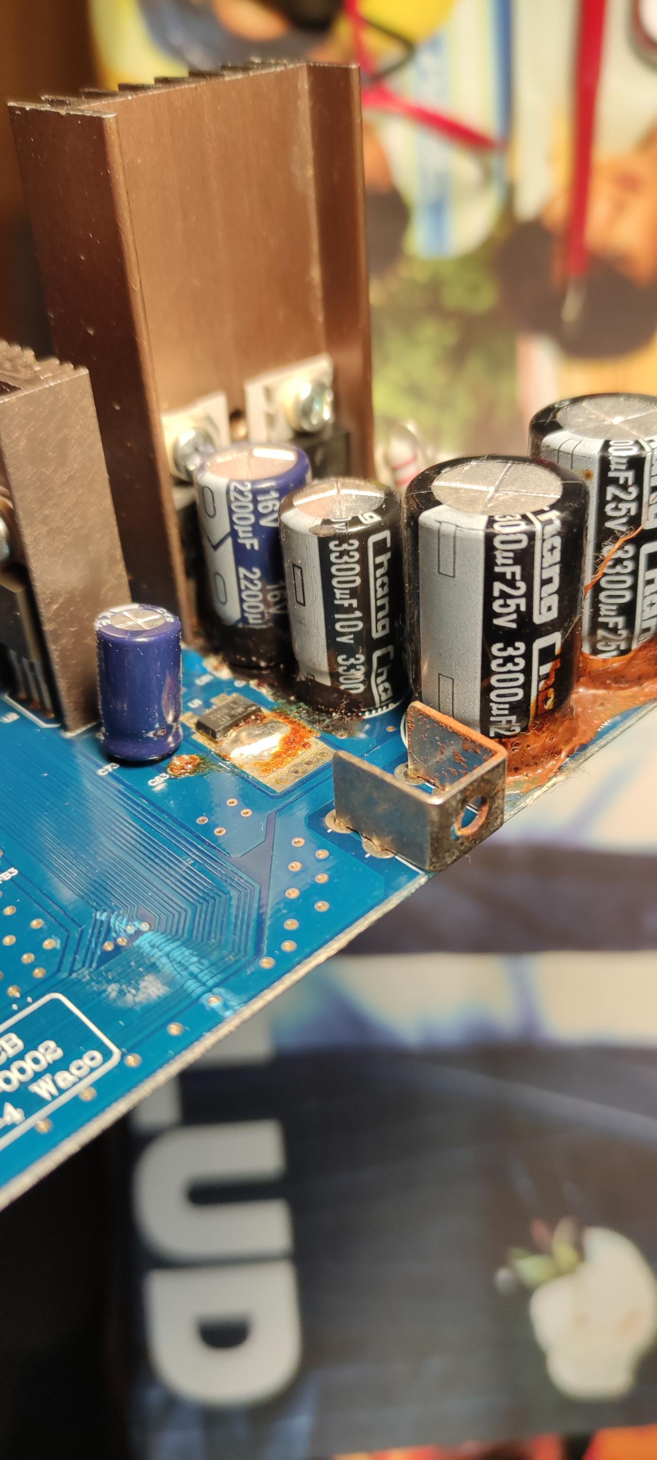

                          What prevents me from replacing those capacitors is that they are located on the mainboard, and everything needs to be disassembled to reach them. My AVR works all day, and I haven't noticed any other issues."
                          ​Should I cut the old capacitors with pliers without removing them from the motherboard and solder the new ones over the old? If the repair succeeds, I will solder them properly."

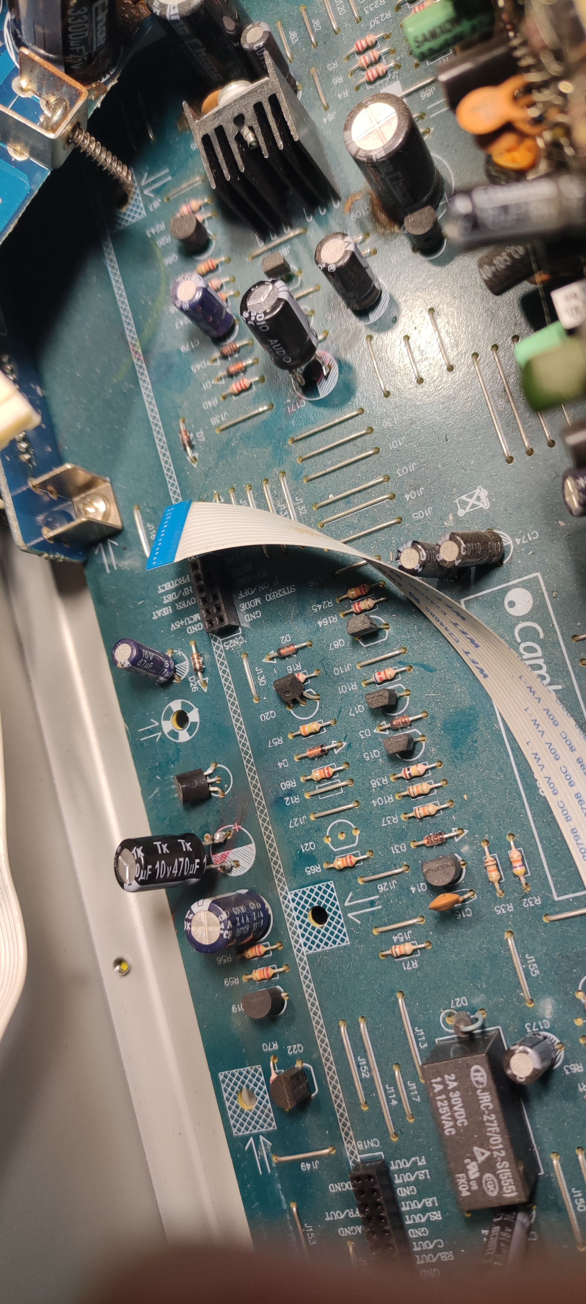

                            Checked ESR on C171 and reading 1.4ohm and 568uf, so assume that it is bad.
                            Could not get a read on C1 unfortunately, but I will get back in there eventually.
                            Also noted that C4 is bulged, C109 and C105 are bad also, so I will not be placing back into service until it is sorted.

                              Unfortunately, replacing the capacitors C1 and C171 on the amplifier's board didn't resolve the issue. It seems like the problem might be more complex or located elsewhere within the circuitry.Any ideas what could be wrong?

                                Having a look at the photo of your board it looks like c109 is bad too? It looks like a lot of the caps on these boards are failing.
