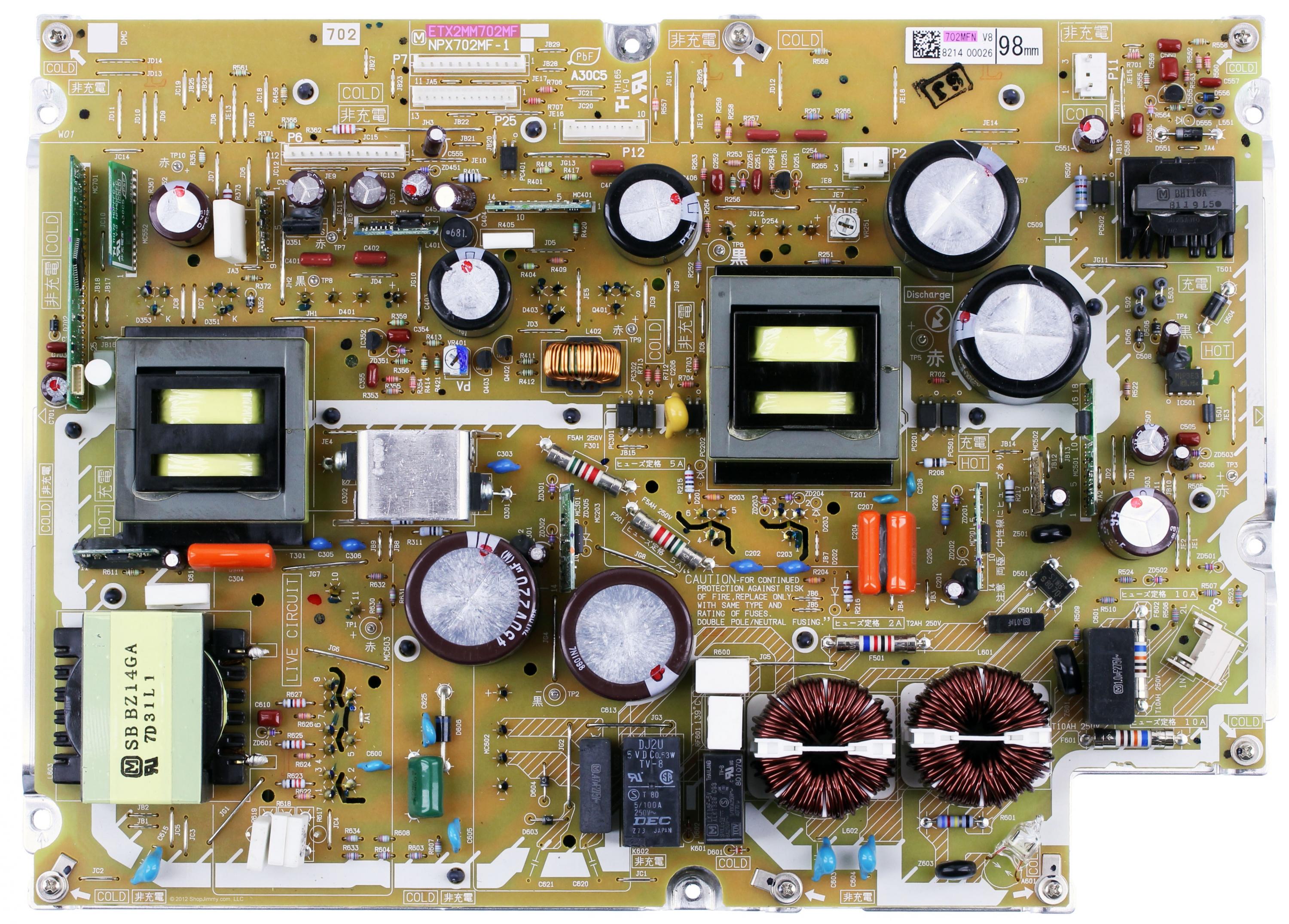

    when I first got this tv it was cold from the trip home when I powered it on and backlights dimmed and brightened repeatedly.
    After that all I have got is the 2 blink error.
    I was reading about the 2 blink sos troubleshoot and I checked for 15vdc at connector P7, pin1.
    After pluging in and hearing relay click I get 1.393vdc.
    About 15sec later I hear a relay and voltage drops but no blink code at this point.
    When I hit power on, 1.3v flashes quick before shutdown and error code.
    I also tried a resistance/short test but honestly I dont know if the results are ok on my dmm. It took 30 sec for it to show a stable 1.748kohm
    Should there be 15vdc just after pluging in?

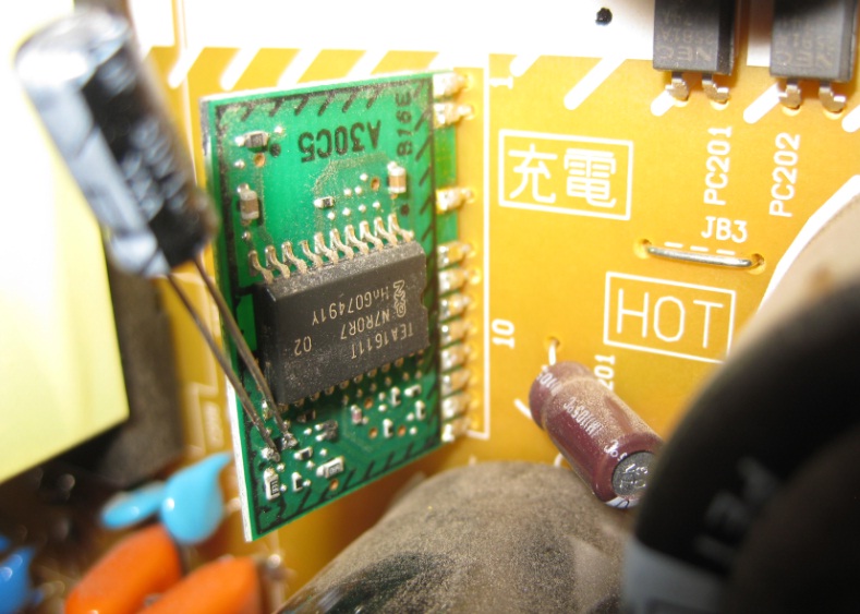

    2 blink fix:
    https://www.youtube.com/watch?v=LjpGKaBt8hg
    You do not need to replace the IC, only the capacitor.

        Norcal used a 10uF 50V(?) SMD cap, you could also use a through hole one. The ceramic cap in this case appears to fail earlier than it should.

          This post will show you what some others have done.
          https://www.badcaps.net/forum/showth...nic+th-50pz85u

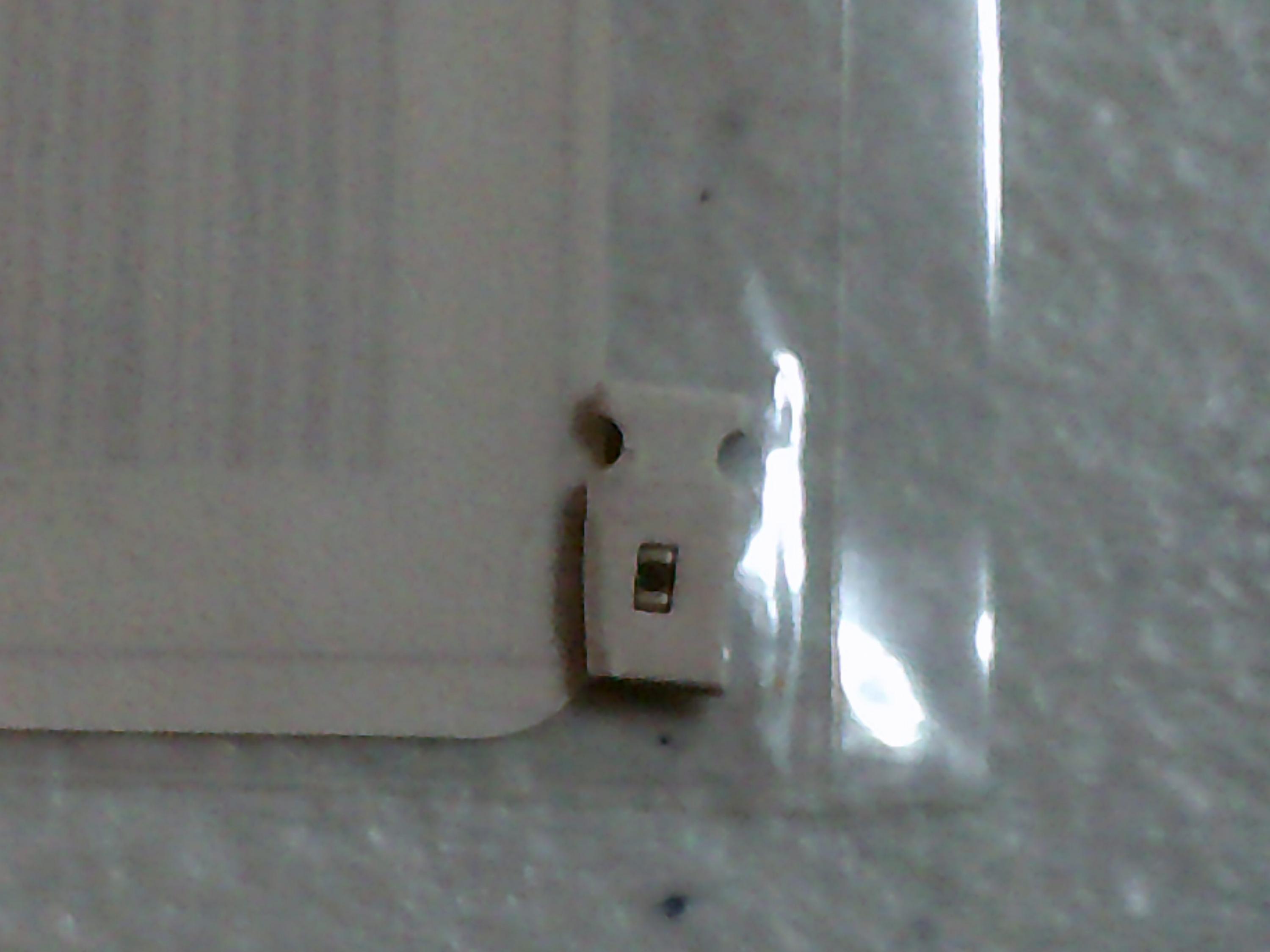

                I ordered the surface mount ceramic cap. Hopfully I can solder something that small.
                http://www.digikey.com/product-detai...179013?cur=USD

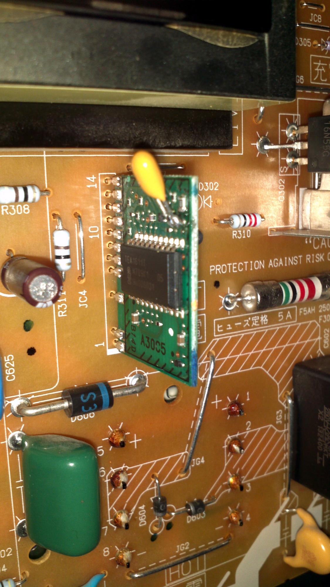

                  The yellow on in the first pic is the one I did on 50PZ80U. It's a
                  1.0uf Tantalum Capacitor 35WVDC bought at Radio shack for about $2. The fix I did was on the MC301 for 10 blinks. I didn't do the MC201 even though some said you should do both. I've thought about opening it back up to do it. But it's been just over a year and the set is still working. So I figure heck with it. If it stops I'll worry about it then. Yes the soldiering is a challenge. I took the board off the PS to make it easier.

                    Re: Panasonic TH-42PZ80U 2 blink
                    I got the caps today and want to make sure i get them in correctly.
                    There are no positive or negative markings on it that I can see but the video I watched said to put the negative side toward top of board.
                    how do I know what end is negative?
                    I also picked up a few 1uf 50v alum smd caps like in video as a backup/spare
                      There is no polarity for a ceramic capacitor. Either way is fine.
