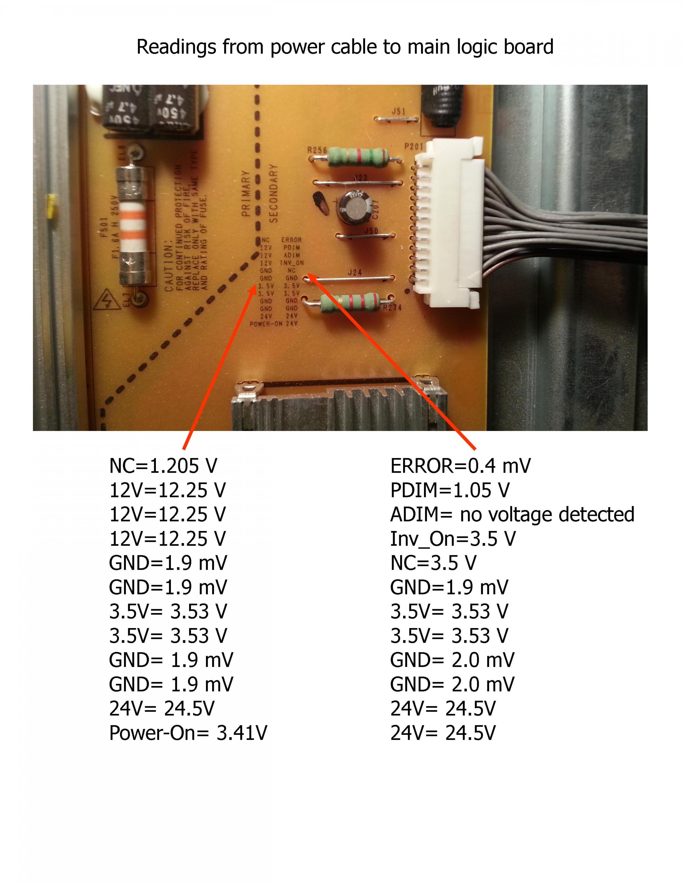

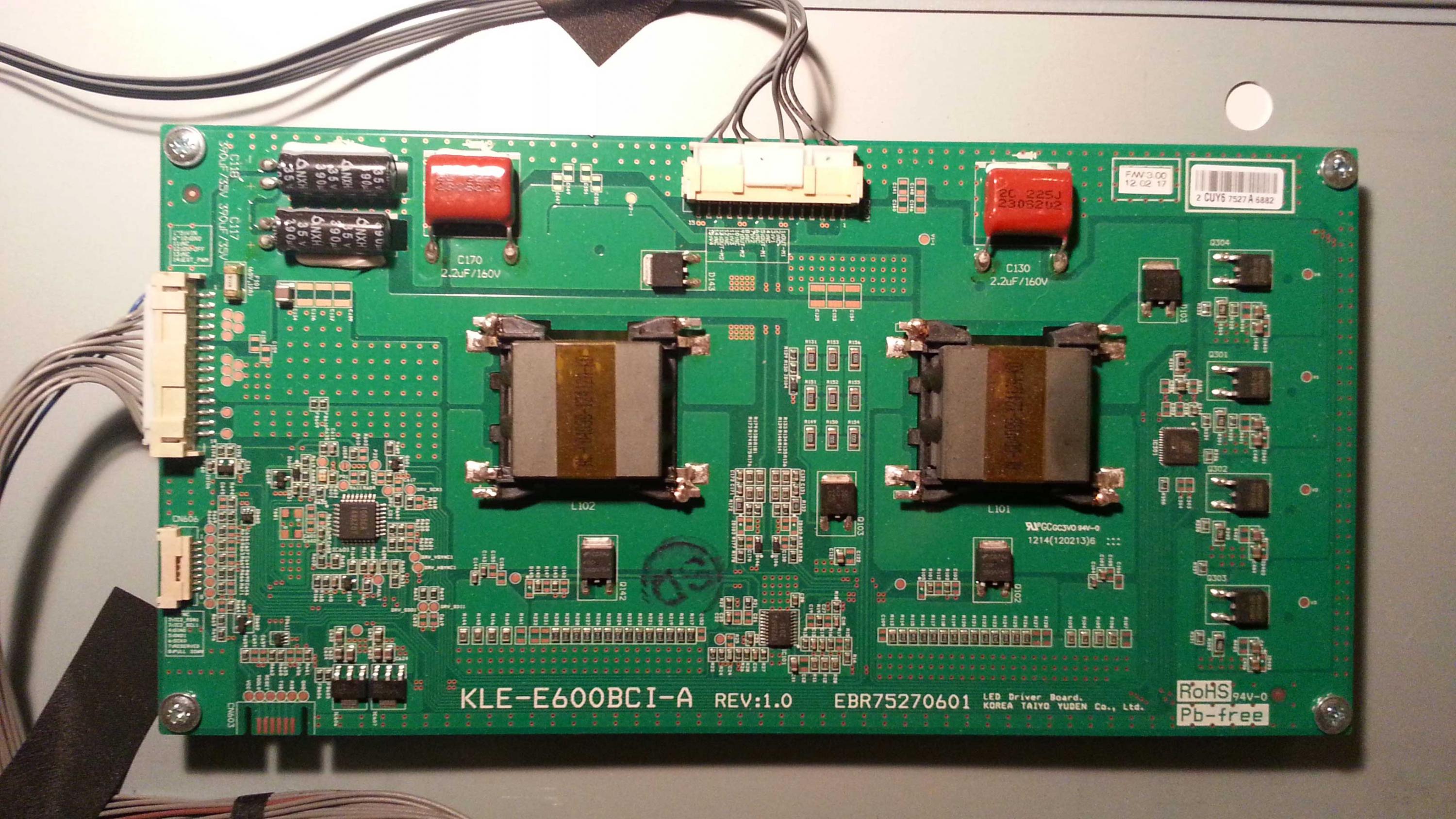

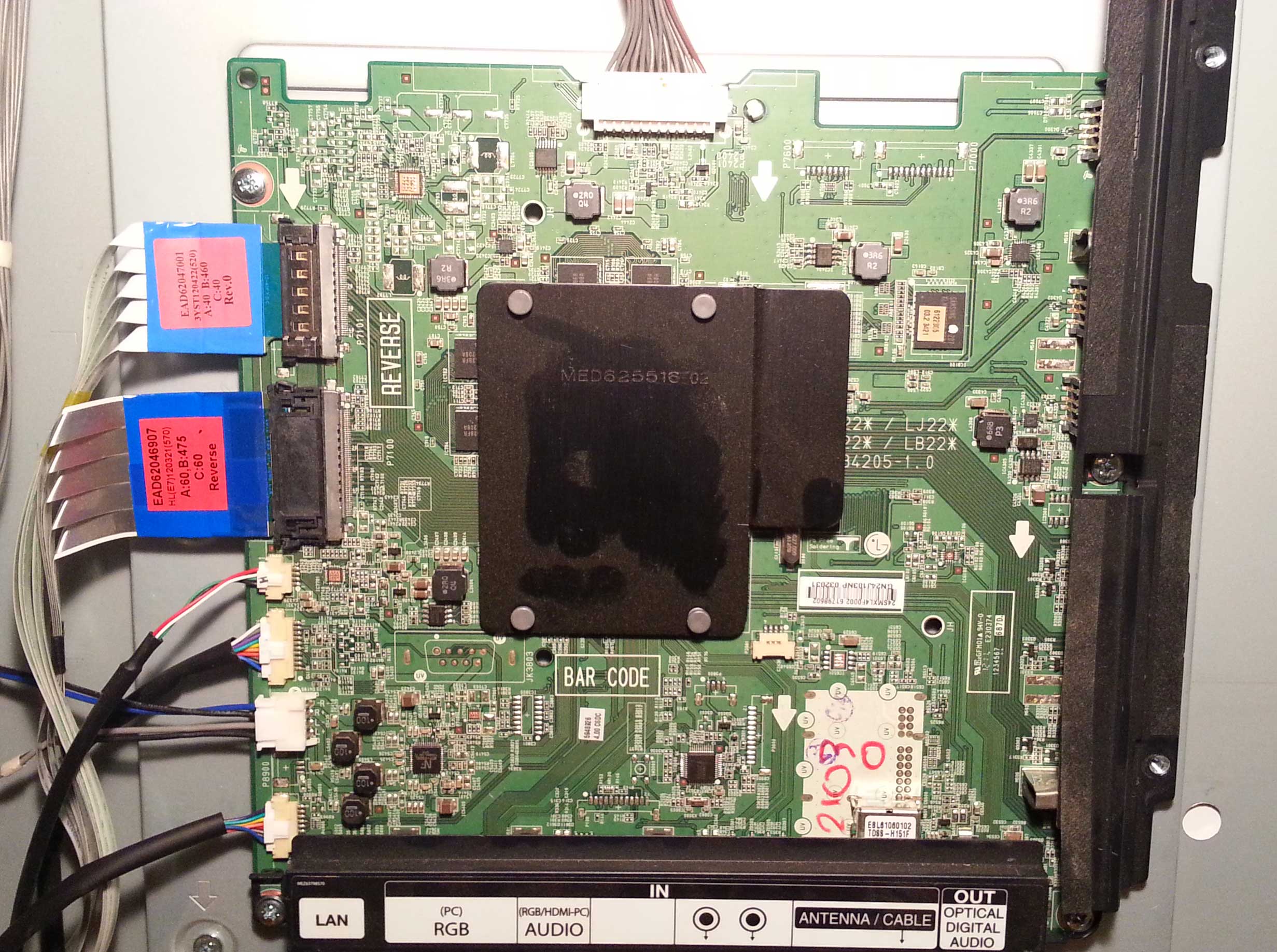

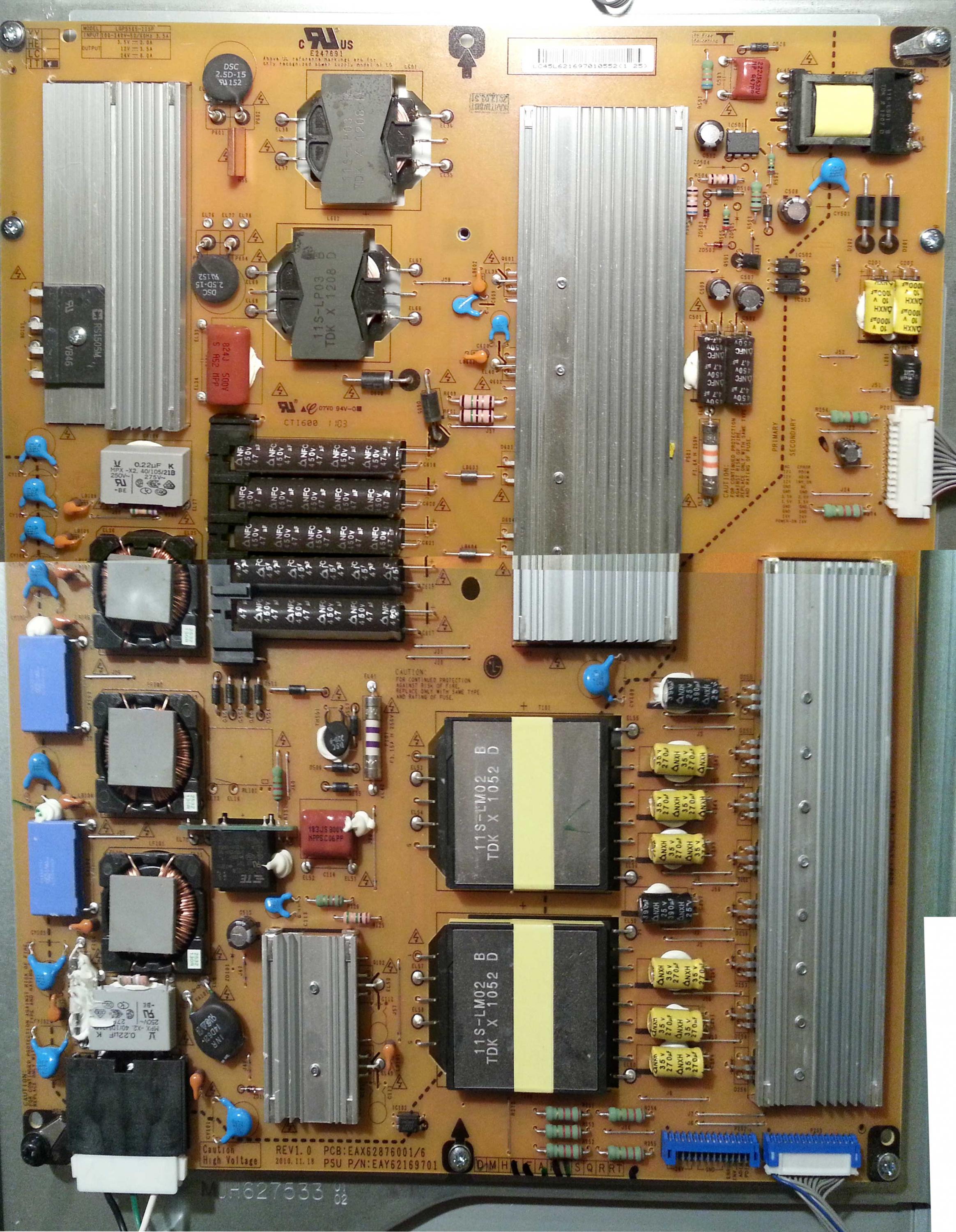

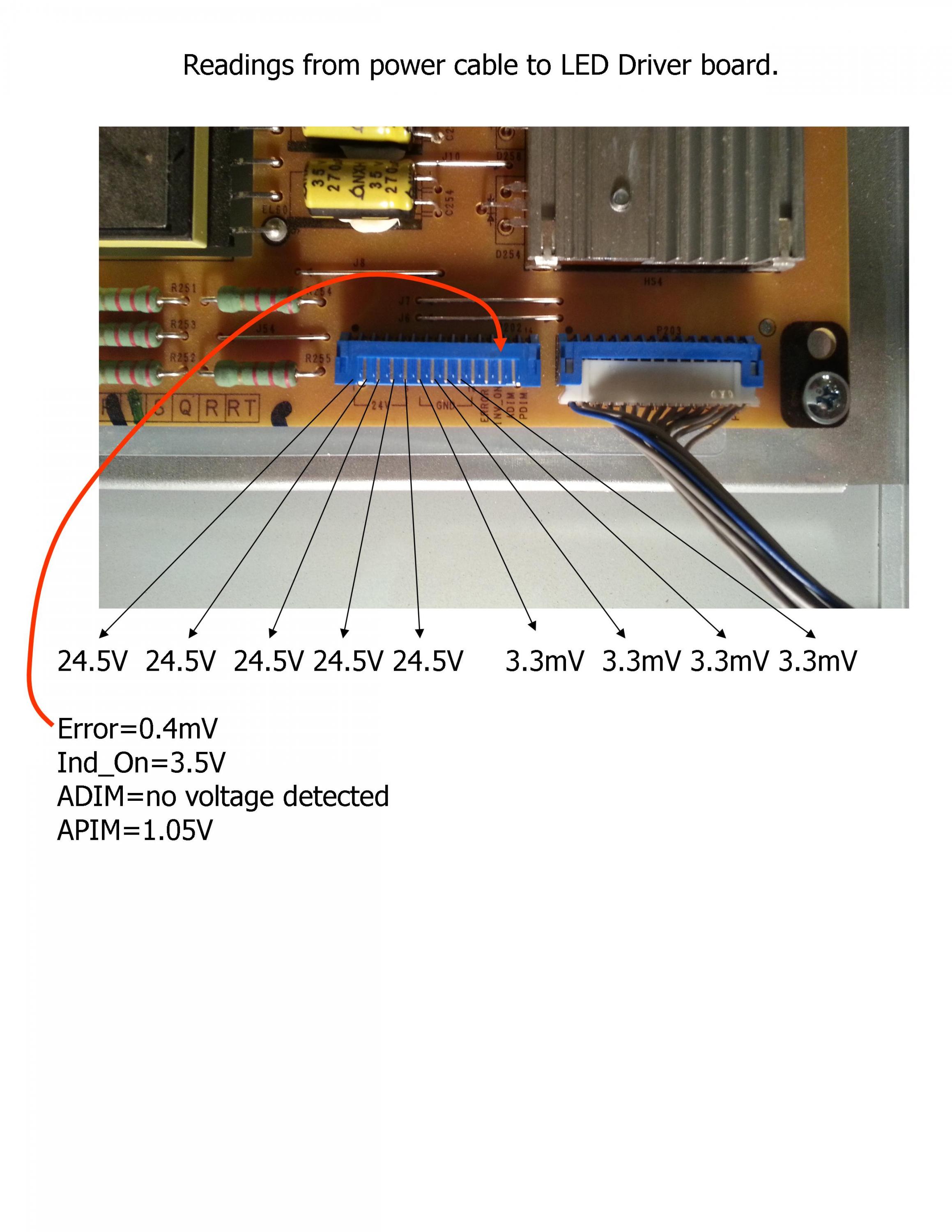

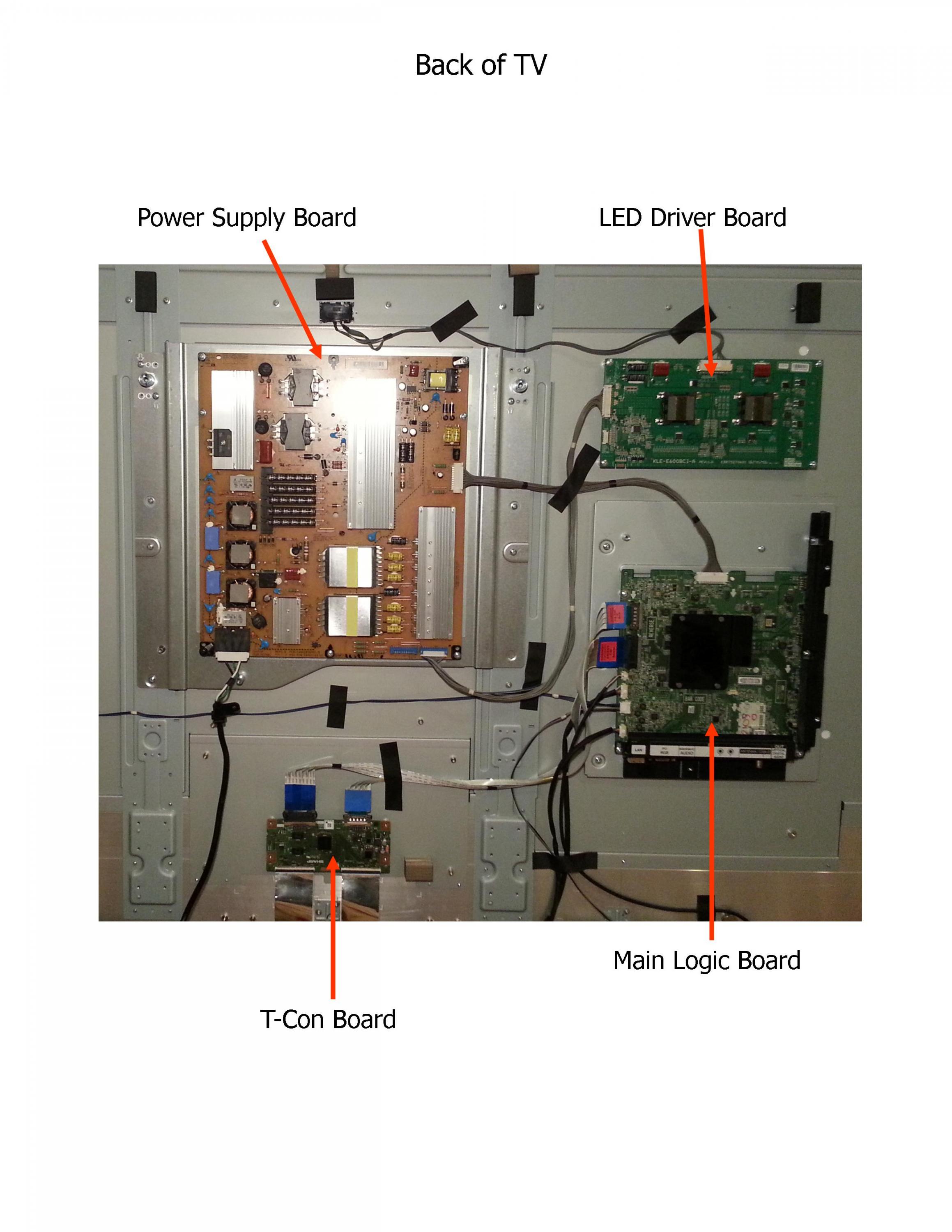

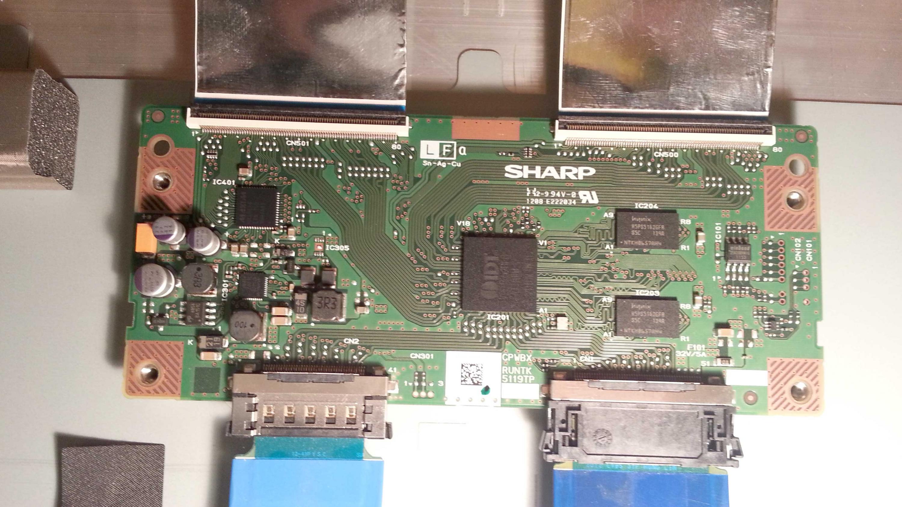

    I have a LG 60LS5750 60" with no picture but backlight/screen works. Could not determine if audio works. Opened up the back and all components seemed to be okay physically. Voltage measurements were taken from cable to main board and to LED driver board. See attachments. Thanks in advance for your assistance.

    There's a fuse F101 on the T-con board.
    Measure the voltage on each end of the fuse relative to the chassis with the TV powered on and in the fault condition.
      Re: LG LED 60LS5750 No Picture but Backlight OK
      I measured the voltage on the "YD" labeled fuse: 12.23V (left) and 12.23 (right)

        Do you have an oscilloscope?
        If not, I would suggest the t-con first, then possibly the main board.

          Led backlighting uses an inverter?
            No inverter, but a high voltage, current limited power supply is necessary.
              Does anyone have a service manual for this model, LG 60LS5750?
                Thought LEDs worked off low voltage
                  Lots of them chained in series use a high voltage. Looks to be a little under 160V, judging by that 2.2uF/160V cap.

                    Seen a bunch of these from Costco. Its a bad Tcon board. Part# AGF76630001
                      Any suggestions on where to get the t-con board? I got 2 of these sitting here with the same problem.
                        LG came out with the part number about a month ago. Its a Sharp panel. You can try searching with the Sharp number on the board. But Sharp does not stock the board.
                        Your only hope most likely will be LG, might be awhile before any LG parts distributor gets it added to there system.
                          Yeah I've contacted both sharp and LG only to come to the same conclusion. I have seen these on ebay with broken screens for $150-$250, may be worth it for this part considering I have maybe $100 in the 2 I have sitting here.
                            Thank you for your info., Mt. Man. I got a used t-con card from ebay and the TV is now up and running.
                            I would love to find out the malfunctioning component on the t-con card.

                                T-CON board has to match your LCD panel, you have to match the numbers as printed on the barcode sticker. The same blank circuit board can be stuffed with different component and it will have its own PCB assembly numbers on the barcode sticker for a bunch of LCD panel models. So be careful to match the numbers.

                                    Do you have the picture of this T-CON board of your TV?
                                    The picture on your link to EBAY is not the same T-CON as shown on post1.

                                        Same model TV can have different LCD panels, panel revision, T-CON revision. As I already indicated, the EBAY T-CON only has one input connectors, the one in the post 1 has TWO input connectors.
