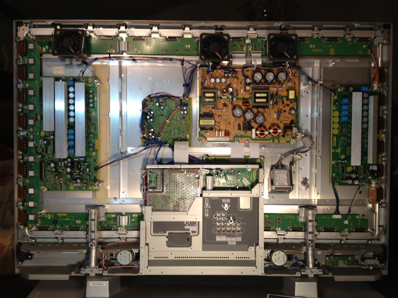

                          Hi Tom. Sorry for the delay. Attached is the picture of the chassis. I ordered a power board from a company called TSM Inc in hopes that it might fix the problem. I replaced the power-board today, but that didnt seem to solve the issue. When i pressed the power-button, the power light went on for two seconds, the tv clicked once, and that was it. Power light never went on again (even after disconnecting/reconnecting the power cord).

                              Re: th50px60u panasonic plasma issue
                              Can we get a close up of power board?

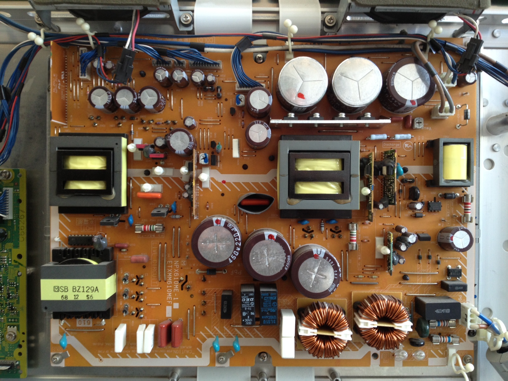

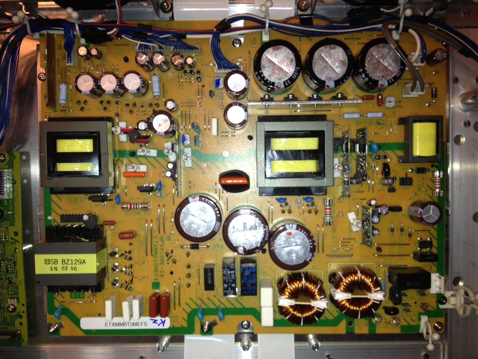

                                    Hey Fellas,
                                    Ok, I am attaching two photos of the Power Supply Unit.
                                    Photo#1 (PSOriginal.jpg): The original power supply unit
                                    Photo#2 (PSNew.jpg): The replacement power supply unit
                                    Is there any chance the issue could be the PA board?

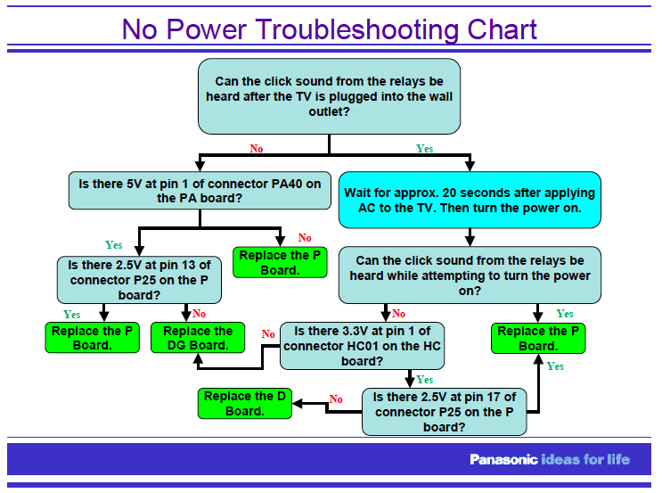

                                        Hello Tom66,
                                        Thank you so much for your response and for providing me the training guides.
                                        They were extremely helpful and definitely tied many of the loose ends, especially with my limited technical knowledge.
                                        I am attaching the "No Power Troubleshooting" flowchart which was illustrated in the training guide (page 39):
                                        http://www.tgohome.com/ServiceManual...&Search=Submit
                                        My questions on this flow chart pertain to, for example, when it states "Is there 2.5V at pin 13 of the connector P25 on the P board?". My questions are:
                                        1) If the P25 connector is already in connection (via cable) to another component on the board, how will i be able to measure the voltage, granted that I will not have access to an exposed pin? If I remove the cable connection, then that will break the circuit to the other boards. Am I missing something?
                                        2) Assuming i can get to pin13, this will connect to the positive terminal of my voltmeter. Where will i connect the negative terminal of my voltmeter to?
                                        3) Does the pin numbering go in the following order (from top to bottom)?:
                                        1 2
                                        3 4
                                        5 6
                                        7 8
                                        etc...
