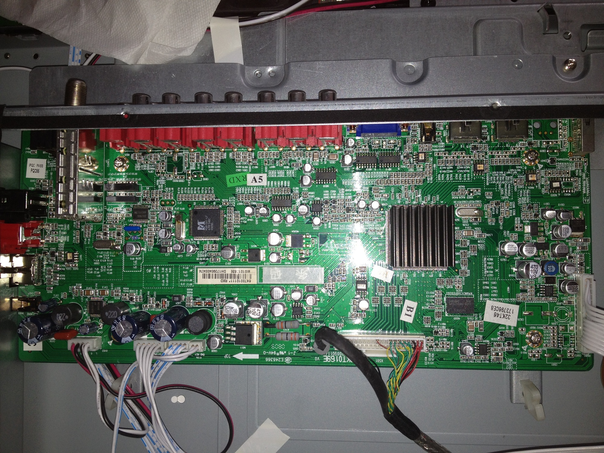

    DX-L32-10a won't power on stuck in standby
    All voltages are good 5,12,24. C610,C611,N603 on the right side of the board in the pic of the main board are getting extremely hot to touch. Any ideas. There's no picture standby light is on but nothing when power is pressed. I've went through another post on here of the same exact model and tried all those things. Thanks!

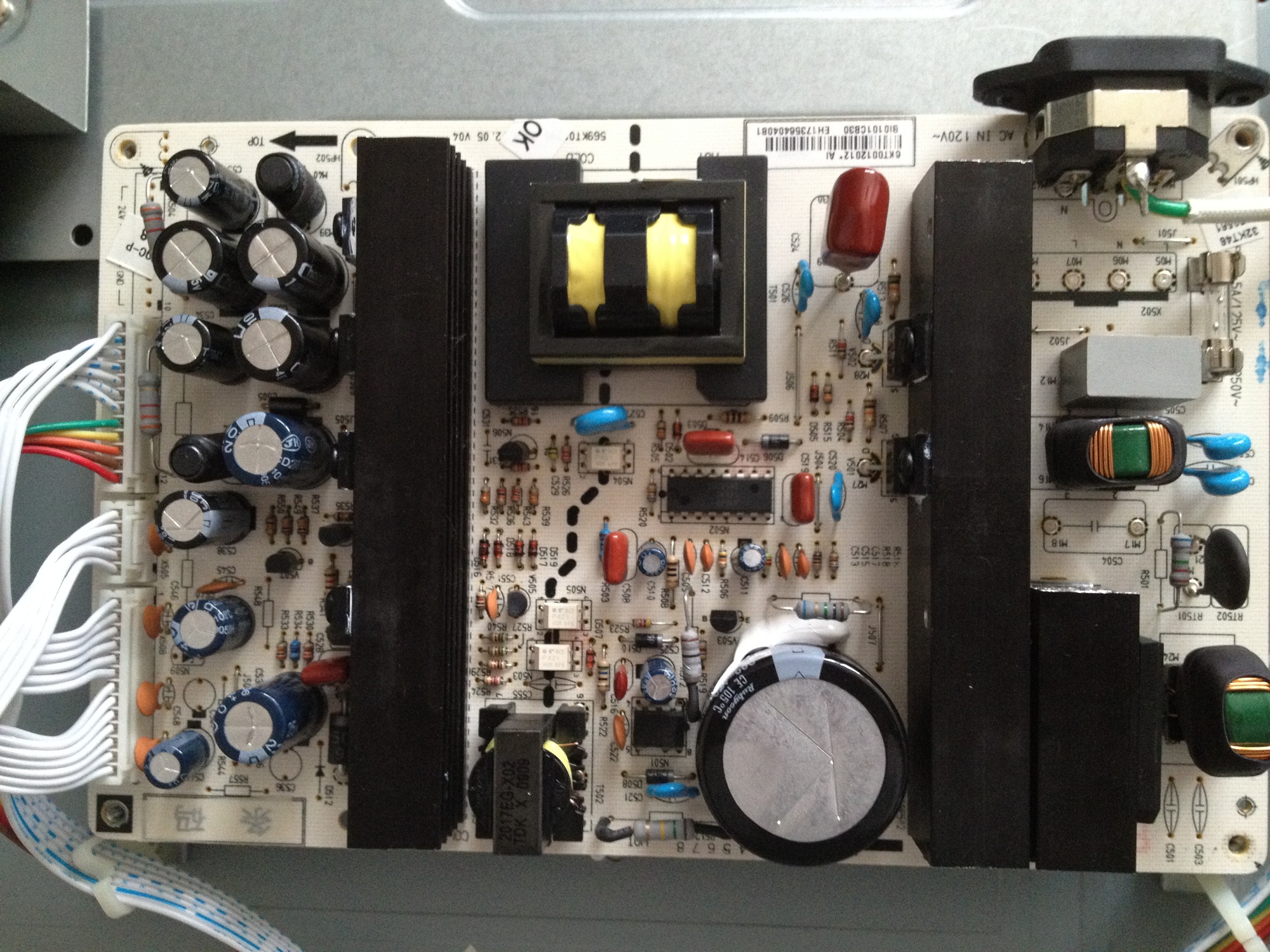

      1) Did you change the capacitors on the power board? It is strange to see Rubycon caps (quality) mixed in with Changex? (crap).
      2) Measure your voltage regulators to see if they are within specification (see below).

        Re: DX-L32-10a won't power on stuck in standby
        Those two caps should never get hot to touch at all unless the N603 (NUMBER???) gets so hot that it heats up that area. You should get the voltage reading on the caps and on all 3 pins of that N603.
          Thanks RetiredCaps and Bud. N602,603,604 are hot as hell as are the caps surrounding them. I need a little help interpreting these voltage regs. N603 is AZ1117D 3.3EI and it looks good. The other 2(n602,604) are 1117L and I looked at the data sheet but i was lost. Heres the readings.
          N602 N603 N604
          1)2.01V 1)0V 1).5V
          2)3.25V 2)3.31V 2)1.78V
          3)5.29V 3)4.95V 3)3.30V
          Voltage Across
          C610=4.96V
          C611=3.30V
          C621=3.32V
          Thanks for your help.
              The Voltages of the regulators are normal, still the caps should not be hot at all, something does not make sense yet, those cap should be bulging right now with that much heat.
                Thanks BundM. Just an update. We pulled the N603(AZ1117D3.3ei) and now none of those caps get hot. Could that be the problem.
                      OK. for the regulator to get that hot and causes the surrounding component to get hot also, it means that too much current is flowing through the regulator. But I do expect the regulator to go into shut down mode. Not sure what else to tell you at this point.
                      You can take the resistance reading between chassis ground and each pad of the regulator to see if the output is feeding the current into really low Ohm.
                        If the regulator is oscillating, the capacitors will get hot.
                        The regulator can oscillate if the capacitors on the output fail.
                          Thanks, Tom, I forgot about that, may be he should replace the caps for the input pin and the output pin at the same time. He does not have the scope to look for the oscilltion, so replacing caps may be the easiest thing to do.
                            Also, usually (not always) when the regulator oscillates, the output will be a little low, maybe 5% or so. Most LDOs are 1% or 2% grade.
                              Thanks guys replaced N603 and no go. N604 gets hot as sh*t as does c10 and c11. Whats the easiest way to remove those smt caps on the input/output. Tried an iron but no go. Also emailed Dynex for a schematic. Thanks!
                                But you did not replace the caps, the circuits will oscillate if the filter caps are bad a s Tom has pointed out.
