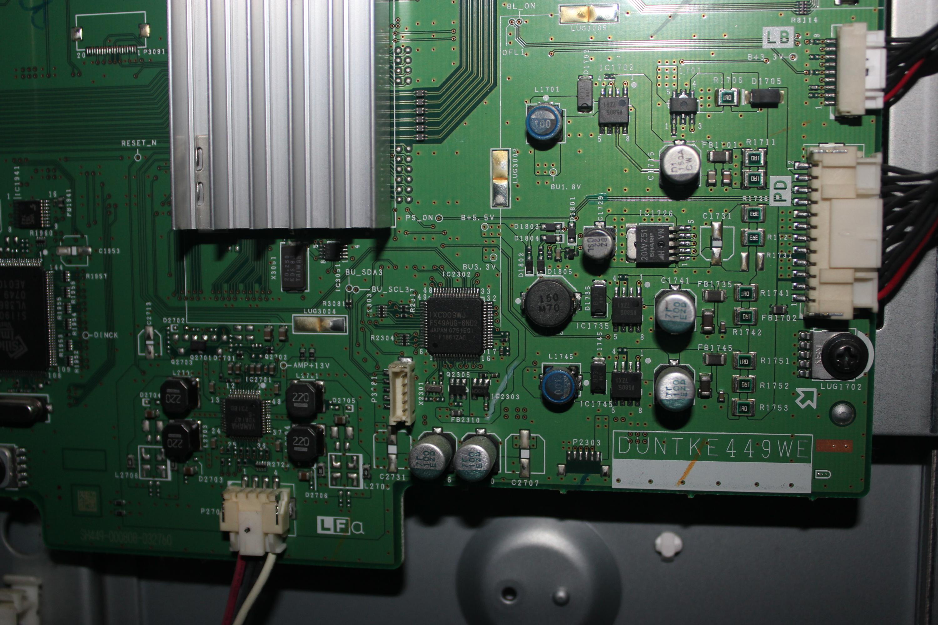

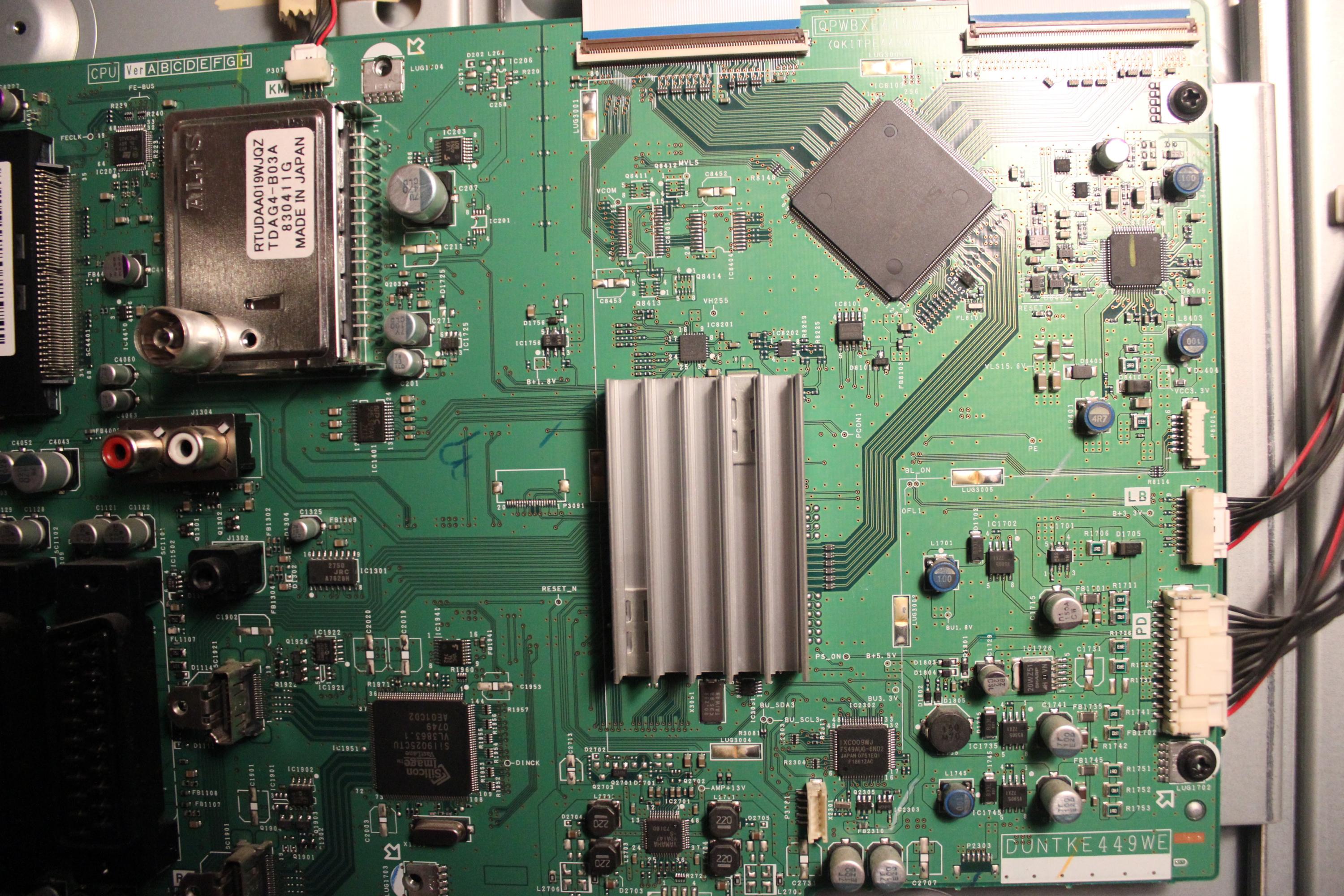

    Hi guys, not sure if this forum is for me as i have no experience in voltage testing (nor do i have the tools) when it comes to electronics...
    My LCD TV turns on (green power led) but after a few seconds turns back to red.
    I've taken the back off it, thinking i'd clean it up but it was imaculate, also checked wires and all seem connected properly.
    I know it's not much to go by but any ideas based on these symptoms?
    Thanks for any help/advice you can bring!

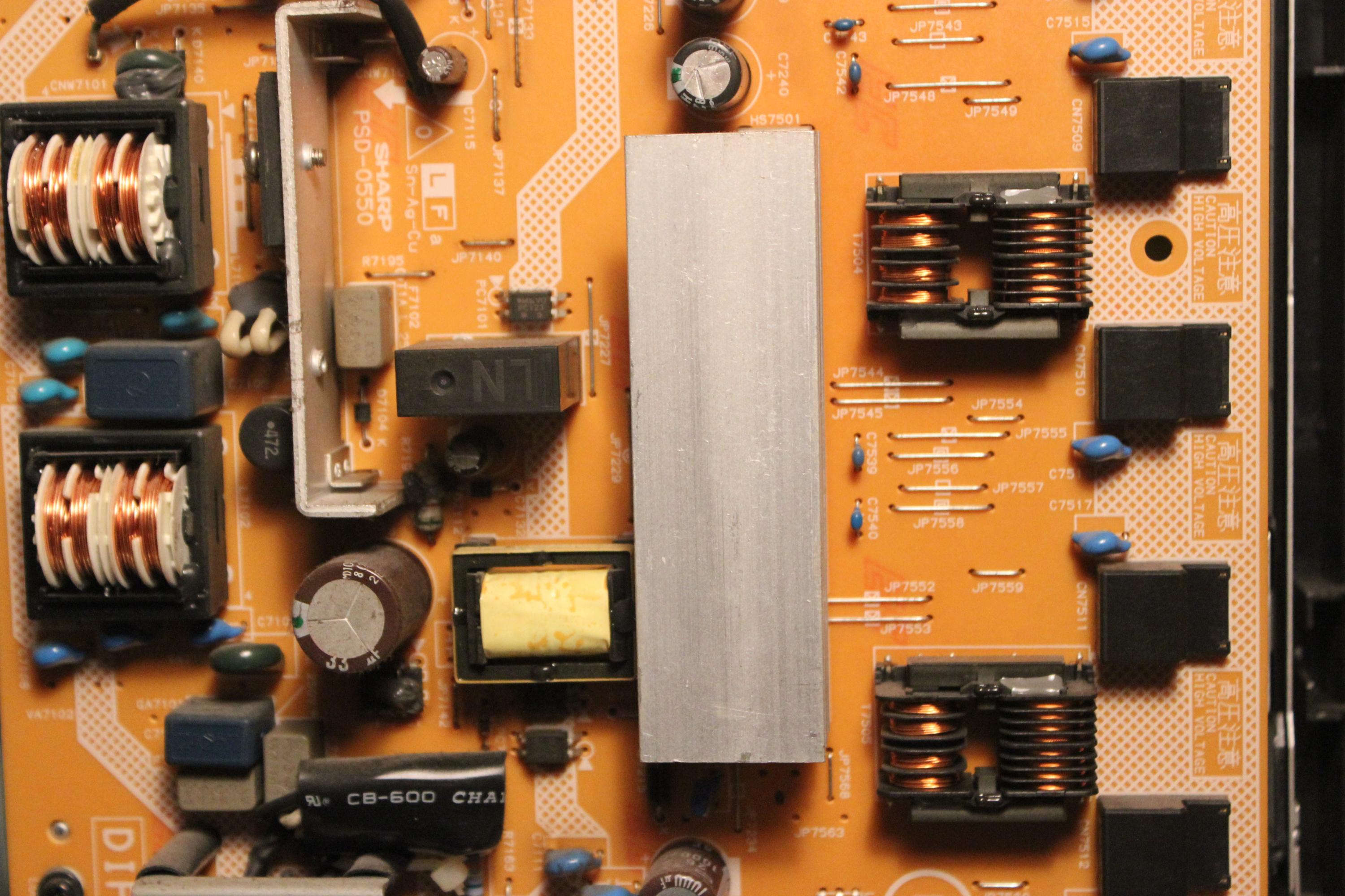

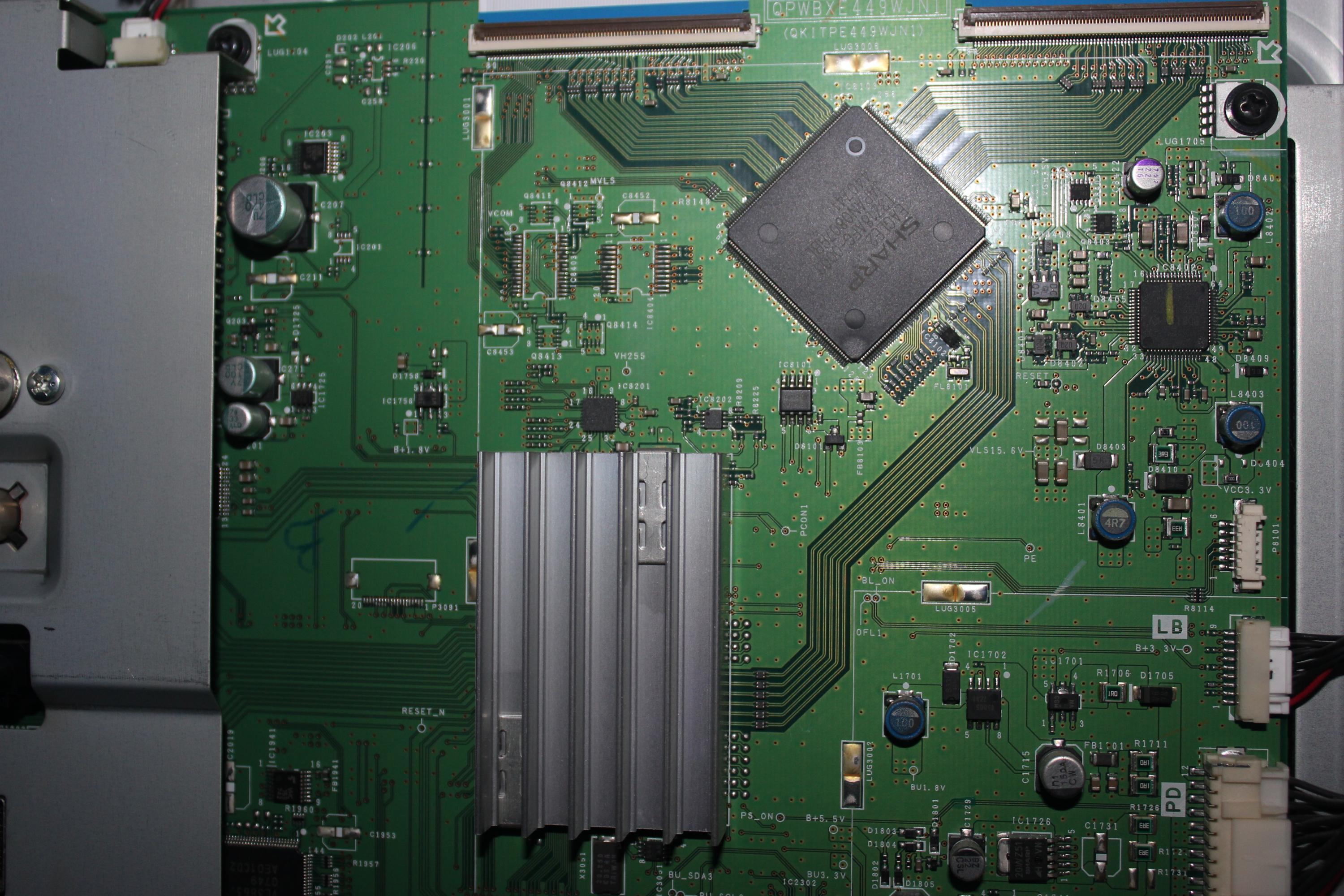

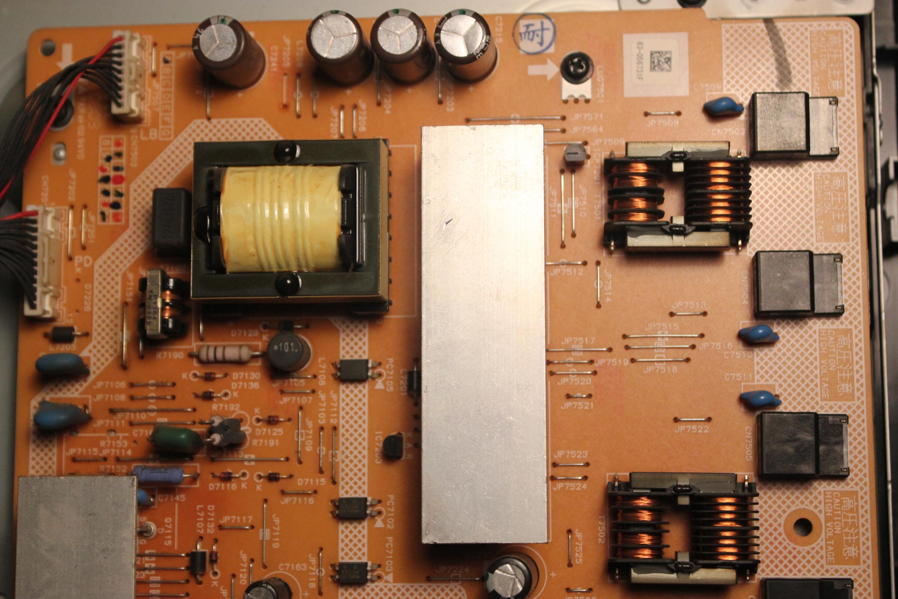

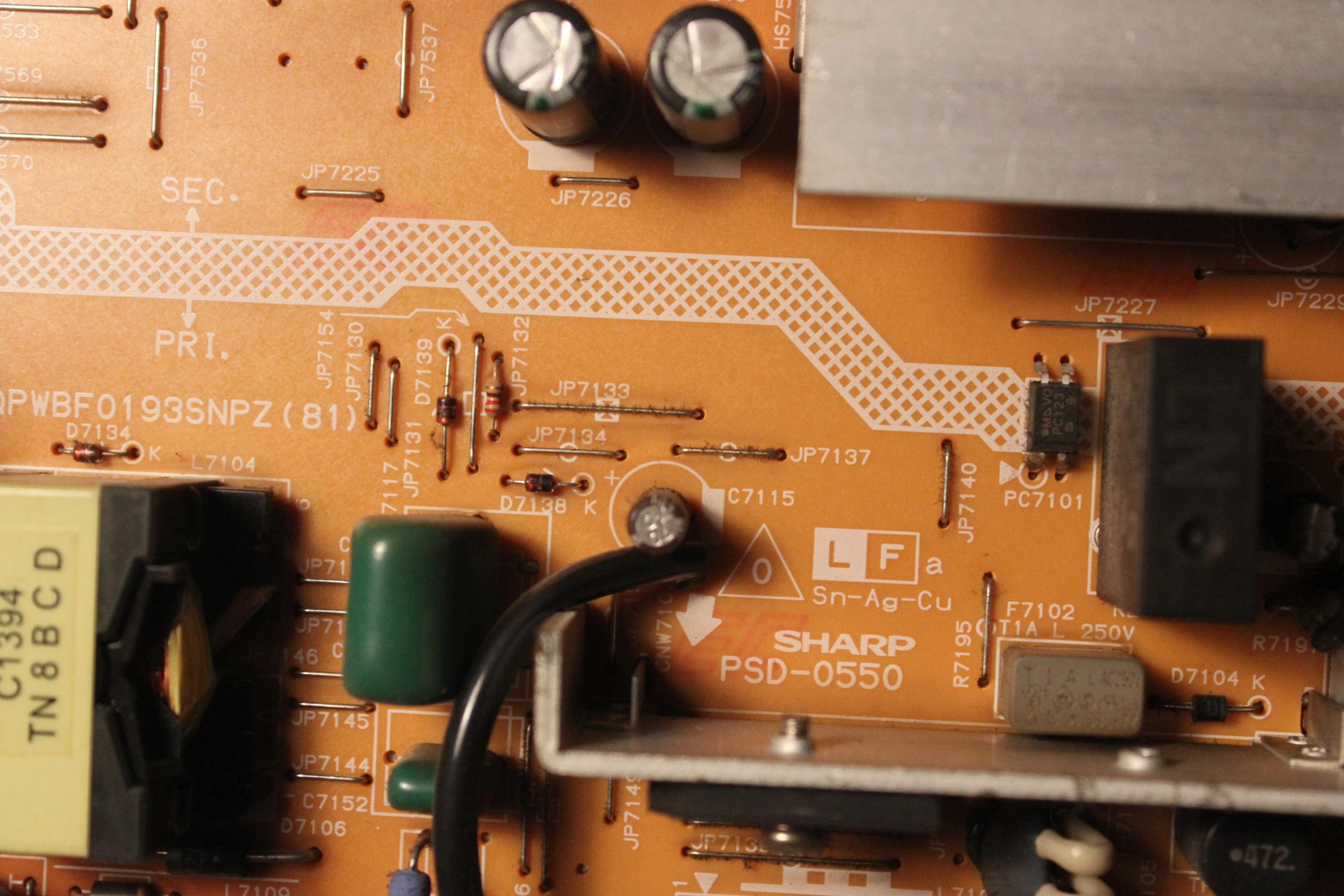

    Take some nice close up pics of the power board.
    Use the manage attachments option to upload pics.

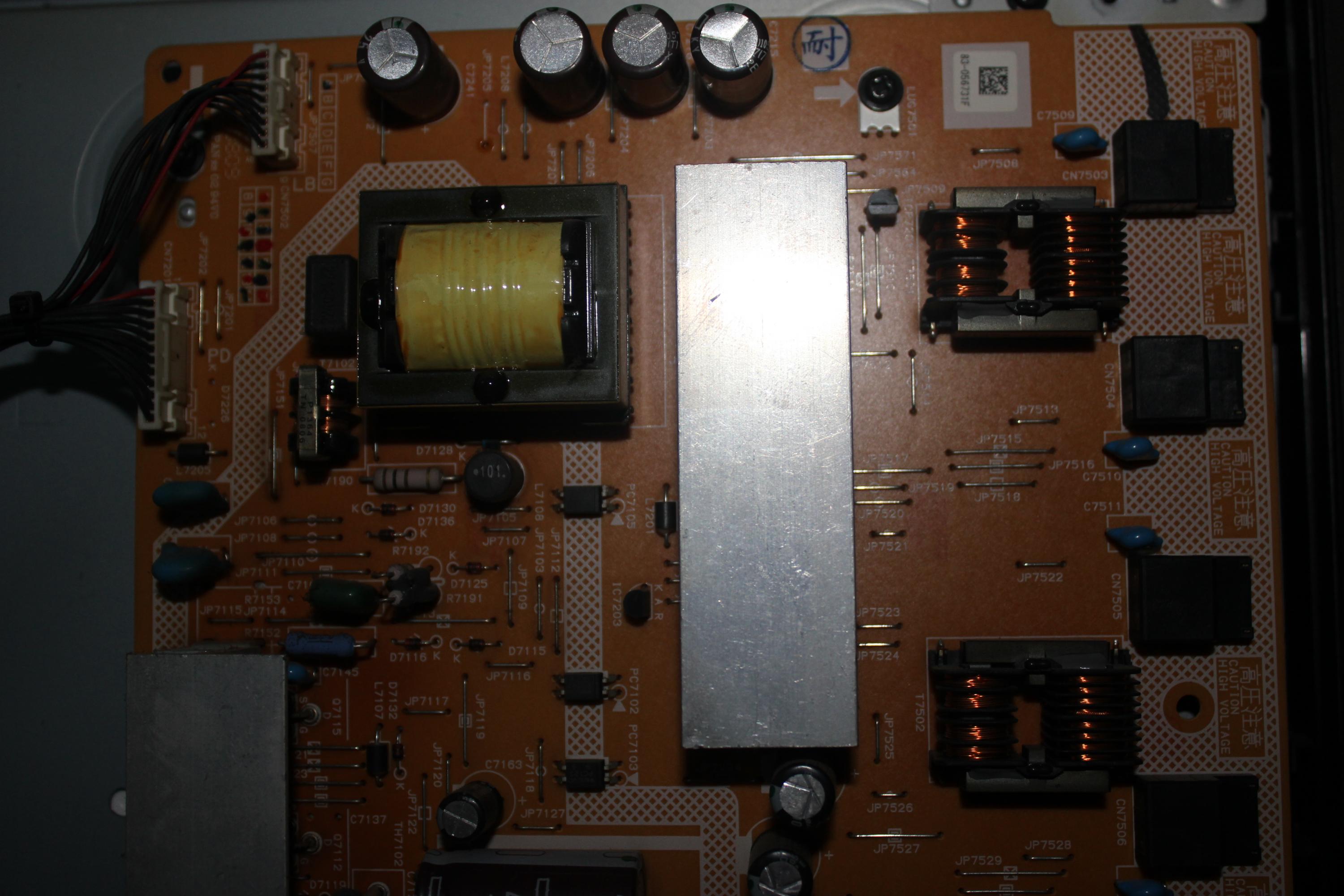

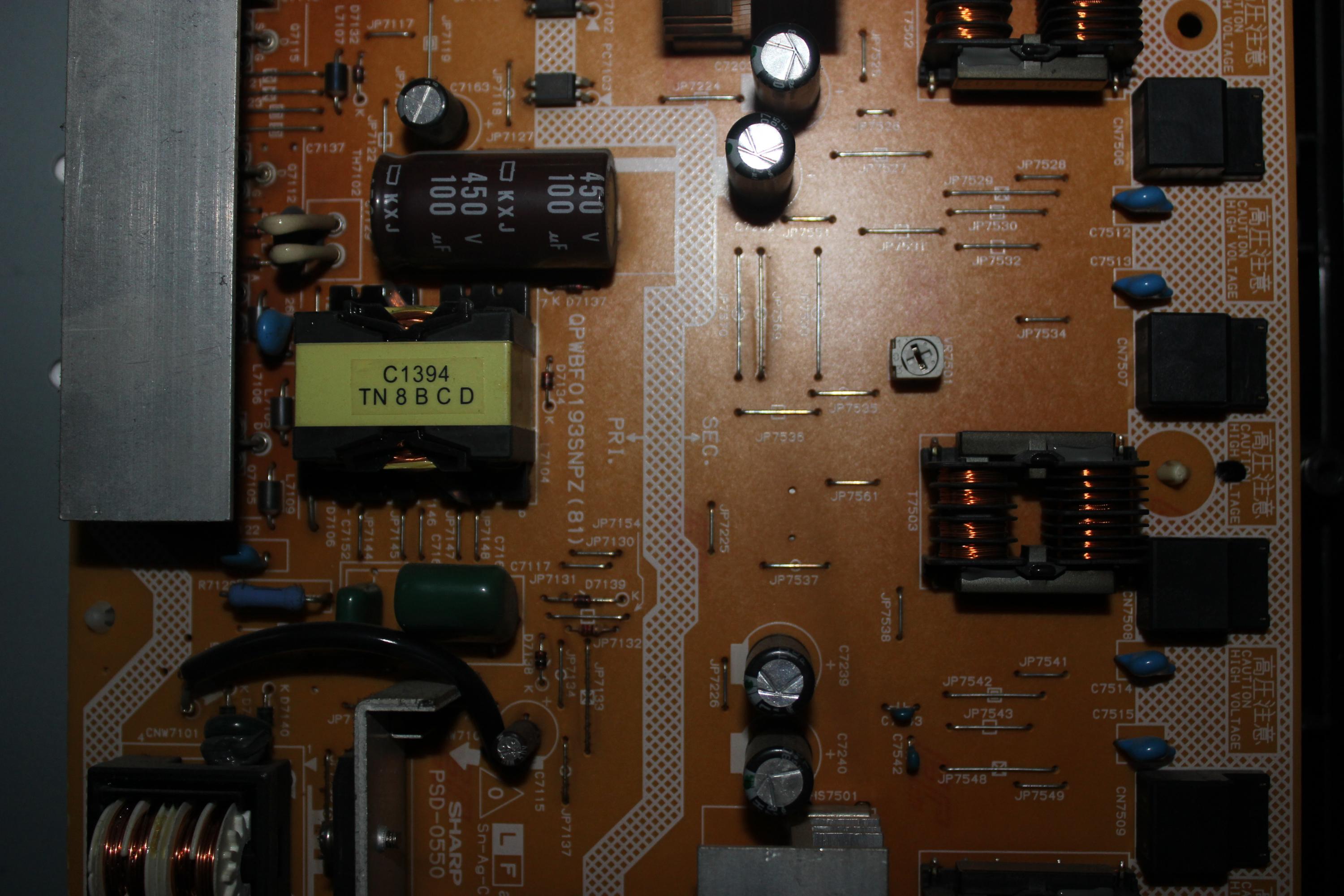

      Thanks Gilly!

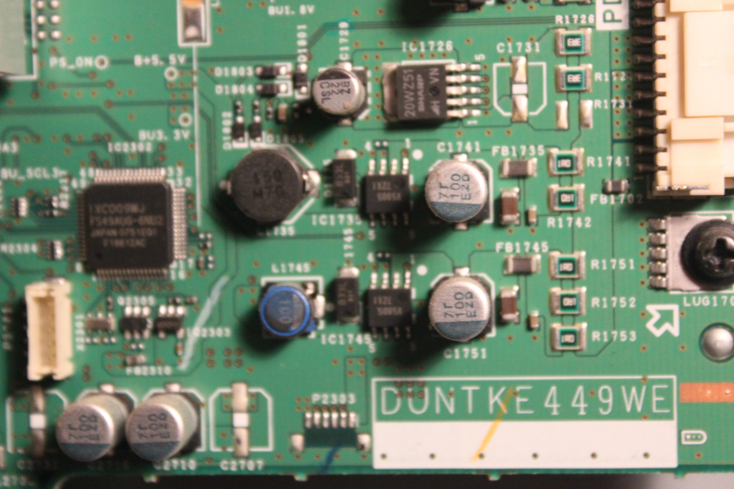

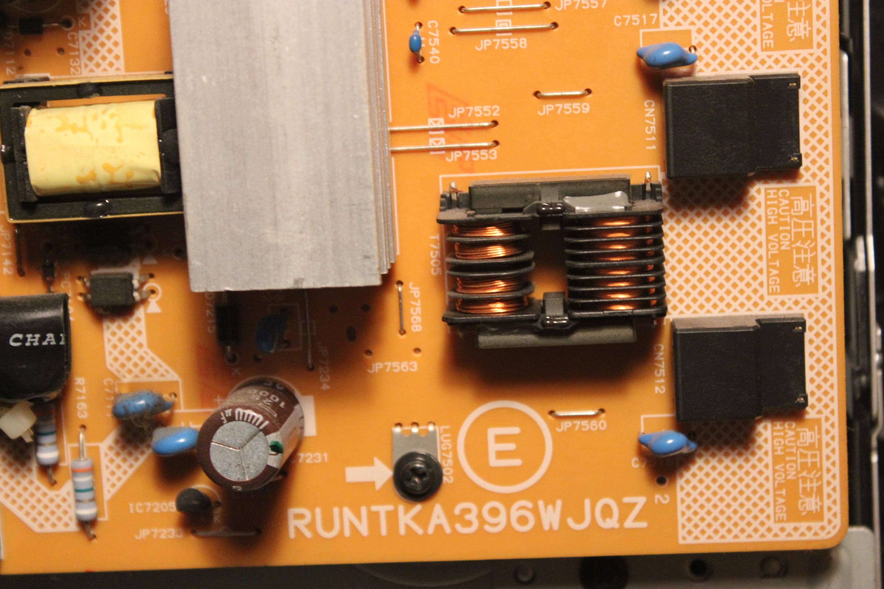

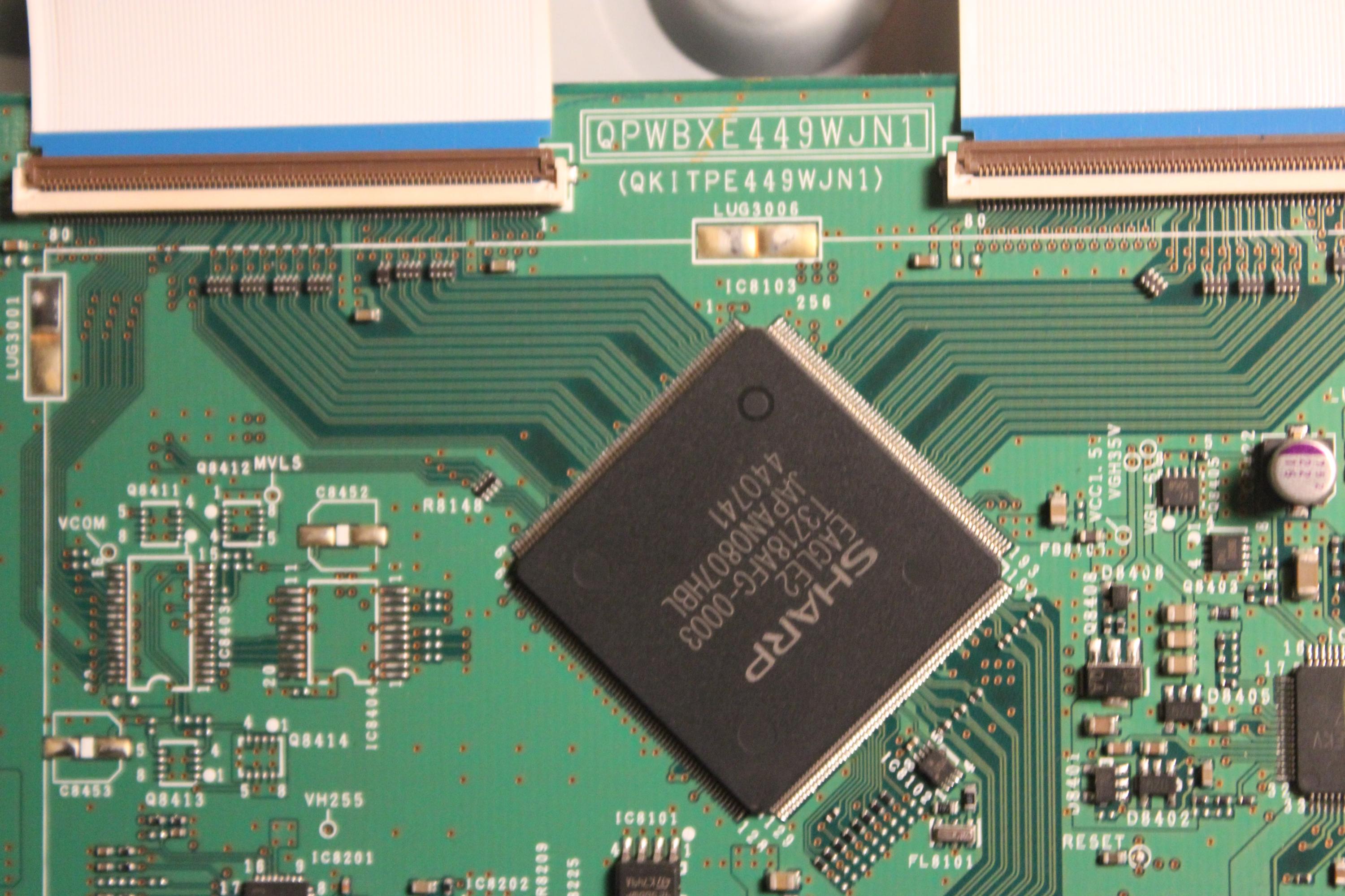

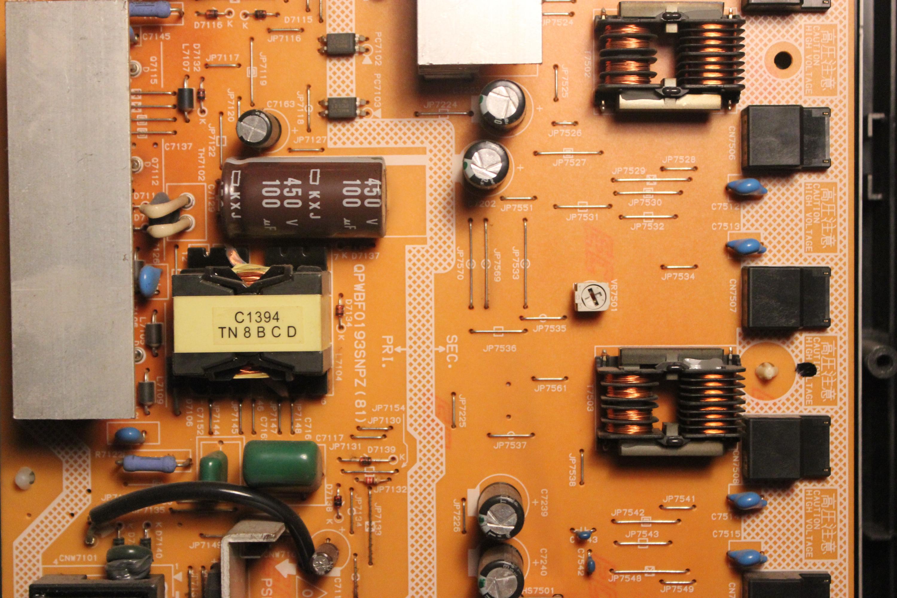

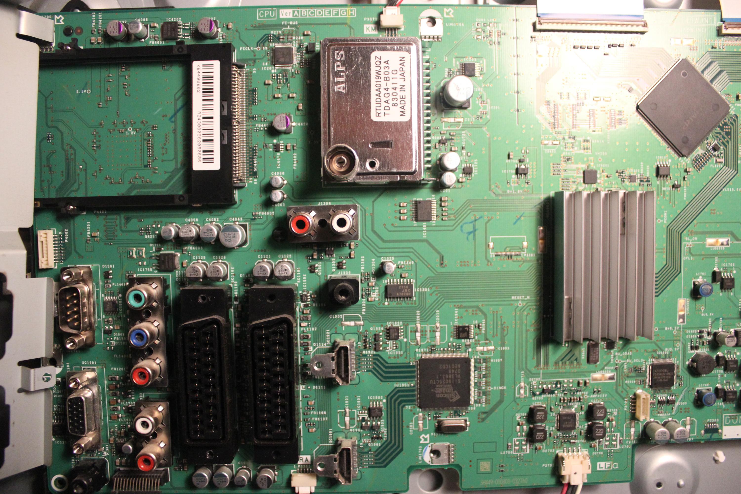

      Attached are the pictures you asked for. Hope this helps.

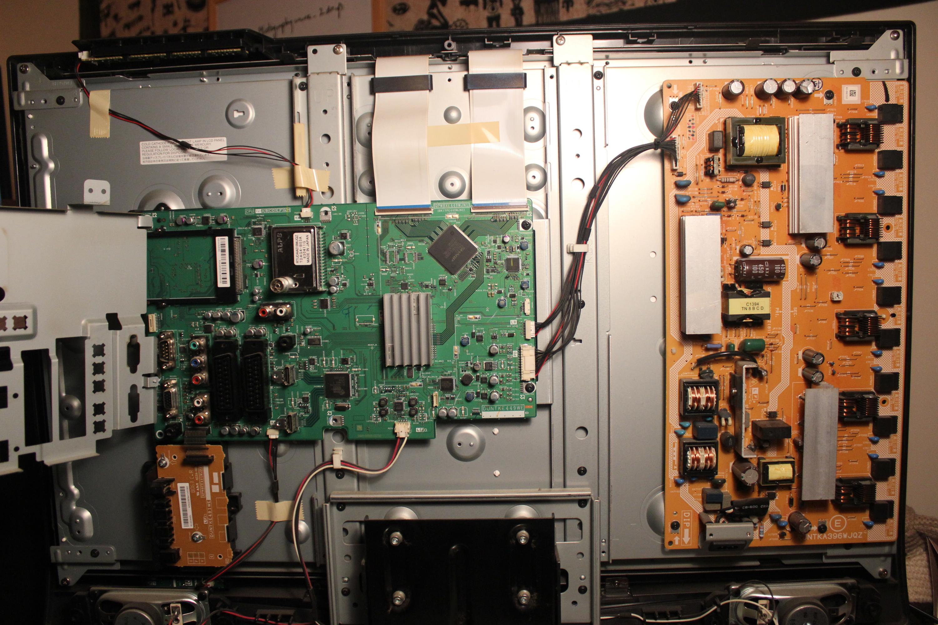

        Pictures are not clear enough you need more light less flash One of whole of the set with the back off is useful and one of the complete boards. They need to look like these

          Re: sharp aquos lc-32d44e-gy issue
          Hi, ok i'll take others. your links aren't working
          the tV was working fine last night and the problem started as soon as i turned it on today.

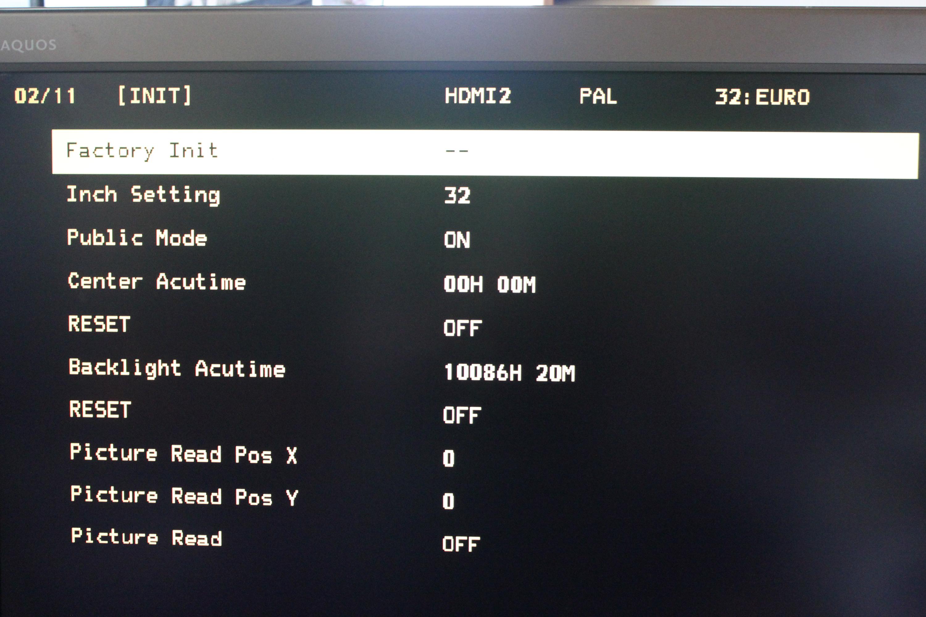

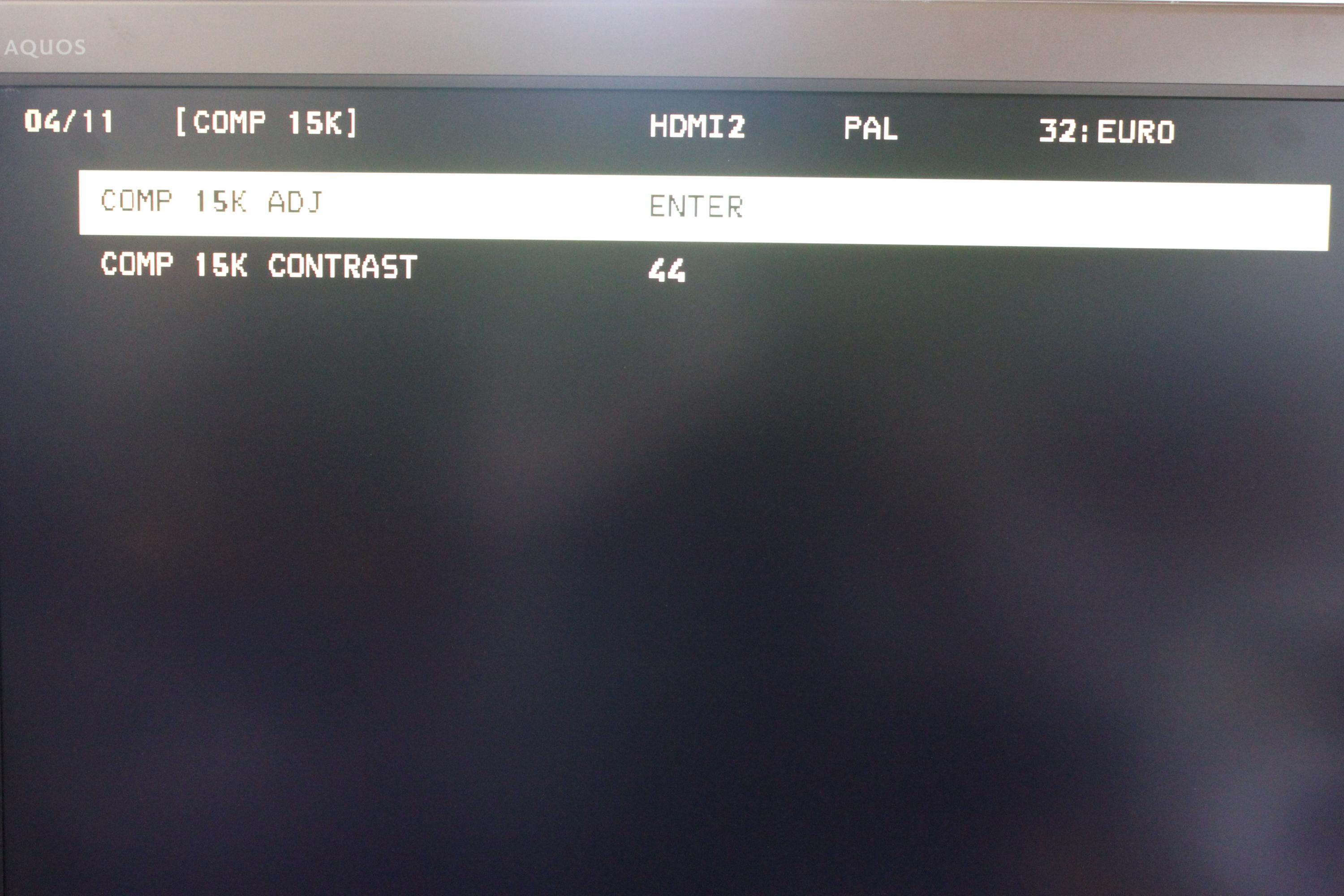

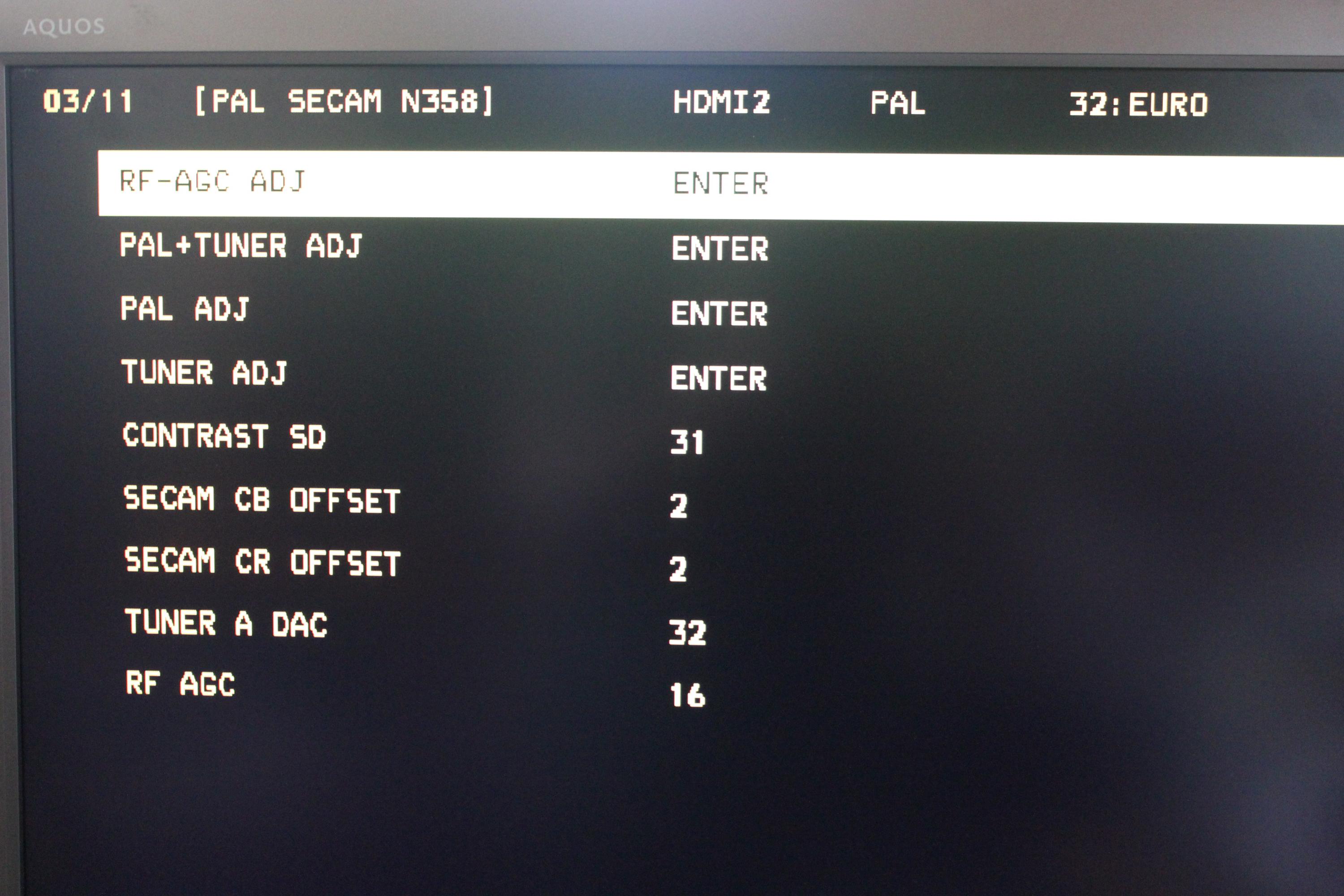

          Have since managed to start in diagnosis mode (vol down, input and start button) and then in extended mode (vol down and channel down). This brings up a new menu and tried to reset to manuf settings but it always switches itself off after a short while (up to 20 seconds). on this menu, i do get picture and sound, but (in normal mode) i don't get either. No ticking clicking.

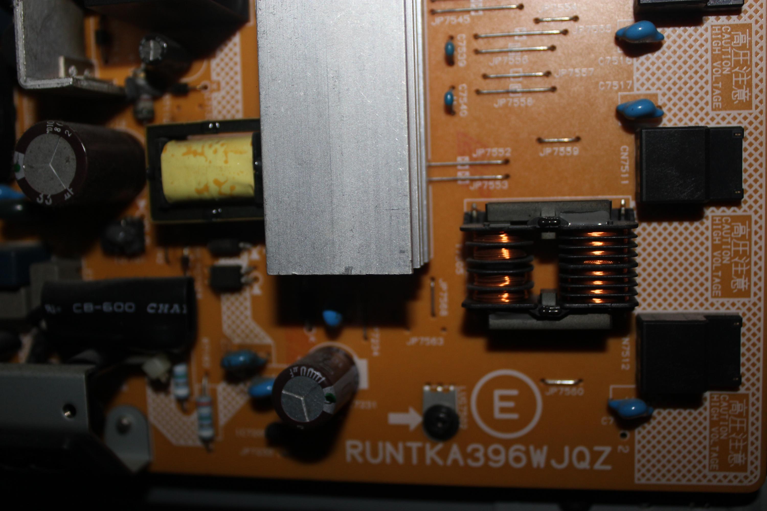

            Thanks - must have become corrupted - I use it regularly and no one has commented - perhaps they dont open them!!
            Anyway they are much better - cant see anything really bad. Can you just check the top righthand capacitor in the row on top of the power supply C7215 -it looks odd compared to the others. Is it a different make and does it look at all bulged
              Hi Selldoor, these are the 4 same capacitators (KY 25V 1000 F)but the one on the right is p[laced slightly higher than other 3. it does have a very slight bulge on the top triangle.

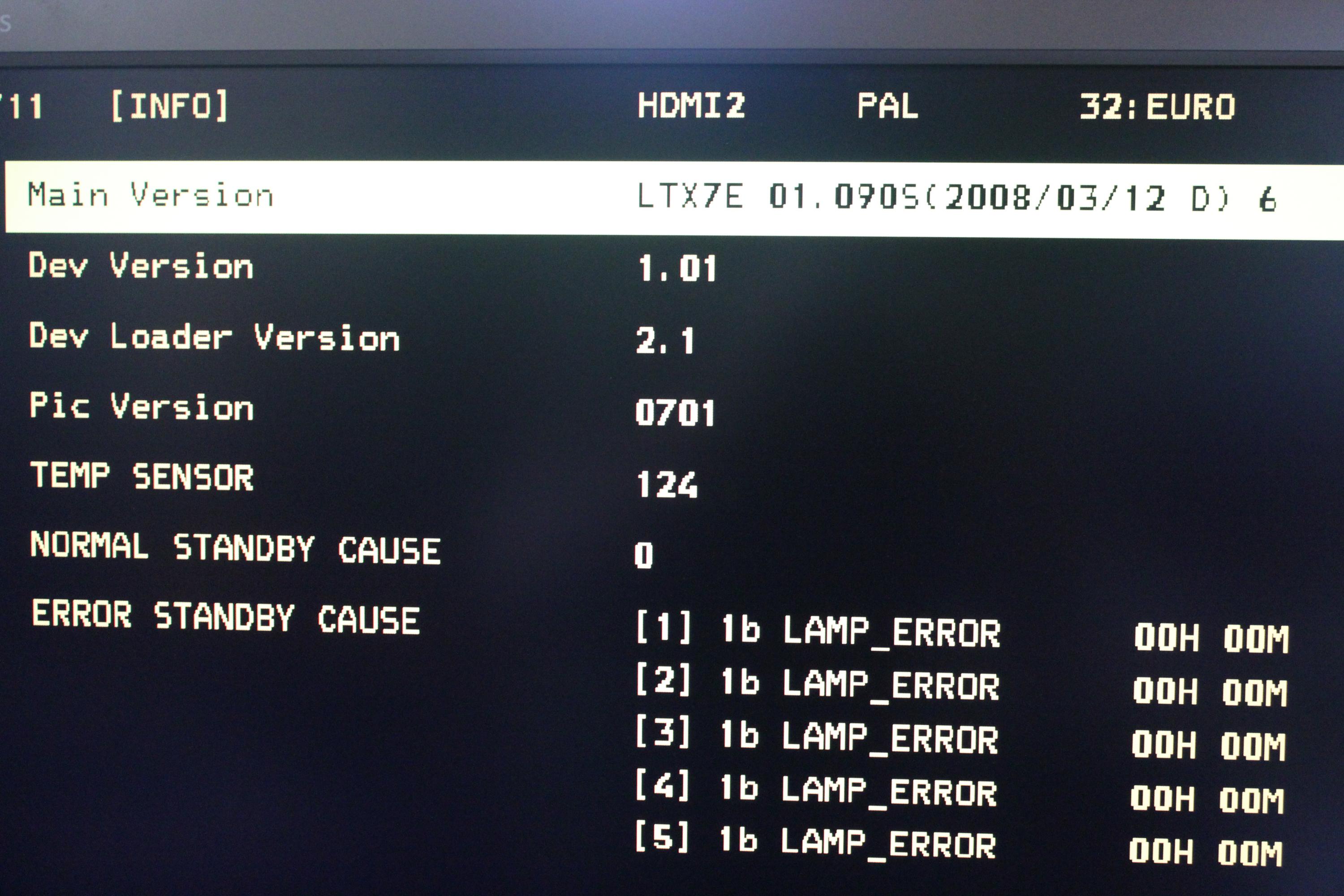

                                  Tom, solid green light until uit turns solid red. no blinks
                                  Edit: not sure if it helps but i've attached pics of the firmware menu
                                  What are these 'lamp errors'?
                                    Those could be the cause of the trouble. Could be a worn out CCFL or inverter problem.

                                        Well this is probably only a temporary situation but after resetting the firmware i haven't had any problems (yet)... At least it gives me time to start looking for a new set. Thanks all for your help and happy xmas!
