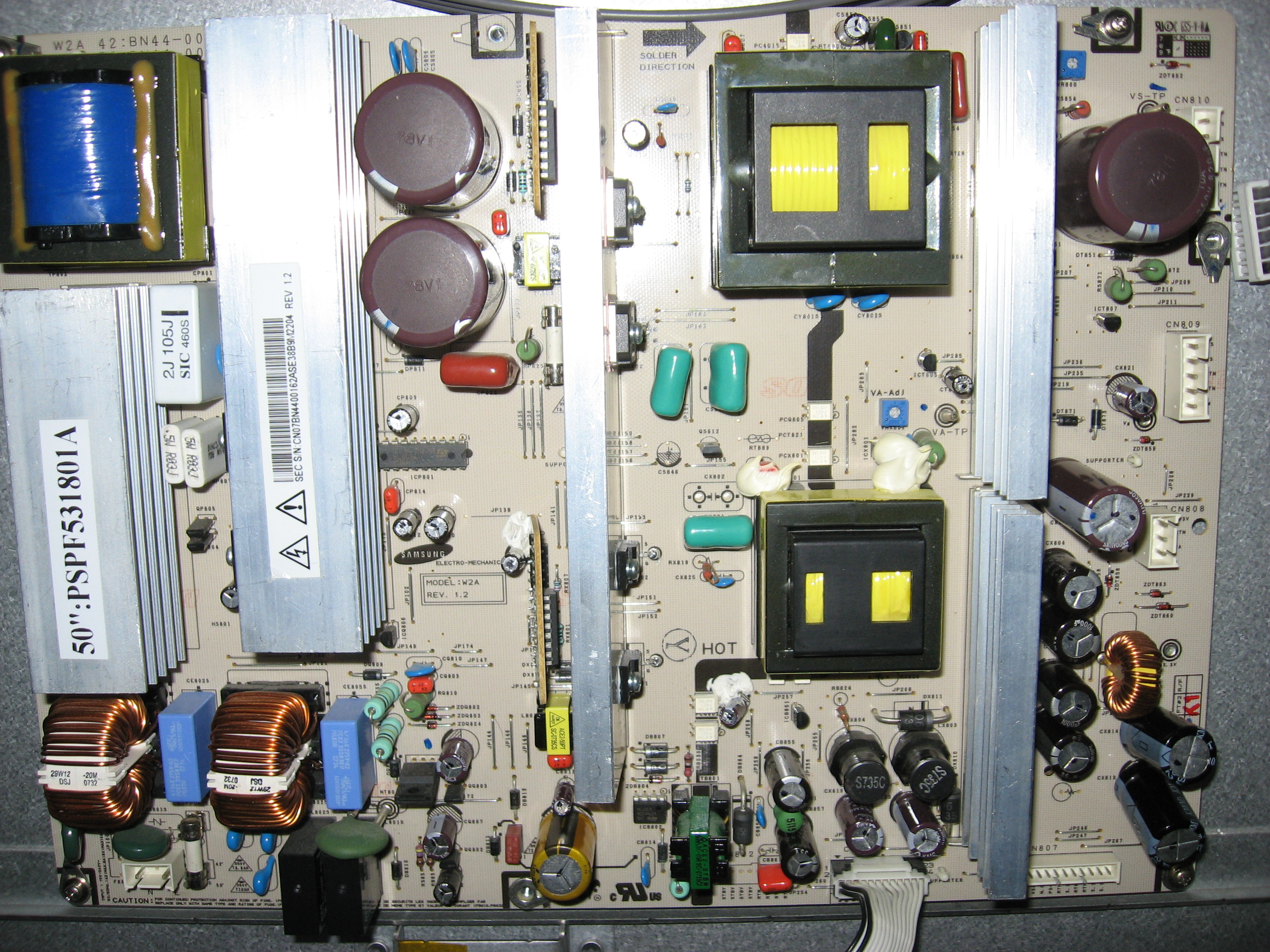

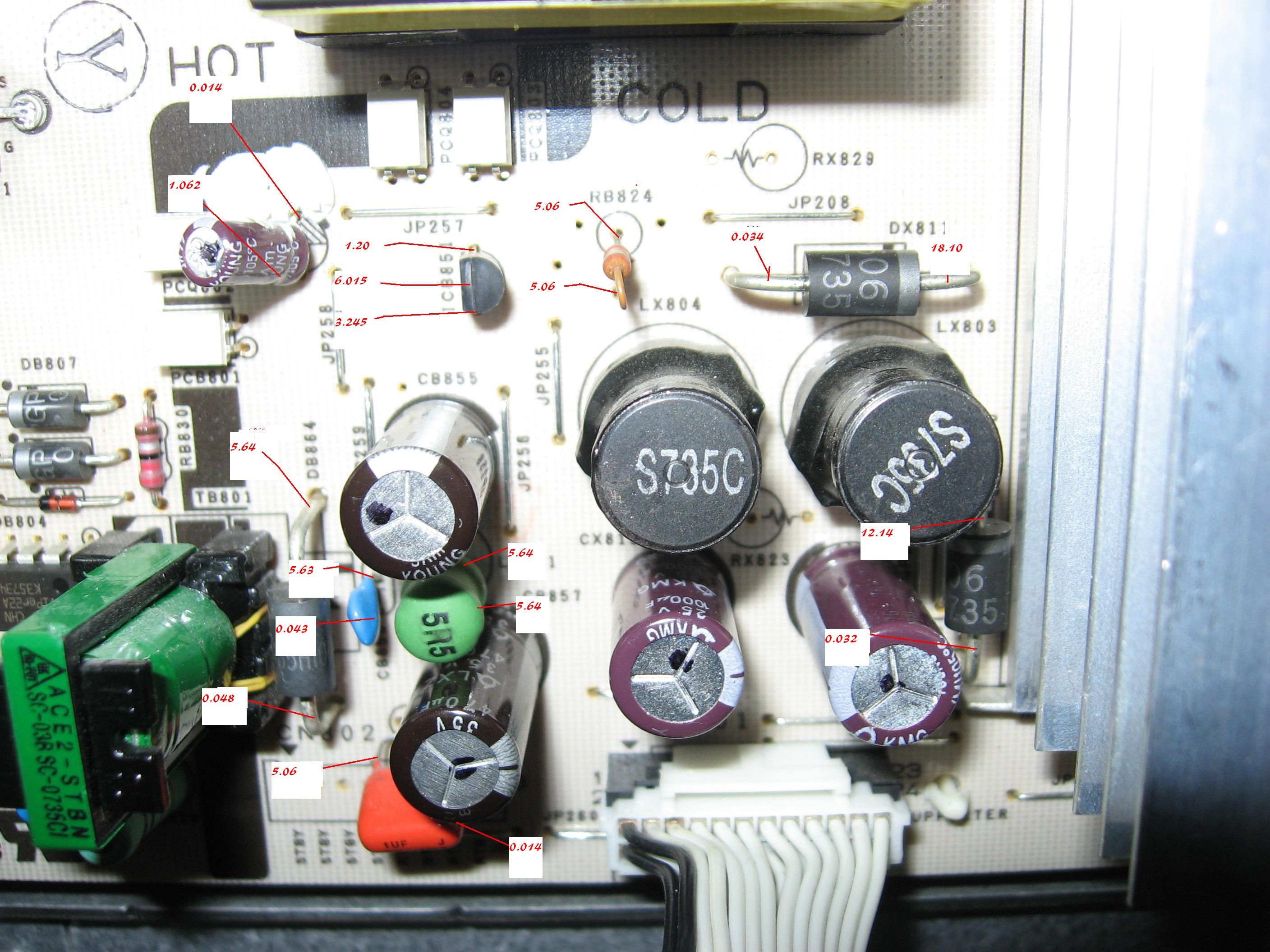

                                      I'll put this here in case someone can use it. The 207v VS and the 63v VA are both very low. The VA is 4.3v and the VS is 0.013v. I've checked the esr on all tha caps but the 3 big ones. I've started rechecking the caps because now I can check the capacitance. I'll pull the big ones this time. The 4 fets on the center heatsink are new. I'll report back when I'm done checking them.
                                        #159
                                        Re: Samsung 50" Plasma HPT5044 No Picture
                                        This SMPS generates Vs/Va on same trafo.
                                        A short on Vs will cause low/missing Va.

                                          I know how to check the fuses with the power off. Both good. But what kind of reading would I get with the power on? How do I check what the volts going thru are? AC/DC? My thought is that this will help narrow down where the porblem is.
