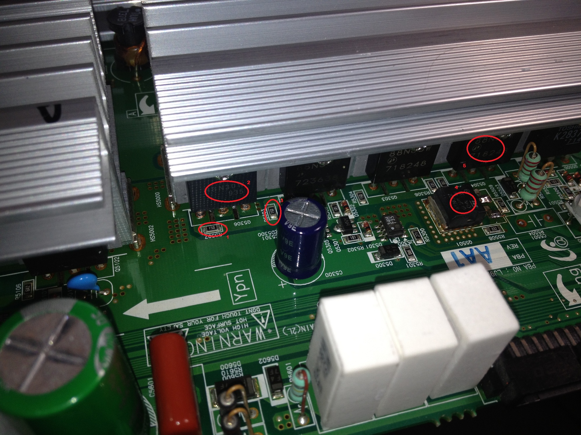

            #65
            Re: Samsung 50" Plasma HPT5044 No Picture
            Ill try and describe what he replaced- as you are looking at the board from the angle where the component of mine had a hole burned in it- The component itself (the one you pictured) plus a small flat onboard (resistor?) next to it and the right hand FET on the heat sink right above the hole-burned component. There is a kit on ebay to repair and it looks like he did about 1/2 of what that provides. http://www.ebay.com/itm/LJ92-01490A-...item3f123998c4

              #66
              Heres a photo, I'm guessing these are the components? Which resistor did he replace, 1 or 3?
              • dsnyder586
                • Dec 2012
                • 39
                #67
                The one not circled to the right of the fet that is soldered to the motherboard (not the heat sink)

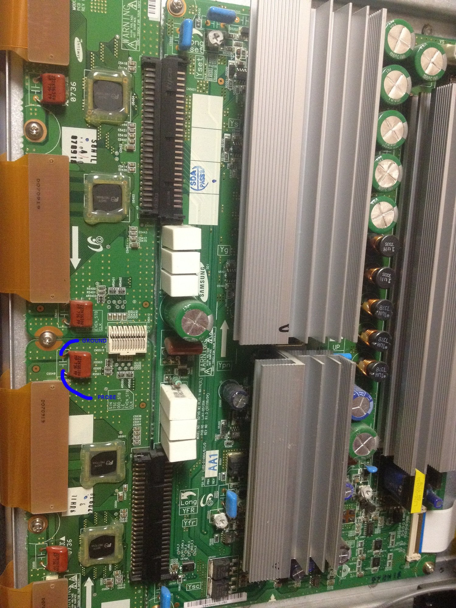

                      #70
                      Have you got an overhead shot of the Y-main?
                      • tieny
                        • Feb 2012
                        • 478
                        #71
                        Here you go
                        • tieny
                          • Feb 2012
                          • 478

                                    #77
                                    K, probe here. Set your probe to 10X. Attach the probe hook (supplied in the packet) to the probe end, and attach the hook to one end of the red poly cap, away from the screw. Connect the ground alligator clip to the side of the screw.
                                    Note: This is for testing with buffers installed. Is that what you want to do?
