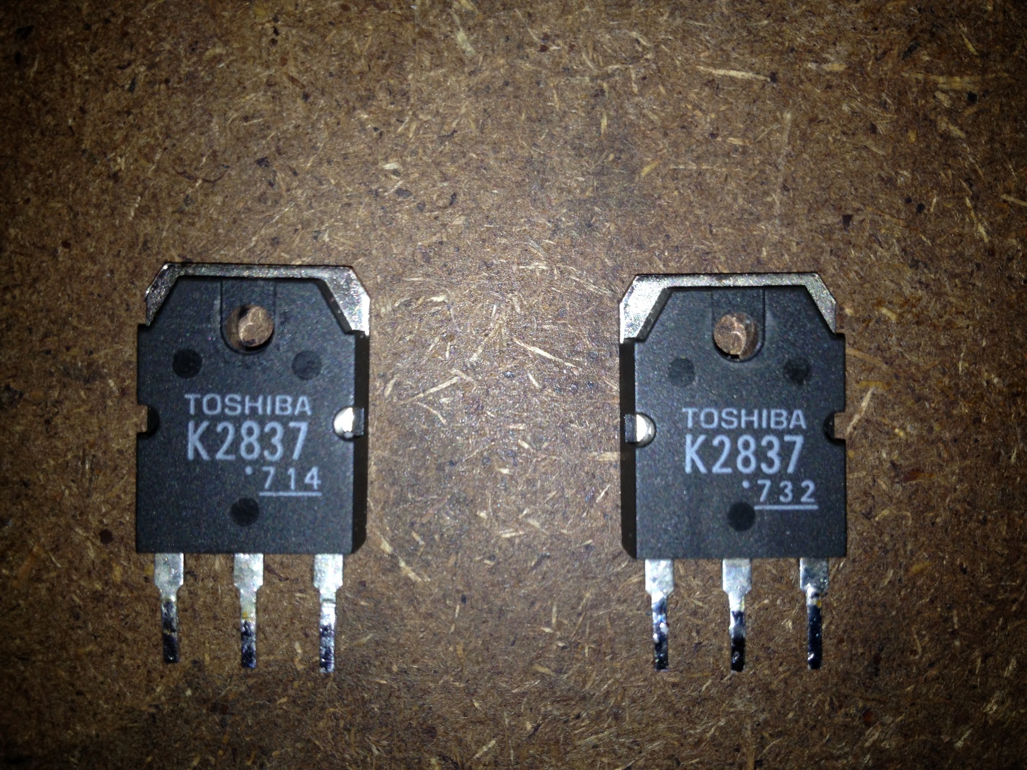

                      #130
                      Re: Samsung 50" Plasma HPT5044 No Picture
                      I got a question, Is there any difference between these two mosfets? Theyre both labeled K2837 but one is 714 and the other is 732. I was comparing the two.
                      K2837 714 is the mosfet right above the Yfr adjuster and my measurements on the pins are getting weird readings I dont know if its right.
                      Even using my Atlas DCA55 meter for it says its an unknown/faulty component.
                      Heres the measurements I'm getting: (On the 2K diode function)
                      Pins 1(black probe)-2 (red):
                      1.603 ohms
                      Pins 1(black)-3(red):
                      0.459 ohms
                      Pins 2(black)-3(red):
                      0.534 ohms
                      Pins 1(red probe)-2 (black):
                      0.988 ohms
                      Pins 1(red)-3(black):
                      0.427 ohms
                      Pins 2(red)-3(black):
                      1.200 ohms
                      I found a replacement at my local store, but its a 2SK2837. Is it the same as the K2837?

                          #132
                          i think the 714 and 732 are date codes .2sk2837 is the part nte 2970 is also the same. high speed n channel power mosfet

                            #133
                            Great! Then I more than likely found the problem! Just have to wait for the store to open and get this new mosfet now.

                                #135
                                Any time you see Knnnn it is a power N-channel MOSFET 2SKnnnn
                                Any time you see Hnnnn it is a power NP IGBT 2SHnnnn
                                Any time you see Cnnnn it is a power NPN transistor 2SCnnnn
