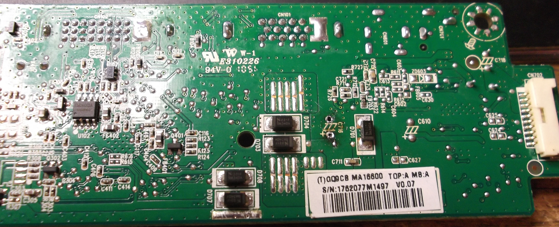

    Greetings BadCappers:
    --Please help me in my ignorance. My Acer S231HL LCD LED refurbished monitor from Geeks.com was dead this morning. The power light was off and it seemed slightly warm in the 19V PS plug area. No complaints, it worked for over a year and was very cheap. My problem is in identifying Diode # 701 on the board that the PS plugs into, see pictures. Below are results of diode and resistance test with my Fluke 87V.
    --Diode 701 fails diode test and shows 0 V both directions. It also shows 0.35 Ohms both directions.
    --Diode 703, which is marked the same passes diode test with 1.51V in one direction and 0.155V in the other direction. Resistance is infinite in the one direction and 150 Ohms in the other.
    --I am assuming the Diode 703 is alright and that Diode 701 is kaput.
    --Both Diodes are marked S21F with SM340A directly underneath.
    --I would appreciate it if any one could tell me just what Diode 701 is and where to get a replacement.

    Re: Help Identifying SM Diode Acer S231HL LCD LED Monitor
    SM340A is a 3amp 40volt schottky
    http://html.alldatasheet.com/html-pd.../1/SM340A.html
    Please can you update your profile with country and mains voltage.

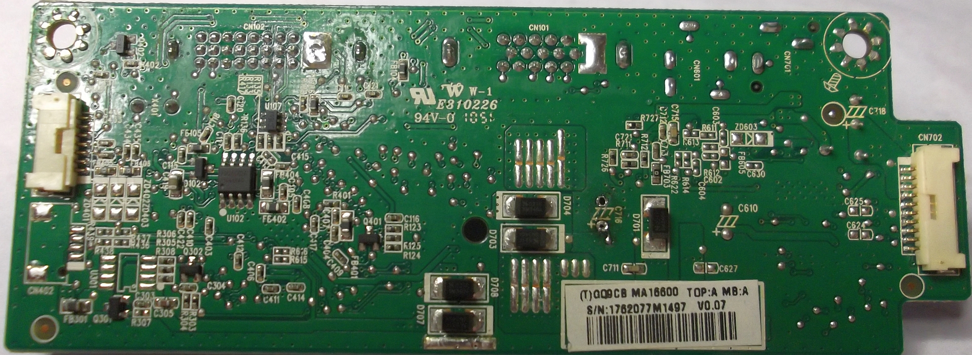

      --Zener Diode 702, see picture, is blown. Fails diode test with zero ohms both ways. It is connected to the negative side of a 220uF 25V Electrolytic Capacitor. It is as SM glass copper zener with a white band covering about 2/3s of the body. Could anybody please tell me what to replace it with or how to go about identifying it. Many thanks to SellDoor for the good information. I have updated my profile.

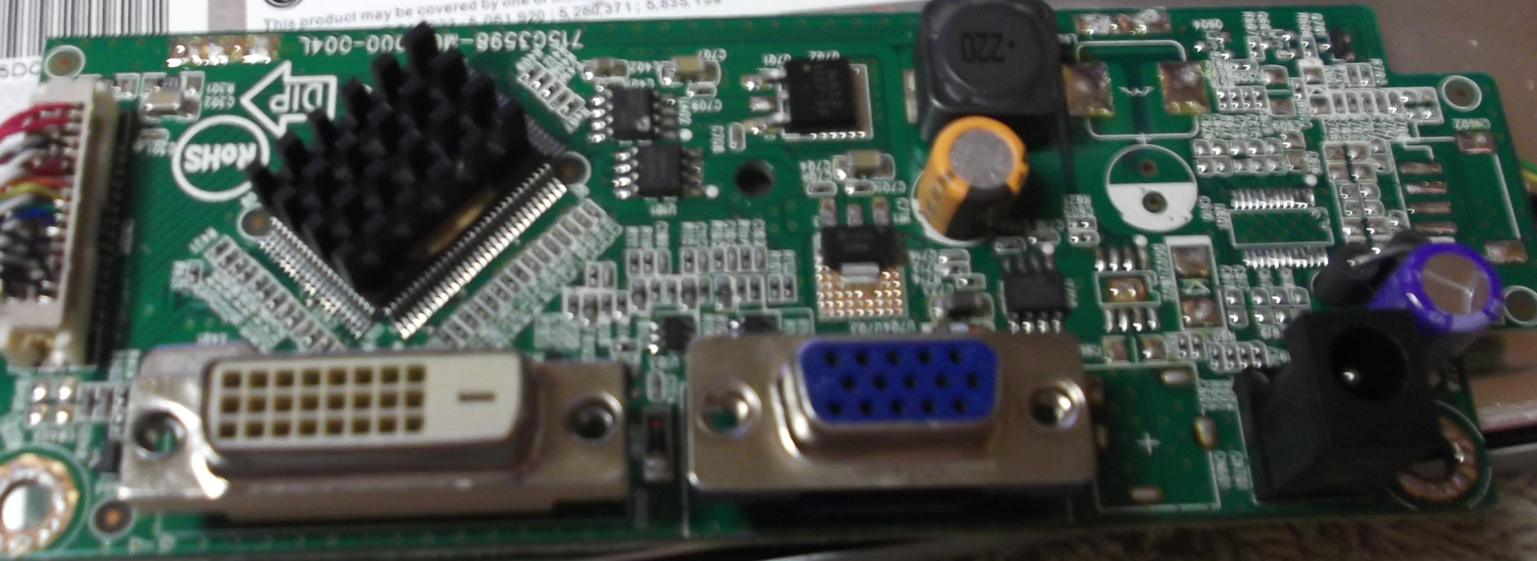

          Dear Augustboyz21:
          --See attached pictures of Board # 715G3598-M01-0000-004L with close up of U705. I need a camera with a better Macro. U705 is marked MP1584EN, AB804119, MPSB801 and is a High Frequency Step-Down Switching Regulator. It is not obviously blown.
          --U101 is a FM24C02A EPROM, and appears to be blown in that pins 1,2,3,4 all go to ground and only pin 4 is supposed to. That being the case I guess it is time to throw in the towel, and declare this board a goner.
          --I would still be interested to know, however, what the specs of ZD702 are or what your best guess is.
          --I have done quite a bit of research on this project and will gladly provide any information I have. Just Ask.
          --This particular board is used in the Acer S231HL and the Philips 191EL2 (in Europe). I did find a Chinese supplier; TaoBao at
            Actually U101 is likely OK. I am routing out a board with an EEPROM on now. Pins 1, 2 and 3 are the address lines and four is the real ground pin. They can be grounded or pulled high, depending on if there are other devices on the bus. The most common strategy is to ground all four pins.
                    Dear Augustboyz21:
                    --U705 is a MP1584EN Step-Down Convertor. Data sheet here
                    ic-igbt.com/uploads/soft/mp1584en.pdf.
                    --So far the only source I can find is aliexpress at
                    http://www.aliexpress.com/store/prod...708765578.html
                    --and they want $17.50 shipping included for 20 pieces.
                    --I wish you good luck in finding a single chip. Perhaps someone else on this forum has an idea of where to find one.
                    --If you have any more questions, you had better ask them quickly, because I will, hopefully, be buttoning this one up in a day or two, and putting it back into service.
                            @augustboy: did you check and see if ZD702 is shorted out, and also check and see if the input pin and output pin of U705 does not show really low resistance due to internal MOSFET shorted out.
                            Here is the diagram: see page 20 for U705
                            By the way, ZD702 is 6.2V Zener, it is used as crow bar to clamp down the output from going beyond 6.2V or shorted out if U705 failed with short circuit between Input to output (shorted out internal MOSFET) of the U705, which will cause the ZD702 to blow up or shorted out if that happens.
                            U705 spec:
                                I would change that 5.1 to 6.2 since the output of that circuit is 5V, so if the voltage goes above 5.1, the Zener may conduct heavily and may shorted out, the Zener is not used for regulation, it is used for protection, the circuit will work without the Zener but then it will not have any protection. This is common way of protection.
