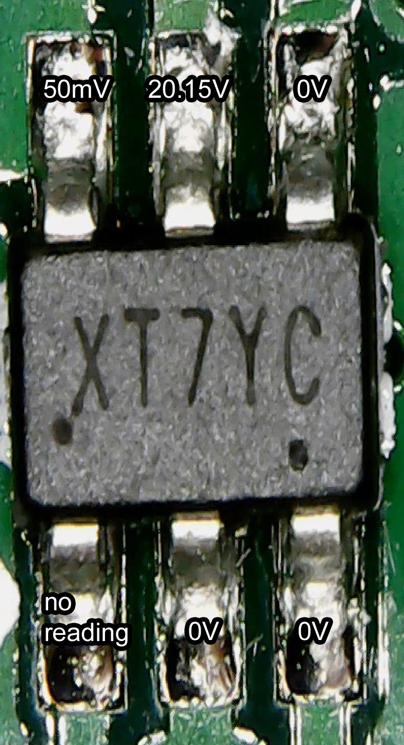

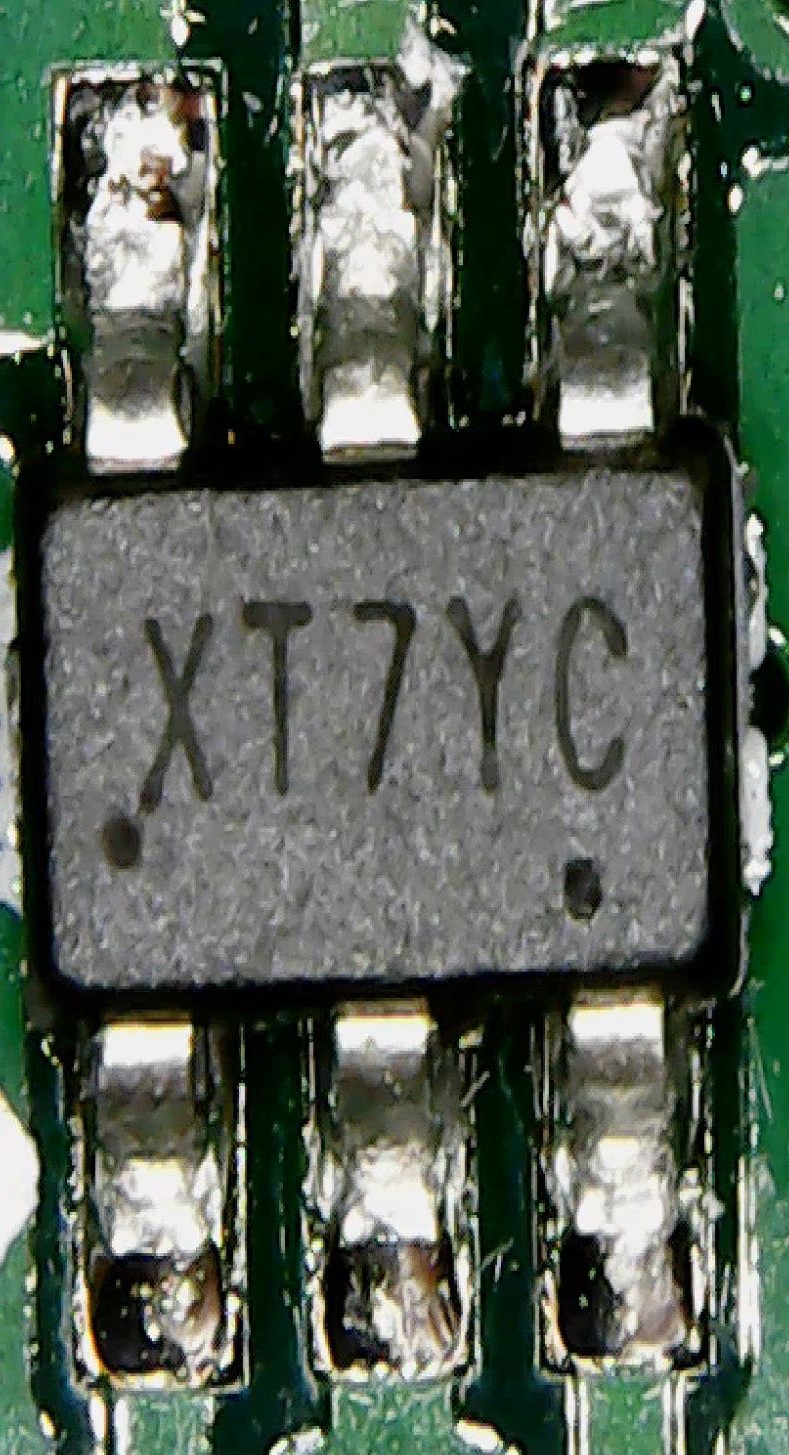

    Hi All
    This component is from the main board of an Acer monitor. I've been fighting this monitor all day and I refuse to let it beat me! Can anybody identify what this component might be?
    I have 20V on the input side of the component and nothing on the capacitors on the other side of it. Does it look damaged or does this component have two markings???
    thanks

    Sy8253adc

      What mistake did I make - I googled the name on the IC and got nothing? The hole in the bottom right is damage, right?

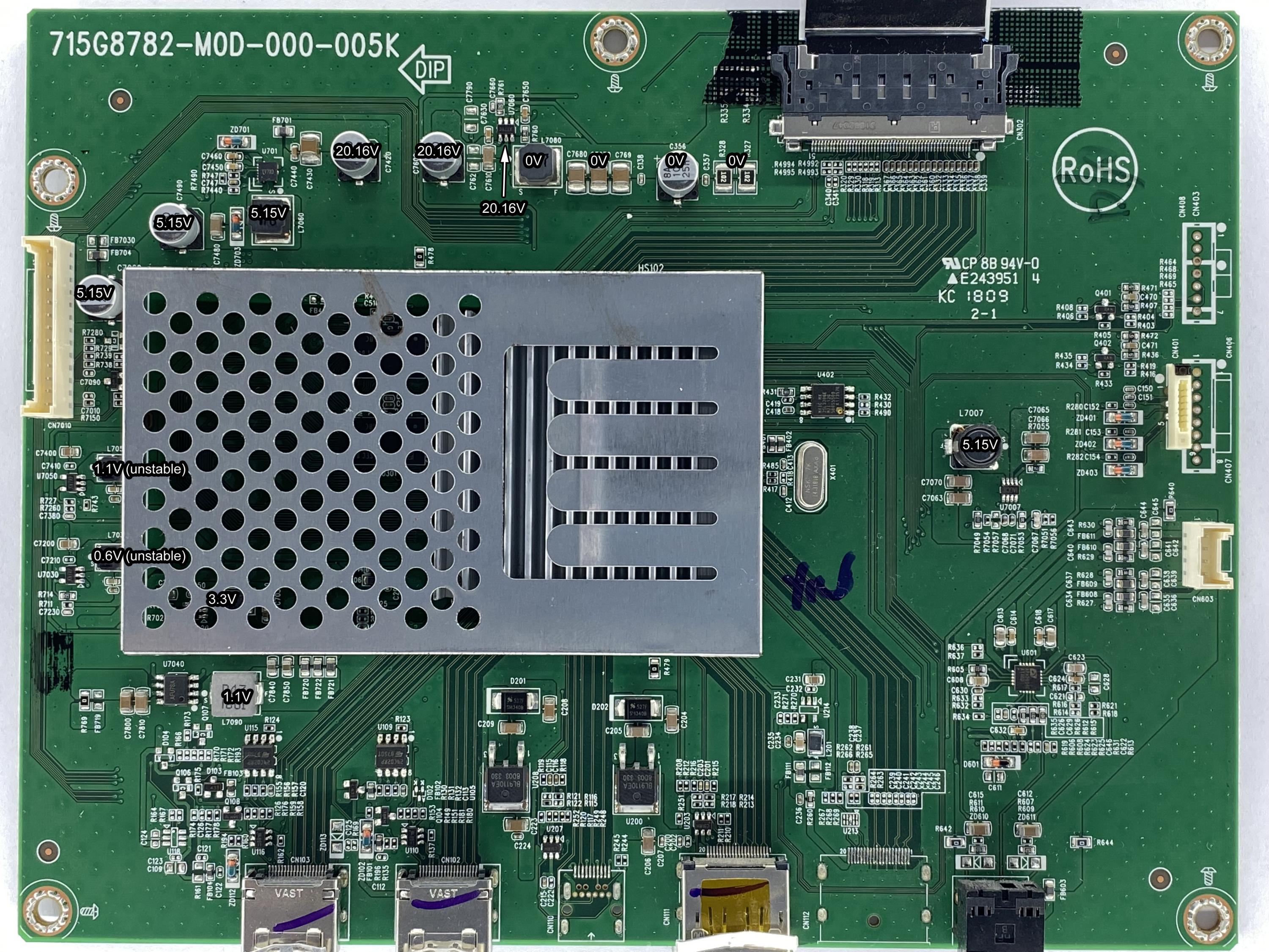

          Re: Help identifying component on main board of Acer monitor
          ACER KG281K Monitor
          Picture of the main board below

            Re: Help identifying component on main board of Acer KG281K monitor
            You have 4 pin. (EN) Enable control is there tension?
            And what is the resistance on 6 pin. regarding gnd.?
            Most likely this is the power output to the panel.

              Below are the voltage measurements on the six pins of the IC. I can't get a reading from pin 1.
              Resistance between pin 6 and ground is 0.472k ohms. I checked for shorts to ground on all IC pins and the only one that is short to ground is pin 2, which is the ground pin. I think I'll just source a replacement IC and install.

                Pin 4 ENable pin is low, so the ic is turned OFF, this pin needs to be above 1.5v

                  You don't have a 4 pin enable command. (Enable) and because of this, there is no output power to 6 pin.

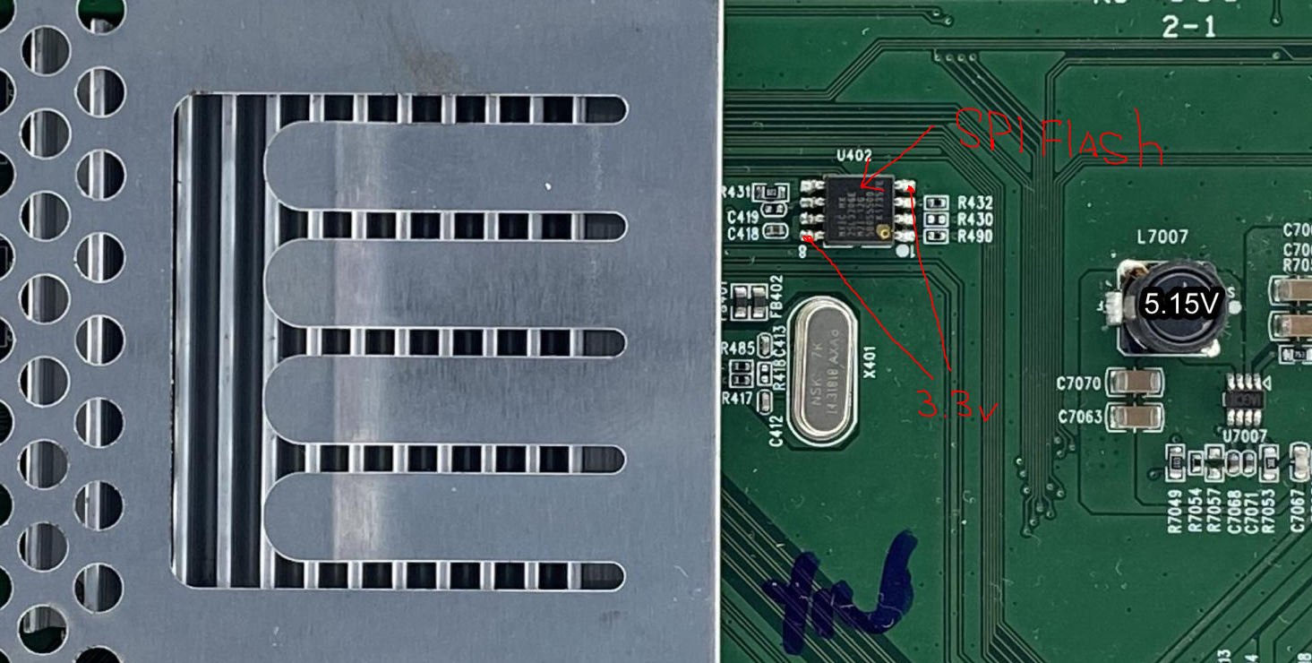

                            Rather, the SPI Flash firmware has flown.

                              Something I didn't see where you have 3.3v on the board, measure if the voltage on the flash is 8 pin.

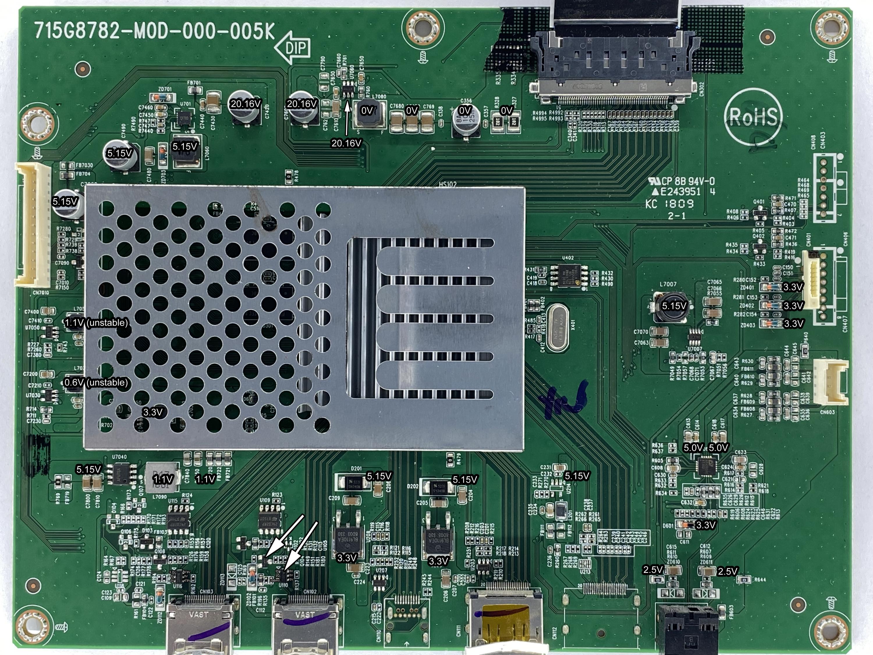

                                I was in the process of marking out all the voltages on the board in Photoshop when I discovered that that section of the board had no voltage on it and started troubleshooting there. I will complete the full list of voltages across the caps and inductors on the whole board and upload later. The 3.3V is present on the button panel, so I am sure I will find it on the main board also.
                                I think I'm trouble with this one. Don't seem to be able to source a replacement main board either. It's listed on a site in the UK that I have dealt with before but they have no stock available.
                                  Here are all the voltages measured on the main board.
                                  I found two shorted components on the second HDMI port (marked by the white arrows), which I removed. Was hoping that might bring it back to action but no go.
                                  I'll try more tomorrow.

                                    I jumpered the 3.3V to the enable pin and that brought 12V online on the output but still no go. I think I may just try source a main board.

                                      I suspect the microprocessor is not outputing the control signal, this may be due to a corrupt eeprom. If you have a source of cold spray (or inverted canned air) You can try freezing U402. Remove power to the board, freeze ic, then apply power and try to turn on.
                                      Might be worth trying?
                                        If there were short-circuited components at the HDMI input, then most likely the discharge slipped through this input and killed the processor.
