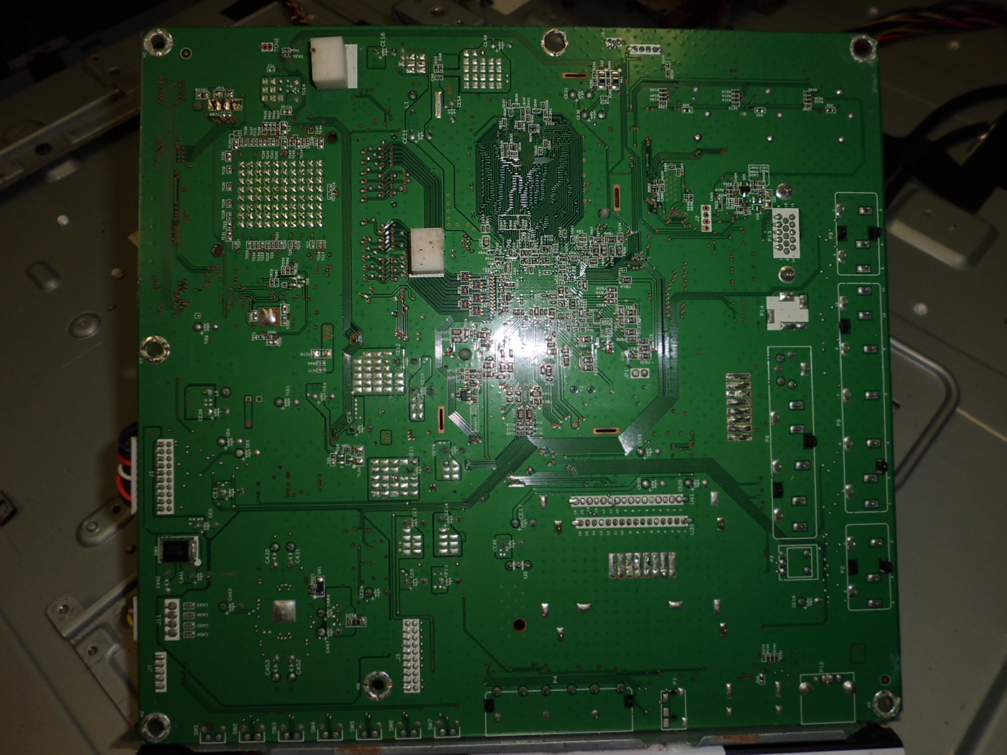

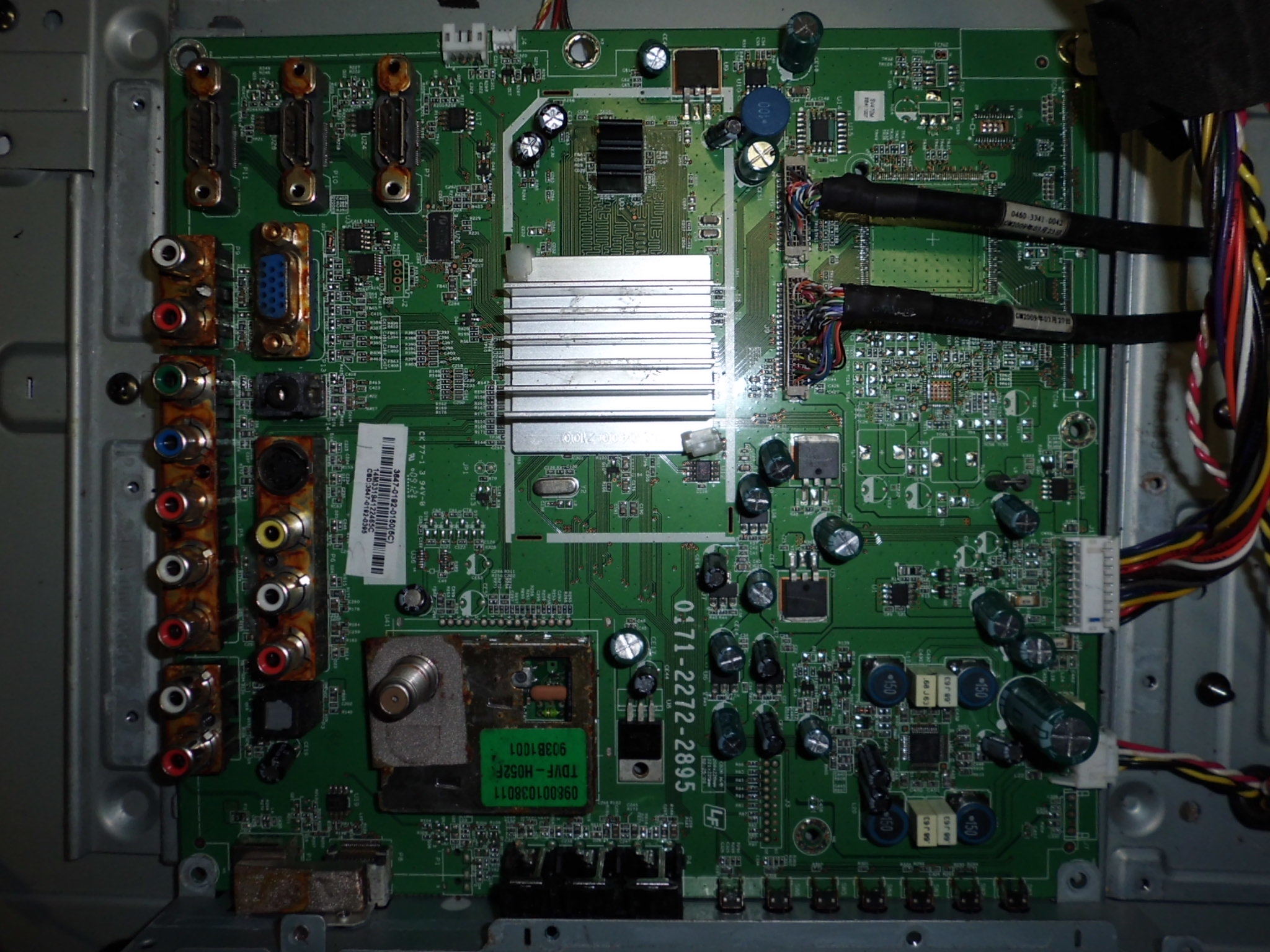

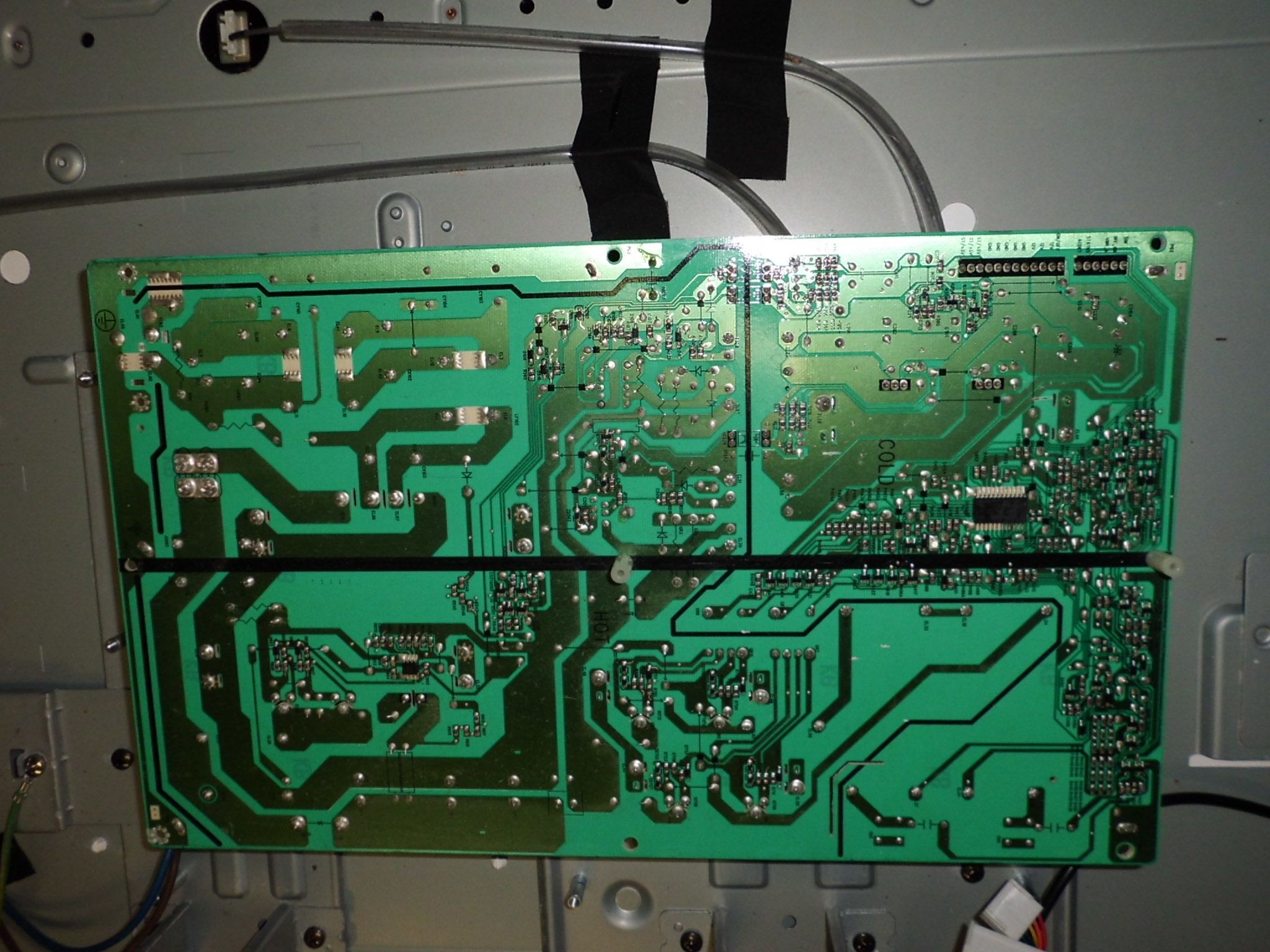

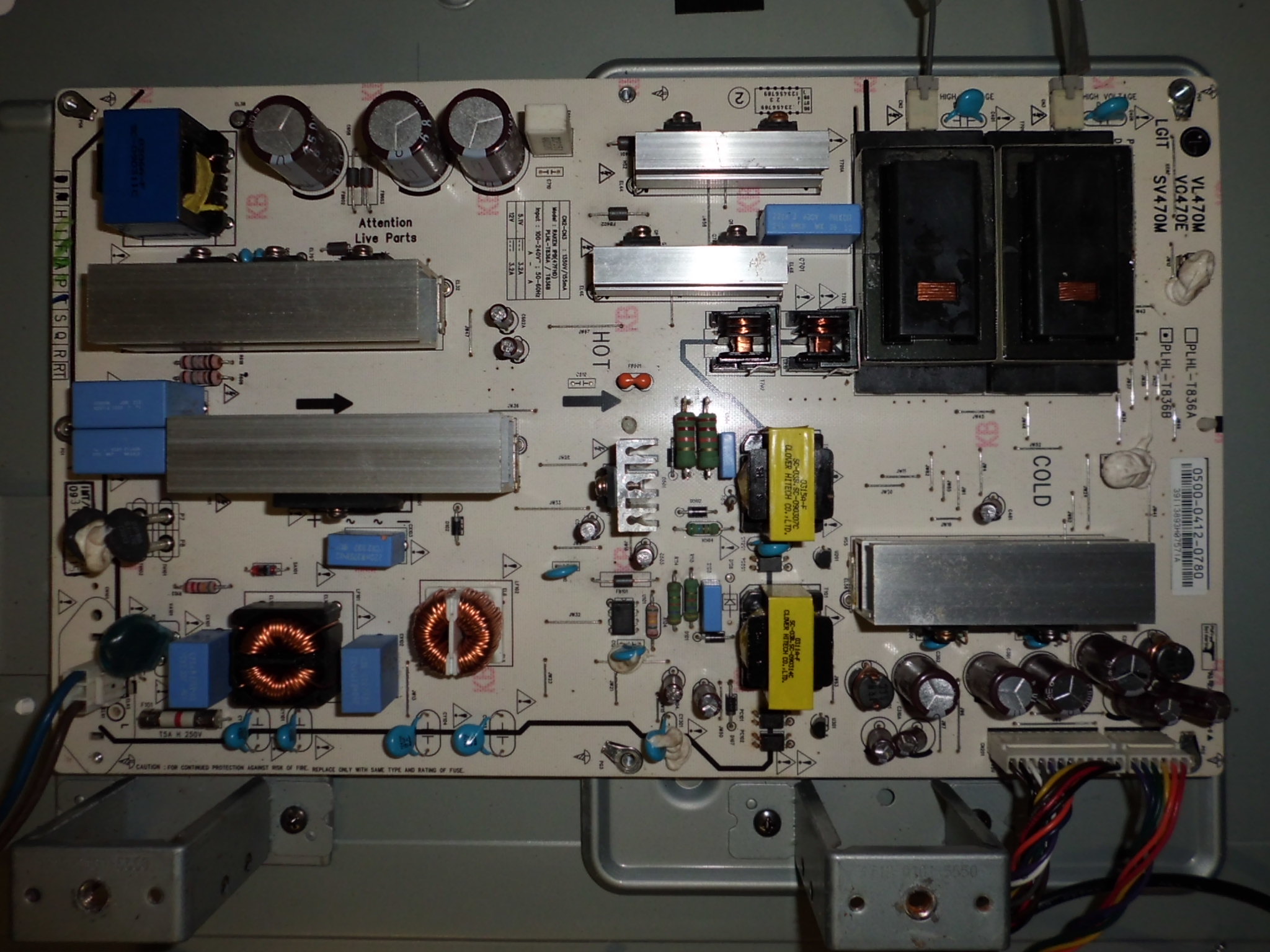

    Pulled a sizeable Visio SV470m from the trash today. Opened it up and plugged it in to the isolated xformer. Orange Visio standby light comes on but no response to the PWR button. Checked all fuses and voltages on PS. Getting a steady 5 VDC, but no 12V. I will get pictures of each board in a few minutes, but would like to know if I should be expecting any other voltages present along the ribbon cable of the PS?

    Re: Visio SV470M - Orange standby only
    Pictures of the boards...
      5v should be all that's active right now. A regulator can cause that symptom or in your case probably rust.
      You can check the p/s by jumping the STBY to PS_ON with a 1kohm resistor with main wire harness disconnected.
        Looks like fairly bad rusting around those input ports, how long has it been in the trash?

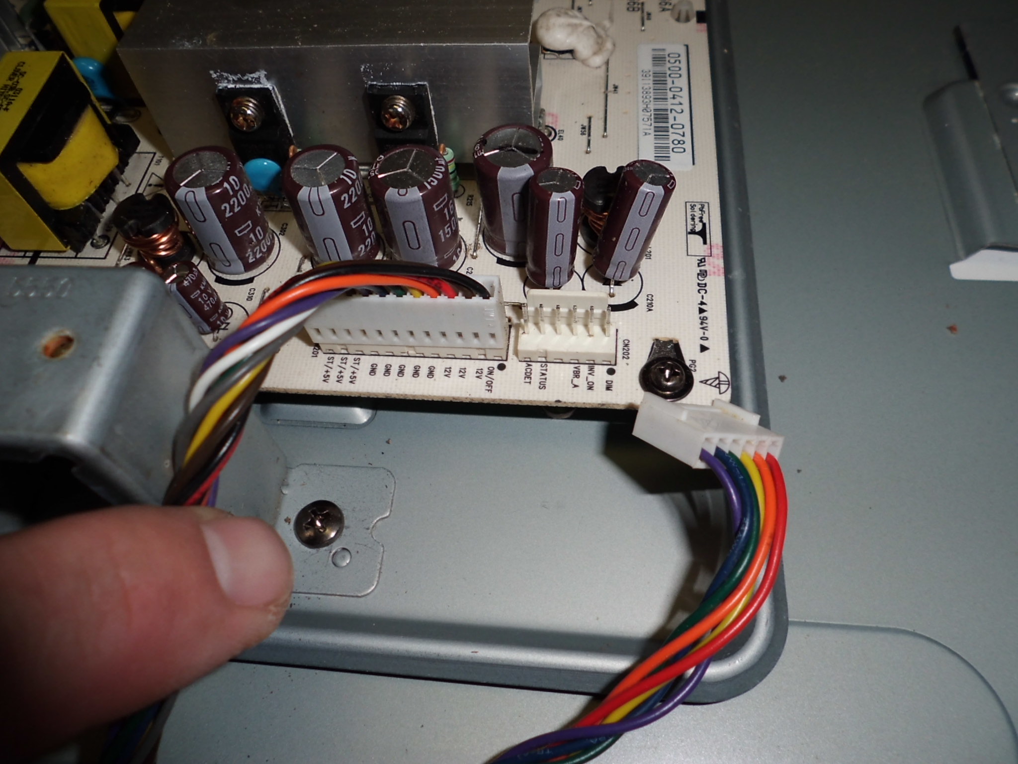

            Confused as to which pin is PS_ON. Is it ON/OFF in the picture above?
              Probably...
                The ON/OFF is the PS_ON.
                  With a 1K Ohm resistor between 5V STBY and ON/OFF, the 12V fires up. Checking all the regulators on the main board now.
