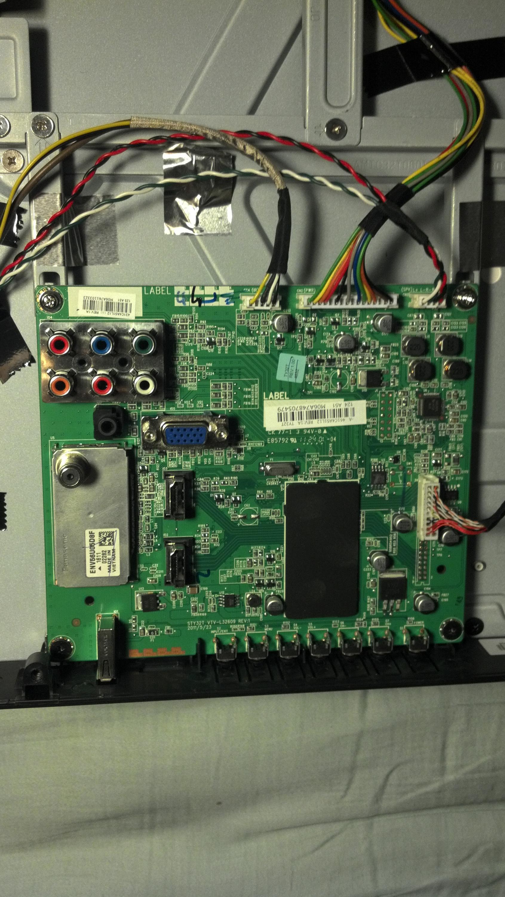

    I have a toshiba 32DT2U that I think has a bad main board. the tv will power up and the back liight works but I get no audio and no picture. is there a way to test the main board. I have tested for 5v 12v and 24v all are present. I have tested the f1 SMD on the main board and it is good. any help would be great thanks.

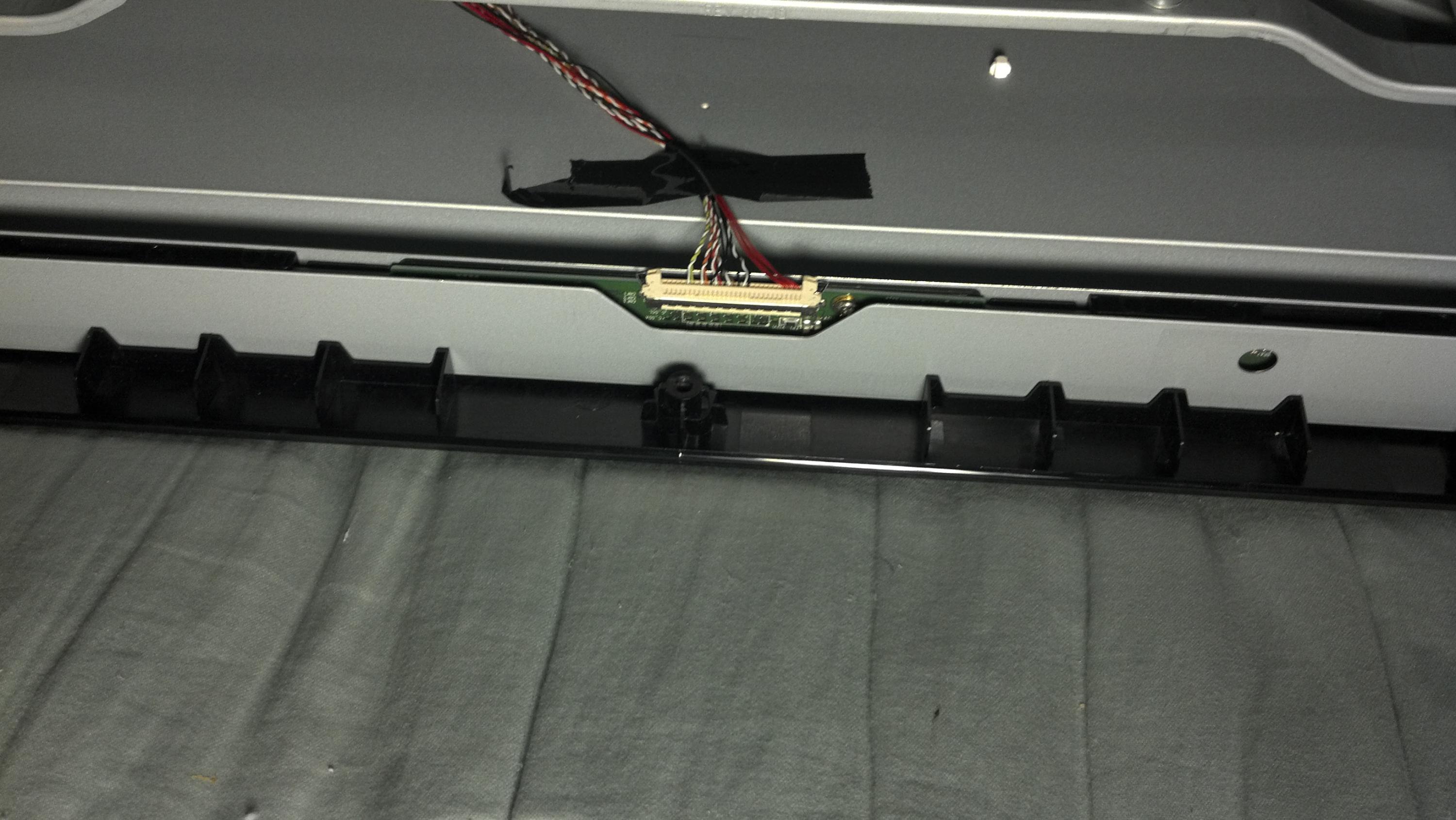

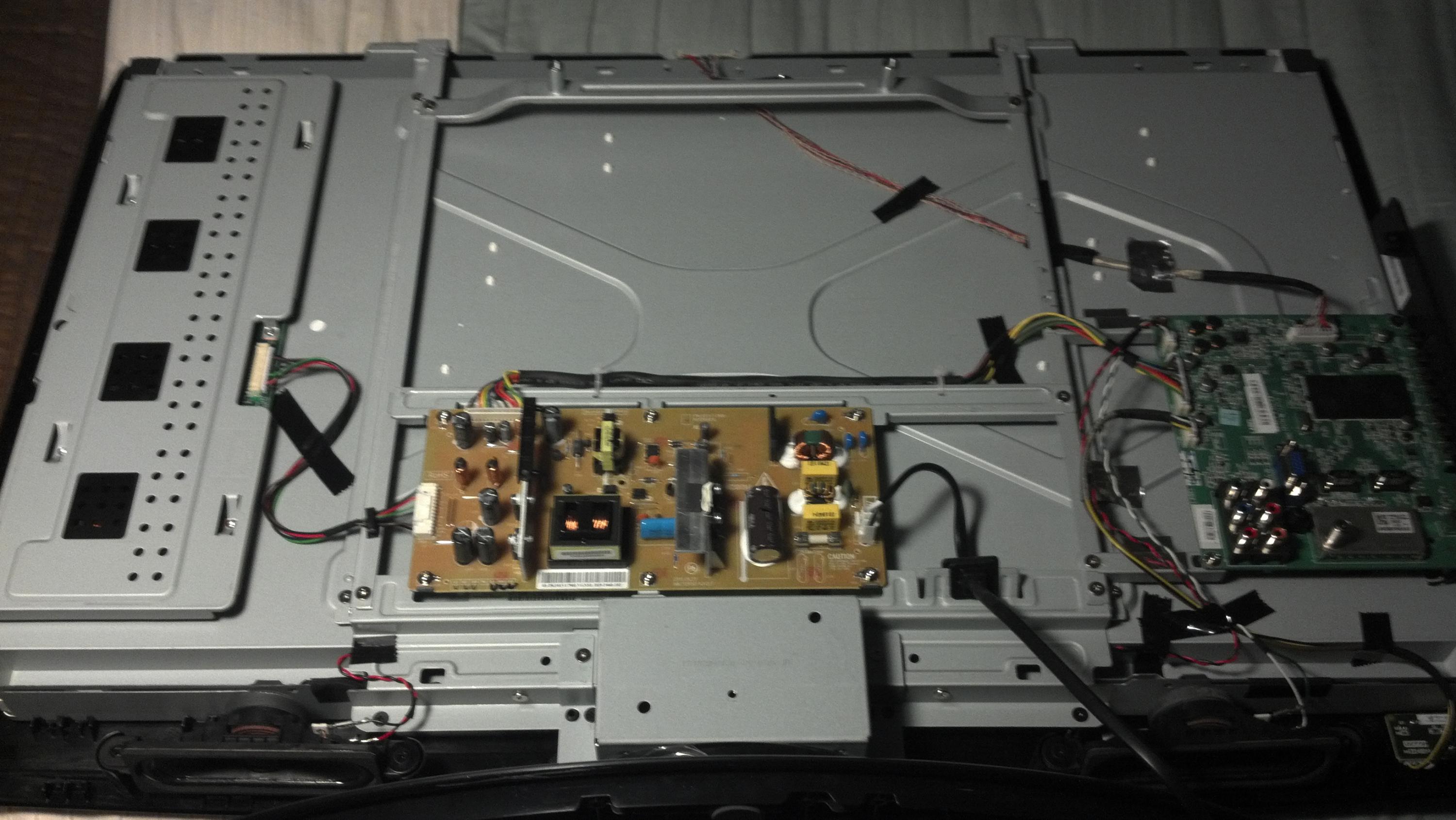

          The T-CON is part of the panel then, the main board just send the LVDS to the T-CON on the panel. There will still be a surface mounted fuse and switching supplies and LDO on that built-in T-CON on the panel. Almost impossible to repair. It is built like computer monitor.

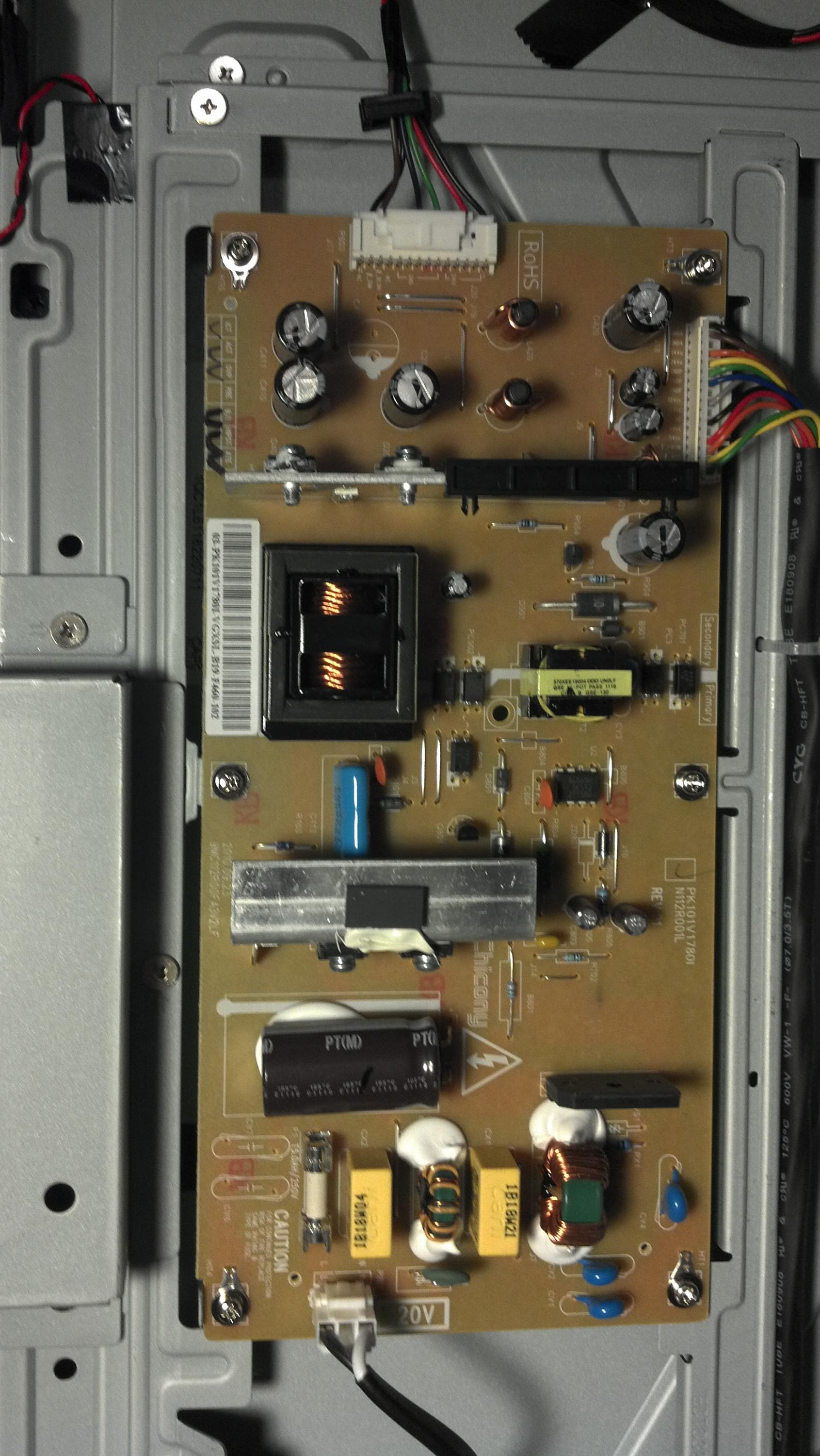

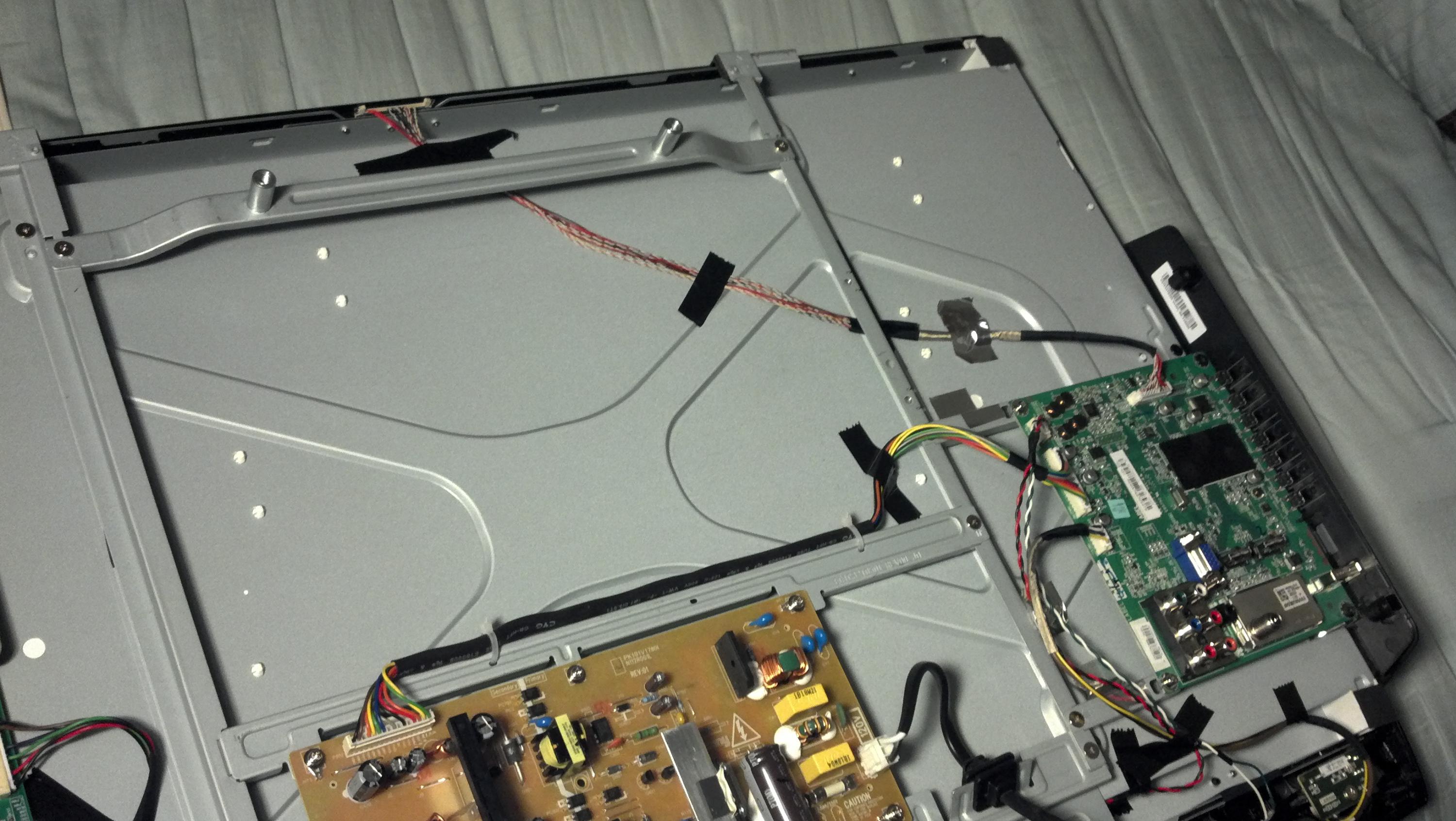

          Can we see the whole back side of the TV?
          • ntehicks
            • Mar 2011
            • 272
            Re: Toshiba 32DT2U bad main board

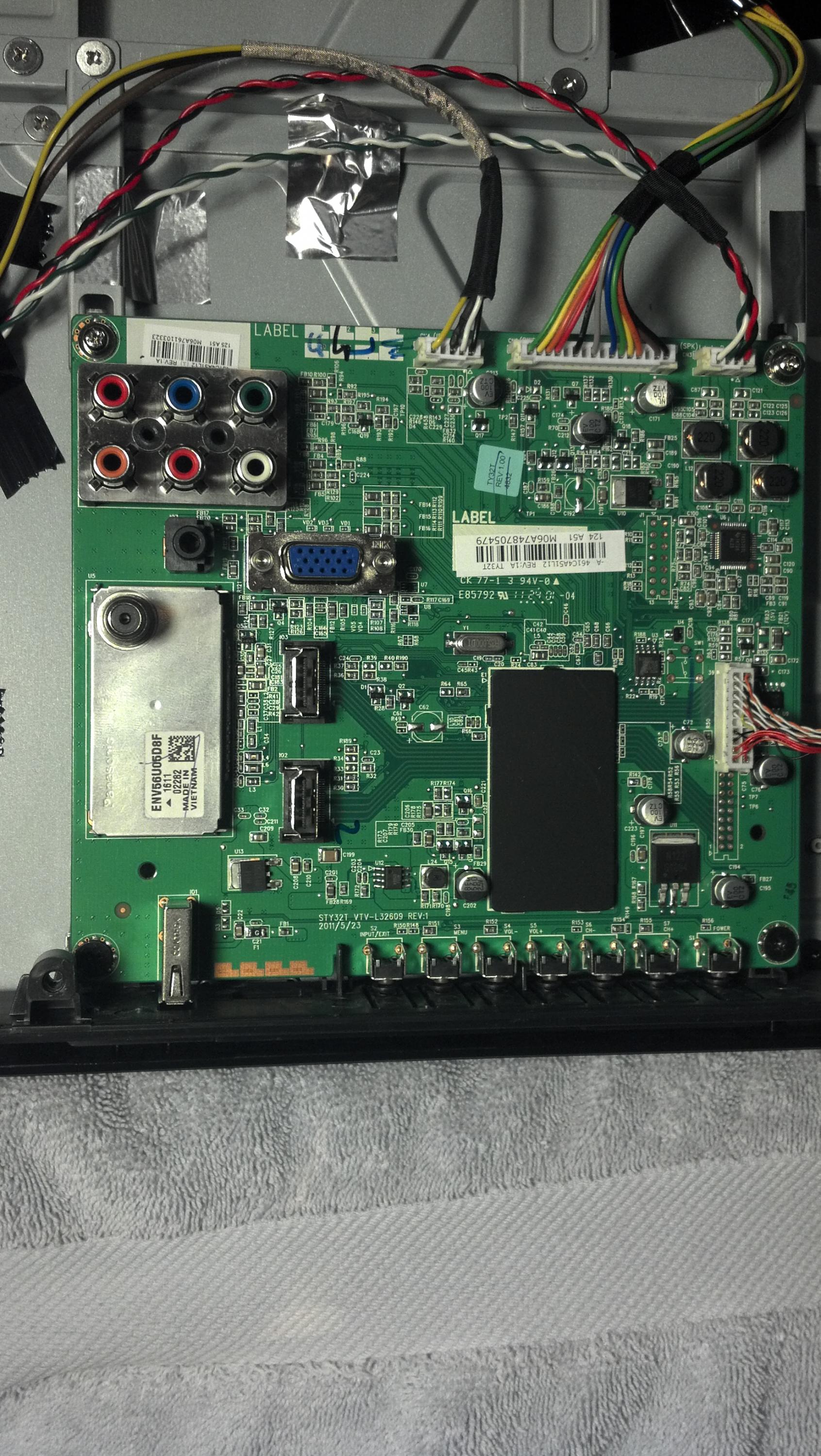

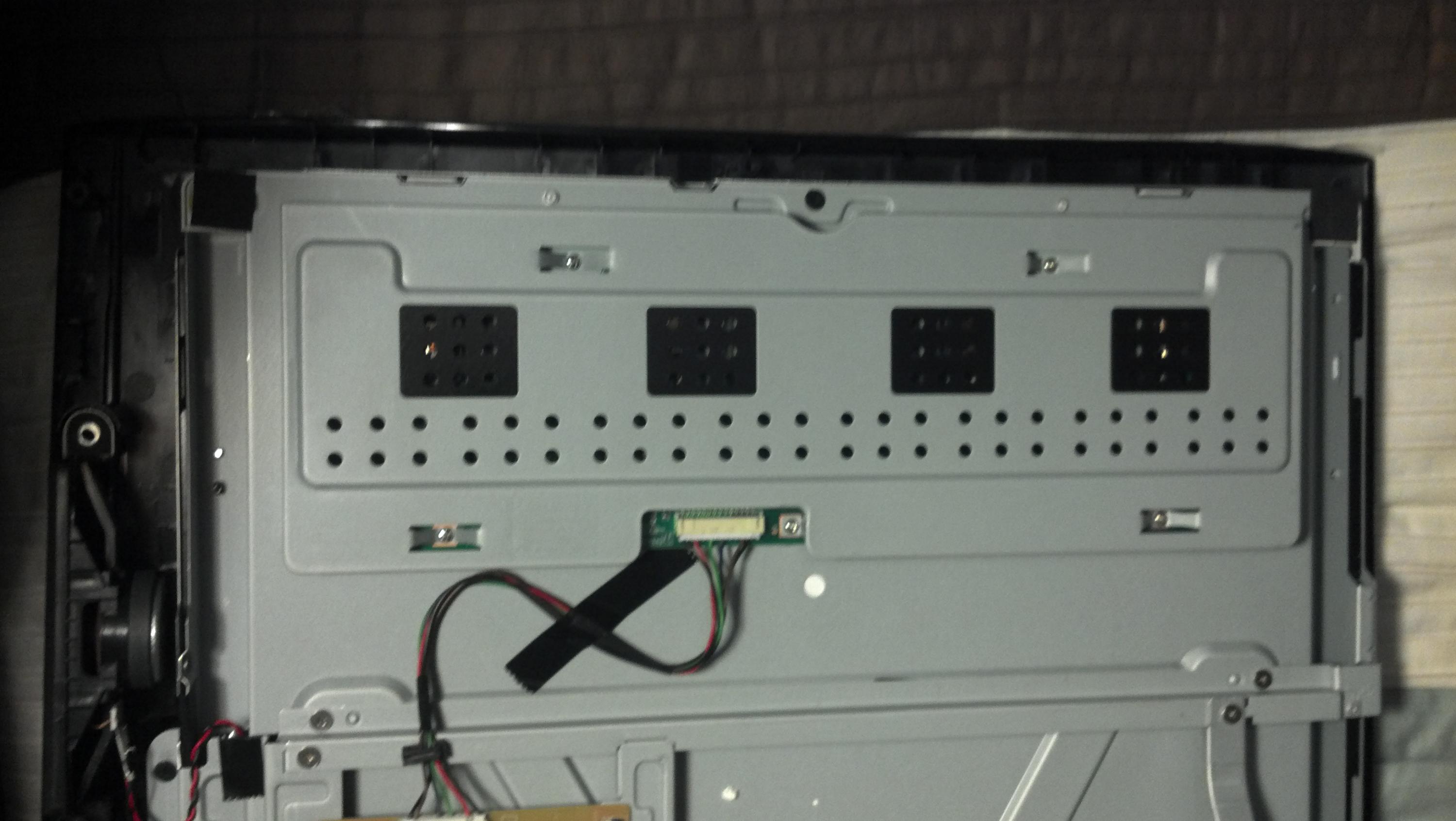

            here is some more pictures
              Can you see any fuses on this board?
              Do NOT touch heatsinks when testing for voltages as they may be LIVE!
                  The picture is not clear but I think I can see the fuse on the right side of the connector where red wires are on the connector.

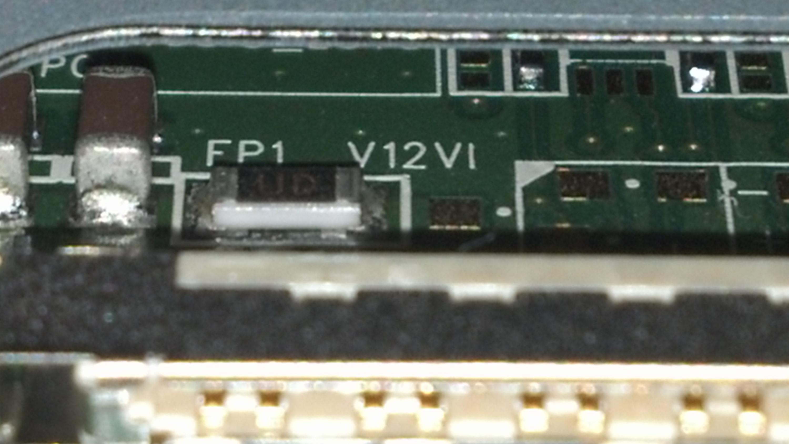

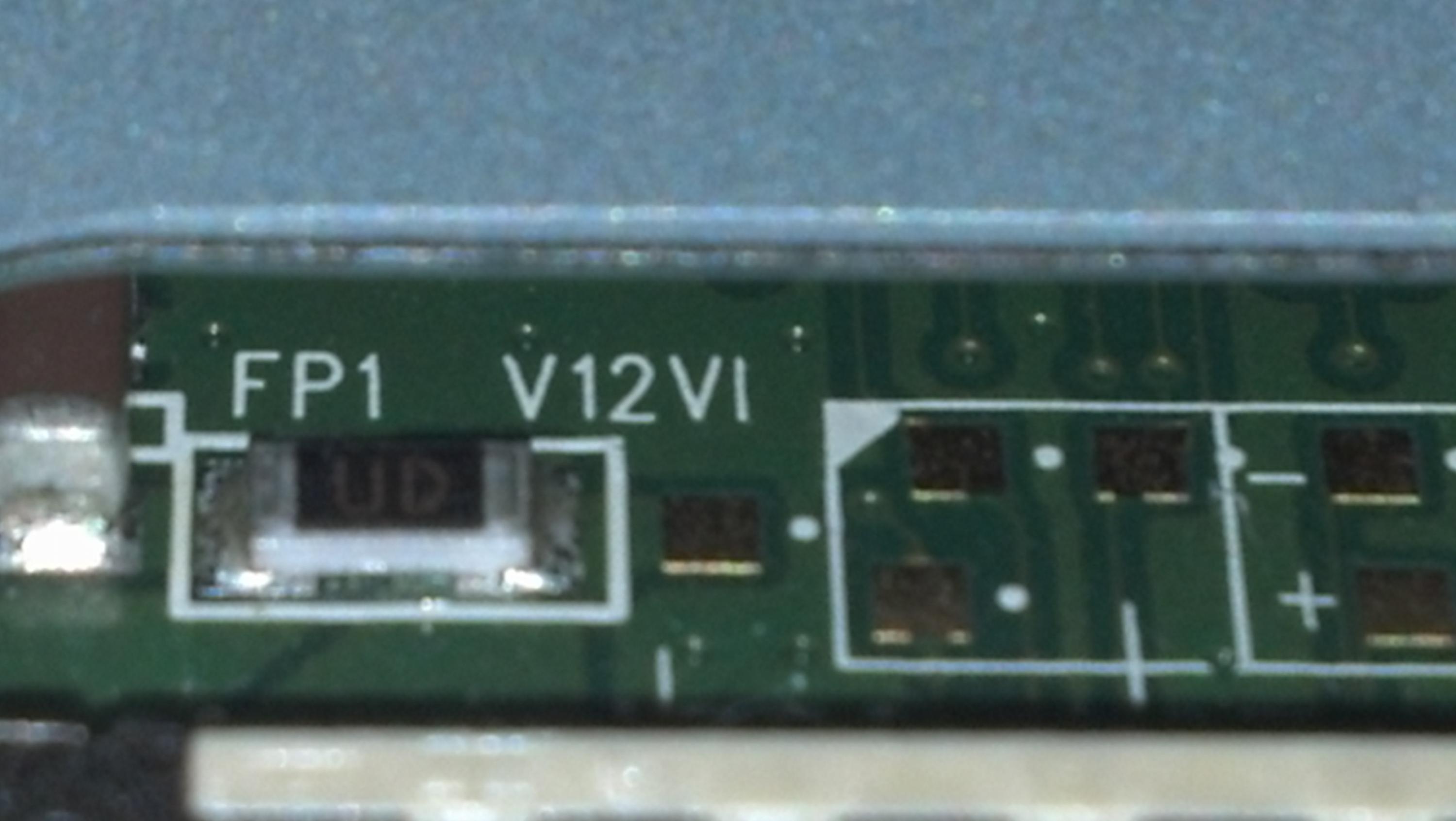

                    I took a closer picture of this area. what do you think. I have tested and if that is a fuse yes it is bad. I get no continuity. what should I replace it with.
                    • ntehicks
                      • Mar 2011
                      • 272
                      Re: Toshiba 32DT2U bad main board DEAD!!
                      well looks like this one has to go for sale for parts. I installed a new fuse and now I get many lines and a bright white screen. I think that means that the build in T-con controller is toast.
