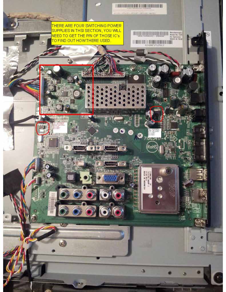

    readings off the two voltage regulators above.. pic below... still trying to look at the data sheet here and see if these readings are good or not.

      Voltage regulators circled in red on board

                    From the look of the power supply board, the 12v is also generated by the same transformer that generates the 24v, you can see two rectifiers mounted on the same heatsink, very common to have 12v and 24v runs by the same transformer. That is why you do not have sound.

                      Bud, in this case, the OP has good 24V and 12V, and they are staying up. The main board is turning the backlight off using the ON/OFF control (not PSON.)

                        By the way, there are four switching power supplies on the main board that should be checked also.
                        I believe there is another thread on this same model.

                            I'm gonna have to read a bit to check the swithching power supplies. But I do see them in the picture. Thanks fro the .pdf Bud
                            The small control board at the top has a voltage regulator on it too. I should check that too.

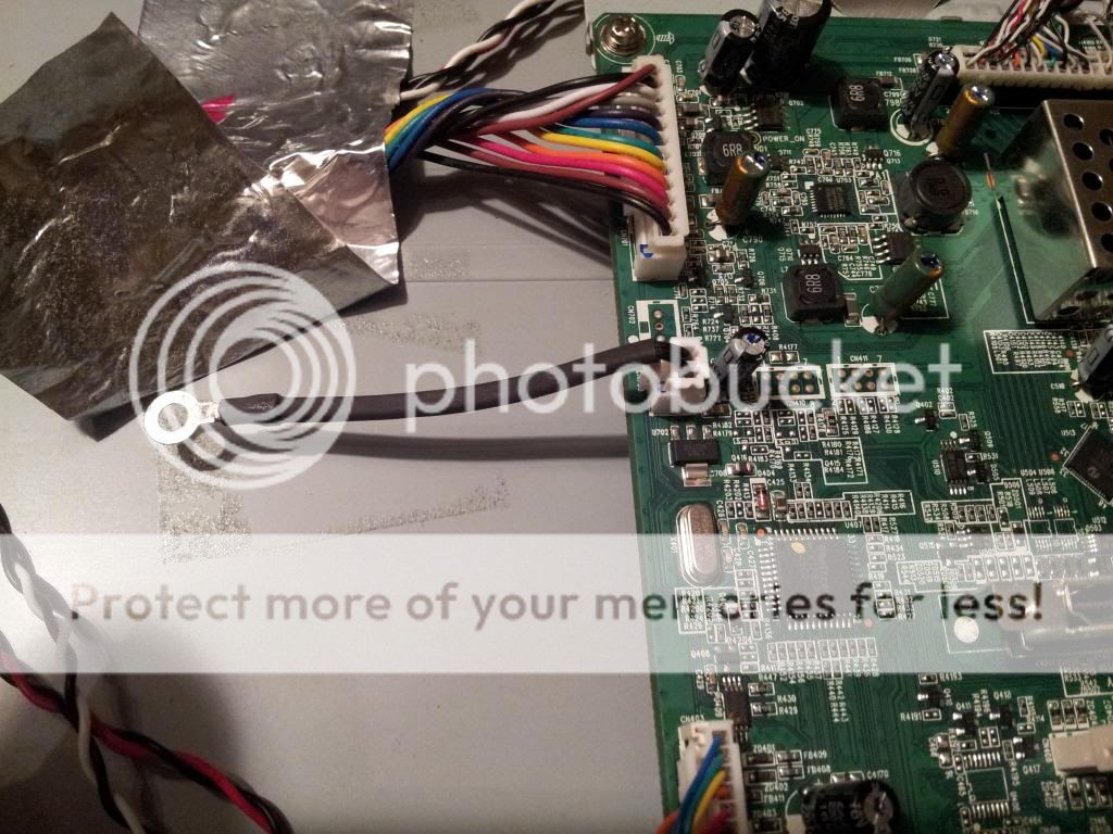

                            By the way there is a connector on this tv that goes nowhere... refered to in white outline. this connector just gets taped down under the metal tape. kida strange for just a ground? off the main board.

                              That is strange, I see that it goes under the foil, do you see what is under the foil?

                                this is the connection on the other end, under the foil
