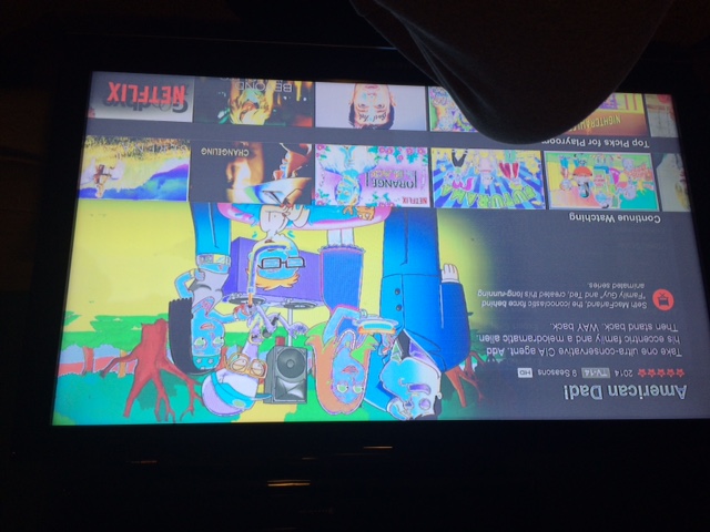

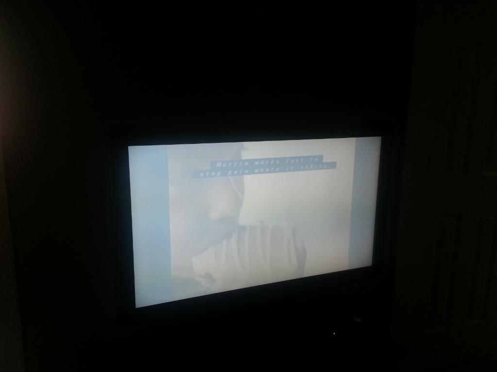

    I have a SAMSUNG LN46A550P3FXZA that just started with this weird issue of like extra snow like distortion. I am not sure if it the main board, cable, LCD or what not.
    Does anyone know what it may be from these pictures? It happens across all inputs. When I took it apart to get part numbers, I powered it on with the back off for the heck of it and it worked for about 2 hours and was still good. I shut it off, put he back on and then the issue was there as soon as I turned it on. Sometimes it takes about 5 to 10 mins for the issue to appear when the TV is started but sometimes it is instant.
    Here are some pictures

    Re: SAMSUNG LN46A550 P3FXZA - Weird Contrast & Discoloration issue
    I don't have the pictures of the parts where the white/bright parts just look WAY TOO bright.

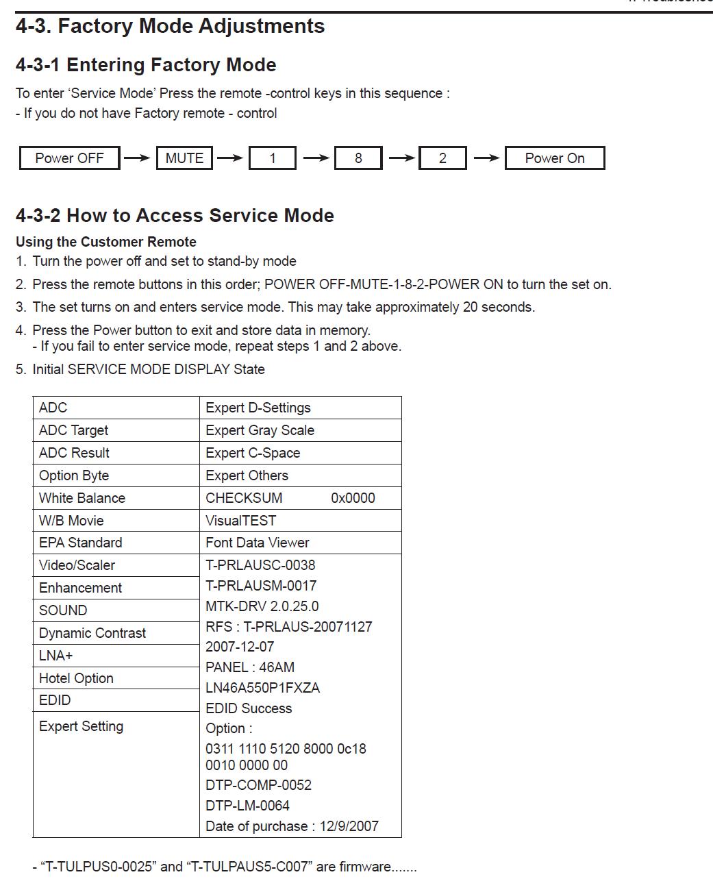

      Try this.
      TV power off (in standby.)
      On remote: Info Menu Mute Power (TV should power on with service menu)
      -OR-
      If this does not work, turn it off again, then try on the remote Mute 1 8 2 Power... some models use that code instead.
      When in the service menu, select "Reset" or "Factory Reset".

        Thanks I will give that a shot. Does that just reset the video settings back to default?
        The discoloration as well as the location of it changes... sometimes its blue, sometimes its reddish or its the white but I will give it a shot.

          Yes, it resets everything. The TV will power on again as if it is new from the retail box. So if you have any important calibration or particular picture settings, back those up.
          One thing I forgot to mention was that you must press the buttons in sequence, not all together at once.
          I have seen this before on a Sharp LCD TV, but it only affected green. Just needed a reset.
          It could also be incorrect panel config -- especially if it occurred suddenly -- or T-con motion-processor fault. (The 100/120 Hz frame doubler this TV uses has lots of overheating problems causing odd artefacts.)

            I would try cleaning the connectors of the LVDS cable. They can cause some weird symptoms. I do this by disconnecting the connectors, cleaning the contacts by burnishing with a pencil eraser, then cleaning with an electronic contact cleaner such as "Blue Shower". I have fixed a lot of picture issues with this technique.

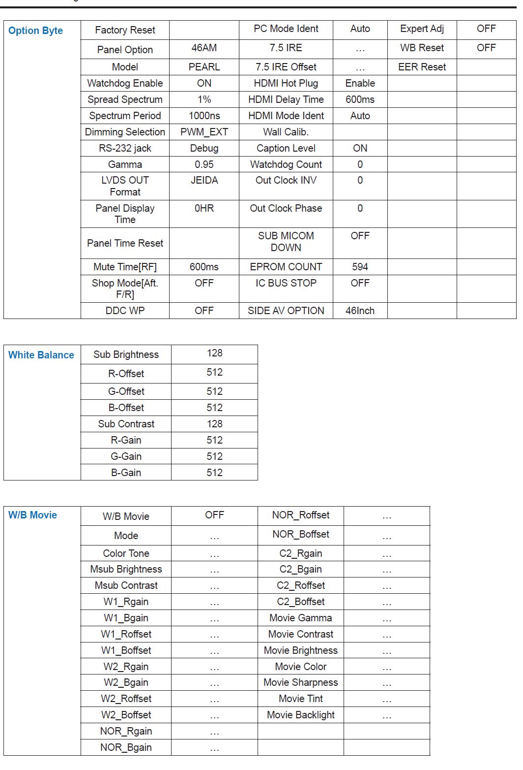

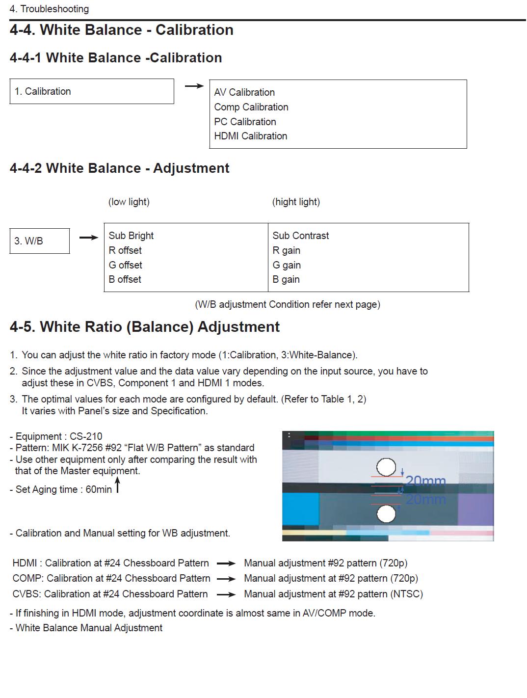

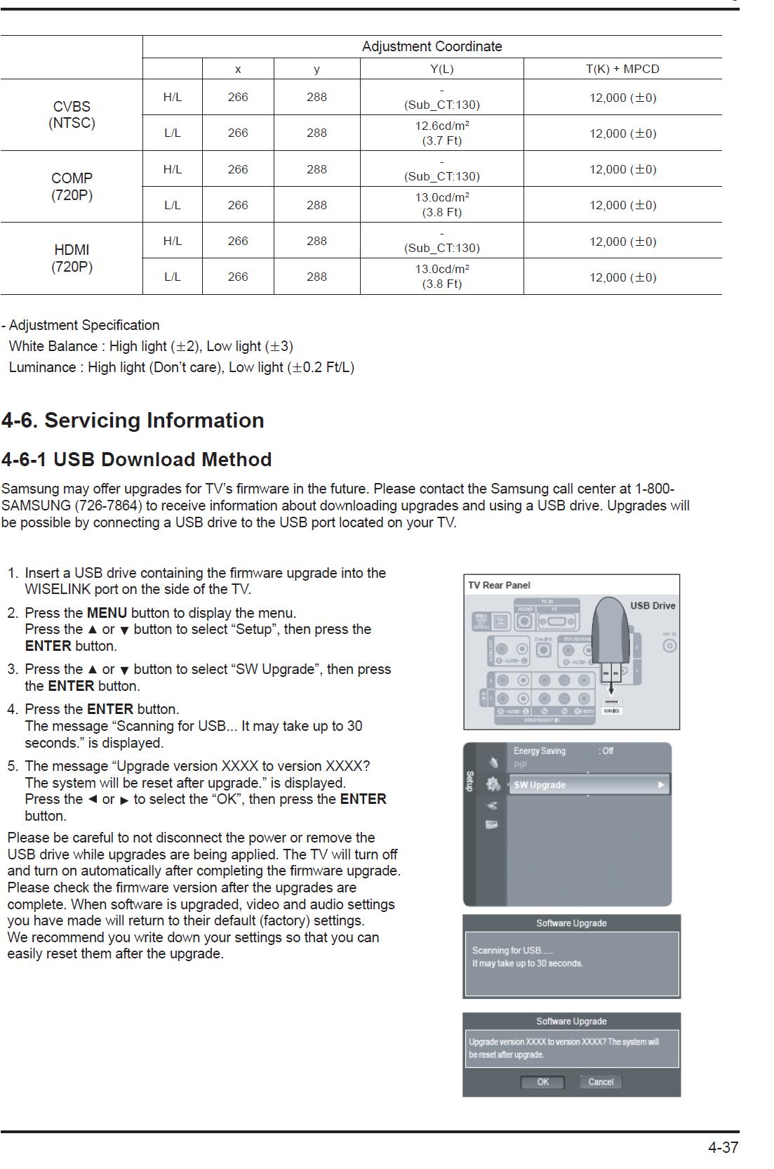

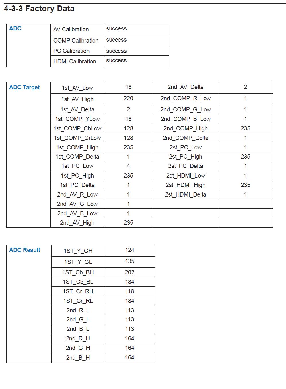

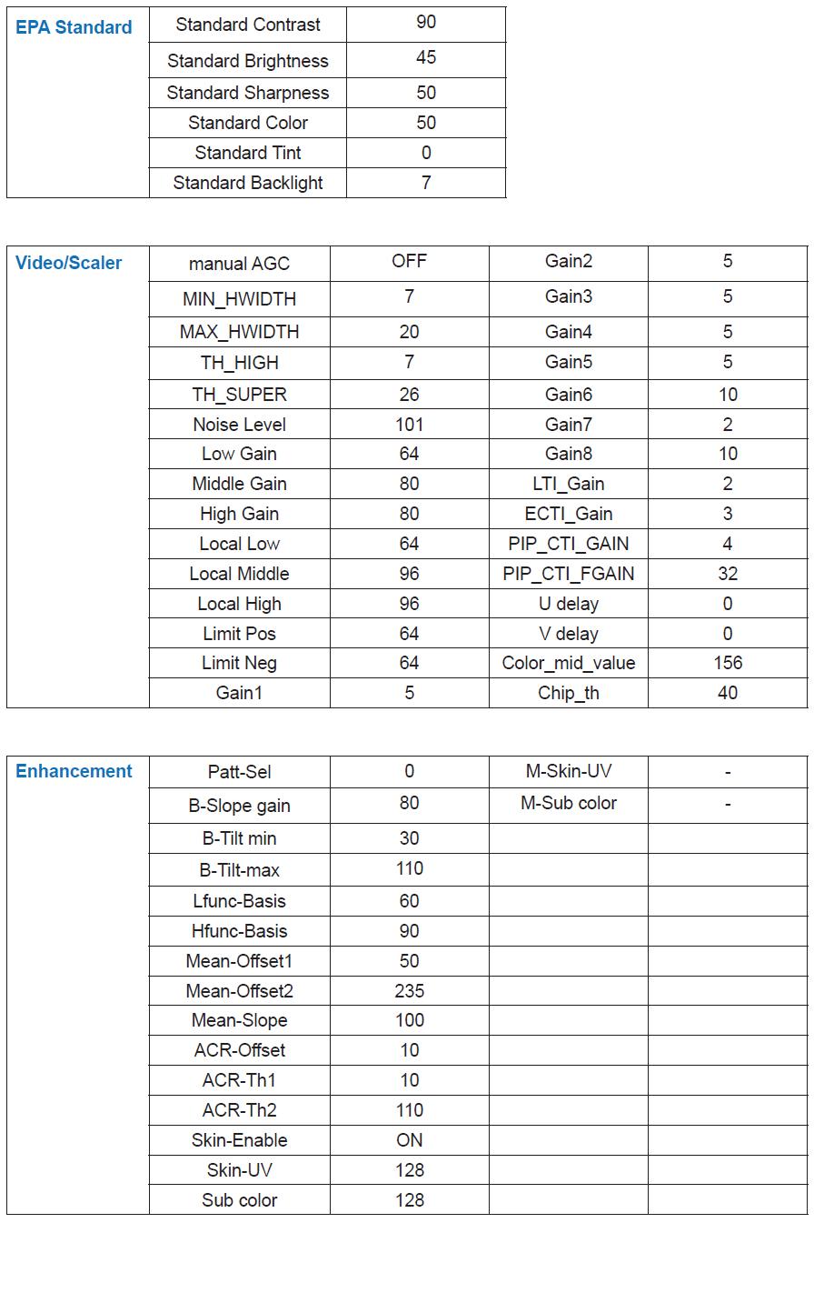

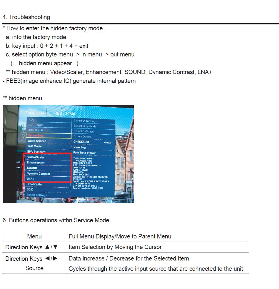

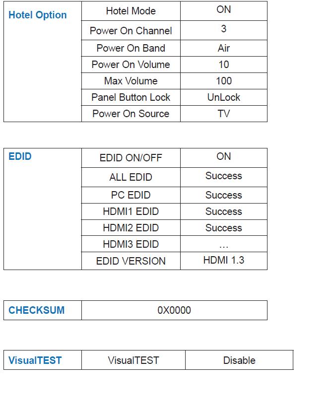

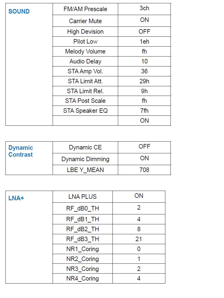

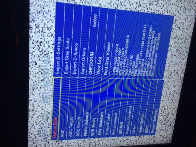

              There's some data in these, may or may not assist.
              PDF was simply was too big.
              looks like there's service menu (what TOM has mentioned)
              Plus a HIDDEN Service menu. Looks like there's some onboard test patterns there as well.
              How to enter the hidden factory mode.
              a. into the factory mode
              b. key input : 0 + 2 + 1 + 4 + exit
              c. select option byte menu -> in menu -> out menu
              (... hidden menu appear...)
              ** hidden menu : Video/Scaler, Enhancement, SOUND, Dynamic Contrast, LNA+
              - FBE3(image enhance IC) generate internal pattern
              Samsung_LN32A550P3F_LN37A550P3F_LN40A550P3F_LN46A550P3F_LN52A550P3F_ch_GPR3X_4X_5X

                    that's T-Con board problem..
                      Whilst it does look like a T-con board problem, it was a config problem on the Sharp LCD I fixed.

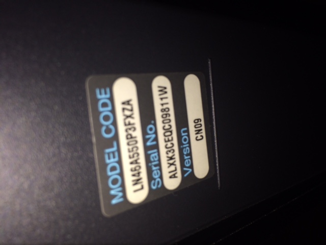

                              I have the same tv (Samsung LN46A550P3FXZA) and I am trying to figure out if my T-con board needs to be replaced, or just some caps.
                              I have light experience in working with circuit boards but feel confident in some basic soldering. I have attached a picture of the service menu, which I heard may be a way to fix the issue with the picture. My options are 'Option Byte' 'White Balance' 'B/B Movie' EPA Standard' 'Sound' 'Hotel Option' 'EDID' 'CHECKSUM' 'View Log' 'Front Data Viewer'. I assume the options between will be available once clicked into a menu.
                              I also attached a photo of the picture issue as well. I think it is the same as the OP's.
                              I would really appreciate any information or tips, and hope this old thread can bring me some answers.
                              Also threw in a photo of the model on the side of the console.
                                Bad GAMMA Voltage ref. IC, Look for AS15 IC on the T-CON board.

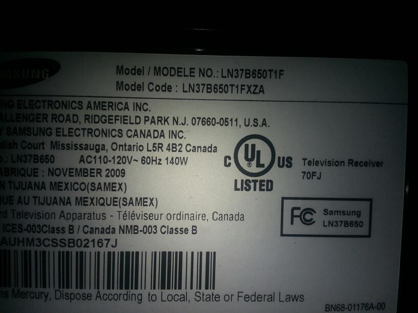

                                  I have some similar (or not?) symptoms on my home TV a Samsung LN32B650T1FXZA ... attached a picture of how image look (image remain with high luminosity regardless of input source used).
                                  Any taught, help or information to speed-up debugging is highly appreciated !
                                    Look at the T-CON board to see if it has GAMMA IC AS15, or AS19, very likely to be your problem.
