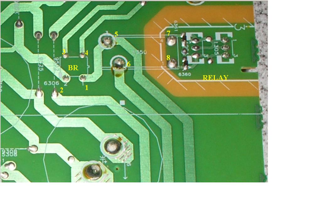

    Re: Phillips 37PF5521D dead after power cut
    Well I blame Tom - he said it wouldnt fix it.
    So off we go again. Still high Voltages -( hopefully)What DC voltage do you get on the + and - pins on the big bridge rectifier 6307?
    What voltage - not sure if its going to be ac or dc at the connector on the end of the red cable on the Green Board.
      340v dc to sb, no voltage on big bridge the relay has to be held on by the feed from standby board[the white socket by relay], was thinking to jump the relay contacts to put a feed on the big bridge to see if that powers up the rest of the power board, what do you think?
        Its nothing daft like you have to press the power on switch is it.
        I wish you had not cropped the picture of the board if you get the chance please post a full one. Looks like we will also need the back of the brown board.
        In the attached pic what voltages do you have 1>2 and 3>4. 5>6 and 7>8.
        Please confirm that the area marked relay is the relay.
        EDIT - presumably it doesnt click when tv is plugged in?

          #64
          1>2 ac in 240ac 3>4 dc out 340vdc 5>6 relay contacts, 5 same as 1, 6 ac to feed large bridge 7>8 no volts [supply from standby board] relay cant click it has no supply to it?photo does show all and the board and yes that is the relay,
