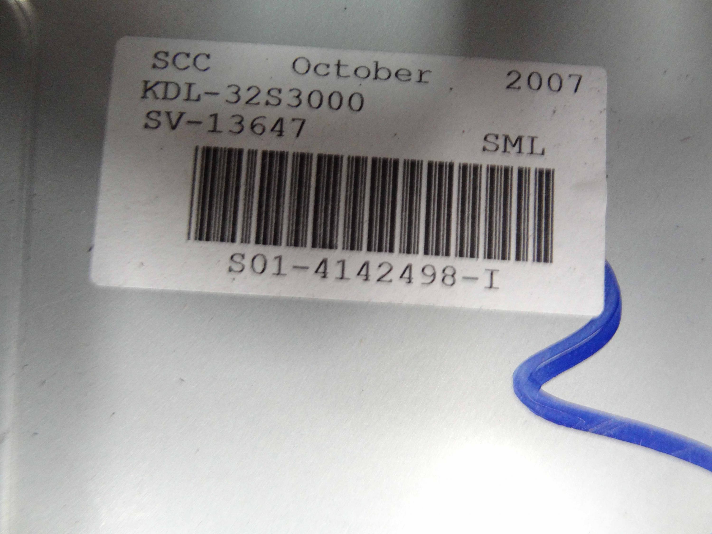

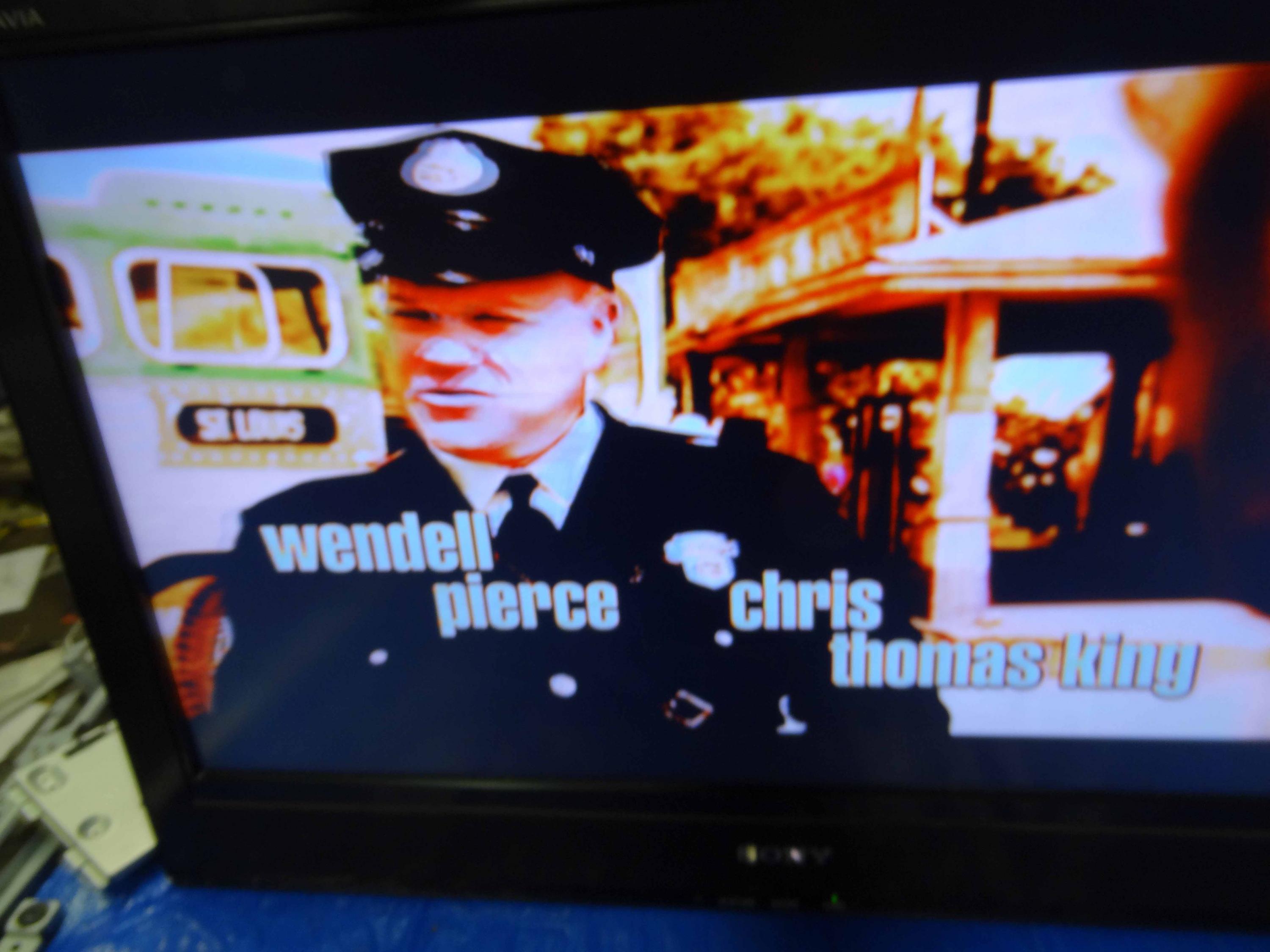

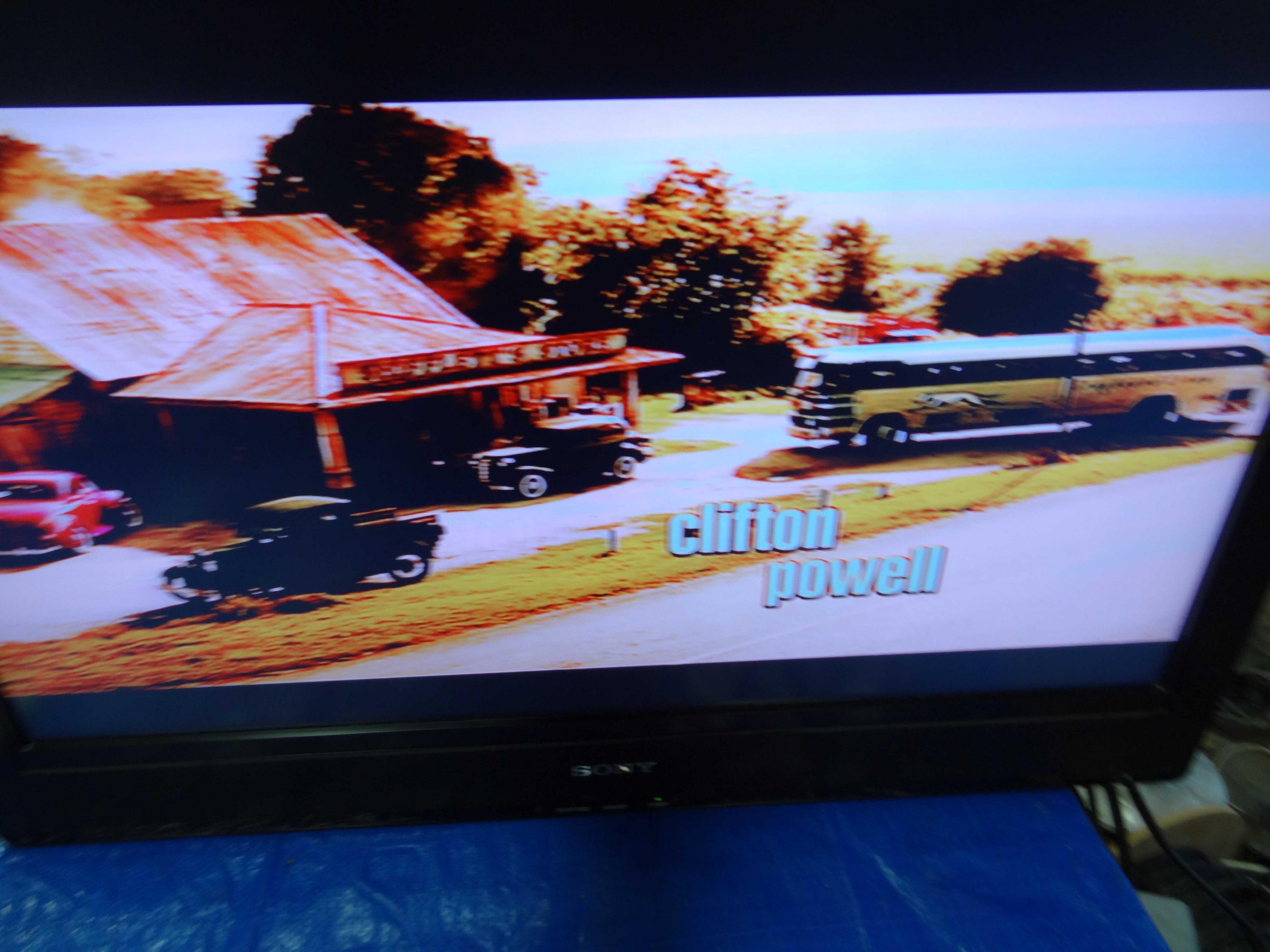

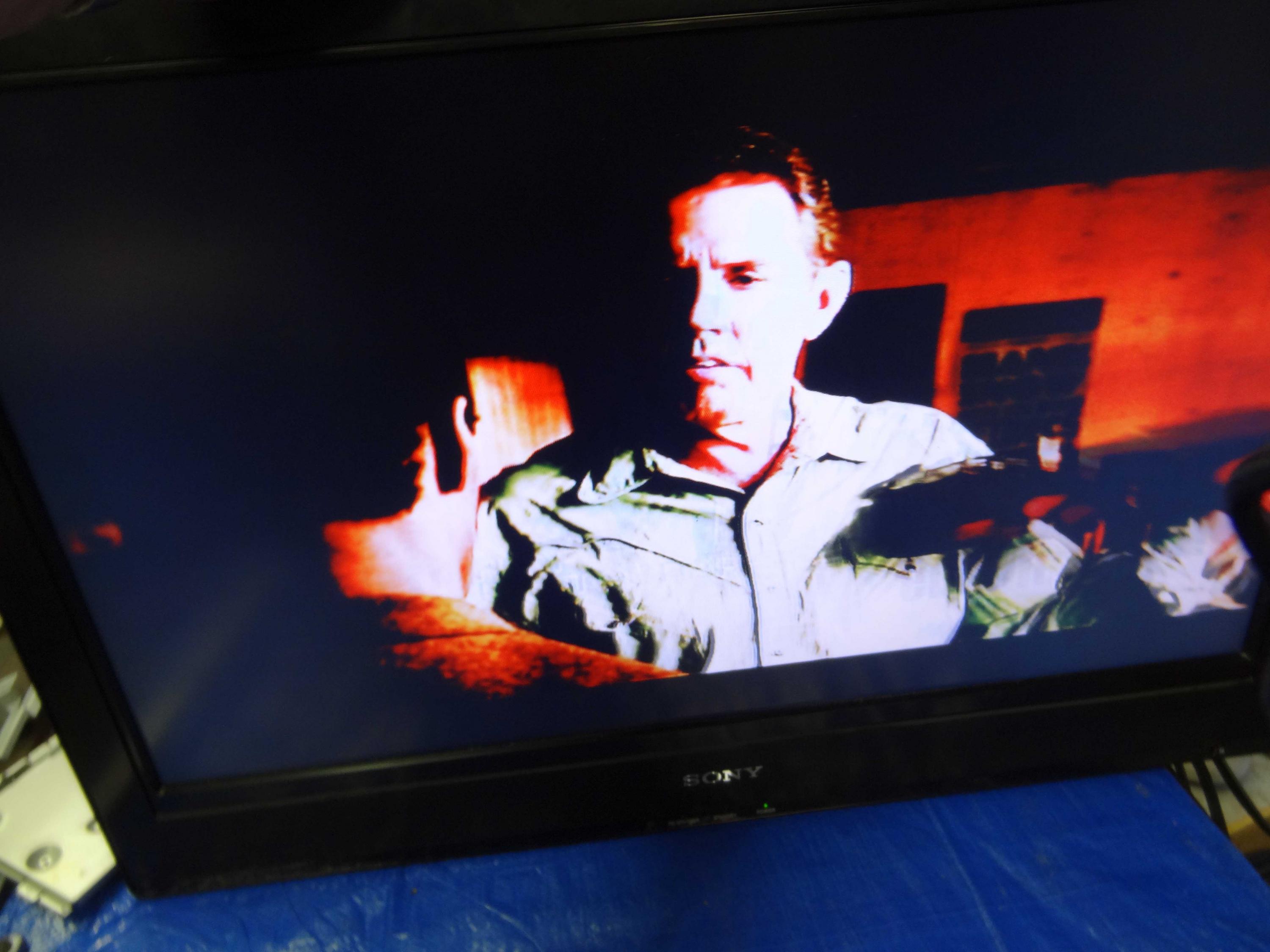

    I have a sony KDL 32S3000 that has a bad picture. Fuse F4003 had blown which caused a error code. The tv would come on shut off then flash the led . After replacing the f4003 fuse the tv stays on but the picture has very high contrast and can not adjust to bring it back to normal. I cannot find what circuit that f4003 powers. it is shown on the picture of the board but not shown in the schematic that i have. I replaced the T-con board because IC (U8) AS34-G on the t-con board was running very hot. I can not find any information on the t-con board. Thought it might be defective. AS32-g on the new board also runs very hot.Any input would be appreciated.

    Sorry to bring an old post up but my kids TV has the same picture problem. Also when you change channel or you get text on the screen for a few seconds you can still see it if you change channel or even av input. I have not opened the tv yet but i thought i would ask on here to see if anyone can point me right without having to track it down, Thank you.
