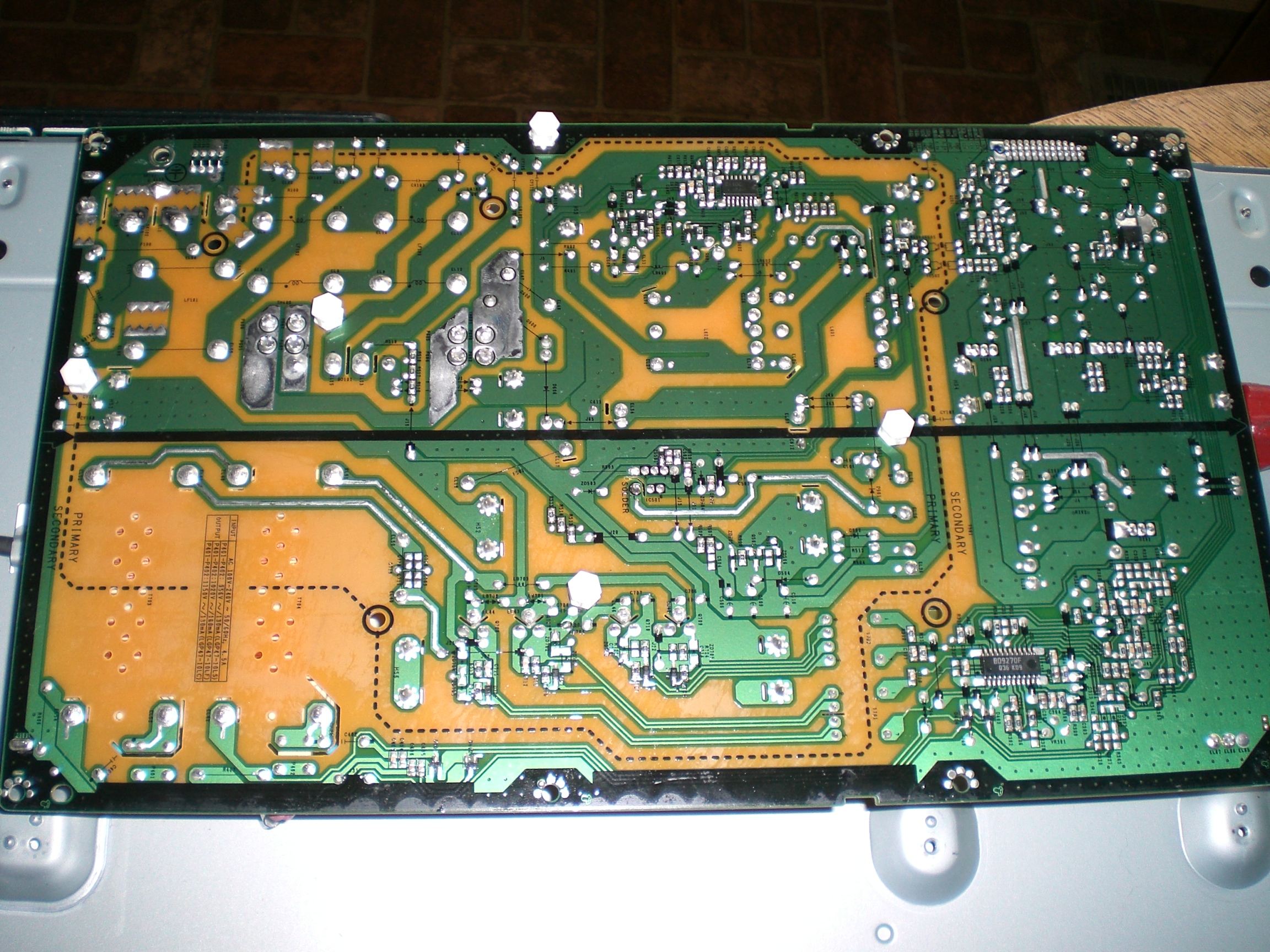

    Pulled an LG 47lk520-ua LCD from the dump and plugged it in. Red STBY LED is lit, but dims when power button is pressed. No picture or sound. Suggestions on where to start?
    Re: LG 47lk520-ua No picture, STBY LED dims
    Post good clear pictures so we can see what we are dealing with it.
    • ahickman
      • Jan 2012
      • 233
      Took me a few days to get back to this. The last picture is the backside of the power supply.
          Test standby voltage. If you're not sure which pin is standby voltage, post a picture of the legend near the connector running to the main board from the PSU.

                No. It is marked as 3.5 VDC. Tested the 12 VDC (12.40 VDC) and the 20 VDC (21.8 VDC) supplies. Noticed that the red STBY LED cycles through bright/dim at about a 3 second interval. No changes in the voltage readings. Also noticed that when PWR is hit again, the PS voltages return to 0 VDC, excepting STBY which remains at 3.5 VDC. I then looked for voltage at F1 on the T-con board. No voltage present on either side of the fuse. Checked the one voltage regulator that I see on the main board and saw 2.5 and 3.2 on the pins.
                  What is the marking on that regulator? I am thinking main board issue now. PSU seems fine.
