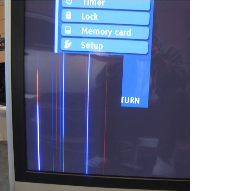

Panasonic TH-50PX60U, Panel or buffer board bad ?
  • Sevenqi
    • Jul 2011
    • 292

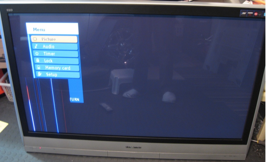

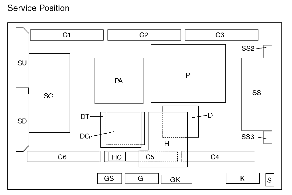

    Panasonic plasma tv, model TH-50PX60U, bottom left side has some vertical lines as shown in the picture. this TV has six C boards, TNPA3821 - 6, control the vertical upper and lower screen. not sure if bad panel or one of the C board bad.

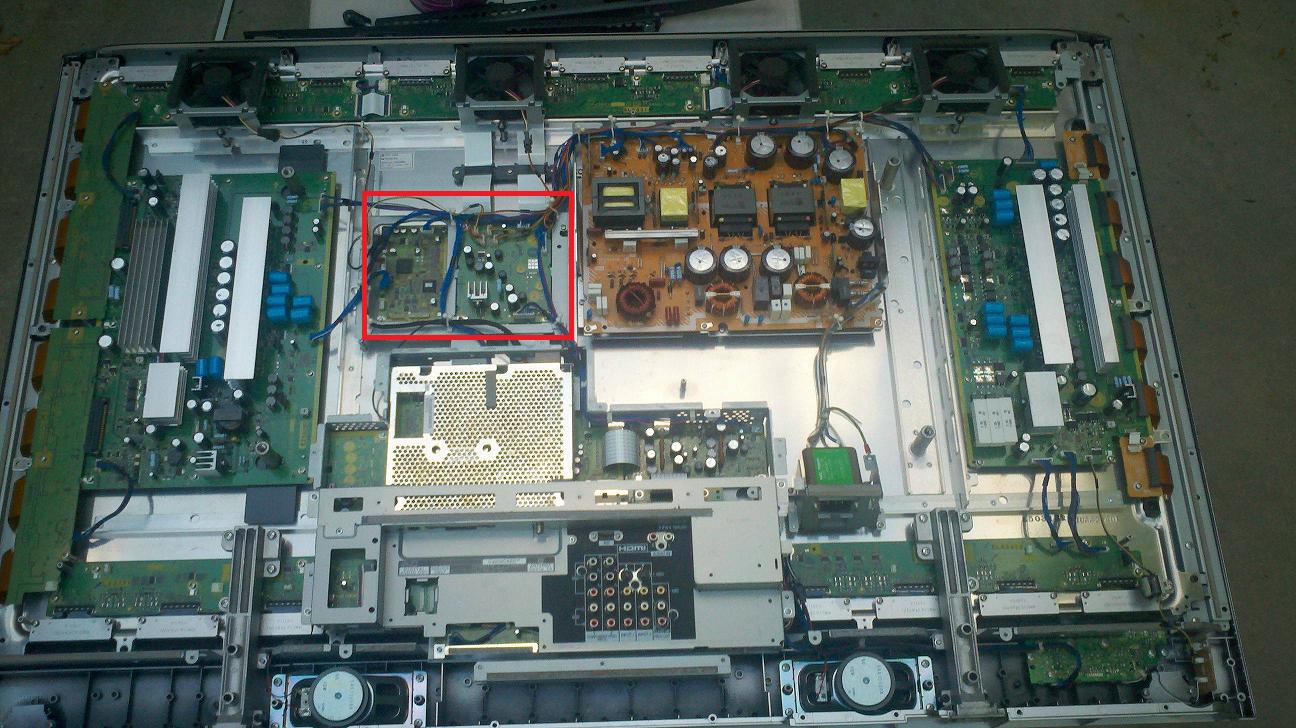

    Re: Panasonic TH-50PX60U, Panel or buffer board bad ?
    Upload a picture of the back looking.
      Considering it looks like most of the panel in that corner was out I would say its a bad logic board or x drive board.
