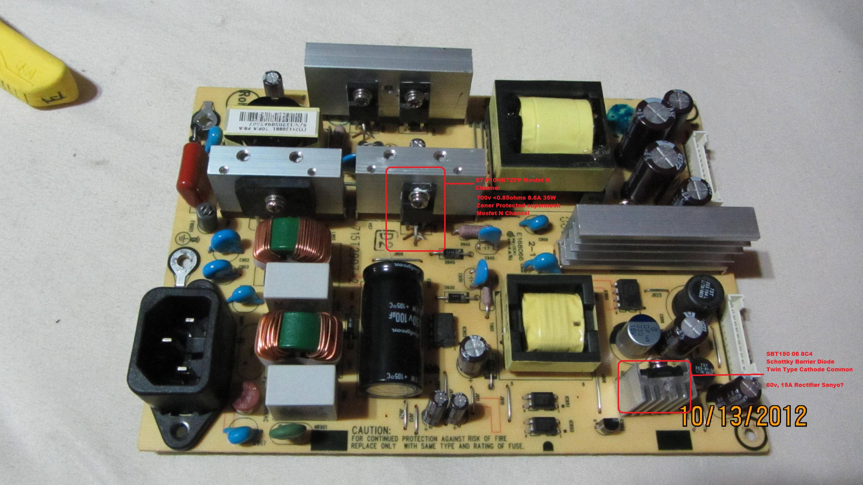

    If you look at the 12v POWER SUPPLY section, that transformer only has one winding for the 12v output, one end of the winding is tied to ground, another end is tied to the Common Cathode TO-220 case rectifier D950, the center pin output is connected to first filter cap and the inductor, the output side of the inductor is connected to another filter cap, this connection is then connected to one of the pin of the 12v output pin. Please look at the bottom of the board again and check that 12v on the connector.
    You are not going to have any 24v since that IC is blown, you can also take out that MOSFET for that 24v and check.
    You can expect the inverter board to go out in the future, too many transformers and fuses I had to replace in the CHIMEI inverter board. When you repair more than a thousand TV and monitors, you will see the pattern of what usually failed.
    Bad lamp wiring, yes,I fixed many of them also. It happens in all brand.
    http://s807.photobucket.com/albums/y...klight%20lamp/
    Main thing right now is to find out the P/N of that blown IC, without it, you will not get far. I already circle the MOSFET of the 24v power supply.

      The IC appears to be very similar if not the exact same thing as the other one on the bottom of the board ... IDK gotta check into it a bit further there are other projects deserving attention as well but gotta stick to this one as well.

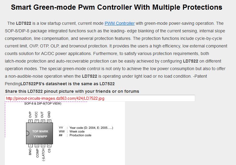

                      Anyways so I got this 32" power board it has nearly the same two 8pin IC's are on it ...
                      The one in question is the LD7522PS do you think that this would be what I need a Pulse Width Modulator IC ? If so I can order these chips fairly cheap so if this seems correct let me know it may differ IDK... The other 8pin chip matches exactly the remaining 8 Pin chip. So I am assuming that this chip should be the same as well I know it is bad to assume but based on my assumption I figure I could either get somewhere or stand corrected.

                        I pulled two chips off the board I need to learn how to properly test these with a digital multi meter if possible....
                        I know for the N channel mosfet there is GDS or Gate Pin 1 Drain Pin 2 and Source Pin 3...
                        ST P10NK70ZFP
                        So set meter to Diode Test.
                        Put black probe on pin 3 or Source.
                        Put red probe on pin 2 or Drain.
                        You should read nothing. (But I read and get a beep .003)
                        Took red probe off Pin 2 Drain.
                        Touched to pin 1 Gate
                        Then back to pin 2 Drain with Red Probe.
                        Should read something more but it does not.
                        The other Schottky Barrier Diode Rectifier 60v 15A SB150 06 8C4? Dunno if proper but them are the numbers IDK How to properly test I guess...
                        I want to get this right and figure out how to properly test similar to testing a diode, bridge rectifier, or transistor ...
                        I guess I need that info or maybe its not possible IDK I wanna get this thing running without investing too darn much more loot in it already screwed myself should have just got a used TV at this rate so the education will make it worth it.
                        EDITED IMAGE ATTACHED

                          Thanks for the help looks like I need a new board for sure one of the pads came off of the SMT IC if it were mine I'd rig it and get it working but it is not so I will have to opt for a board but because it is my screw up I gotta replace it at my own expense. The fun of electronics repair...

                            Don't know but the C940 cap in that picture looks like it has a bad solder connection.
