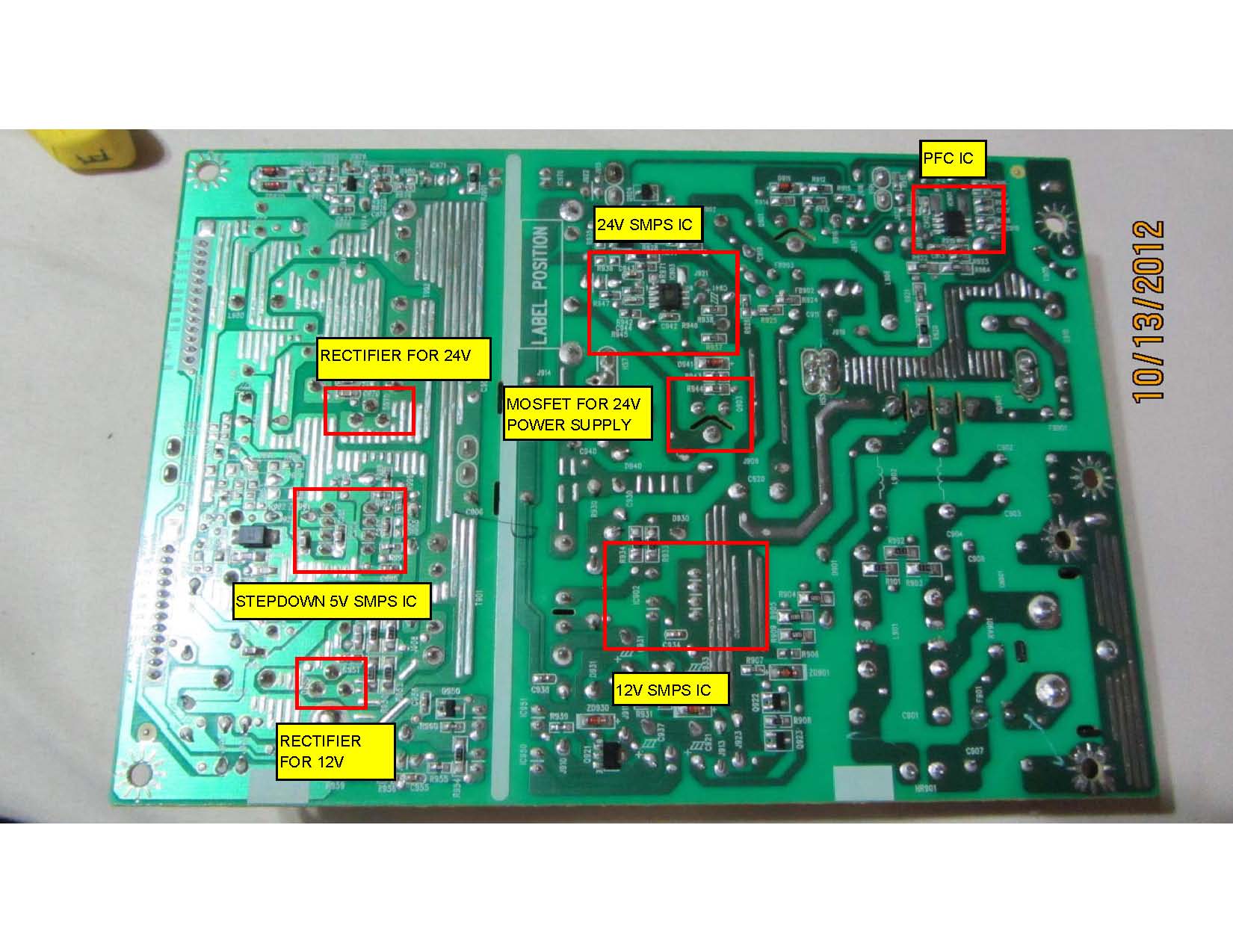

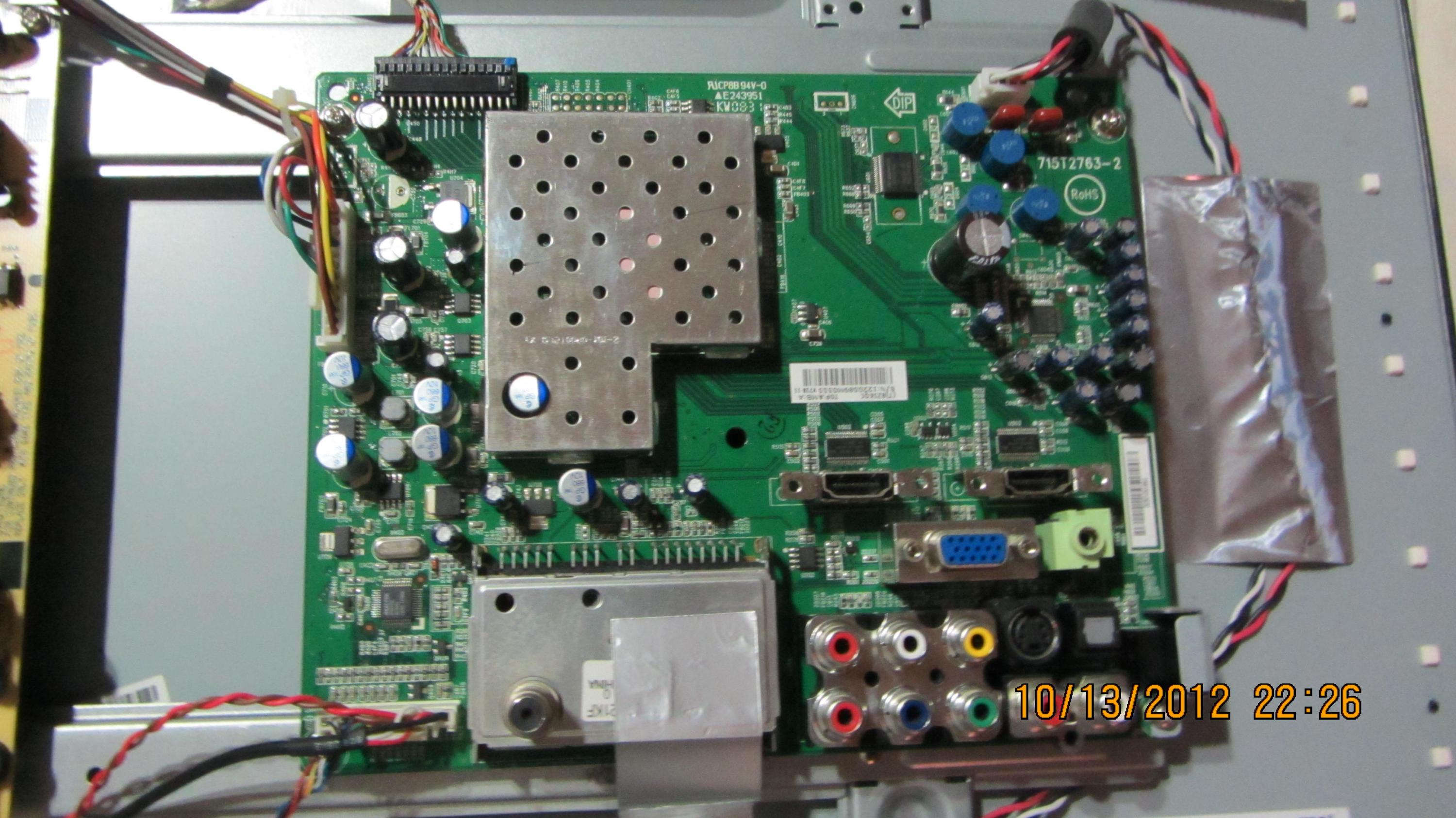

    I have a insignia power board which had a blown fuse upon initial test.
    I replaced the fuse and it blew.
    Upon inspection I determined that the bridge rectifier was faulty.
    I replaced the bridge rectifier and the fuse.
    I turned on TV and the red light blinks 5 times then goes to solid red.
    So next I hit the power button and it stays a solid blue like it should but there is no picture.

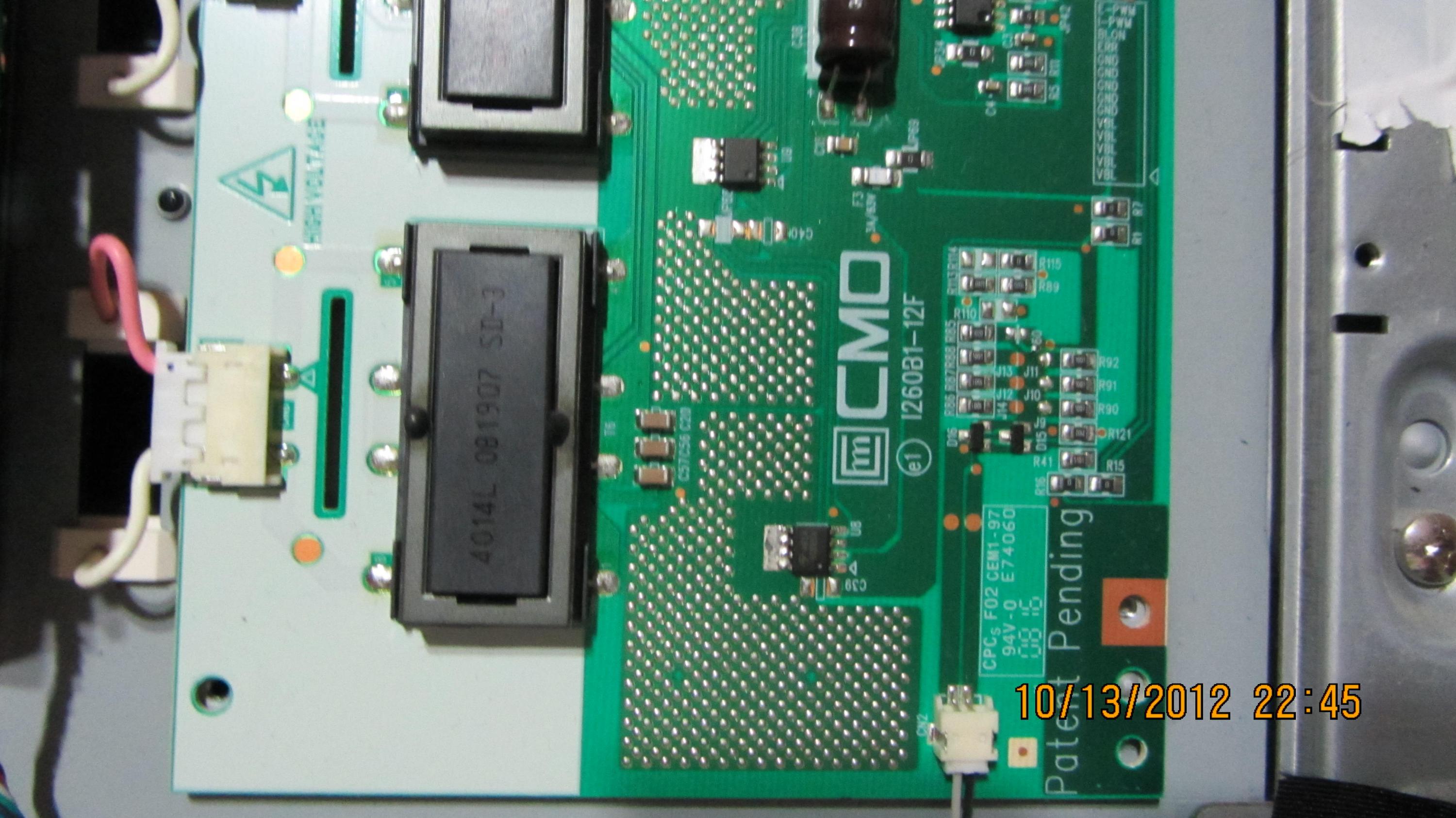

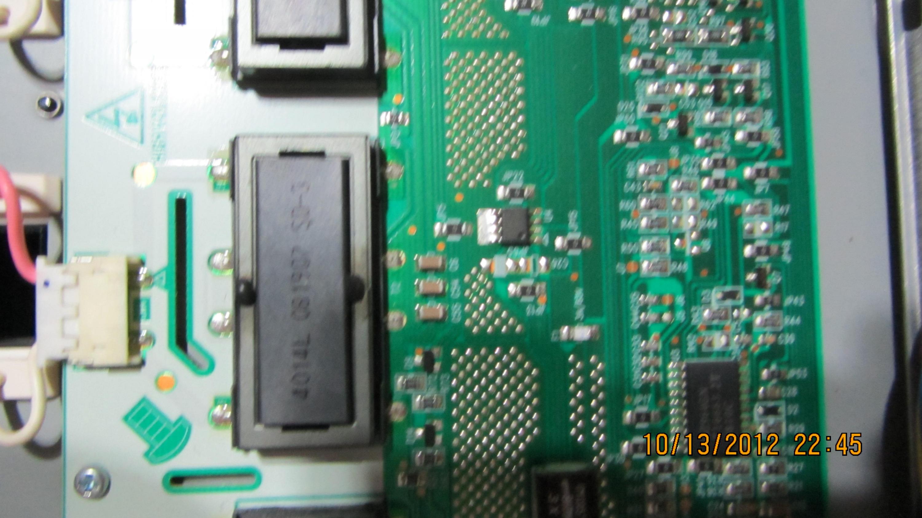

    So I popped it open and tested the voltage lines going to the backlight and found there is no 24v going to the backlight.
    What would be possible causes to this issue.
    Pics are attached for additional explanation and making your job easier to aid me if possible.

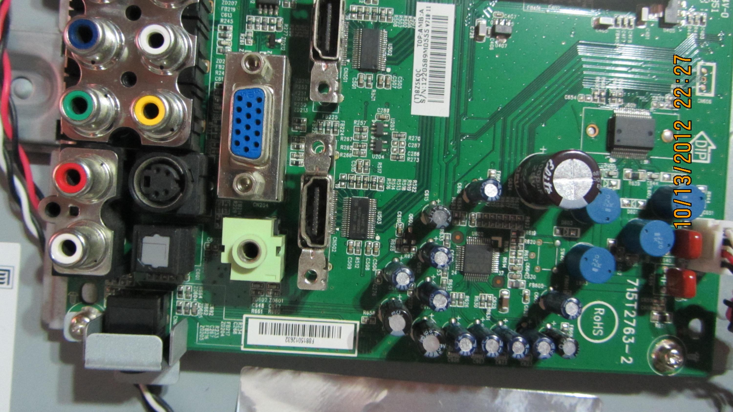

    OK, Can you please take good closed up pictures of the 2 white connectors if they have any labels on the them to tell me which pin is PS_ON, BL_ON.
    Also check the DC voltage on that large black cap in the primary side, it should have 165VDC when TV is plugged in, and around 400v when TV is turn on.
      Re: Insignia 26" power board need help
      budm the pics are already there and they are clearly labeled all you need to do is click on the 5th pic then when it comes up click on it again and you can see the full resolution picture and then zoom in on it the markings are very clear actually....
      Please note: I am not responsible for any harm caused to you anything discussed is just discussion. Before you try anything discussed be sure that you have the appropriate knowledge and safety gear for the job. Like with anything education and safety are first! Do not try anything @ home without it.
        OK, my eyes are not that good, I had to really zoom in to read them. So what DC voltage do you have at PS_ON and the ON_OFF pins, and also the DC voltage on that large cap?
          Cap in standby red light= 166.5v
          Cap when on blue light= 393.6v

            When blue light is on and powered on here are the voltages:
            ON/OFF= 3.285v
            PSON= 2.734v
            Note these are measurements from the video board connector on the power supply.

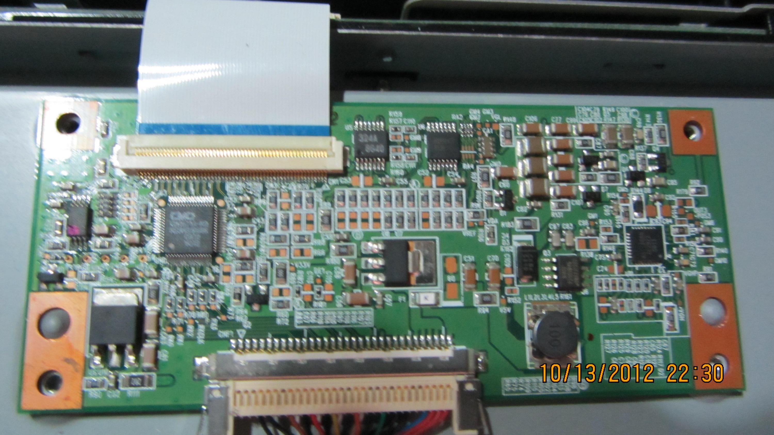

              Here are some more pictures to help determine whatever is wrong I don't want to guess here unless it is educated but I have 2 nagging suspicions on what the problem is but I will resort from guesswork unless there is something educated pointing me in such a direction.
              Anyhow here is the pics...

                    Here are measurements taken from the power board connections:
                    PSON = 2.734v when on
                    ON/OFF (out to video board) = 3.2v when on
                    ON/OFF (out to backlight inverter board) = 3.2v when on
                    All 24v (out to backlight inverter board) = .100v when on
                    Big Filter Capacitor (When in standby) = 166.5v
                    Big Filter Capacitor (When on) = 393.6v
                    PS I attached better closeups of the power connectors...
                    Thanks guys hope this helps.

                      Is PSON much lower when TV is in standby?
                      It looks like the main board is working fine, so the problem is on the PSU.
                        PSON (standby) = .098v
                        Either that or the backlight itself could be bad but you would think the 24v out would be higher unless there is something that reports the backlight as faulty errr IDK keep trucking dunno what to check next been checking resistors and such in the mean time still going at it but an educated approach would be better...

                          OK, do the 5V and/or 12V change when in standby?
                          I think the 24V should measure more than 0.1V! I think that if it is low, it is likely a PSU problem, but it is possible (though unlikely) that the backlight inverter is shorted out. Normally it would blow the fuse on the inverter though, which would allow the 24V to come up.
                            well according to what I am reading there is no 12v on the video board connection it reads
                            0v when in standby and then .003 when powered on....
                            +5v(video board connector) is at 5.00v when on and remains the same whether standby or on
                            +12v(video board connector) is at .003v when on but is 0v on standby
                            +24v(video board connector) is at .100v when on but is 0v on standby

                              Hmm, do you have any sound from the TV?
                              12V should power the sound amplifier and is run from the same supply as 24V.
                              Very odd the TV would work without 12V, but I guess it generates everything it needs for a picture (without backlight) from 5V.

                                  It points to a problem with that main supply. Likely a shorted diode or a bad startup capacitor. Since 12V is dead zero, I'm thinking the fault is there.
                                  Can you post a picture of the underside of your PSU?

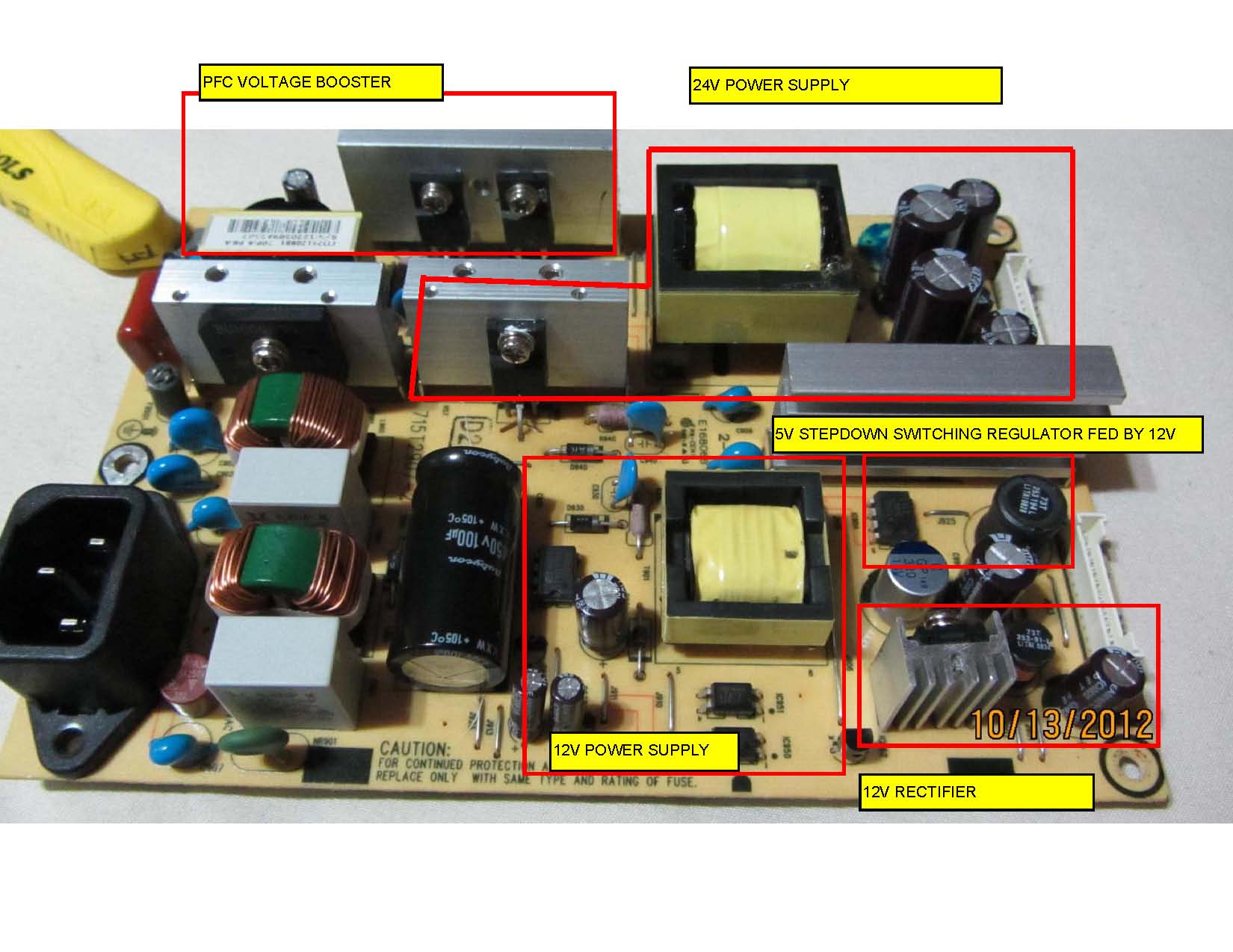

                                      OK, I look at the board layout, this power supply has always on 12V power supply , its output is stepped down to 5V for the logic circuits. So you should always have 12V and 5V at the output connector at all time.
                                      The switched 24V is just a single output for the backlights inverter board.
                                      The power supply also has PFC Voltage booster circuits.
                                      The bad news is that the SMPS IC that blown its top is for the 24V power supply, and it is very likely that the MOSFET for the 24V has Gate to Drain shorted out so it dumped 400V into the SMPS IC.
                                      This TV also use CHIMEI backlights inverter that is famous for bad transformer and blown fuse for the PWM IC.
                                      So verify that you do have 12v, it must have 12V otherwise you will not have the 5V because the 5V is generated from the 12V section.
                                      The bad part is to figure out the P/N of that blown IC, and you will need the MOSFET and component around the Gate drive circuits also, lots of work!

                                        hrmmm oddly contrary to what you say I have 5v but I do not have 12v and the picture on the LCD I can see with a flashlight no video or sound but I can see the OSD menu ...
                                        Very tuff I know but this is what I have found so far my +5v's are all fine metered at 5.00v when powered on 12v I have almost nothing and 24v I have almost nothing... Che Mei or however you spell I have seen lots of backlight issues with these screens as well in computer displays specifically and normally it has been corrosion and the backlight harness arcing off on the frame almost as if they didn't truely use the proper hi temp wire and cut corners in this manner. It is interesting to know that the power board issues would arise from their backlights I would think that would all be on the power board and inverter board engineers more so from the engineers assembling the rest of the TV or monitor with their power circuits.
                                        Anyways with all of this I don't wanna get too much more off the subject but is there anything that you would suggest to test next in circuit which mosfets or voltage regs would you suggest I check ....
                                        Yes this is a wild one but I do have 5v's weather standby or powered on...
